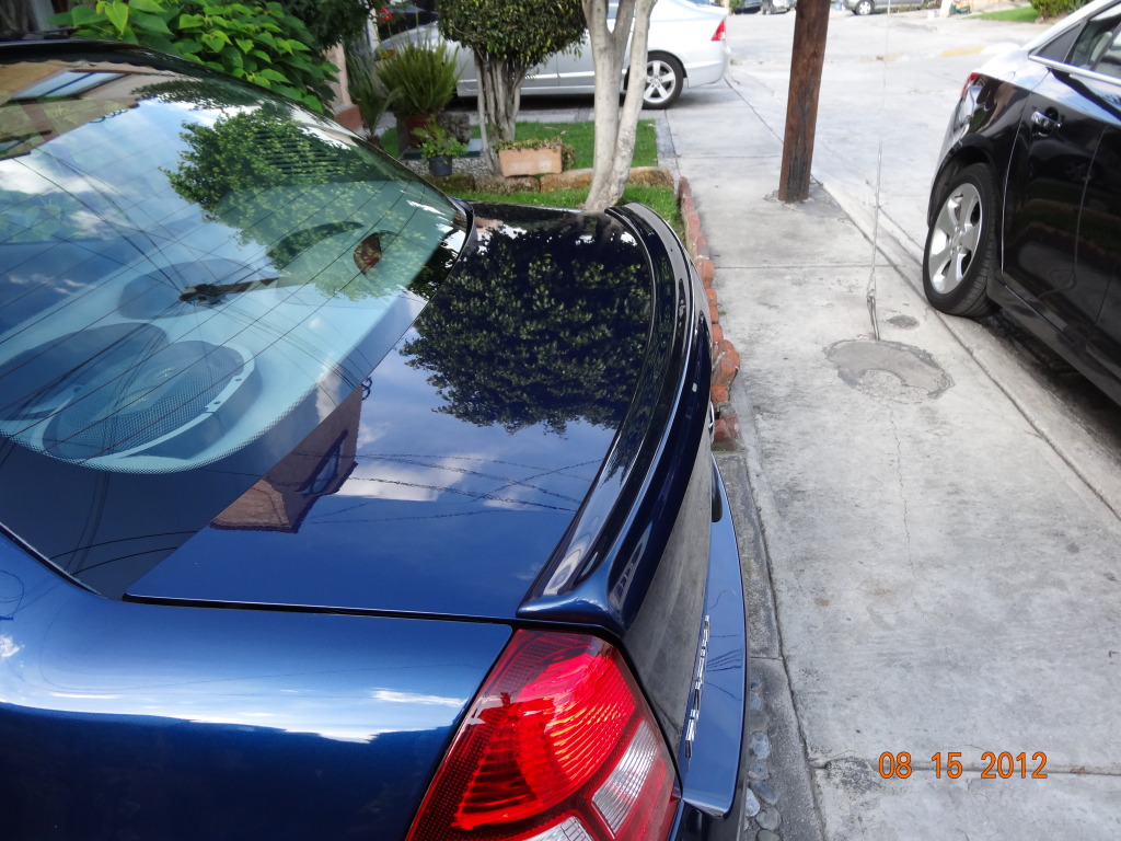

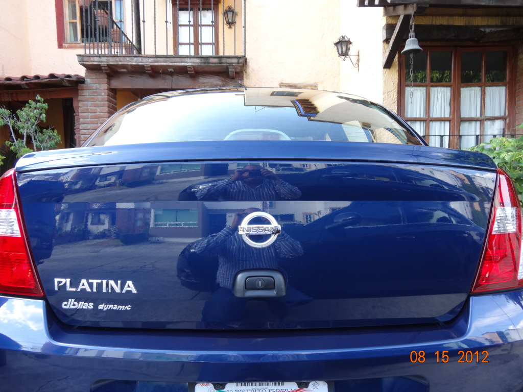

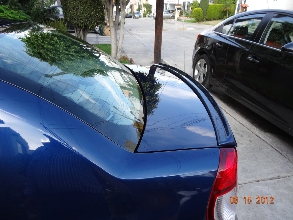

I agree,I think maybe a little lip spoiler on the tailgate aswell?
Yes, I will install something like this:

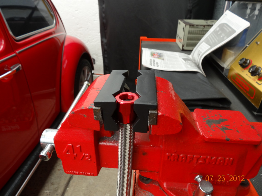

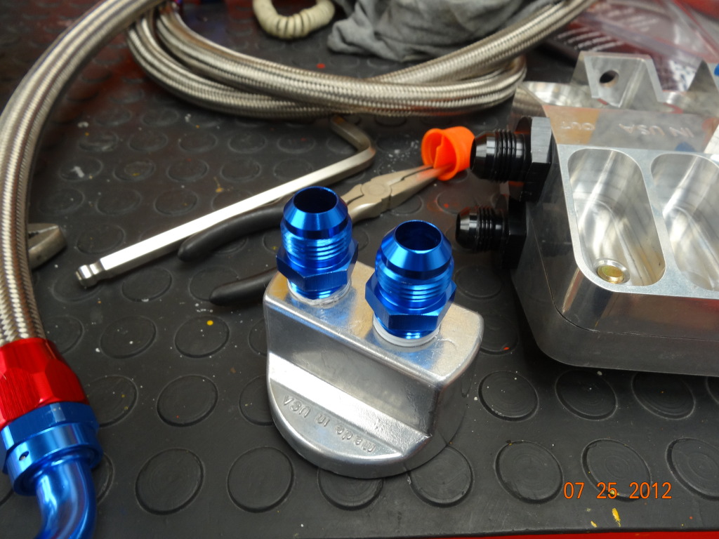

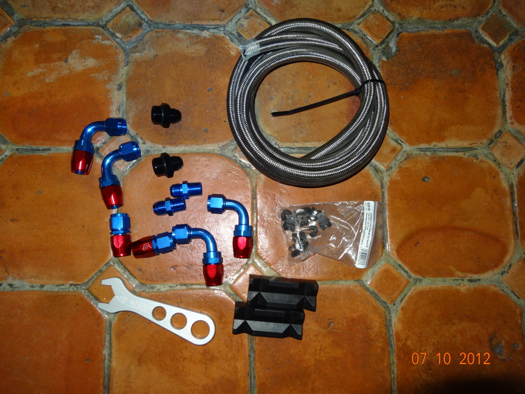

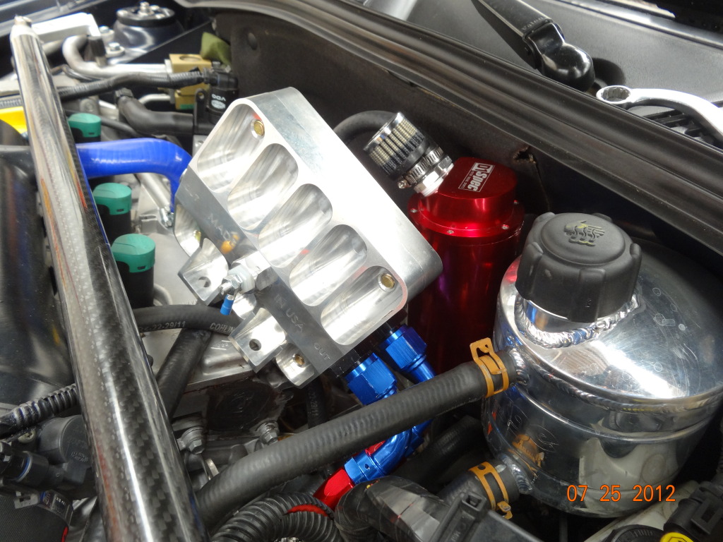

Today I got my hoese and fittings for my O'Berg Oil Filter:

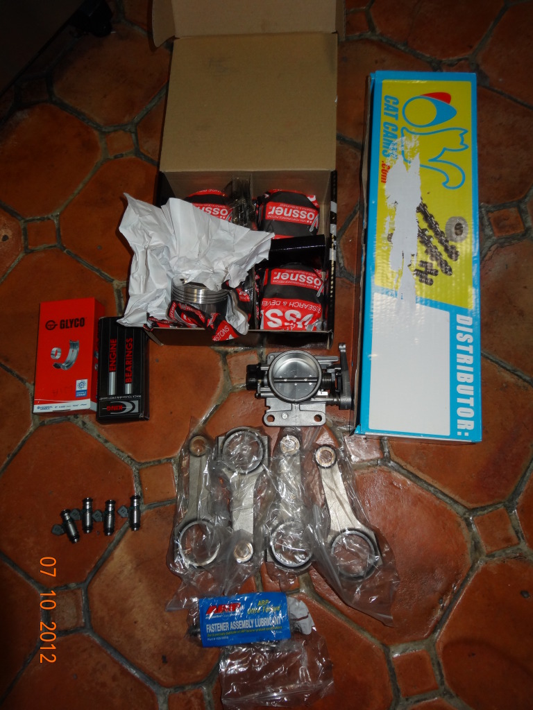

Also got the CatCams, The Forged Pistons & Rods(with ARP bolts), the Weber Injectors, the BIG Throttle Body & Engine bearings...almost done with the parts, still waiting for some small bits

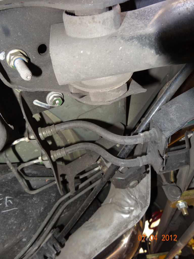

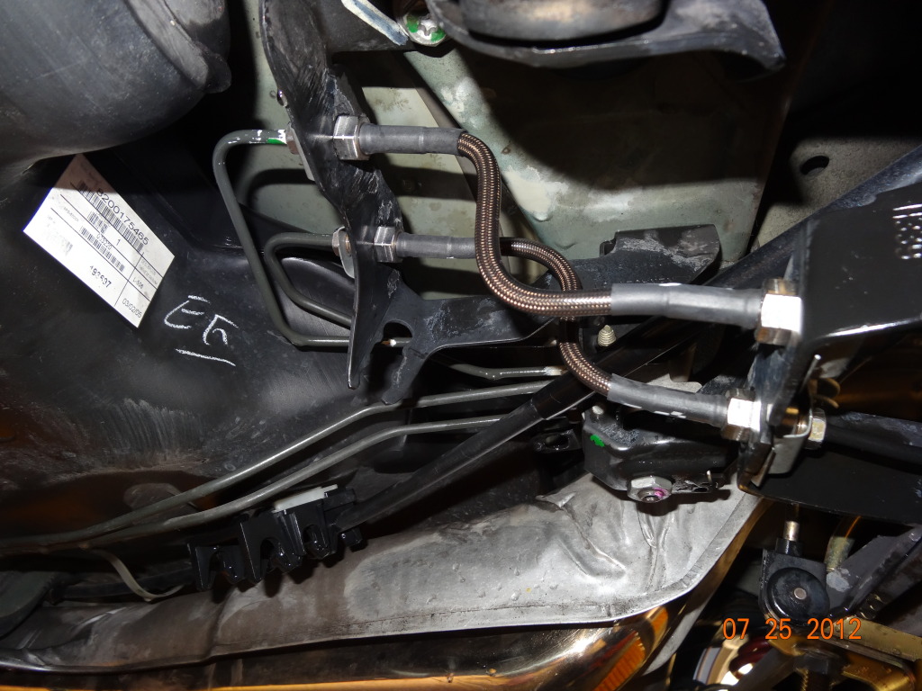

I've never seen the rear brake lines done like that before. You are putting the second set where the first set should've gone - i think!
Great project!
Thanks!, Yes, I'm installing this second set here:
And keeping the extra front lines as a spare...
The rear hoses are installed now!!!:

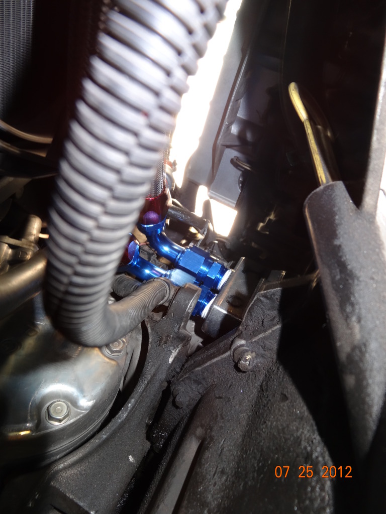

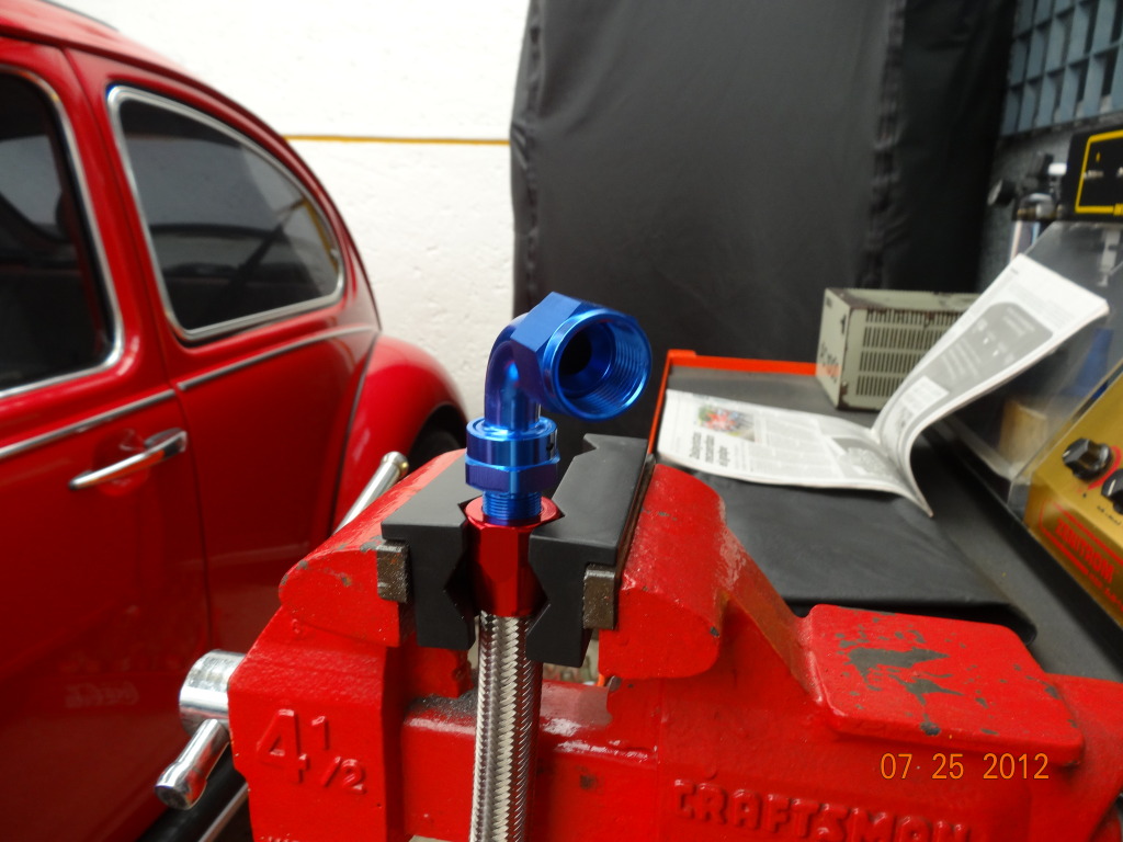

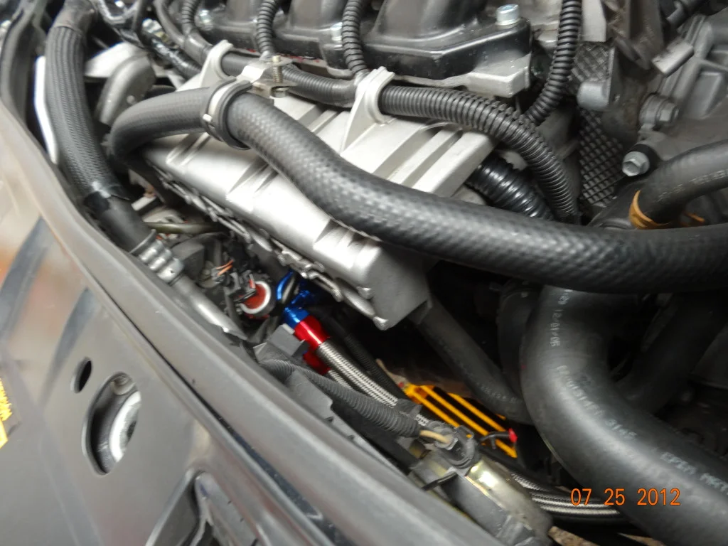

Doing the O'Berg Filter pumbling....a nightmare to install the adapter and hoses.....but It's done:

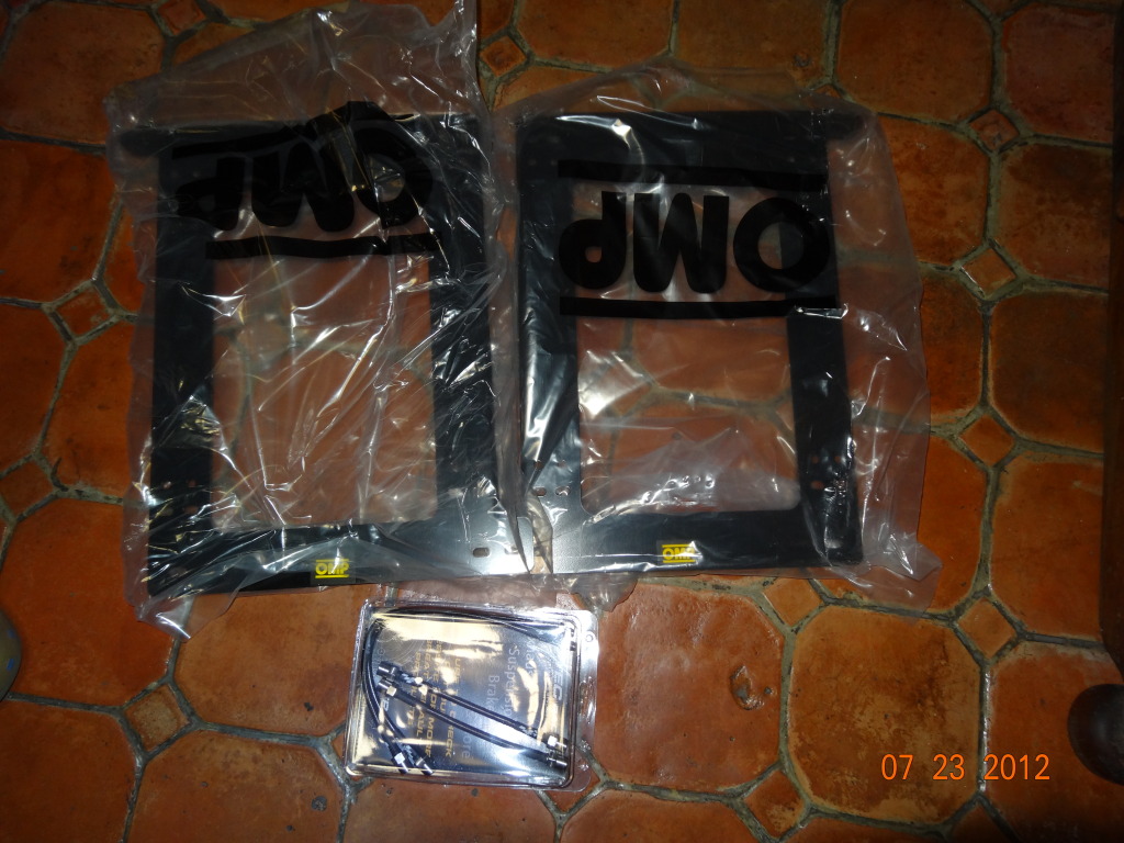

Thanks!, once I got back from vacations, I will order the sport seats and try to find time to pull the engine out and install all the parts I got...once I get the seats I will send the car to the shop to make all-leather interiors and insatall the rear lip....and I guess I'm done :p

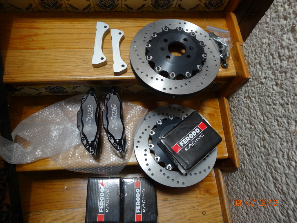

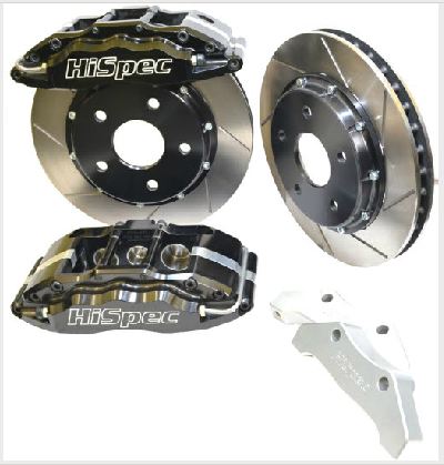

Ordered BIG BRAKES today!!....thanks to Alex from HiSpec MotorSports....he is the man!, thay are going to fabricate an "special hub" for me so the brakes clear my rims profile, this set has 325 m.m./32m.m. floating curved vane and drilled rotors, slim calipers with 6 stainless steel pots, Ferodo DS 2500 sintered pads & custom hubs...lead time is 30 days...I can't wait to have those!!

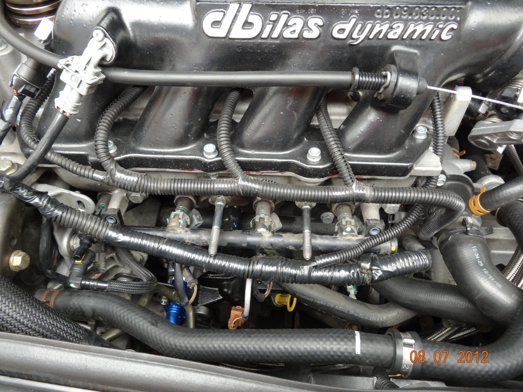

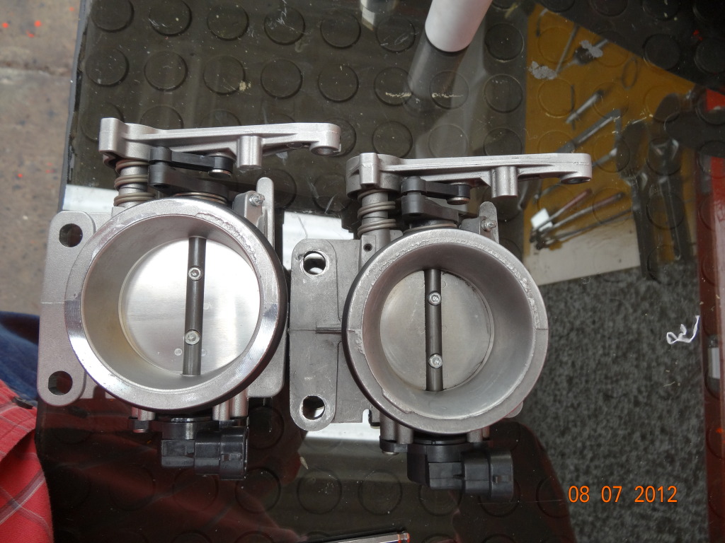

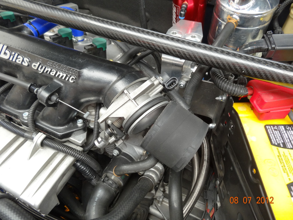

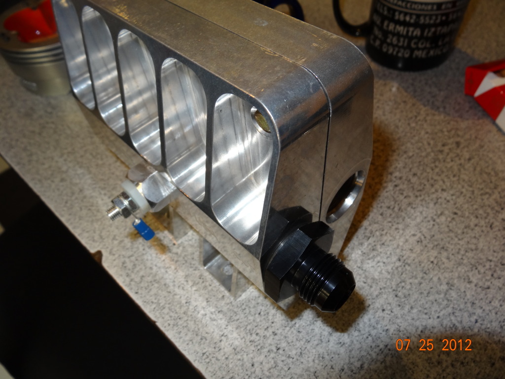

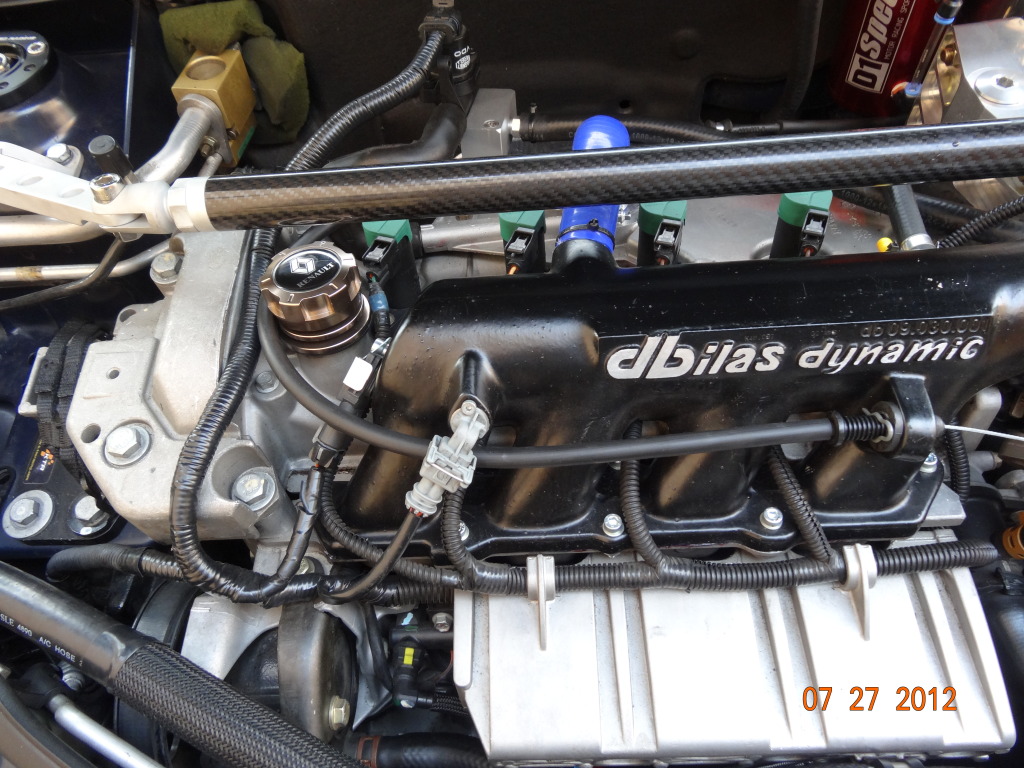

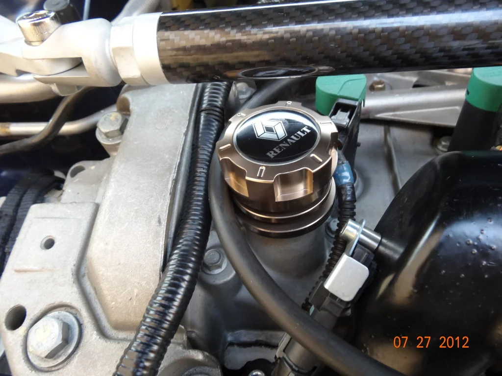

Installed today the big throttle (65m.m.) and the 250 c.c. injectors:

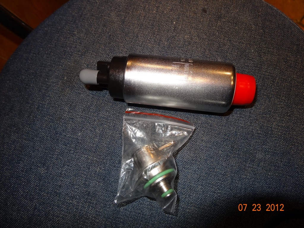

I could find the fuel pressure regulator, at least is not located at the injector's reel.....maybe this K4M 1.6 engine doesn't have it?
Any Advise would be appreciated, Thanks!

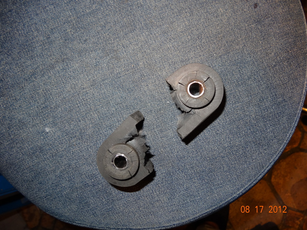

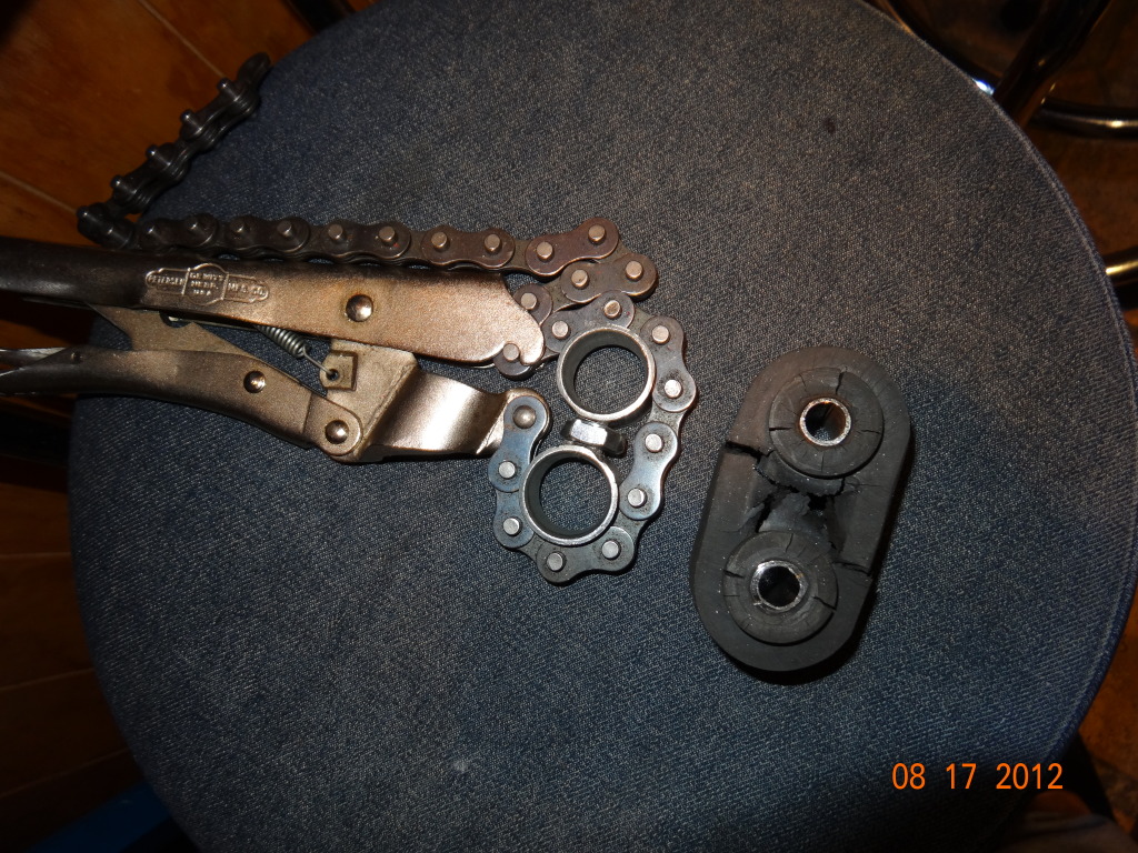

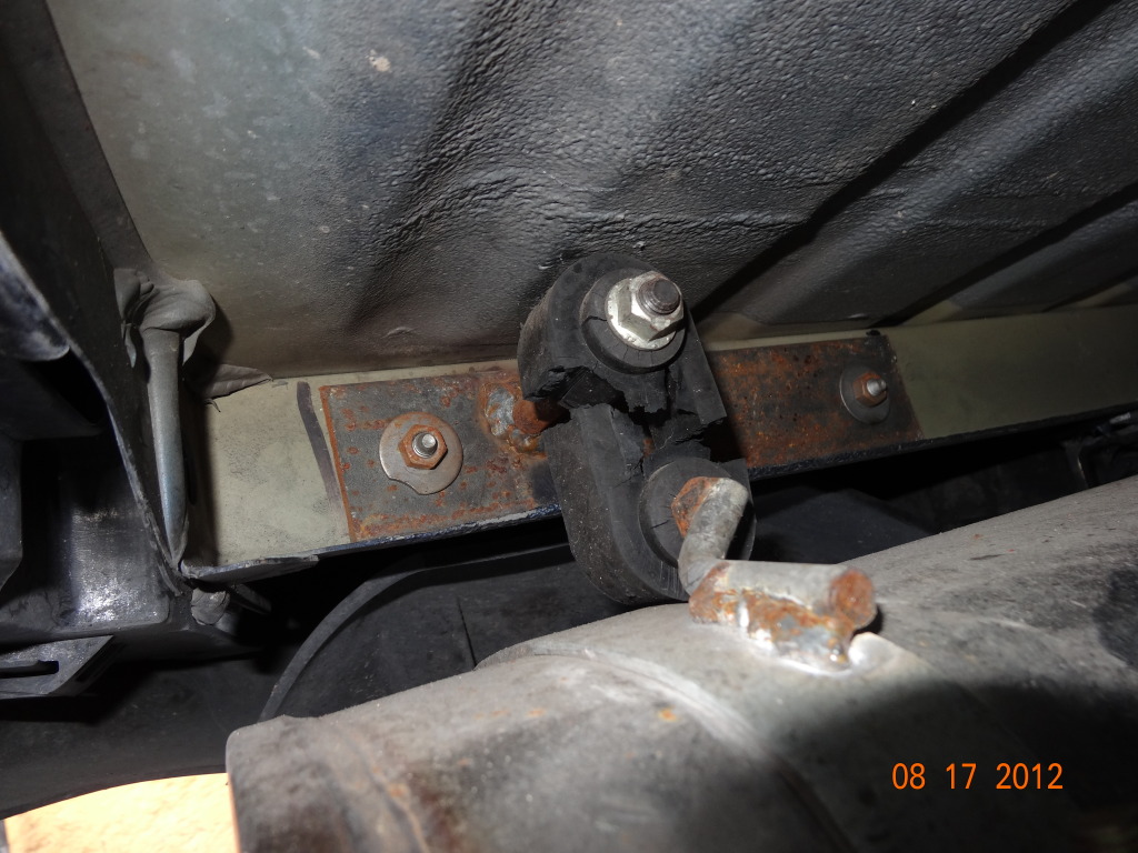

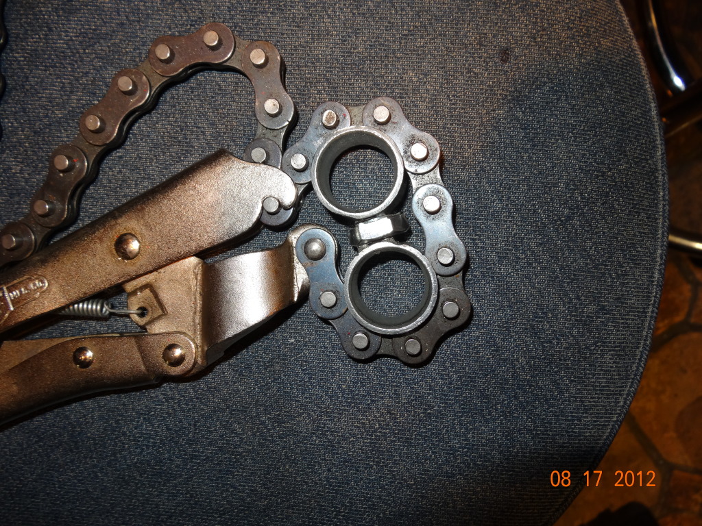

Building a "support" for my silencer....tire of braking the "rubber" supports...
Will pot more pics when finished and installed

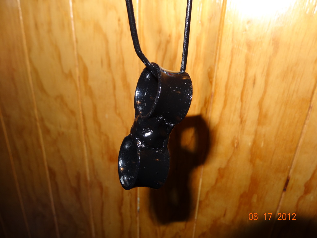

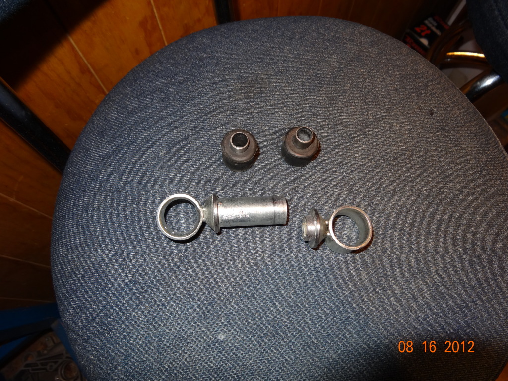

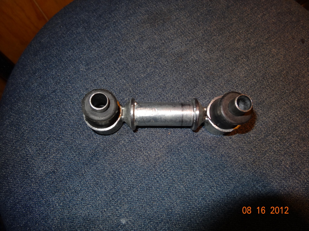

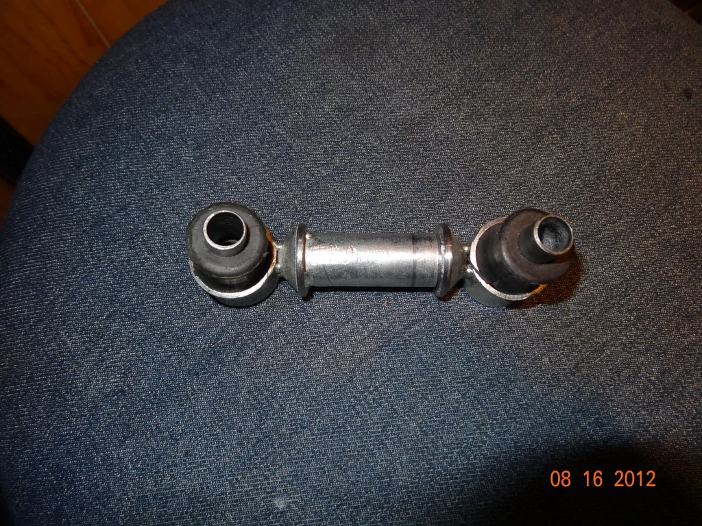

Here is the rubber support that always brake:

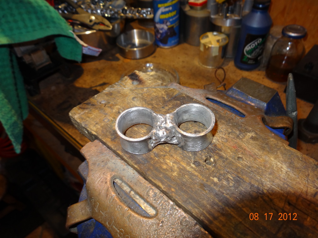

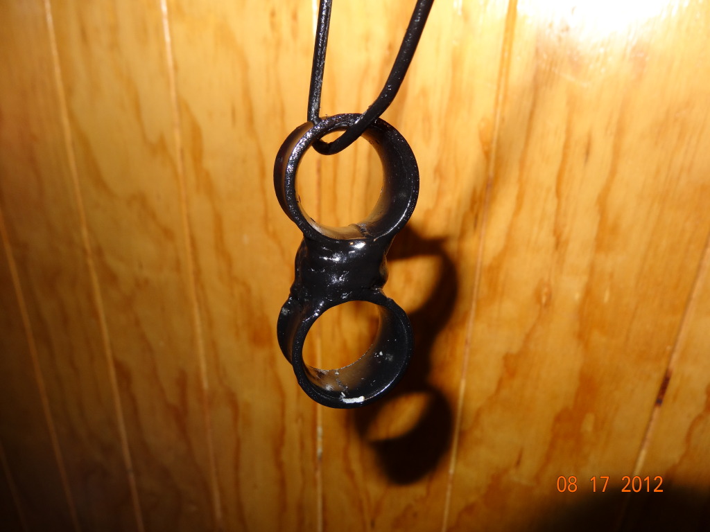

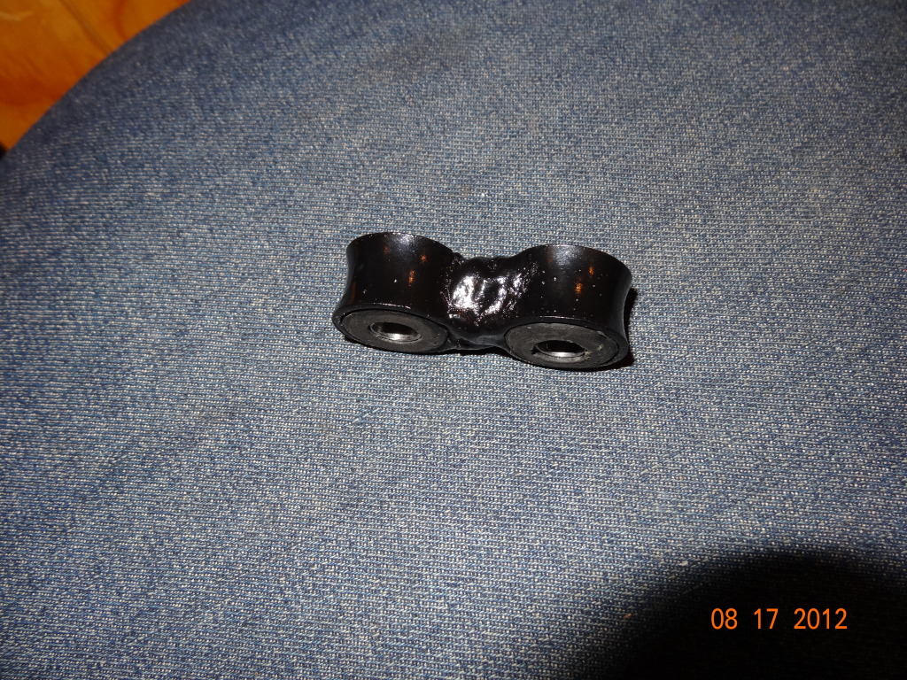

Had to make the support a lot more short....

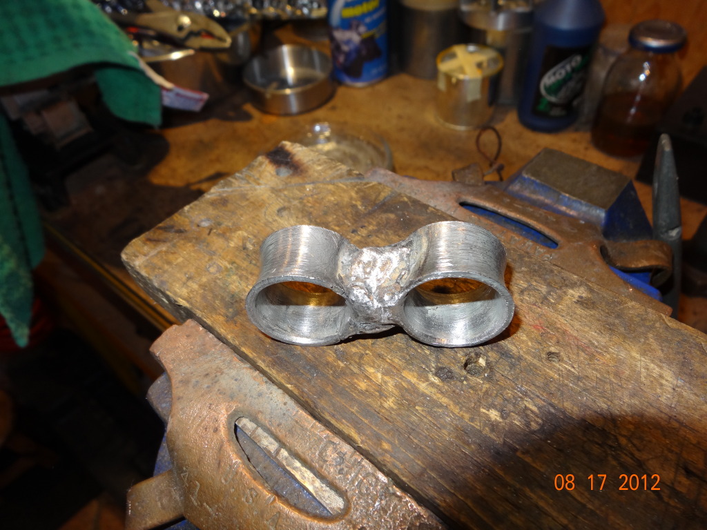

Ready to be welded:
Welding skills are no good:

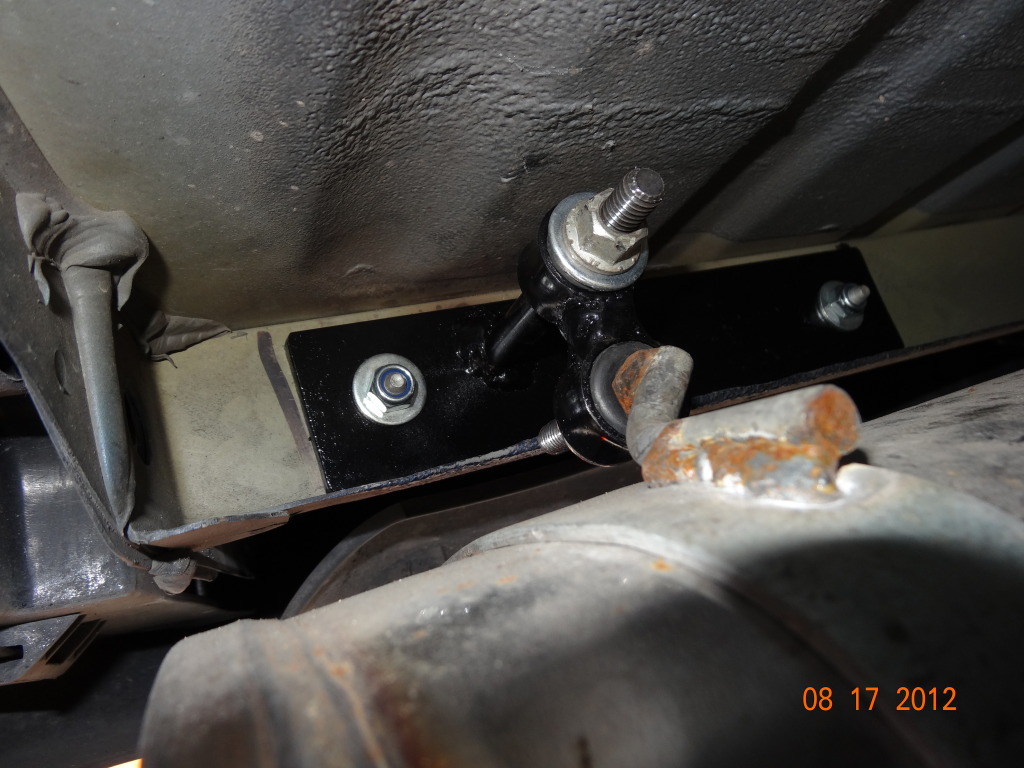

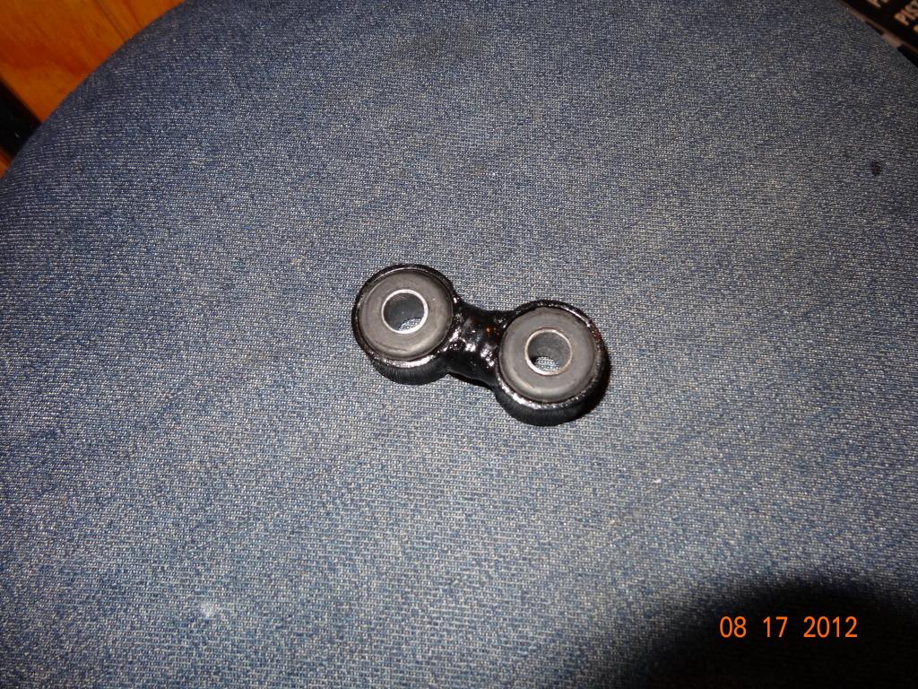

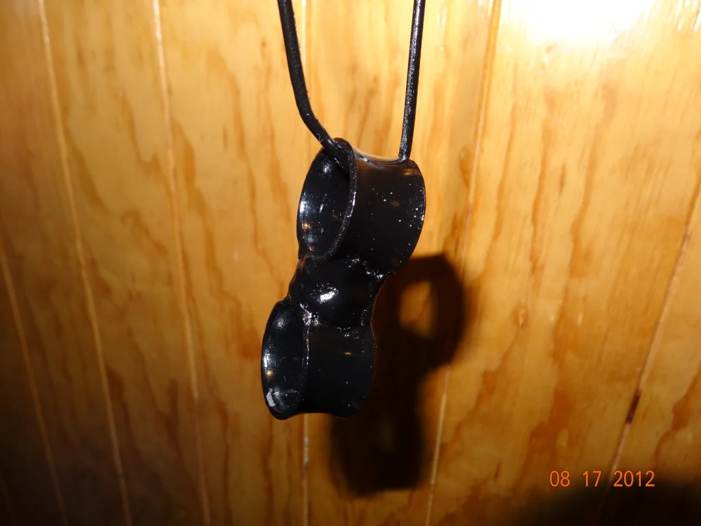

Finished and painted:
With the rubber bushings installed:

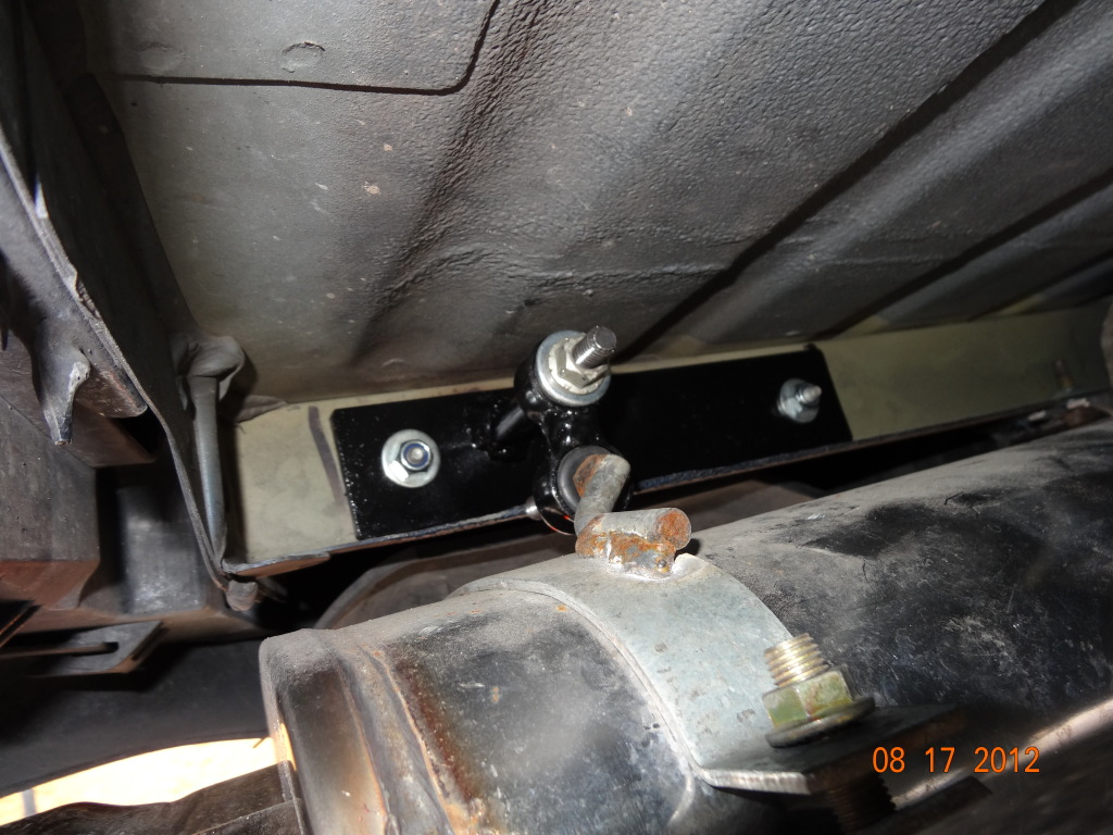

Installed on the car:
I guess this strong enough and won't brake again :S
