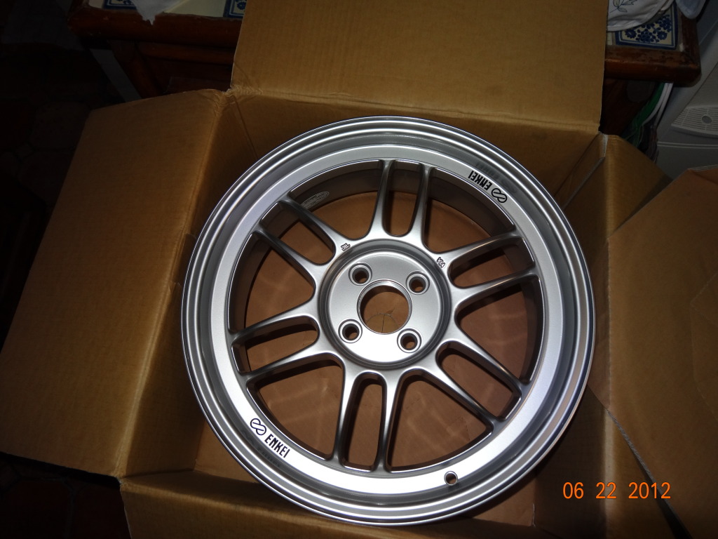

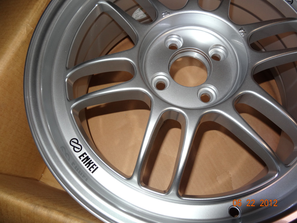

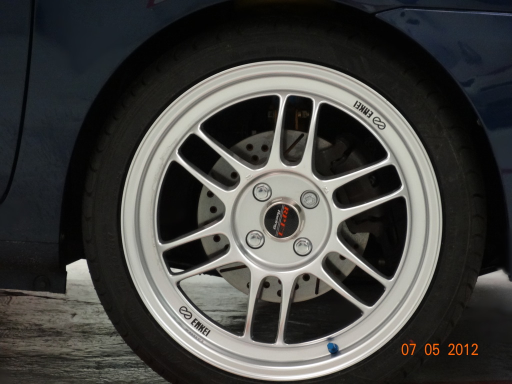

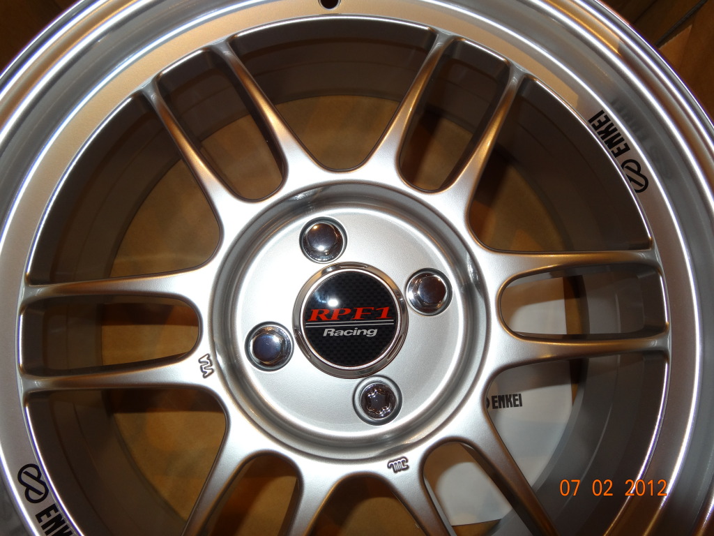

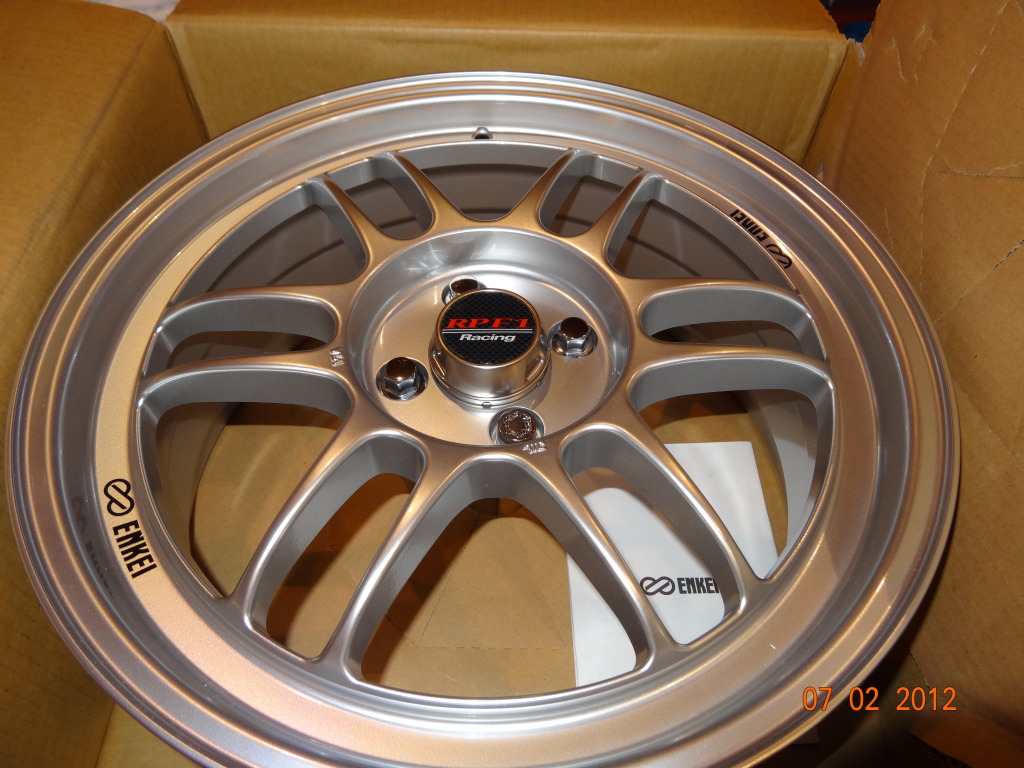

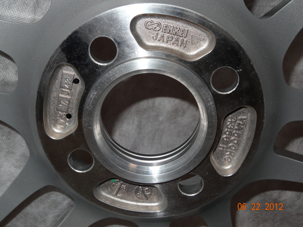

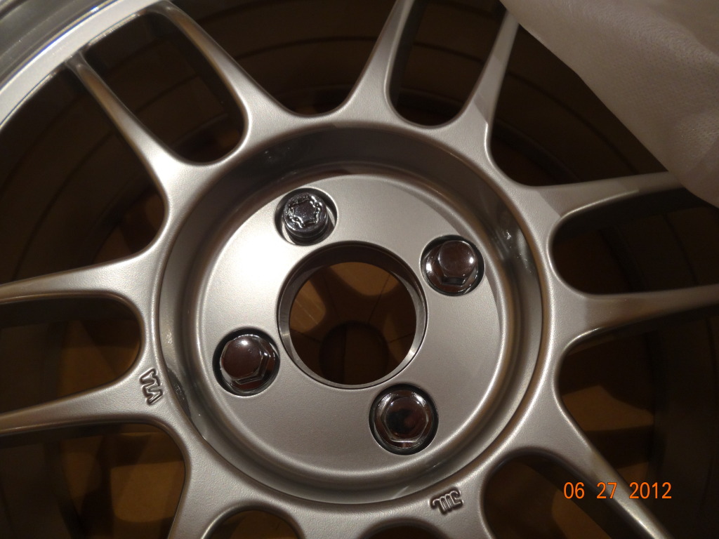

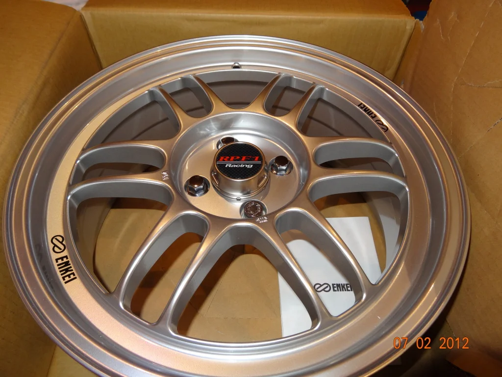

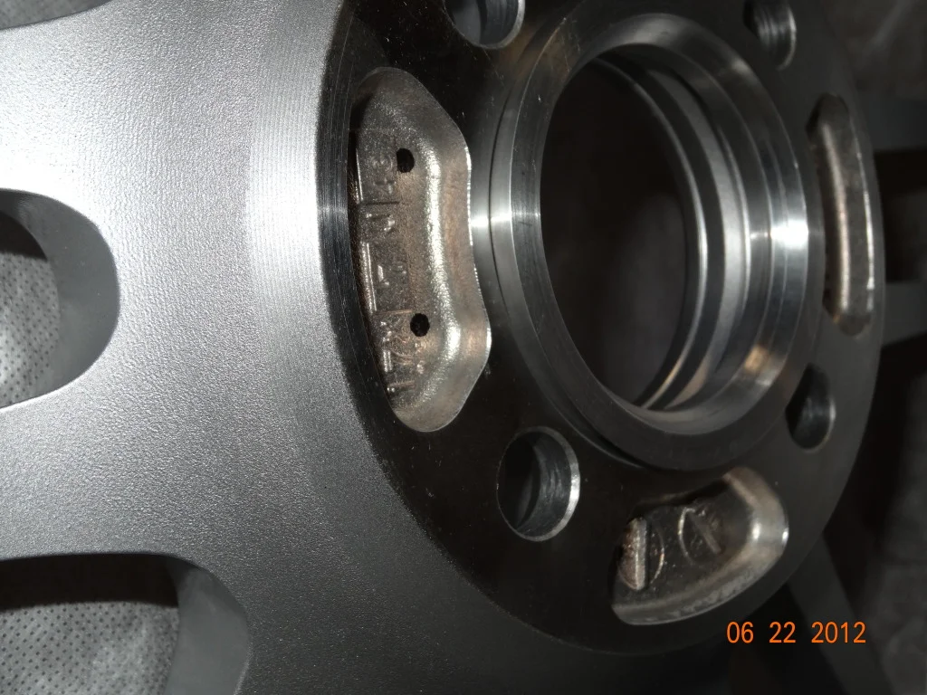

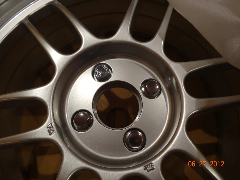

I got my rims back from the shop...a friend of mine fabricated a nice set of "spacers" for my new rims; the rims center hole dia. is 73 m.m. and the humbs are 60 m.m., hence an spacer was needed, here some pics:

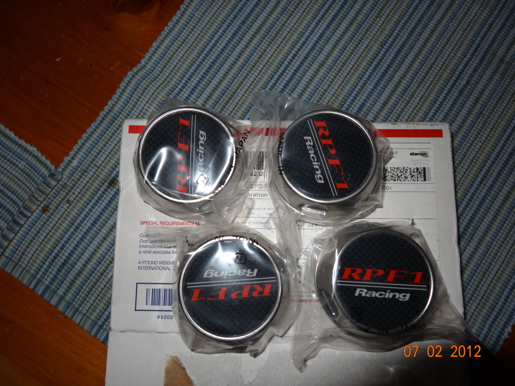

Now I have to get a nice and good quality of kug bolts and wait until the center caps arrives(not included with the rims :banghead: )

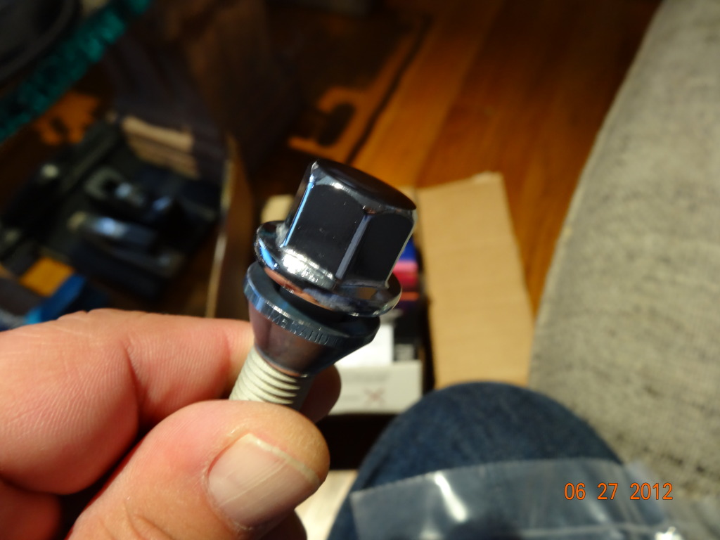

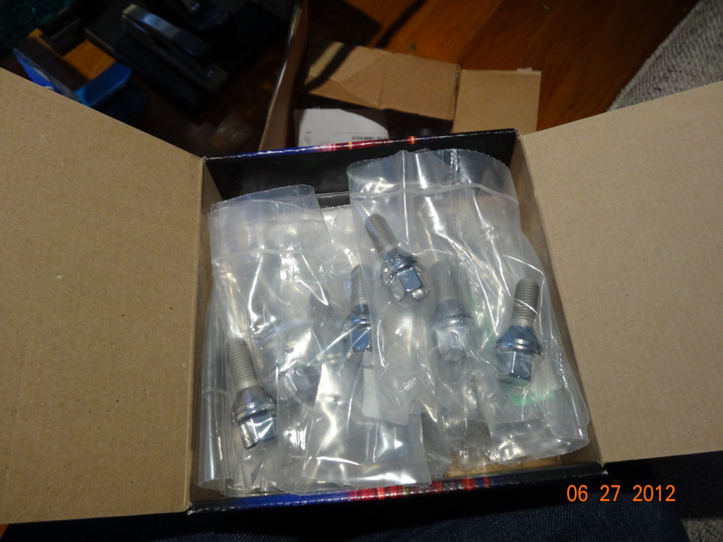

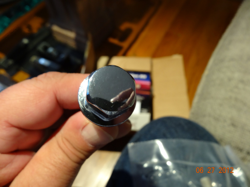

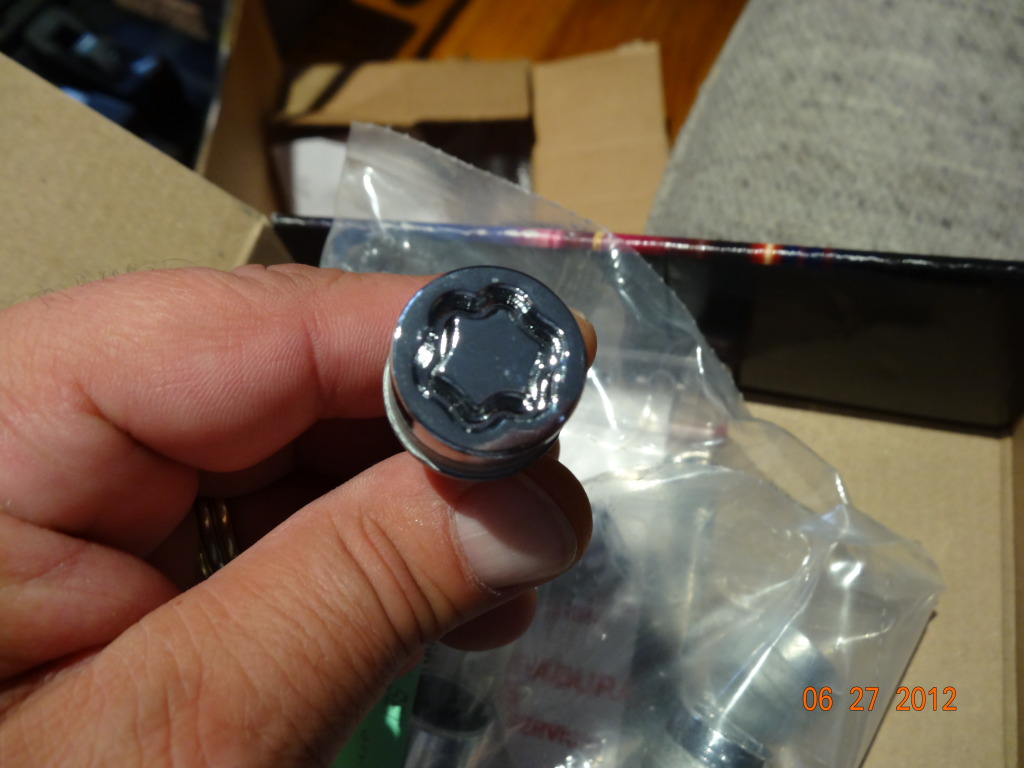

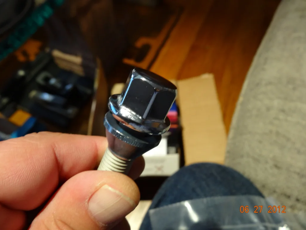

Amazing AMAZON.COM !!!...got my wheel lug bolts in a record time!...believe me these stuff is maybe the BEST lug bolts I have ever seen, worth every cent.
Look how nice the look:

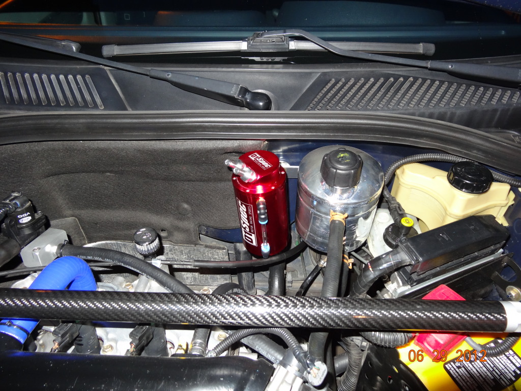

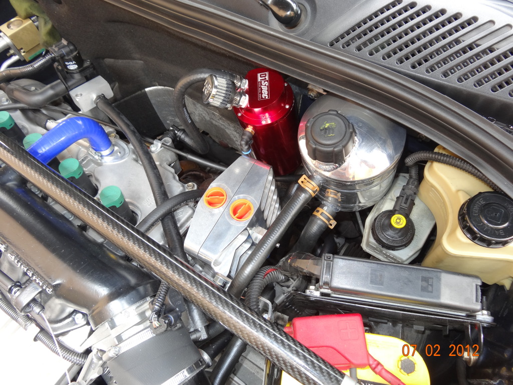

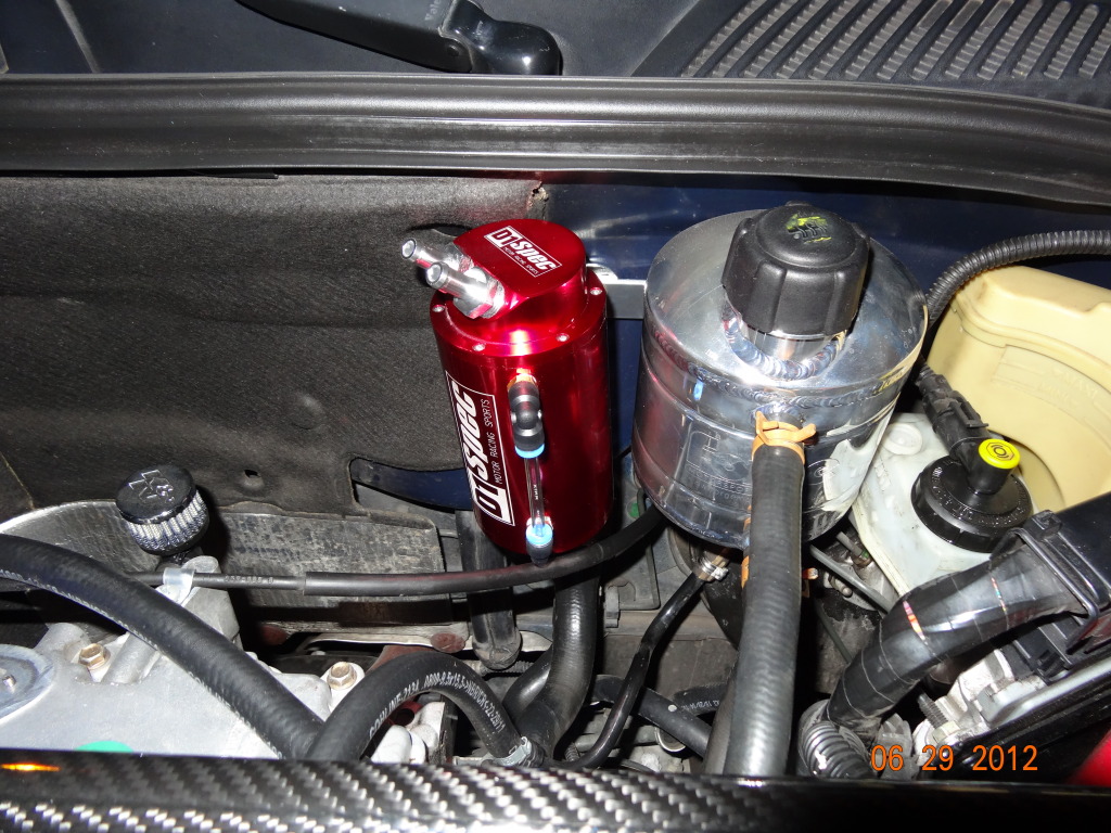

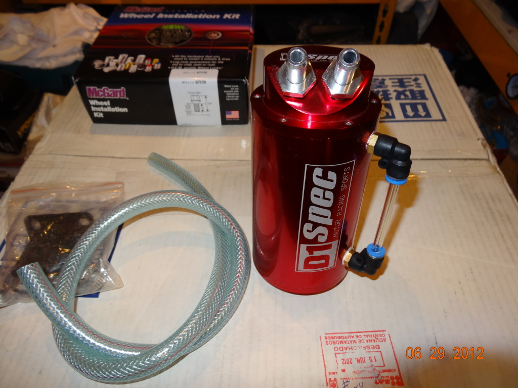

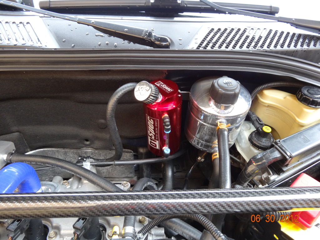

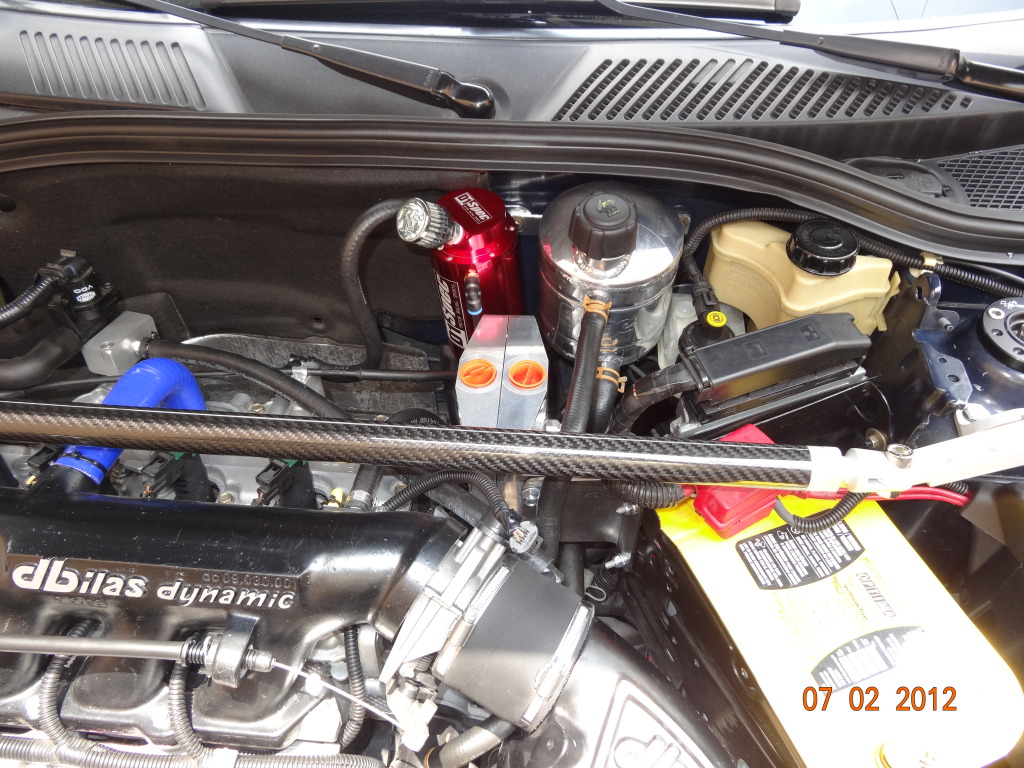

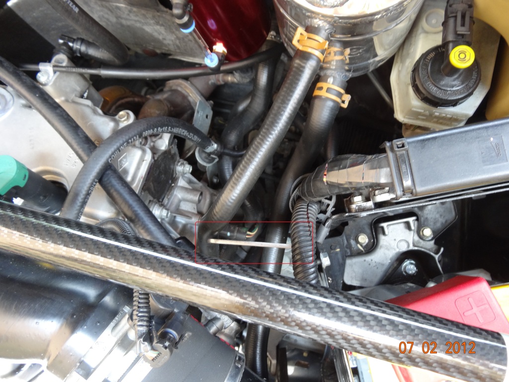

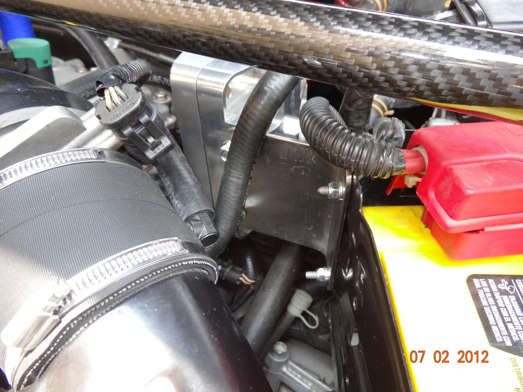

I got this Oil Catch Can:

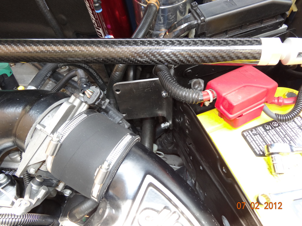

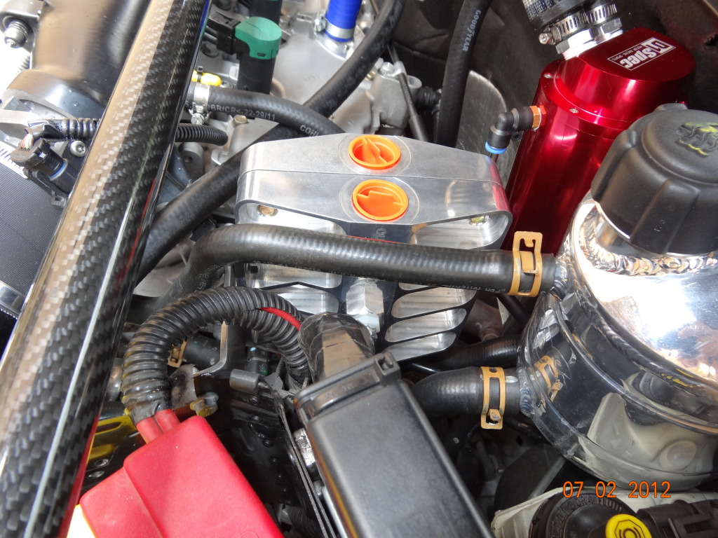

Here is installed on the engine bay:

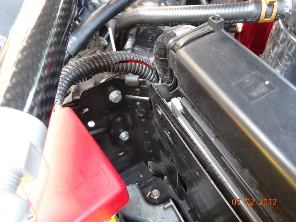

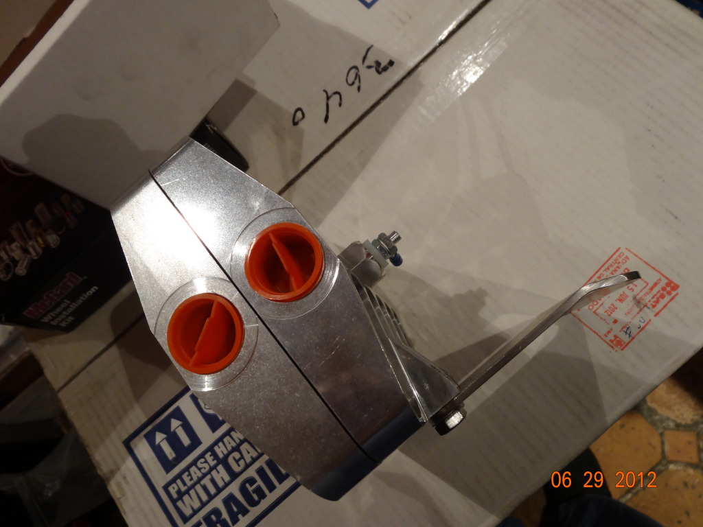

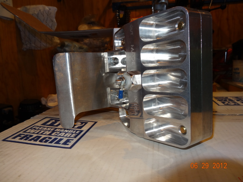

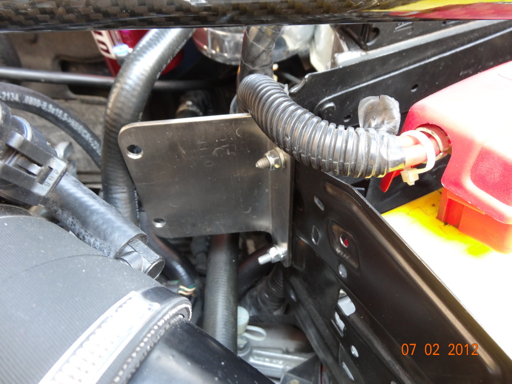

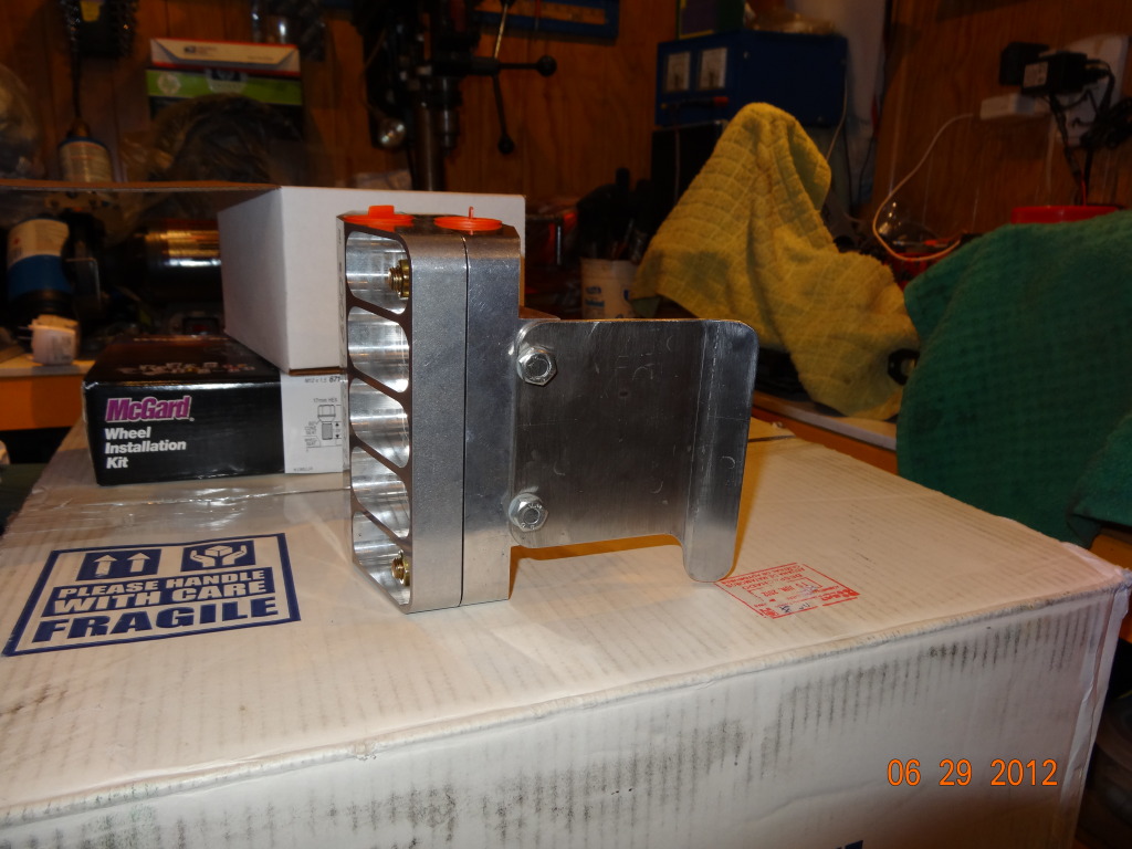

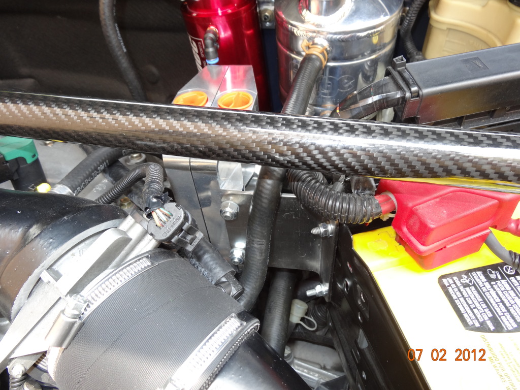

Also fabricated a base for the O'berg Oil Filter, It was made of a sheet of stainless steel:
I have to "bend" the lip a little bit more and make some drills for the bolts to hold it from the battery box:
I will keep working as much as I can....

Nice can mate!looks good! I'm going to fit one too :) we're all waiting to see the o'berg fitted too!!

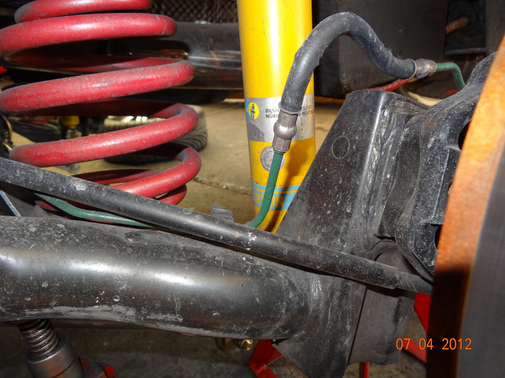

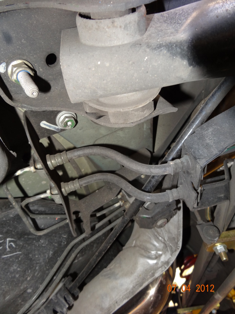

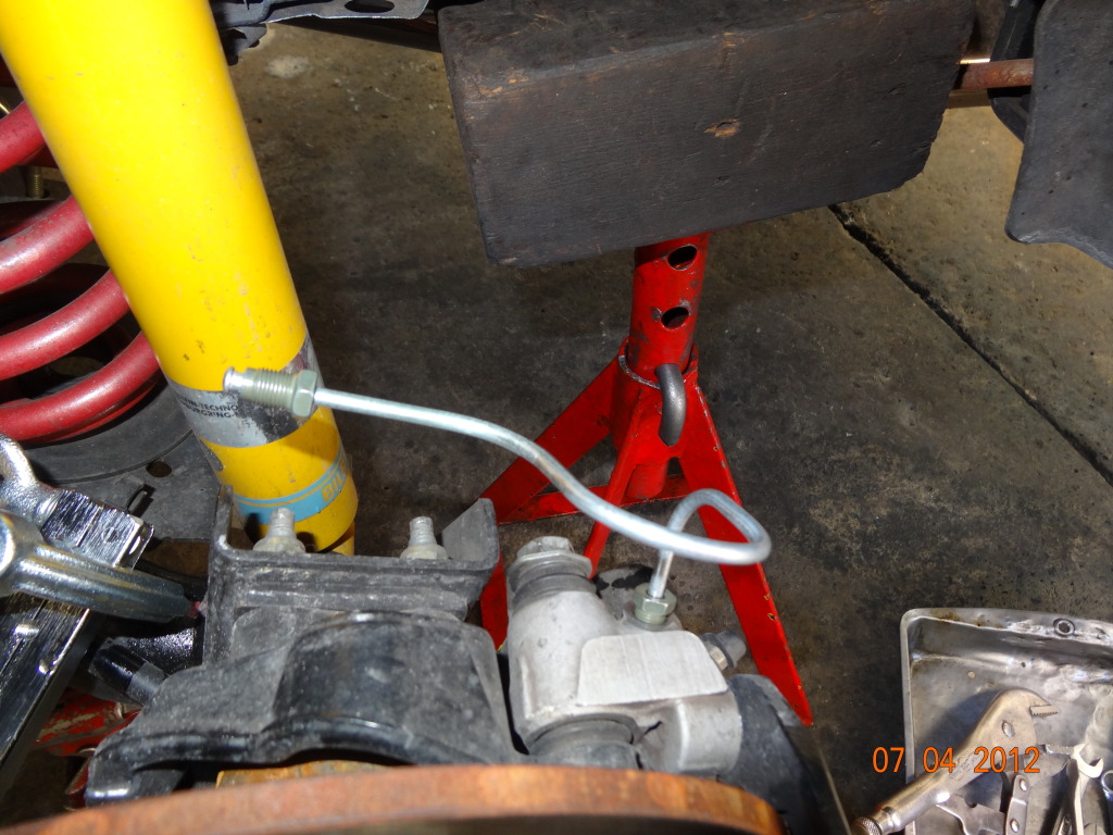

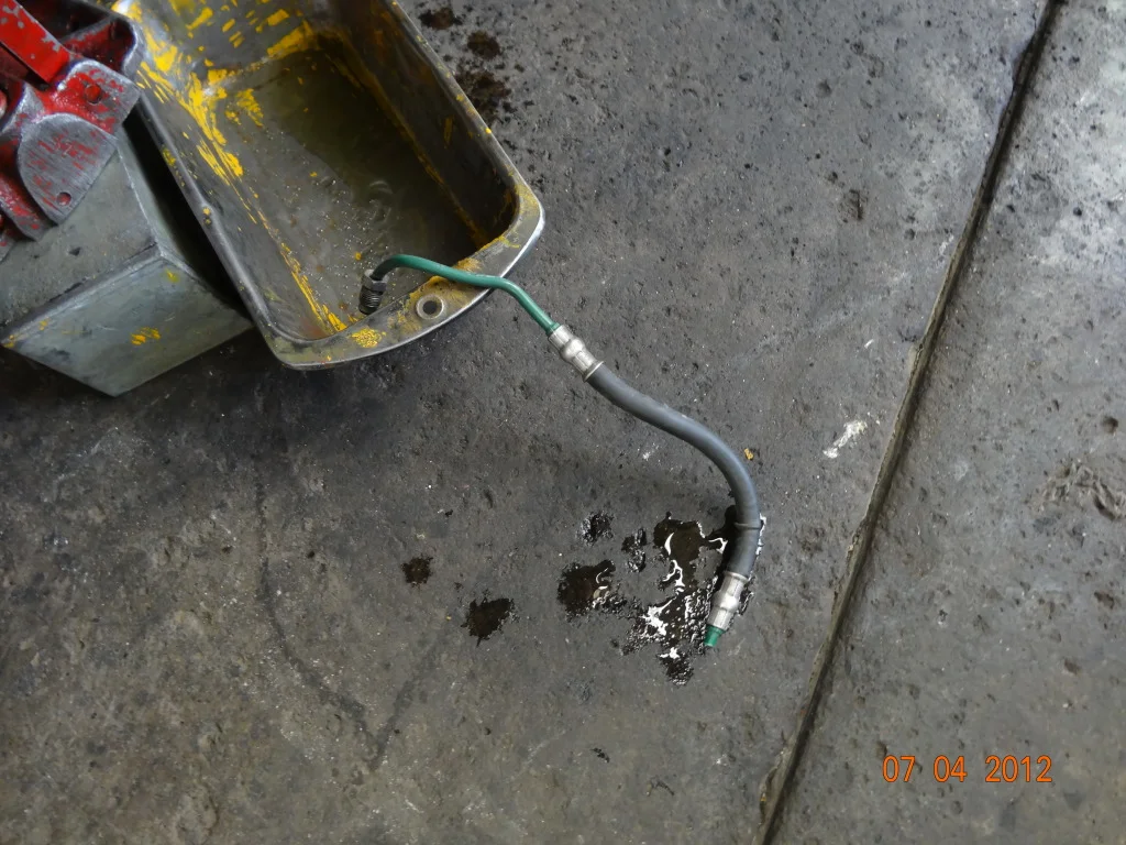

.in the mean time I will install my SS braided brake hoses, the front ones are easy...but the rear ones not...my stock lines are steel tube crimped to a hose and another piece of steel tubing, I am trying to sort that some how..have some ideas.
Regards
you're looking in the wrong place, look above the axle by the load spring ;)
  Lionel Richie
you only have to replace the short rubber flexible pipes over the axle (about 140mm long, should be in the kit you have), not the the metal crimped ones that go to the calipers
  Renault Symbol
Thanks, I'm going to post some pics of this once I have time to work on it.

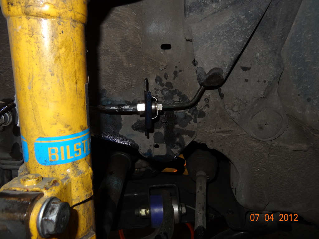

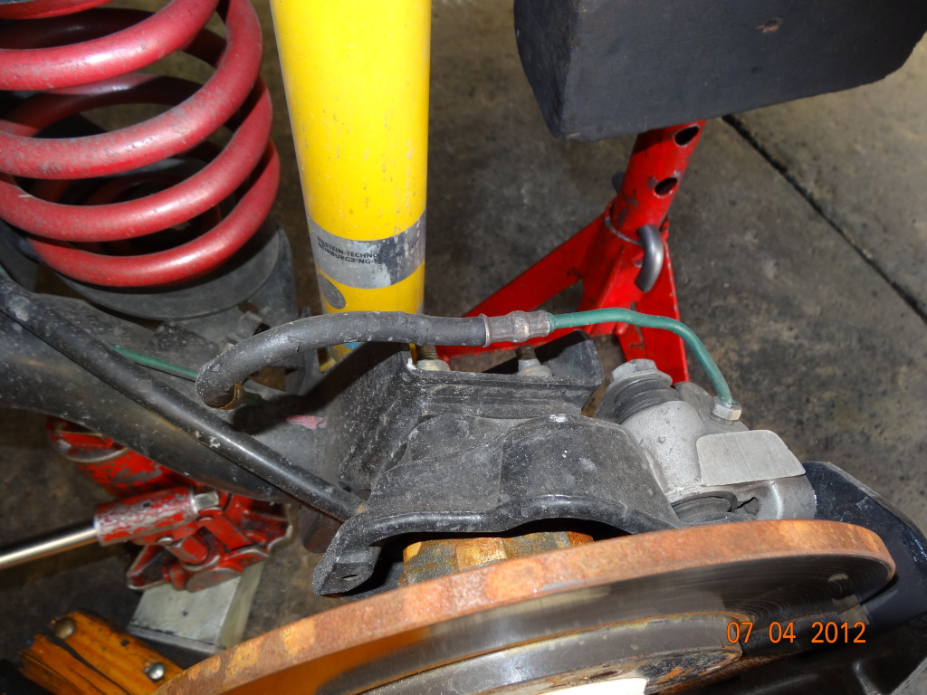

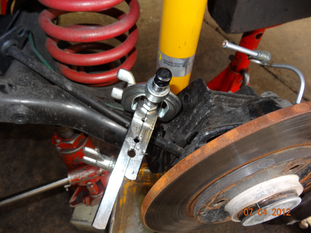

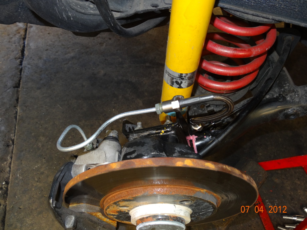

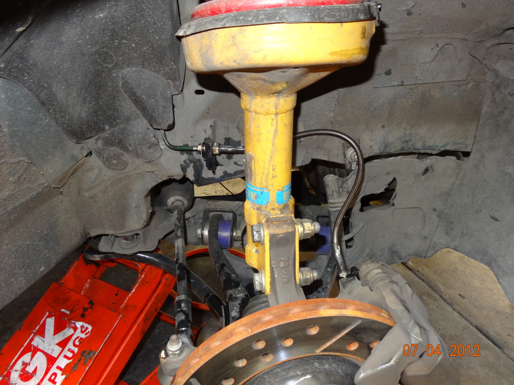

Some pictures from the Brake Hoses, I replace them today.
The rear hoses, crimped to the steel tube:
First step was to cut the tube near the rubber hose:
Then I used a bubble flare tool:
A new tube, bent to the size:
The new Stainless Steel Braided Hose:
Need to order another set of rear hoses to replace these ones:
  Renault Symbol
The front SS Braided Hoses:

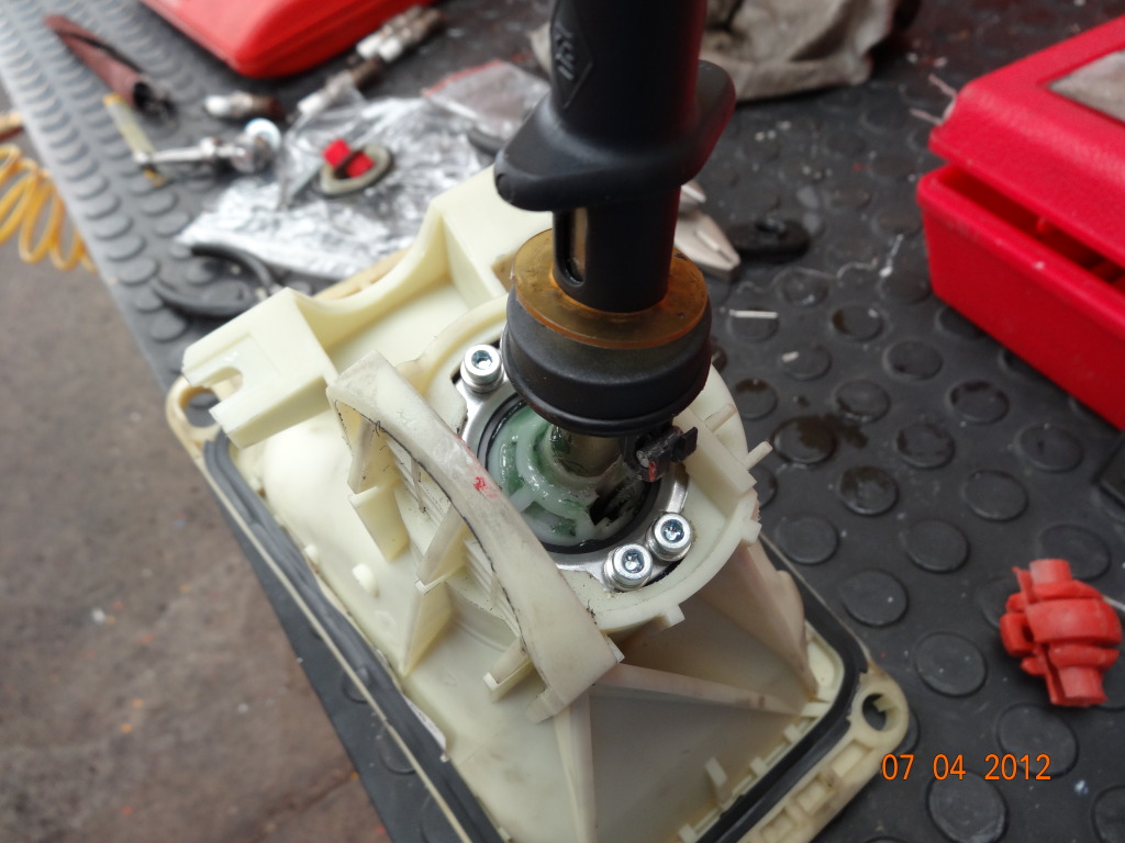

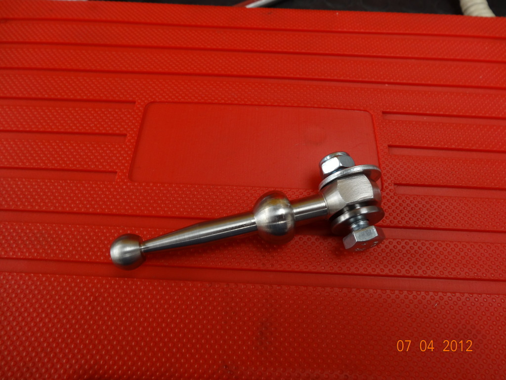

And finally, The Quick Shift Kit:

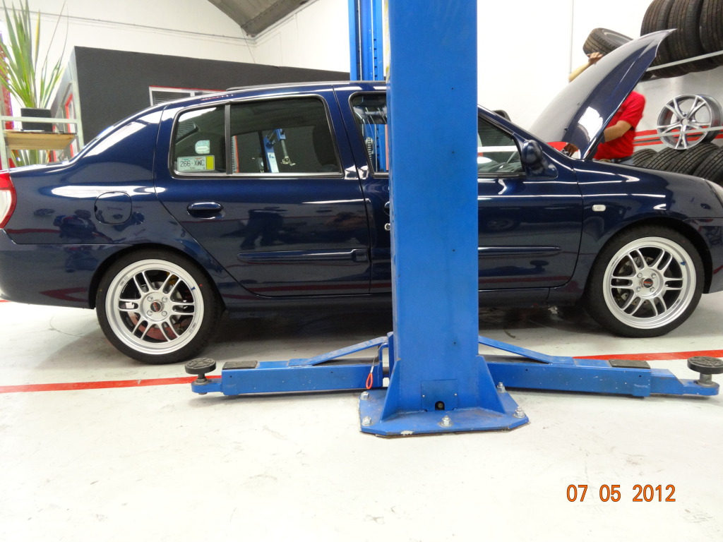

Tomorrow I will take it to the shop to install the new rims and tires...:p
