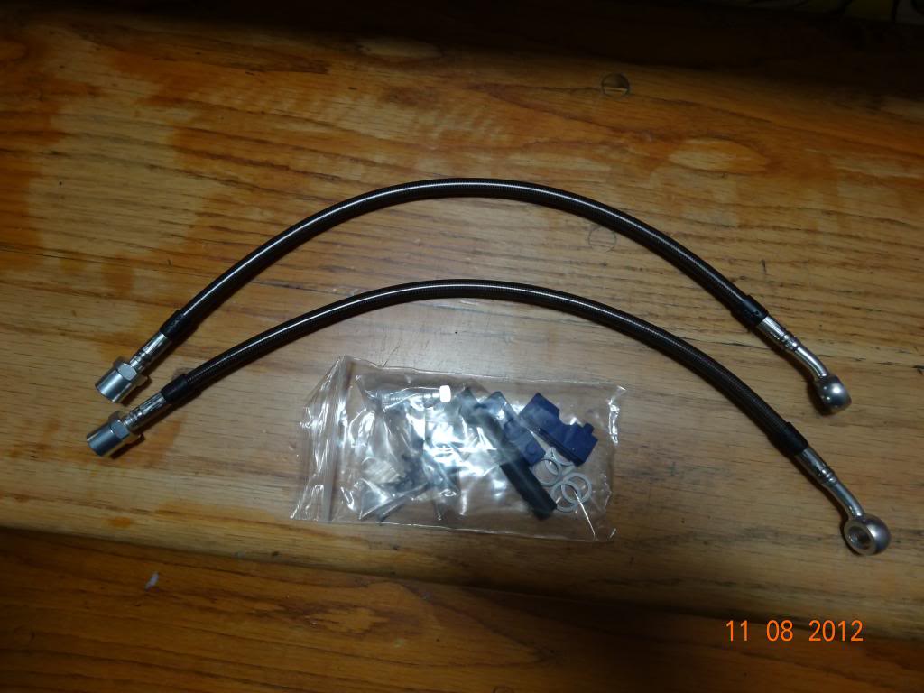

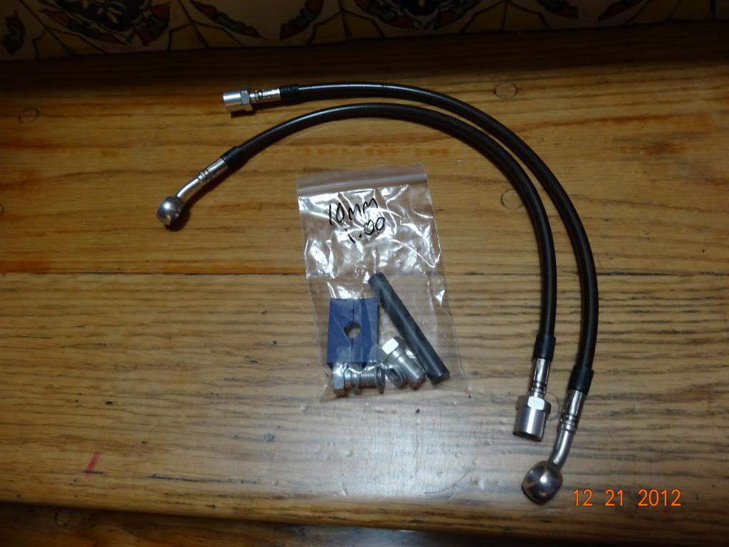

Do You want to hear somethong stupid?...after several weeks waiting for my front brake hoses to arrive from Germany, finally they arrived today...then I discovered I SCREWED UP and ordered the wrong thread pitch...1.25 instead of 1.00 !!!!!!!

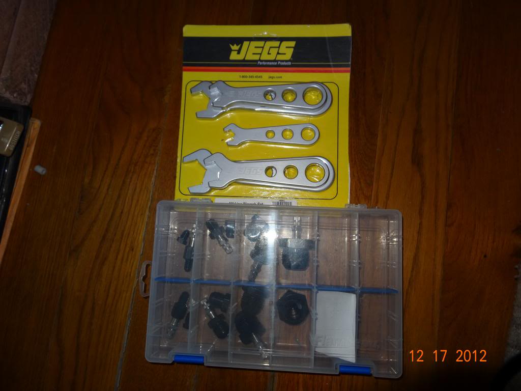

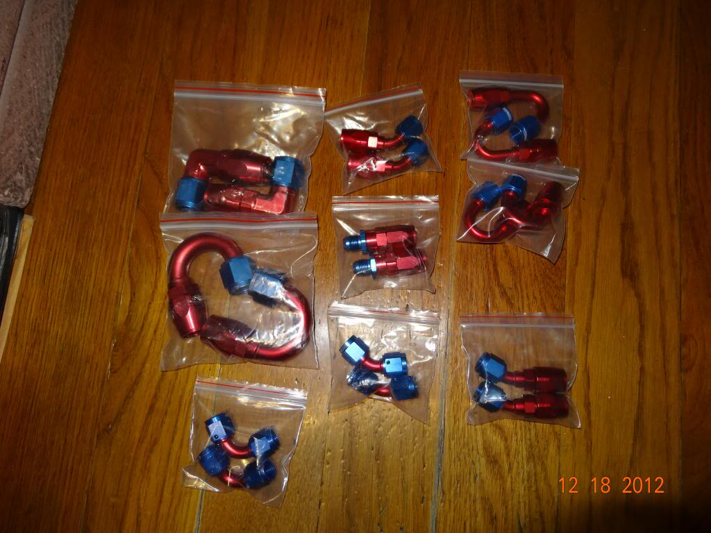

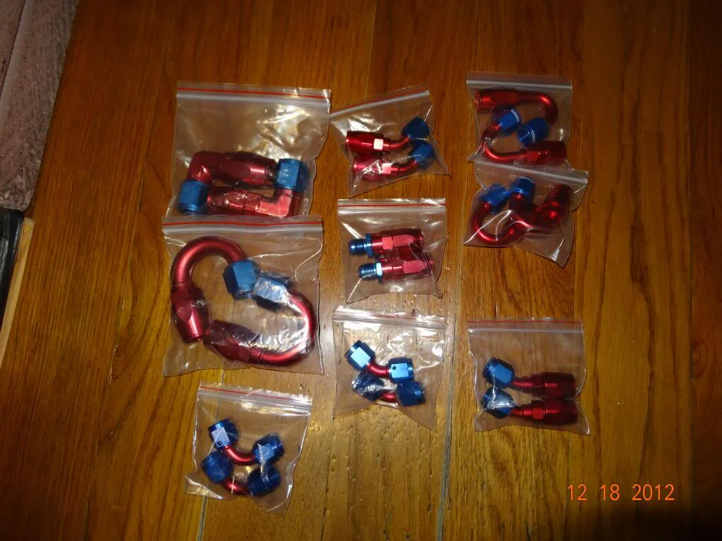

I got today some wrenches to work with braided hoses and a "Pressure Test Kit" for the hoses, more hoses and fitting on It's way...

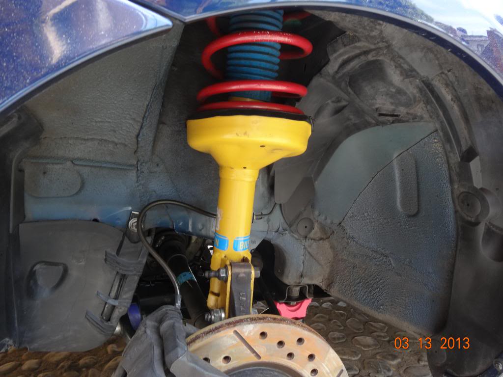

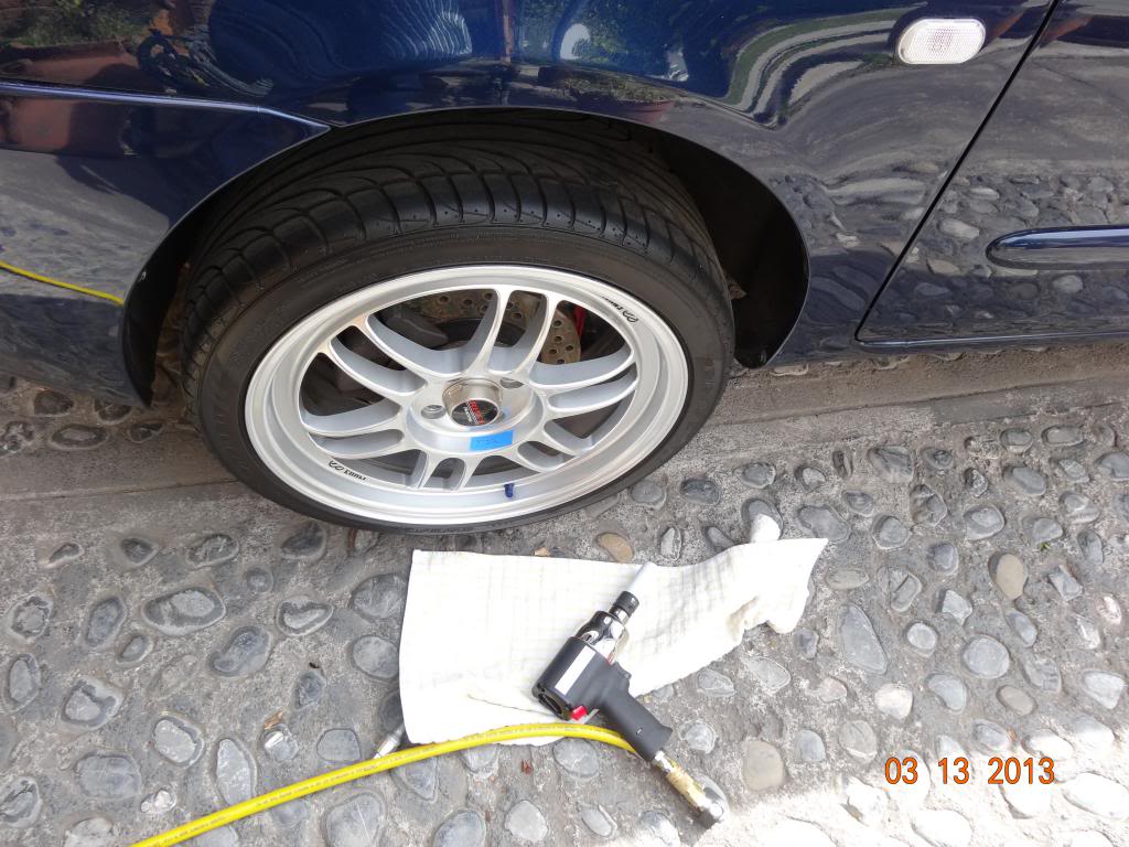

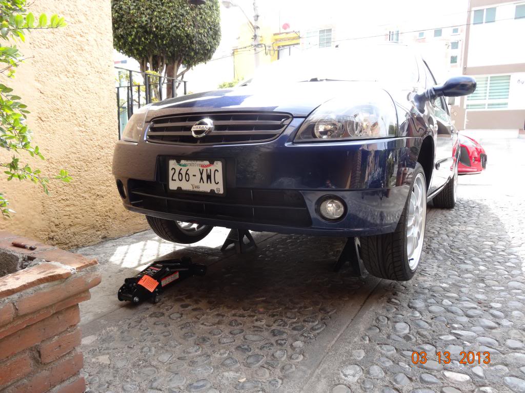

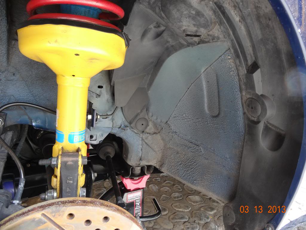

Removing the tires:

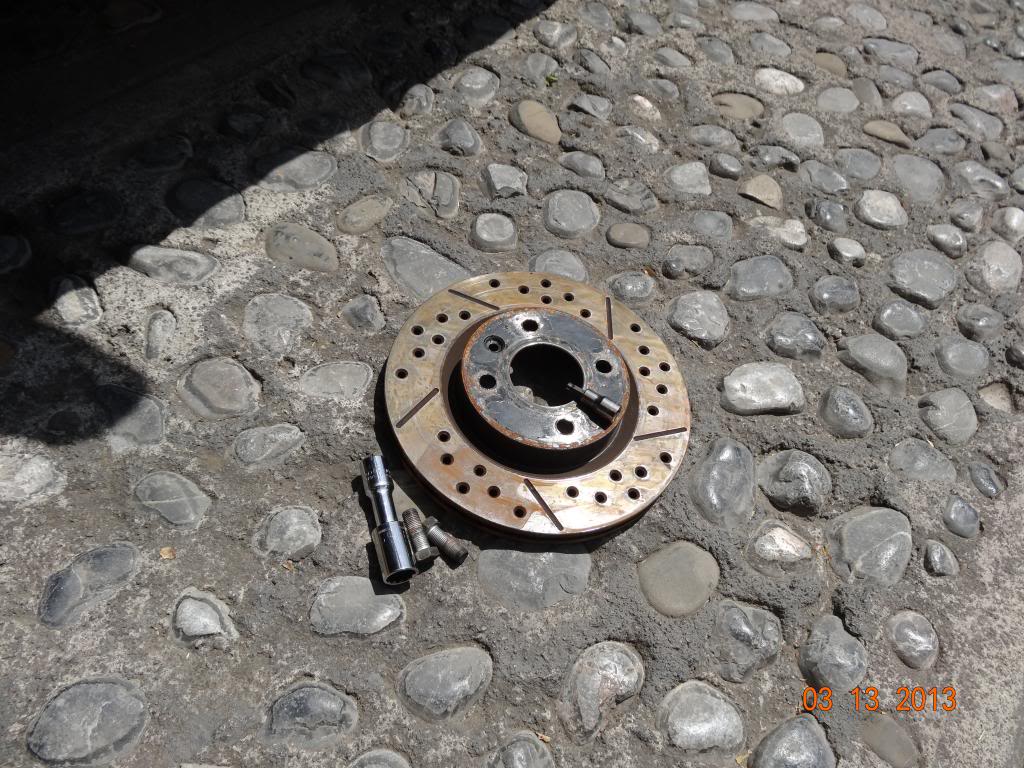

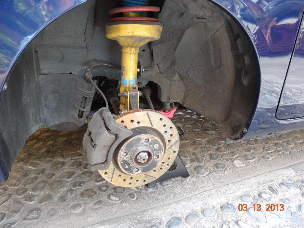

It is a littel bit dirty...You can see the stock size discs (Brembo):

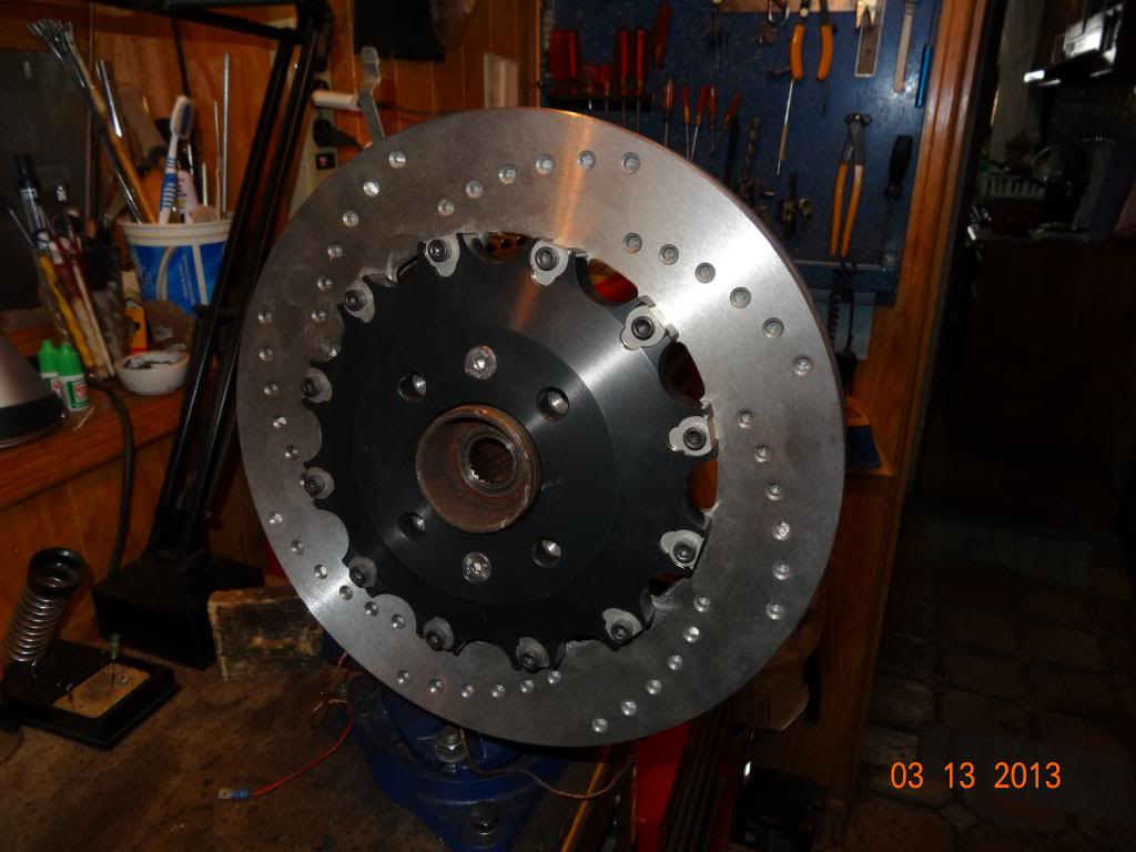

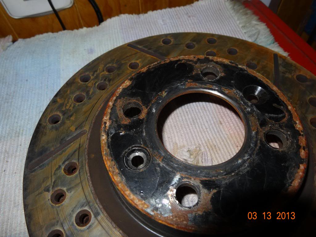

Removed the disc:

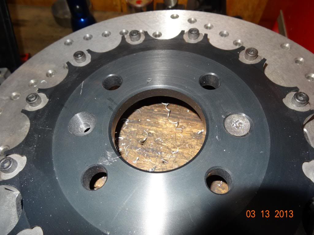

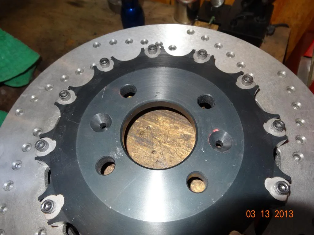

Some minor issue with the "centering bolts" holes, they are smaller:
Easy fix:

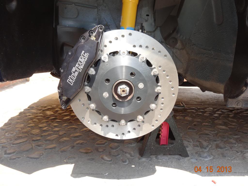

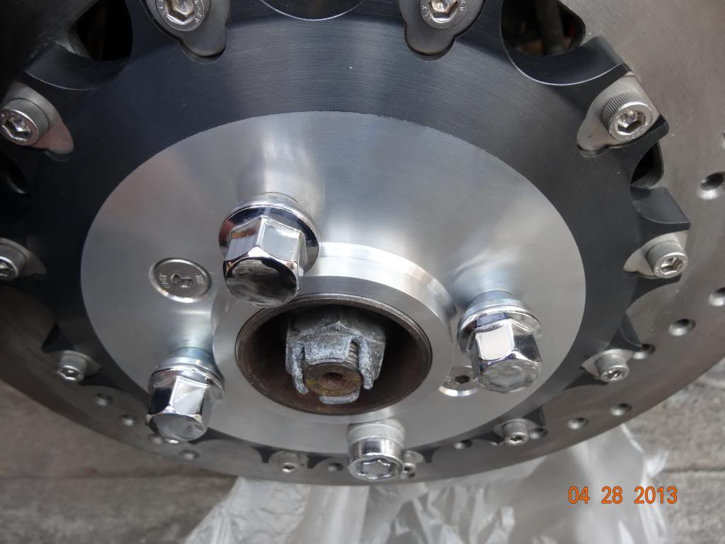

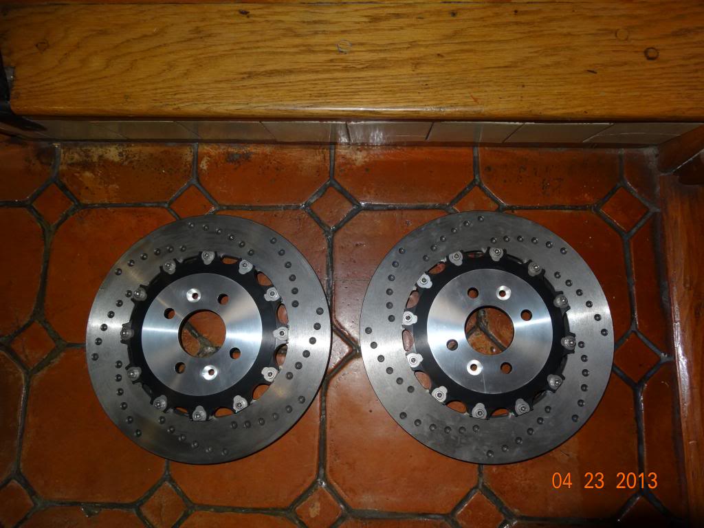

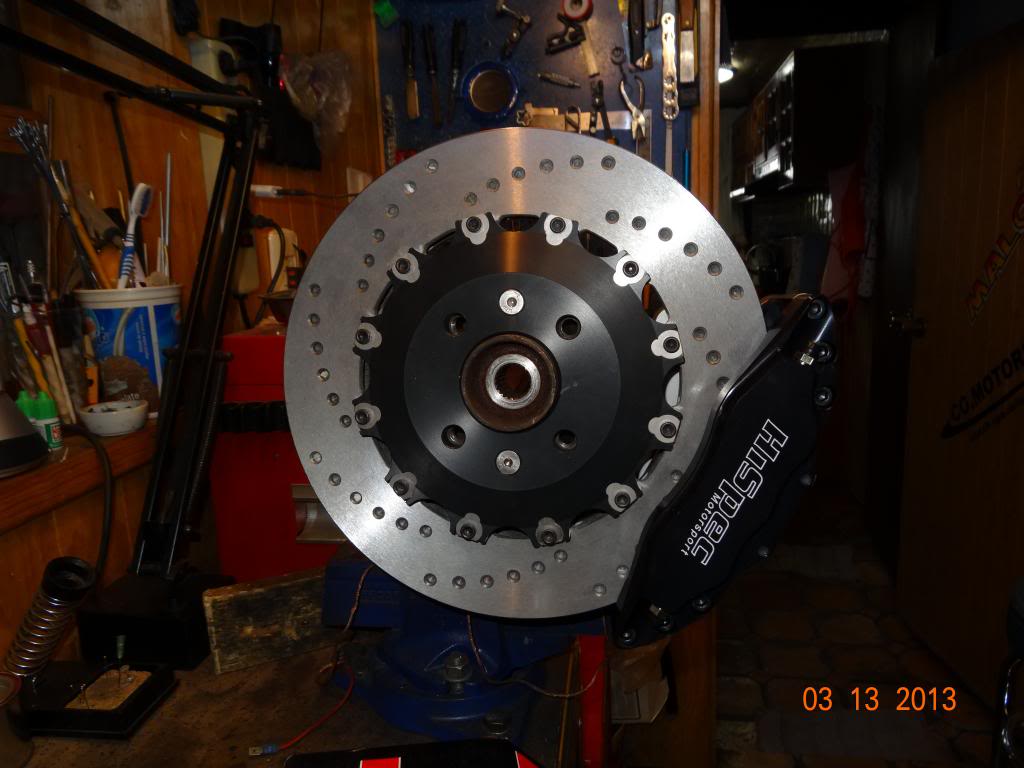

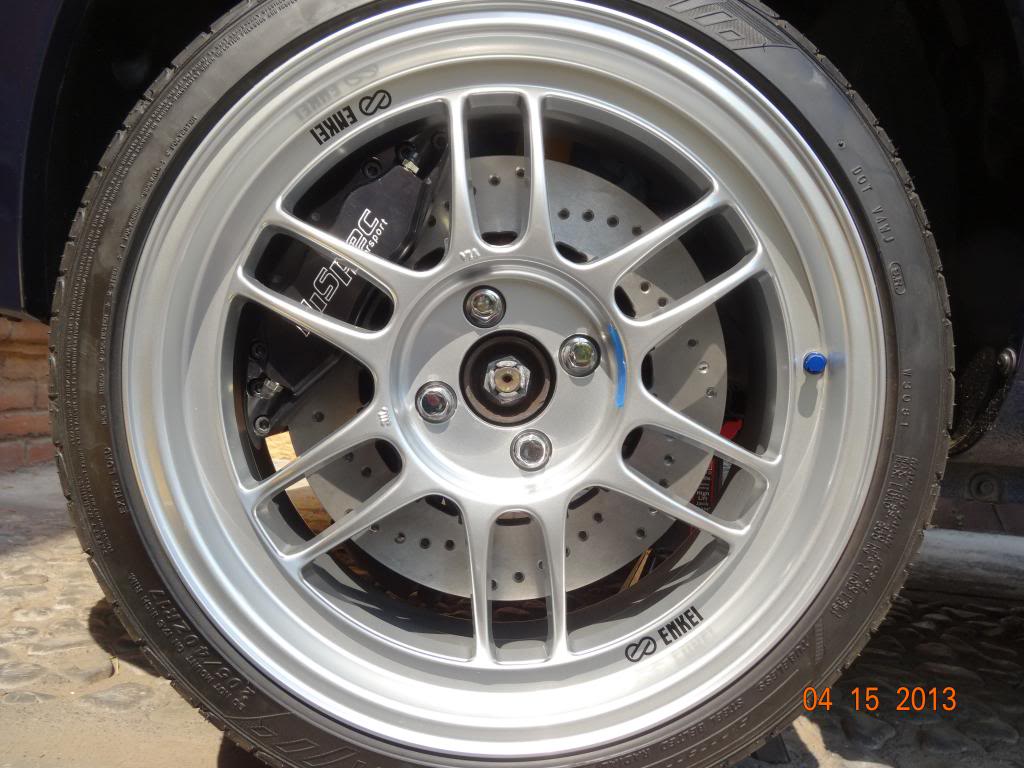

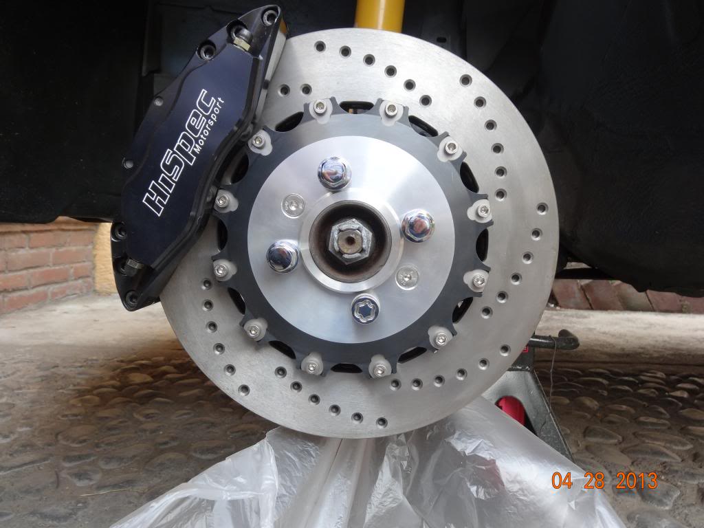

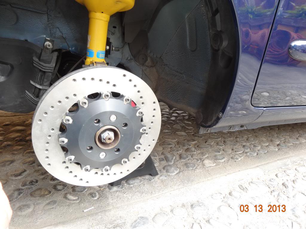

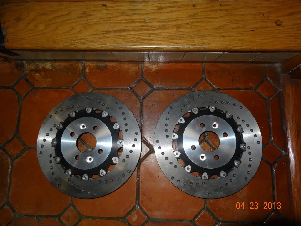

Big rotors installed:

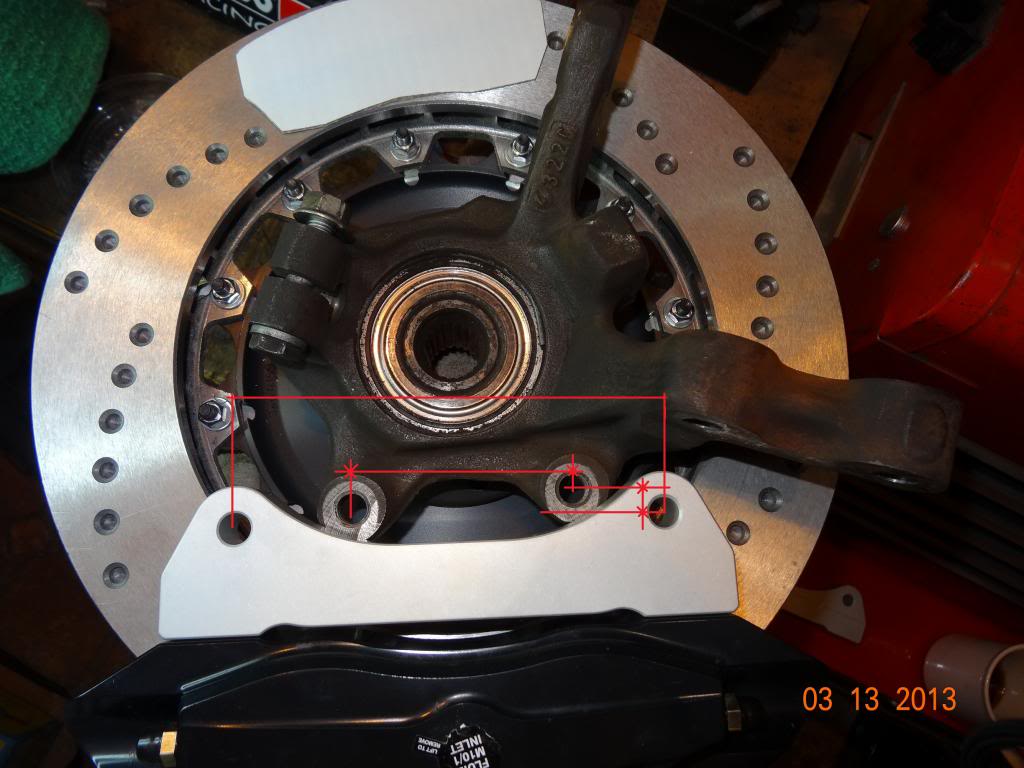

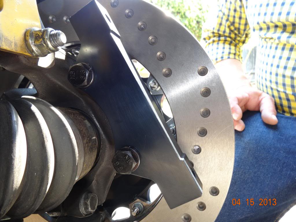

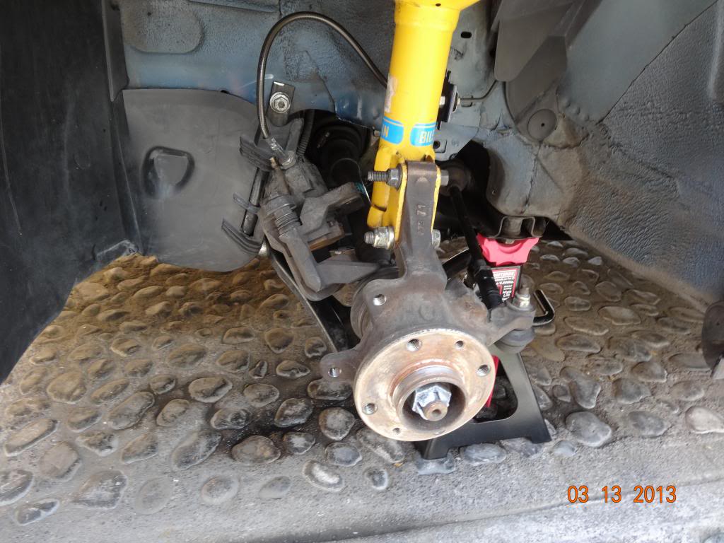

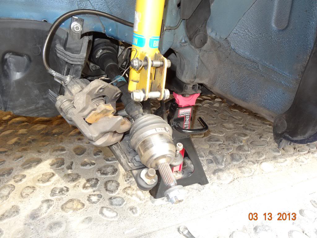

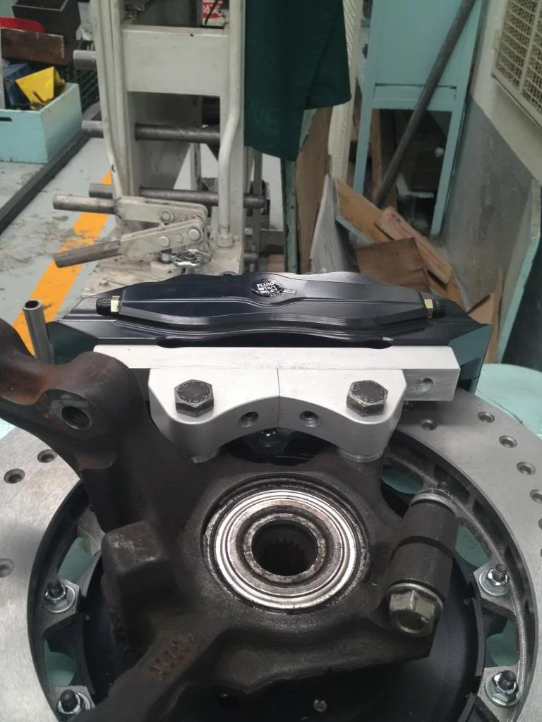

I was about to install the caliper brackt when I realize they don't fit, the I removed all the axle

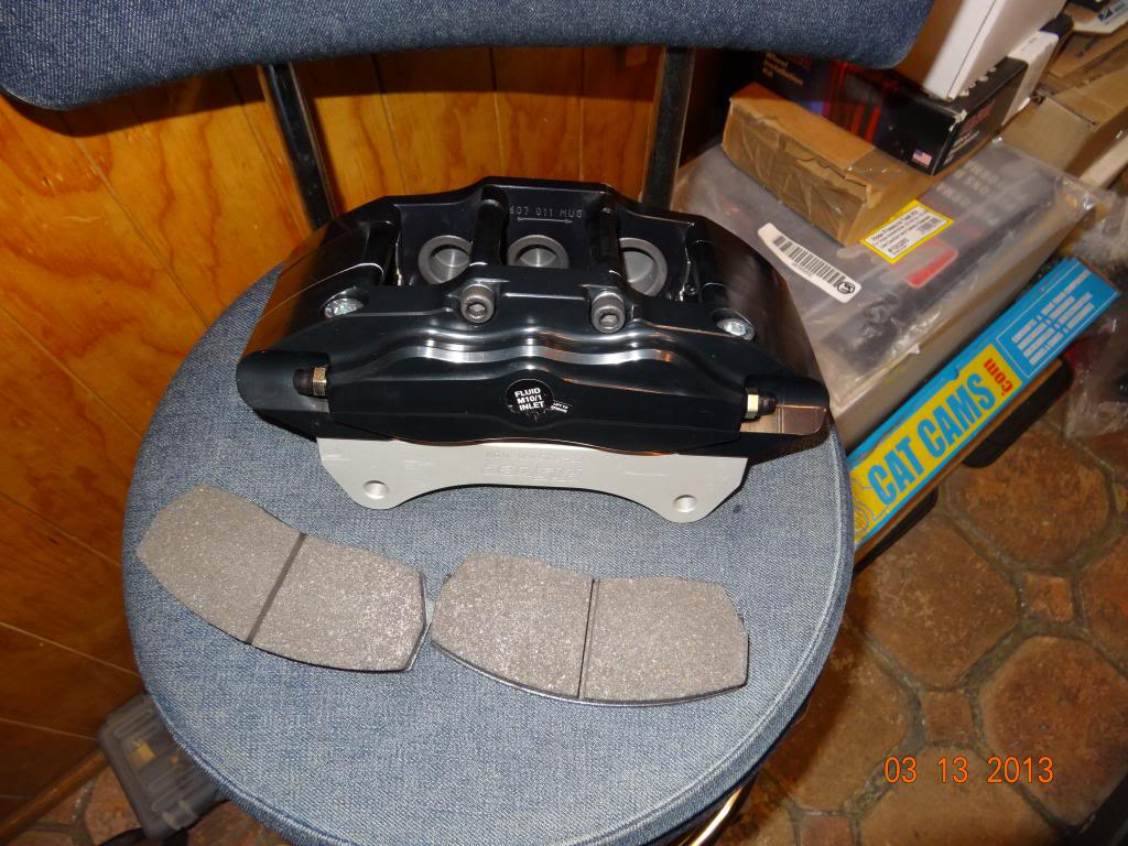

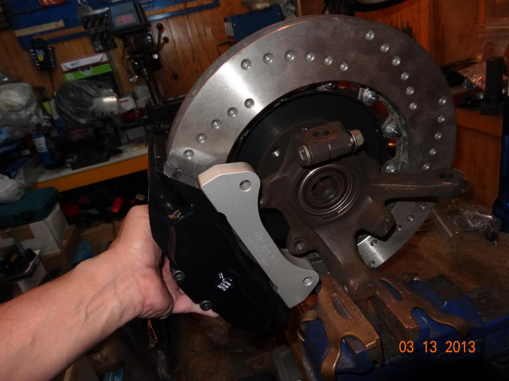

Big calipers and Ferodo brake pads:

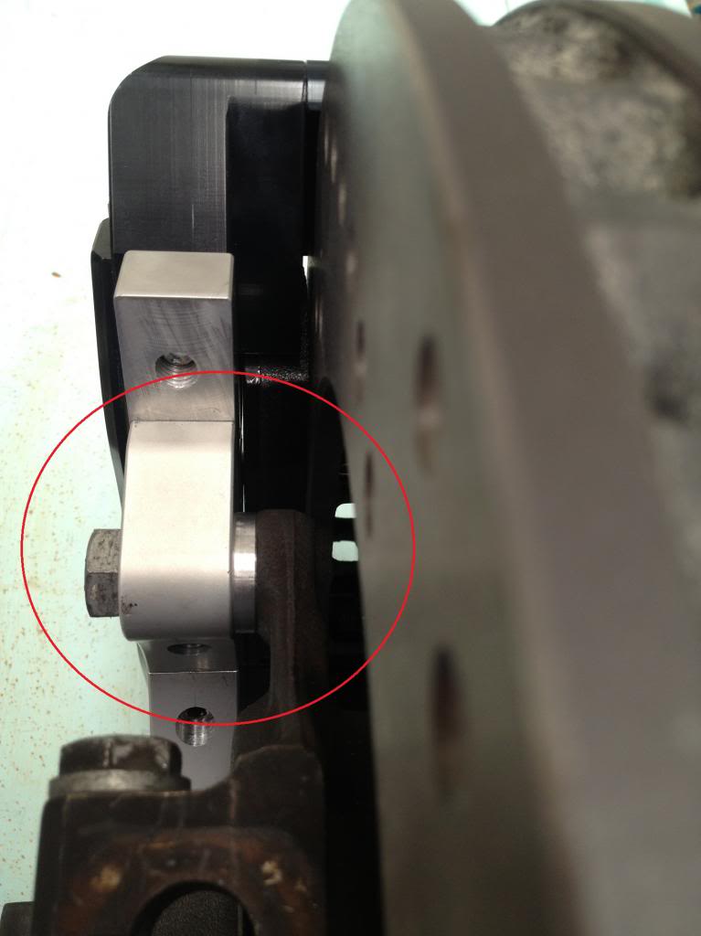

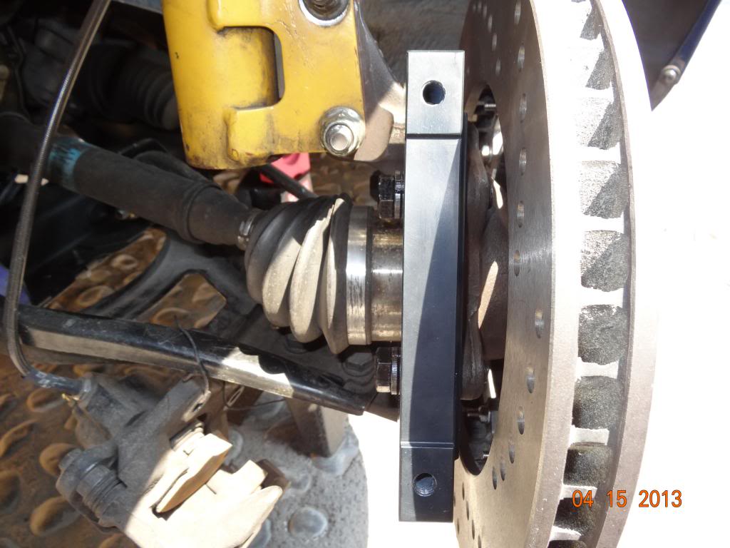

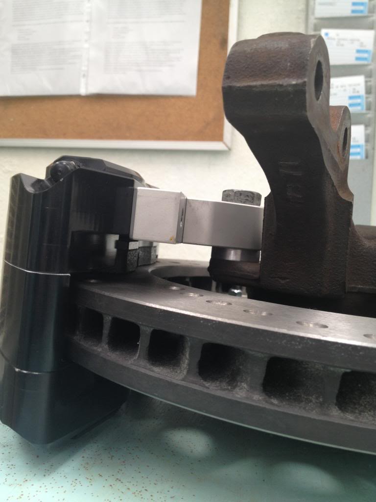

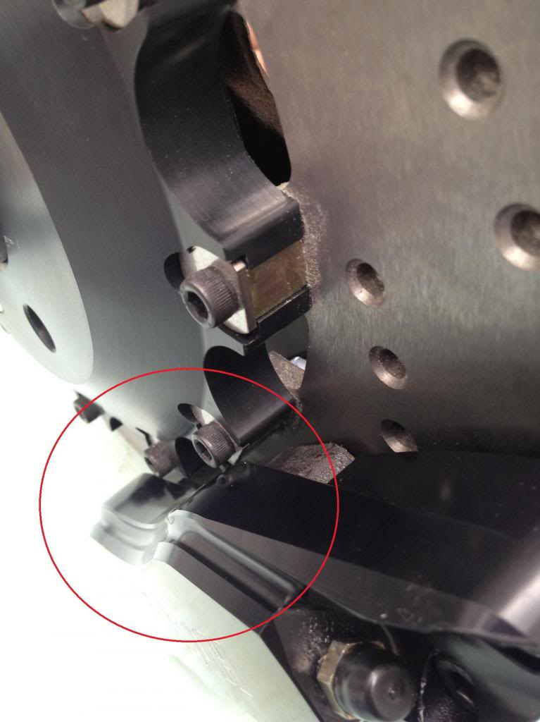

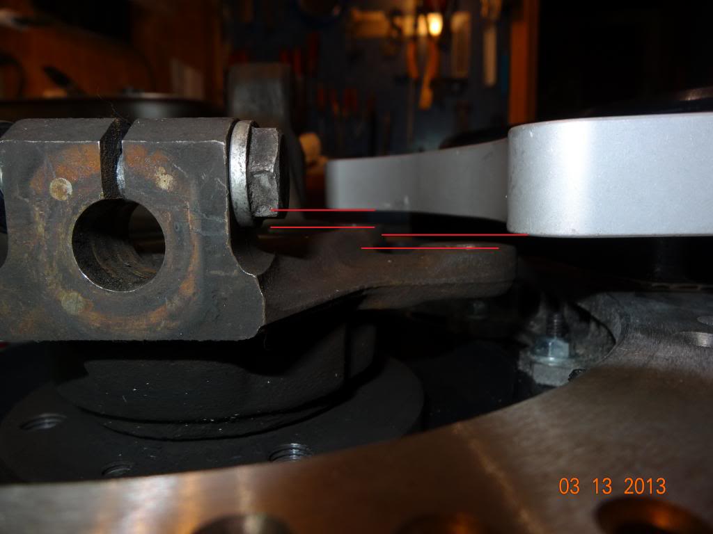

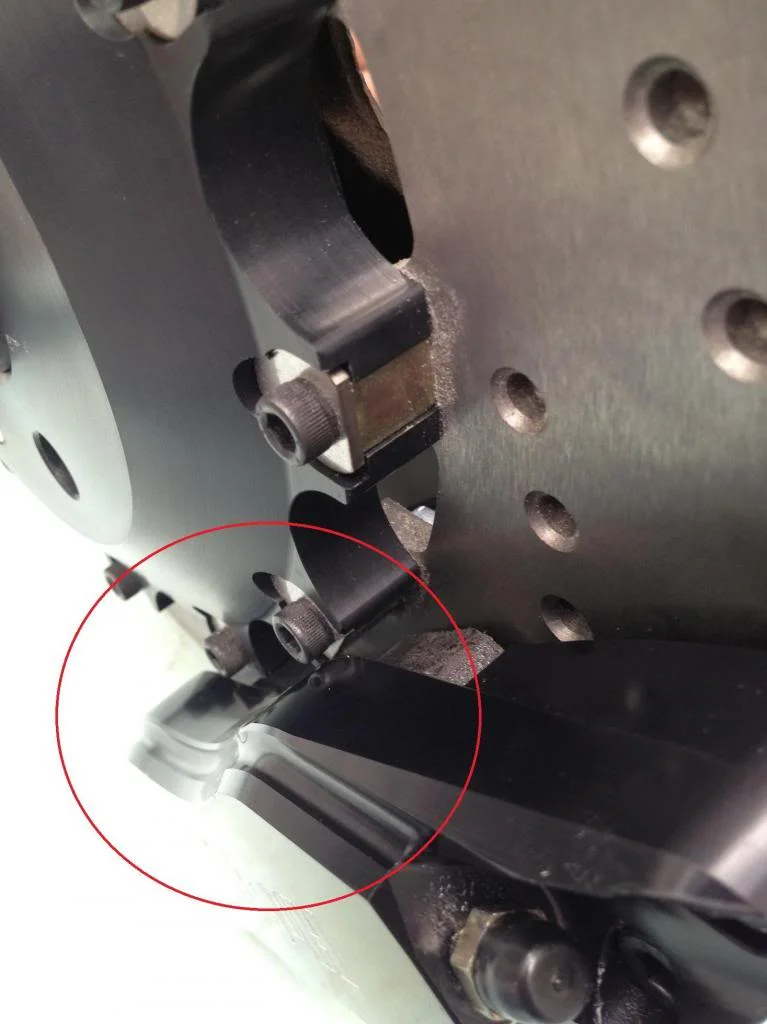

Here You can see what the problem is:

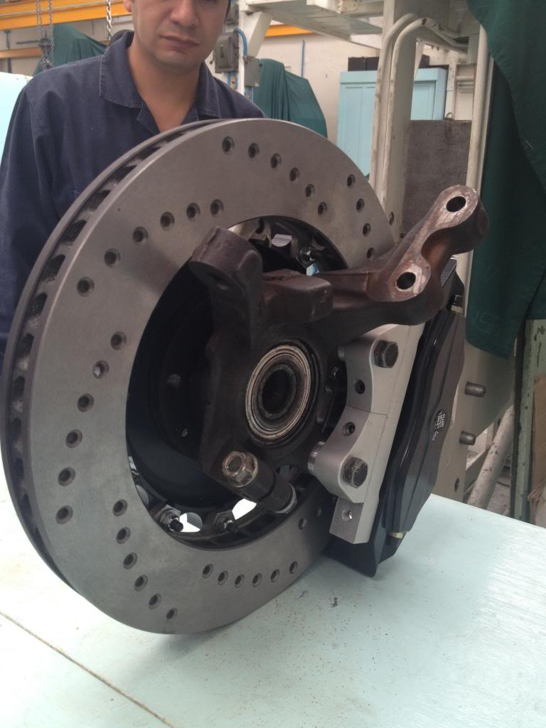

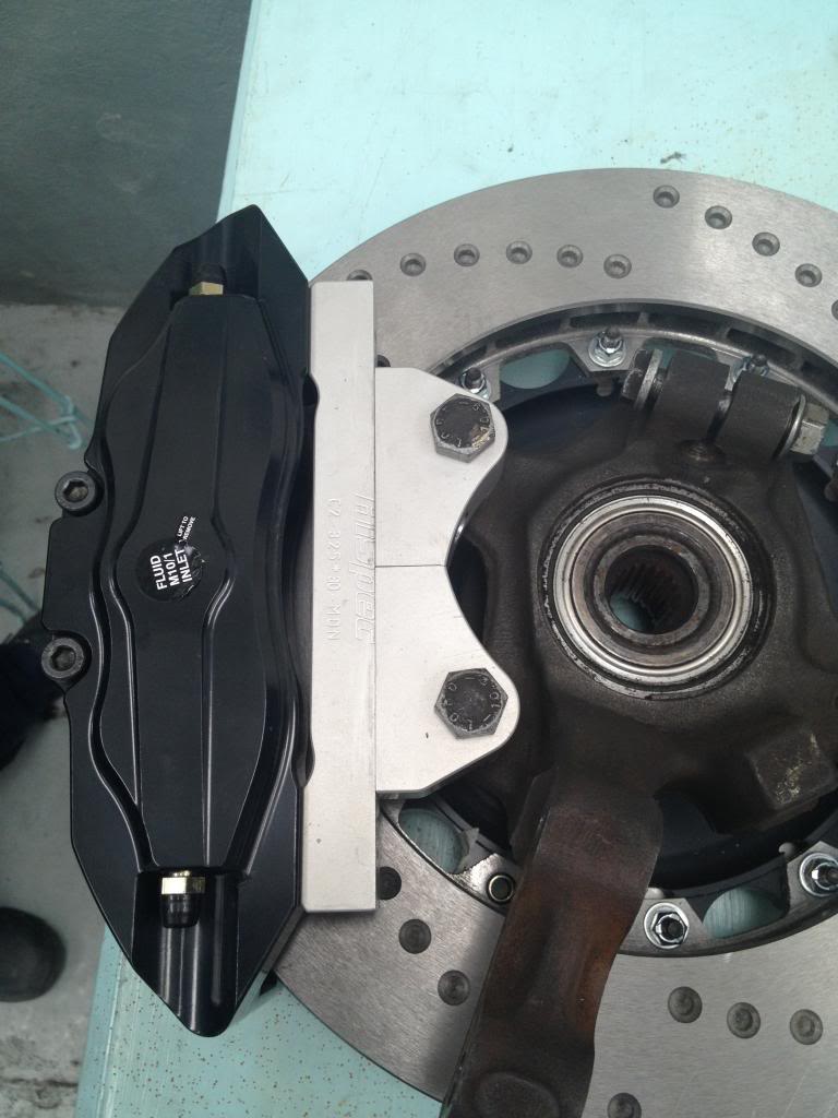

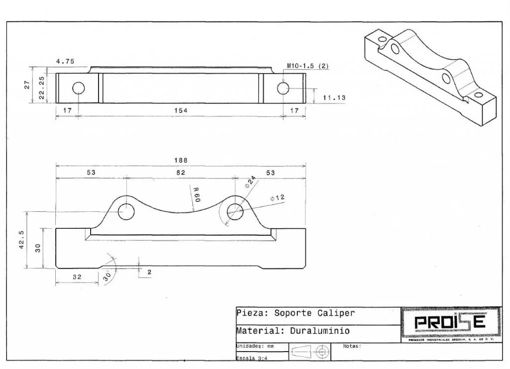

I will fabricate a custom braket ASAP.

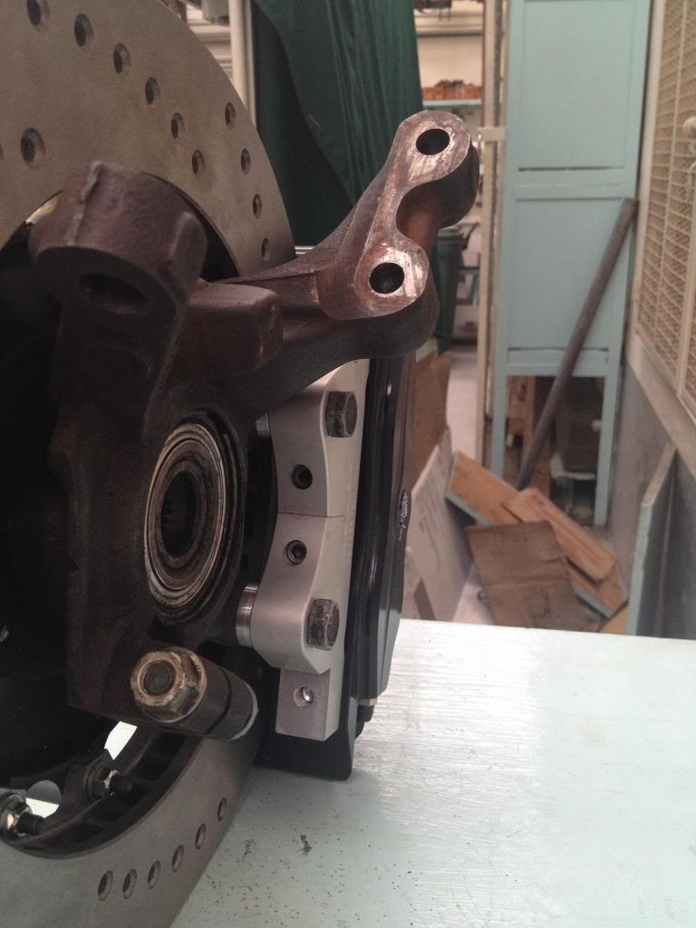

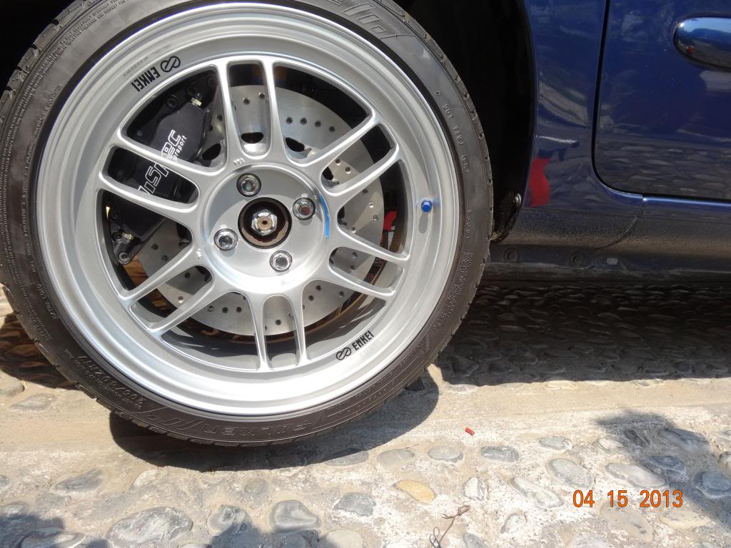

This is how It should look:

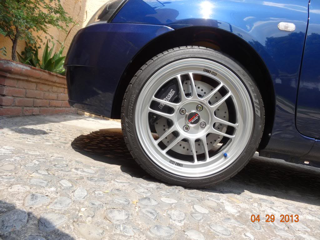

I would say, the car is looking interiorly brilliant !!!

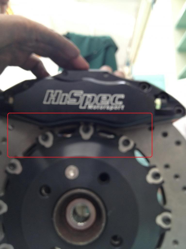

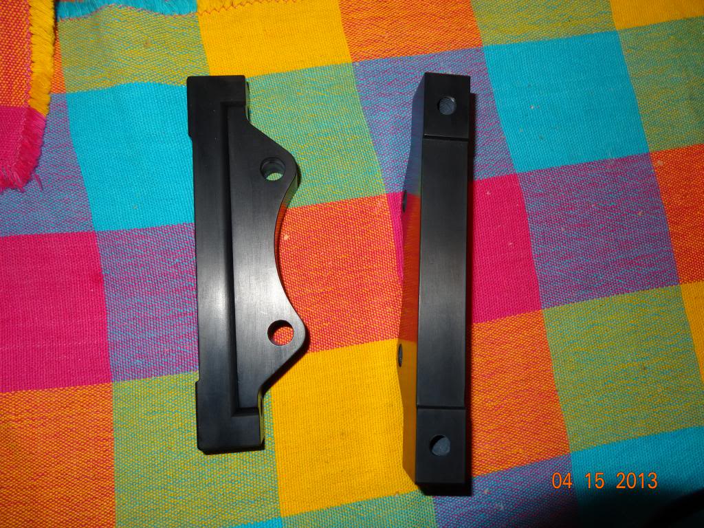

This is what I have to solve:

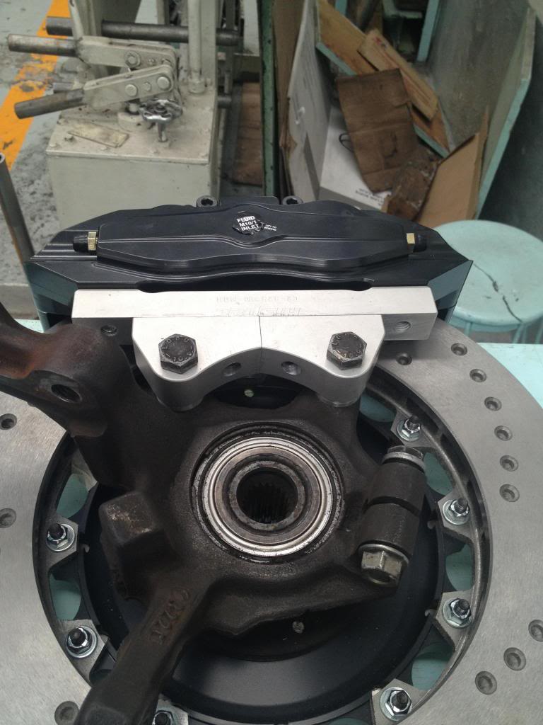

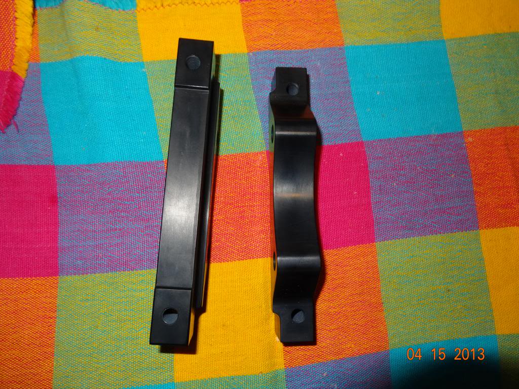

I will fabricate custom brackets to sort the issue, will "cut and weld" the brackets I have to do a "dummy" bracket, once it is finished and measurements tested I can sned it to the machine shop to do the real ones....more time, more money!!

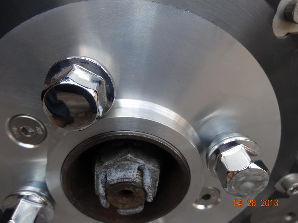

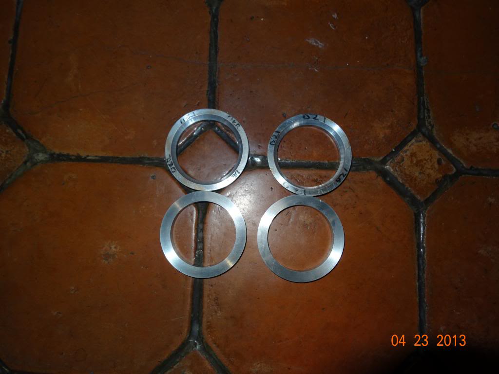

New Center rings, this time without the internal radius:

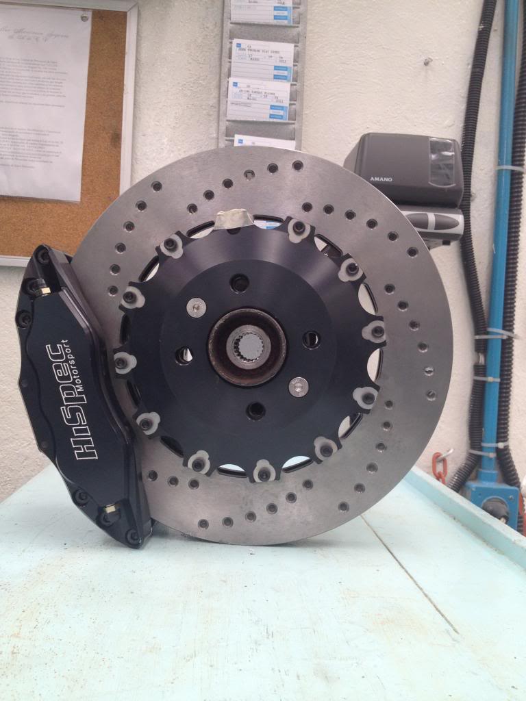

Had to "turn down" 3 m.m. from the front face on both center hubs:

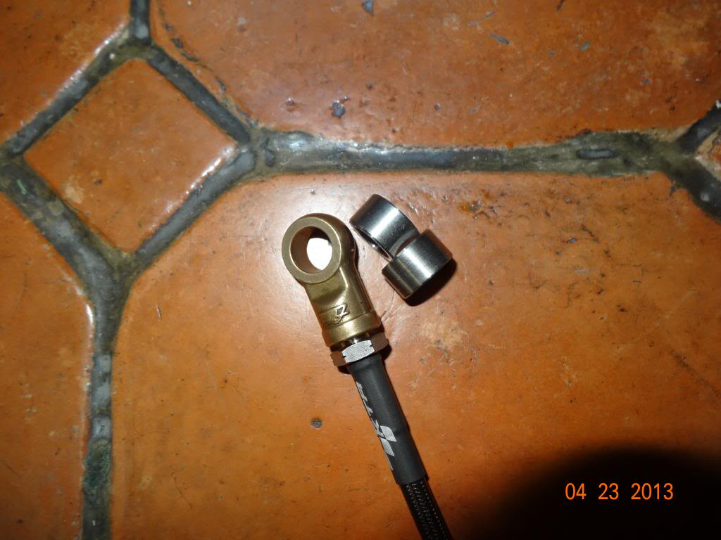

These are bushings for the front hoses:
