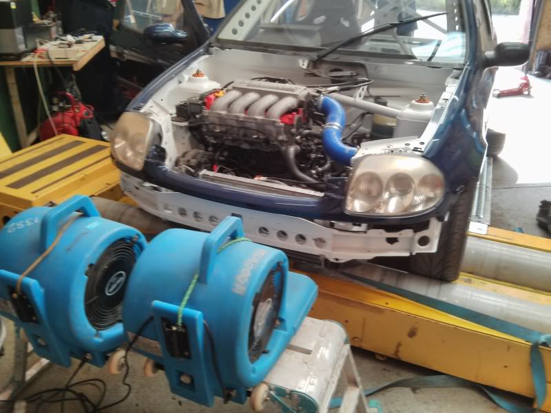

Well a week or so ago I first attempt on the rollers and had to abort due to a knocking front pulley (looked like it was about to throw itself apart)
Had to order up a brand new one. Fitting involved using all the cam locking tools as if doing a cambelt.

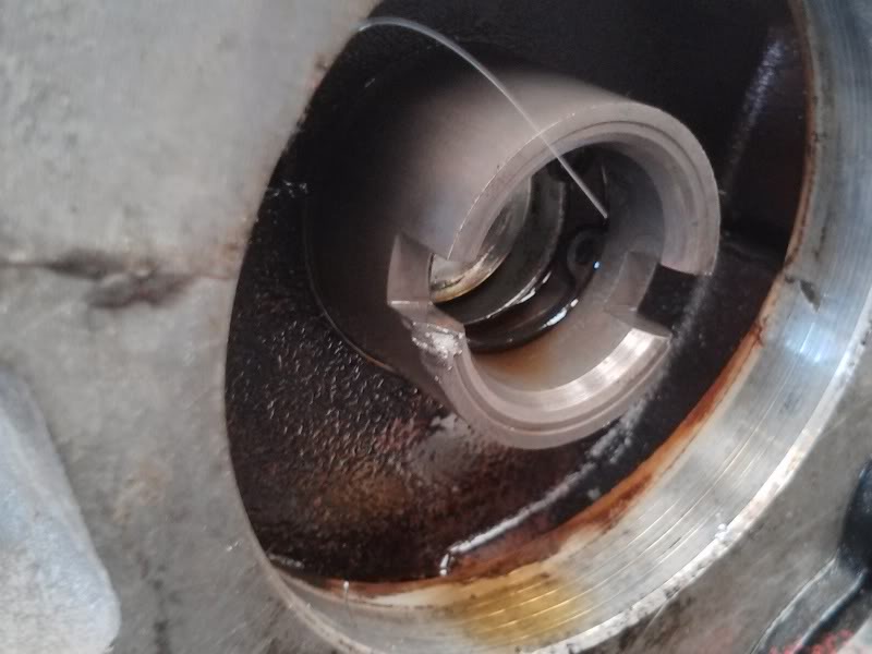

Found this core plug hammer in too far and been rubbing on the cam
And a nice job been done of chewing up the cam slot

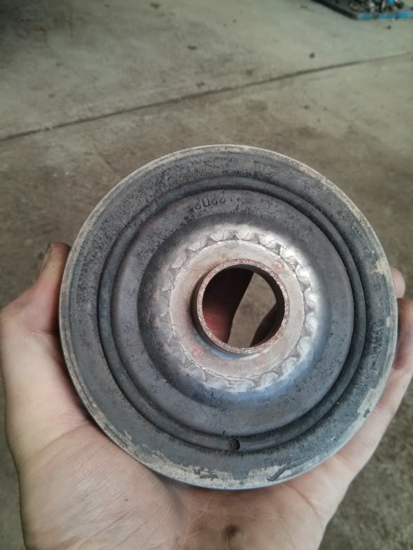

Old pulley came off, you can just about see the rubber has started to disintegrate and leave black powdery remnants

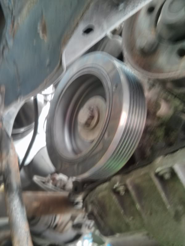

And the brand new pulley fitted up. Shiny! (excuse the crap pic)

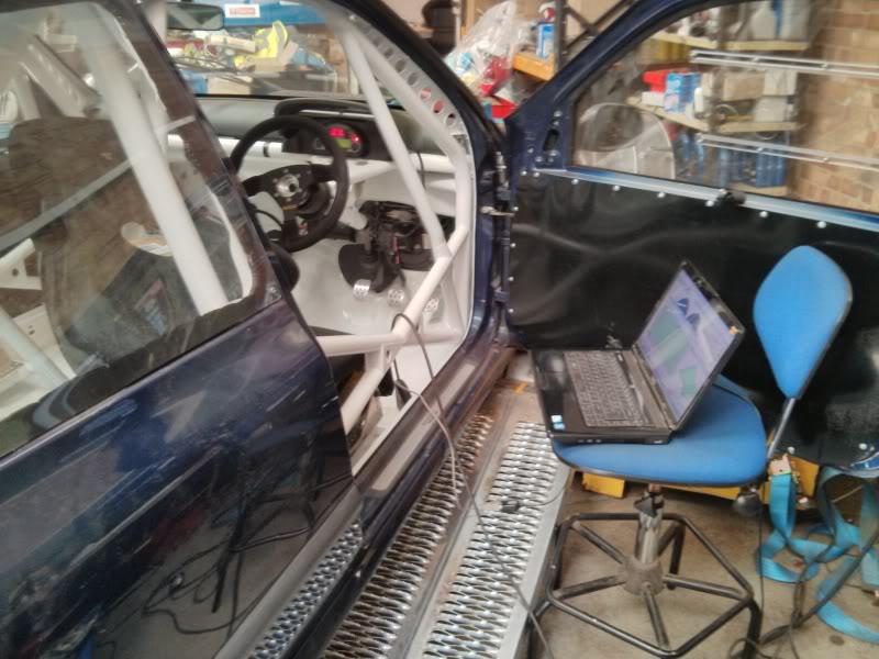

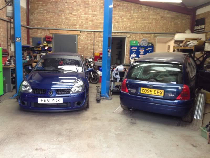

So this afternoon, after I'd waved off Tony with the Burpspeed racecar having sorted out the rather rich map, it was back on wih Rhys'

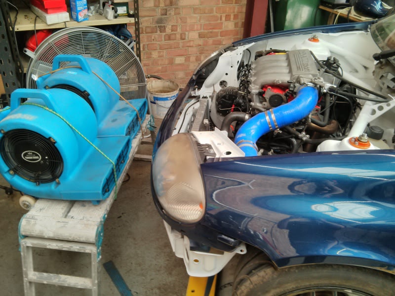

Spent an hour or so on it this afternoon so far. Slow going as it's probably the hottest day I've had in here since installing the rollers. Mostly got everything below 2.5k done and starts runs and idles well.
