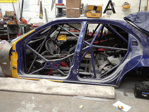

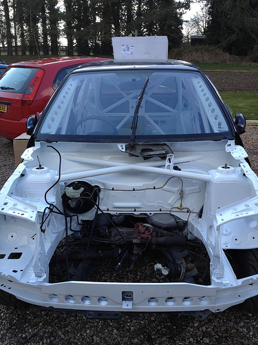

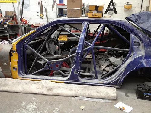

Also at the spray shop on Saturday was this project.
http://
Untitled by Rhys Beal, on Flickr
Can anyone guess what it is? A passenger ride in my car when done to the fully correct answer ;)

Yes sir! And I cannot tell you how much I WANT that shell! It's from the 1999 championship. The cage makes mine look completely inadequate
Im just a genius really arnet I? sorry for ruining the fun though as its a given i was going out in your car when its done ha
IMO it does look awesome, always thought something 5 door'd and caged would look wrong.

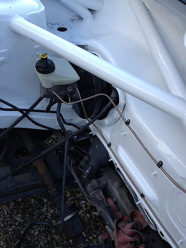

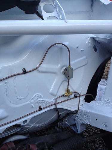

Today I have plumbed the brakes in. Bias valve in passenger side of the bulkhead.
A job that I hated and IMO is not neat enough but it just got to the point where, that'll do. But functional.

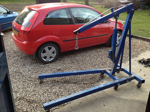

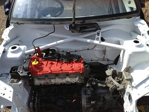

Engine and box will be going in tomorrow. I think this engine crane will suffice...

I hate making brake lines!
Out of interest why haven't you put the bias valve within reach of driving position for adjustment on the fly?
  ph1 172
If it is within reach of the driver it then breaches race regs if ever I decided to go racing. So it's in a random place because I didn't want to run lines through the car.

​I opted to run fuel and brake lines through the car to protect them from inevitable excursions through gravel traps and the like ;)

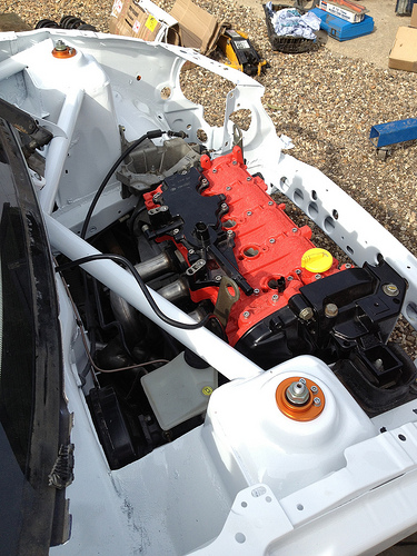

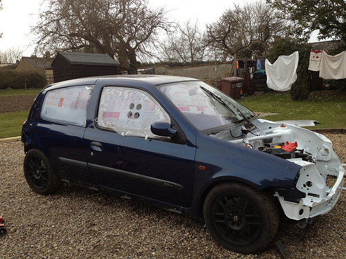

Cheers chaps:) Once again another day has flown by and I haven't achieved everything that I wanted to. (Maybe I am setting my sights a little high..Or I'm working far too slow) Today the engine and gearbox went in, along with the exhaust manifold, suspension, door card, spoiler and cleaned and few bits and prepped others ready to go on. Finally starting to look a little bit like a car.

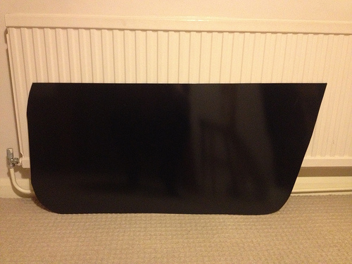

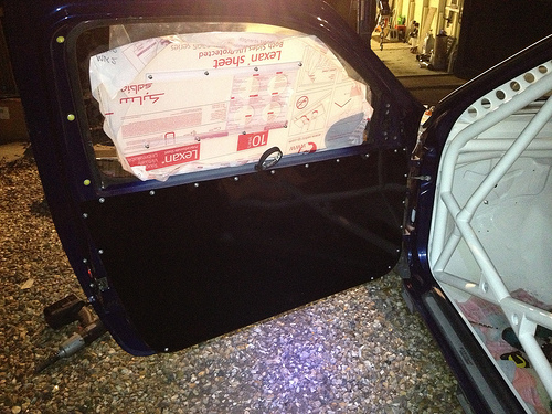

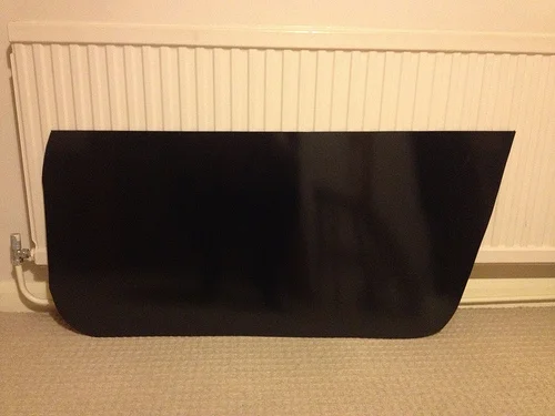

My new door cards. 2mm polycarbonate then black vinyl that I wrapped them with. Hasn't got all the fixings in but you get the picture
Untitled by Rhys Beal, on Flickr"]http://[/URL]
I was going to do this but despite the spec of mine, atm it isn't an out and out race car so our trip to the ring will mean carrying item's in the car and a passenger so I thought maybe it could get damaged quite easily.

On the brake lines, thats a fair comment, easy enough to re-route later if you decide, but as long as they're tucked up out the way they should be ok under the car.

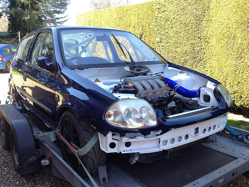

Sorry Dan, didn't see your post. Haven't had time for updates been working hard :)
Should be on the road within 4 weeks as of today
  ph1 172
Coming together nicely Rhys. When is its first outing?

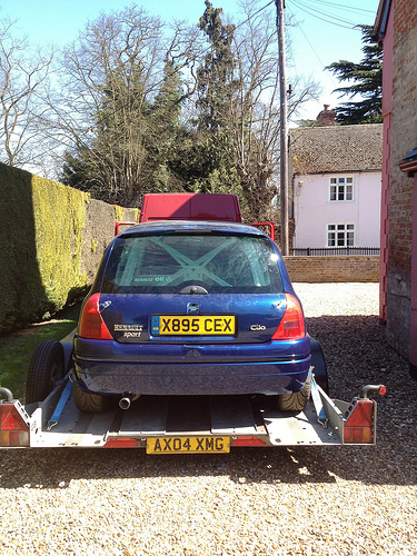

First proper outing will be the Nurburgring at the end of May! Car will have hopefully 2 weeks of road testing before we go
Rhys that was what i was talking about last night when i text you! No worries about no update, I undertstand how busy you are! That your trailer? Also shouldve painted the inlets ;)
Yep that's ours :)
The inlets were going to be painted wrinkle black but I ran out of time so stuck them in the dishwasher and tbh they look alright in the flesh. The blue inlet hose is only temporary.
