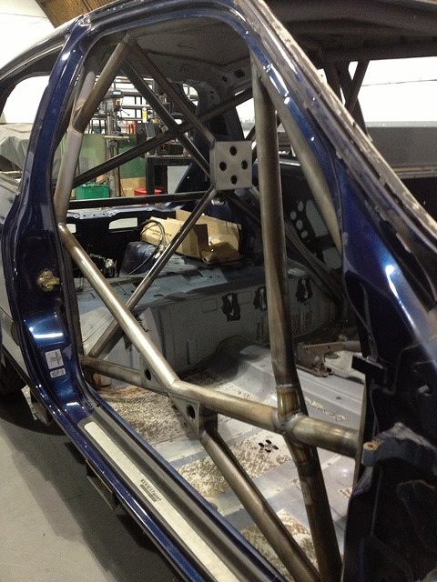

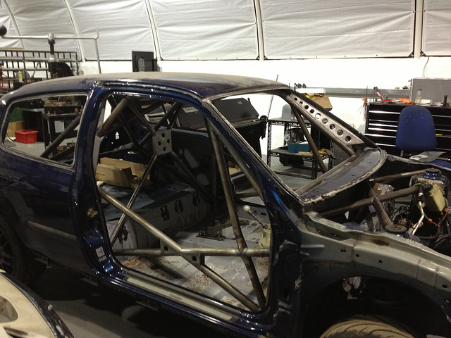

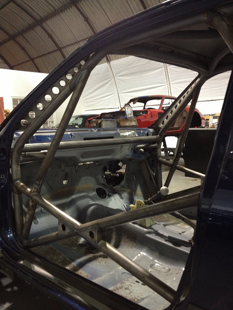

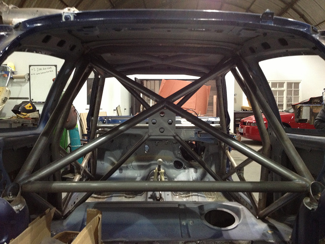

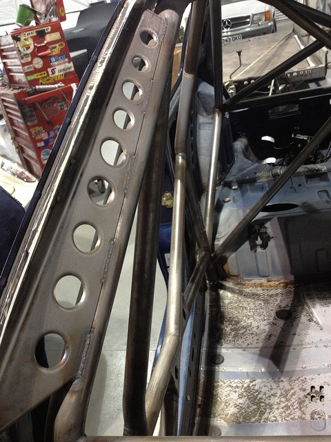

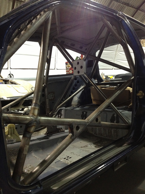

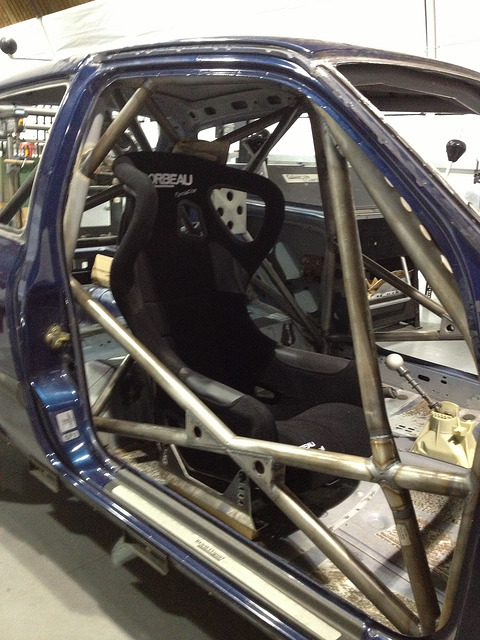

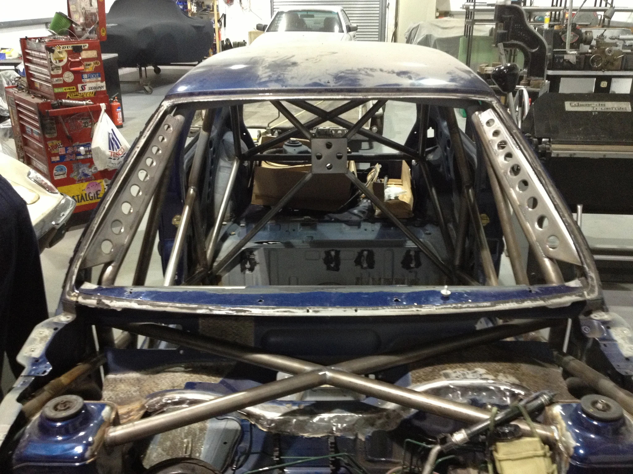

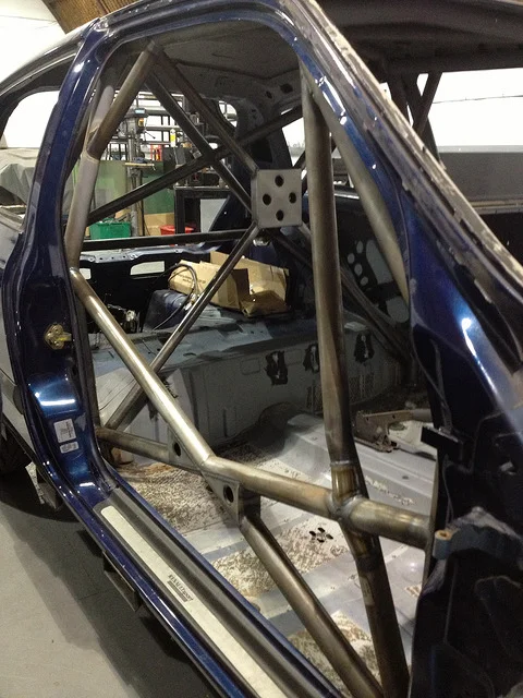

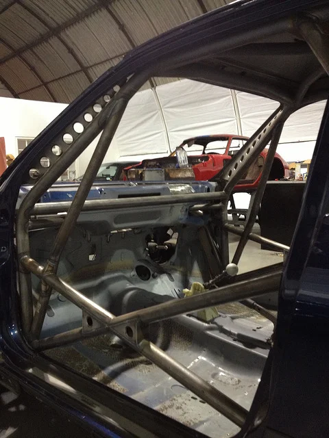

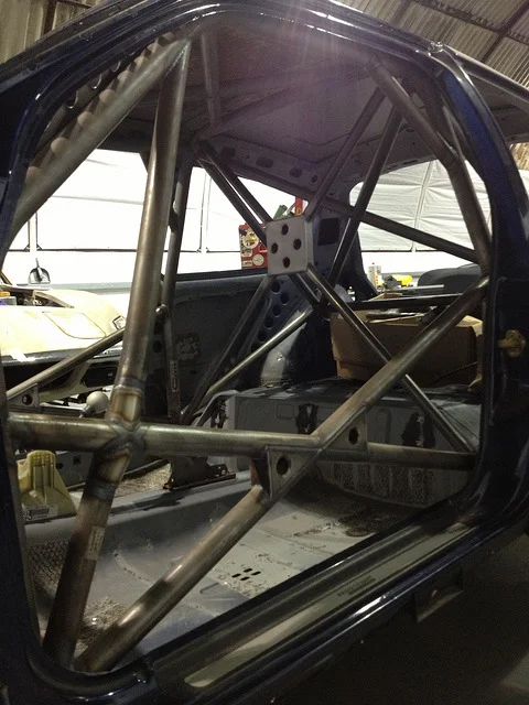

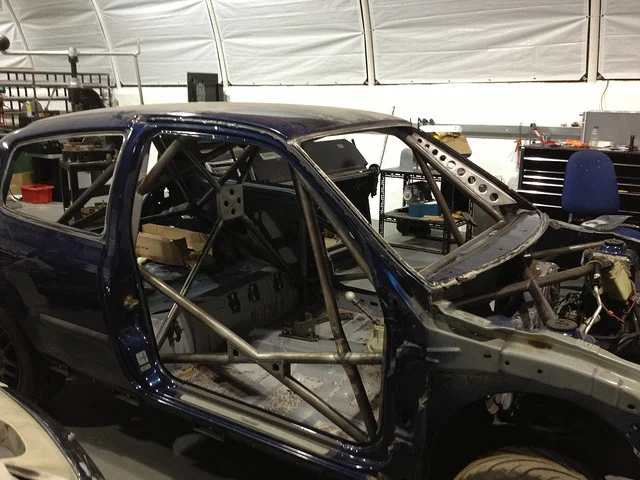

The cage is finished!

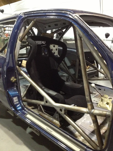

I also popped the seat in to see where I will need to put the mounting tubes and typically it doesn't go back far enough for me because of the centre diagonals. No big deal, will just be a slight compromise in leg room. Height wise, where it sits is about right. Nightmare to get in and out, and that's with no steering wheel.
So excited about getting the car back very soon!:D

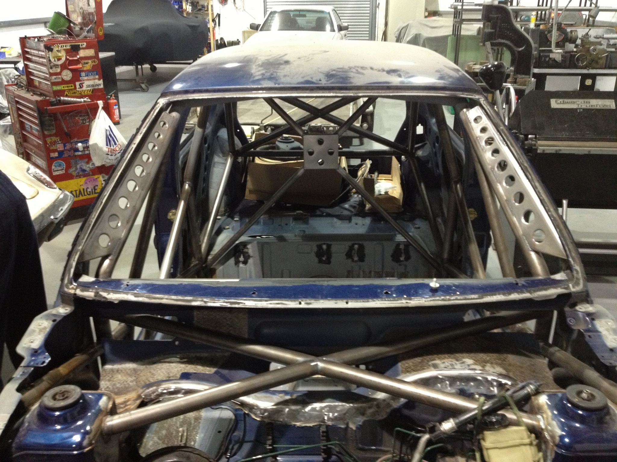

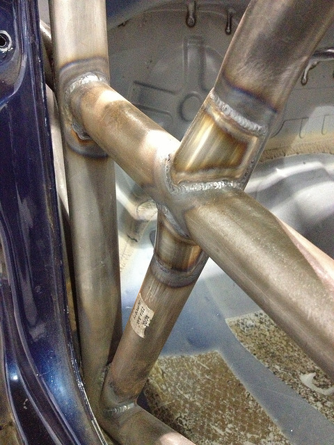

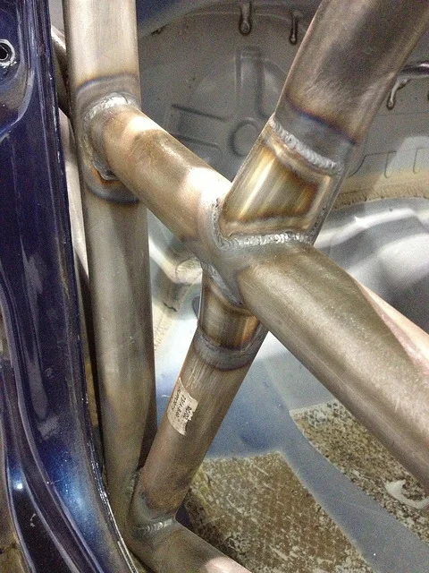

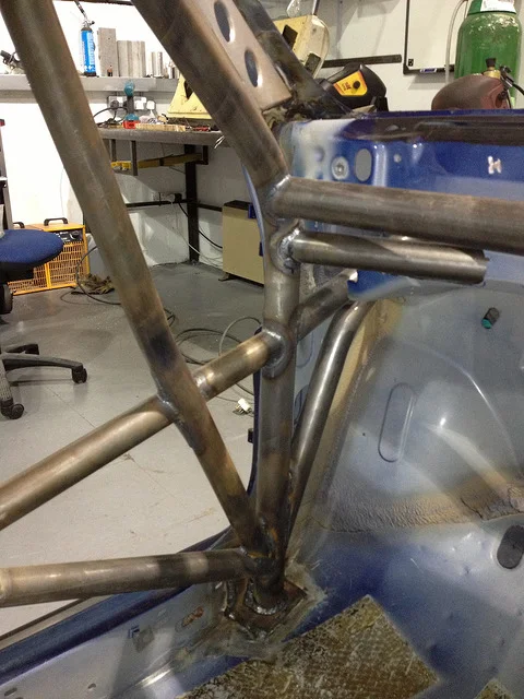

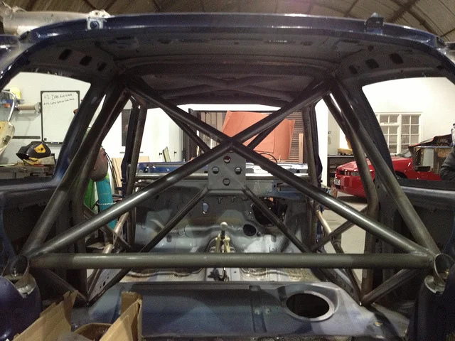

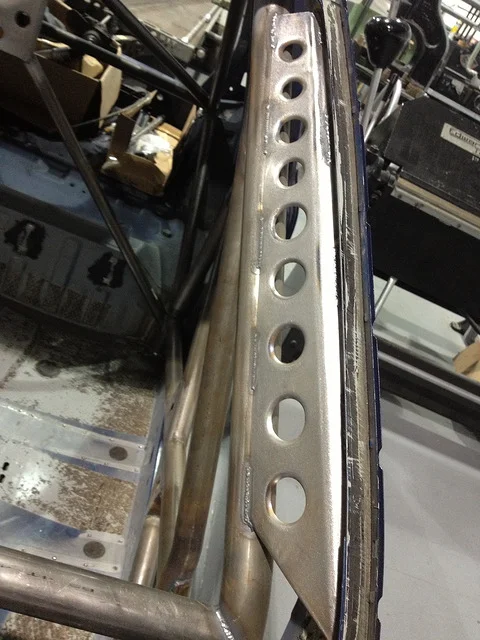

Looks awesome! Your man can weld too! What size tube did you use for the front X? Looks like 35mm possibly bigger?
Thanks Kenny, and if it wasn't for some of your pictures that I printed off it would have been alot harder so thank you!!
The front X is 40mm T45 which is just what Custom Cages sent. I didn't specify a size. What it yours then?
Not a problem, glad to be of some help. Mine is only 25x1.2, your's looks properly solid! Suppose the other X I've got on the bulkhead will help, I'm sure as hell not changing it now lol
Well at least your gona be safe it that car! Cage looks great!

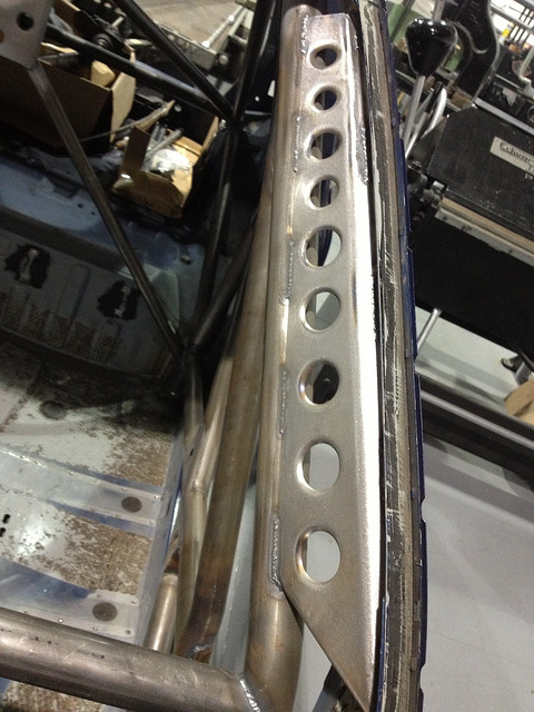

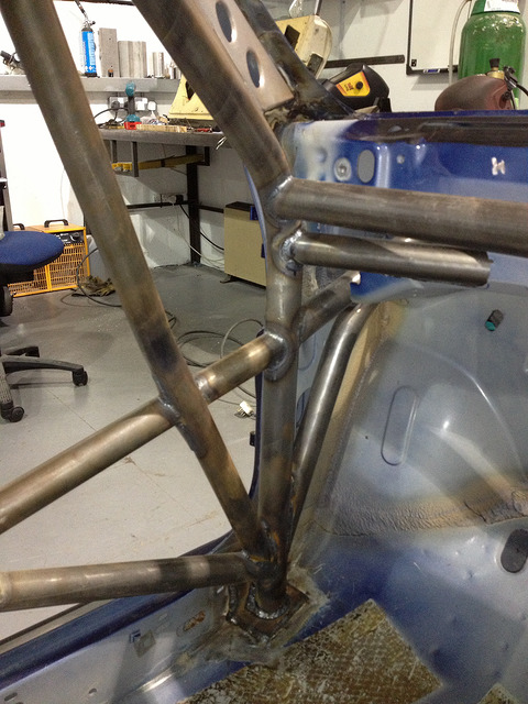

The 2 big rectangle holes in the bulk head look like they are gona be a right ball ache to cover up! Fiddly job!

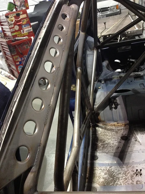

The infill sections on the bulkhead aren't too bad, I thought they were going to be a pain in the ass too. Use some 0.9mm sheet, easy to shape and easy to cut with tin snips. You'll need to make it in 3 possibly 4 bits per side and overlap them slightly, hardest bit is probably getting in round the bars to get the metal clean enough to take a good weld.

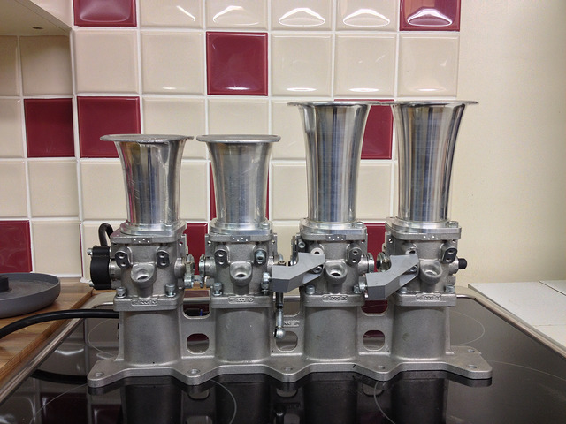

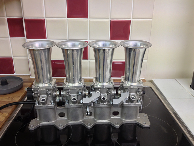

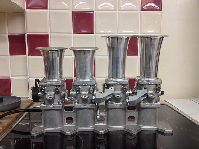

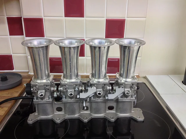

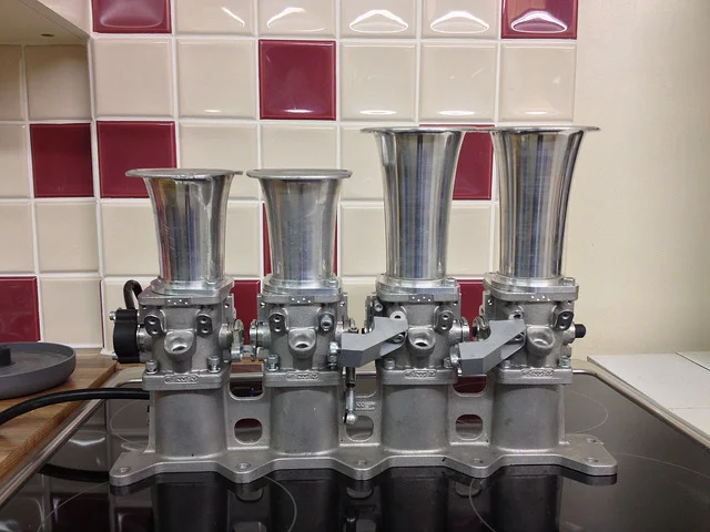

ITB's, cams and supercharged... Oh and my 120mm trumpets arrived today:) Massive
f**k me Rhys, that cage is MEGA! This car is going to be a weapon in every aspect, suspension/shell/engine!
Though there is more room on the inside of that shell to make some more holes. ;)
Cheers Nick:)
Yes there is your right! And there is still too much metal in certain places. I shall address this matter but cutting more off:D
Bloody hell, that's some seriously strong cage! Atleast you know you've given yourself the best chance should anything bad happen (obviously we all would hope it doesn't)
Looks badass too. Me likey

Can you make the old trumpets into some sort of art work for my lounge? ha
Appreciate the comments thank you!
lol trust you ;) I was going to use them for back to back runs when mapping with the 120's but now it's going to be supercharged it might not make any difference. Look cool though!
