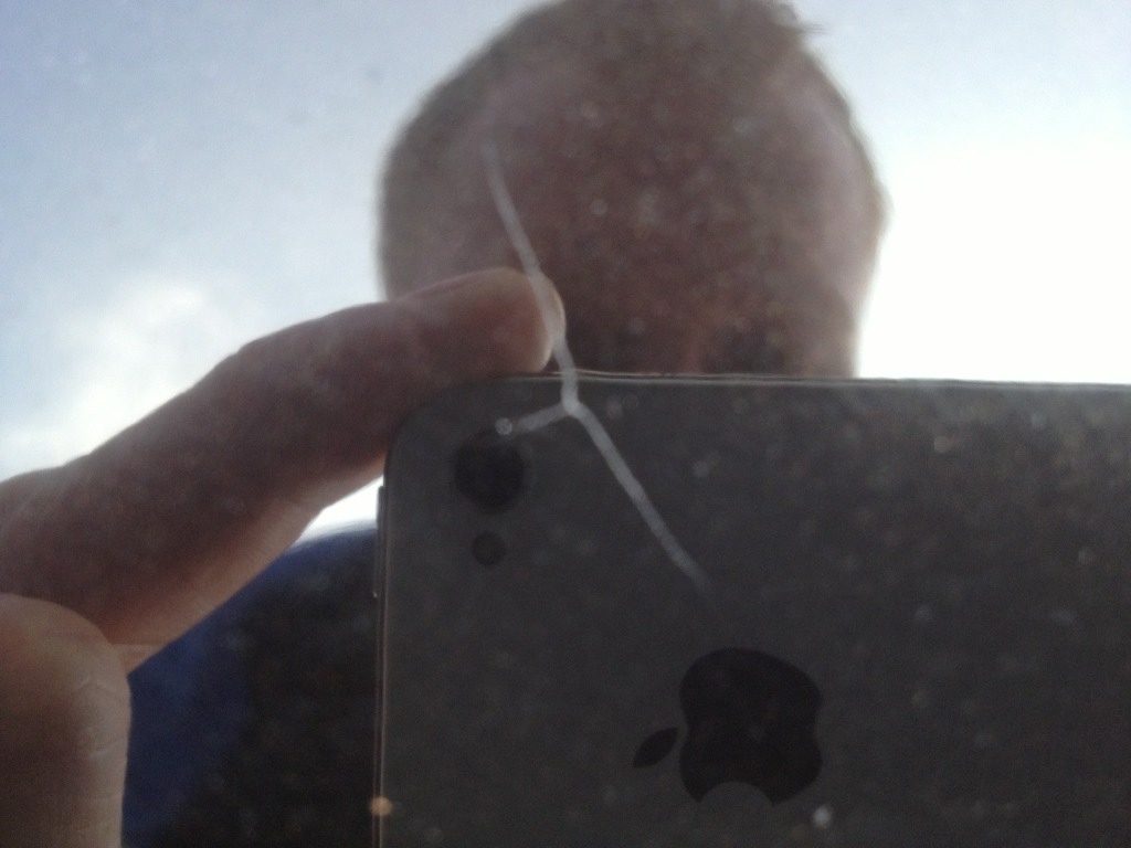

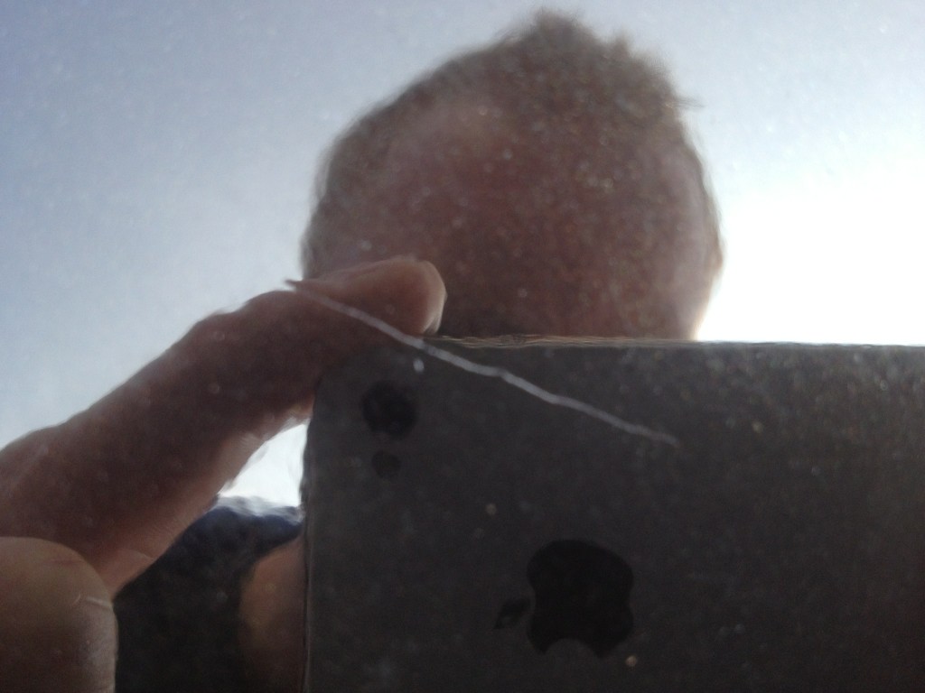

I have noticed that my bonnet has began to develop 4 or 5 hairline cracks in the paintwork. Is this normal or has the bonnet been repaired at some point and it's due to paint or filler shrinkage?
Sorry for the crappy quality photos but you can see that they are not usual scratches as the seem to branch off too
Thats most likely been repaired at some point, my money would be on a paint reaction being the cause......

Thanks for the info! It's not that much of a worry to me but it's just slightly annoying.
Would a bonnet from a different car be a good paint match only being an 04 plate car? Or would it be a case of just getting the original bonnet sprayed? Don't really want to spend a fortune as it's not essential really
If you got anouther BG bonnet match will be fine, assuming its a factory finish on new bonnet. If you used your current bonnet it would have to be stripped right back and totally refinished, which will be expensive.
