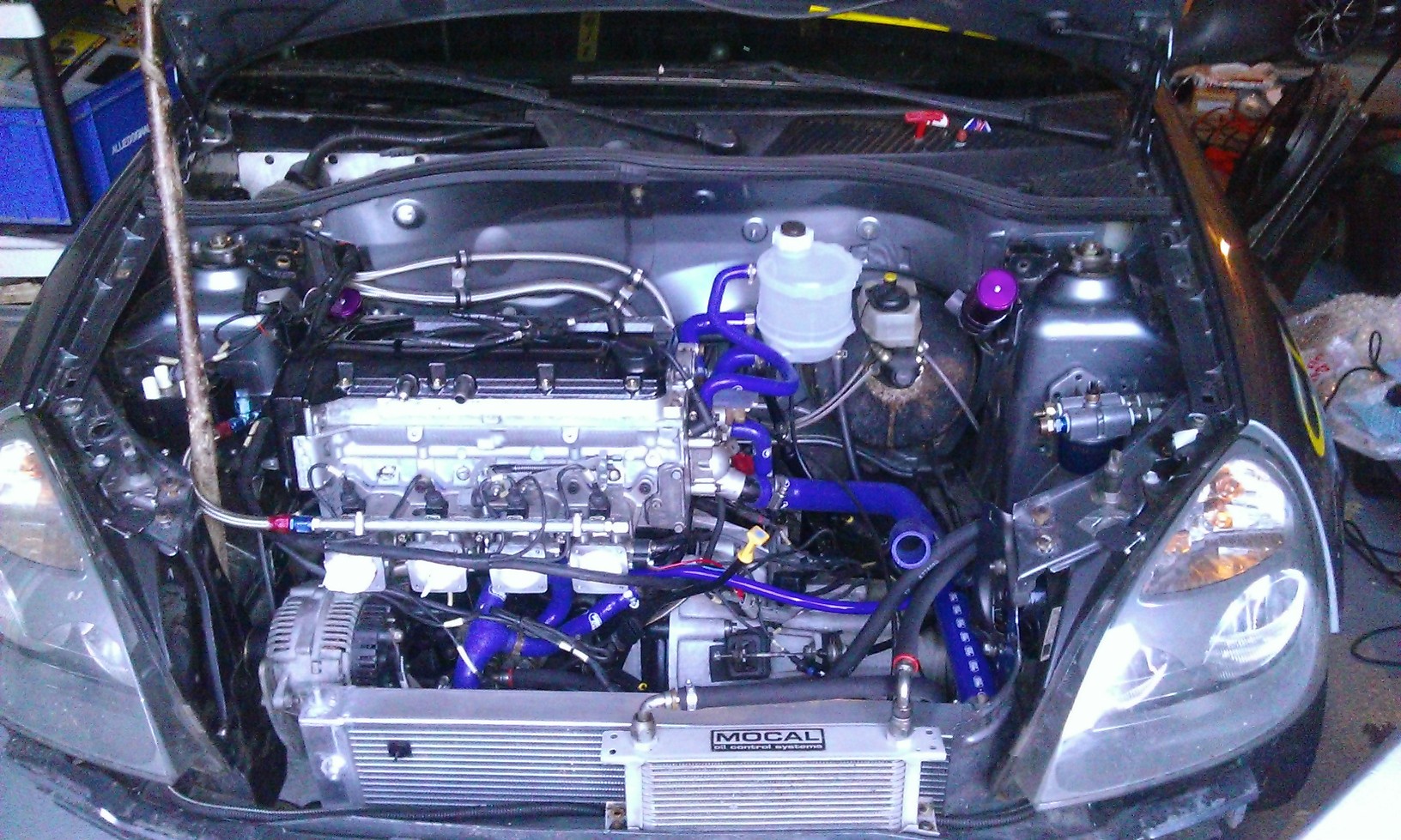

Finally engine and gearbox running in... :)
Tidy loom connector, swap out fluids and all set for first event.

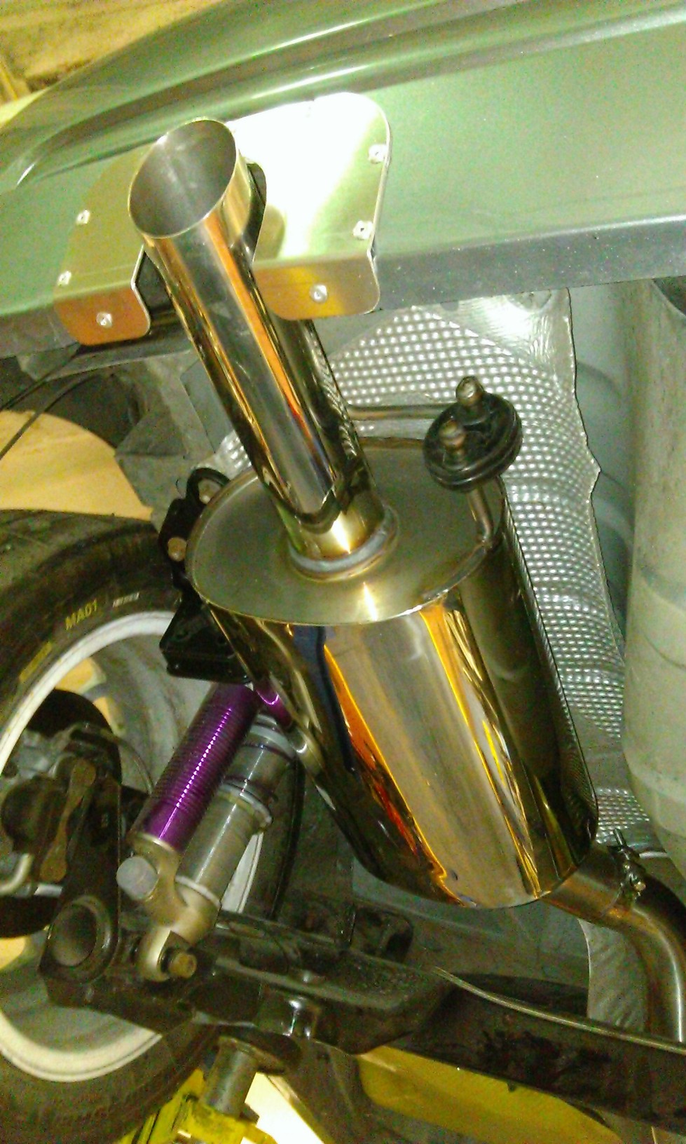

Reiger suspension

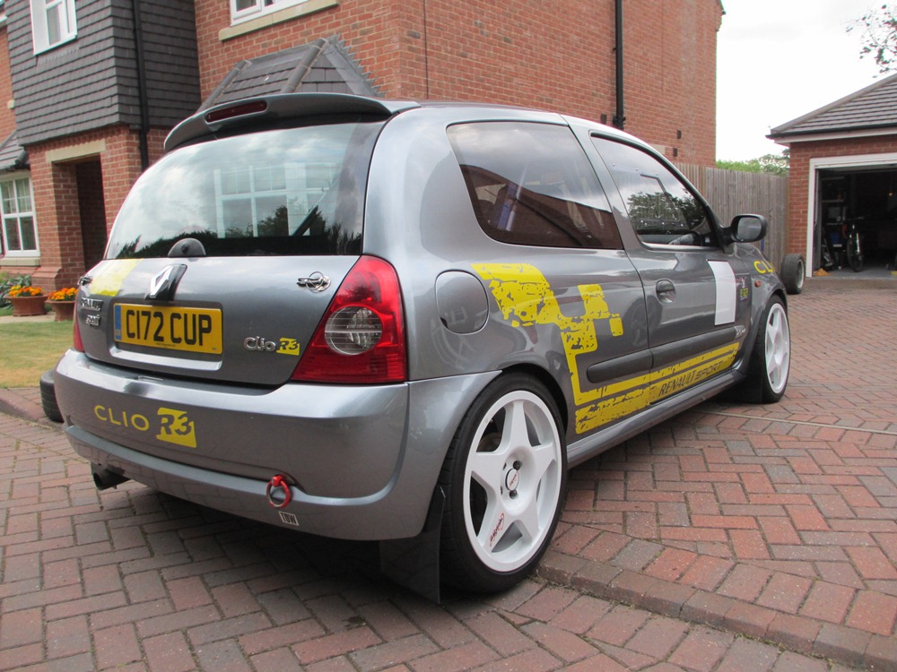

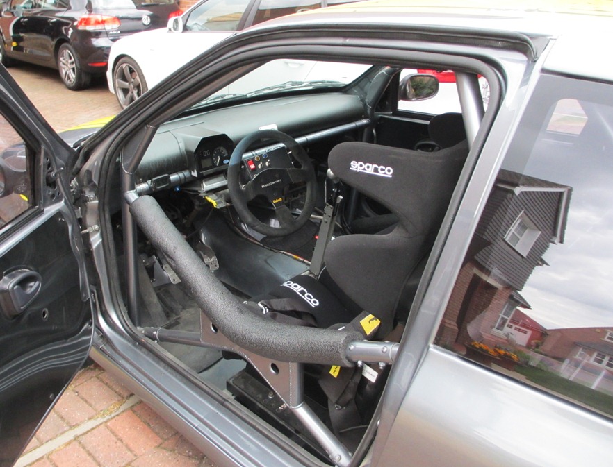

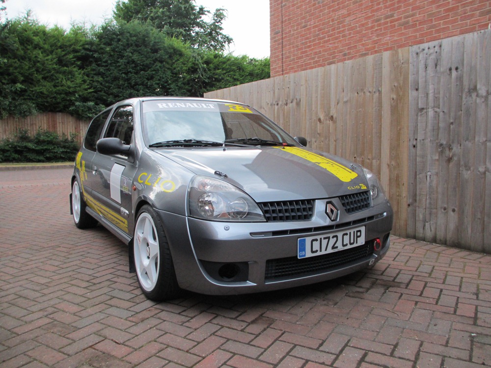

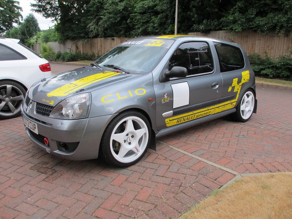

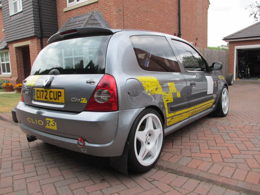

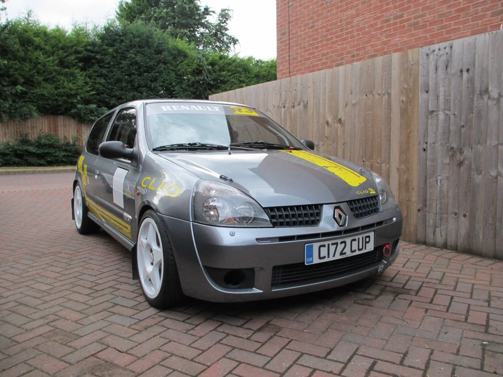

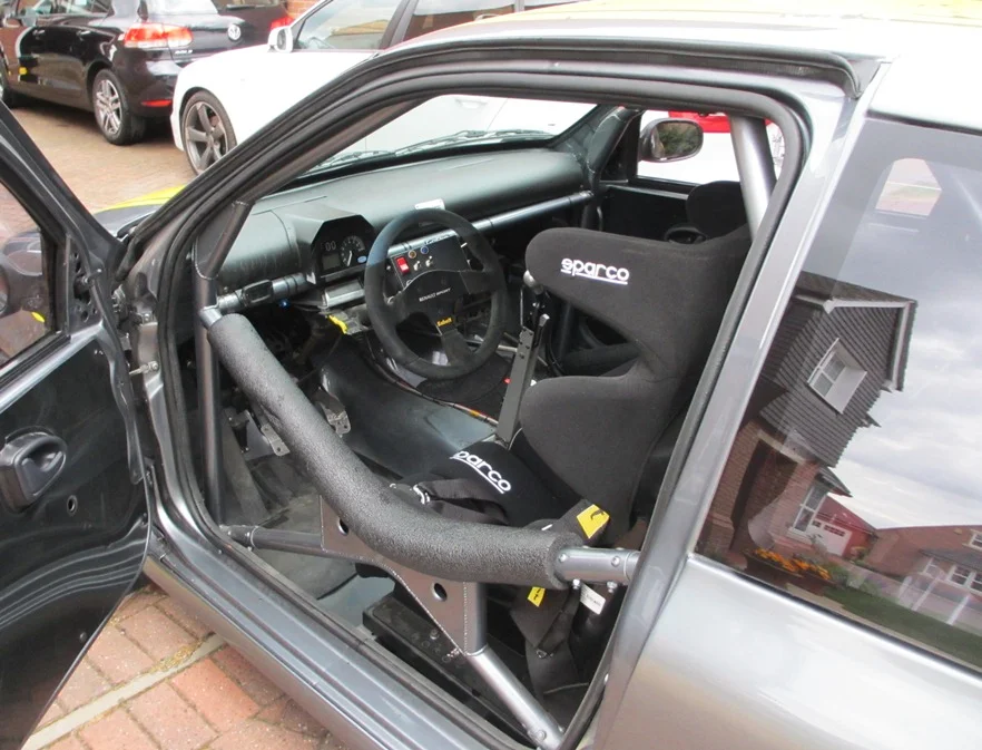

I'm sure Steve will be along soon to tell you all more but off the top if my head the engine is out of his pink mk1 rally car (f7 I think) hats off to you Steve I'm hoping to see you put this car to good use :D
EVOgone
  Pink Cup Racer

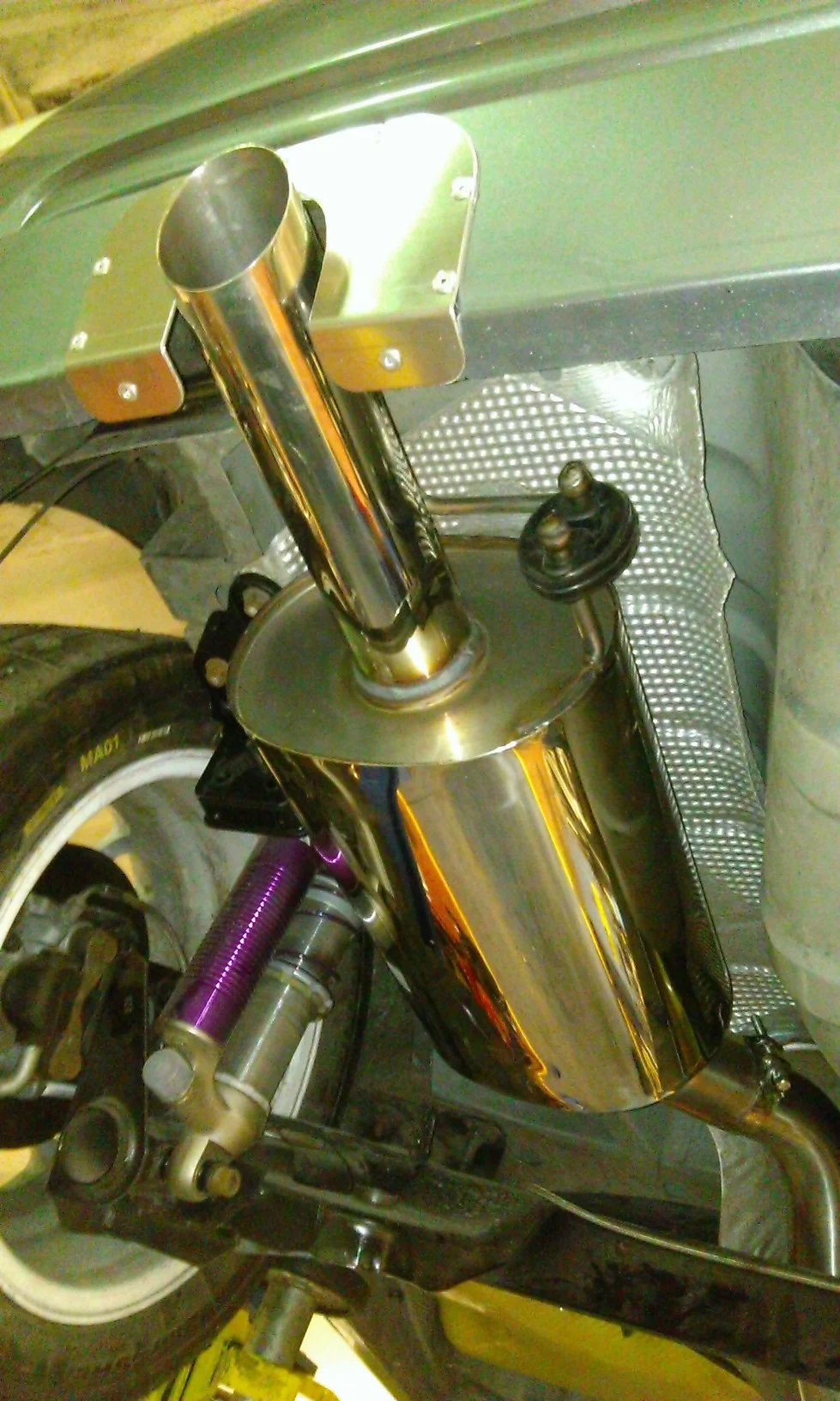

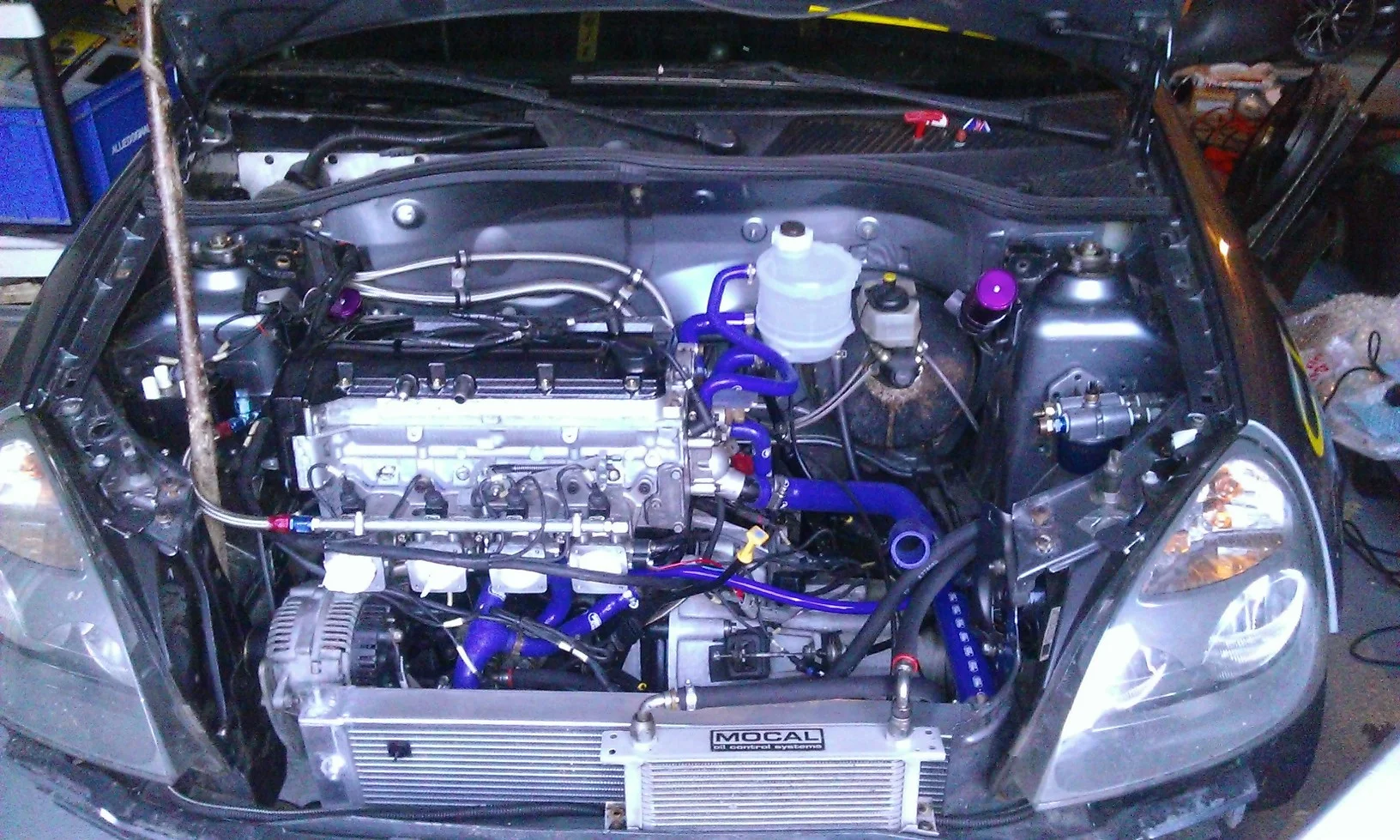

Yes correct its the F7 engine from the Pink car, was excellent in that car and we have fully rebuilt it with a few extra mods and a new Jenvey ITB set up with 100mm extra induction length. Its now got 180lbs (peaks at 189lbs) from 4500 to 7000 now where it used to be a bit more peaky before hand.
Regards spec a dare not list it out as it cost well over 20k thats for sure......Ask Ian Godney as his is very similar spec and it maybe 30k........ :-(
Car has took 12month to build really and everything is new or fully rebuilt, its like brand new even underneath.! Wont be on track as its a rallycar and only geared for 120mph tops at 8k. It really pops and bangs on overrun its like antilag, quite a bit of overlap.!!

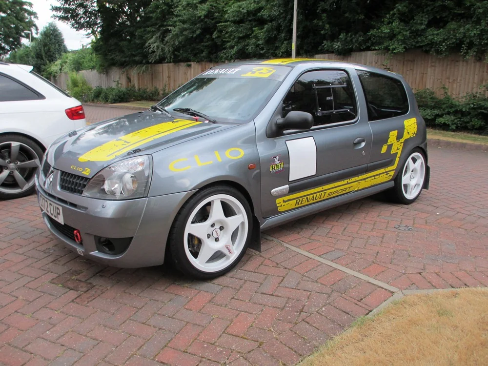

First event in car footage, lens a bit blurred with a smudge. First event in 18 months and lhd so some learning to do but car is good but suspension a bit soft at the rear, brakes are mentally good though, breaking early everywhere!
We're upto 6th o/a but car cut out like it ran out of fuel and we retired. Think the timing belt has jumped a tooth, all compressions 130 (normally 215) and black plugs. It does start but only on wide open throttle and just ticks over on WOT too. Oh well we will see.
