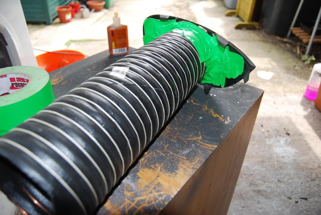

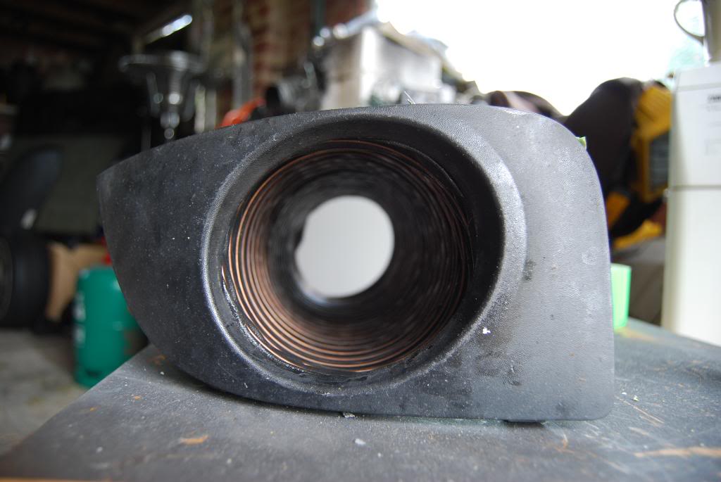

Update

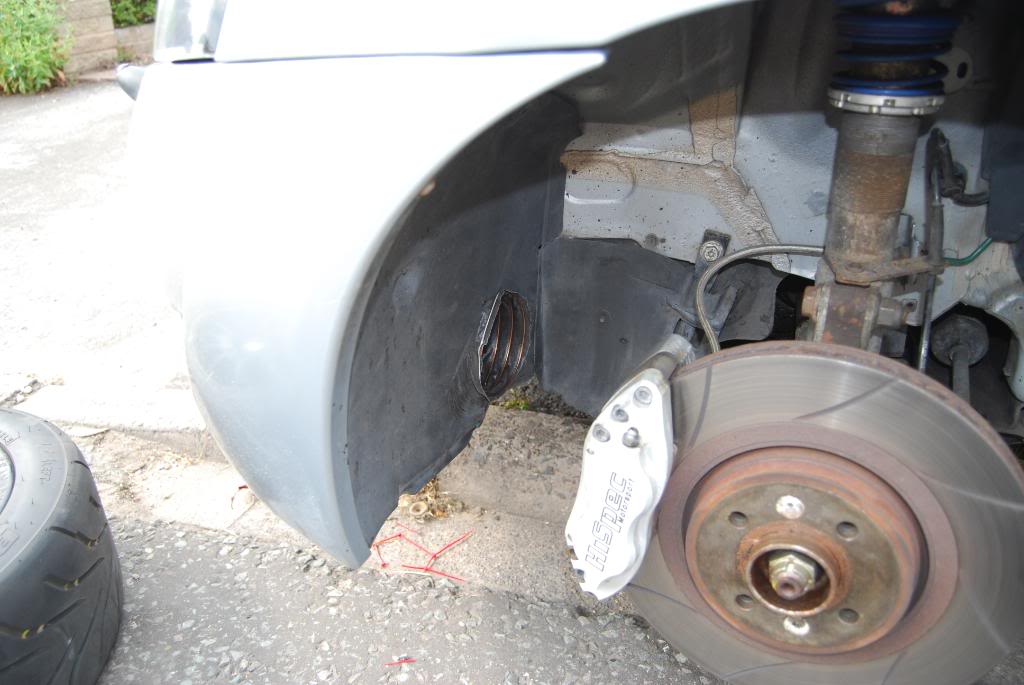

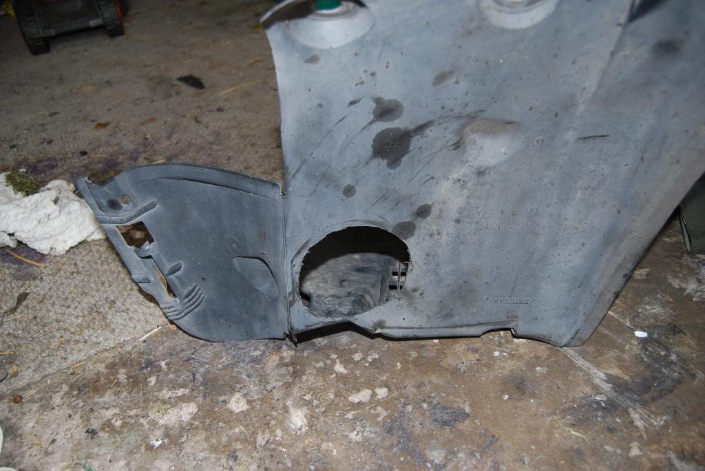

Fitted new brake ducts today :)

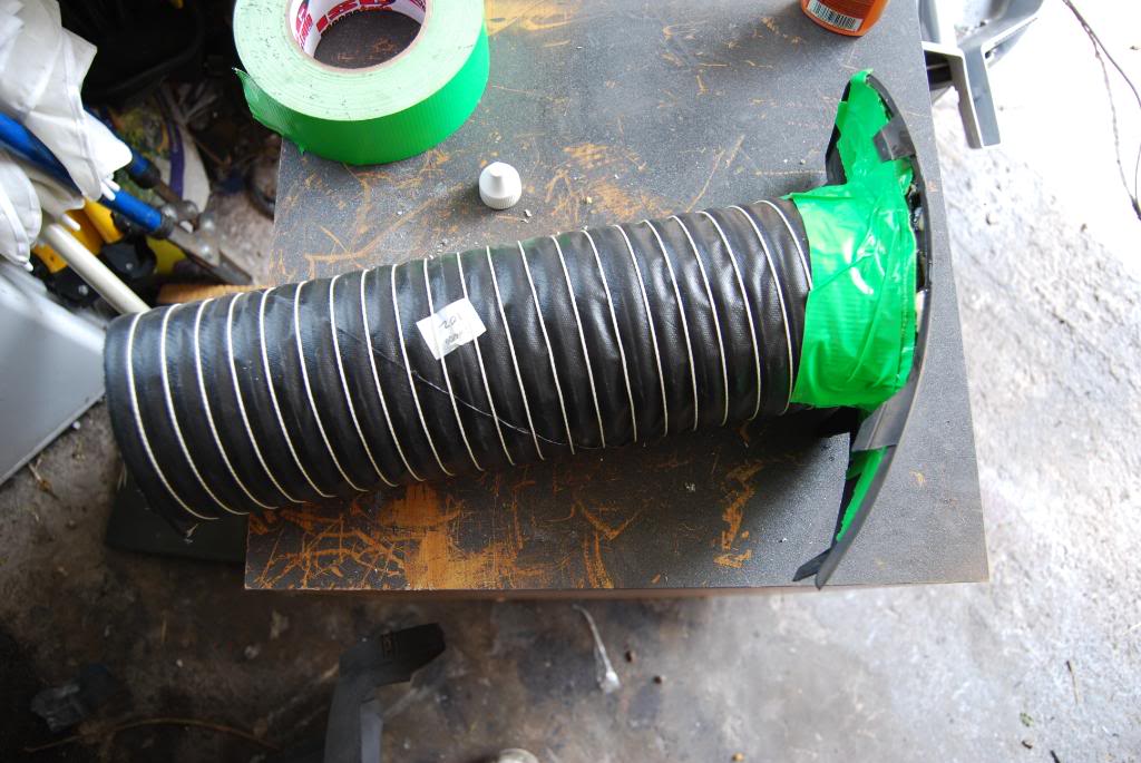

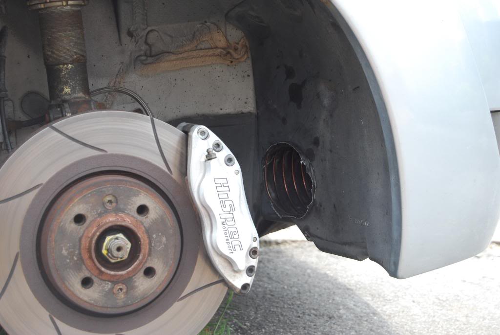

First of all had to create a hole in the wheel arch for the duct
Then with my weapon of choice
and the green tape in the background

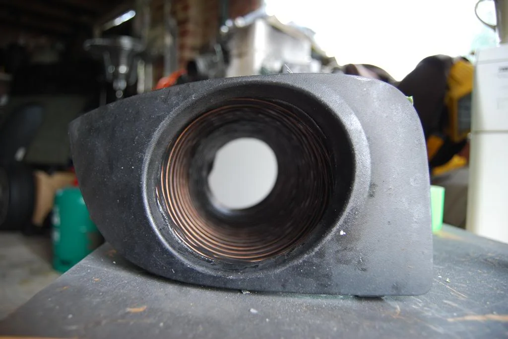

I began to bond the ducting to the fog light covers
Left dry for a bit, then fitted to car - Carbon cannister was moved slightly to allow enough room

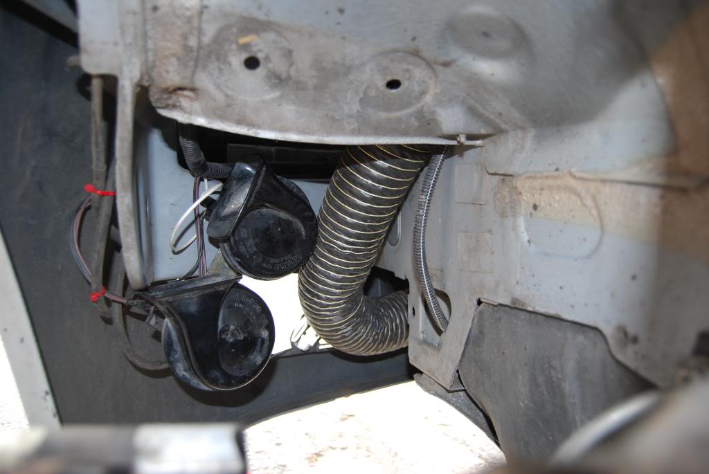

Process was repeated for the other side, however the horns were in the way.
So using the existing bracket, i bent it, and relocated the horns to allow room for the ducting
Note the existing ducting from the front grill to the air filter in the way a little aswell.
Fitted
Done

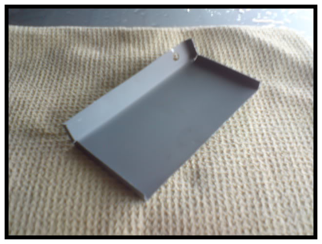

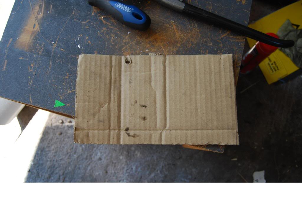

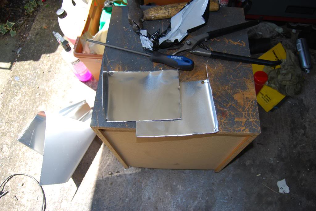

Will be making some deflectors when my metal snips arrive, and i get my saw tommorow :)
Re: Project 172 **** Update page 3

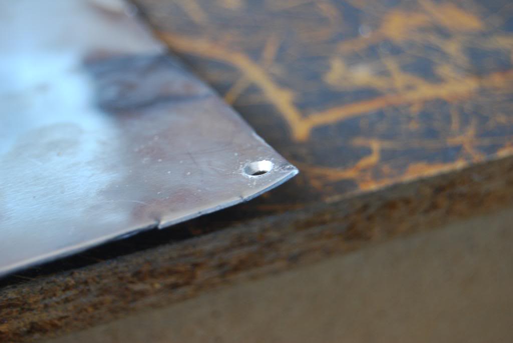

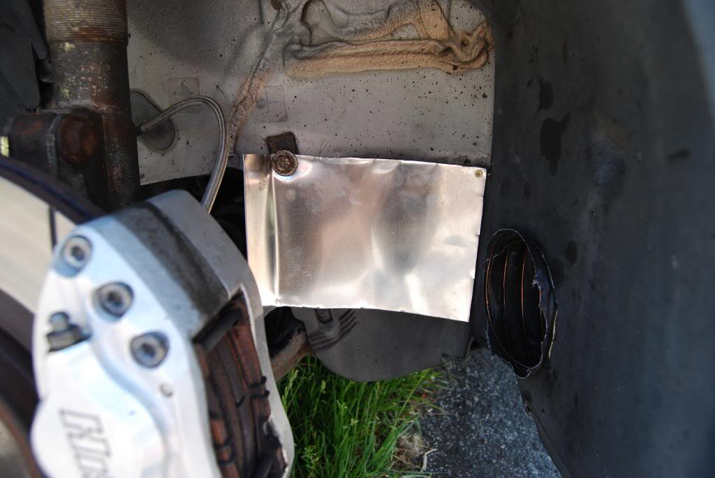

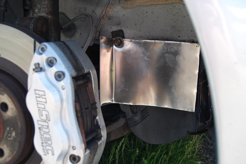

Deflectors fitted

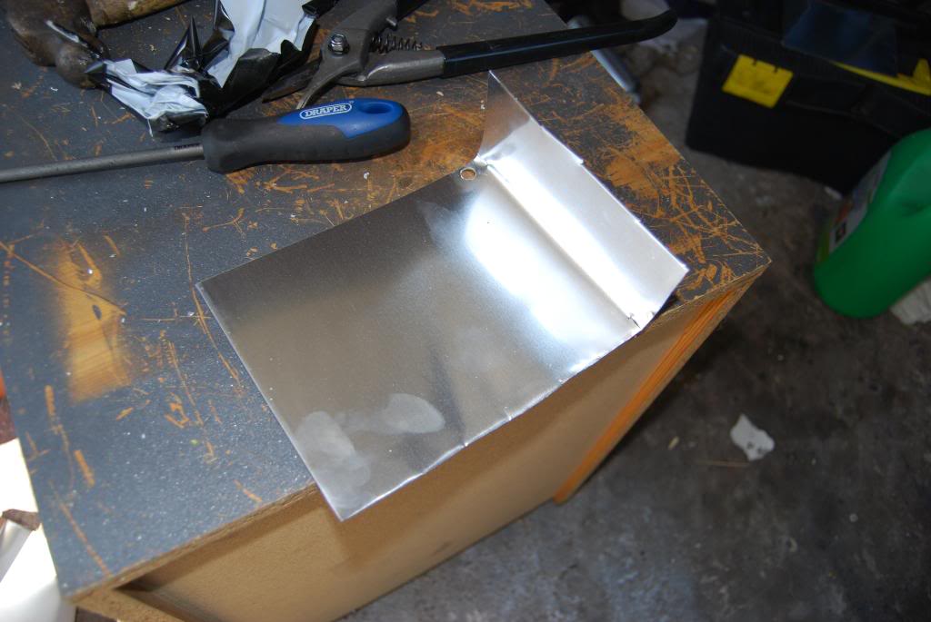

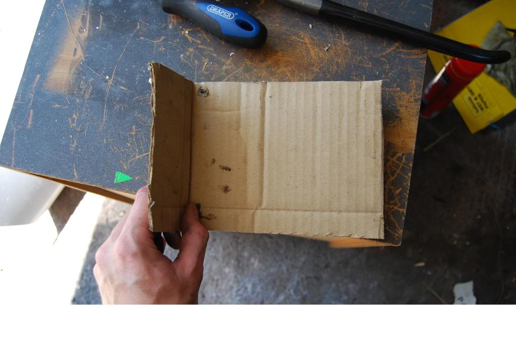

Mock up in carboard first
Cut out in alluminium
Hole countersunk slightly for support
Fitted
With the use of a hair dryer,its good to say they work spot on :)

great job with the ducting but the aluminium looks terrible, logical thinking but poor job, get some decent deflectors made. also if that ever came loose, say bye bye to your tyres! make them out of perspex or some form of plastic, carbon would be cool :)

i made my deflectors out of an old safety face mask but like you say, no one can see them anyway. theres a pic in my old project thread i think.

Surely the Ali scoops will bend when at speed?
Galv Steel, finished off with galv protection paint to prevent rusting,
Tested on all JMS cars to over 130MPH at Snetterton with out failure :cool:
Still have another idea i'm working on with the ducting, will update all on my project thread
James
Might see how they last, cant grumble for £5 for 500mmx500mm of alluminium.
If they break at least its weak and will just bend very easily against the tyre :)

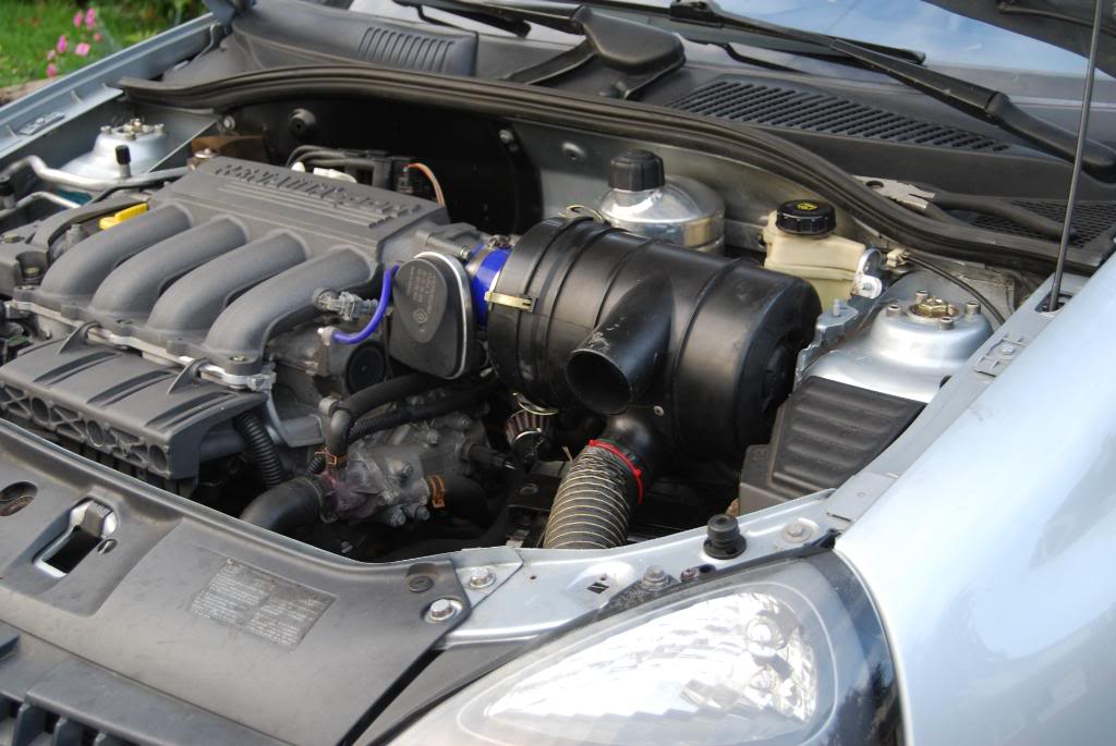

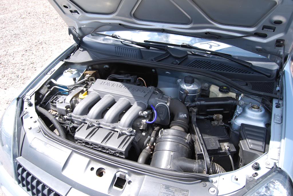

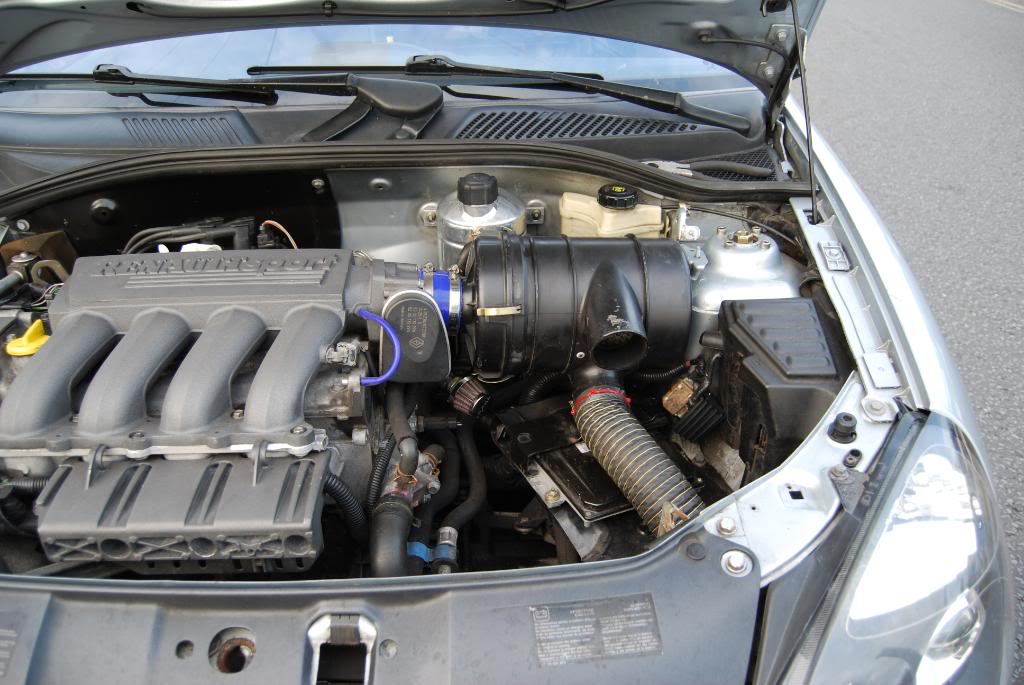

Re: Project 172 **** Update page 4 - Air filter located cup racer style ;)
nice big gap under the bonnet now, get another cold air feed to it
Yeh, shed loads more room now. Wanted to see what the filter would be like that way, and it doesn feel loads better.
  340i
Top work!

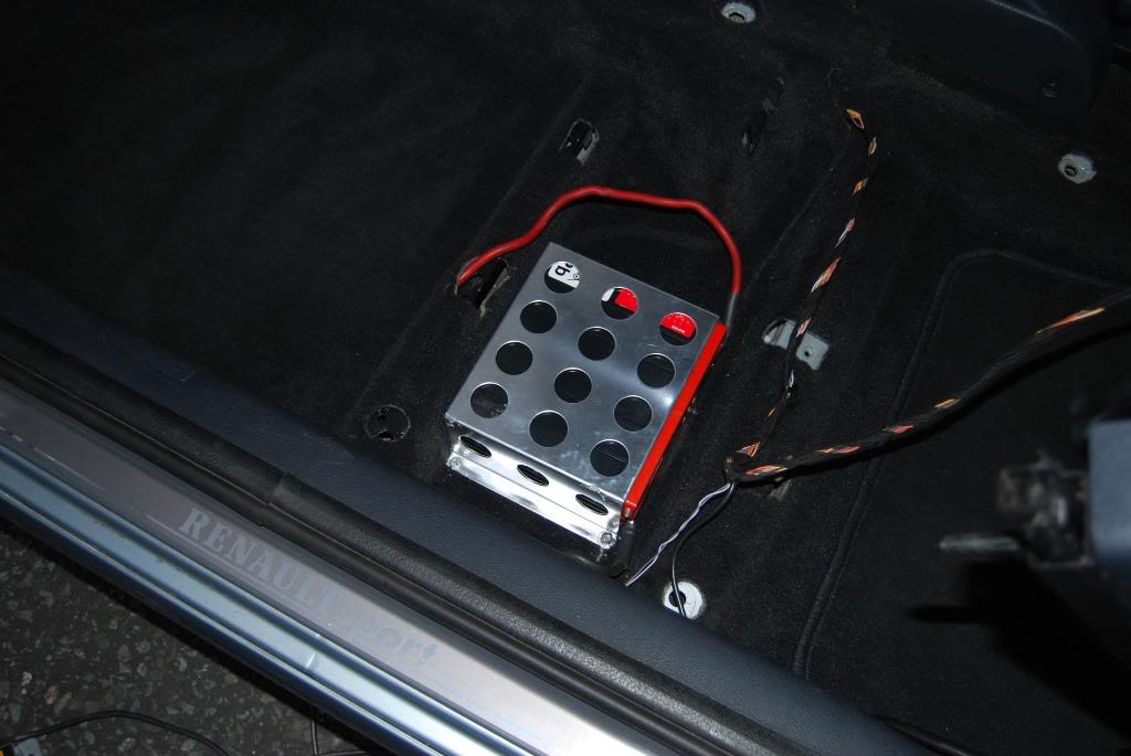

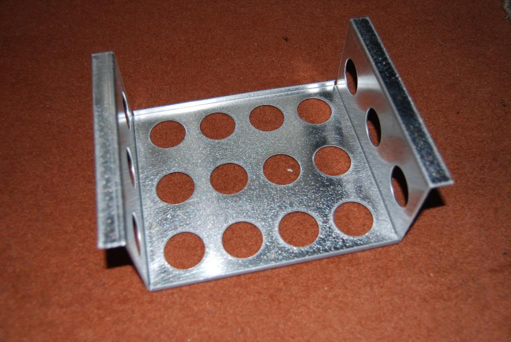

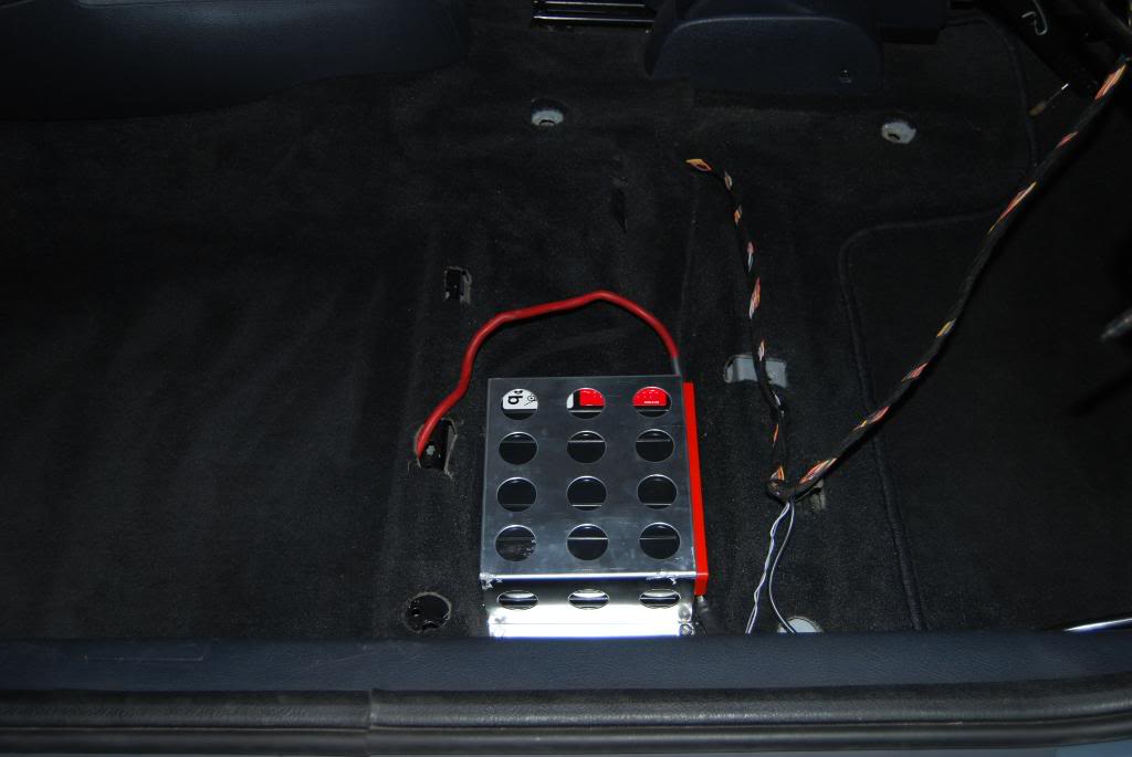

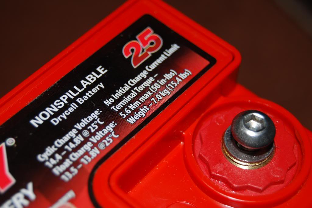

This is my next "mod"... Out of interest how/what have you done to secure the ECU?
Just not sure if I will get the same fitment with the Ph-1 throttle body!?
Its secured using the old hole where the battery bracket went :) You can just see the bolt under the junction box i used for the existing wires. Solid as a rock.
Can feel the difference without the big battery upfront,feels alot more stable.

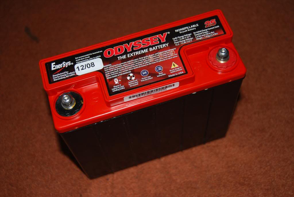

Looks like a nice fit under the seat!
How much was the battery?
  BMW M135i
Nice tidy job with the battery, I want to have something like this soon :)
