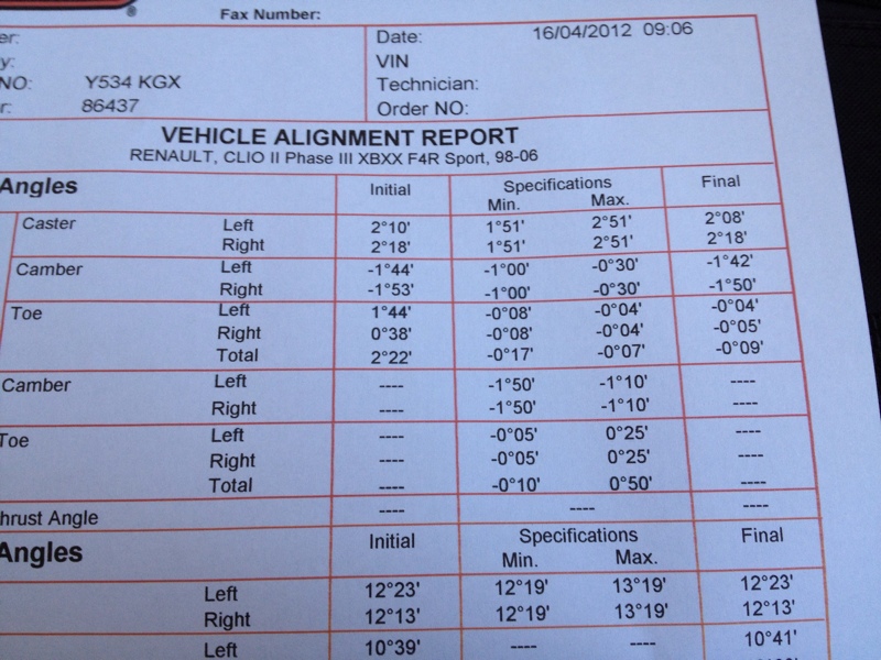

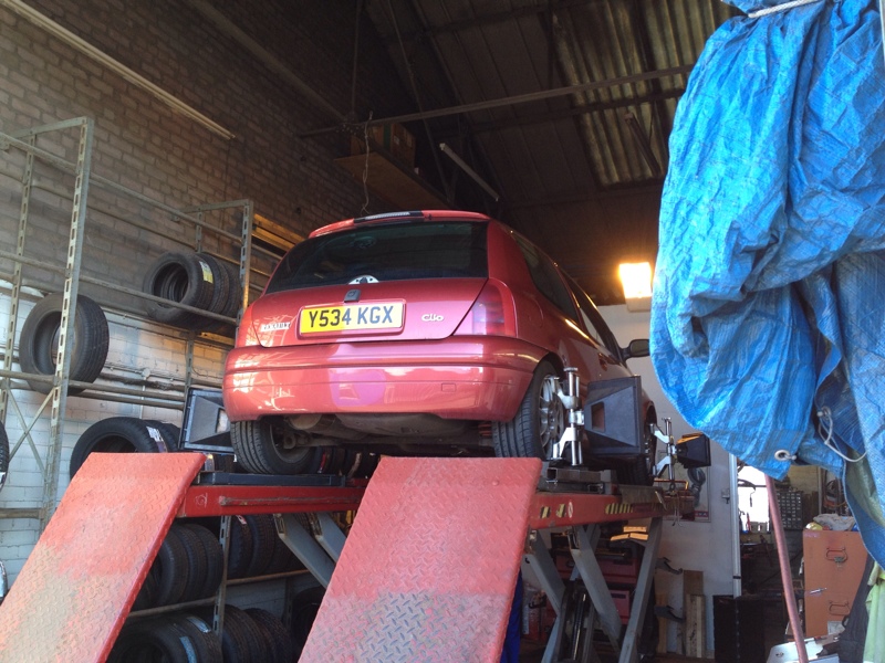

Went along and got the alignment done at clcm in Edinburgh today, knew it was miles out as it was horrible to drive, big improvement now

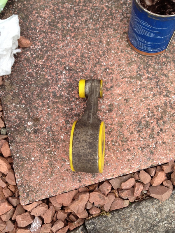

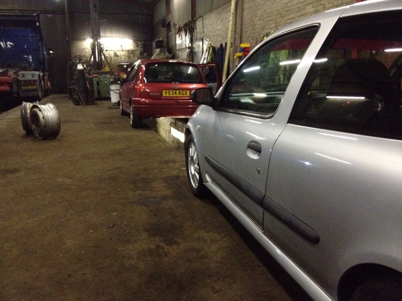

So a bit of a busy week with the cars, started with the alignment on Monday as above, was meant to work on it on Tuesday but accidently had a 3 hour nap! So that put things back a bit, was out on Wed night so that used up more time and finally on Thursday we got round to changing the rear ns caliper and bleeding all 4 brakes as well as a couple of niggly little jobs like adjusting handbrake cables, heat shields etc etc. We were just pressing on so didnt take many pics, just one at the start and one at the end!

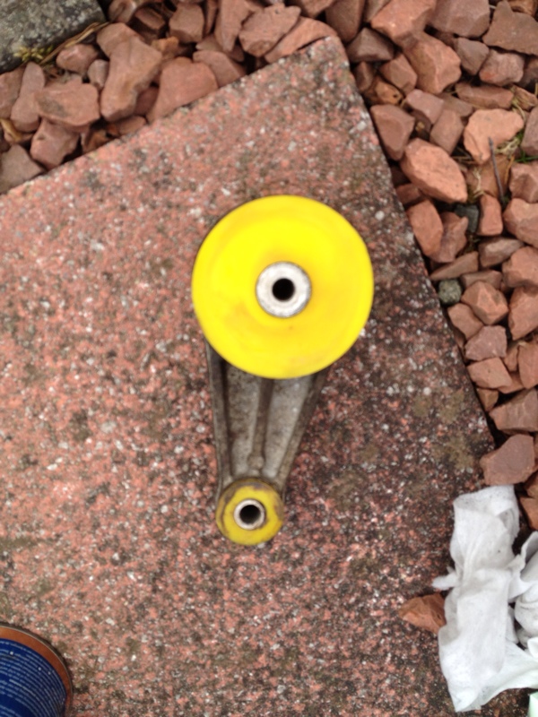

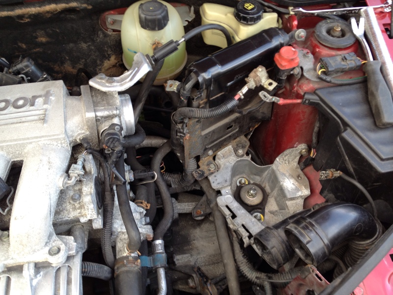

So on Friday I swapped over the upper gearbox mount, which is a boring pic but here it is anyway!
Currently the plan is still to upgrade to stiffer ones but, as always for me, money isn't overflowing!

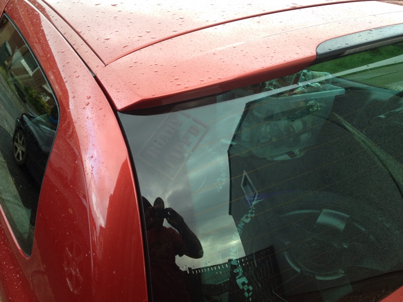

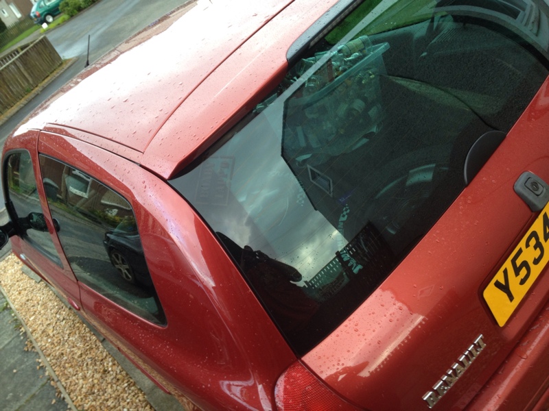

And today was a case of cleaning out all the crap that has built up in and on the car over the past wee while, any spare time has been used doing things to it rather than washing it. I also fitted another splitter and my wiper blank. That almost passes the 20ft test. Almost. Gonna have to redo/buy a better one, paint etc is not my strong point!

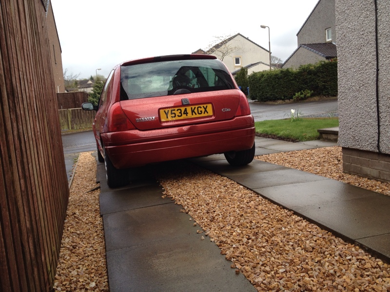

Car is now ready for Knockhill tomorrow, hopefully! And sitting a little bit low as its loaded ready for the early start, wish me luck!

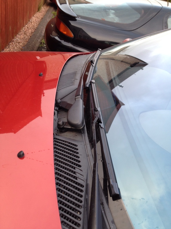

Looking good John. I like the look with the rear wiper removed, think I'll take mine off, is it hard to do?
Djw John
Scotland - South
No, easy to do but I struggled with the filler of all things! I did it using a 13mm open spanner on the nut and iirc a 17mm spanner going over the end of the nut and behind the wiper arm, basically acting as a puller.

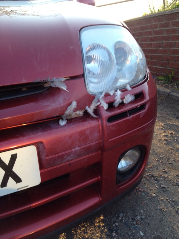

Also changed from the normal blades to some Goodyear aero blades from Costco, seem good so far but not been properly used yet.
Recently smacked a pigeon at 70 on sat and still not washed these feathers off!

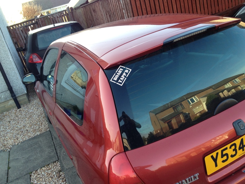

And fitted a less subtle sticker!
