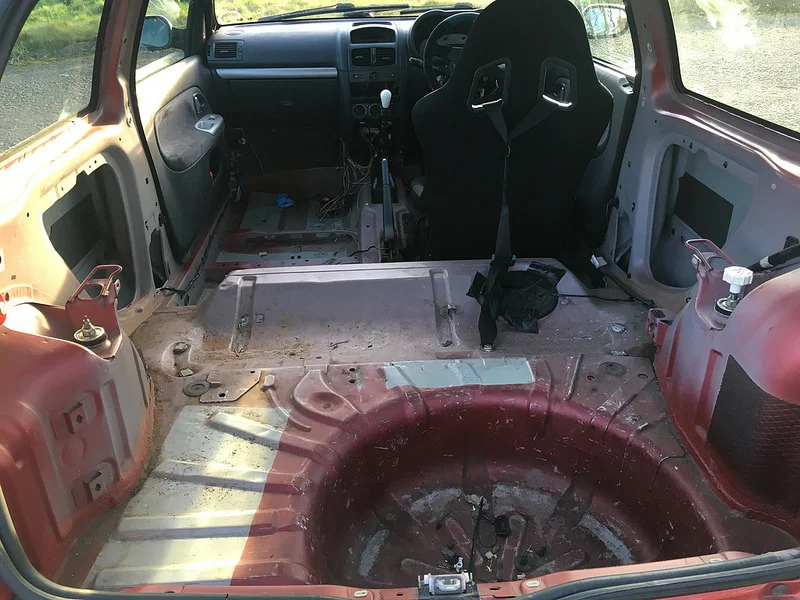

I'd like to make it clear that any wiring im removing is not for weight saving! It's because it's redundant and I can clean it up. I'm planning on painting the interior so this is all prep work for that. Even though it'll be brushed on hammerite.

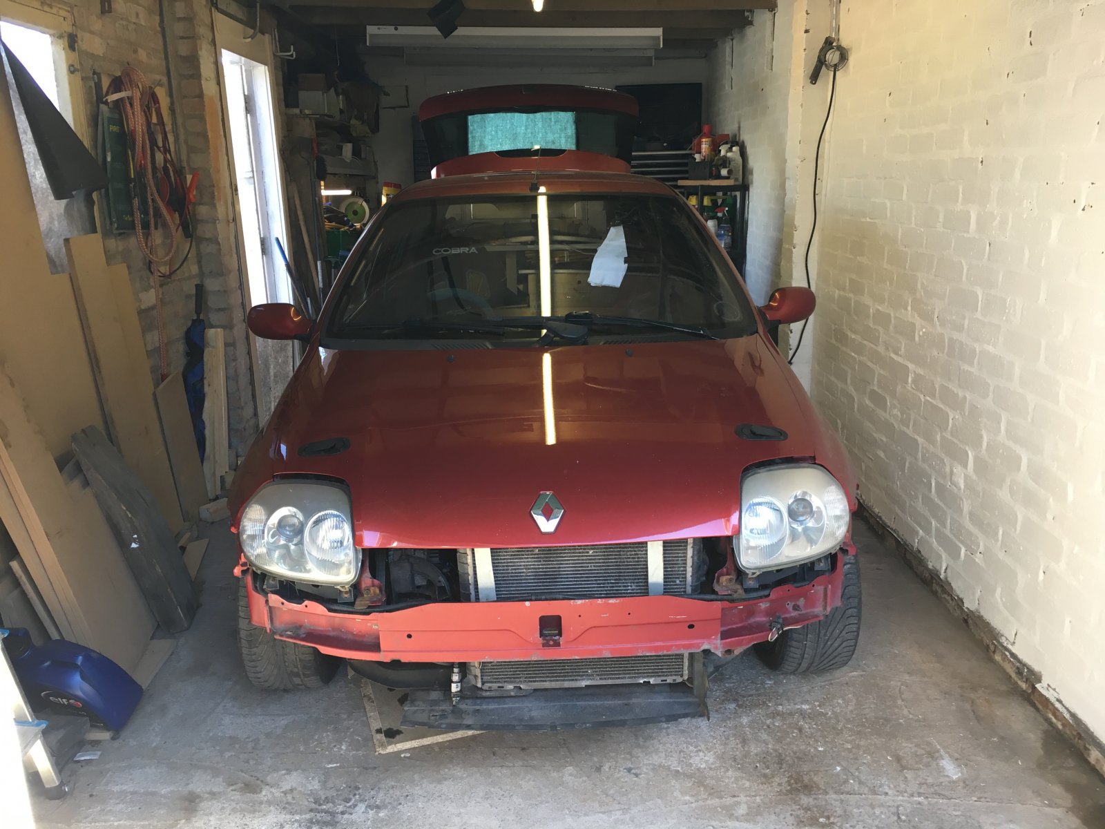

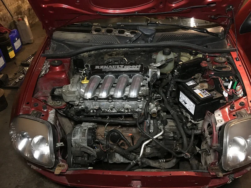

I removed the slam panel cos it was redundant with the aerocatches, it really helps access to the engine bay as well. Sorry, I forgot to re-measure the garage but I shall.

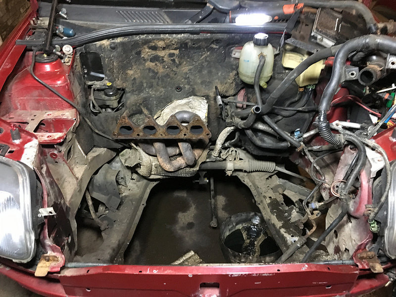

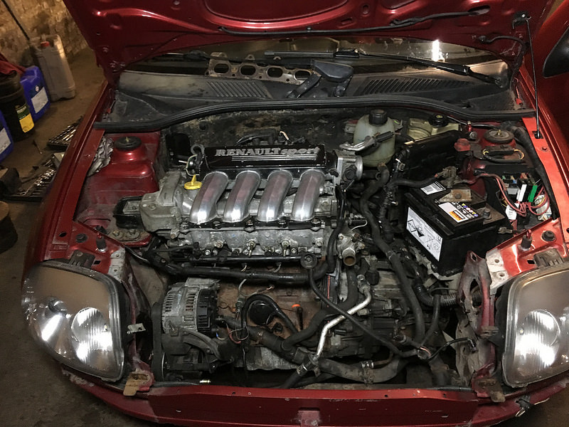

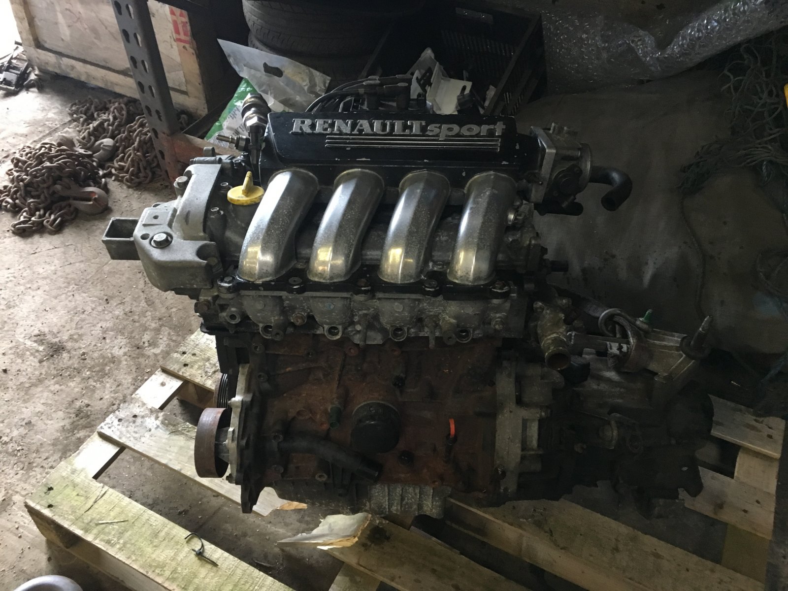

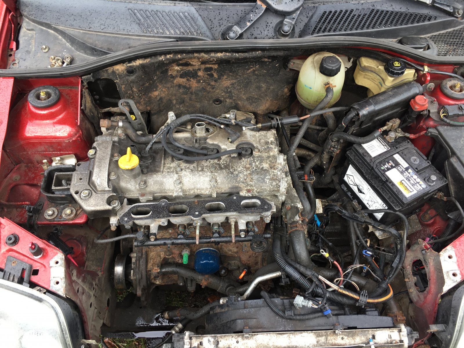

Things have taken a bit of a turn for the worse with this, I was basically 3 jobs away from having it MOT ready (rear brake line, bleed brakes, fit harness) when it really didn't want to start yesterday. It was popping and banging whilst turning over and then when it did eventually fire it ran terribly. Was able to identify that it was cylinder 3 that was being lazy, with having the 182 on the drive it does make parts fault finding easy at least, was able to rule out injectors, leads and coil pack which left the plug or the engine itself.
Removed the plugs and noticed that cylinder 3 one was noticeably looser than the other 3, now I know that it blew plug 3 out when I didn't own it but a new plug went in fine. Figured it made sense to compression test it when its all apart anyway and got the following results, 1-4: 110, 150, 170, 175 which obviously isn't great. I've managed to source a known good engine and box (from the old track car!) so I'm going to get that but for the sake of £20 I've got nowt to lose so may as well fire a helicoil in this one and see if it takes.

Nice one @Djw John garage looks similar to what I'm allowed to build width wise so just want to get a rough idea.

Got the engine put back together to turn it round for better access to the rear lines and also so I don't have to push it up the drive tomorrow when it gets taken to Dave's work for its engine swap which we hope to do this weekend.
Shame to take the front end off again but it needed to happen.

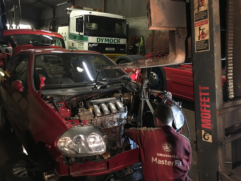

Lets start with, f**king hell we're tired! But happy, very happy. 50 miles done so far and its been going well so far.
As above we started yesterday evening and after not long we got it to this stage
Untitled by john.holligan, on Flickr
and then a wee bit jiggery pokery
got us to
so we rewarded ourselves
and pottered away until about 1. Got started about 10 this morning after dropping Daves wheels off for a refurb and a hour later it started on the first turn which is always a great feeling!

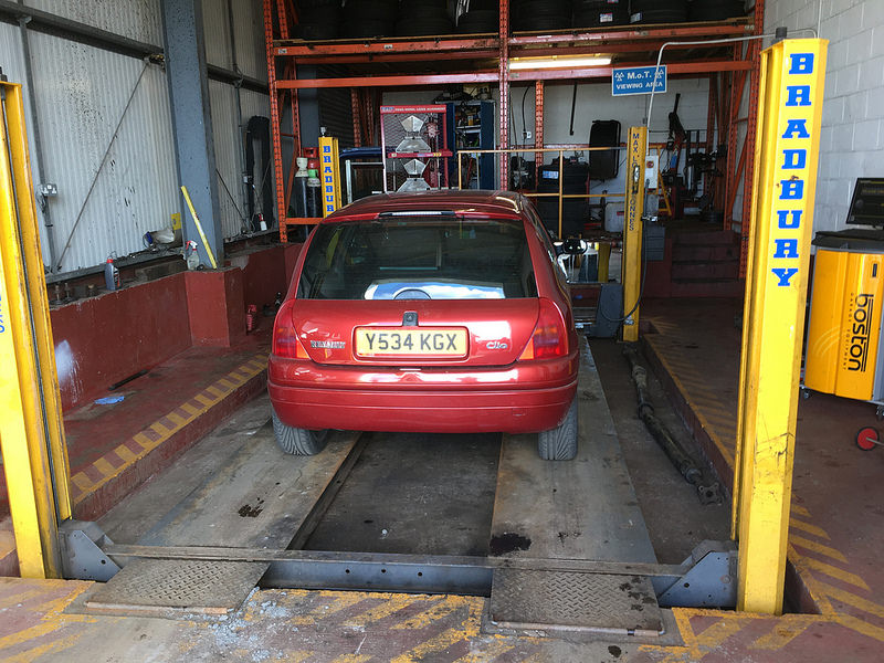

Took it along for its MOT which it passed with flying colours, which made me very happy as about the only thing I've not had off this is the rear axle!

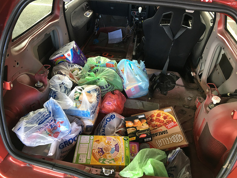

And then on the way home I had to pick up a click and collect order from Tesco, perfect daily/family racecar! (The harness will be getting adjusted, just wanted it good enough to MOT!)

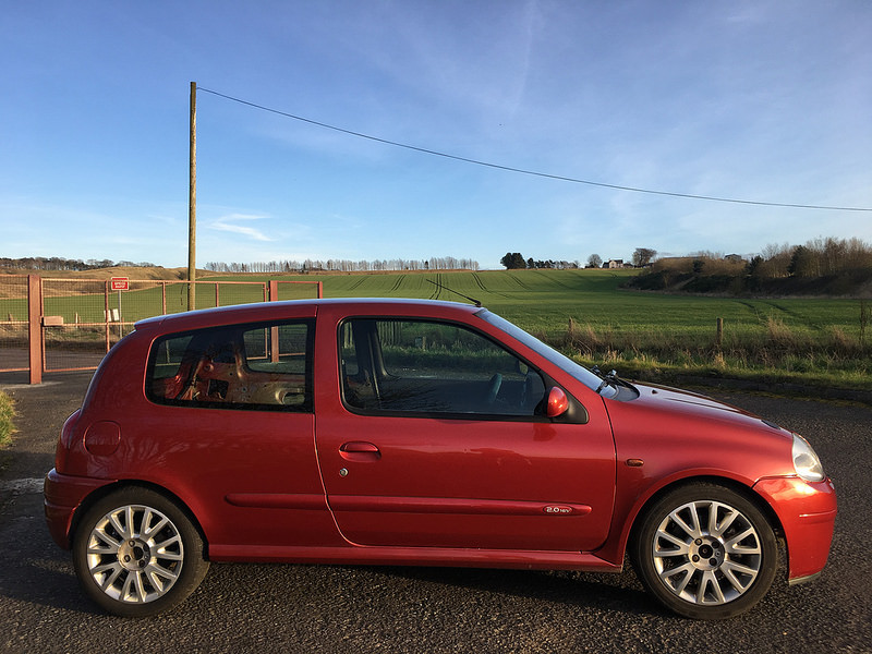

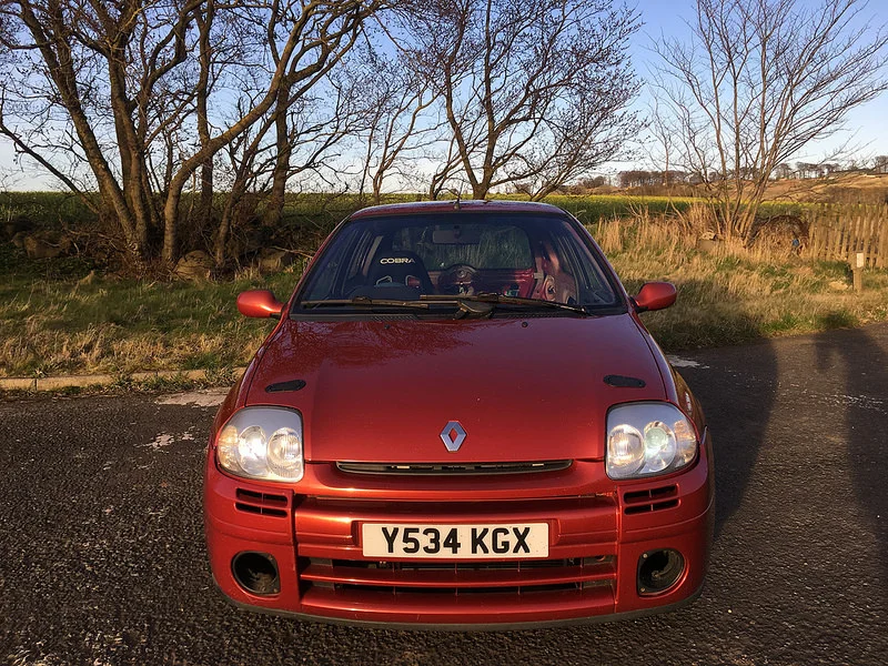

Went out for a 20 mile blast last night to make sure everythings working alright, tweaked the konis and that improved things a lot, proper sized wheels and tyres will be good too! Needs a new thermostat and the speedo sensor played up but only once and briefly. Other than that its going very nicely, even stopped for some shoddy pics with its awful wheels and tyre combo!

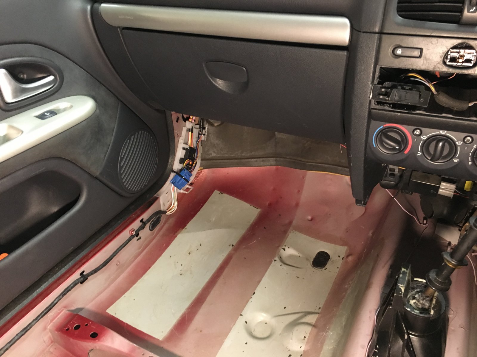

But after a particularly shitty day yesterday I forced myself into the garage with a 4 pack and a need to some pottering. Got the new thermostat on, throttle cable lubed, camber bolts on and interior wiring tidied up.
Should've taken more pics but wasn't thinking about it, only got this one that I sent to Dave.
Fair bit neater than it was. I'll remove the dash at some point to sort wiring and get rid of the insulation but not before this track day.
