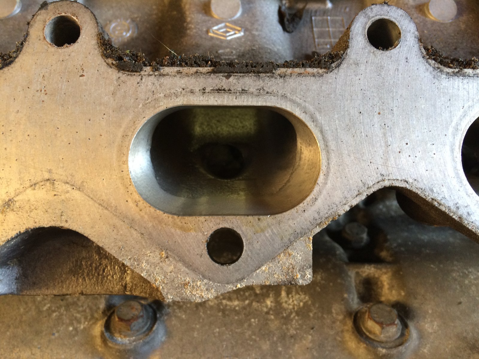

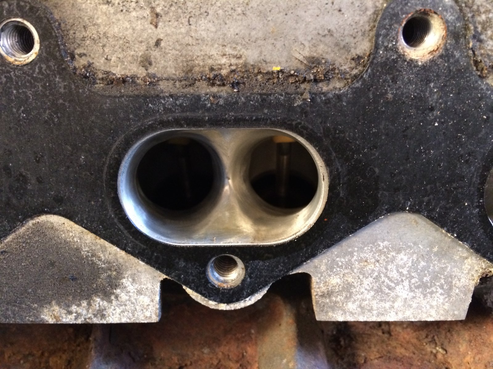

Needed to get out the house for a bit last night so went to the garage and pottered. Not a massive fan of the painted inlet that's flaking and since I've another 3 sets of inlets I thought I'd see which ones where matched best. Long story short, the ones that were on it! Did give me a chance to check the spark plugs where still torqued up at least, don't want a repeat.
Wee bonus though, I'm 99% sure that the head has been ported and polished at some point, we thought it maybe had been but had never looked!
And the lower inlet too
So that explains why it goes so well! Once I get a decent exhaust I'll head off to EFI then that'll do for power.

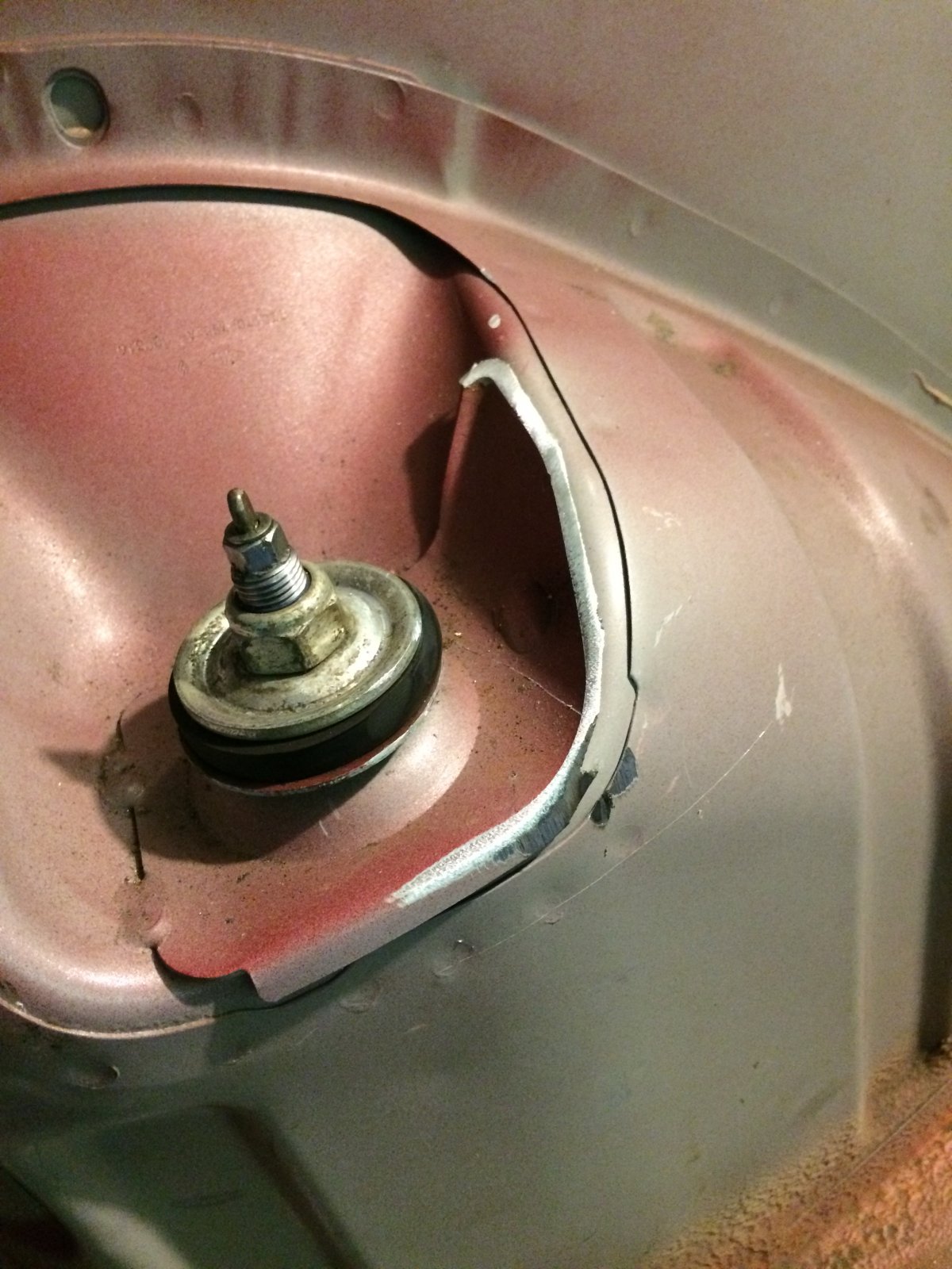

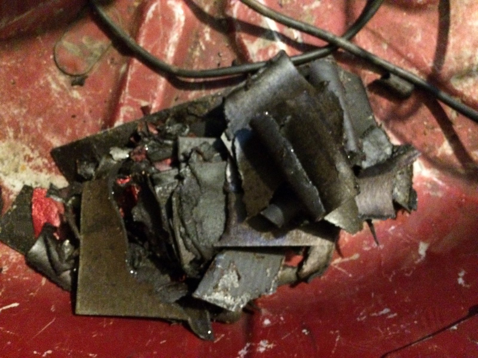

It's been a properly miserable day up here today and having been in the house with the wife and child all day I was beginning to go a bit mental. There's only so many danger wanks a man of my age can manage in a day.
So I escaped to the garage for 40 minutes and hope to get back out again after dinner. Took off the last of the tar inside and removed the rear seat bracket. That took a bit of care and attention to try to not make it look completely s**t.
Really interesting eh? I know it'll make no performance difference but it'll look loads neater when it all gets painted.

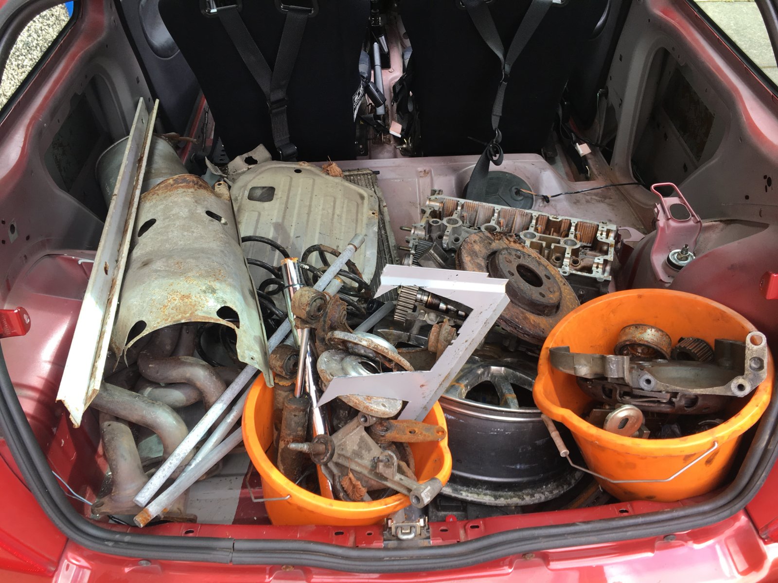

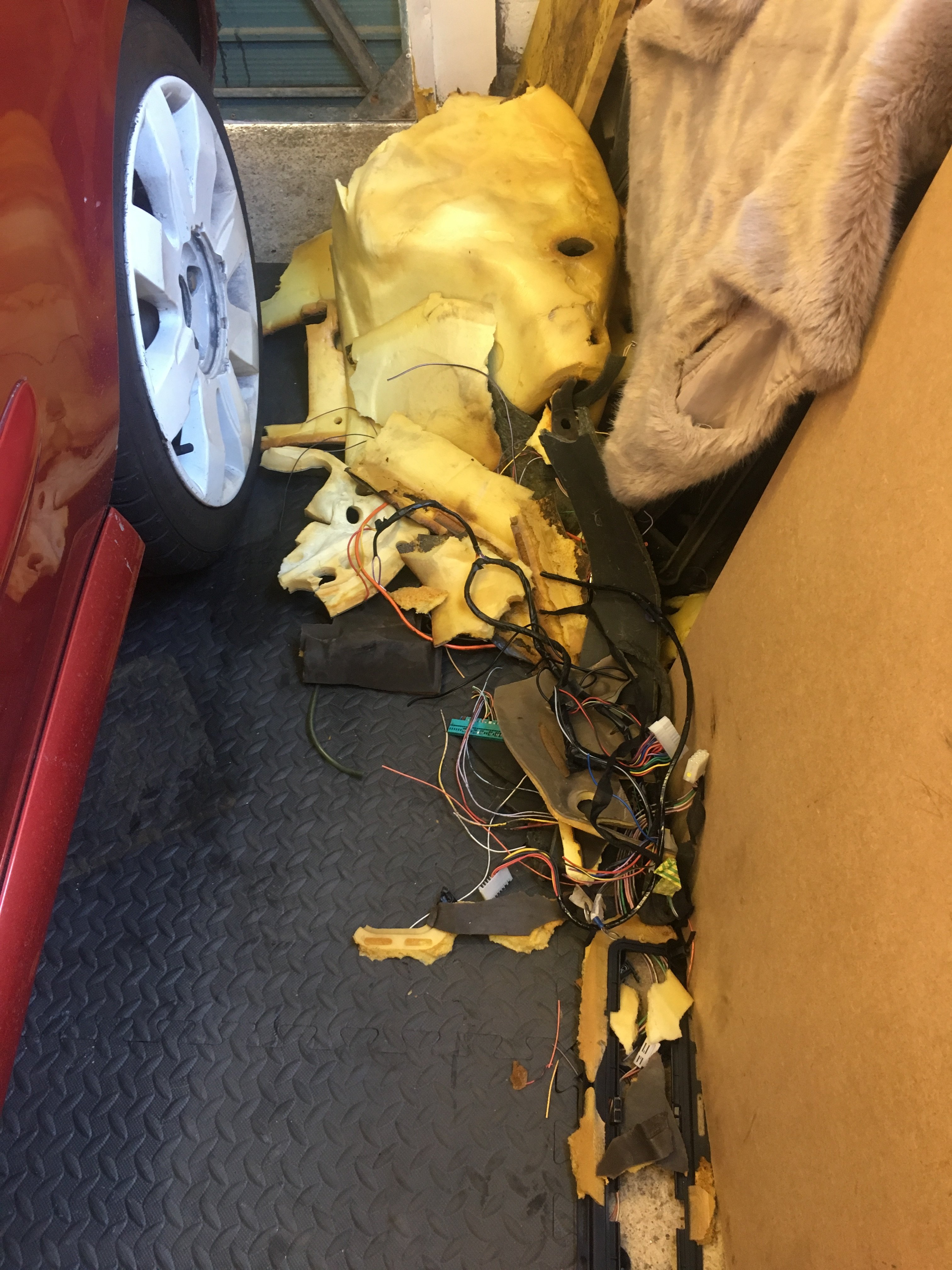

Worryingly little has happened recently, barely even driven it tbh but motivated to get on with some things again. Today was mostly about clearing all the scrap I've collected and all the other various shite that seems to gather.
It's a practical track car at least
and finally the back was at a decent height, all I need to do is carry 190kg in the boot at all times!
Turns out it's down at 960kg with a full to the brim tank so that seems ok given it's been a half arsed attempt to strip it. Still got the sound deadening behind the full dash, the front door cards, all glass, all metal body parts still and 16" wheels.

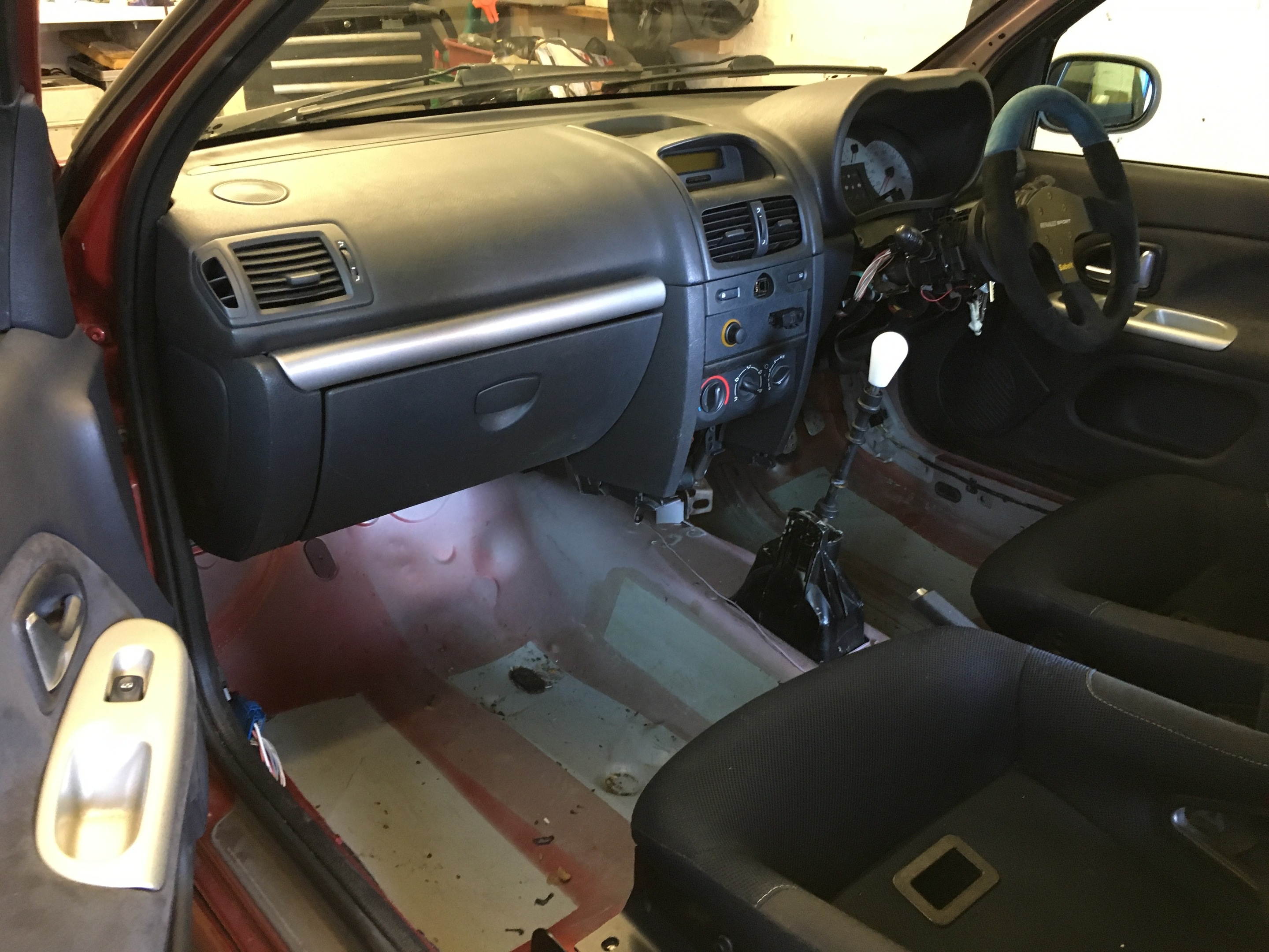

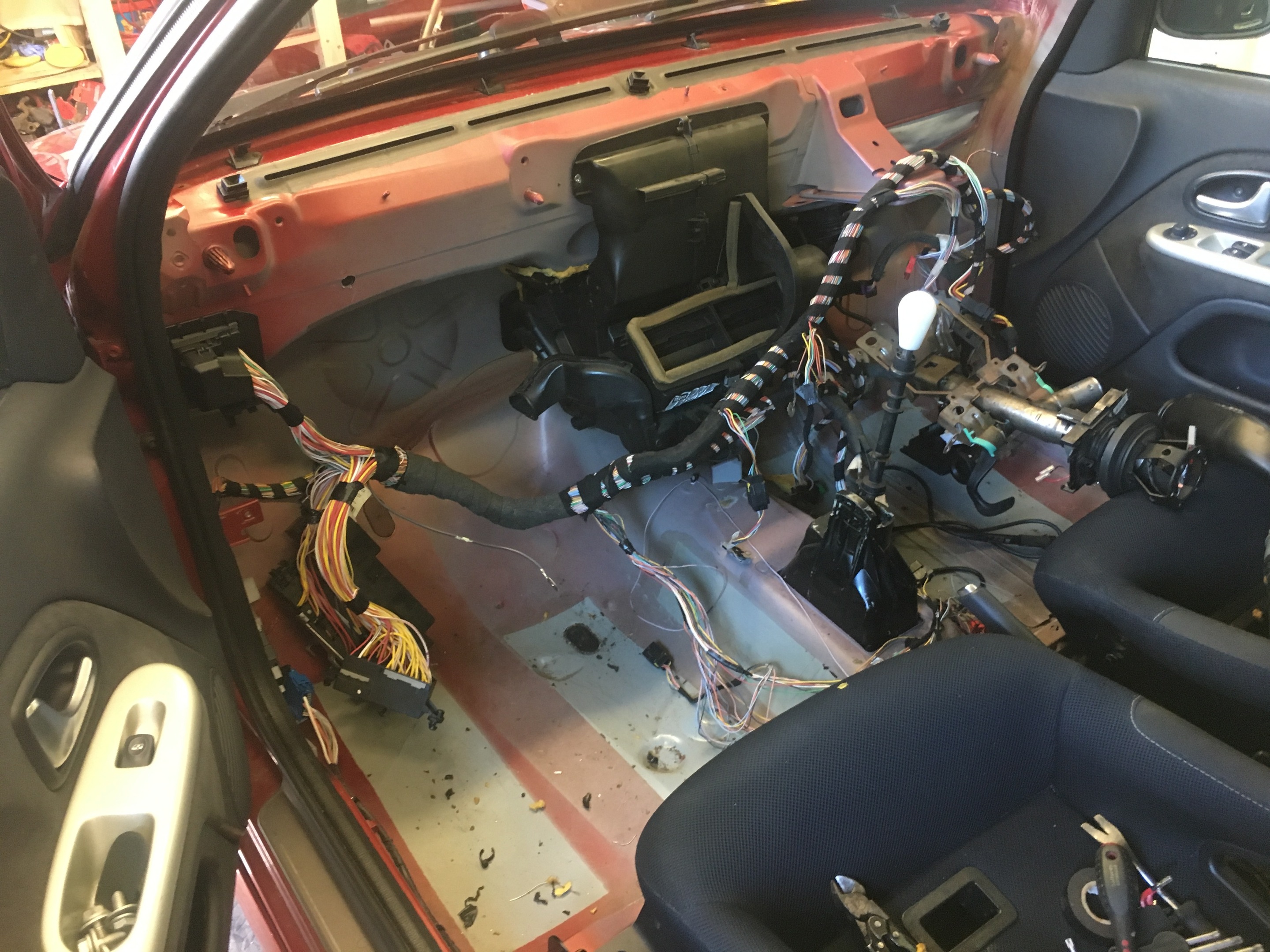

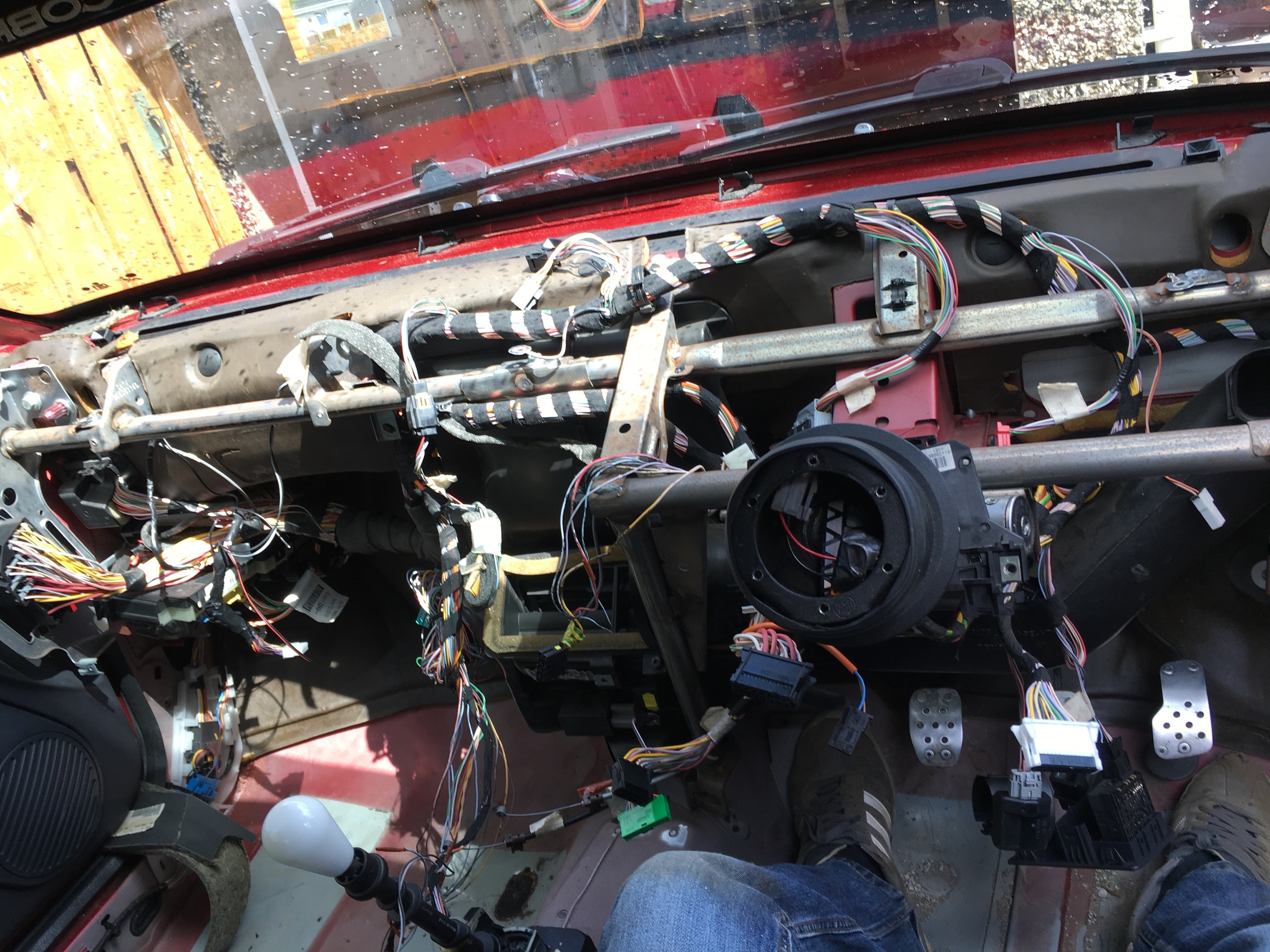

Bit more pissing about today. Fitted a ktec stealth the other night (big thanks to @Djw Dave for drilling out the centre mount bolt..) and today decided to get rid of the sound deadening from behind the dash since you could see it and it was annoying me.
Only 5kg saved including a decent amount of wiring that I removed but it was more about neatness, I'll never notice any speed difference with that!
Couple of pics to keep @Dr Jekyll happy.

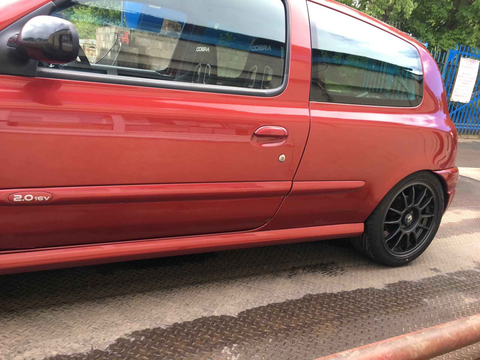

Yes I'm aware that the wheels look utter w**k on this but they'll only be used if it's wet and I don't want to wreck my suoerleggeras. It's weird cos they look quite good on the rb.

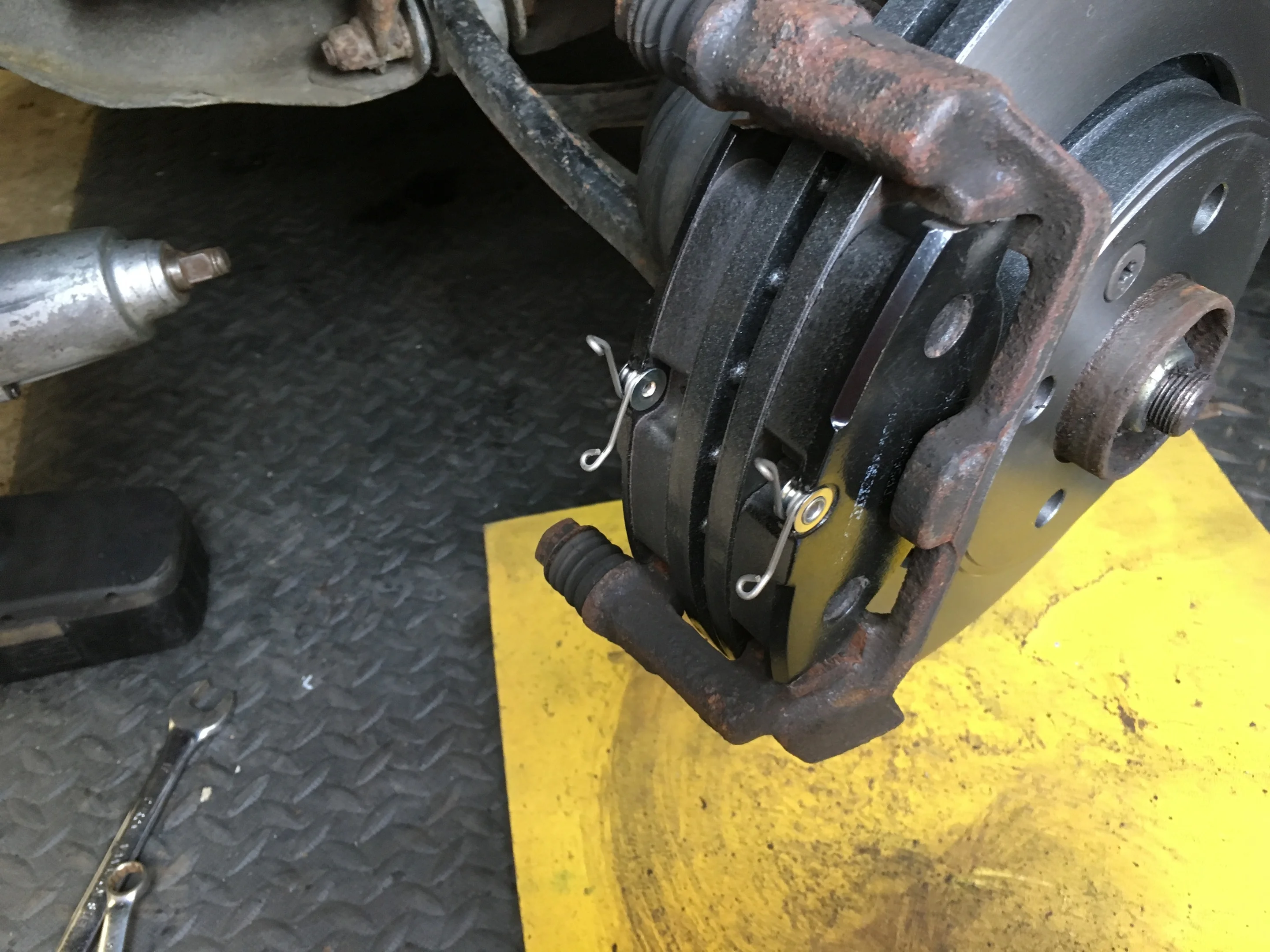

Well last night went pretty damn well, was dry for the first hour and a half and then the rain came heavier and heavier in the last half hour. When I knew my tyres were fully bald so just went out for fun, was quite impressed with how much grip it still had though.
I wasn't sure about the DS1.11 at first, the initial bite is awesome but then it felt like it was slowing me down as much as I expected. Then I was following @Djw Dave who was on DS2500 and pushing them as hard as possible and I was just tickling my brakes. Realised it was more because I didn't have a point of reference really, turns out they're mega. And couldn't get them to fade either.

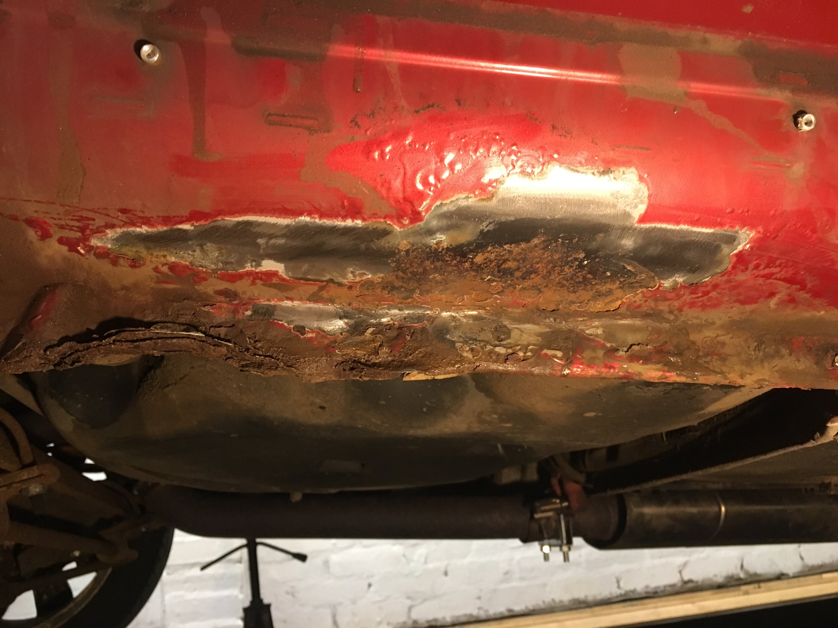

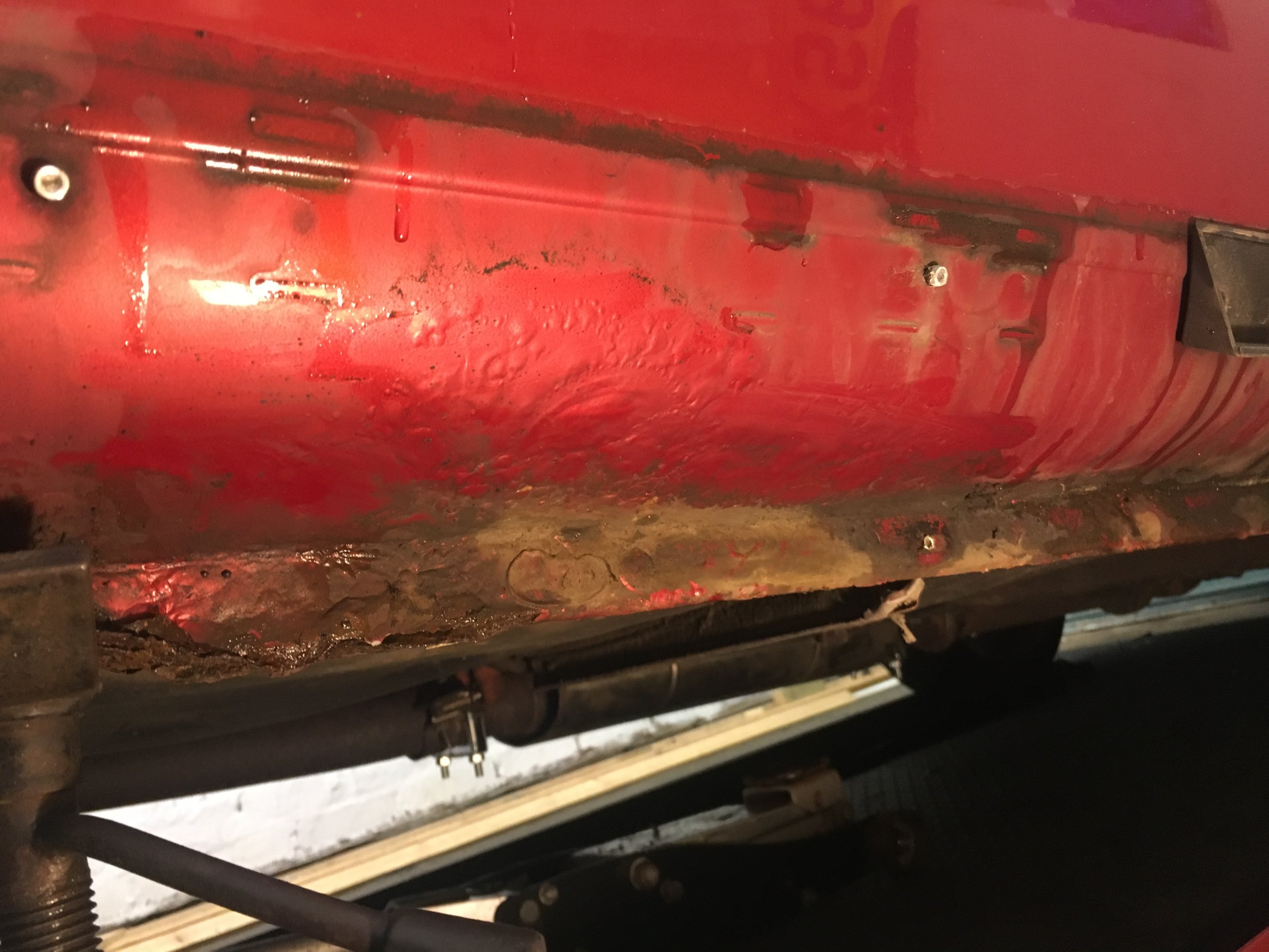

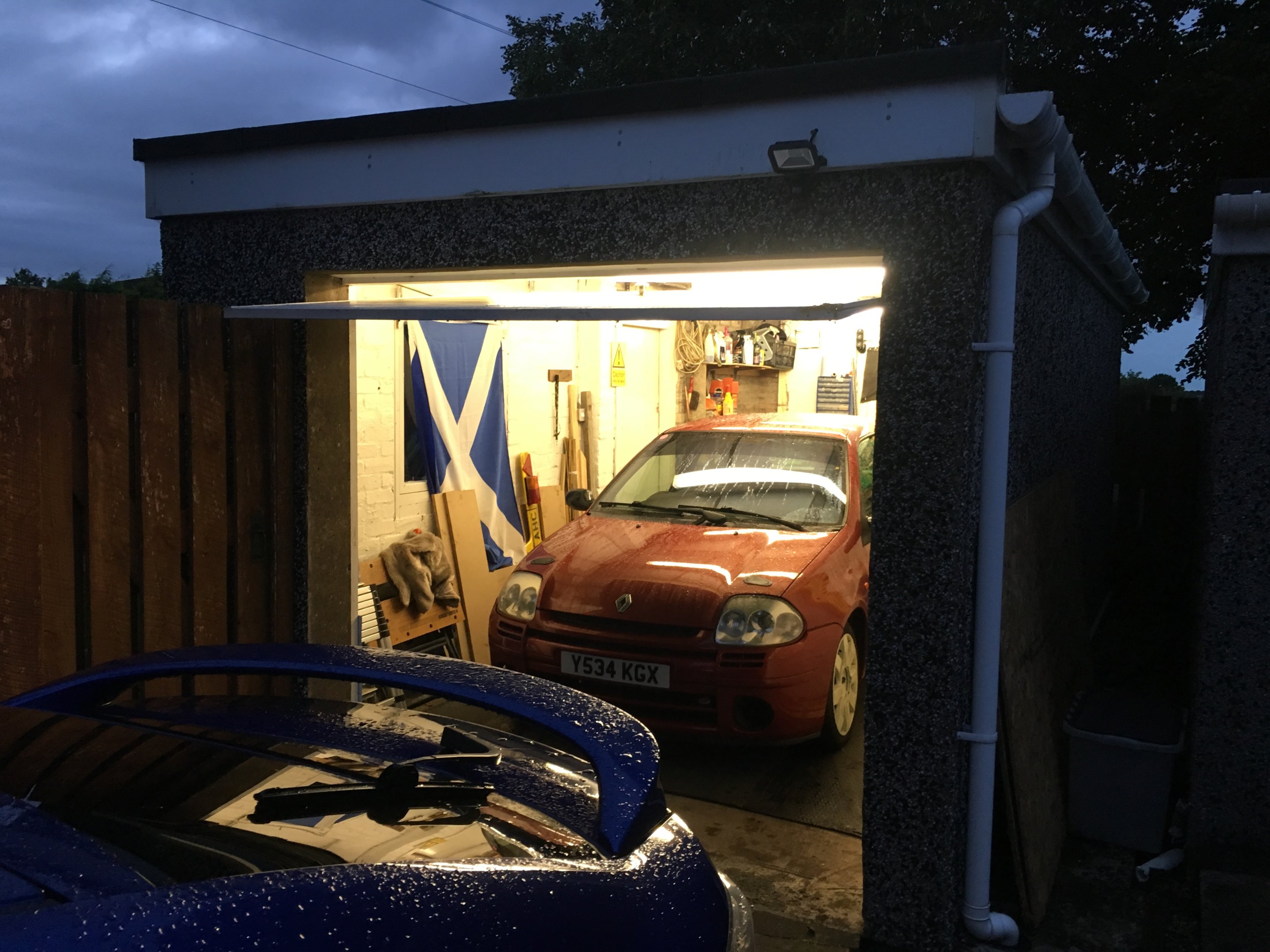

Fixed the garage door temporarily for now and got the flamer back into the garage and popped the skirts off.
Not too bad.
And with 2 minutes and a flap disc it shows this is the worst bit.
Not holed so I think it'll get some treatment, a layer or 2 of paint and the skirts out back on. It's good enough for a track car I reckon. Will need to investigate further tomorrow but I don't use power tools in the garage after 9 if I can help it.
I know if I look further I'll find more but why the f**k would I do that?!
