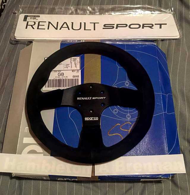

It's my birthday today and I've been very spoilt. Alex has officially earned the number 1 girlfriend award I think...

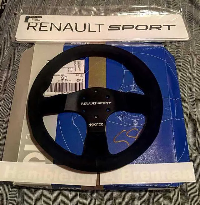

New Renaultsport Sparco wheel, show plates and name stickers for our windows!

Happy birthday! That wheel looks awesome. I love closed flat wheels. I've had one for a while but the suede got messed up :(
Do you know where I can find that wheel?

Thankyou, she got it from RPD - here

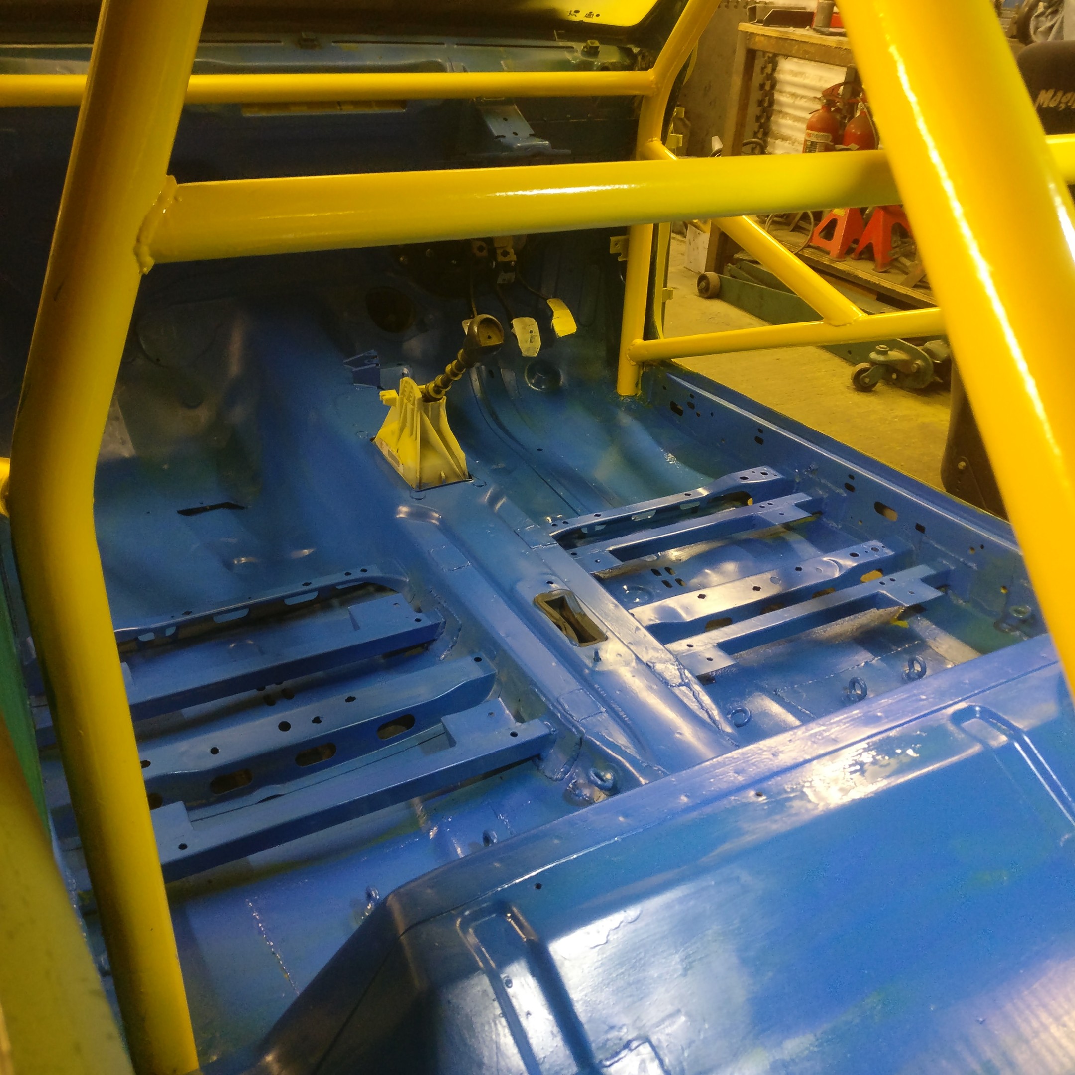

Sanded down all the rollcage today with some fine grit sandpaper to remove some runs and get the surface even again. We've decided we're going to do the final couple of coats with rattle cans as they're easy to work with and although the brush was working for us, they will allow us to get a perfect smooth finish for the final result.

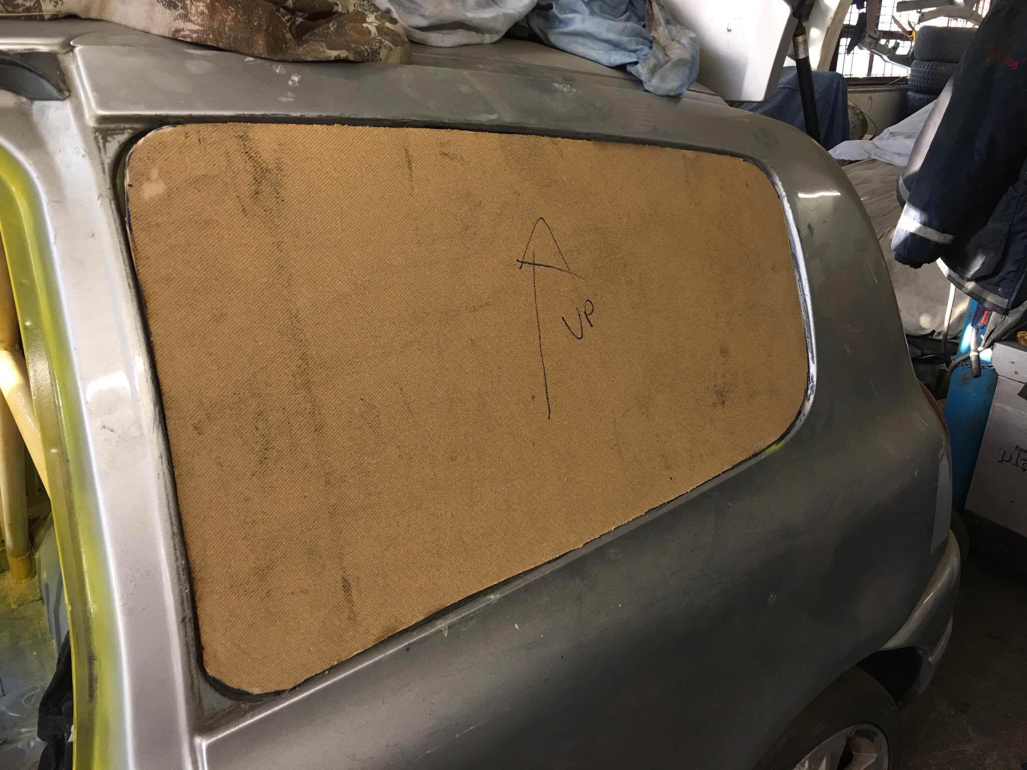

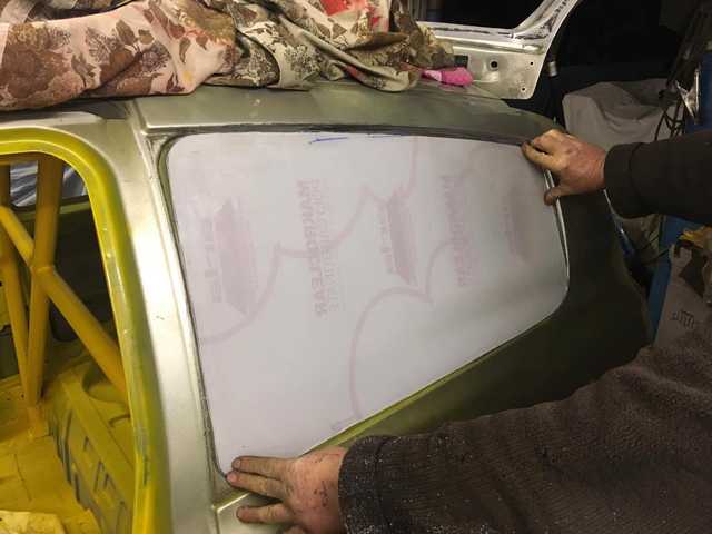

Once we'd done that we made a start on making some polycarb windows.
I drew around the original glass window onto some hardboard and cut it out roughly to shape. We then fine tuned it until we got the perfect fit. The picture below shows the hardboard a few cuts before it was perfect.
Once I made the template out of the hardboard, I found some 5mm Polycarbonate laying around... (as you do 😂) and then traced 2 of them out for each of the rear windows. Using 5mm as it's the only thickness we've got and it exceeds the MSA regulations and also meets the FIA regulations.
Need to find our Jigsaw to cut the polycarb now, then we can fine tune the fitment and get them ready to be fitted up after the inside has been sprayed. After we've made the two rear windows we can move onto the front ones and creating the sliders, then the boot... which will be fun:neutral:

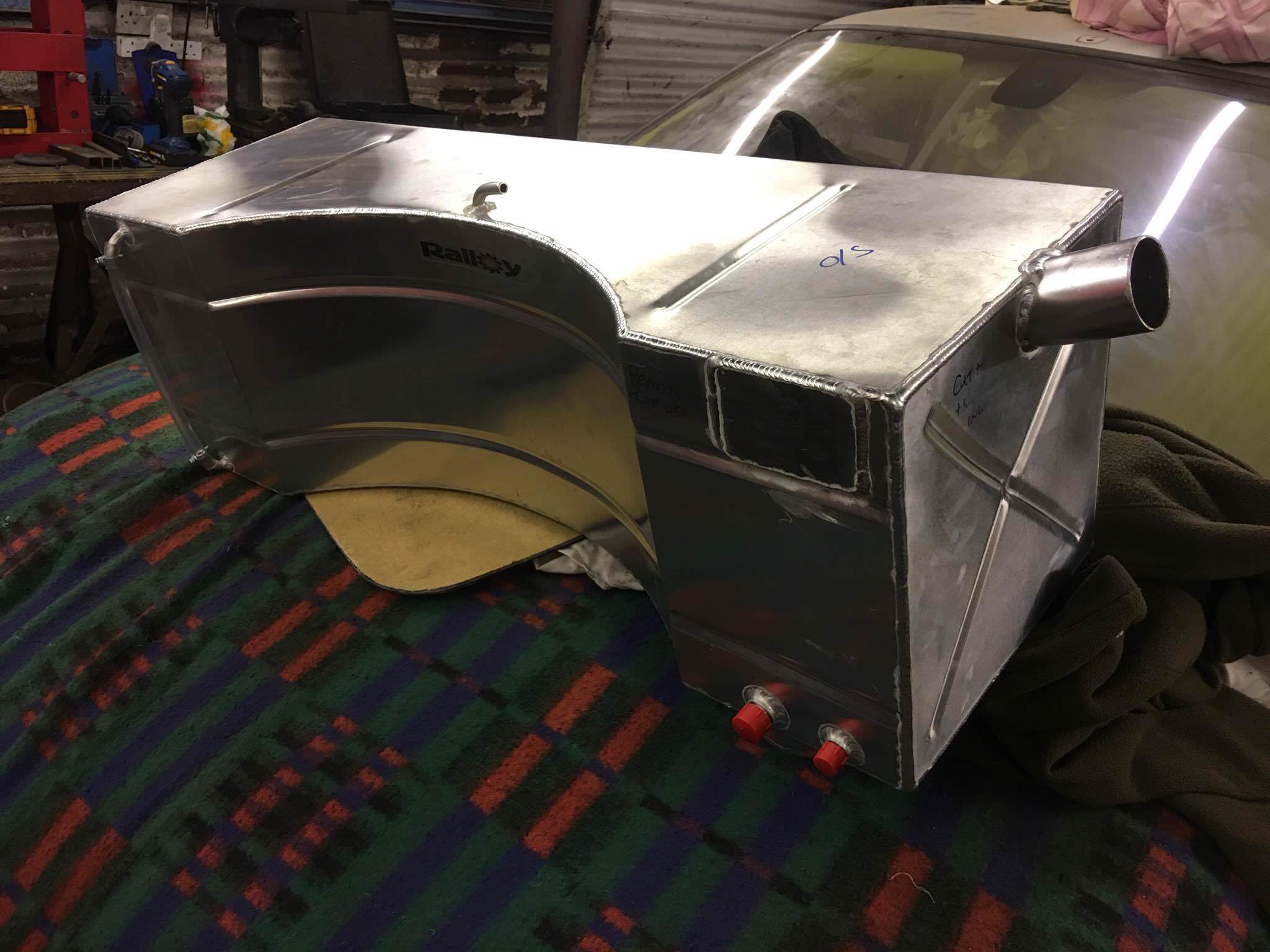

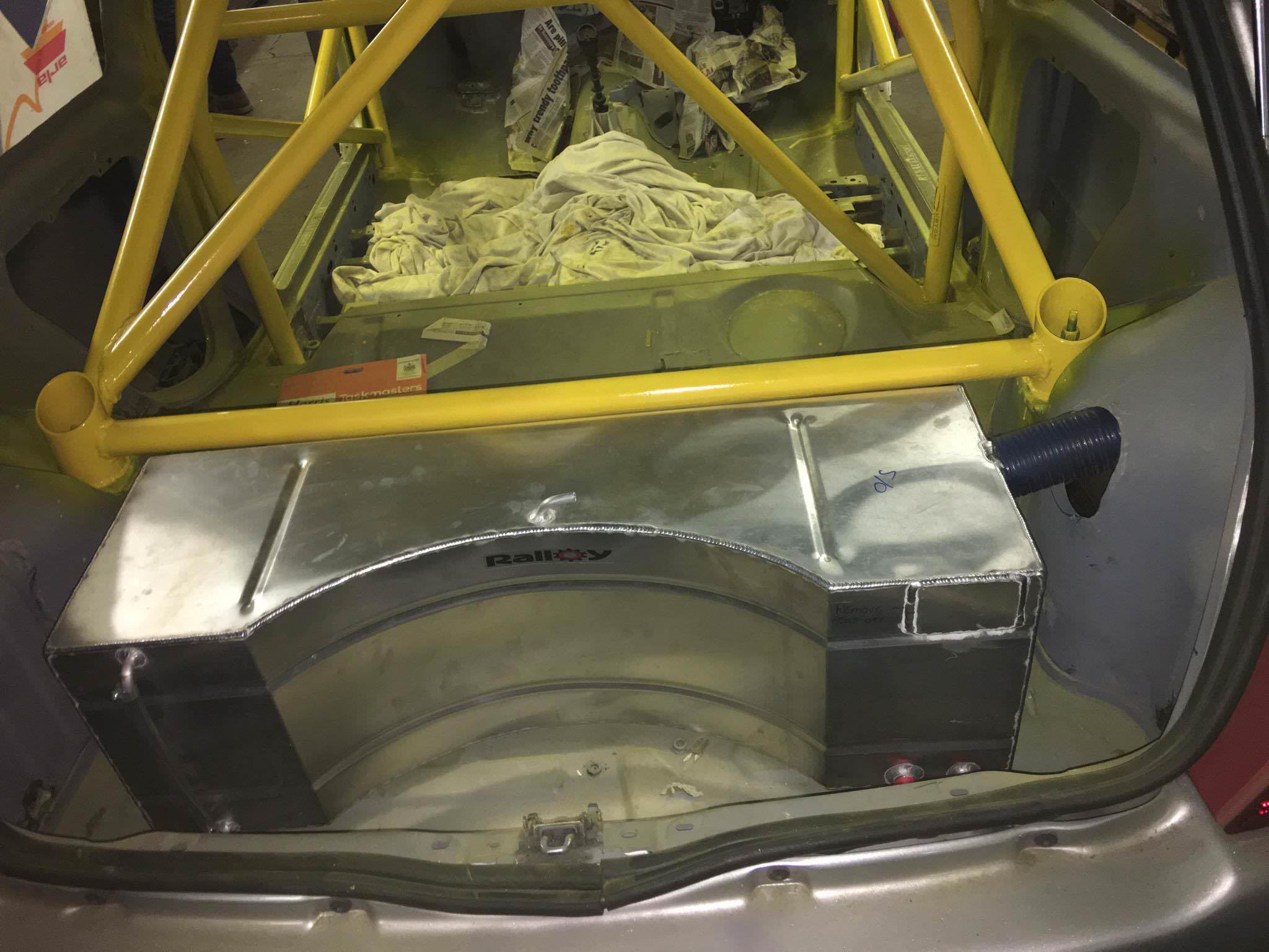

Got the fuel tank back from being welded today and it looks really neat! Filler is now on the side as we wanted it and the previous location blanked off with a plate - neatly TIG welded on.
Quick test fit to make sure the filler pipe still fits to the new filler now that the neck has been welded on. It does!

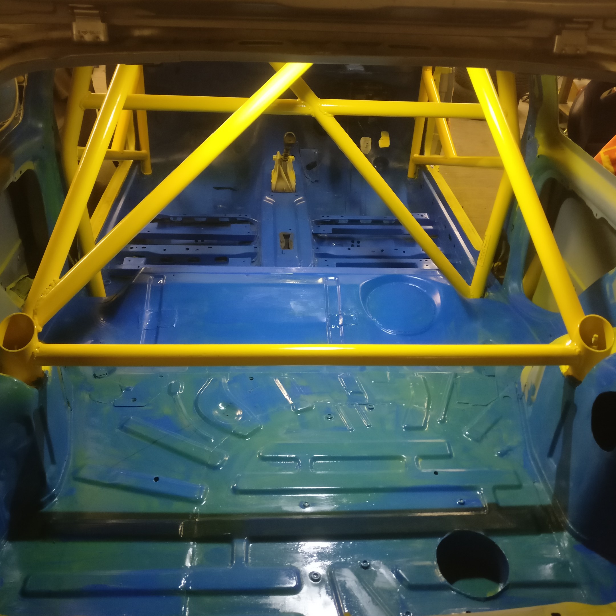

Bought some rattle cans from our local paint shop for a fraction of the price from Halfrauds and gave the cage a good going over with them. Looks almost fluorescent with all the light shining on it 😂 Looks grim on the picture but nothing like the colour irl. At least it's getting to the point where it's block colour now and not really thin.
Couple more coats then it'll be done.

My one query is the fuel tank. I get that it's a bit lighter but it's now higher up and behind the axle rather than in between. Won't that affect the handling?

Yeah you're right it's quite a lot lighter than the original as you say but it's also higher and slightly further back too. I guess we just had to make a compromise tbh. We tried putting it in the centre of the car originally but couldn't get the right angles for the filler, which is unfortunate as it would have been better protected also in case of an impact and distributed the weight more evenly like you said. I'm hoping it doesn't affect the handling drastically as realistically it's only ever going to be half full and the tank is baffled anyway so it shouldn't swish around enough to make it noticeable. I suppose there's a possible handling benefit that it's added some weight back to the rear now that everything is stripped for better distribution :tonguewink: Will have to just see how it handles and change the setup if it's bad.

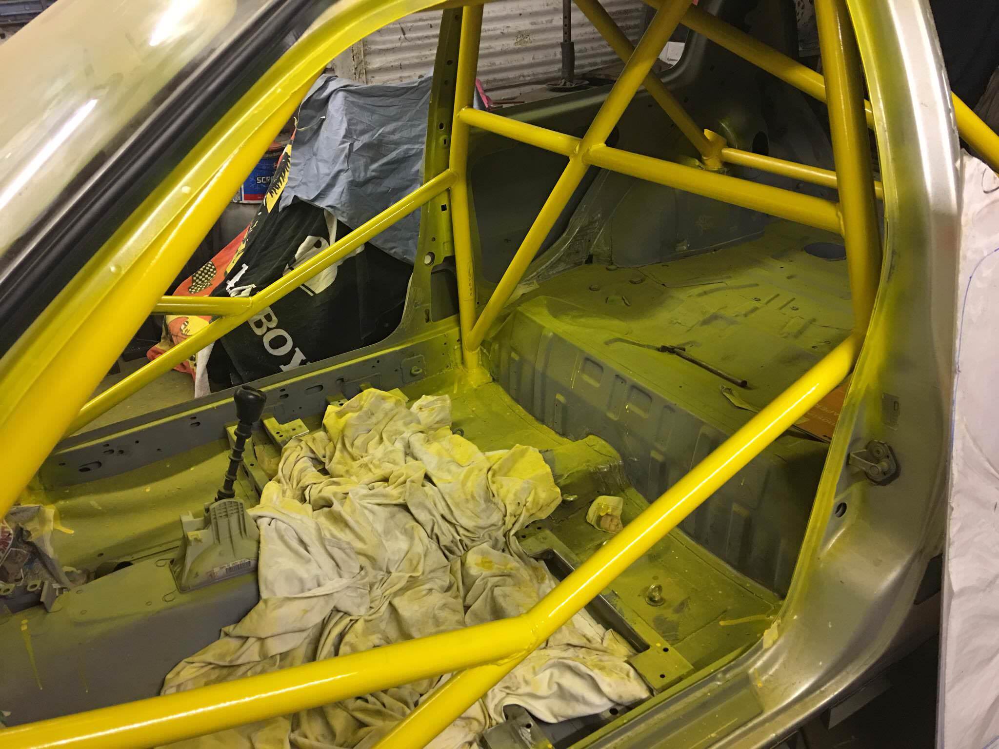

So we've now finished painting the rollcage at the weekend and it just needs laquering now which I may do tomorrow night after Uni. It looks really good - we chose a good colour imo now it's finished :tongueout:
While the paint was drying Sunday we dug out the jigsaw and cut out x2 rear windows from 5mm polycarbonate after drawing around our template.
Perfect fit :cool::smirk:

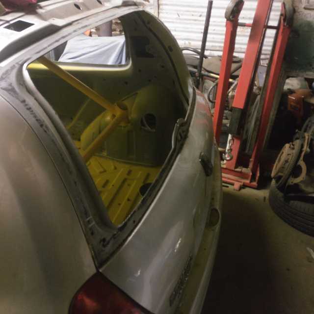

After we made those, we cut out the rear windscreen and studied the shape of the boot lid and had a think about how we'd go about making the polycarb replacement.
Our plan is to trim a bit of overhang in places on the boot where the glass sat previously - allowing us to make the polycarb a little flatter; meaning it'll be easier to make and fix down. Might make this tomorrow!

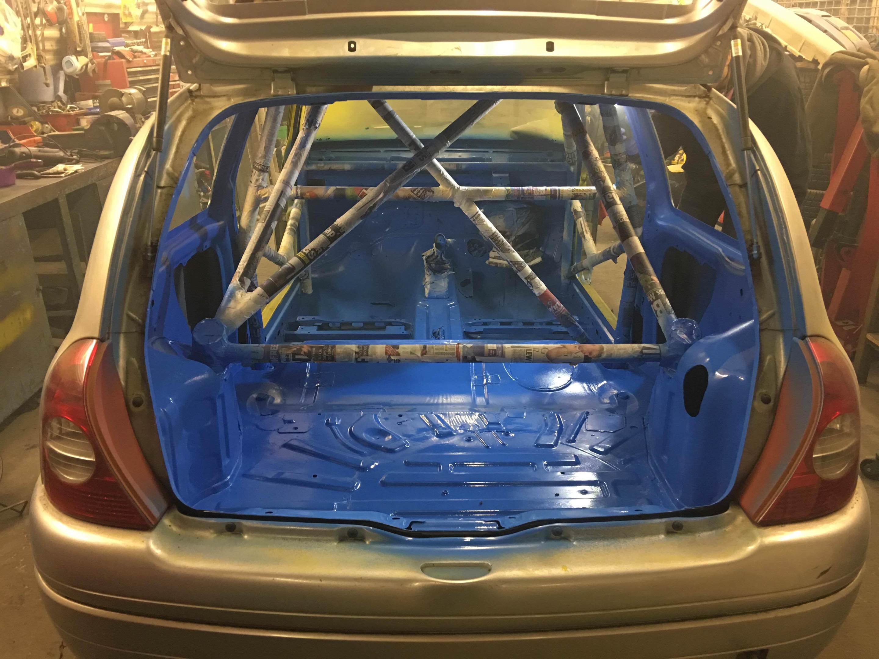

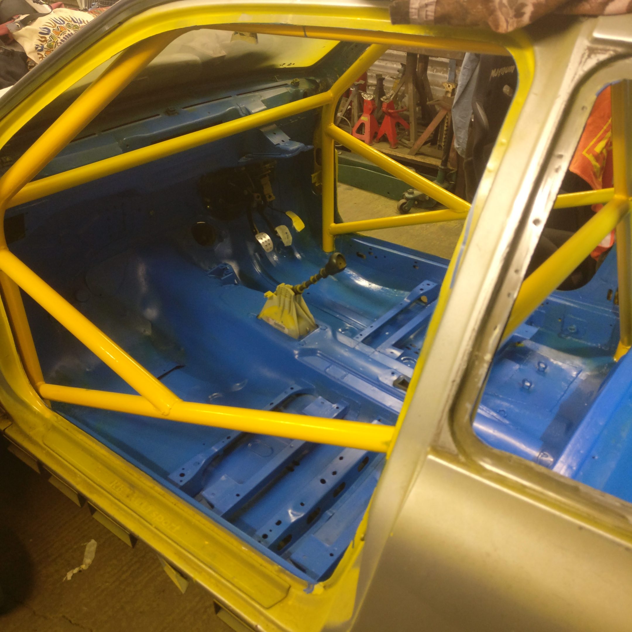

Started to paint the inside today in Racing Blue. We're painting all the awkward bits with a brush, so under and around seat rails, roof, around the cage, under the front bulkhead and footwells etc... Then once it's got a few good coats on it we can just blitz over it with the spray gun to give a good finish and laquer it.
We're really happy with the colour combo and it's gonna look stunning once it's all done!! The blue obviously isn't shiny as it hasn't been laquered yet but once it has all been painted and laquered it'll be perfection:hearteyes::hearteyes:
I'm hoping we can get the interior sprayed blue this weekend and then let it dry for a week ish.
Once it's all painted we've got the brake lines, fuel lines and wiring all to go at and then the main jobs on the car will be pretty much done dare I say it... Then it's just tinkering like fitting all the parts back on like driveshafts, exhaust, etc etc...

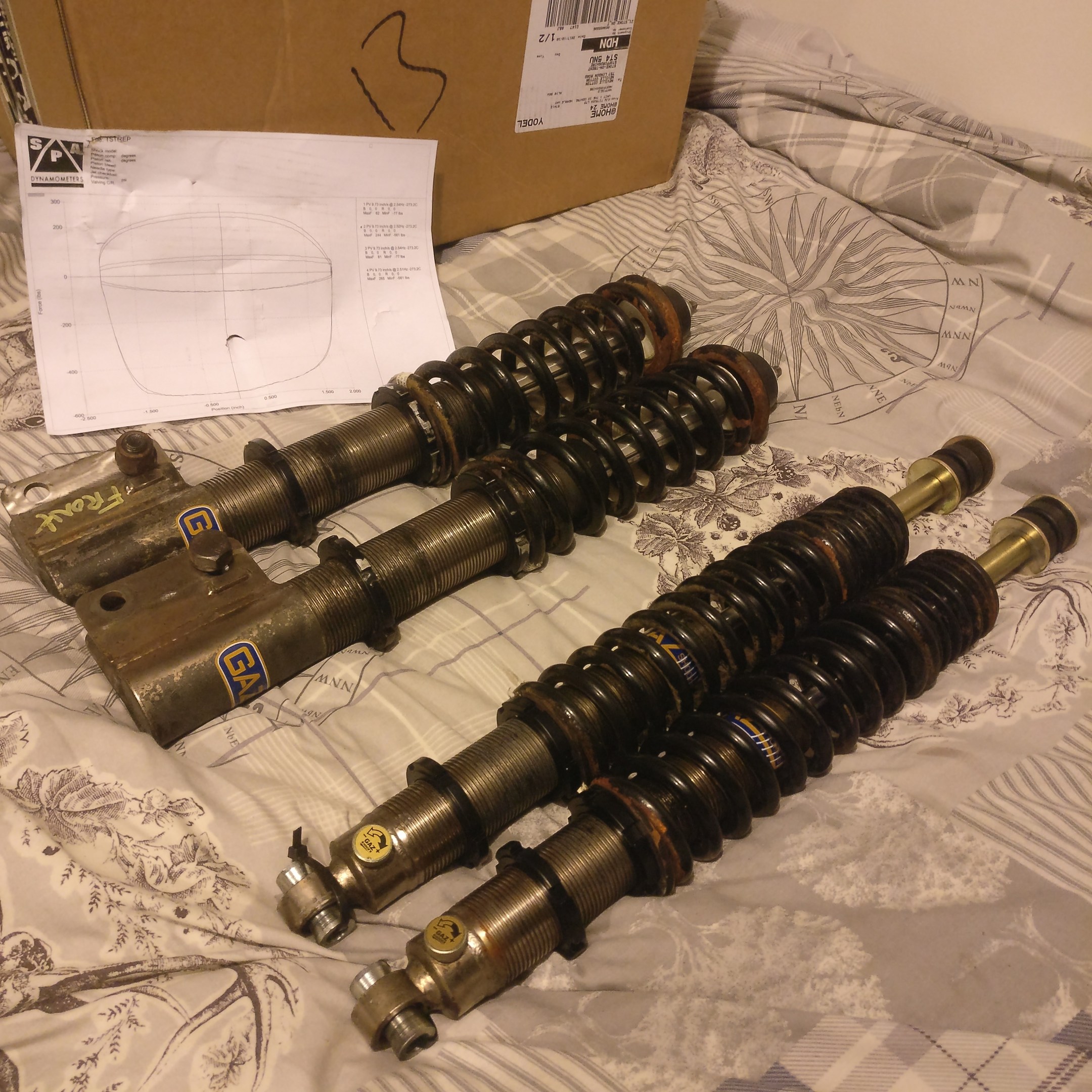

Also, I picked up our new coilovers last night all fresh back from being fully serviced/rebuilt with new parts all over.
Will probably get these fitted whilst the paint is drying after spraying the inside, as need to swap the hubs over for some 60mm ones to match the coilovers. Luckily we happen to have a set laying around :tongueclosed:
Gaz Gold - 1 way adjustable damping & height adjustable:
  • 450 lb front springs.
  • 350 lb rear springs.
Think these spring rates will be a good starting point for us, not too stiff so that we can't use it on the odd rally stage if we want and not too soft for track imo.

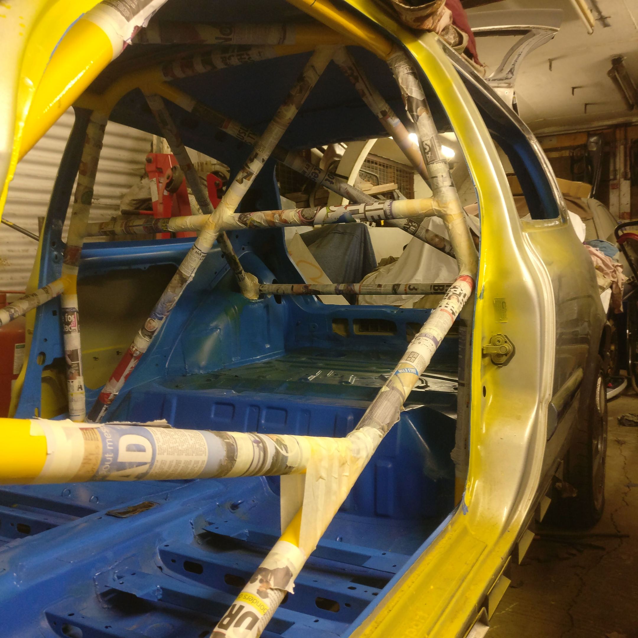

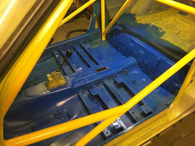

Forgot to update yesterday...So the following was completed yesterday. Didn't do a lot but it was very time consuming what I did do.
I brush painted the entire inside so now everywhere is blue! It needs spraying another coat on top now to obtain the correct shade of blue as this will be the final coat before lacquering.

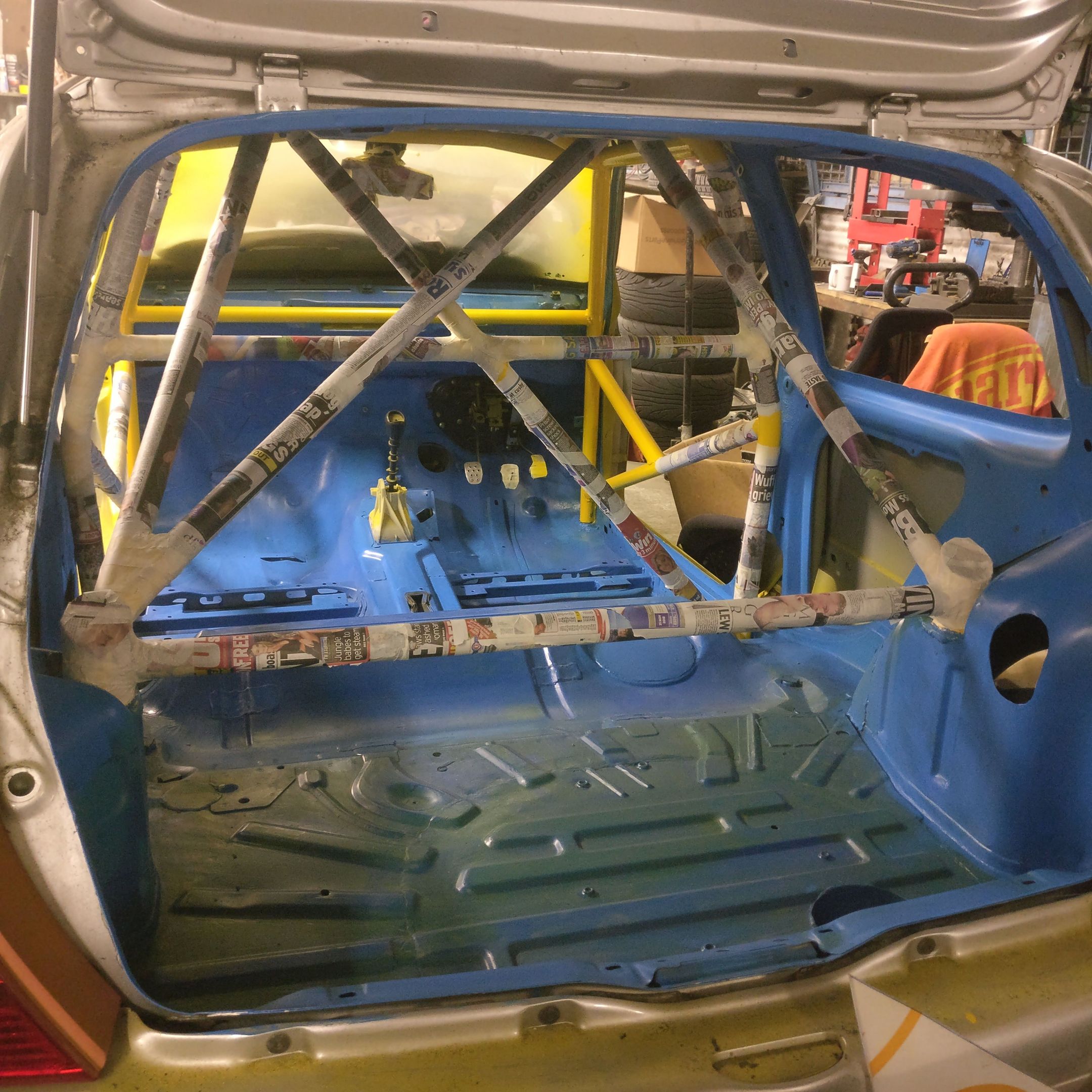

After painting the inside which took hours to carefully get in every crevice behind the cage and roof - I begun to mask up the roll-cage really tight so it didn't blow around in the air from the spray gun. Until I ran out of masking tape...😂
Need to get this finished tomorrow night so we can crack on with getting the car up and running.

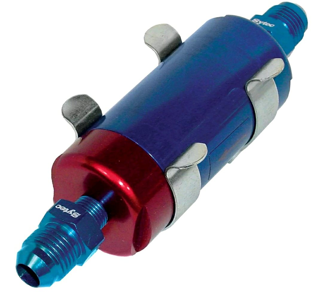

Yesterday, we bought an in-line fuel pump and filter so we can start stockpiling bits to get the fuel lines plumbed in. Once these arrive I'll inspect the fittings that come with them and then work out what other fittings we'll need to fix to the fuel tank, rail, pump etc...£££ :confounded: - also need to measure up how much fuel line is needed and order that.
http://www.ebay.co.uk/itm/APS-Exter...e=STRK:MEBIDX:IT&_trksid=p2057872.m2749.l2649
http://www.ebay.co.uk/itm/Sytec-Rac...e=STRK:MEBIDX:IT&_trksid=p2057872.m2749.l2649

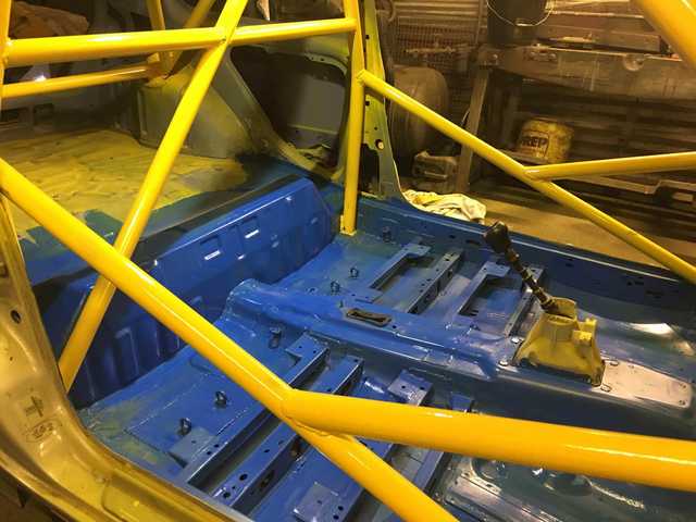

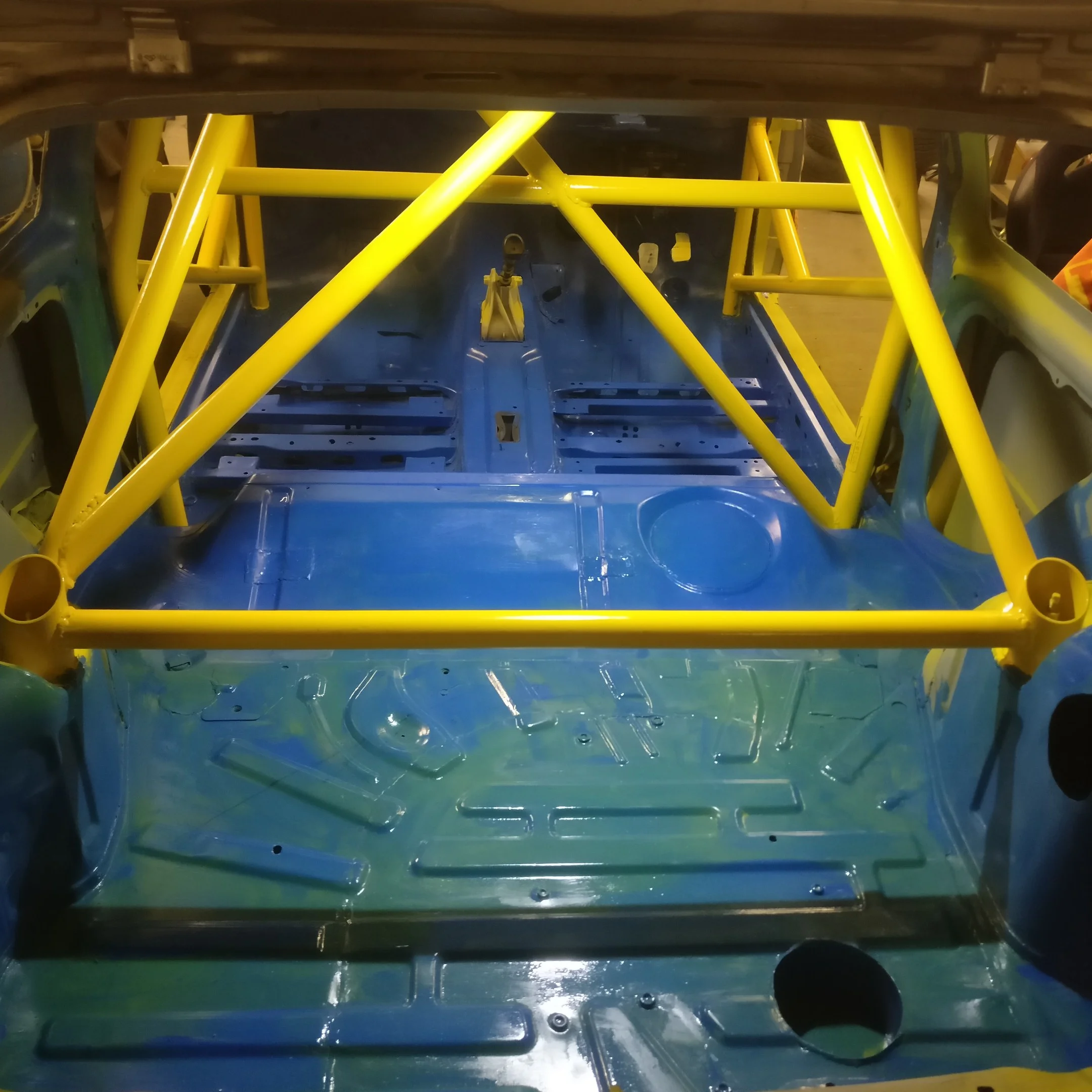

Also today, Alex got her dad to spray us the inside of the car. As previously mentioned we've only sprayed the rear areas and roof of the car because we'll be getting in and out of the car loads when doing the fuel & brake lines and wiring - we'll end up ruining it. So gonna get that all planned out and then spray it after it's sorted so it's perfect. Needs another coat in a couple of places to make it perfect, so it's back off to the paint shop to get some more racing blue lol.
Looks absolutely mint!:hearteyes: Picture makes it look really dark due to the lighting being so dark, but it's a lot lighter in person and will get even glossier when it's lacquered.
Will spray the areas that need doing again and then get lining all the fuel tank up, then the wiring and then get the car started for the first time in god knows how many years!!

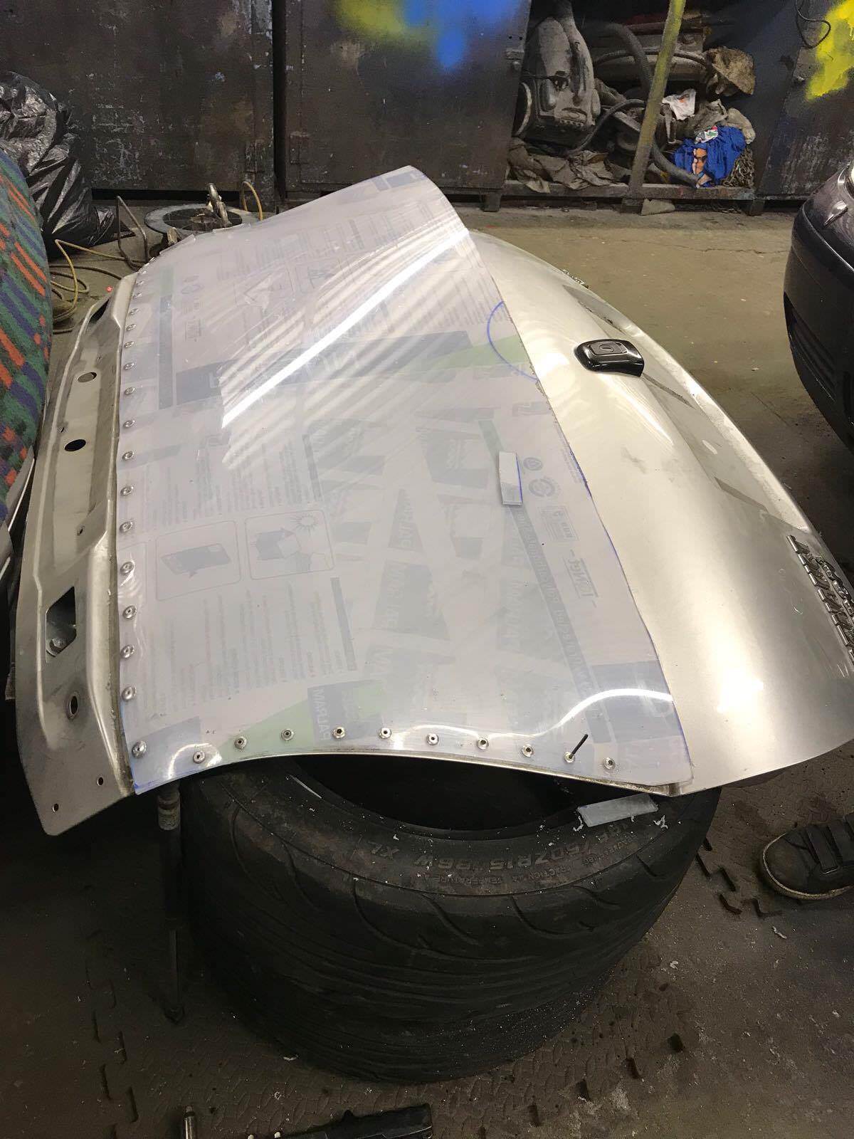

Yesterday, we begun making the rear windscreen out of polycarb. What a job that's turning out to be 😂 It's so awkward as it curves in so many directions but we've cracked it.
The current plan is rivet it down so it takes the shape, then trim the excess edges off. We got a basic shape before starting this by bending the polycarb to the glass we took out and drawing roughly around it. It wont look as neat as some cars but at the end of the day it's a track car and it's serving its purpose.
