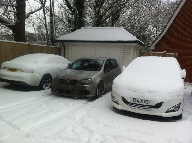

Keep thinking the same about the Panzer over a Z4MC. But then I go out in a friend's classic (soft top) and realise Winter driving with the roof down is the only way to roll. In your case "Riding through the snow, with a full lock slide going on, la la la la laaaa, la la la la laaaaaa".
Looks lovely. THAT NOISE.. Shame about the mechatronic issue.
That's not a standard bumper is it?? If so then can't believe I've never noticed those flares before..

My thoughts exactly, although on the other hand I'd enjoy the Golf more over winter I think.
Mine was very good in the snow, although even with the Haldex Controller in race, i found that you had to be really brutal to do doughnuts/drift, would always understeer quite a bit before getting sideways.
