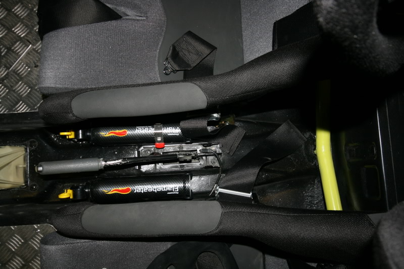

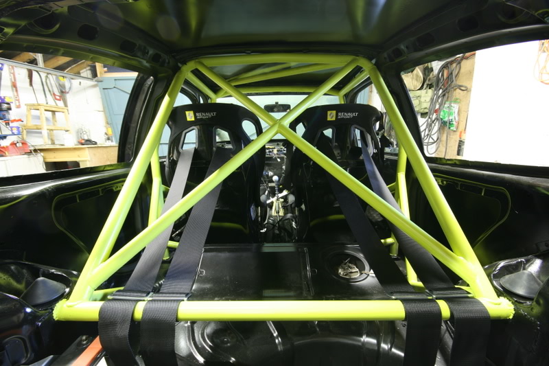

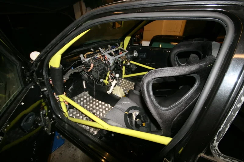

Ben, are you leaving the harness tapes like the above picture. It's just I'm sure that if you were to loop under the bar behind the seat and then to the rear bar it would hold you more securley. Heaven forbid, if you rolled it, you wouldn't be held in your seat at the moment - you need to have the force pulling you down into the seat, not back into the seat. That's the way they do it in the race series.
  titanic killer
I always thought you didnt want to be pulled Down in the seat in a crash as it compresses your spine?not good
I maybe wrong thou
  C63 AMG, F430 & 172
yea it can cause damage if they pull down on you.
there 6 point so hopfully they will hold me in! loL

  Black-Gold 182
oh right. Learn something new every day.
Looking good though - the ph2 rear end is looking well nice. Really looking forward to seeing the lump after its all mounted- not gonna have much room under the bonnet!
Yep thats right its been said before
Where harnesses should be located.
http://www.cliosport.net/forum/showthread.php?t=224554
I maybe wrong thou
Your right

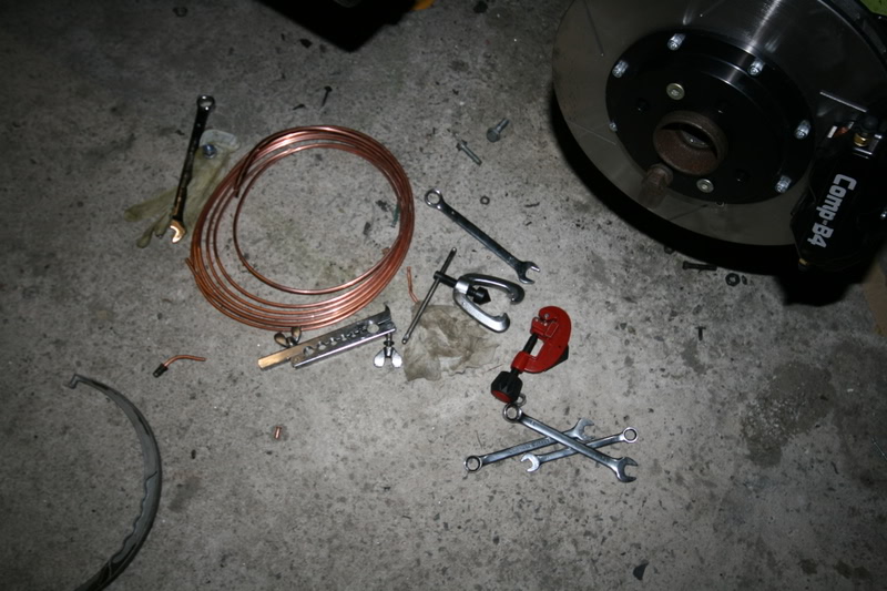

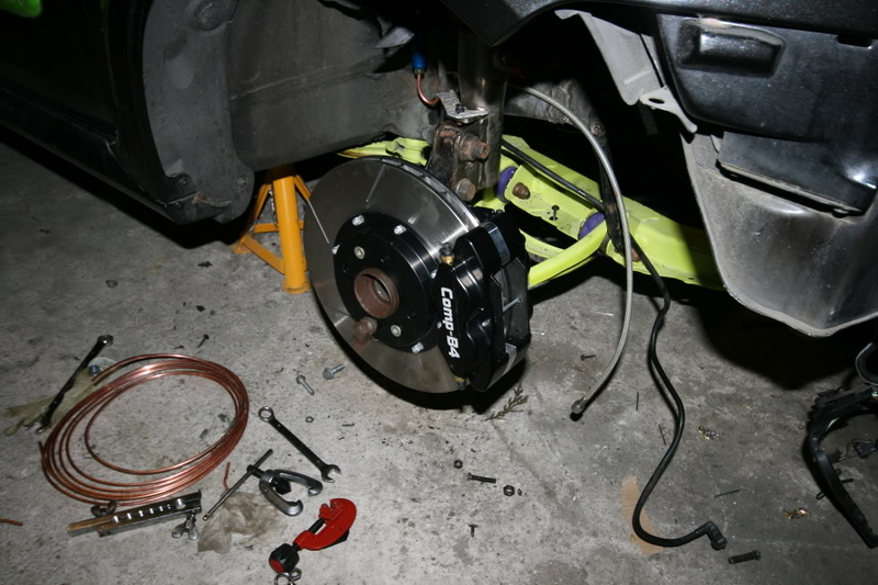

Work is mad busy so not much of a write up.
I managed to get the brakes fitted, put the rotors in the vice and torqued each nut and bolt (in star formation), then fitted the cap bolt from the calliper to the brackets.
First I fitted the rotors and bells on both sides and secured with the torx screws.
I chose to flare my stainless steel lines on with the unions I got with the kit. This would reduce the length of the free line after the bracket as I could fix them wherever.
so I had to re do the cooper pipe sections again!
Then bolted the calliper to the hub (100NM) and fitted the pads!
i will upload the rest of the calliper pics tonight as PB is cack!

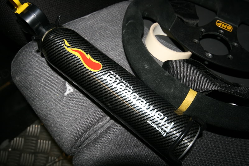

my two fire extingushers arrived
and then fitted them to the car, spaced them off the tunnel due to the heat!

you getting a proper extuingisher as well as the small ones? ive got one of those flamebeaters in my 106, and ive got another to go in the clio, but i will be fitting a proper one aswell just in case
