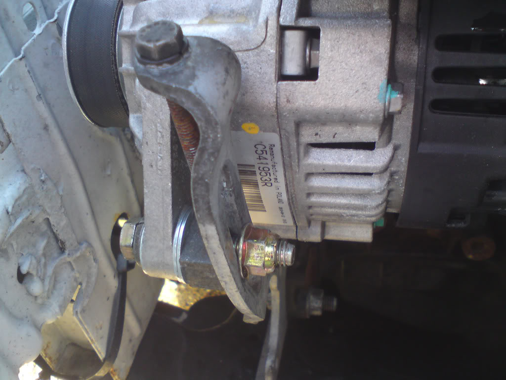

your alternator bracket is bolted to the wrong side of that part of the block, that's why it looks to be too far over
I did a little bit more research and Burp put the Tentioner bracket on the other side which would put it even more over to the left. Bit looks like its actually ok

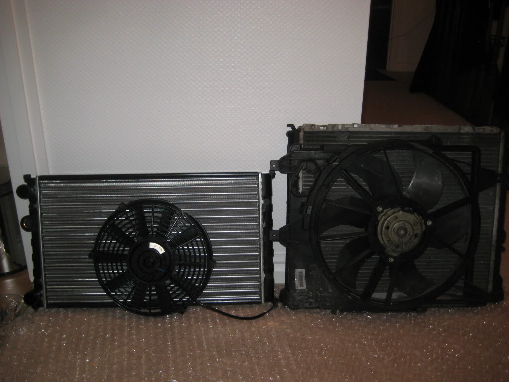

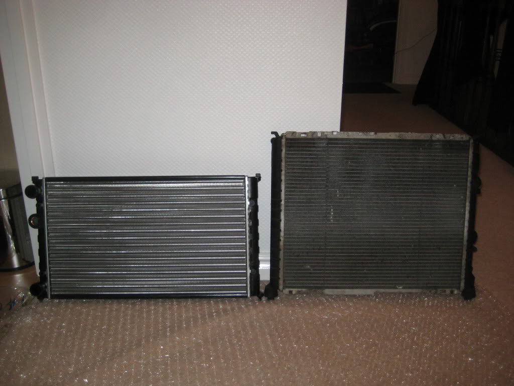

New Rad arrived :D
Also see the New Vs Old Fan
Had a bit of weight saving too which is allways a bonus :)
Standard Radiator (dry) - 3.390 kg
Standard Fan - 2.576 kg
5.966 kg
New Radiator (dry) - 1.988 kg
New Fan - 969 g
2.957 kg
So saving 3.009 Kg :) Every little counts

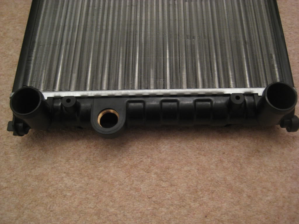

Bit pi**ed off tho as the bung is missing from my new rad so its gona make it heavier, booooo :(
So I'll be droping them a call tomorrow.

What rad and fan is that boss and do you think it will cool as well ? silly question i know but im looking at a smaller rad package as my OE setup is a bit clumsy around the my bodies.
  182cup & 172 racecar
We have raced with this set up all year and had no problems at all,infact at Silverstone the fan wasn't working and was still ok.
  TrackCar & F30 330d
There's a few people on here that have run the same set up, Laxy used the same set up on his track car and that was running 240ish BHP
The fan is only needed for when your in traffic, as soon as your driving the car fan stops.

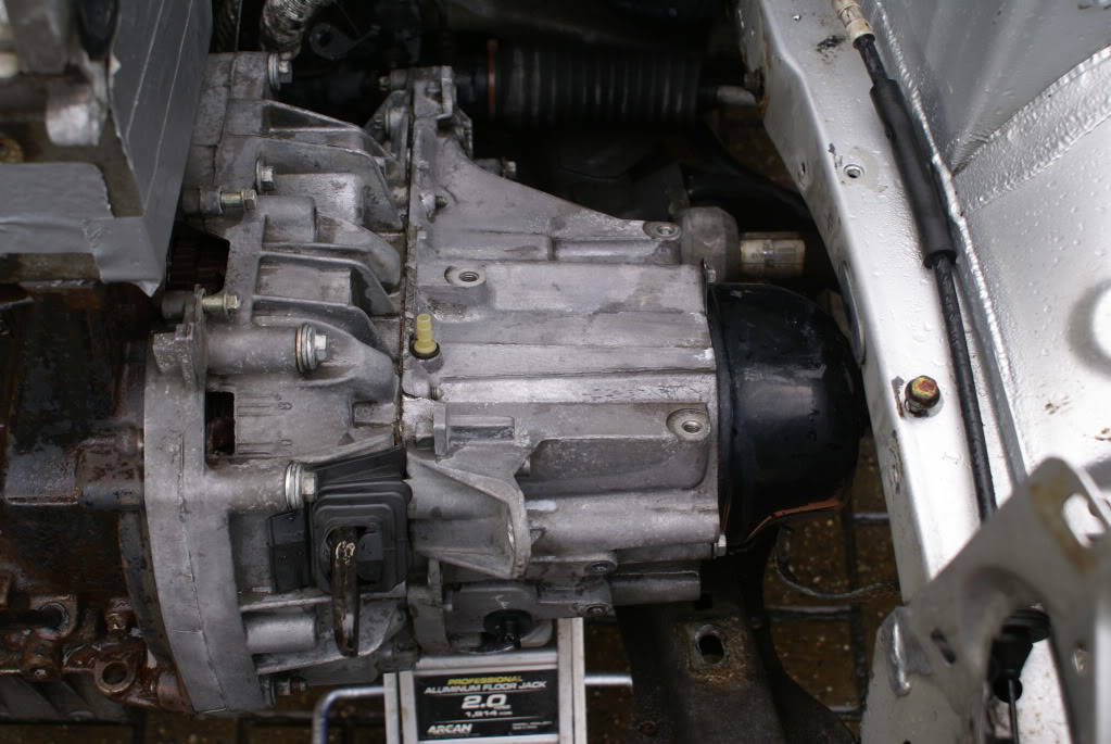

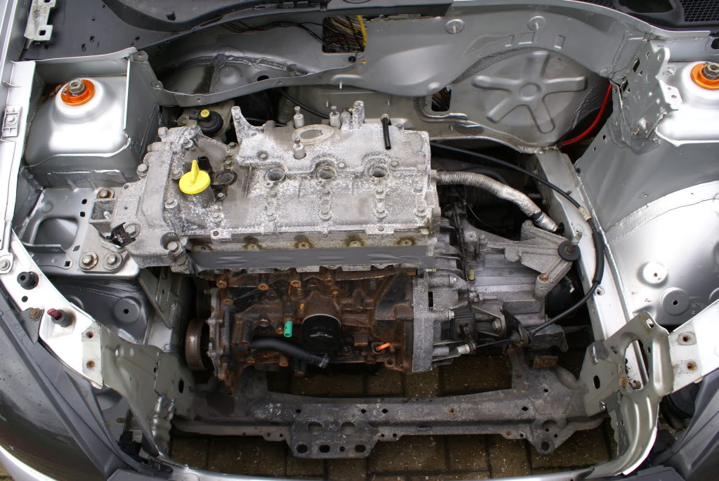

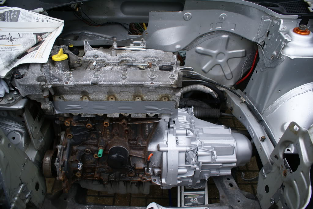

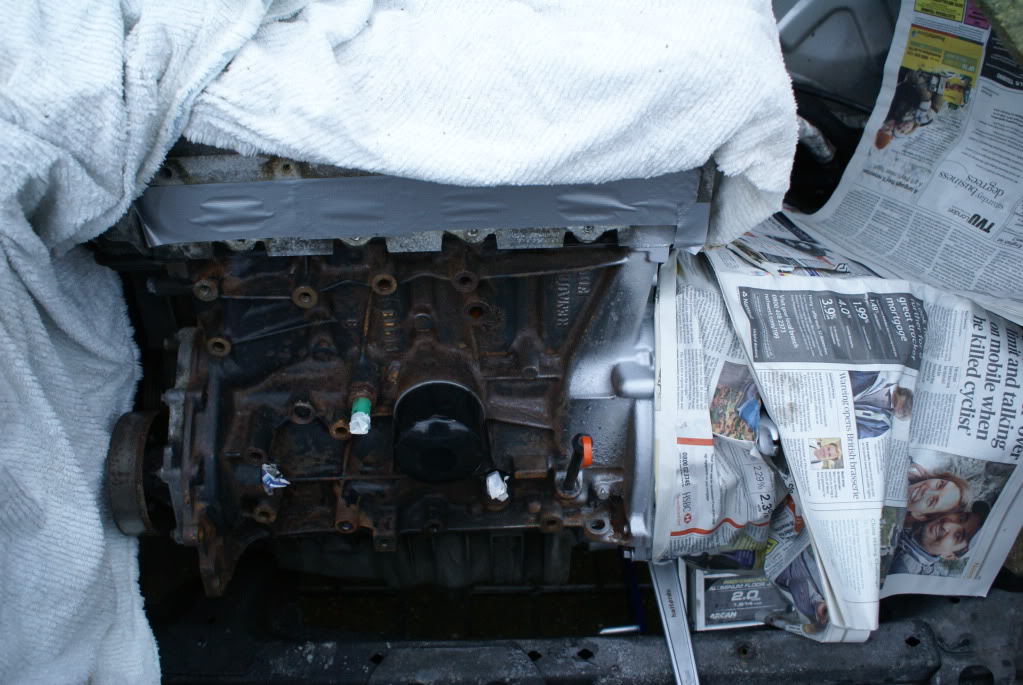

Anyway at the start of the day this was the state of the engine

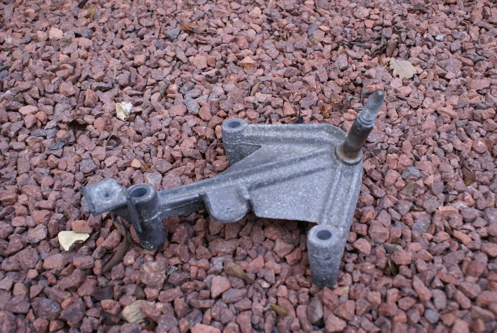

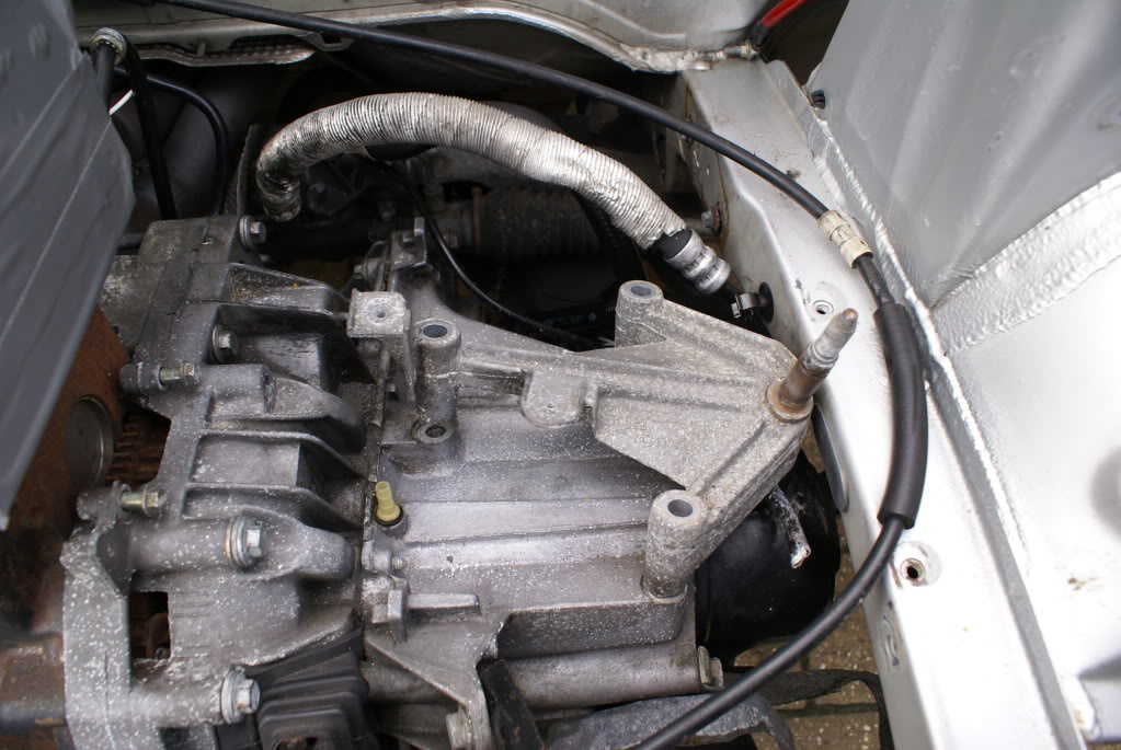

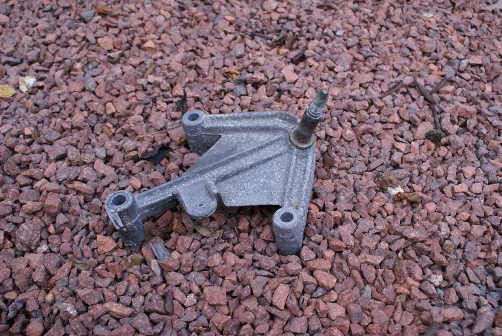

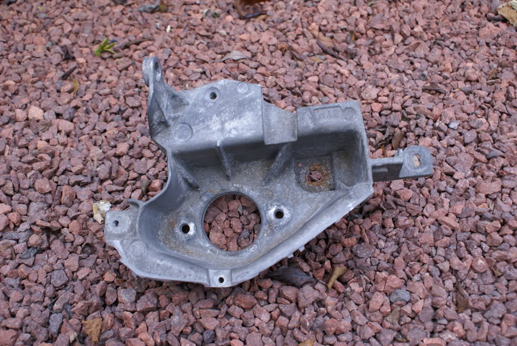

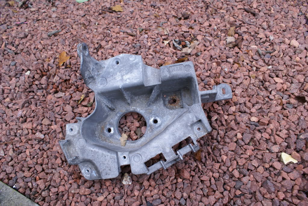

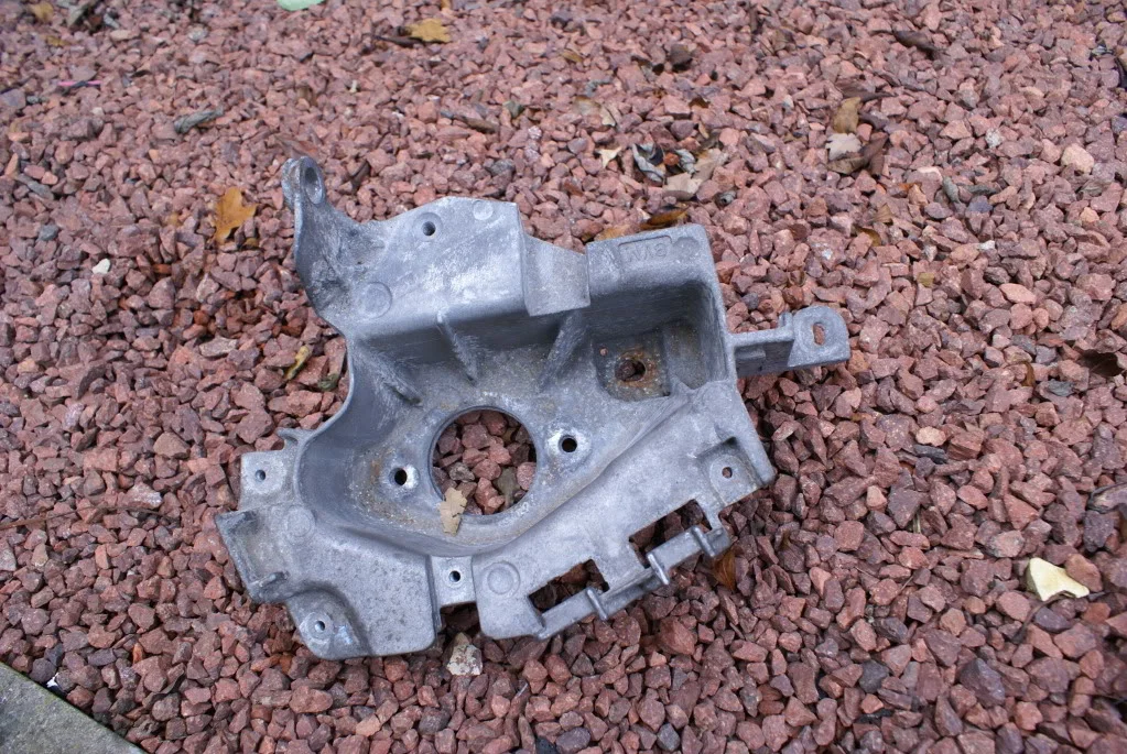

Removed this bracket so i could get to the PAS pipe which was bolted to the gearbox
Took it off and decided to cut a little bit off
Before
Bit of anglegrinding later
Also decided to see what excess i could cut off the battery mount, gearbox mount
after

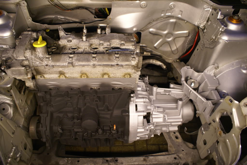

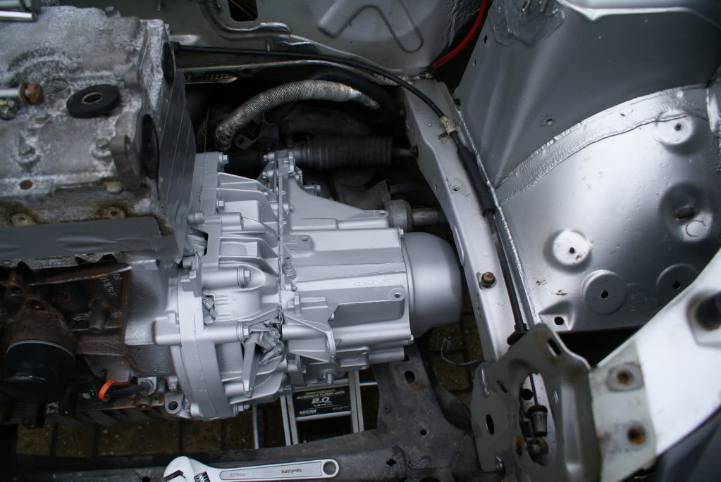

I then sprayed those parts silver

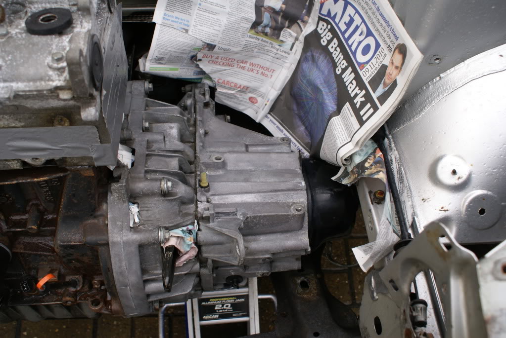

I think fully degreased the gearbox
Then masked up some bits
All painted
I think it looks much much better so i was really pleased with it :)

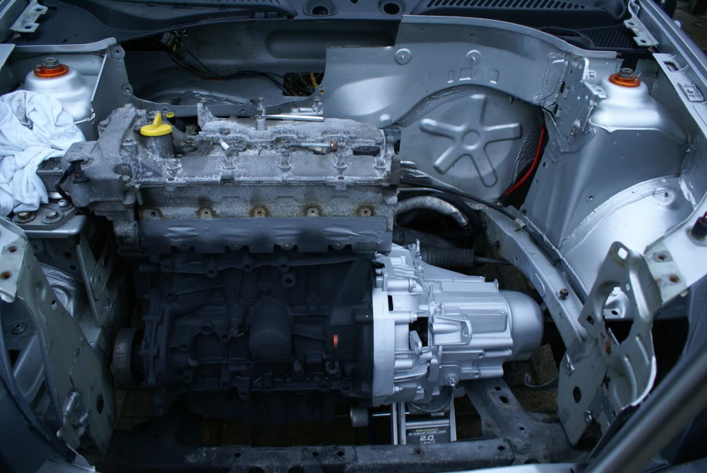

Then properly degreased the block and masked it up
All sprayed up in black
It was getting late so i replaced the gearbox bits and refitted the gearbox mount which i had sprayed black.
I'm really pleased with how it looks and i think its gona look great when the rest is done.

That looks mint mate, nice option (Y) Pity you couldn't tuck the wires to keep it looking that way
  M3 Touring
I really would of tried to get the engine out... for the sake of a few more nuts and bolts :(
Looks smart though!
  TrackCar & F30 330d
Looks smart though!
Yeah i did want to get the engine out but i have no where to store the engine, the garages are full of cars. But i've painted it pretty much all over so it looks good from all view points.
I just need to keep telling myself i'm just smartening it up, not entering it into a concores competition.
