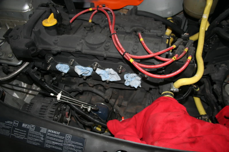

i think so, i can't remember...lol the front is totally covered by the airbox anyways....
i checked today as i was working on the car, it appears i am already stealth, but its covered by the airbox anyways....
i will be tidying up around this area though....

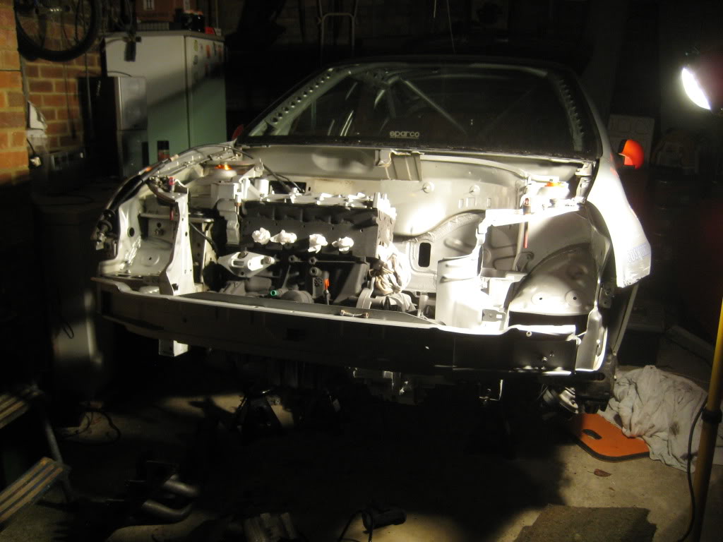

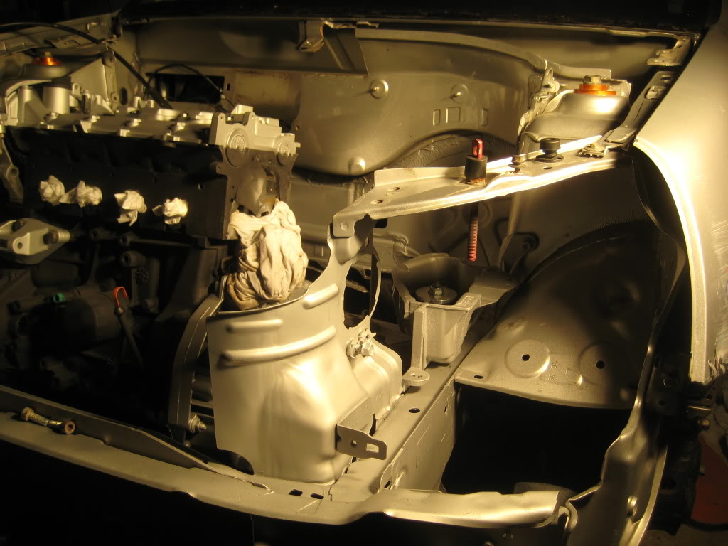

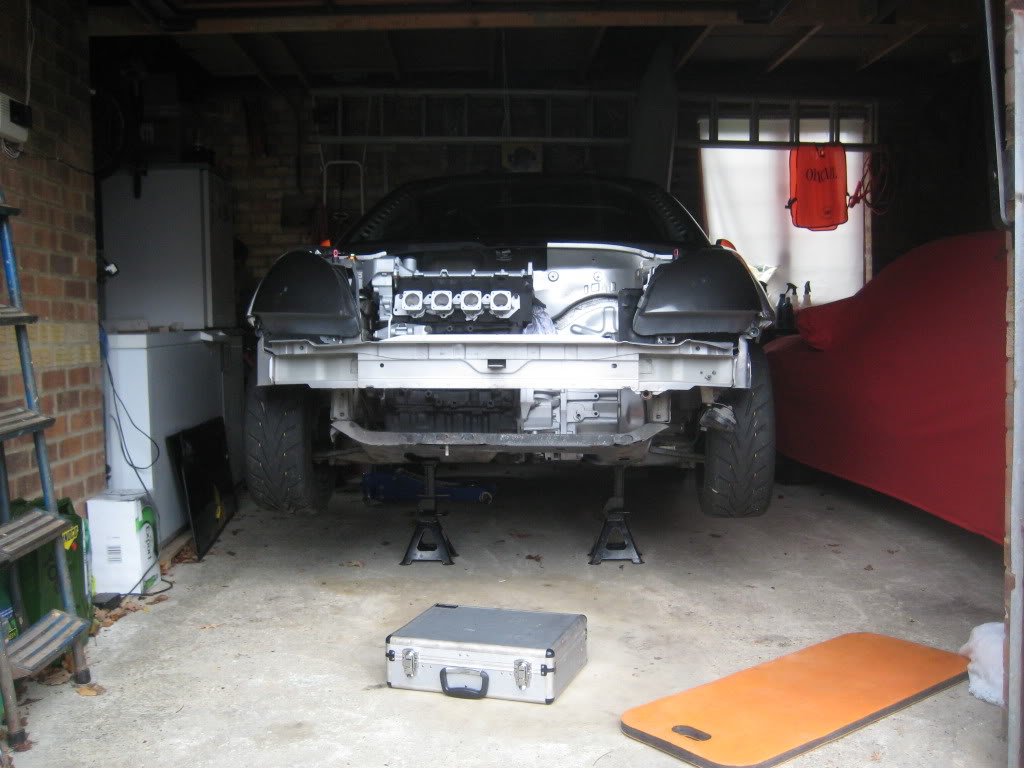

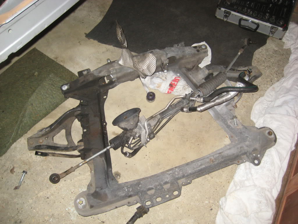

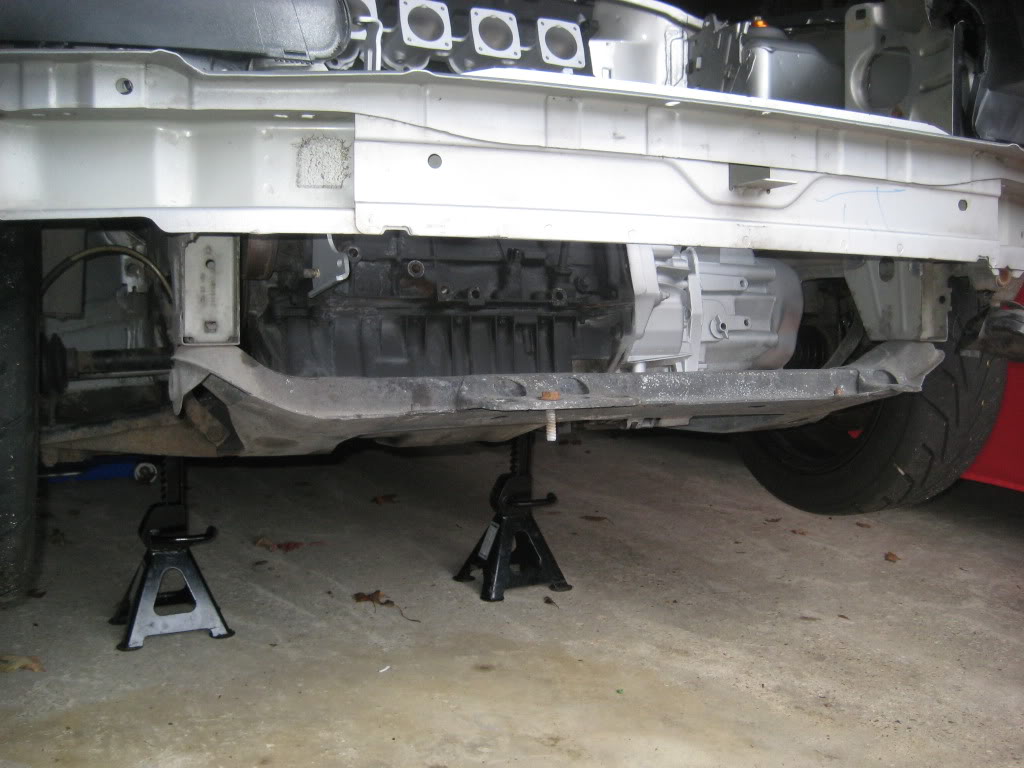

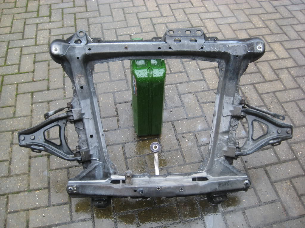

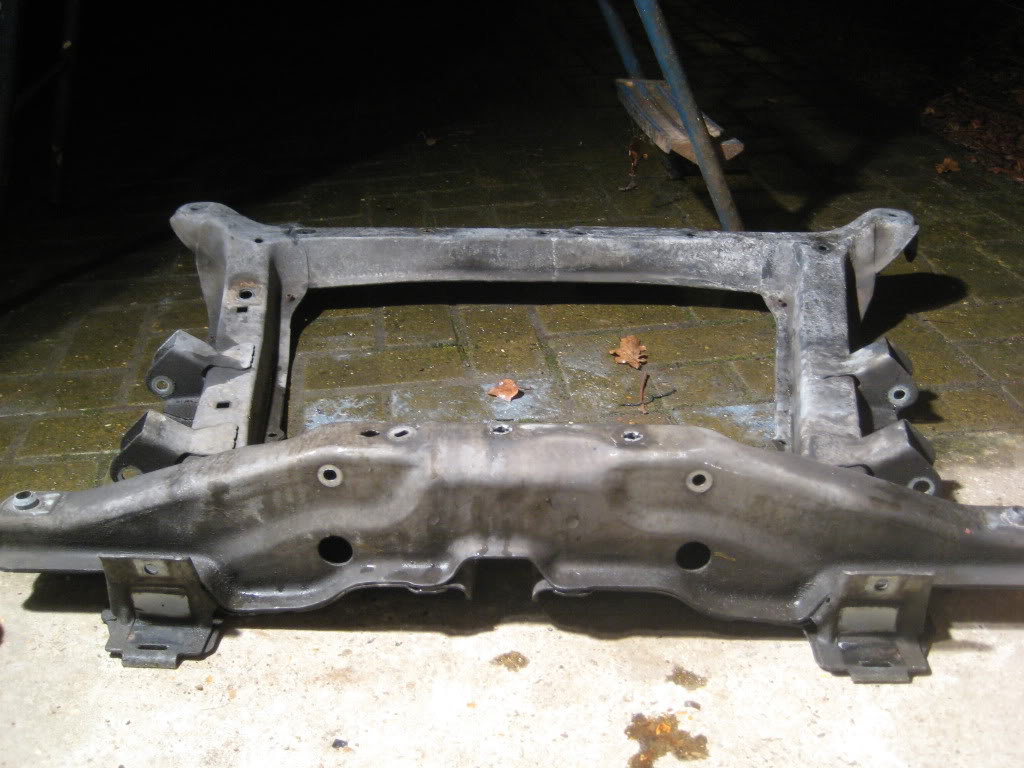

So as the GT is getting a servicing I put the clio inthe garage and put it on the stands ready with the intentions of quickly dropping the subframe. quickly lol.
So as you can see the subframe is a mess really

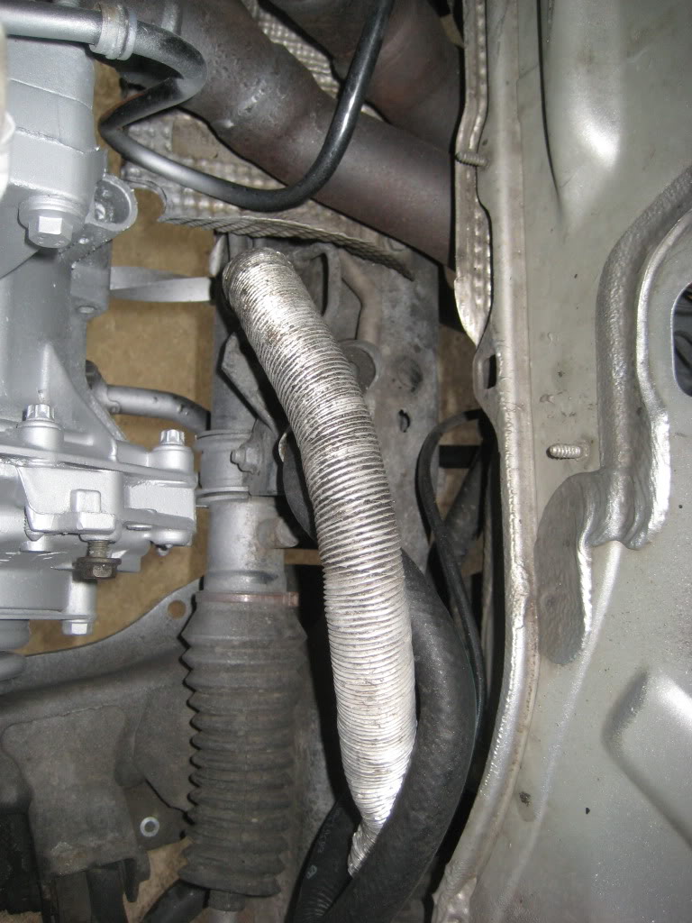

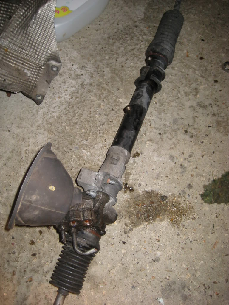

I wanted to try remove the steering rack without dropping the subframe at first but after gashing my hands i ended up dropping it.

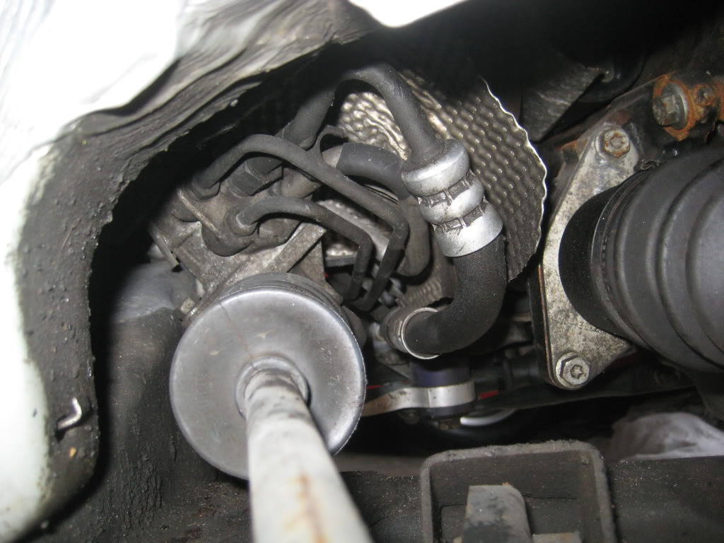

Here you can see all the PAS pipes that i was wanting to remove.
Had a bit of a fail mid way through when I dropped the Light and the long light bulb smashed and part of it broke into a million tiny little ba*tard sharp bits :(
Anyway finally got the subframe off. I thought someone said it was only 6 bolts?!!! Was more like 15 or somthing and some of them are right little s*its.

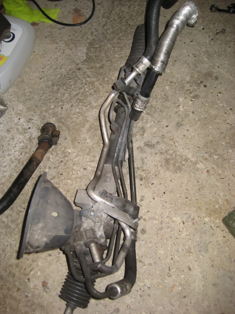

All the PAS pipes i wanted to remove
All gone
Just need to fill the rack with grease and block off the holes and clean it up.

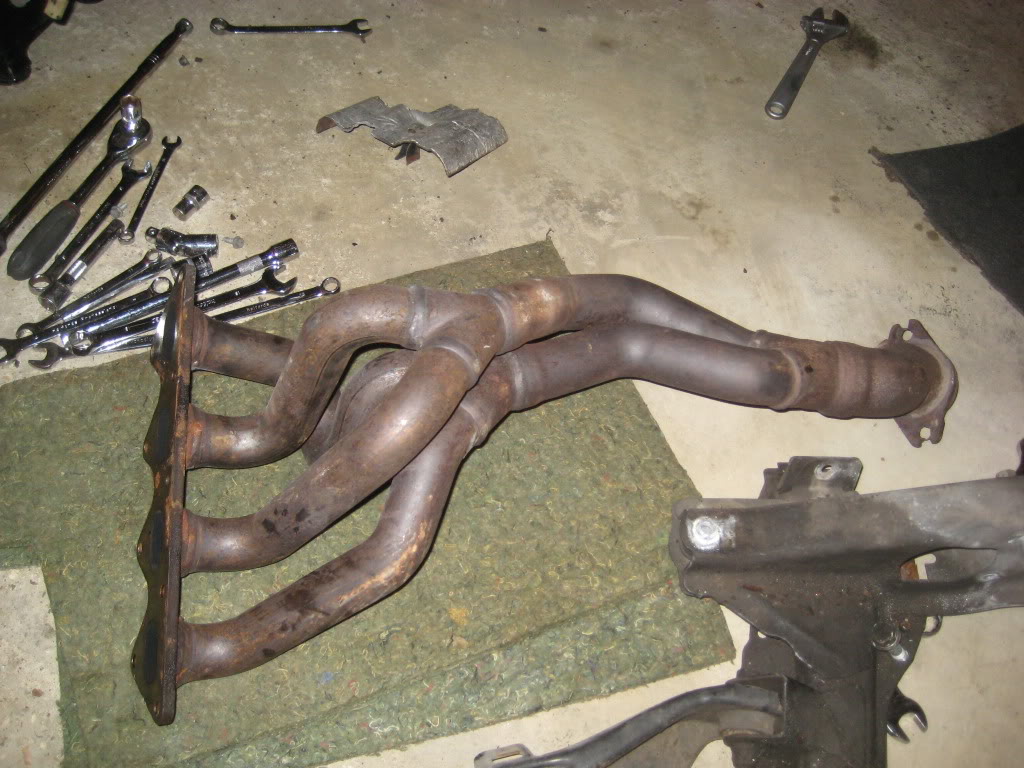

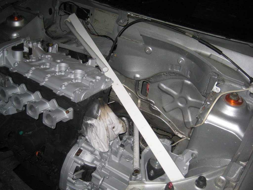

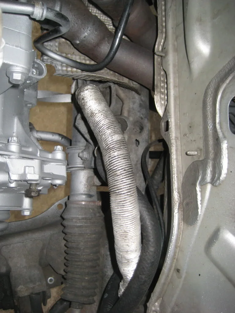

Also too the mani off so i can wrap it.
I know some people say it does fu*k all but I want to do it.
Might spray some bits up tomorrow depends if it snows or not.

Tell me you haven't removed the starter heat shield to lose a bit more weight have you ;)

Nope i havnt removed it for weight reduction, but if i wrap the mani then i may not replace it as i've dammaged it a little when i was trying to remove the wiring from the started motor a litle while ago.
After speaking to F0xy and Daz they were telling me that I can just keep the same rack and just block off the wholes after filling it with grease. So thats what i'm gona do :)
I hate those days, need to get out there again today and tidy up a bit so i have room to do stuff, Its nice been in the garage but there's not that much space :(
Good point, wrapping will substancially lower the risk to the starter. I've been told that it would be fine anyway, but you just need to cool it before starting again.
It will make the steering very heavy,you thought about that?
Why's that Tony? you not running a manual rack?
I have tried to drive ours with the pas turned off,not nice imo anyway,its the same as disconnecting the servo on servo assisted brakes,not nice.Good luck.
I don't think you will like the steering set-up...
not matter how much grease / lube you pack in your still trying to force something to operate in a way it was not designed to ;)
sure it was bomber i was having a discussion with on this type of mod, something about speaking to a power steering specialist saying how to get round it...
^^that is totally useless information really...lol
Well at the end of the day, if i end up finding out that i have girly arms then i'll buy a manual rack and do that.
Its not really the end of the world but I thought i might as well try the sort of free mod and then buy a different rack if i dont like it.
I'm just costing up my new braided hoses. I think i need 7m of the stuff :( ££££££
i drove my mk1 for a few week with a dry rack(no fluid or grease) it wasn't that bad just really heavy when parking/manoeuvring. i got use to how heavy just got to watch it when booting it, steering can get a hand full.

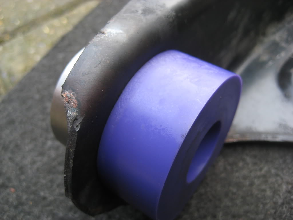

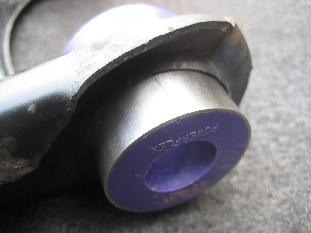

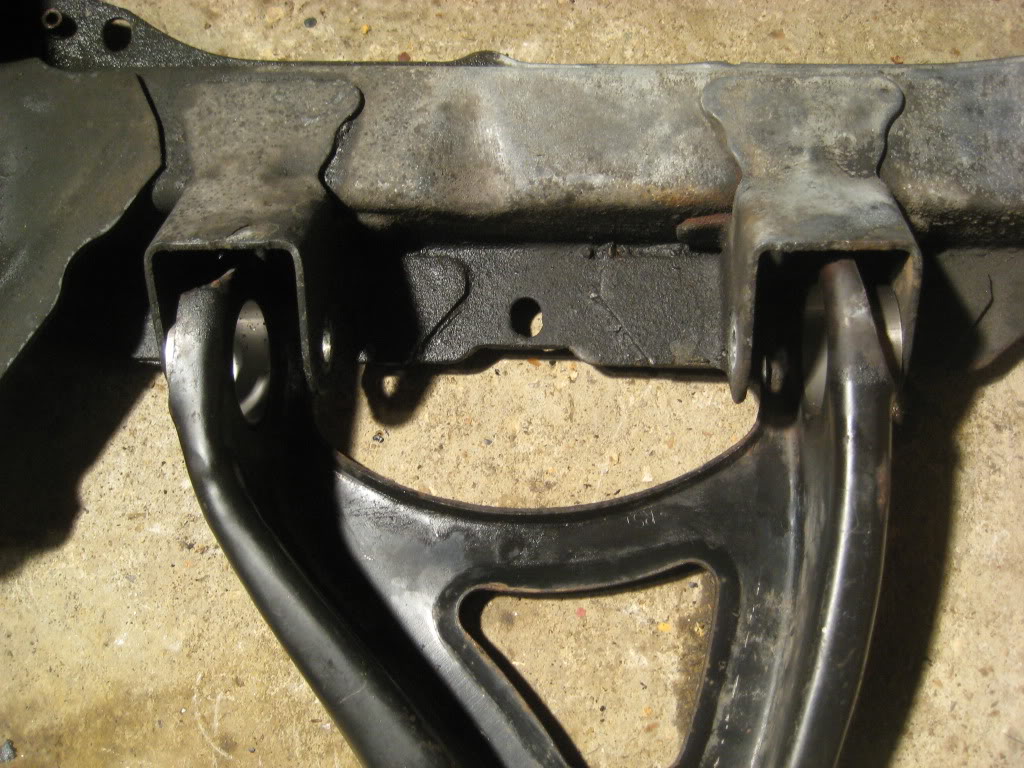

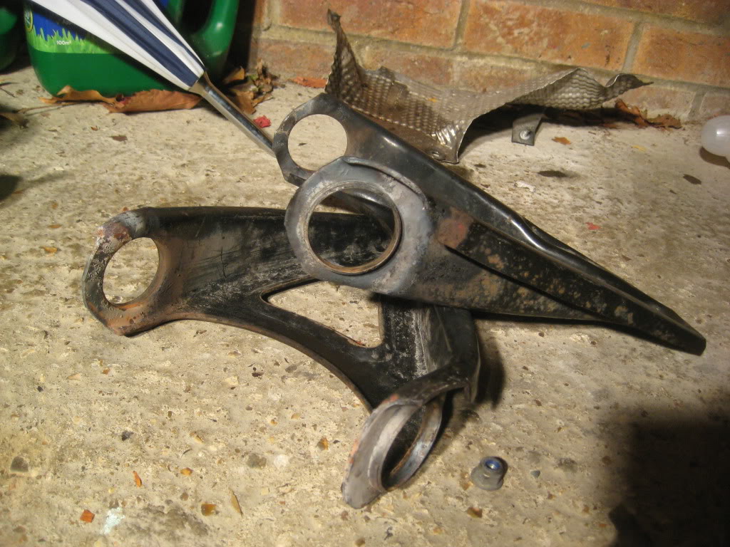

I removed the wishbones and took them to a local garage for them to crack out the blow torche and remove the old bushes and metal sleves. They did it for free which was nice
So here are my wishbones with no bushes

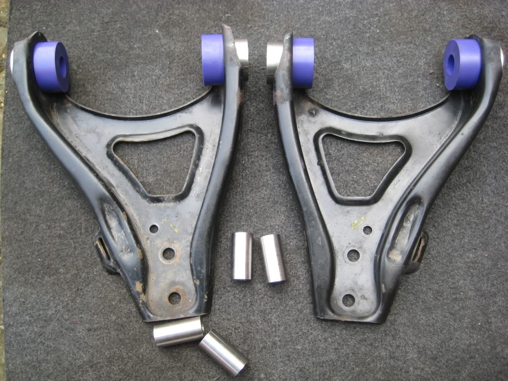

I bought Powerflex bushes a while ago which were going to be for christmas but had to use them so i can get the wishbones powedercoated
I pushed the sleves in and test fitted it to the subframe
I then placed the bushes in to see how they sitted in. perfectly.
So i'm hopefully going to get the metal sleves tacked/welded inplace tomorrow at work.

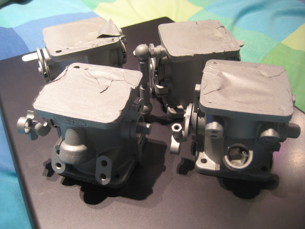

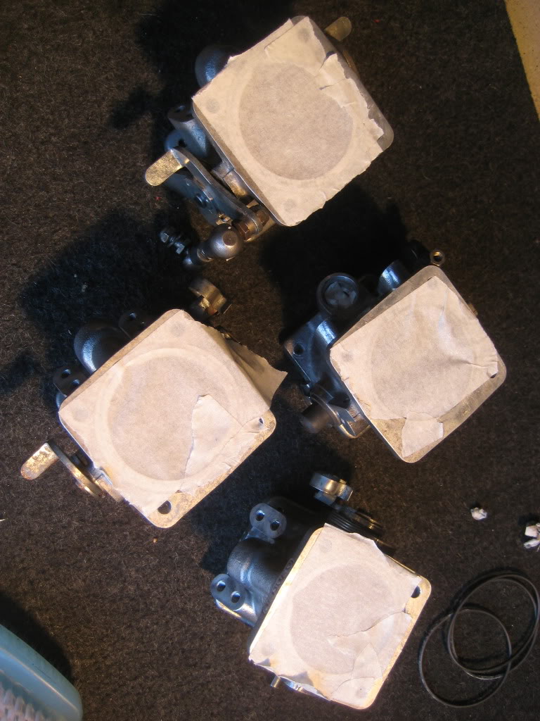

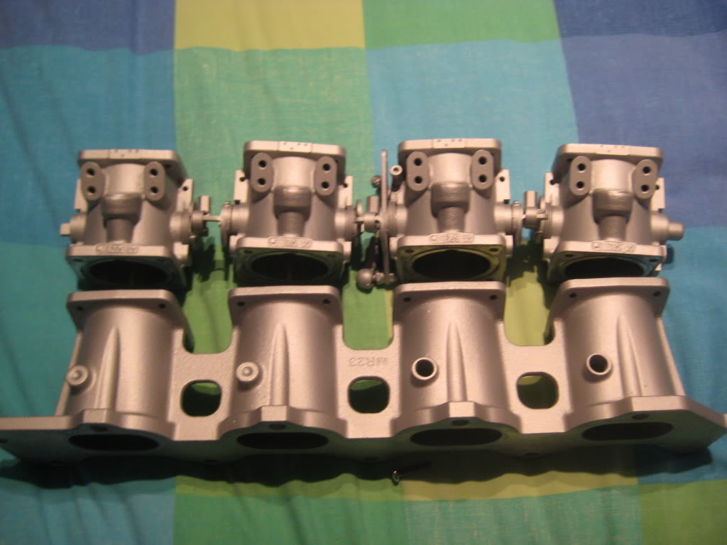

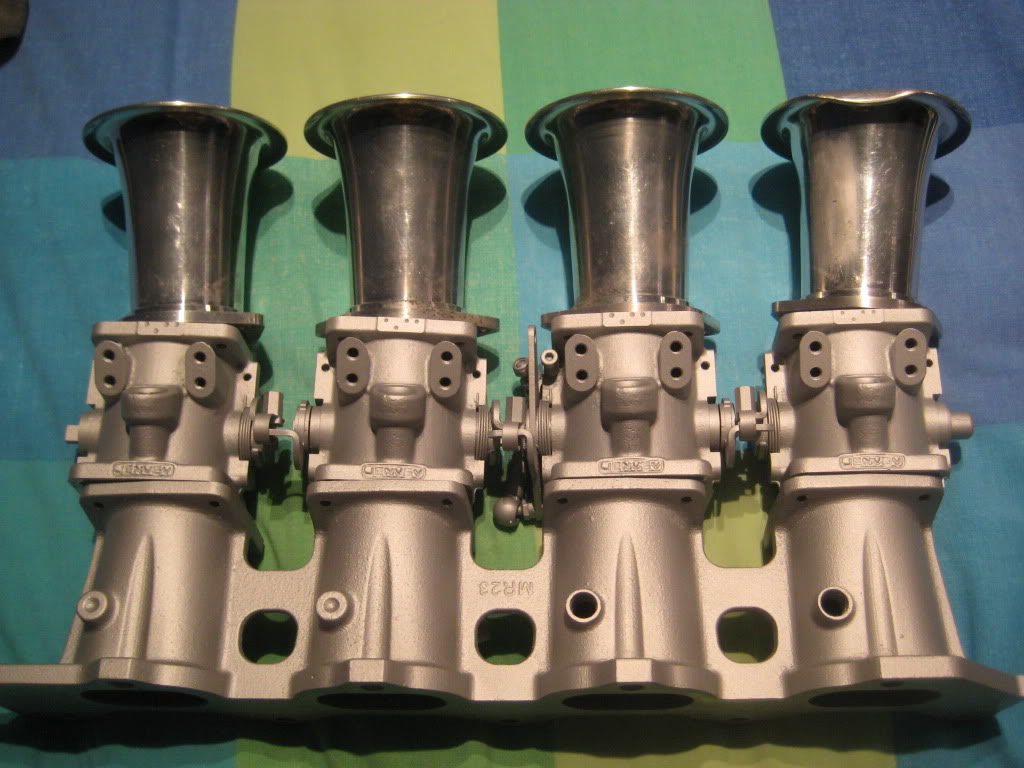

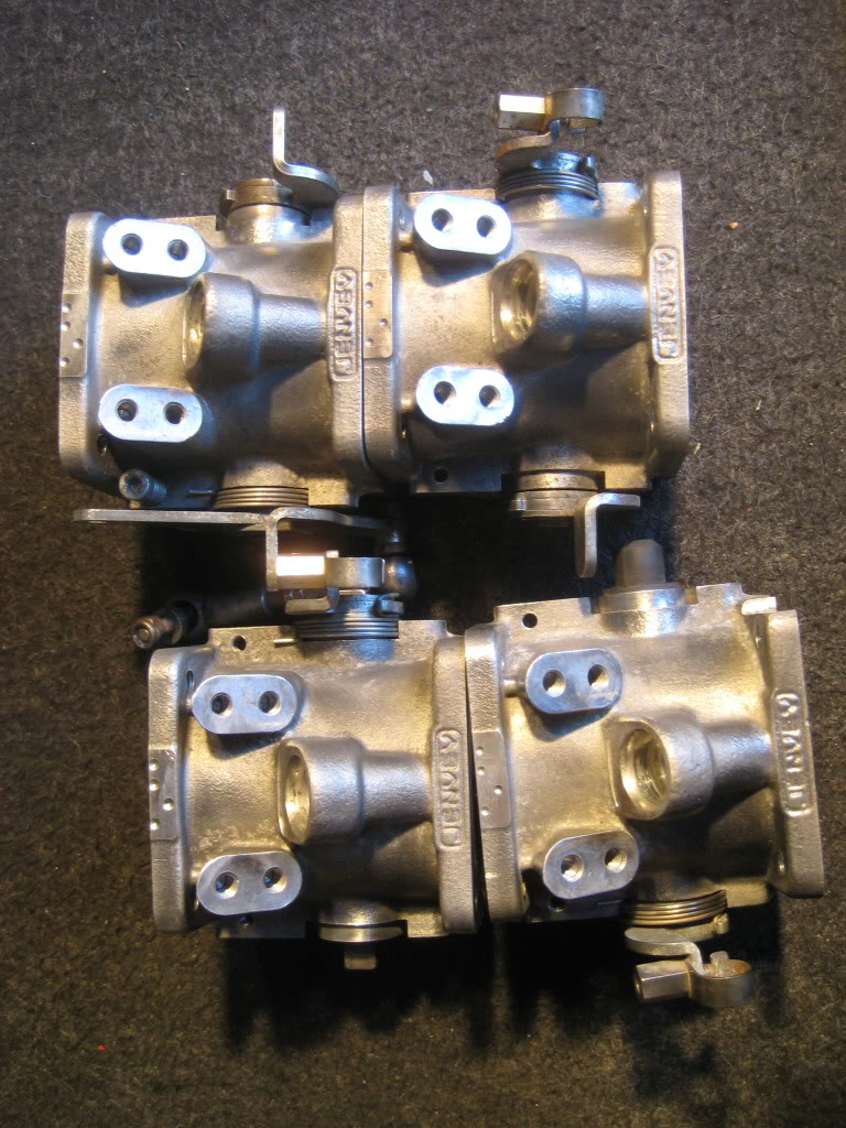

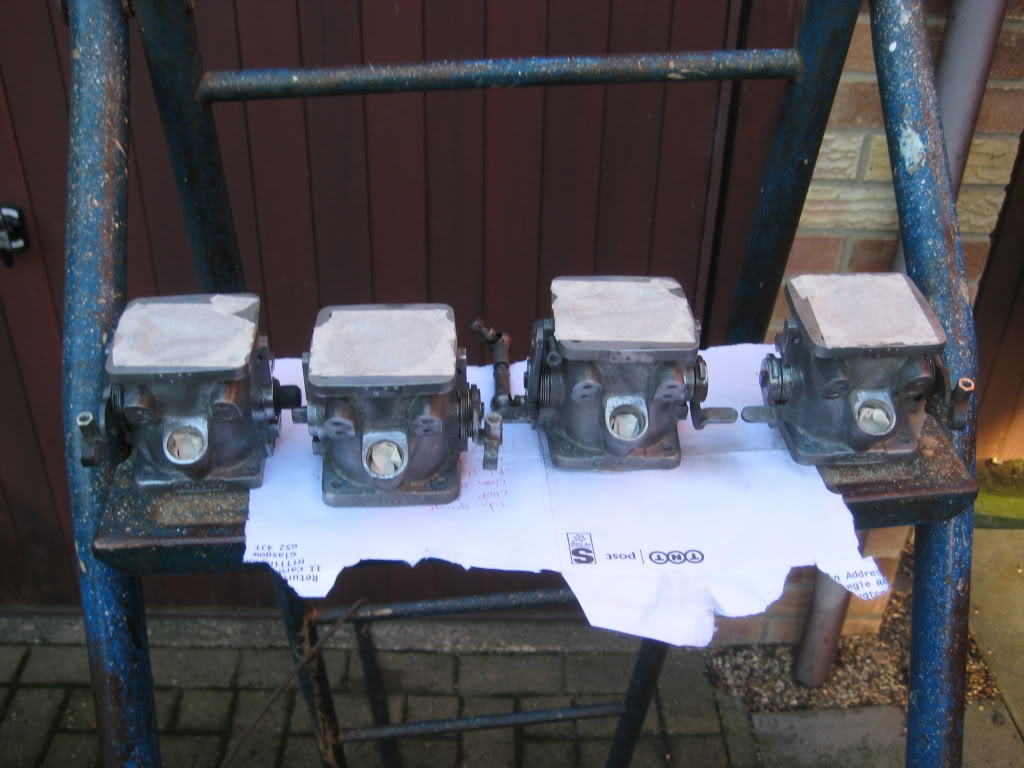

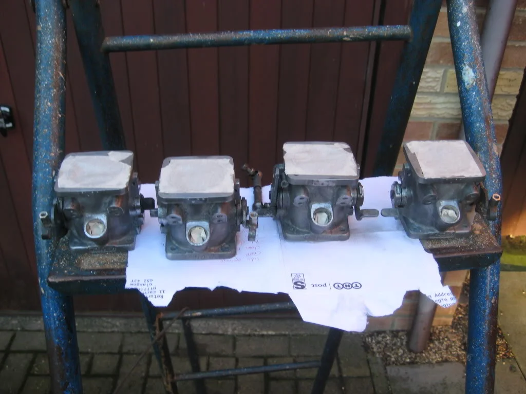

Next job was to finish of spraying the ITB's so i can build them back up again
First gave them a rub down to get all the dust and loose grime off
Then I masked both ends and the injector holes
Then set took them outside to spray them
Now they are all sprayed
So just need to build them up and polish the trumpets up :)

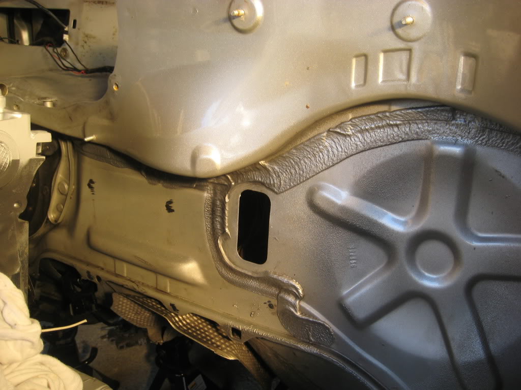

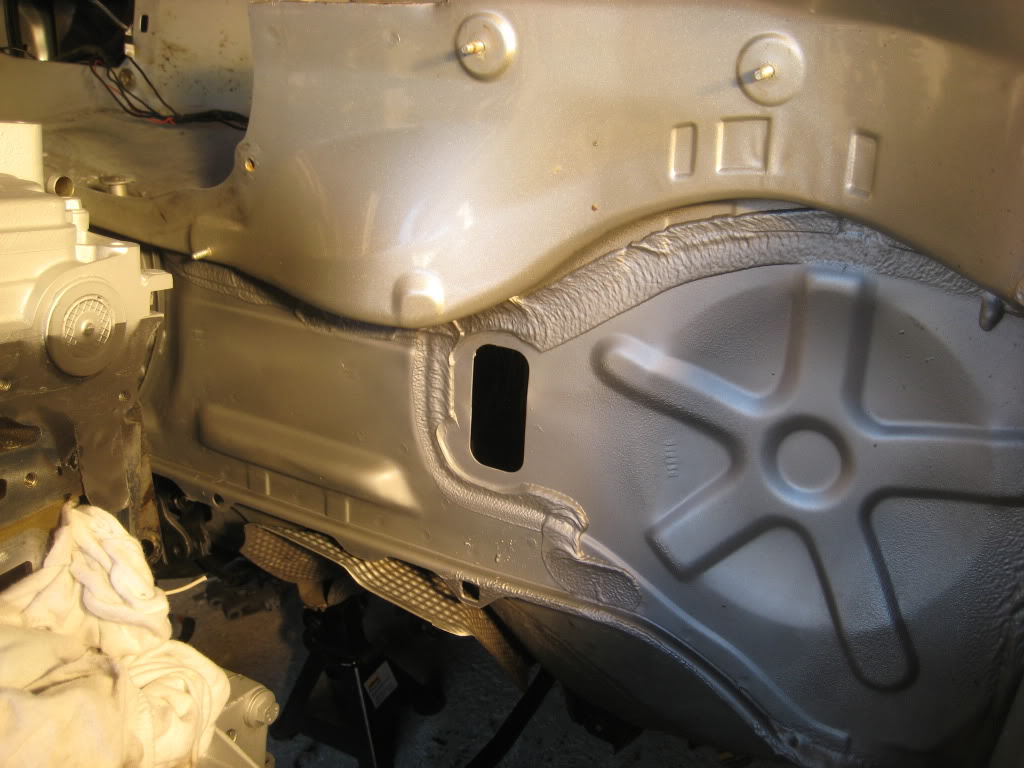

I took an angle grinder to all the little sticking out bolts that are on the bulk head
and then sprayed it up so it looked a bit neater and stoped it rusting
Also sprayed some of the shell as it was black in some places. I didnt get a before pics up it did make a big difference.
Over all it looks much better

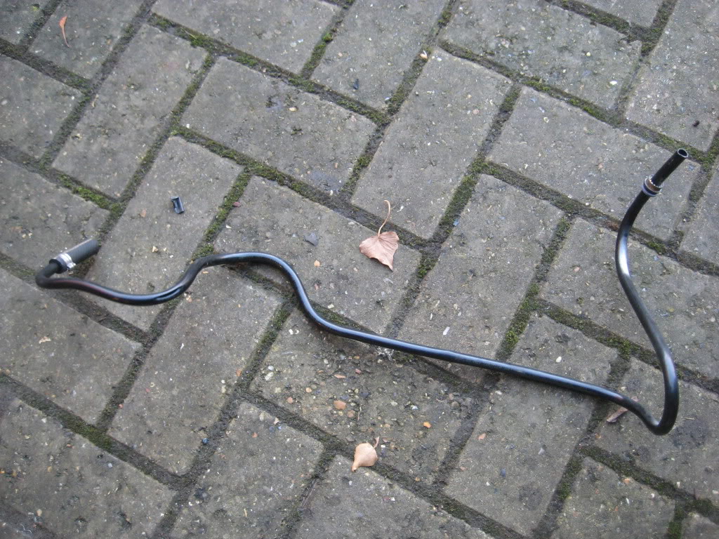

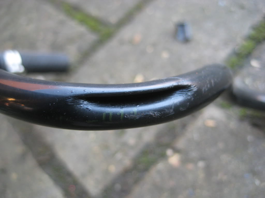

I also noticed that the pipe that goes from the ITB's to the Brake servo had a cut in it :S
This pipe
The cut
What does this pipe do and why do you need it?
More soon :)
Brake vacumm pipe for servo assistance. YES you need it. With a hole in it would of been sucking in extra air and messing the AFR up.
Hope it was mapped BEFORE the pipe split or it will need doing again
Ok thanks,
I think it split after it was mapped.
Could it be down on power because of this hole in the pipe?
