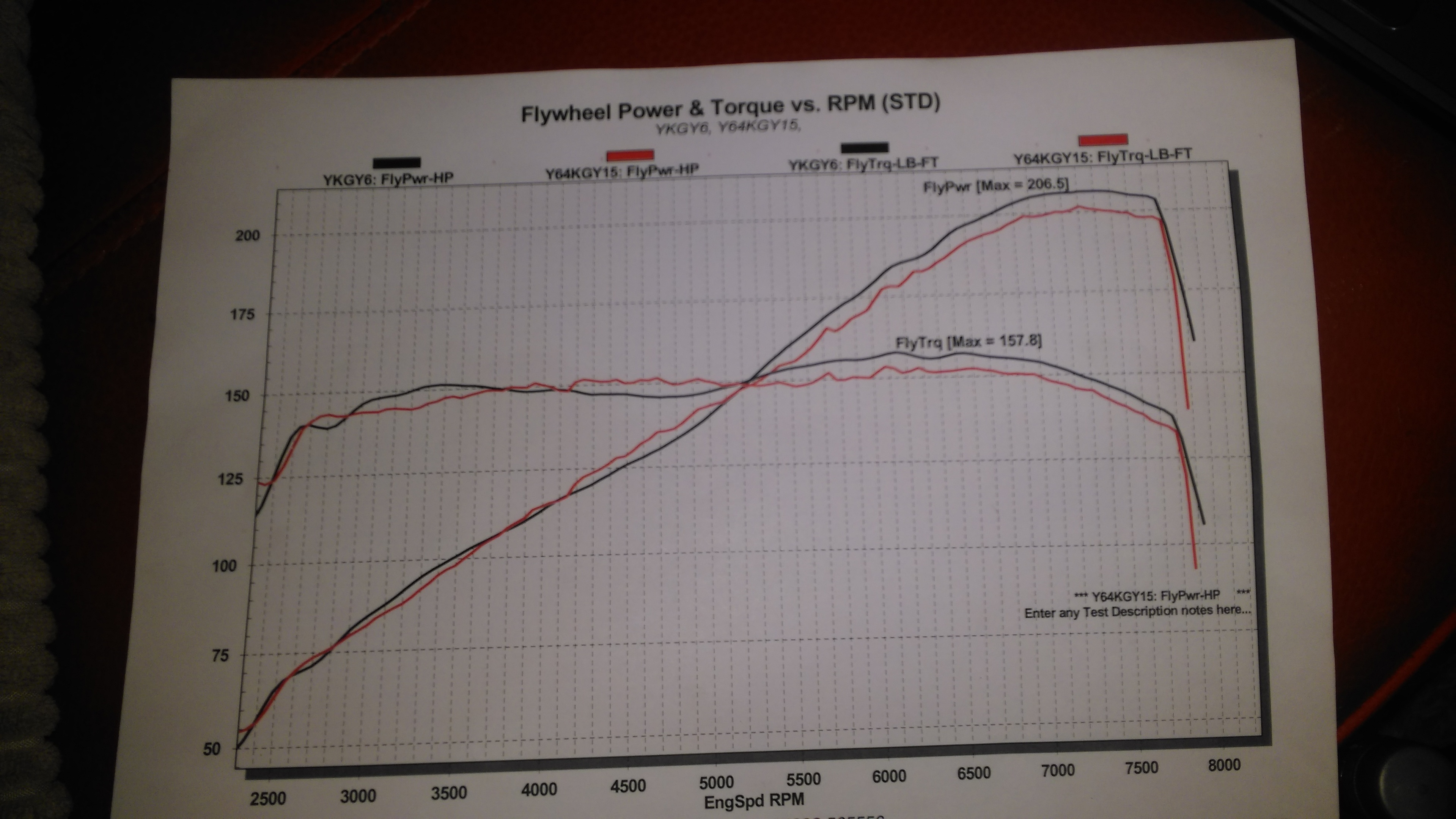

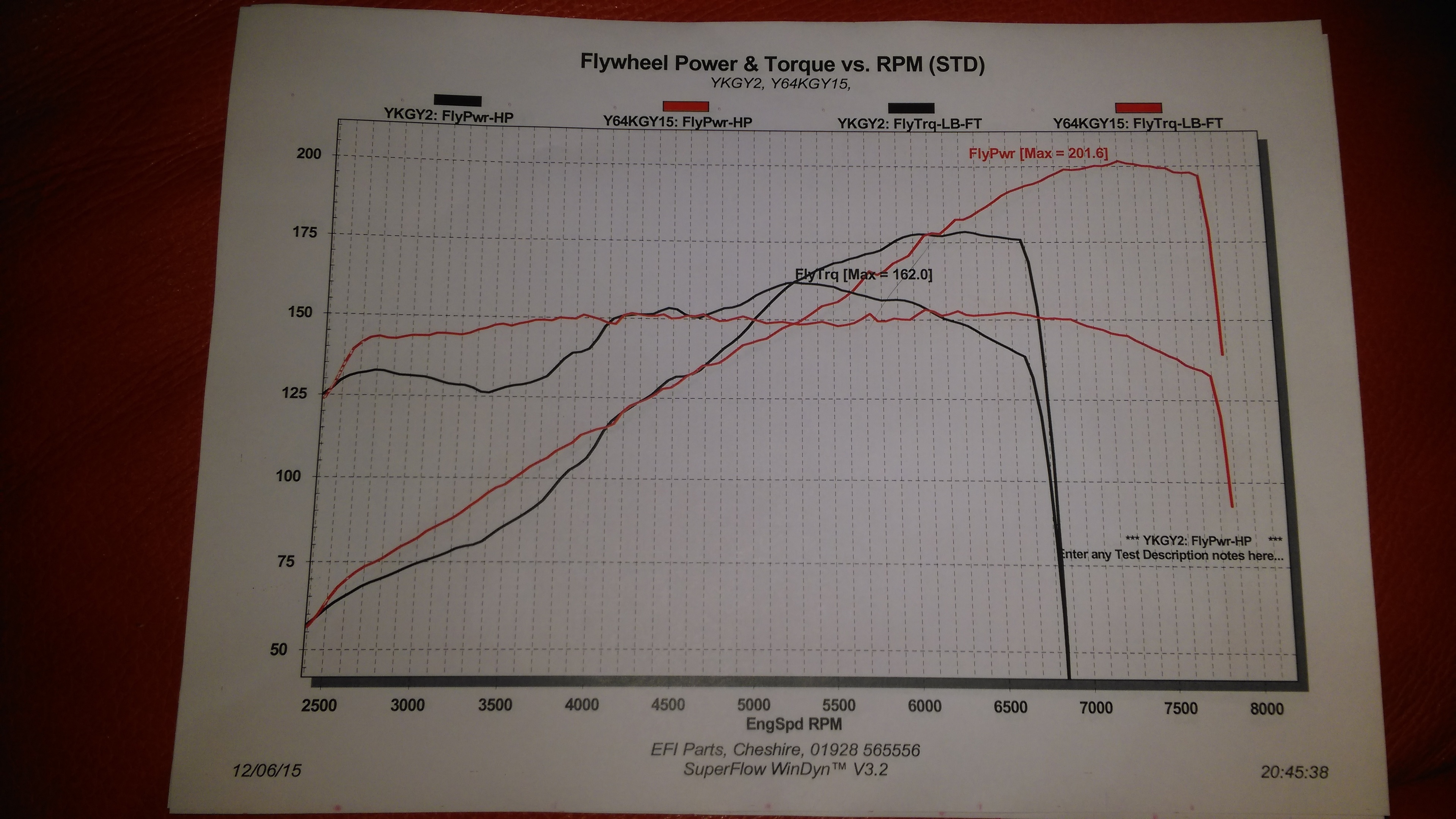

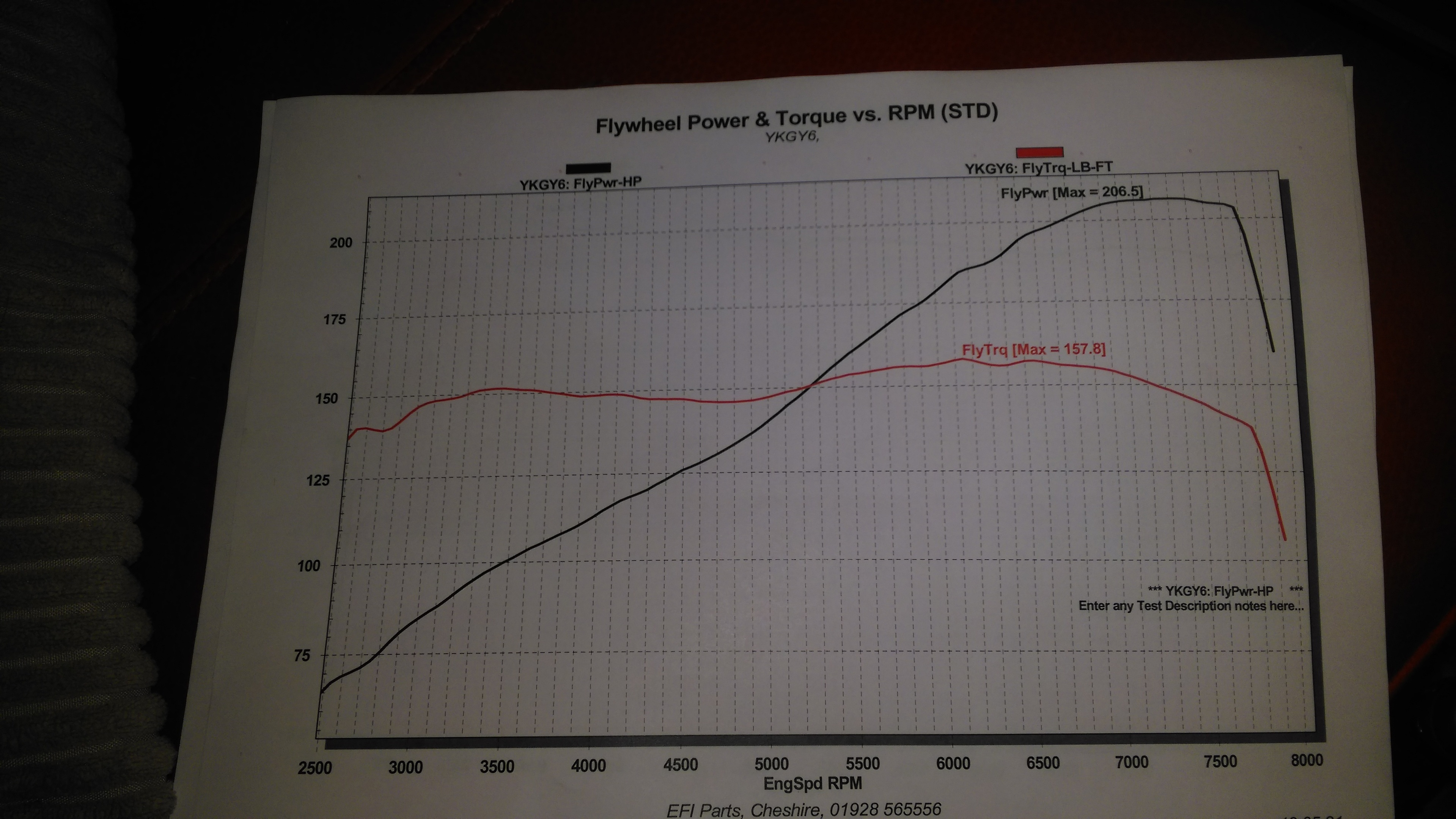

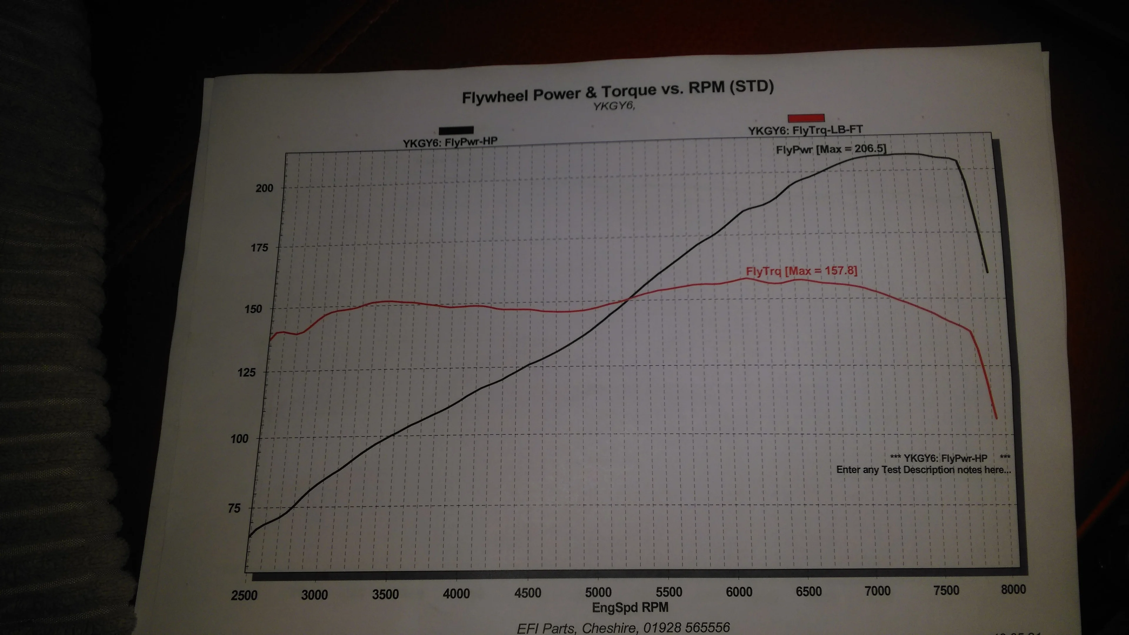

yup, it was great to drive beforehand and the lump pf mid range torque was bloody great fun but now you don't notice it missing. i had hoped we could get the torque back up to 155, bit optimistic maybe but no great loss in the scheme of things.
Bloody good numbers there, seems the inlet just needs a decent map. Defiantly something to peak the interest and a nice alternative to ITB's. And luckily I'm only 5 minutes from Chris lol.

Pretty good results for a slated product tbh.What is Chris a magician ?
