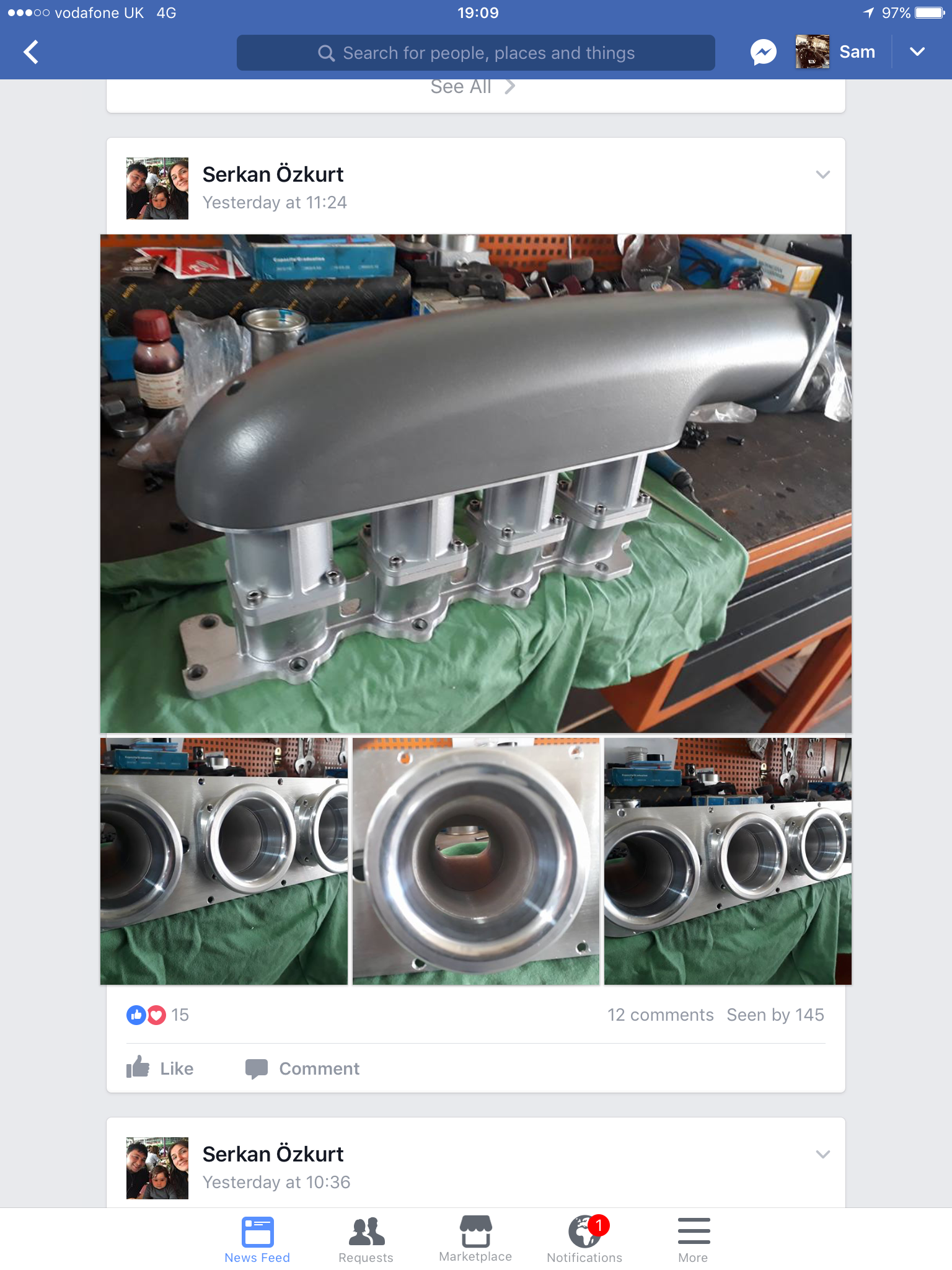

not sure about the new one as well, be interesting to see one done and mapped.

The new one looks good, but as per above at £700 not worth it. £600 and i think they would sell well, i like the new design as it offers a scope for increasing the runner length.

Search tessa motorsport on Facebook. Think they are available now for €700

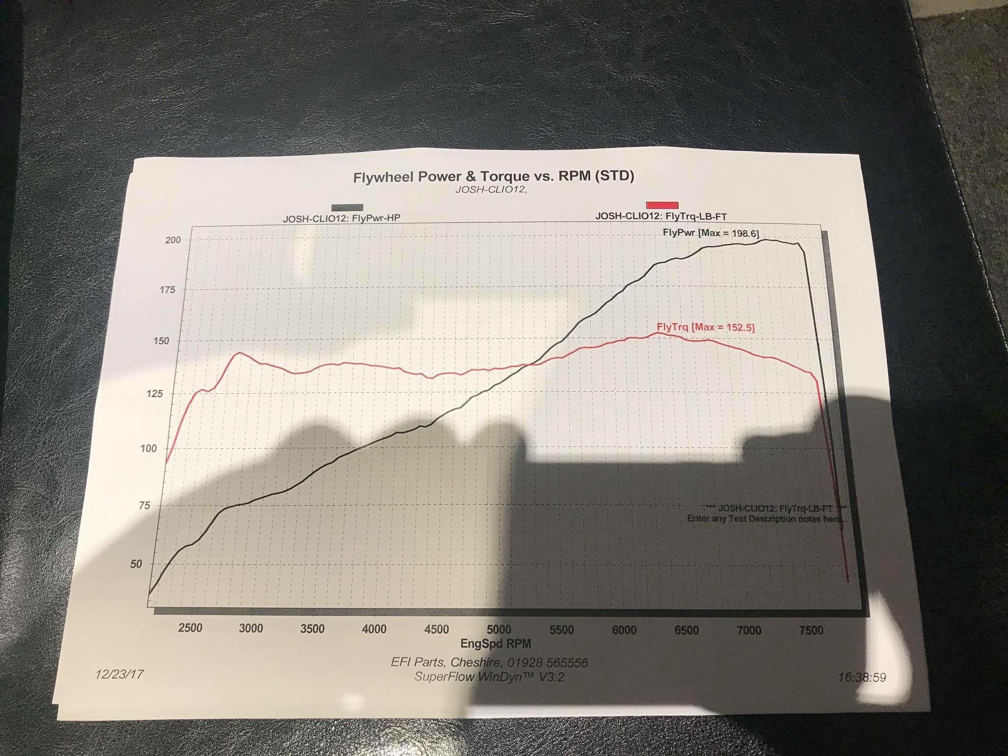

Looks like it's cammed possibly but if it is torque is bloody low low down?
If it's on standard cams then it's not that bad with th3 power results but it's first one of the new design I've seen so far but be handy to know specs of it?
Just hope that's on standard cams but got a feeling it could be 197 cams?

Iirc it has 197/200 cams fitted.

Yeah seen this recent one on FB. £700 + mapping sounds bloody expensive for reduced peak torque (but better overall). Scene tho innit
