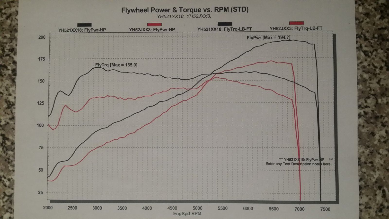

that's stu's before and after.

Is that fitted unmapped vs mapped
Or standard vs fitted and mapped? I assume your not doing the fitting at Chris's?

stu owen has got video of his at donny. sound great, not as good as bodies but still good.
  172 2003
shorter runners than standard. the original was a bloody torquey one anyway, despite the change in torque it's better now than it was.

What was the base car and modifications to achieve the 194bhp as very interested in this inlet

172 cup, standard inlet, cams, rs tuner map, 182 exhaust manifold and powerflow exhaust.
sm inlet, pms manifold back single box exhaust, epas and remap at efi.
can't remember what the figure was beforehand as that one was stu owens car.
