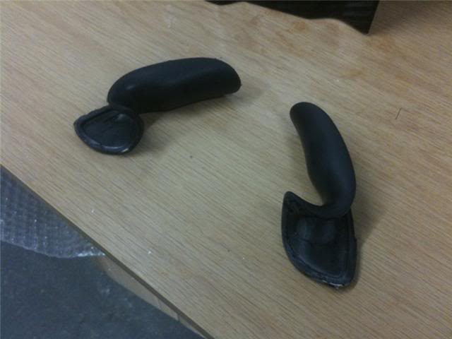

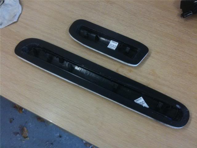

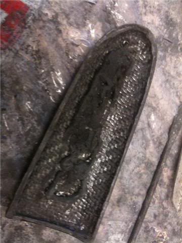

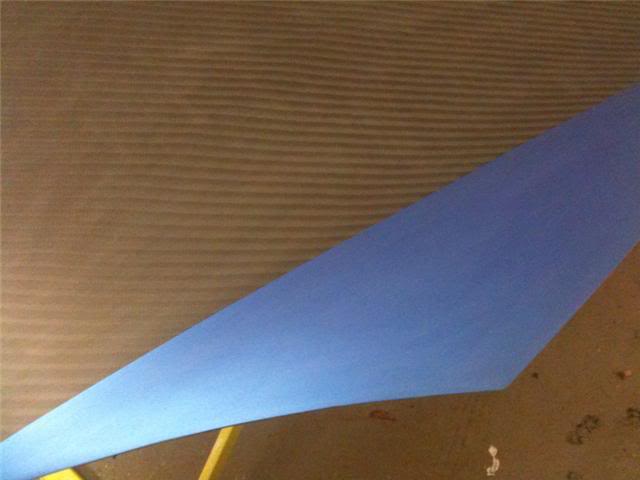

First job, Merv had kindly laminated the moulds off of some clio dash inserts last week, left in them was the sheet waxed used to create the thickness of material that will become the actual cover to go over the oe part. The sheet was needed scraping off, then acetone the residue, then flat, polish and apply the usual release agent
Original parts sat in the moulds, showing good clearance for the covers when made, which will be out of 4x4 twill 280g backed up with 203g plain weave
The first of 7 release agent applications

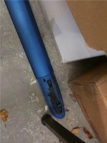

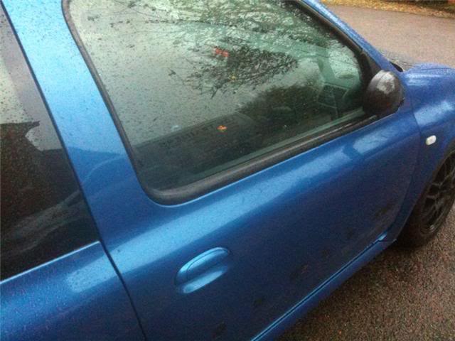

Driverside door moulding removed
Passenger side
Door badge removed from moulding

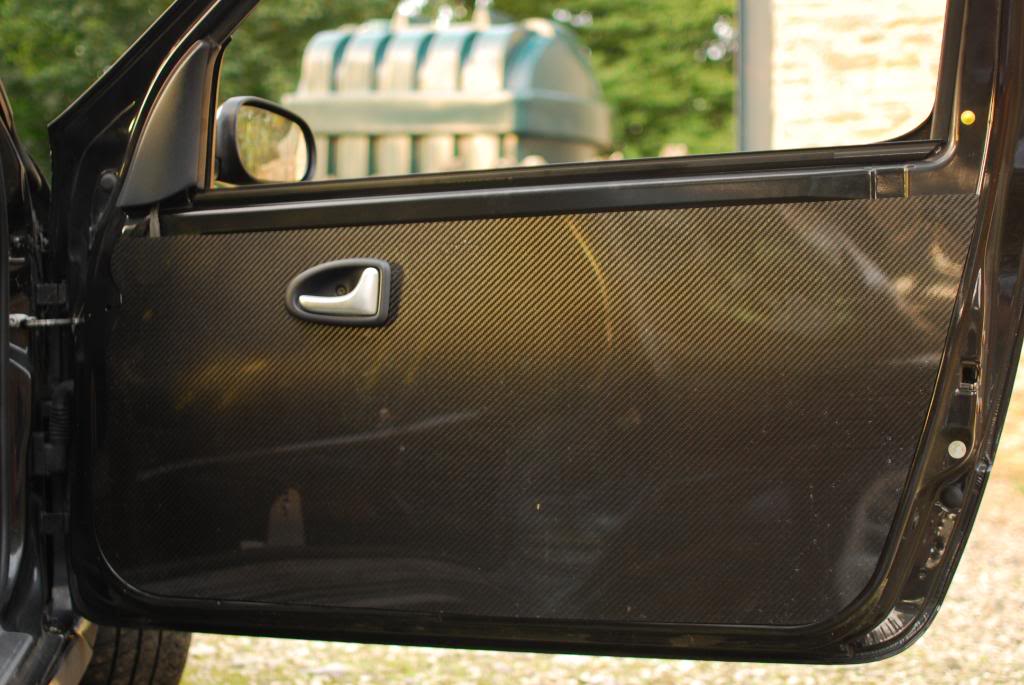

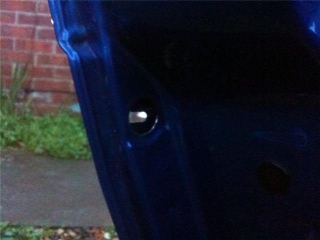

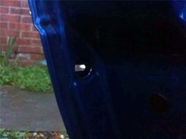

The funny bit, I thought about taking this out but then didnt first time round, so instead removed complete driverside doorcard to realise how easily the door mouldings come off, lol
Idiot lol

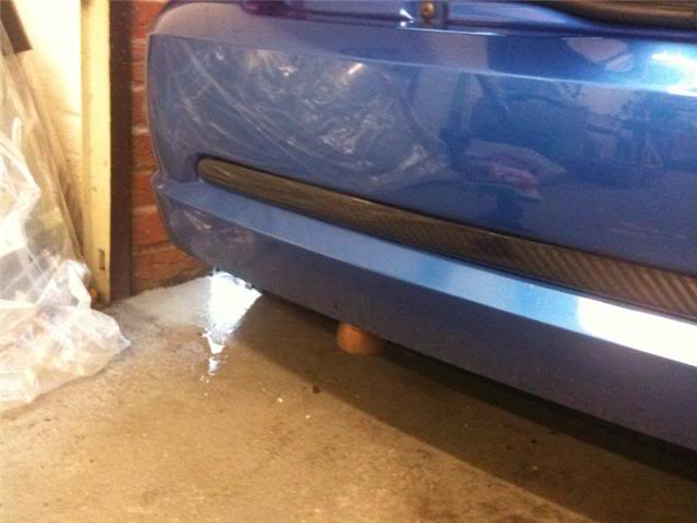

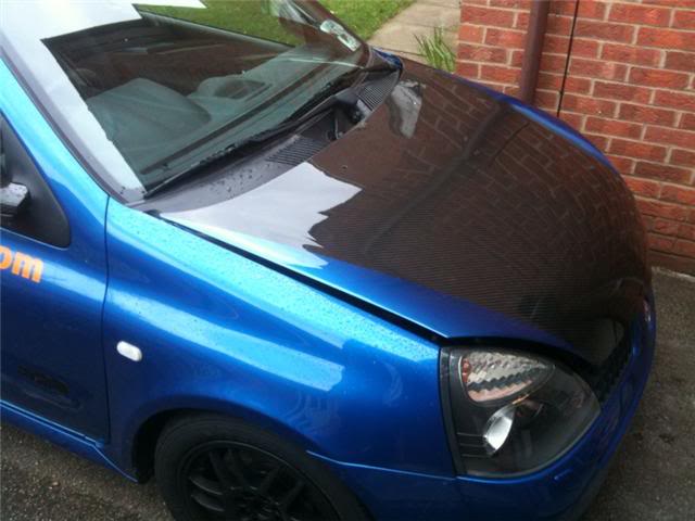

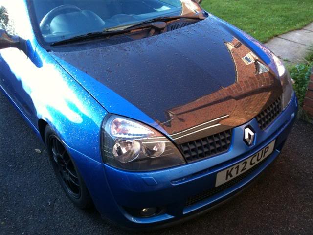

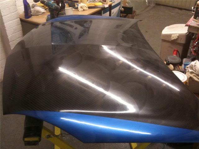

How i left her tonight

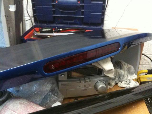

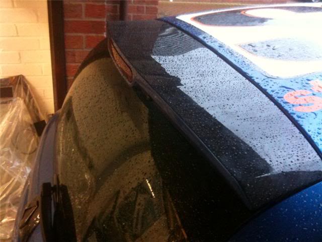

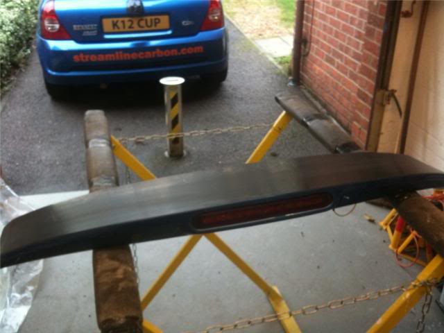

This week she will go back together with new side mouldings in carbon, bonnet nad spoiler back on all colour coded, and hopefully get the wheel off tomorrow niight ready to mould the thumb grips as this will make the job quicker and easier
