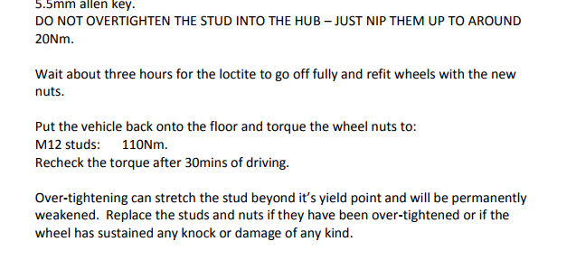

Try them a bit more at 110 and see how that goes.
You've not got any paint or powdercoat in the bolt tapers have you?
Potentially. I'll give them a clean then tighten to 110. I carry a torque wrench with me now and just check them before/after any long journeys. Take 2 minutes so doesnt bother me

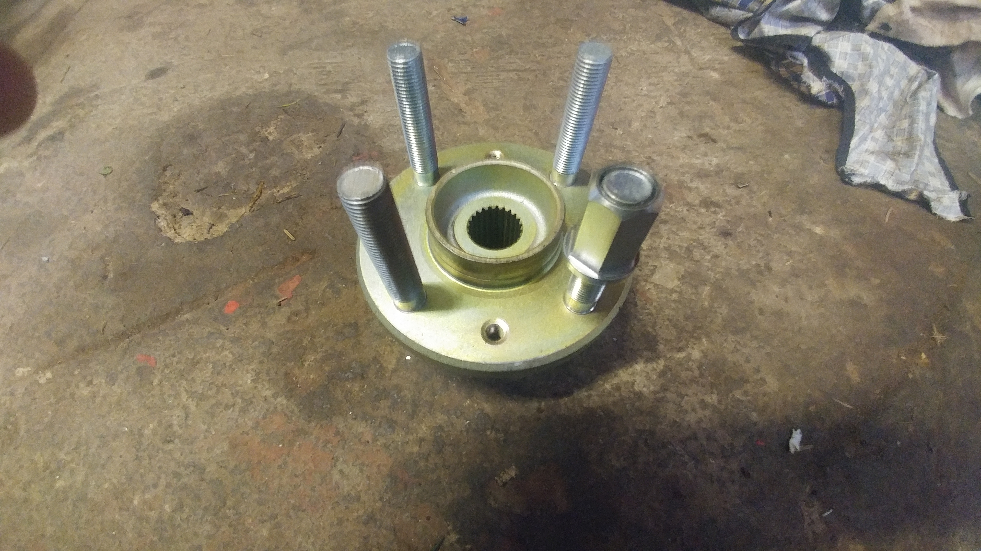

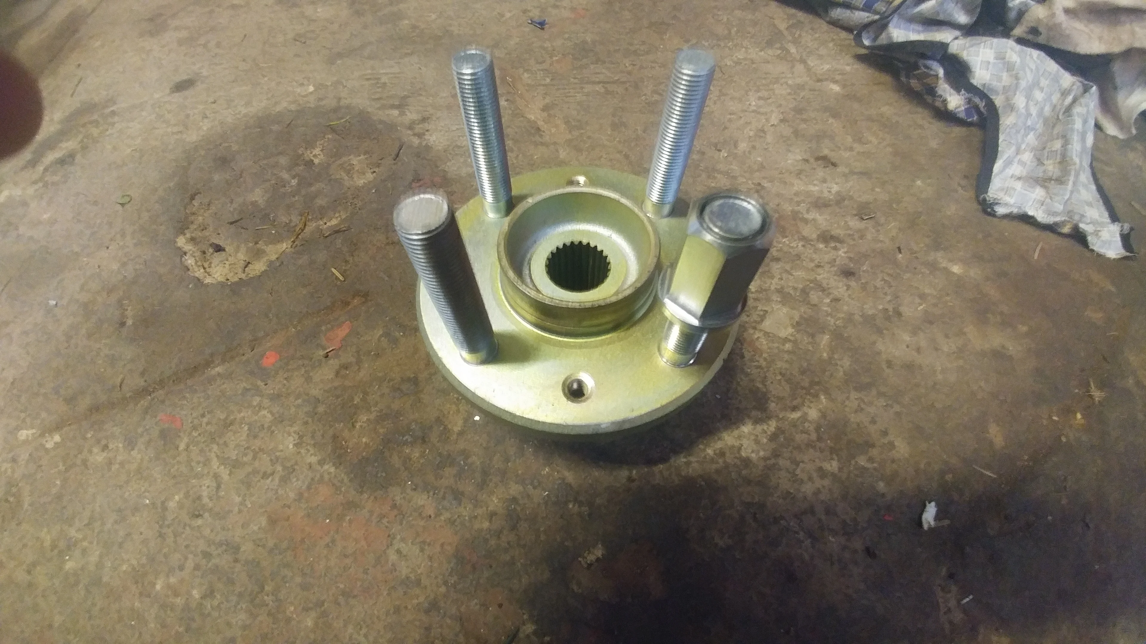

yes as abouve, tap the hubs to take M14 studs,changed to m14 after shearing m12 studs,changed to m14 years ago and never had any issues
need to make sure tap is straight
