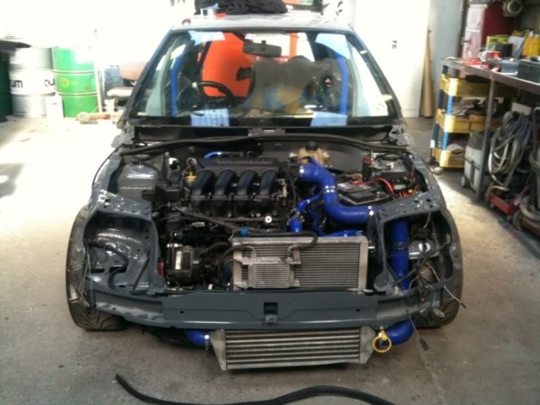

Although it does state in the install guide 'Place the oil canister with the cap below or level with the supercharger’s shaft. Use the bracket supplied in the oil set. Make sure the canister is placed upright. Leave the plastic plugs in place to prevent debris from entering the system'
FFS, it sits right at the bottom on the Clio.
Looks like that's not for the new seals and recommended on old ones. Going to have to rejig all mine by looks of things :(
So how low does the charger sit? From the pics ive seen it seems low. Is it possiblee to get both the cooler and canister actually lower? Surely the coolers are already low as reasonabley possible
I could get my cooler inline, I need to rearrange a few bits anyway
You can see where the first blue hose goes to the cooler on my old one, it's basically same place now.

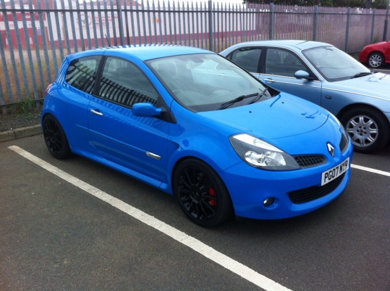

Ive also bought a RB 197 FF as a daily, the plan with that was to keep it as a standard daily but it hasn't lasted long :rolleyes: Bought all this lot & just got it all fitted the last couple of days I've had free.
K&N panel filter
FK 25mm hubcentric spacers all round

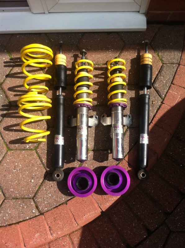

KW V1 coilovers
RS steering wheel insert
TypeR aerial
CLIO badge removed
New style RS rear badge
6k HIDs
White side lights
White number plate lights
Silvervisons
Plain number plates
RS200 rear diffuser
Custom outward exhaust tips

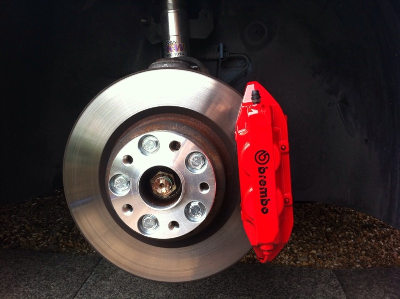

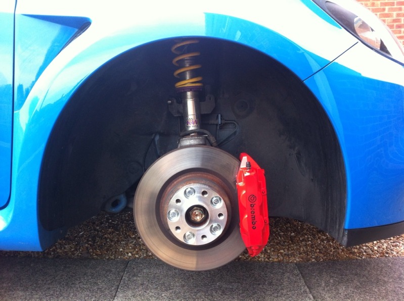

Painted the calipers bright red with black brembo stickers
Wheels painted gloss black.

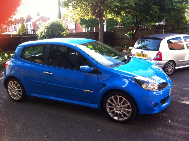

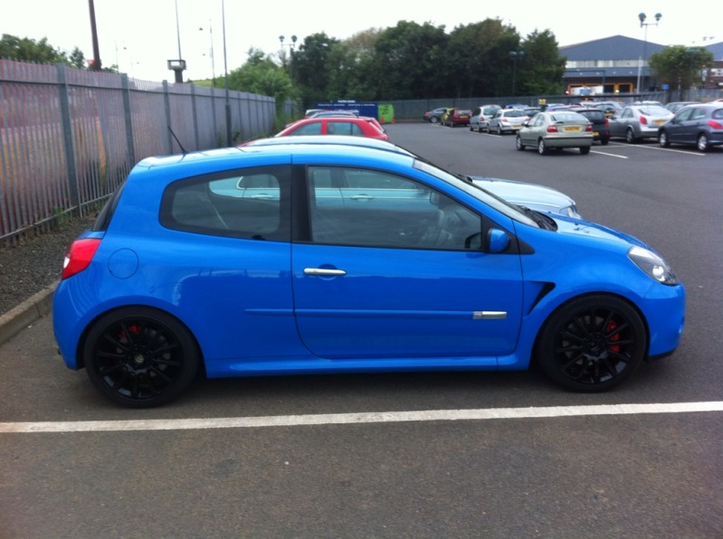

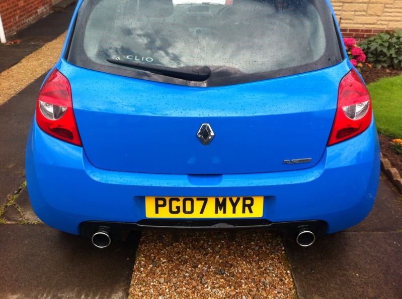

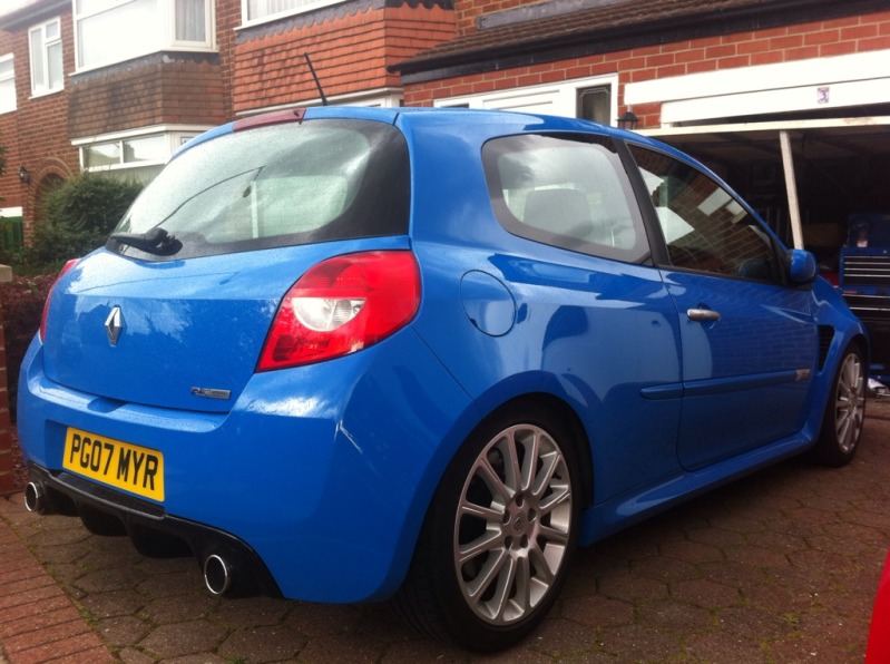

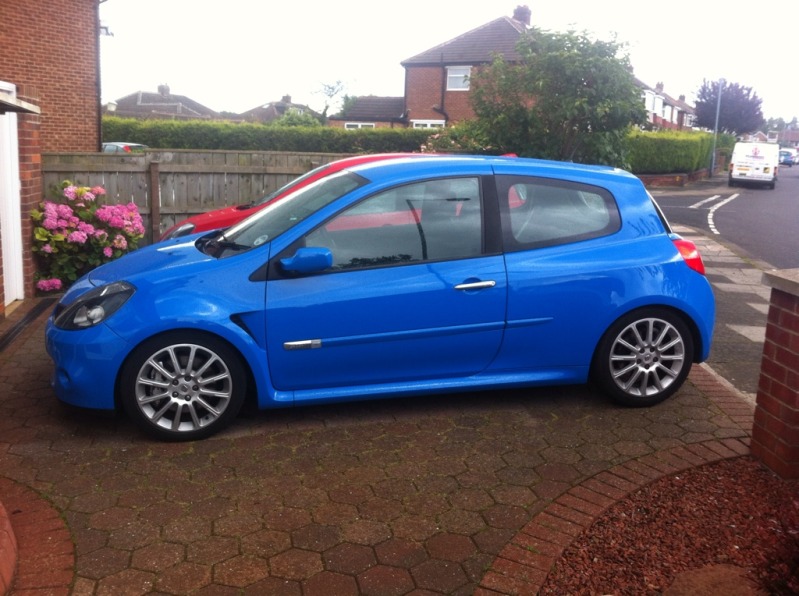

Couple of pictures of the new addition anyway.
When I got it totally standard :)
What it looks like now :D
Only other thing I would like to do is fit a Cup marmite spoiler. I just can't wait to get the sunflower back on the road.

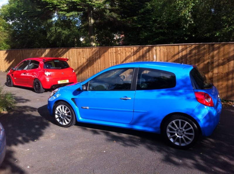

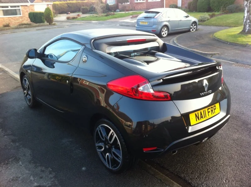

Quick snap of my girlfriends renault too.

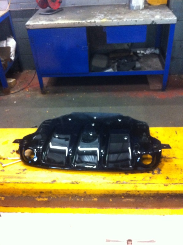

Did you line the defuser up against the flower? Always wondered if it would be do able

Regarding the diffuser i didnt line it up this time however i have tried it & cut a bumper to suit. A good few months back kris had to take his 197 diffuser off so we decided to put it up against the sunflower & see what it looked like, Ive got a tatty ph1 sunflower rear bumper so i cut it out to get the full effect but you would have to fit the 182 boot floor for it to fit properly. Ive got a picture ill post it to give you an idea.
