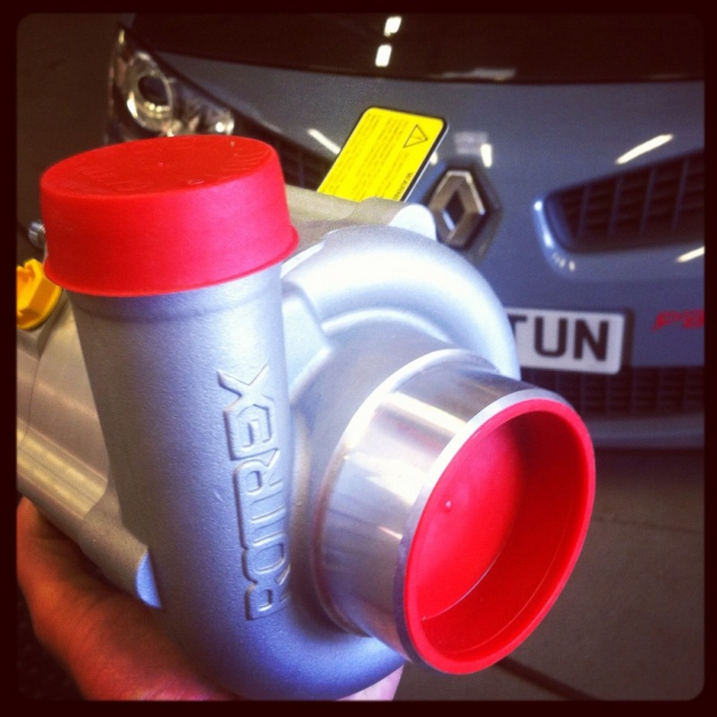

Just got back from Venice where I got engaged :D & picked up the new Rotrex C30-94 Supercharger from Paul's. Hopefully get to use the car over November before the tax runs out & it go's back in the garage for the winter & forget about is year lol.

Good times on the charger, I remember the day I opened the box for mine. They never stay so clean looking lol

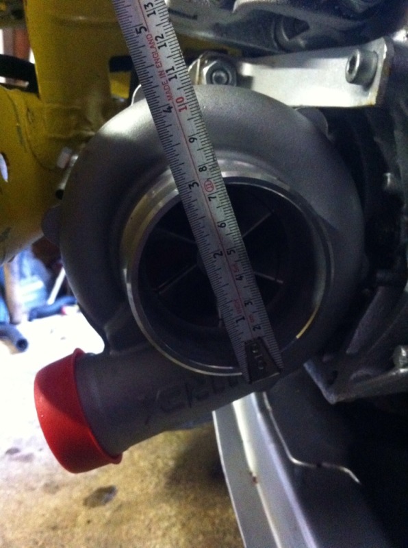

Quick update
I've fitted the new charger :-D

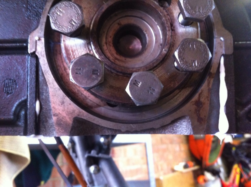

I decided to remove the engine after the seals went on the last SC due to having a small oil leak but I couldn't determin where it was coming from, either the gearbox or the crank shaft end cap, so whipped the engine out & took the gearbox off etc & that was all dry, then took the sump off & the end cap to find the engineering company I used to do some work to the block had put a tiny amount of sealant down the sides of the end cap (might as well not have put any in it was that bad) so cleaned it all up refitted it & put sealant in till it squirted out the sides, job done. Refitted the sump & gearbox & fitted the new SC.
Have been very busy lately so only been doing bits when I can but I had a day spare on Thursday so the engine went back in with the helping hand of my other half she was a massive help too.

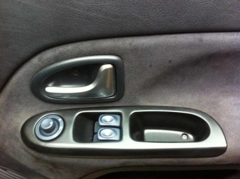

Few bits painted today - Statin black interior handles & dash strips done in sunflower yellow (they look a lot better in person & the colour match is spot on) but I'm undecided if I like them or they look tacky?

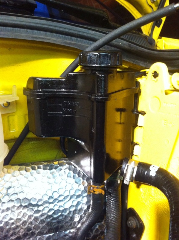

Also a better picture of the PAS tank I painted in the summer, done it in gloss black instead of the horrid OEM colour it was.

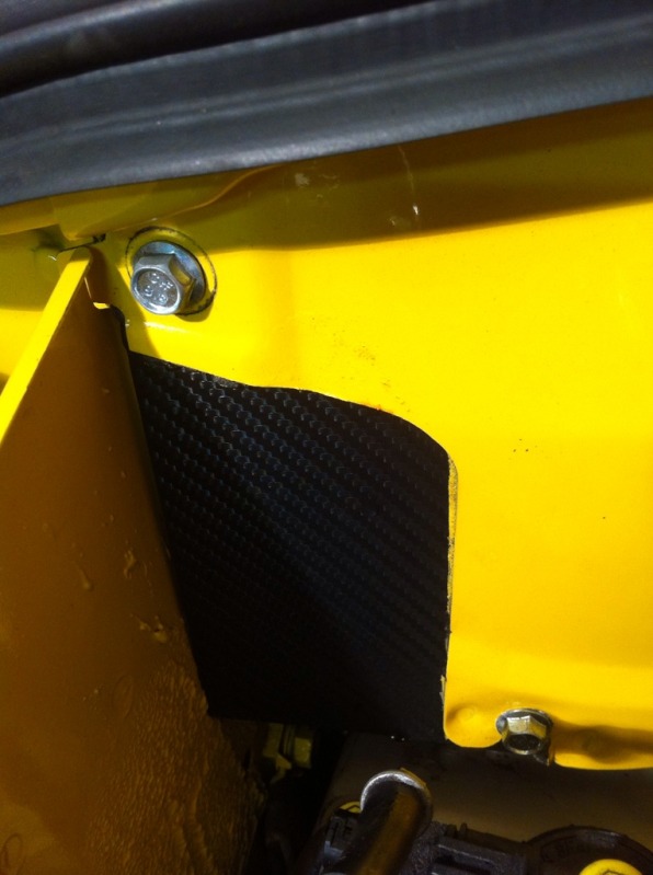

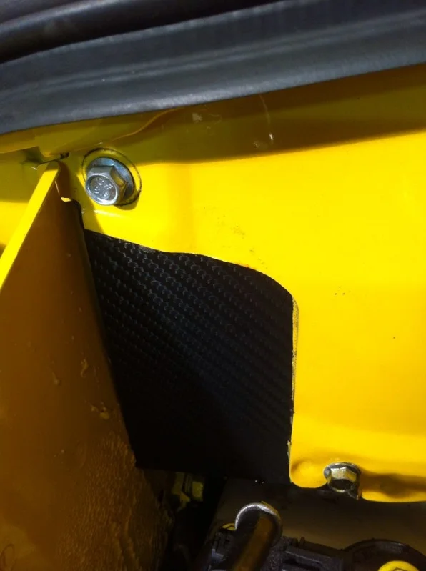

After removing the aircon I was left with the remains of the pipe work gong into the bulkhead, so I cut them off & cut a piece of perspex to fit the hole & wrapped it in carbon to tidy it up job done.
