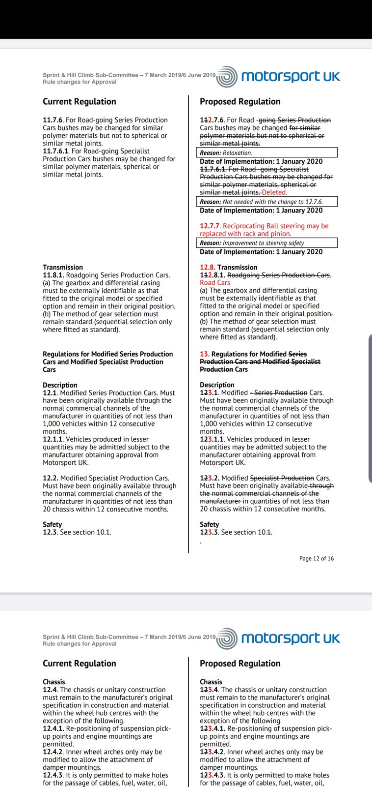

Yeah, under current regs you cannot replace components for rose jointed / metal replacements. Cant remember the exact wording. There was a few guys pulled for it in the scottish sprint and hillclimb championship along with solid top mounts. They were checking the whole of the class specifically for these. Some members did challenge it with the msa and didnt get anywhere

Do you know what time of year its normally confirmed on reg changes? This was my first season so figured I'd wait until they are confirmed and any specific Championship changes are done on the back of them before I spend any money!

Sorry cant help on that one
Just seen on facebook that all changes were scrapped due to the volume of emails they received but I wouldn't take that as gospel!
Big thing was they were relaxing the original block rule in modified class which then introduces engine swaps into that class. Alot of guys had spent years and £1000's to get the most out of their engine when now they can get the same power overnight and with widely available parts and gearboxes if the change goes ahead
