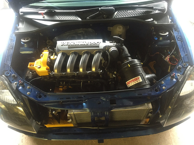

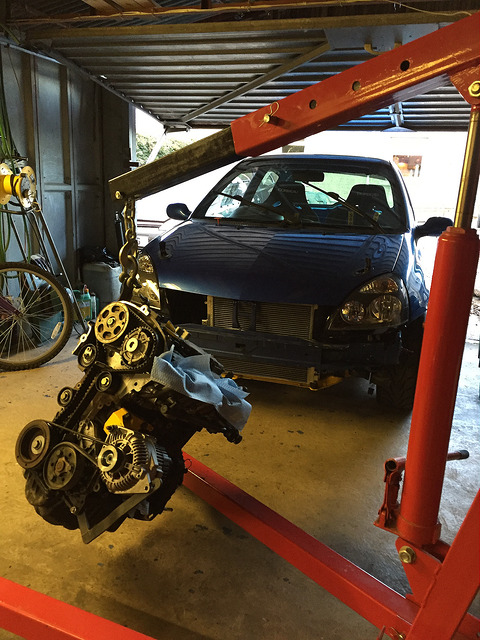

Been a while since I've updated. Was getting sick of the car sitting having no engine and was wanting to use it so starting hunting for a cheap engine. @Stu. came to the rescue with a ph1 engine, thanks again boss :wink:.
High mileage one with circa 130k, belts looked ok but no history and to be honest I couldn't be arsed doing them so just threw it in. Hopefully do me longer than 15 minutes unlike the last one!
Dropped it in last night then plumbed it all up this morning, love how easy these are when most of the engine bay is clear of battery and pas pipes etc. She's not as pretty as last time but I've lost interest in all the clean parts now just wanting it out.

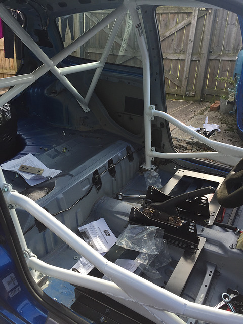

Well I've been sorting a few ends out this weekend to prepare for this track day.
First was getting the cage in and pads welded. Some piece of kit the safety devices cage, very impressed!

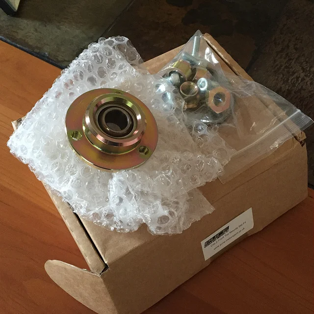

Then had a bit of a boredom streak this week staying up Aberdeenshrie with work in the arse end of no where, hit the Internet and bought a few parts:
Also ordered some cm composite brake ducts which will hopefully be here soon.

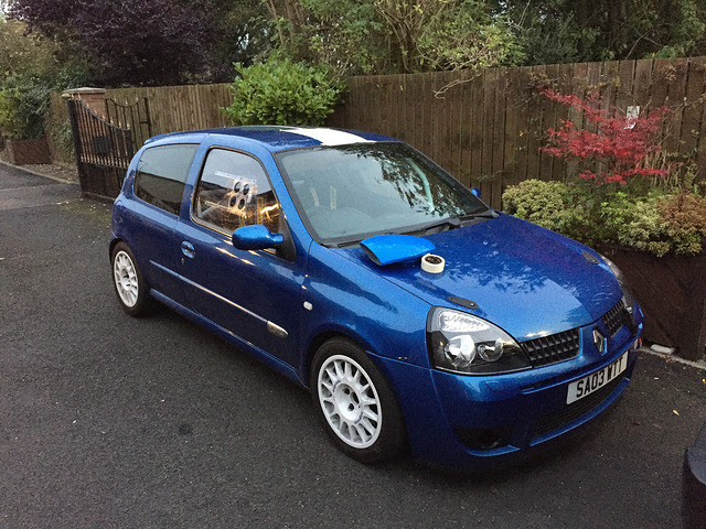

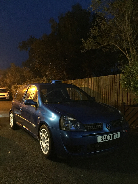

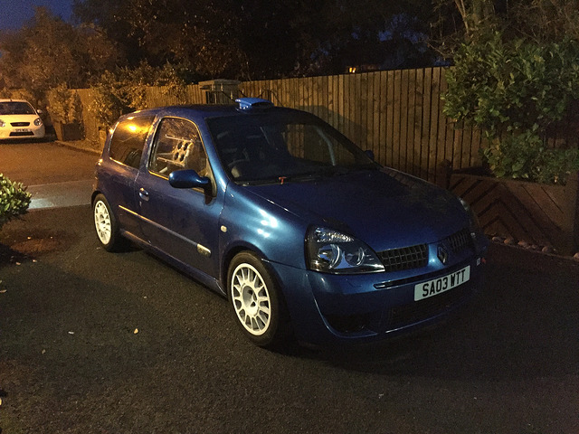

And tonight quickly put my roof scoop on that I'd forgot about. Lost the light towards the end so not the best of photos.
Just little odds and ends now, geniuinly feels like this is never ending!

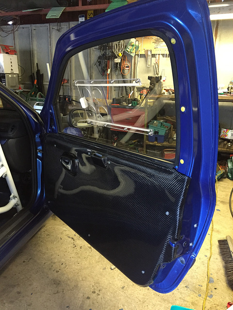

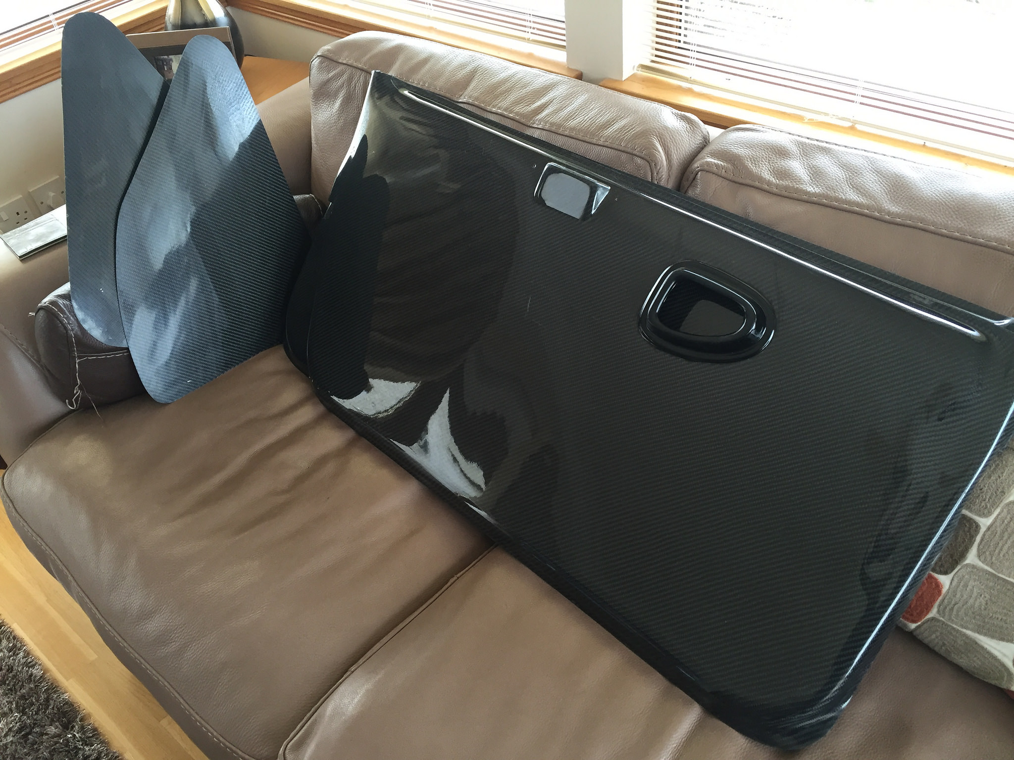

@Arran_ can I ask how have you mounted your plastic Windows in the front have you just glued them into the seal around the edge?
  Clio 172 & BMW 335D
I've actually still do fix them in mate. There holding there self up just now, I think I'm just going to stick a bolt through the bottom to keep them up.
Ahh right I see are hey easy enough to fit? I have just ordered a full set for the car the back 2 and the back window I'm sure will be easy to fit just bond them to the car however the front seem a little more tricky any tips?
Rubicon_
  Defender & Westfield
Yeah very easy! With the door cards off you just remove the mechanism for the old window couple of bolts, hardest bit was getting the plastic part out the glass (there is probably an easy way to do this, I ended up smashing one window by accident). Glass just then slides out then slide the plastic ones in.
  Clio 172 & BMW 335D
Brilliant sounds easy enough, I'm not to fussed if it smashes it doesn't go on the road anymore. Did you smash the back and side windows or jail eased them out?

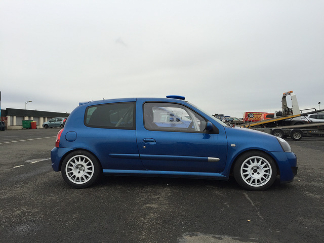

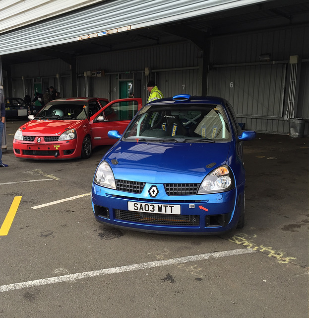

Well Sunday finally saw my first track day! What a great day, really enjoyed it. Was the first time id ever pushed a car that much, very impressed with how well the car went, and best of all no issues :smiley: Enjoyed the track also, was a bit greasy in the morning but once dry i gained a lot more confidence. Took me a while to go through duffus dip with some speed, something about entering a blind corner i couldn't quite get used to ha!
Thanks to Fraser and Craig for their advise during the day as i was a bit lost at first haha!

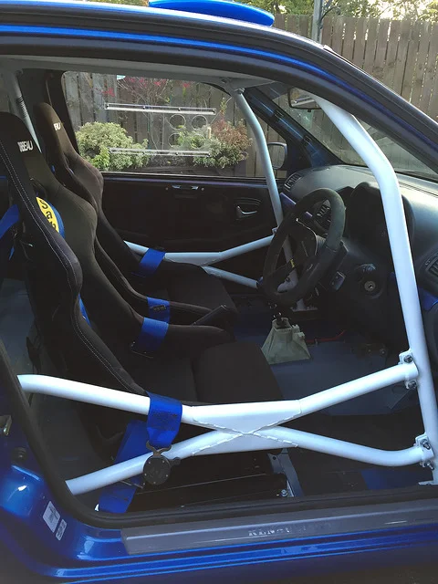

So yeah in terms of the car i couldn't fault any of it. Was a short and sweet year as that will be the only track day until next year. No real plans over the winter, although I'm going to have a bash at giving the interior a quick spray to tidy it up and then will just be little bits and bobs. Im definitely done with spending... for now 😂. I think next year I'm going to get the track tuition session to brush up on some skills also :smile:
Some pictures from the day and a couple of the full cage now fitted and the new door cards, sadly none on the track yet.
