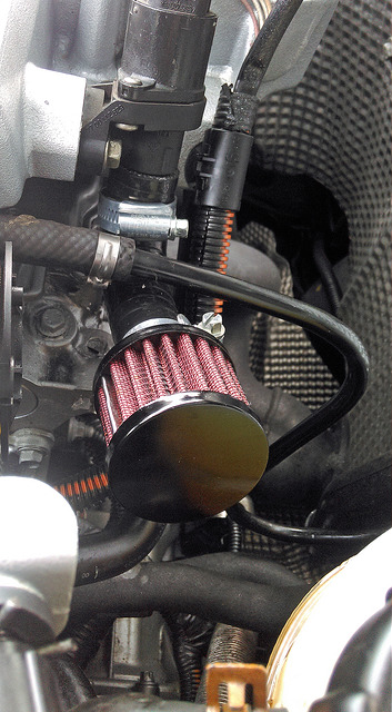

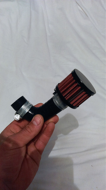

My ph1 box has been rubbing the rad pipe for some time and I think it's only a matter of time before it cuts through, maybe.
Might get on this little set up but just wondering what most do with the oil breather? Don't think mine breaths heavy or anything but just curious.
Ol’ Tarby
  Clio 220 Trophy
Use the standard elbow, plus metal joiner and then filter. Keeps the standard oil breather then
Adamm.
Cheers lads I'd probably do as above with the standard elbow seen as I'm not fussed about it looking pretty. Didn't really consider that lol.

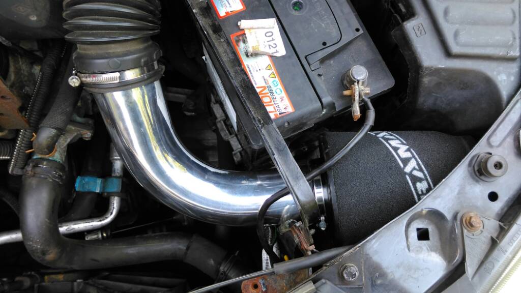

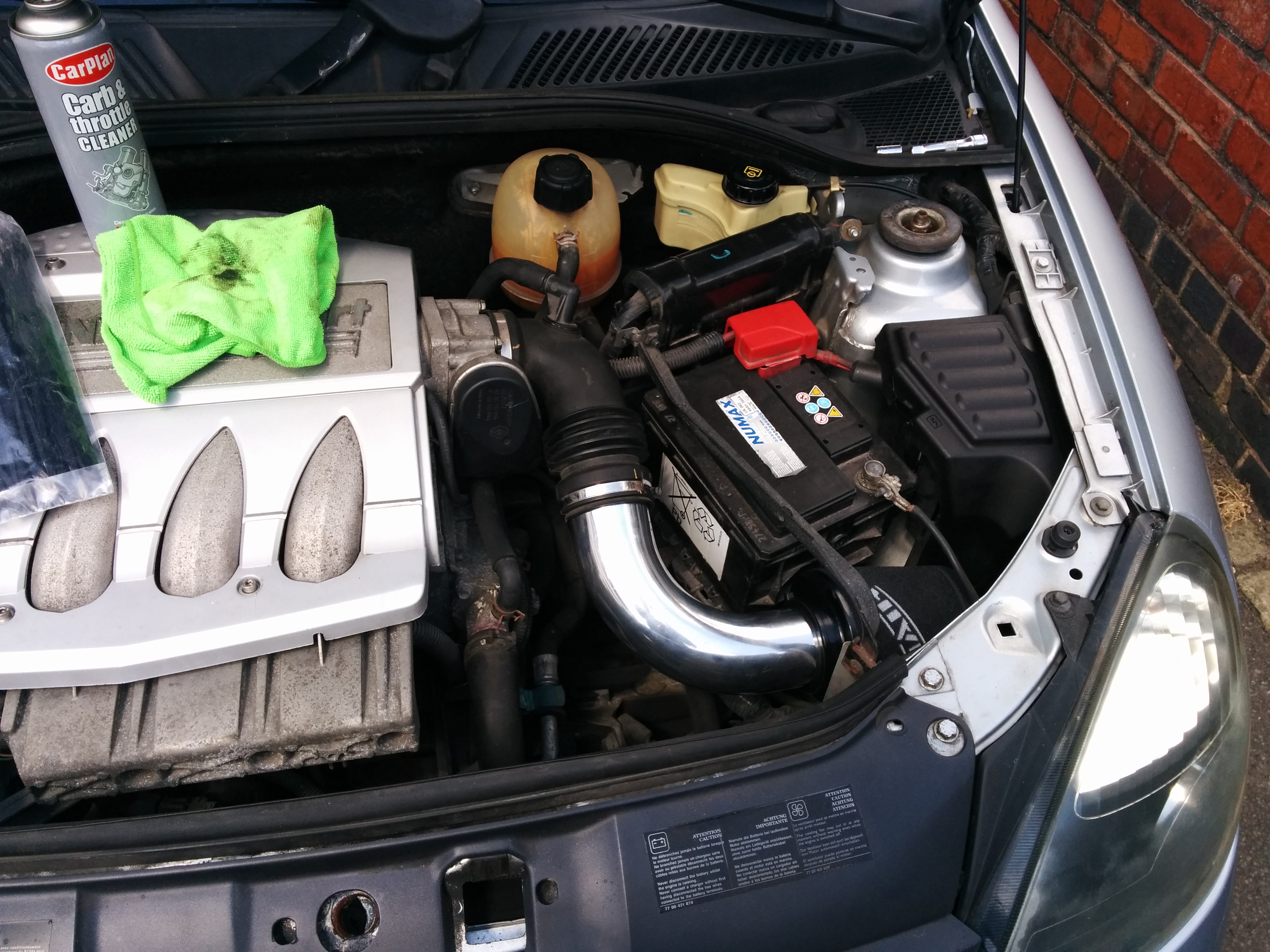

Well fitted mine today and I have to honest I'm not impressed. I have a really bad metallic resonating sound which is driving me potty. I've noticed that my aluminium pipe is about 5cm longer than the one on the front page. Surely though the extra length wouldn't make it resonate or would it?
Pic of my install
I've tried cable tiring it on place moving the pipe and filter but still makes no difference.[emoji20]
Anyone else's doing this?.
I may well cut 25mm off each end and see if that makes any difference I will though lose my flange
  172
Yep tried this still makes no difference . Still got this awful metallic resonating. The feed for the acoustic valve is all blocked off as well.
  172
No not yet just loosened it all and tried moving it about. It's v tight in there I'm using the bigger filter and with the pipe being longer I'm thinking this is my issue. I'll take a part and report back.
It does sound impressive at 5k if only I can get rid of this initial resonance it has. I'm only hearing it with the Windows up so I'm guessing the extra length of pipe is making it create the noise.

Had it a part cut my pipe down to the right length and its still making a high pitched resonating sound when you just touch the throttle. The only thing I can think is that as the pipe is aluminium it's making it have a high pitch resonating whistle when the throttle is just touched. Certainly turns heads when the throttle is fully open though. I have to say the jury's out on this mod. If I can get rid of the annoying high pitch sound I'll be happy.
  172
Is it the metal pipe touching the bracket area? Stick in a piece of sponge or similar to stop the metal on metal
Already but a pics off piping on there. So no noise.
Looks like it should be. The filter ok etc?
Yet filter is fine where it is. It's a right fit. It's touching the battery and the fuse box cover.
