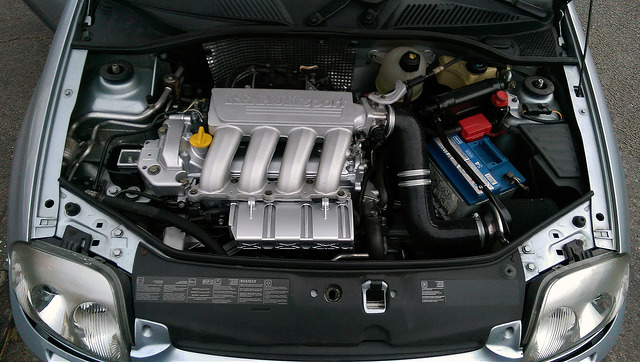

Are people still having problems with dirt entering the manifold?
  Clio II 172 RS Ph1
10/10 would agree again :)
Cheers @McGerkin. Was considering this for my next mod but don't think I'll bother. I'm not that desperate for a bit of shiny pipe

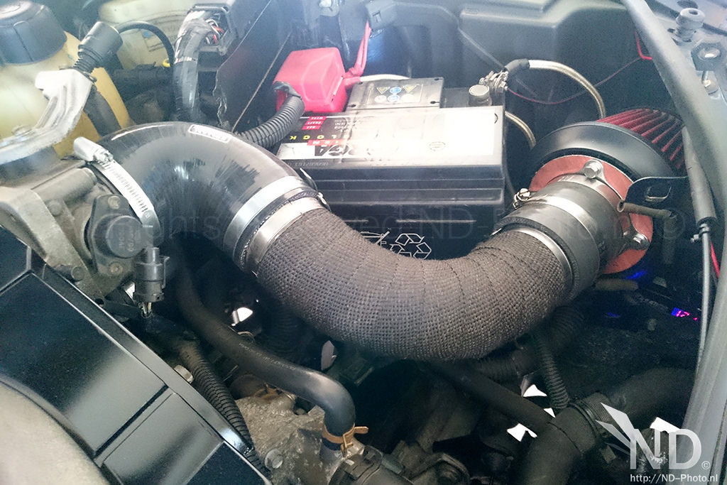

Shiny pipe? Use heatwrap or silicone and shinyness solved...

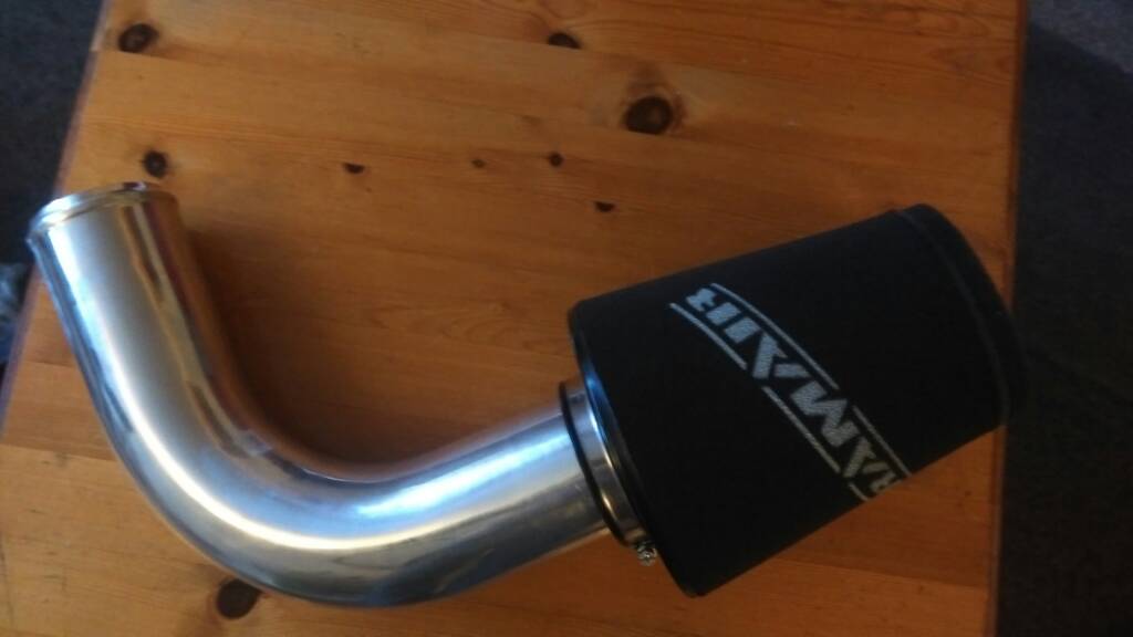

Well I gave in and purchased a fatty kit. A bit of test fitting tonight looks like it's going to be tight
At the weekend I'll remove the acoustic valve and fit this

I've had to remove mine. Fitted a new battery which is slighlty bigger than the original so now there's no room for the pipe to pass between the battery and bodywork.
Might take a hacksaw to it at the weekend though as I miss the noise

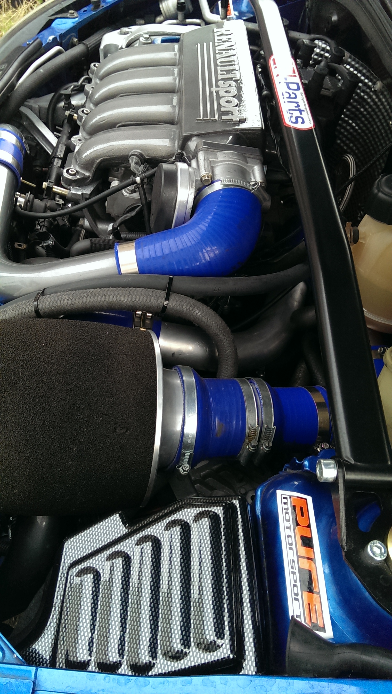

Ordered this for my 172 cup , does the filter need to be oiled ? Filter has turned up but no mention of oiling it in the paperwork

I think so mate. Mine seems pretty dry so as a precaution it's probably worth doing just to be on the safe side
  FF Titanium 182
I still run mine, sound is awesome and never had a problem! They come pre-oiled purchased mine November last year and havent oiled since and its fine could probs do with a clean tho!

It is louder. And tbh the fatty kit is £40, second hand ktecs are £100, I'd stump the money up and buy the latter if noise is a concern. But both are good

Ktec one is definitely louder but you can make your own that looks very similar (black pipes, black clips, black filter, black paint if you can't get the black stuff) for around £60 which is noticeable cheaper than ktecs.

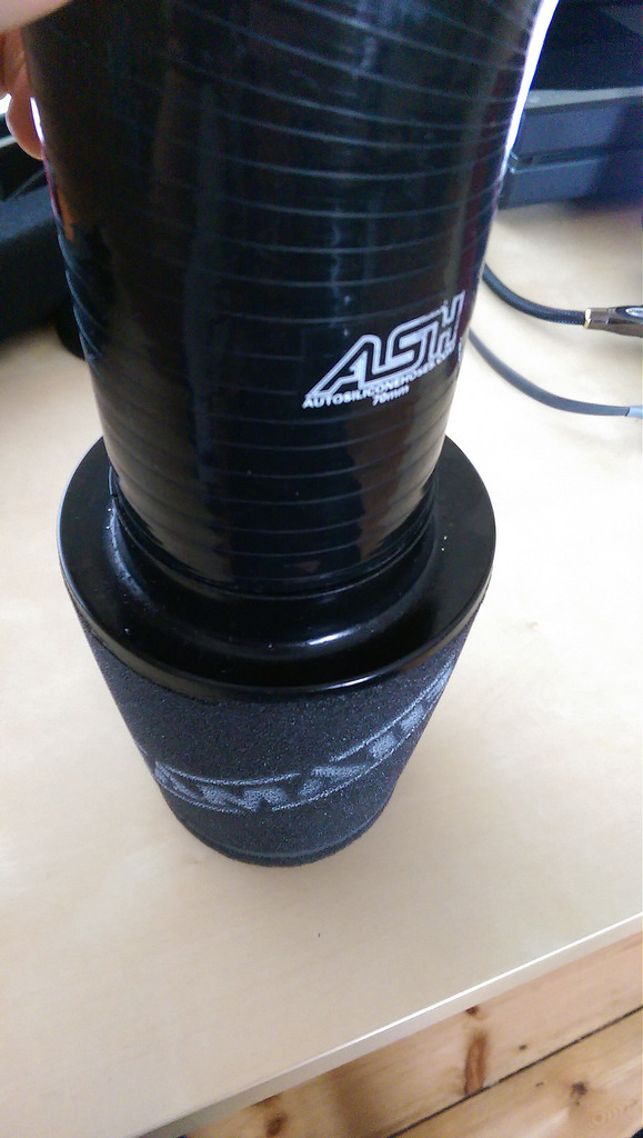

Ok, so airbox has been removed. Next issue is how to get the hose and the end of the filter to attach!
The hose is a good few mm smaller than the end of the filter. I thought this would have been the other way around?
