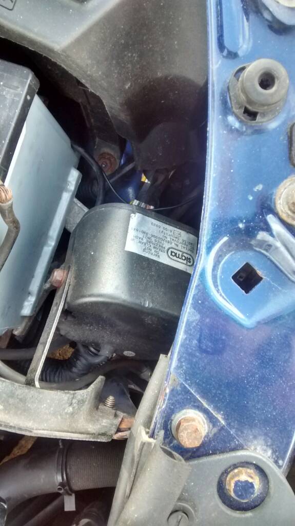

I think I've got the horn in the way, where do I move that too? Also anything else needed to be done To get more air into that area?

The horn is near the foglights. This filter set-up goes from the throttle body to in front of the battery.
What's this in the way then?

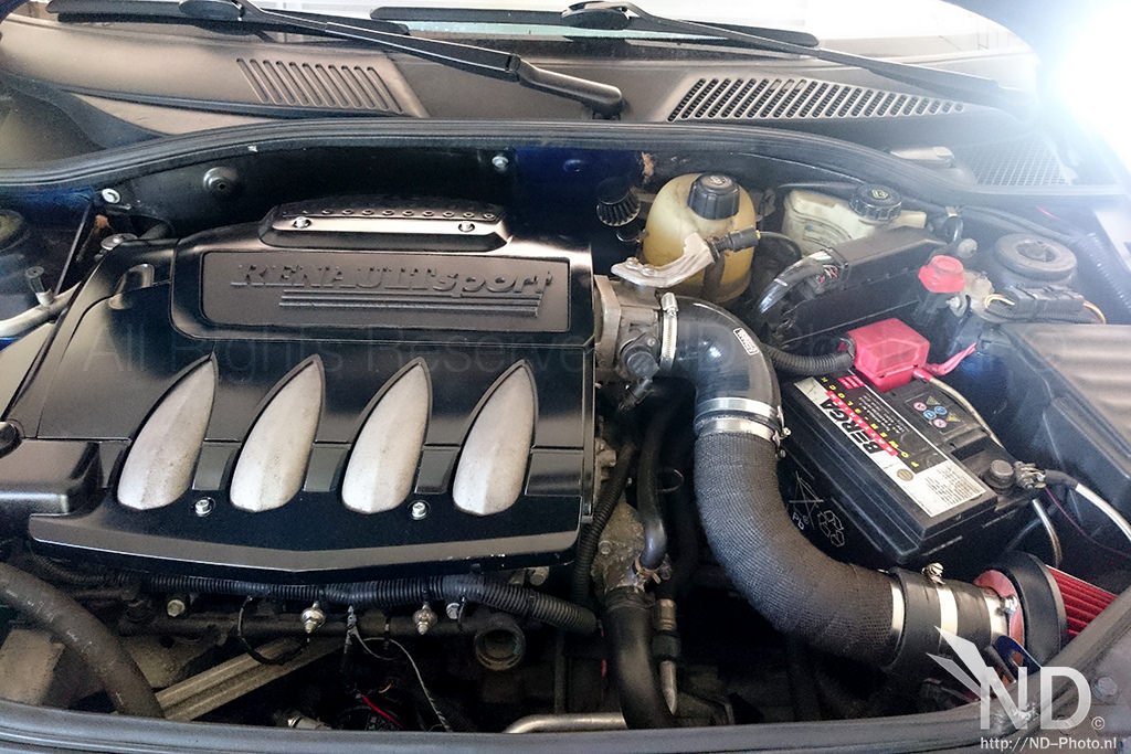

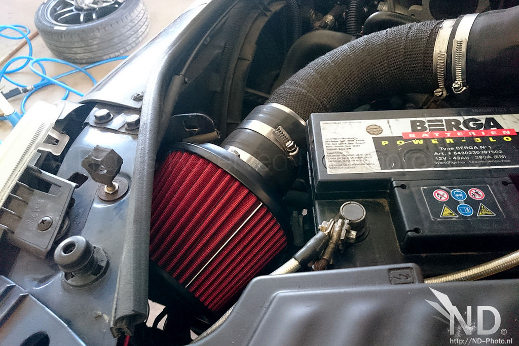

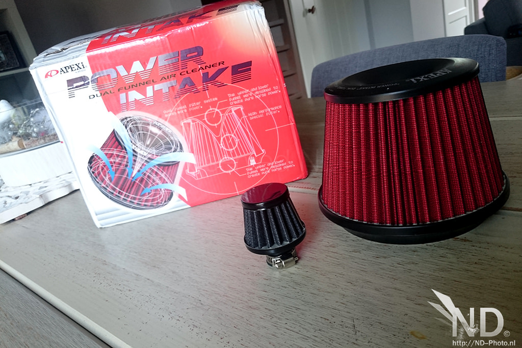

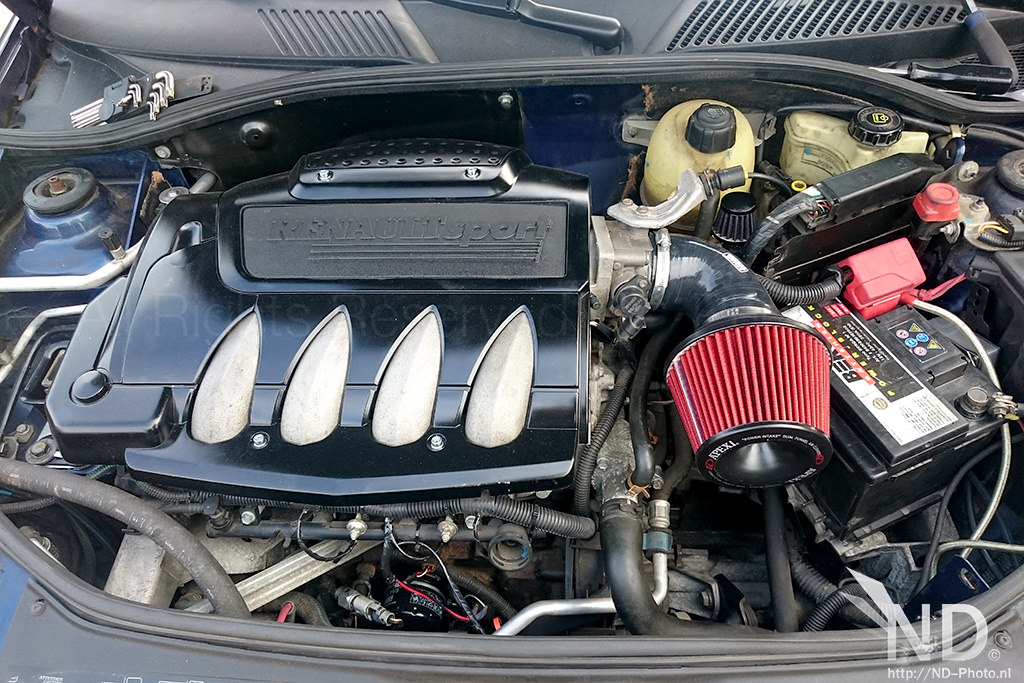

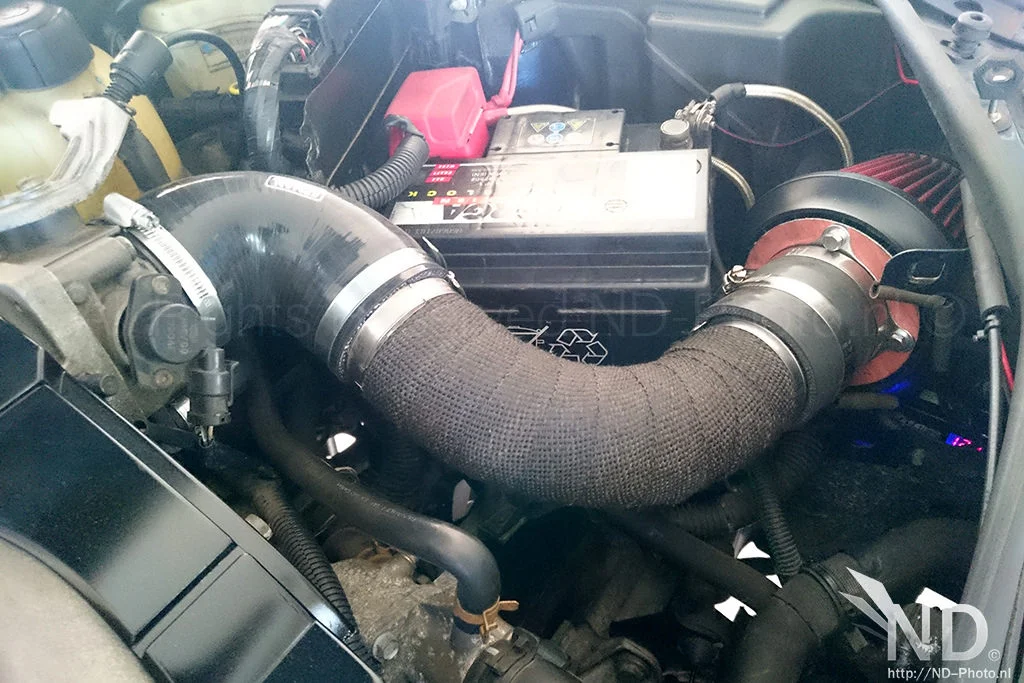

Hiya, this is what I created not too long ago, after being inspired by this thread. The ICV has it's own breather filter using a 18mm plastic coupler and breather filter. Unfortunately no dyno numbers to backup the performance, but it sounds and feels awesome :smile: The car "feels" more alive now and the induction noise has to be enjoyed everyday
Base products
Apexi Power Intake + Breather filter by Andy Ramdin, on Flickr
Initial setup with 90 degree silicone (not all parts delivered yet, but couldnt wait so went for it hehe)
First CAI mod setup by Andy Ramdin, on Flickr
Then the final build
Apexi Closeup by Andy Ramdin, on Flickr
Custom Cold Air Intake Overview by Andy Ramdin, on Flickr
Custom Cold Air Intake by Andy Ramdin, on Flickr
So what did I use?
- 1x 18mm plastic coupler
- 1x 18mm breather filter
- 1x Apexi powerfilter
- 1x 70mm 90 degree silicone bend
- 1x 70mm 90 degree aluminium bend
- 1x 70mm to 76mm silicone reducer
- A bit of heat wrap
- Some jubilee clips
[edit]
90% of the stuff was bought on Aliexpress, so quite a cheap mod!

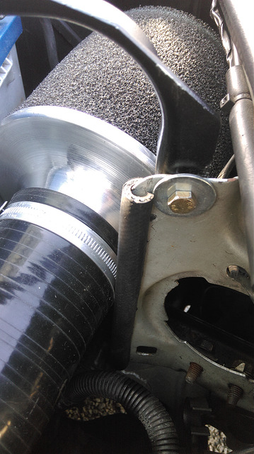

The only place it is rubbing is by the filter, but it is resting on the jubilee clip. But would rather have a piece of rubber there instead to add more protection. Also would like to shorten the jubilee clips as they could look a little gash.

Just get any old rubber to stop the chafing. I think I used a old bit of hose and sliced it down the middle!

Ohh shhhhhh!! I got a little too excited fitting it so may have forgotten to remove it, plus there is a cable tie on it, but can always relocate that. Also how have you secured the hose in place to stop it vibrating?

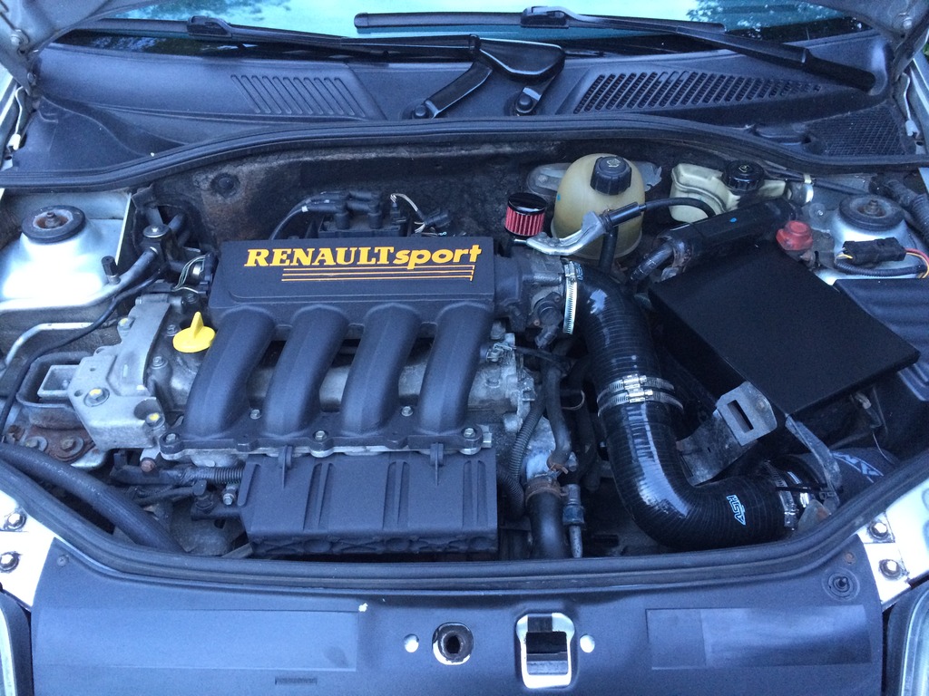

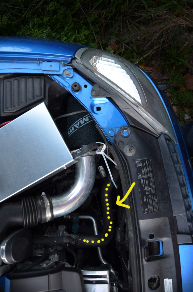

  RS182 Full Fat
Why leave this bit on? (see pic). I have the same induction kit but i pulled that bottom air feed out as that is no longer directed at anything. Thats the one that entered the bottom of the Oe air box?
