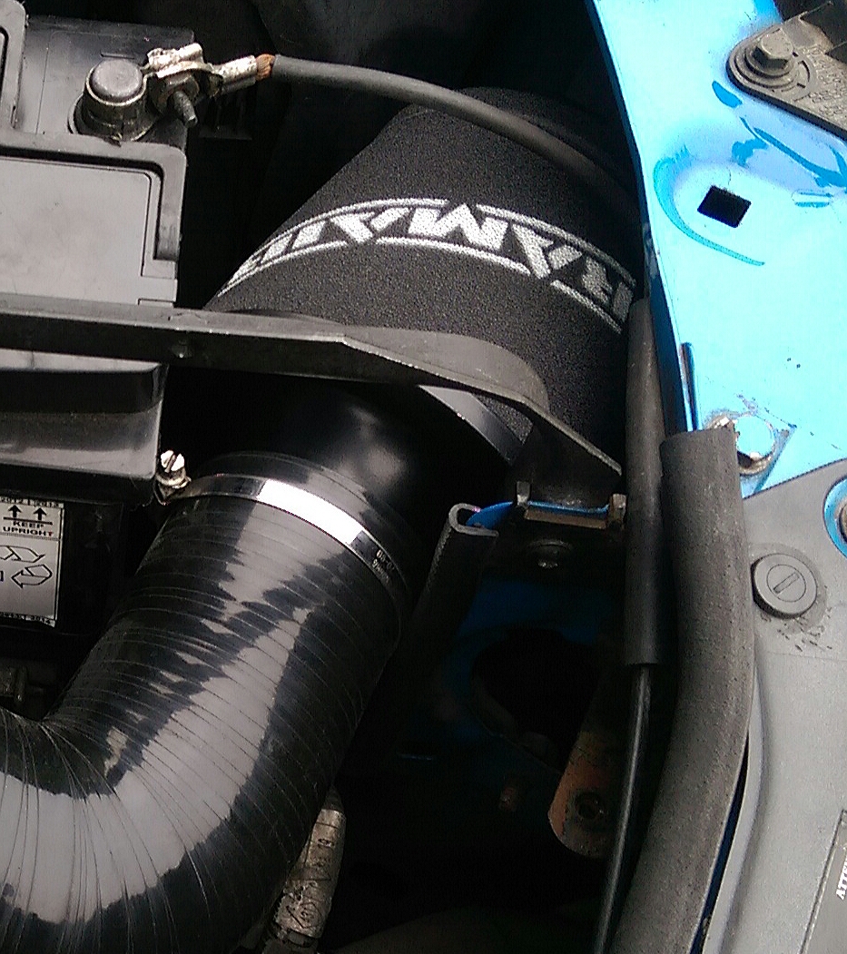

How are well all securing these then? Been running mine for around 6 months now with it just hanging and wedged under the battery ground wire. Is it a case of zipties to the nearest panel or what? Noticed the rubber on my ramair is starting to split at the neck as well which is annoying :/

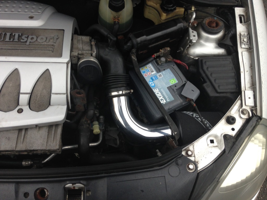

Just been out installing mine as the polished pipe came today:
Didn't need cable ties as it's wedged in tightly between the battery and headlight. The pipe rests against the metal where the old air feed went, which is a little annoying as it will scratch it but all in an easy setup. Been for a very quick drive and definitely more throaty sounding above 3k rpm but not as loud as I had imagined. A whole lot neater than the oem setup.
Jekyll
Mine has a note change at 2.5k as well as 5k.
May try and get a video later in the week.
Also, I've put a bit of rubber strip on the brace so that it doesn't rub. Not really noticeable on mine as i have silicone pipes but it's worth a try on the ally bends.

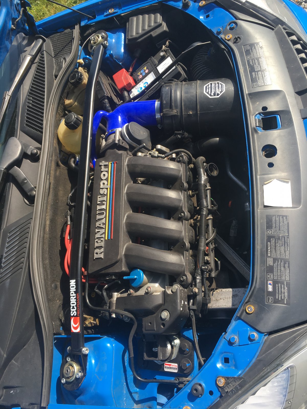

Fatty Kit fitted (with the larger RamAir filter). Initial thoughts:
Love the sound!!! Makes it a lot deeper and more meaningful. Only really kicks in above 3000rpm with a decent amount of throttle. Cruises quietly on the motorway still so hasn't ruined everyday driving.
I was worried about a loss of performance, and it has definitely changed. Initially it bogged down a bit before the 5k kick, but after driving for a while it all seemed to smooth out. I honestly couldn't say if there is more or less power now (which is a good thing). However the 5k kick seems smoother than with the standard airbox. Anyone else think this?

Pulled away earlier today and heard a metallic clanging sound. Thought I'd snapped a spring! Turns out the jubilee clip had popped off the air filter neck and was rattling around on the alloy bend! The twisting of the engine on its 12 year old mounts must have shaken it loose.
