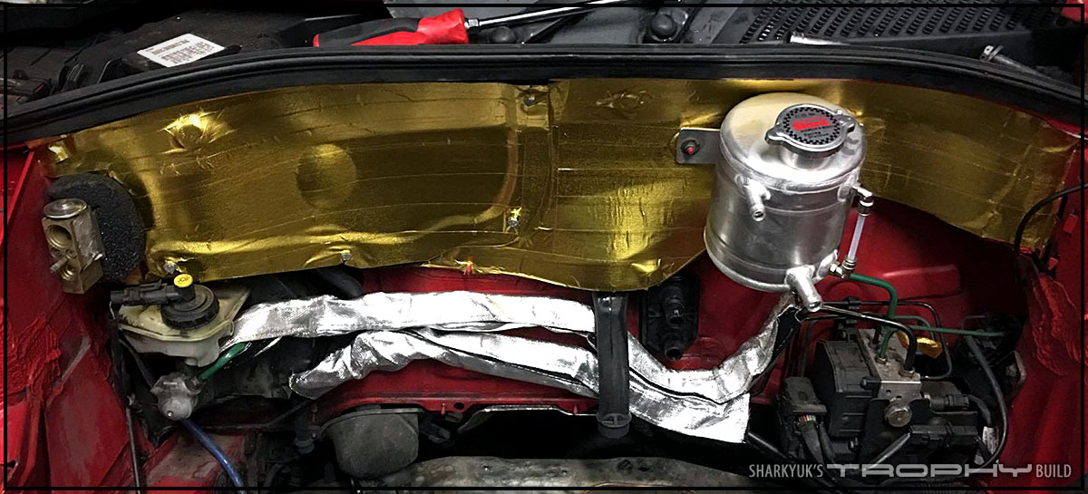

The standard PAS is being ditched in favour of EPAS; it frees up some room in the engine bay, means that some of the pipes can be removed and stops the possibility of the PAS fluid boiling where the lines would normally run by a very hot turbo.
In other news, the loom is shaping up with the various sensors being added, traction control, etc. and things like heatshield / wrap, fuel regulator have been ordered and are on the way. The Trophy is also booked in with the welder / fabricator to have all the hard piping sorted and then it will be off to the powder coaters to make it look pretty. I'm hoping to have a few photos soon.

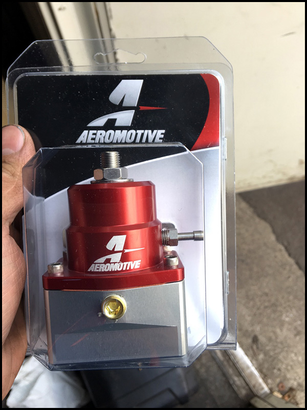

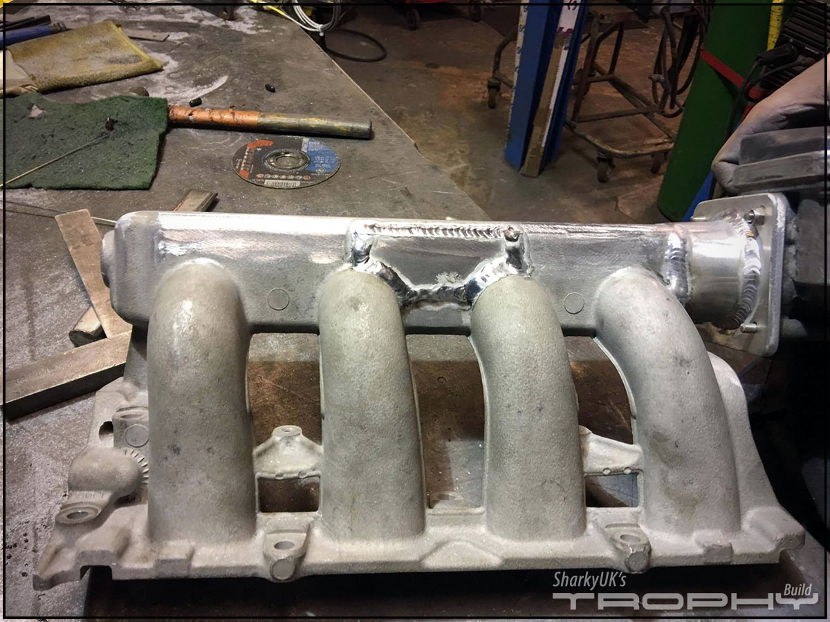

The project is coming together bit by bit as pieces start to fall into place. With a bit of luck (and a bit more money as is always the case with modified cars!) it should start to resemble a Trophy again soon :) In anticipation of said times, here is a picture of a pressure regulator (thanks to Dan for the pics in this short update).
Exciting stuff. More on the fuelling side of things in a moment...
Hot off the press (well, the fabricator's workbench) this turned up a few hours ago.
After a bit of jiggery-pokery and black magic it should be just the ticket. Later this week Dan and the fabricator are meeting up to get the hardpipe and fabrication sorted. I'm not going to give away too much yet but I think Dan has something on his mind to try so I'm looking forward to seeing how it turns out. Once that has been completed it will be off for powder coating. It's not going to be a Queen of the Concourse but there's no harm in making it look good, right?

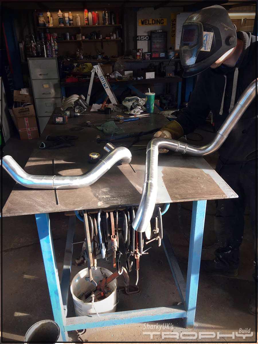

As mentioned in previous posts the fuelling system is being revised, hence new connectors, braided lines, swirl pot and so on. This has presented a bit of a problem due to the way in which the new setup will work and how the swirl pot will be located. There's a bit of interference from the backbox of my exhaust system hence it was potentially going to require alteration. However, after a bit of a discussion with Dan, it became clear that the better option would likely be to remove my current exhaust system and to upgrade to a custom setup with decat and a wider 3-inch size all the way from the turbo down. This would be less likely to cause a restriction and consequently a sudden levelling-off of power. As a result of this there may well be a Clio 182 Pro-Speed stainless exhaust system for sale very soon.

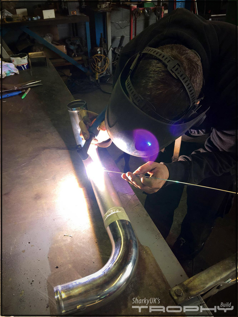

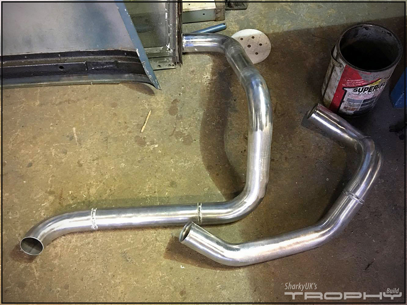

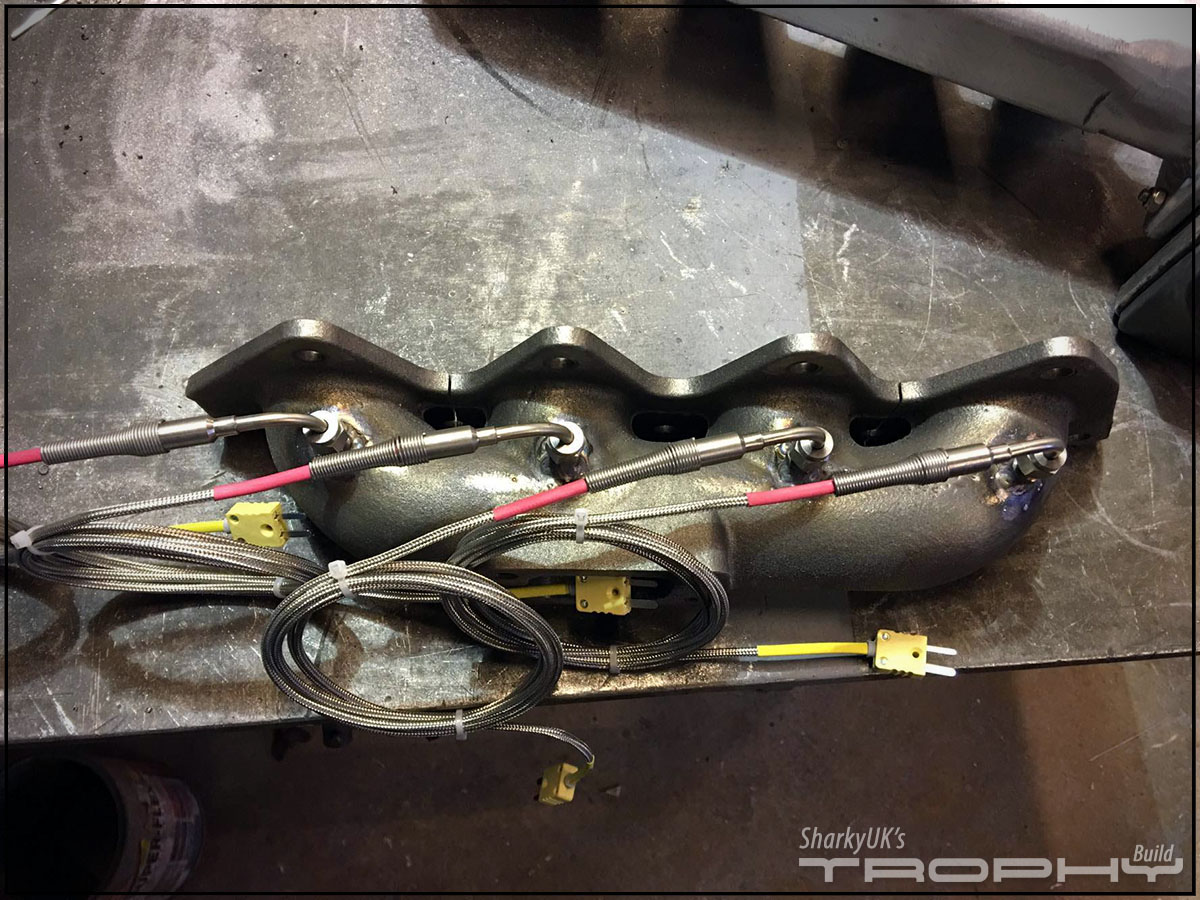

Here we go, another quick update and a few more images. As you can see below, the fabrication is now underway and parts will soon be off for powder coating. With a bit of luck they will come back pink so as to match the Trophy's colour perfectly :) Well, that's the plan...
Once it's all done and put together it should look pretty sweet in the engine bay. The folks helping me out have gone out of their way to do so and I'm excited for what's going to come out of this.

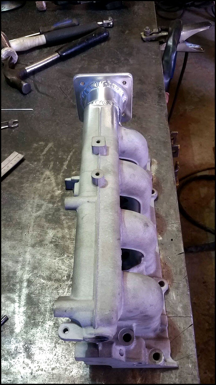

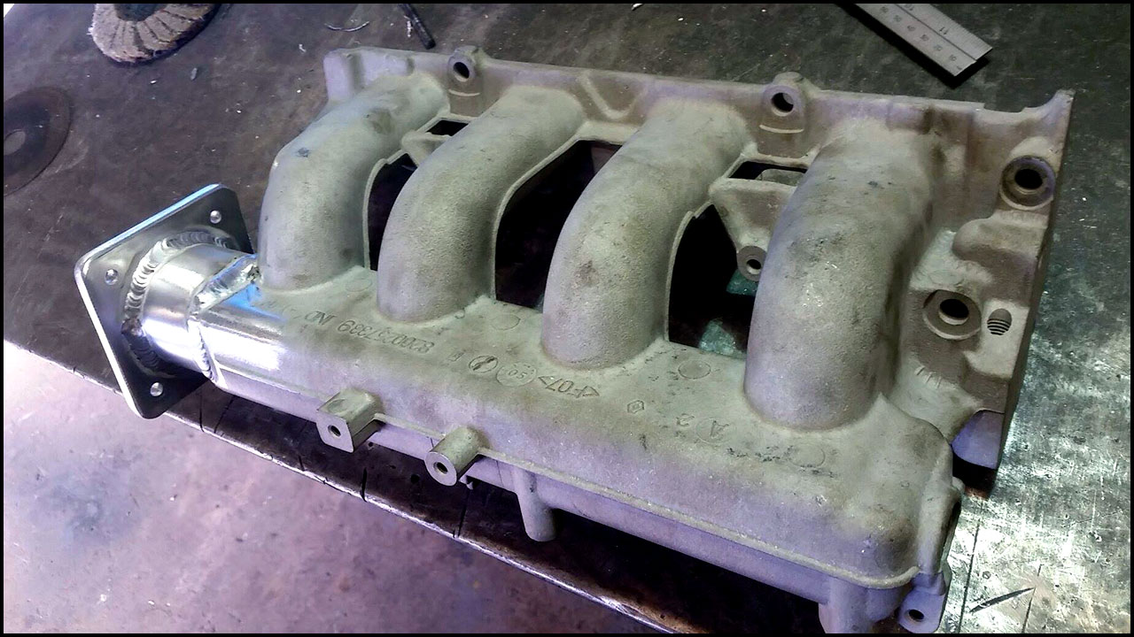

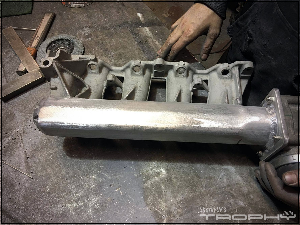

Ooh, she has a new heart :)
Shiny bits :)
Again, a big thanks to Dan for the photos and his work along with the fabricator :) Top drawer!
Proper job!
Definitely mate. No more faffing around :tonguewink:
Nice that!
Trophy-K Extreme unlocked edition :)
I don't see a mounting for a blow off valve or IAT?
Worth ensuring their done before it gets painted
What Dan said :)
The plate in the underside of the manifold is for all the take offs and sensors. It'll be running low enough boost to not require a BOV. But we will also be mapping in NLS.
