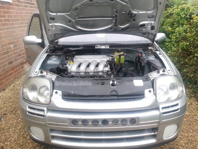

Got the servo fitted and brakes bled today, and then had a little test drive.
also had time to install my polycarb front windows!
Few bits of tidying up here and there...
So yeah to conclude - the steering wheel is not straight at alll but it seems to track straight... kinda pointing the finger at me not putting my QR steering wheel on properly or something to do with me not connecting the upper and lower dci column on straight...
Also the brakw pedal is quite spongy and more annoyingly the brake bias has diverted itself to a 50/50 split so when I brake hard the rear locks up! I would of thought the cup compensator valve sorted that out...
anybody got any input on those problems?

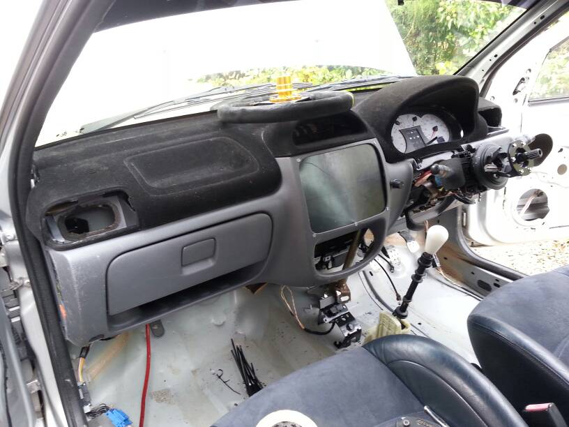

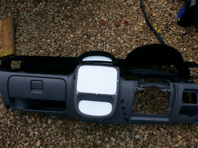

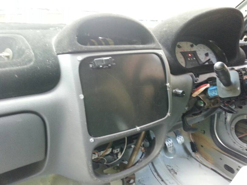

Some bigger updates on the interior - ive choose to put the lower dash in even though I cut it.. bit of stitching up, drift style yo.
To continue with using the lower dash I still wanted a big flat surface to mount switches on, so I cut abit of a flower basin thing, and put that on, see below.

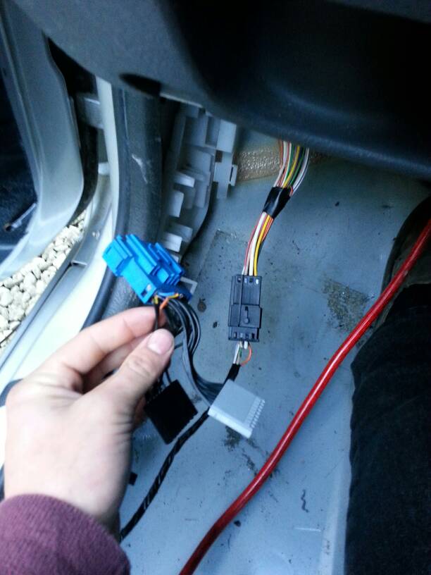

This morning was spend putting on the passenger side door card, and fitting the OBD onto the dash. Haven't got a pic of the door card, but you know the message measure twice cut once. yeah well that didn't happen... I gutted the inside of the door a bit to much, so it doesn't really fit... hehe oh well excuse for FG doors then ey

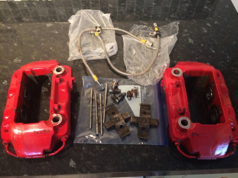

Accidently gone and got myself some 4 pot brembos... After all this time saying they wernt needed, got them for a very good price with repairs need to the bleed nipple thread, which won't be too hard.
So just need to source some brackets, and then have a play getting them under oz f1s...

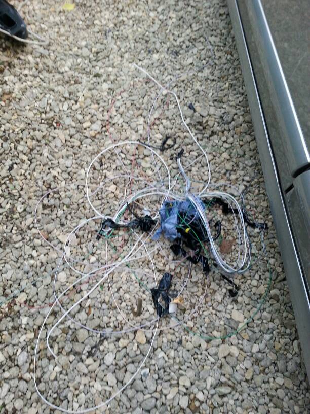

Managed to remove this join that's been annoying me for the pass couple of weeks.
Tidied up the rear loom a little bit more
finished it off by relocating it through the panels, with the loom all wrapped up noicee.

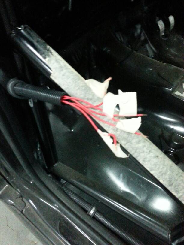

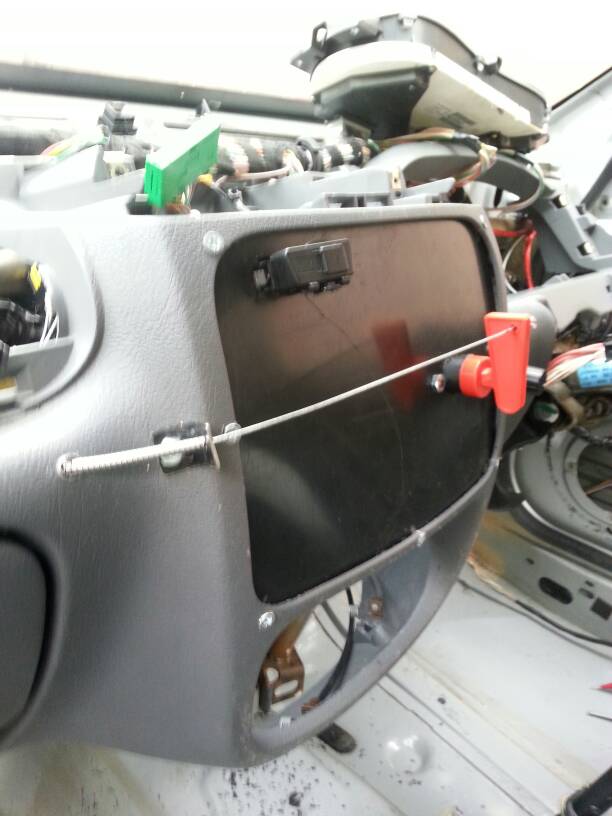

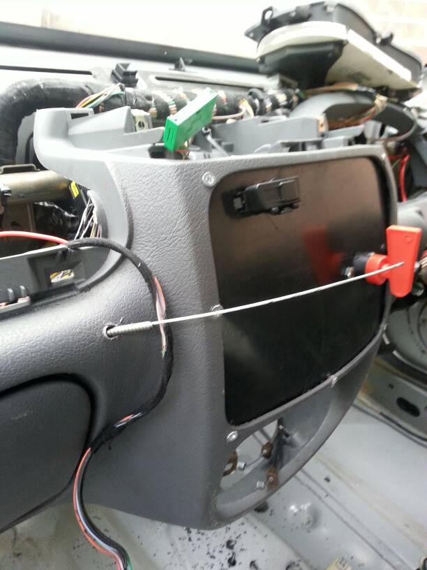

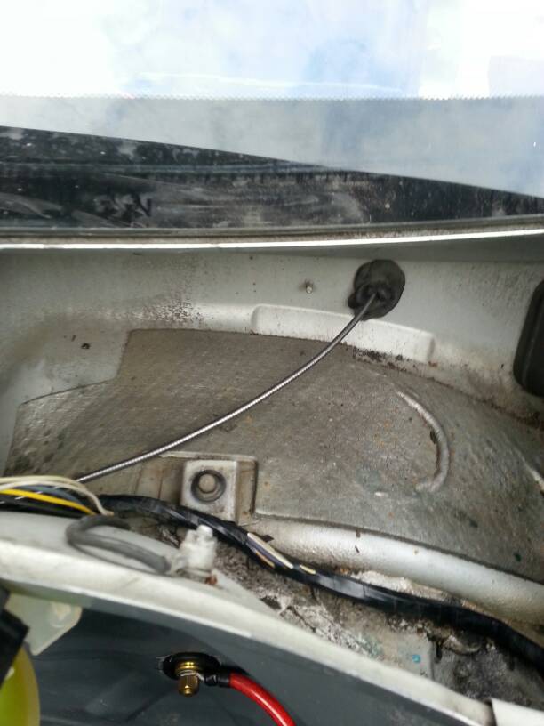

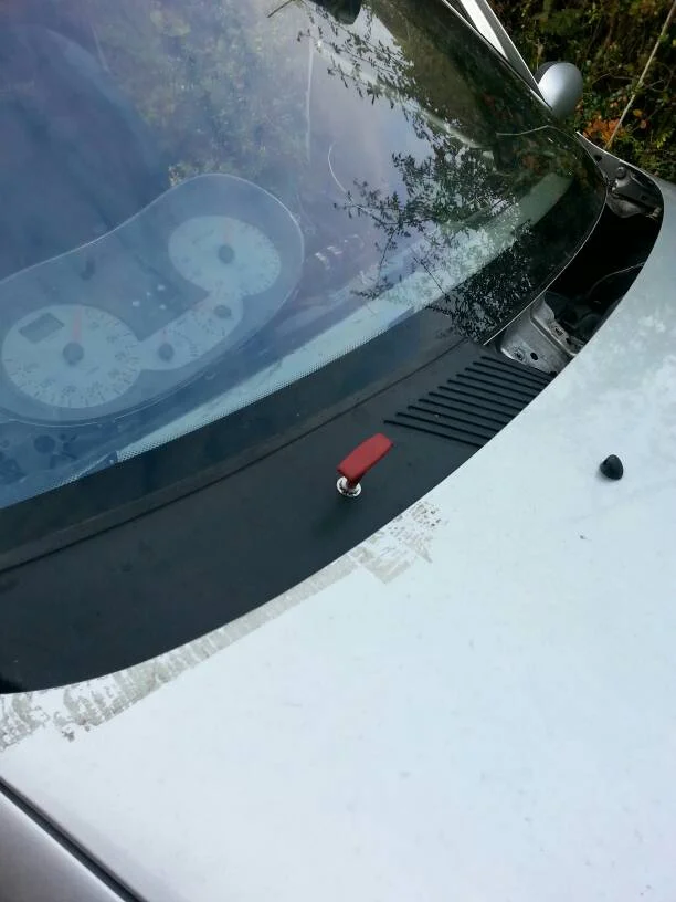

Started fitting the battery master switch and pull cord.
used the alarm wiring grommet/silicone mess...
And this was the outcome.
Not really happy with the way there so much uncovered wire that could quite easily be pulled while snatching a gear (maybe)
But im happy overall. ...
Now just the fun wiring part, I'm a bit unsure weather I'm gonna follow the standard feeding the live cables through it with the resistor or run it on the earth cable then not have to worry about the resistor, or fire hazards...
or am I chatting s**t.
cheers laaa

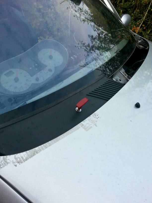

Having a bit of a mare choosing picture, but yep this is the finished product.
Pull cord didn't come with a bracket to connect it to the dash, so chopped up the frame that holds those 6 cd changers, always kept a lot of bits and spares as there's always a chance I will use them again.

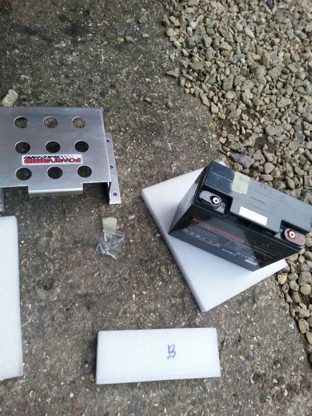

So I got home from work excited seeing a parcel there waiting for me

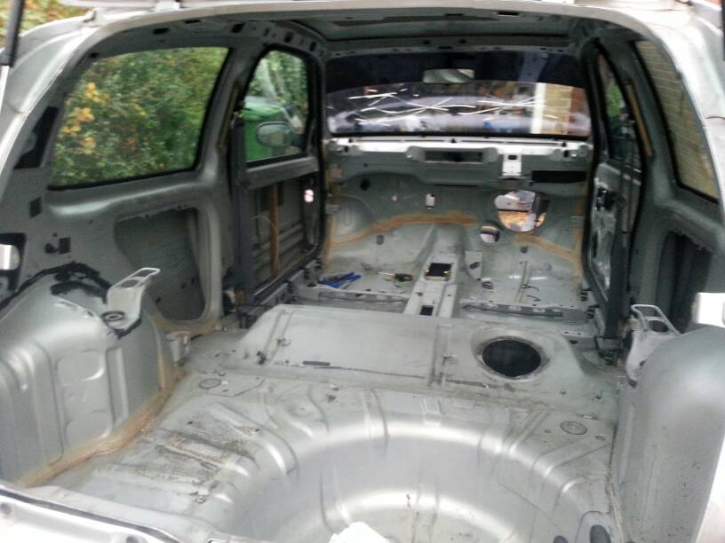

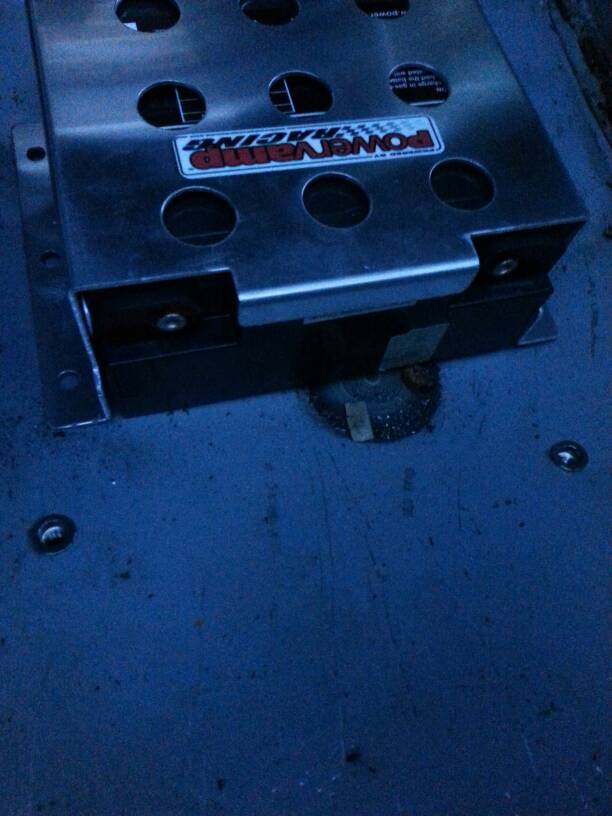

Woo lightweight battery, so time being the limited factor I rushed on ready to fit it, and use my new rivnut tool.
I decided of a "good" place to fit it was the upright section of the rear bench behind the passenger seat.
Get drill bits ready and then put a small pilot hole in, get the bigger drill bit while putting pressure on the drill it goes through the metal! the pressure was continued to be put on the drill and it goes through a second bit of material...

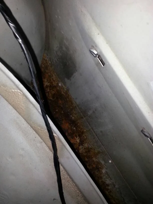

So does anyone know what's underneath the rear bench upright bit, yep the f**king FUEL TANK.
So yep, lesson learnt stop being to impatient and think it through before doing it... hey ho, picking a fuel tank up Sunday along with a set of direzzas.

You could get away with 20mm spacers I think and a bit more off the callipers as I tried a F1 for clearance when @Phase1sr was going to fit some Brembos on his Ph1.
They're my old brakes although there were no issues with the nipples when I had them.
Yep he did say he bought them off you, and yep also to confirm that the thread striped when he tried to remove it.
thats interesting! Do you know how much these callipers have been machined by? (if you had them machined that is)

Have a look through my progress thread. You need to take it off the corners like in my photos. You don't need to machine the mating faces at all.

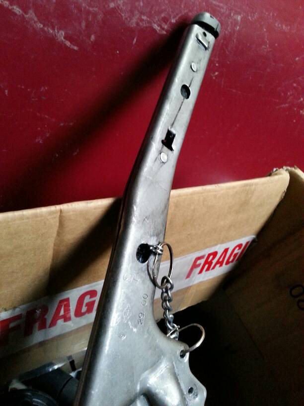

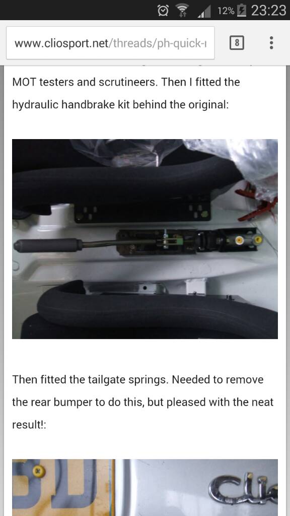

-Hydro handbrake conversion (utilises the current handbrake which is connected to a master cylinder.
It's a bit of a statement putting one in a clio, but my handbrake was f**king useless before hand, and when is it ever a bad thing to have handbrake turns on tap? and as I'm plumbing in my own brake lines right pass the handbrake it would be rude not too...

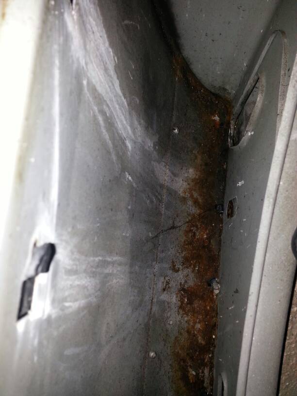

Onto the sad news - Reading through @ph1toms project thread got me thinking, that I should probably check what condition my sill are like, how better to show you than a picture:
yep, fooked.
yep and the offside too.
gutted, but every cloud has its silver lining and all that.

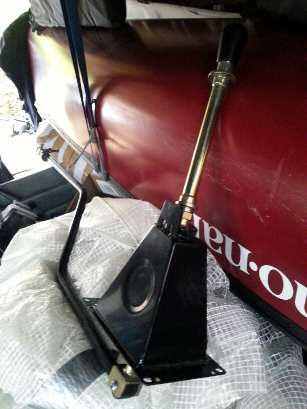

Thought I'd start this post with some p**n.
Got this ready to go on the new shell, while I had a modified scenic shifter before, I just always looked at getting a PMS one so bit the bullet.
Can't wait to get this fitted. Plans are moving forward with the new shell - just need to confirm a finalised price from @pingpong then should be all good to go.

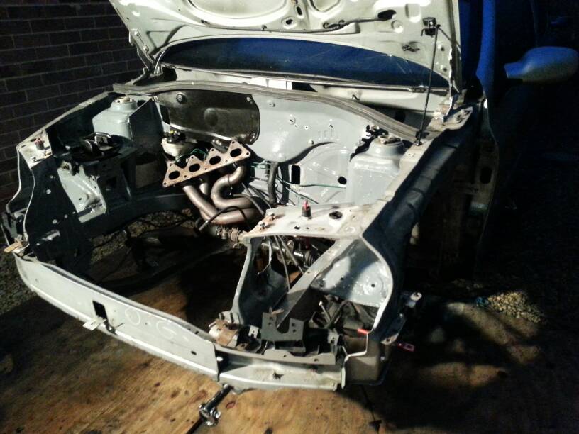

The ph1 has had its engine removed tonight. Got back from work at 5 had the engine packed away in the garage by 730 - not sure why I feel it's necessary to gloat, but it's a new PB for me so feeling chuffed.
Picked up a set of TD 1.2s also, while failing to take a picture of the actual wheels (silver) I took a photo of the 888s that were on there, the previous owner mentioned there were still a track day in them.......... [emoji55]
Got a set of direzzas to go on the TDs also. really can't wait to get these on track.
Got bored waiting for gearbox oil to drain... (it was already cracked)
So, yeah unfortunately the updates will be stripping the ph1 again but this time to a bare shell, and then it's off the the scrapy for it. I'm a little bit annoyed that I didn't check the obvious before I put all the effort in prepping it and building it back up.

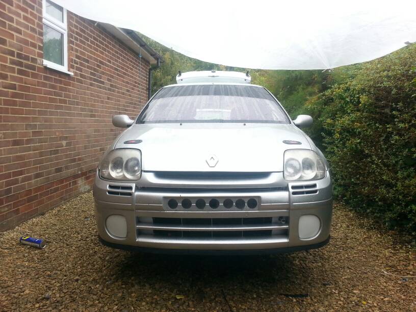

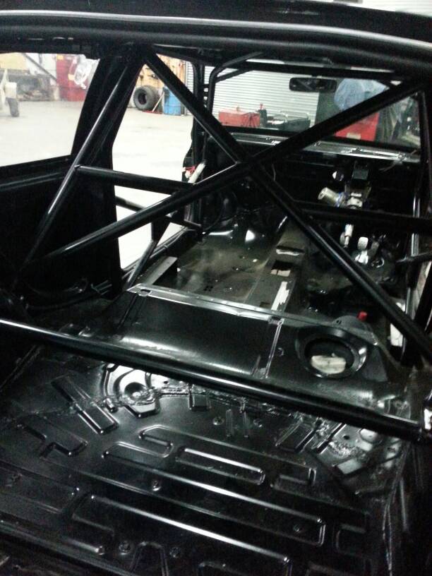

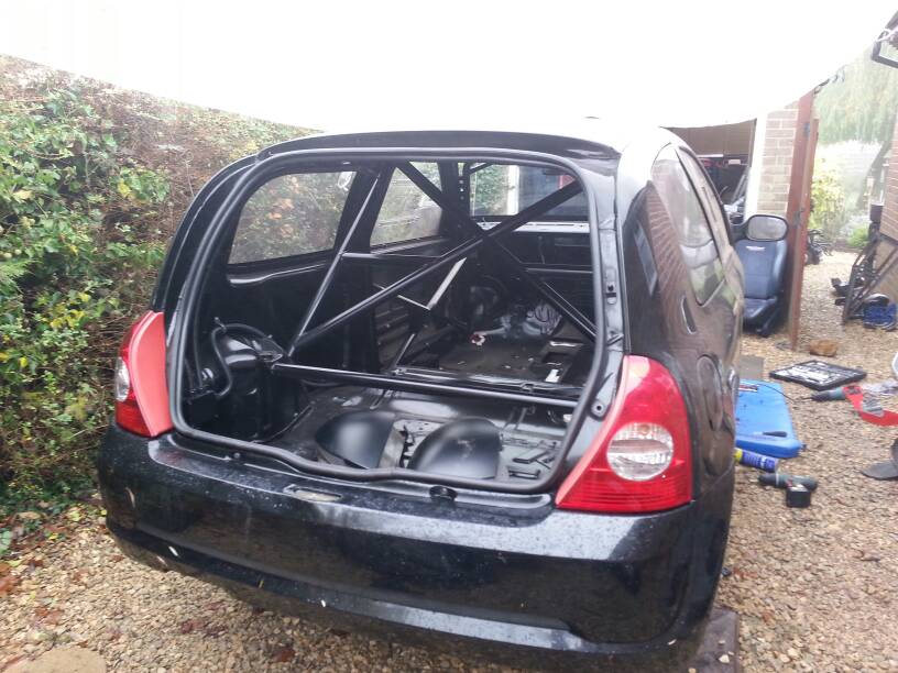

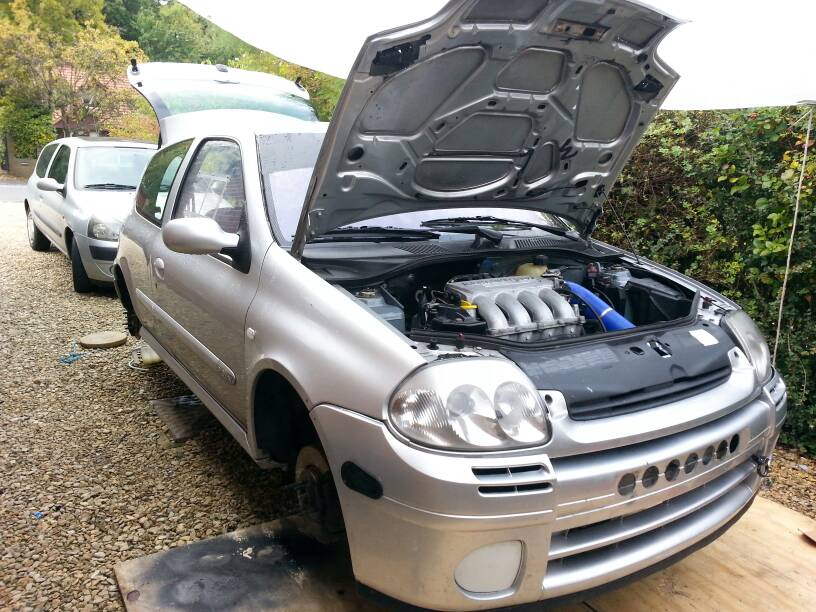

Well went down to Toms unit last night to view the 182 shell.. and what can I say, it's absolutely mint!
Grabed a few photos as I was walking around, attention to detail is amazing, the interior was a bit dusty but the spray job was really good.

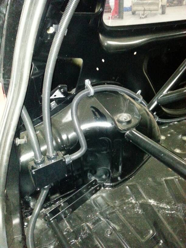

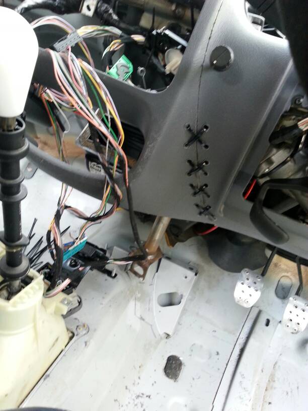

The rear loom is all custom with a junction box at the back splitting it off into brake lights etc etc
As I'm not running a custom loom on the grot interior I'm just gonna a have to work out what does what and join the originall loom with Toms loom
So I proceeded to talk numbers and I bought it, I couldn't if really said no as the ph1 was rusting away annnd I had already got started on stripping it
This was definitely a first for me, the unit was awesome so much space, and let's day a good use of tools...

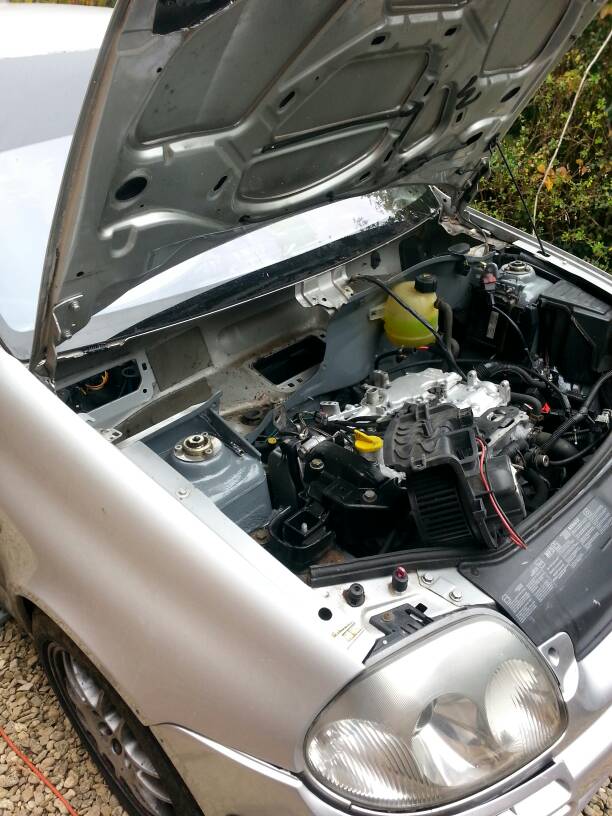

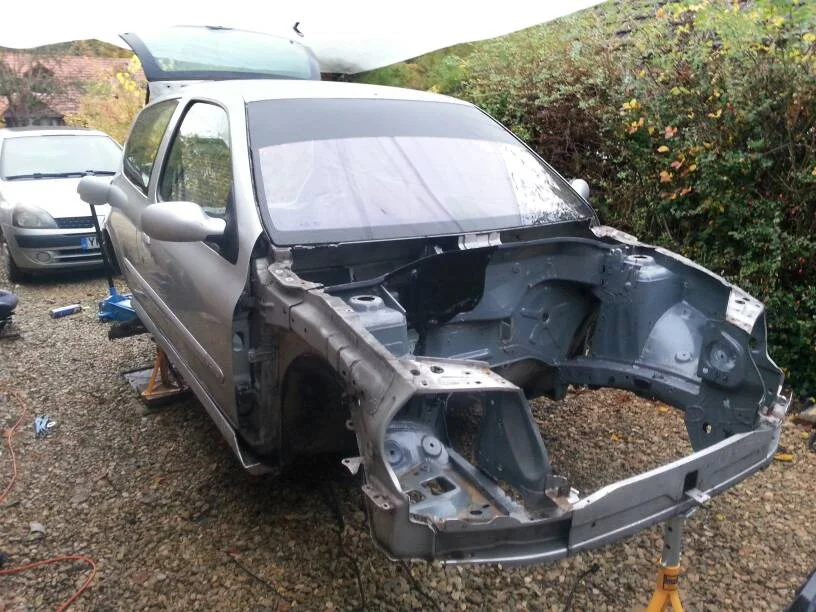

So the plans are to front end swap the 182 to my ph1 front end - wings, bonnet and bumper.
This saves me having to find a 182 engine loom, headlight loom, headlights and swap over the upper inlet so all the plugs are the same.
I've heard it not a simple bolt on, and the crash bar needs a bit of modifying so we will see how that goes.
Safe to say I'm excited.

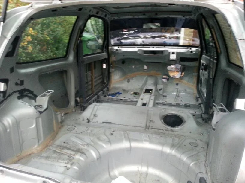

That's the ph1 all stripped and ready to get collected. (if anyone wants anything off the car in this picture just holla)
Fuel tank was an utter basterd to get out due to a captive nut no longer staying captive (story of my life with this ph1) Still need to remove the fuel pump but the big plastic screw thing is on f**king tight.

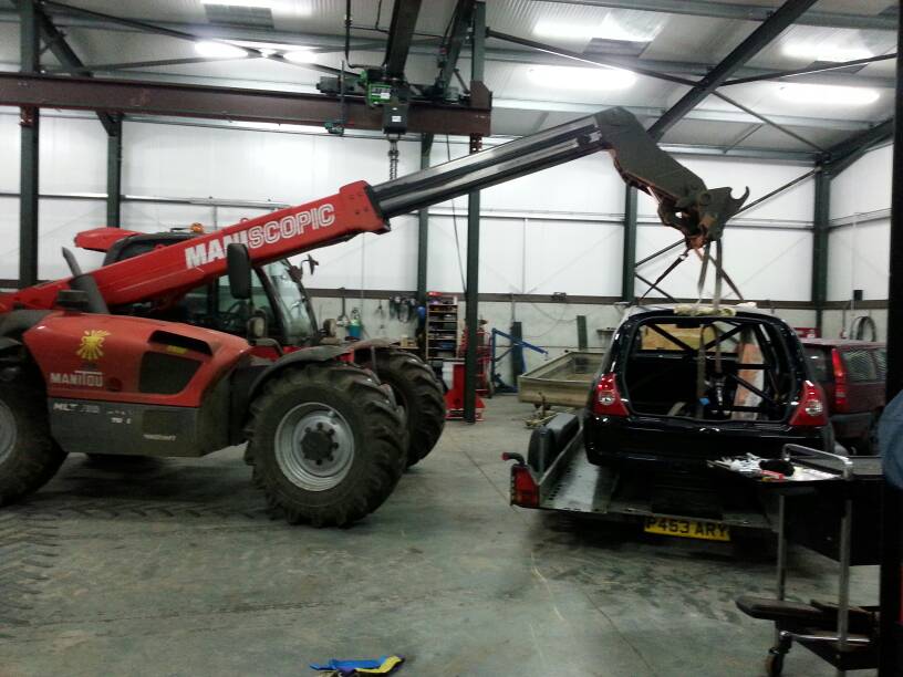

Hey ho, 182 shell is getting delivered Sunday. canne wait.
Helllloooooooow
Welll the 182 is on the drive, getting it off was a lot harder than getting it on, had to lift the shell between the 4 of us haha

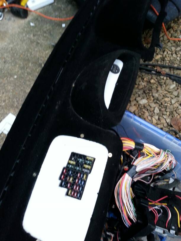

So alot of faffing jobs were done today, sorted out the the dash switch board.
Also the top dash, previously it had a dip where the air bag, but had to cut it out due to the roll cage, but saying that I may have mounted the fuses in the wrong place so they might catch on the roll cage also... s**t.

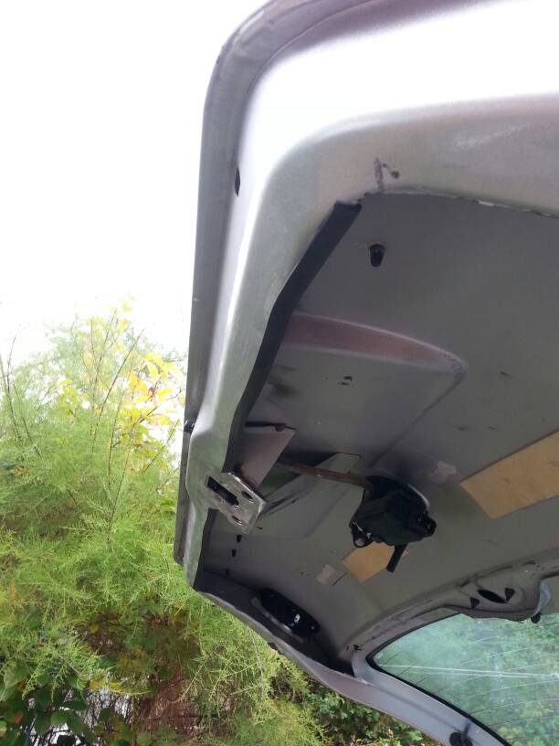

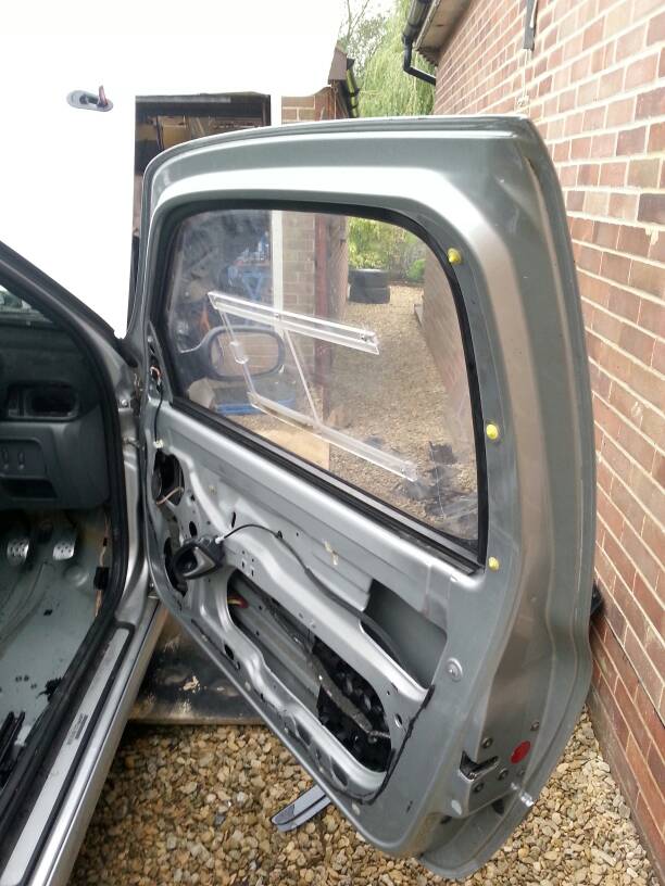

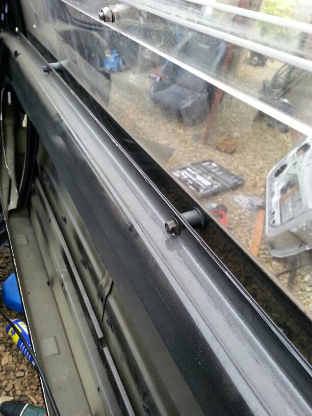

I think I have asked before could you get a picture of how you have filtered your front lily Windows?
Have you just bonded them in or have you drilled them at the bottom?
  Clio 172 & BMW 335D
weirdly I thought of you asking that question earlier, so I took a pic.
outside seal covers the bolts.
I see so that acts as a spacer....? Have you just used a nut and bolt or what?
Are you replacing the inside seal or just leaving the outside one on?
Sorry for the questions
yep you can buy plastic spacers on ebay for whatever length. It looks like a thin nut and bolt yep.
yep leave outside seal in as it waterproofs it, and nope inner seal will stay off no need for it.
Brilliant I actually have some little spacers at home I will make them a tight fit and put a screw into them to hold them tight.
Then just seal the in around the top!
