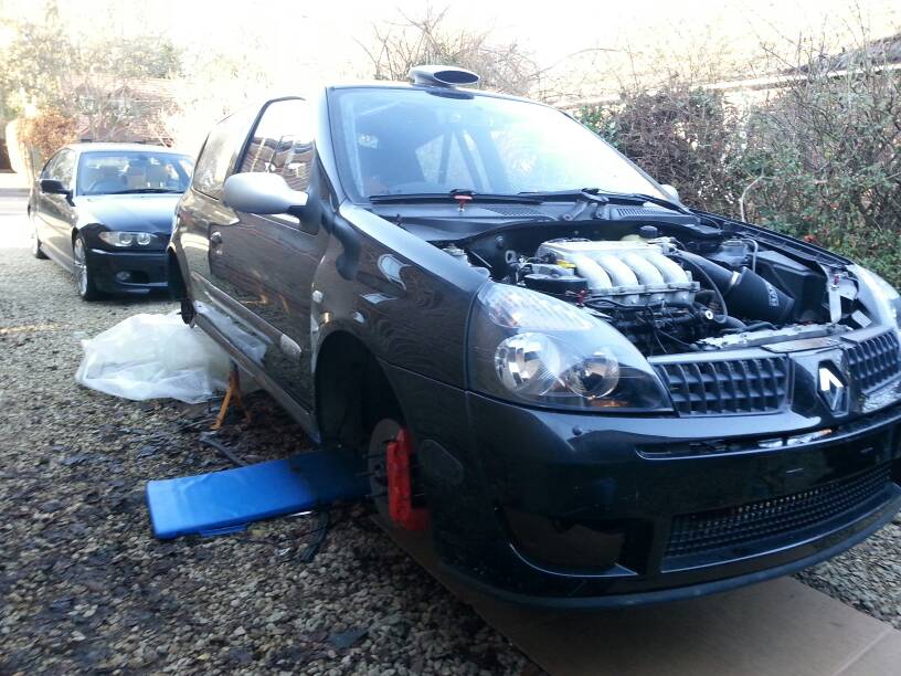

So managed to find some time inbetween the rain and the wind.

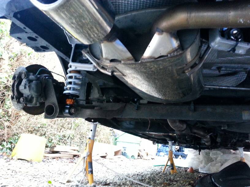

Rear asts are on

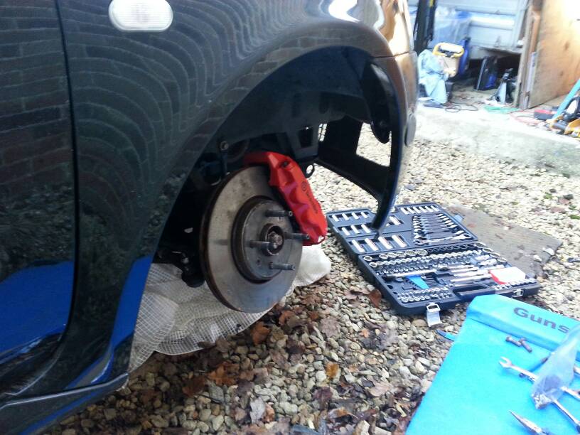

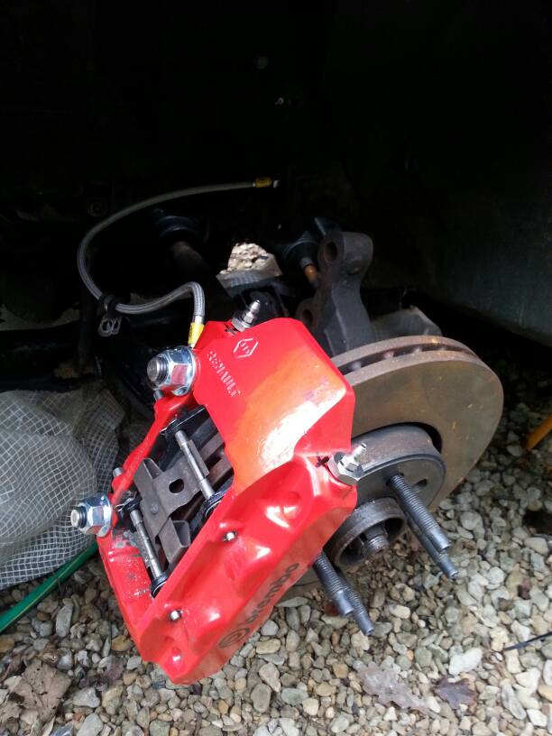

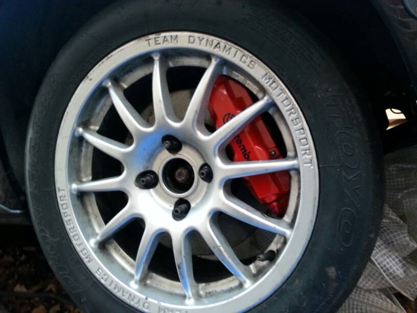

Brembos are on.

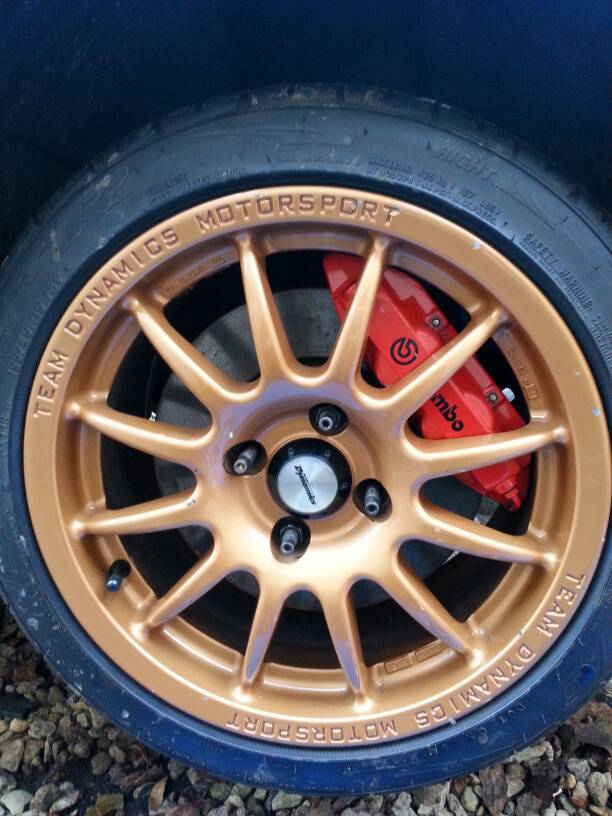

Wheels test fitted.

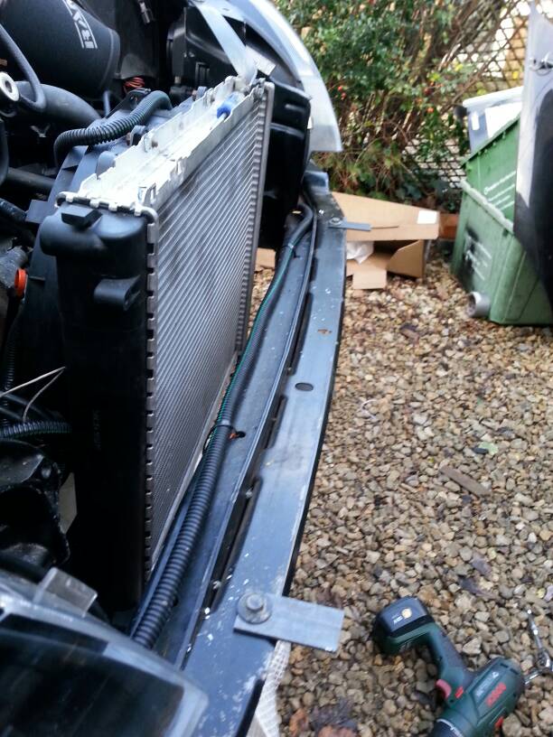

Made up some brackets to stop the bumper sagging in the middle due to running no slam panel.
They will be swapped for some snapable metal, and not steel.

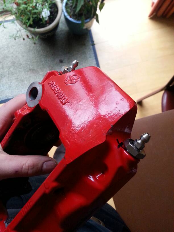

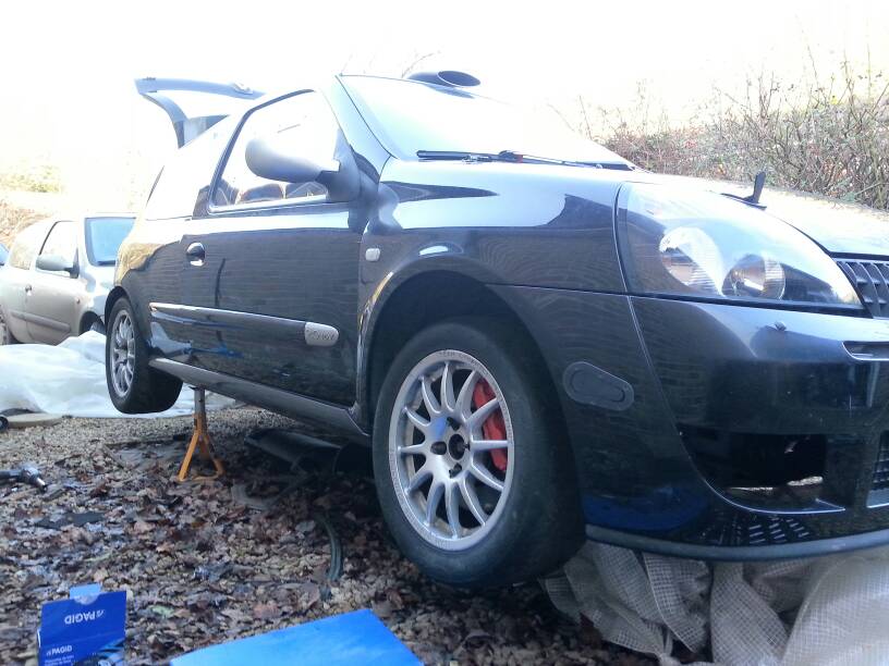

Can you write something more about brakes? You put 15 wheels and brembos from megane?
Yep, so used:
-Chris Powells Brembo brackets £180
-197 callipers and braided brake lines second hand £80
-Standard 280mm discs

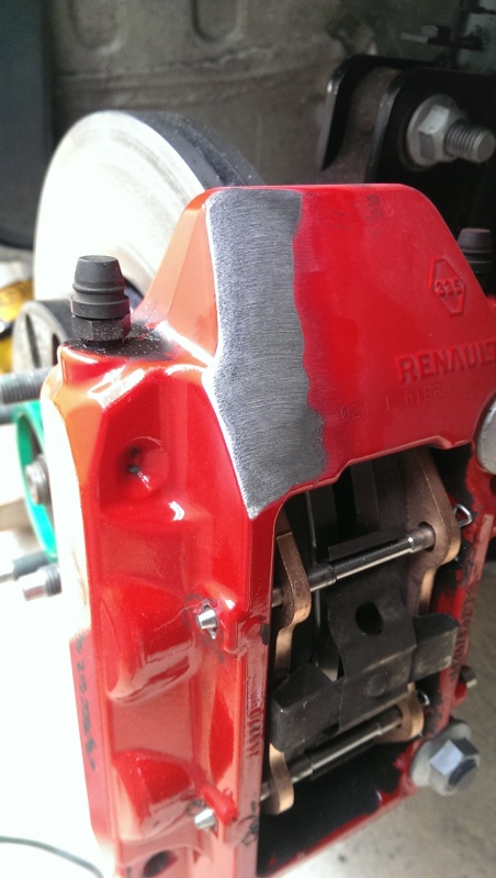

5mm needs taking off the mounting surface of the brembos, and that's about it. I'm using a 5mm spacer on these wheels, could get away with none but need a bit more machining.
£80 calipers? Wow. Someone got their pants pulled down!
Inc :
-braided 197 lines, alloy pin kit.
although the bleed nipples were stripped on the calliper so need machining, which I could get done.
New and improved, much better design than standard.

Firstly was the sleeve nuts to fit the PMS top mounts are different due to the thread sizes on different coilovers. I had m14, I needed m12 for my asts so had them made.
Also due to the reposition of the gear linkage a new linkage rod was made longer, unfortunately I had to remove the lambda sensor as this was hitting the linkage, so just zip tied it to the floor pan, and we can map that out later or do something special... haha
But there we go, asts fitted along with the brake lines...

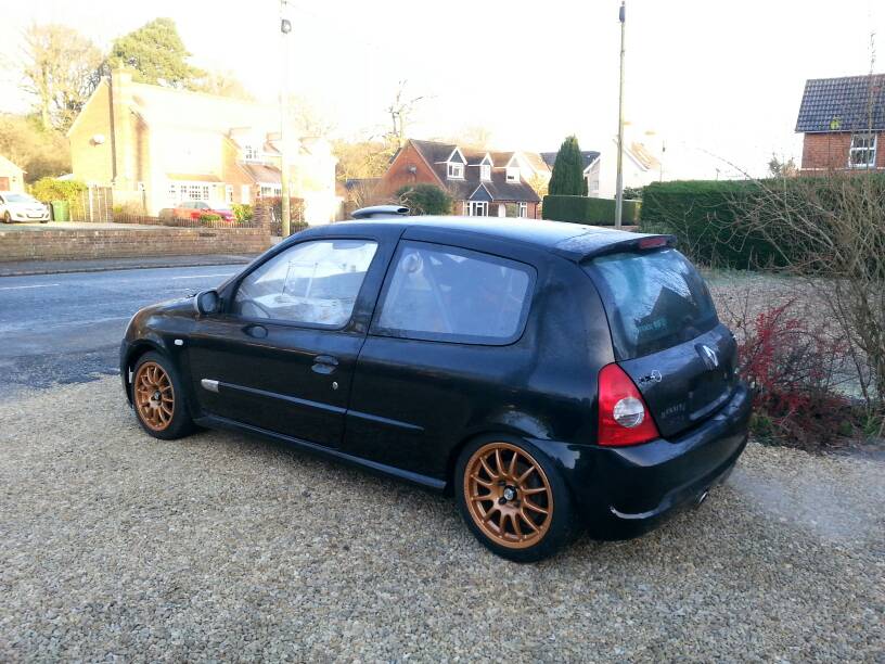

She's on wheels!!!!!! I think it's been out 5 years since she's been on wheels and moving haha
1/4 of a year in my ownership tbf.

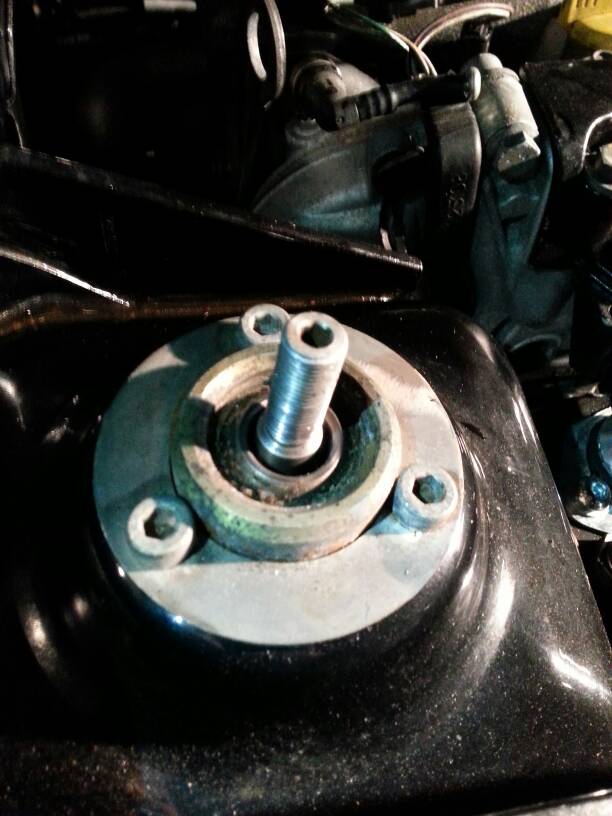

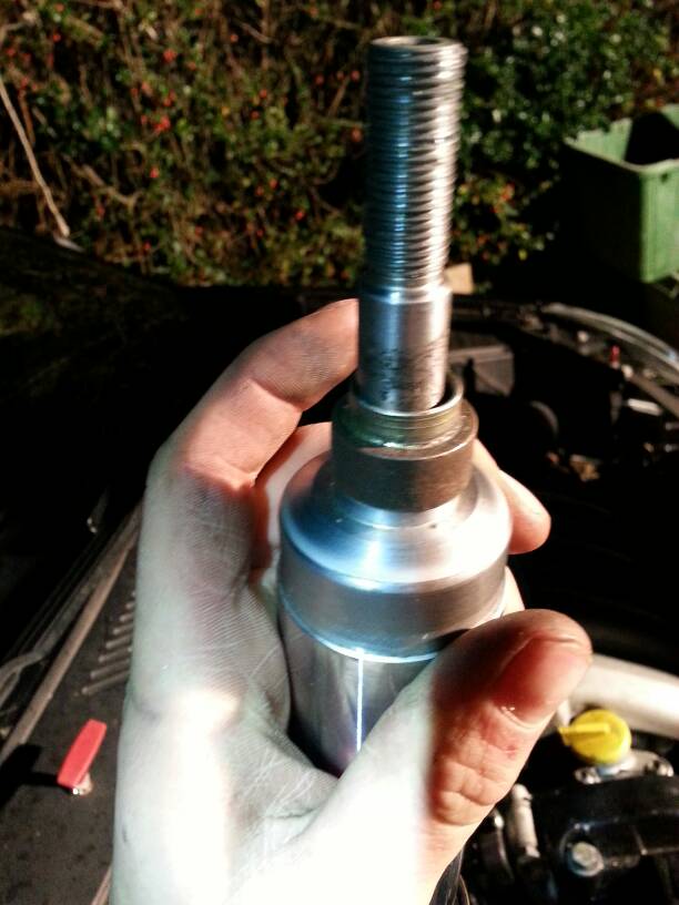

Few niggles, need to get a smaller bottom collar for my asts, as you can see the ID is to big of the collar, as it needs to sit on the ridge between thread and strut (I think) the depth of it also needs to be shorter too.
This is how it was previously. Not good meaning the threaded sleeve nut on the top doesn't tighten enough the clamp the bearing, due to the ridge.

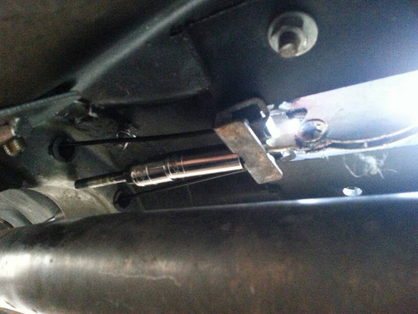

Due to the modified position of the central column (futher back) the handbrake needed some adjustment, and since the thread doesn't go all the way up the adjuster for the handbrake I used some spare sockets... seems to work haha [emoji56]
