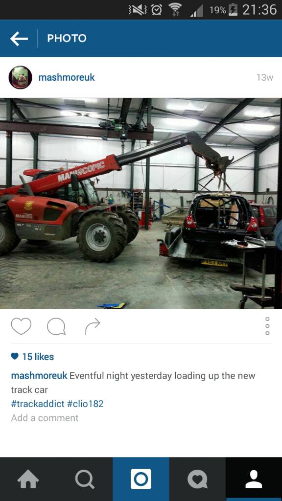

Scrolling through my insta and stumbled across the night the shell was loaded up on the trailer to be dropped at mine the following week!

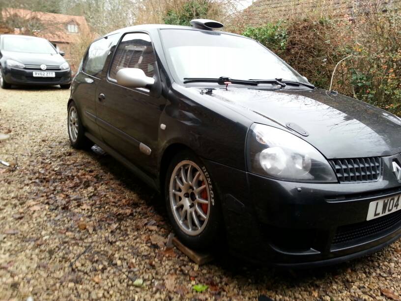

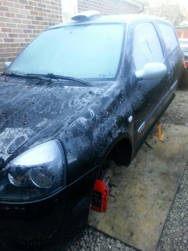

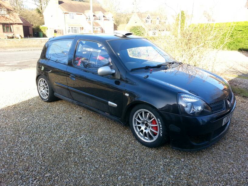

Car looks great!!

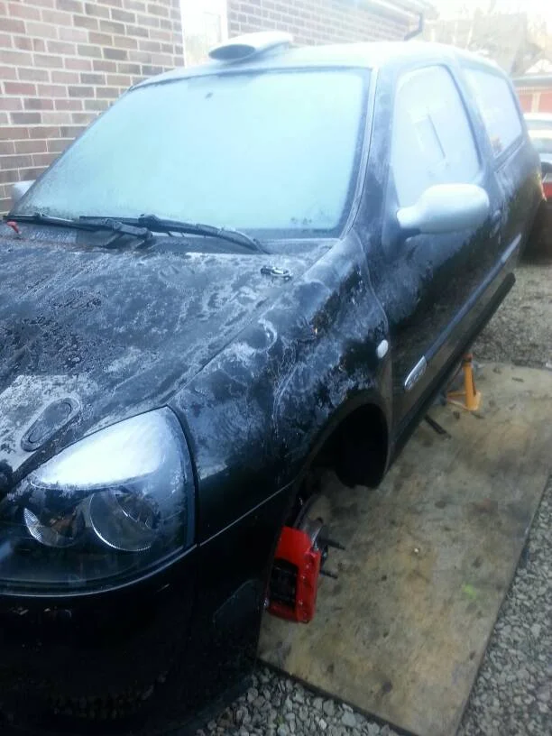

How on earth do you jack your car up on a pebble driveway?? does it not just wedge into the floor when coming down?
I have enough trouble on an old crazy paving driveway!
Car looks great!!
Thanks bud
Yeah I have bought 2 x 8by4 bits of plywood to go over the gravel :)
Ahhh good Idea!!! Never thought about that. Might try it in future. Nothing worse than having to push the car back and forth just to find a big section of paving which isn't going to buckle the jack wheels
Yeah you can't really do anything safely on uneven pavement/gravel, Should of got marine ply though! as the ply won't last exposed to the weather all day.
All it needs to do is get the car up so you can get stands under it though, then you can just remove the ply and put it inside again until you want the car down.
Yeah go smaller than what I've got then, as mines for working underneath too, and as you can see in the pic once it's up on stands I can't get the wood out

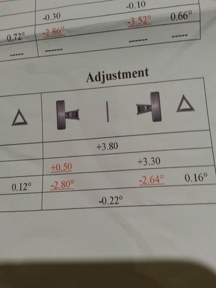

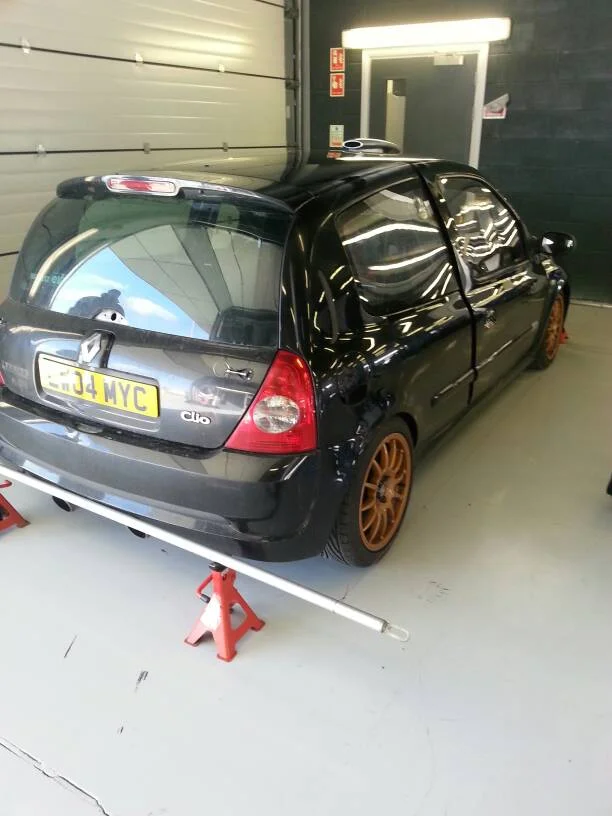

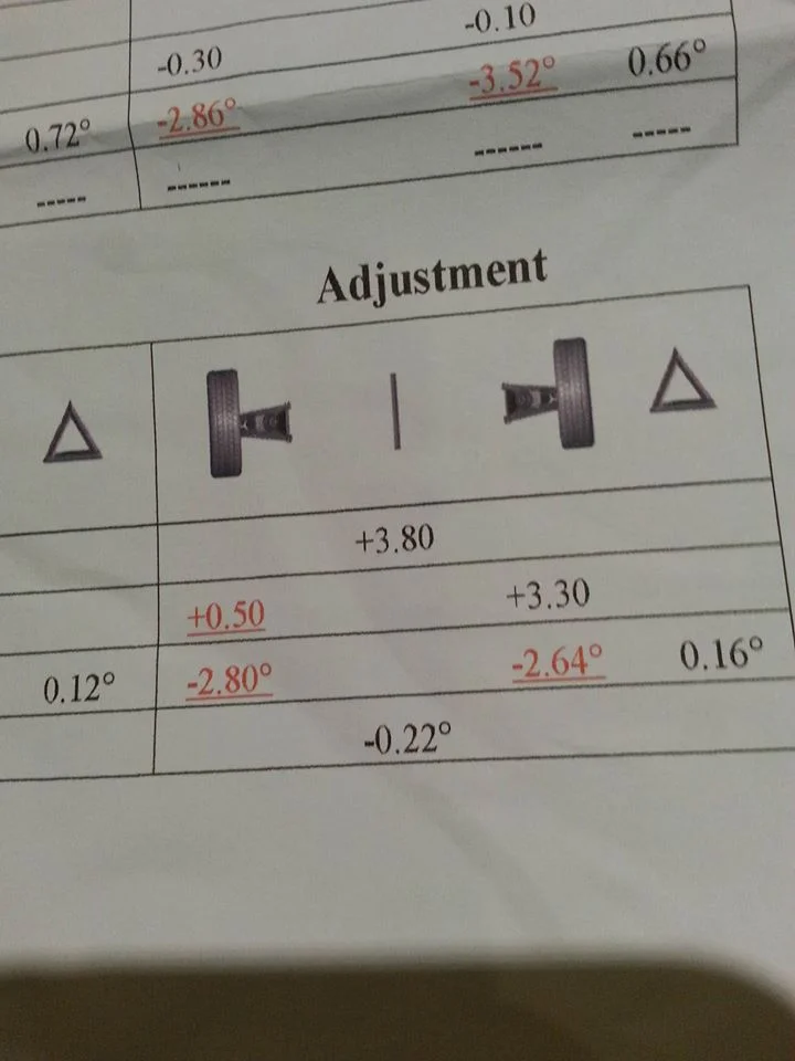

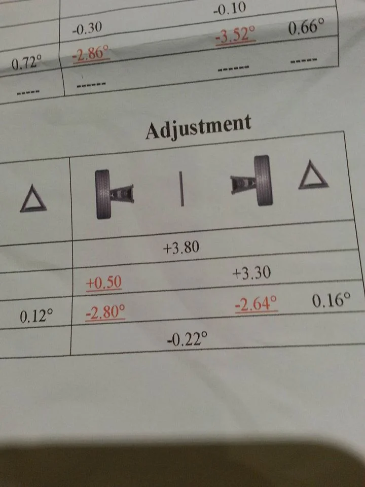

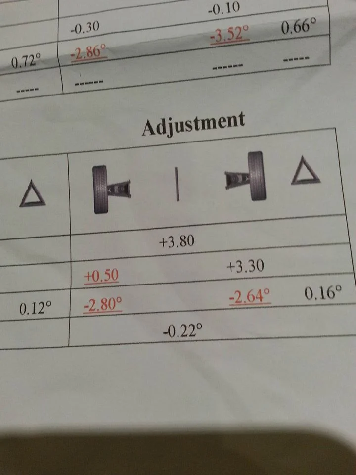

well had a cheap alignment done
0.50 and 3.30 is toe on the rear... The axle is not straight...
What's the measured in degrees? Surely you'll see 3 degrees of toe in? it looks straight...
The offside rear is also bent so that might upset things a little...?
I work with Dunlop tracking sticks mate, so I'm not 100% sure if that's in degrees and minutes or in mm tbh. You should be able to see it, but it's hard to line it up on a Clio. You need something for your eye to line up on, and I personally find that quite difficult on a Clio. Not impossible though.

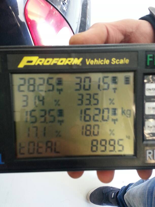

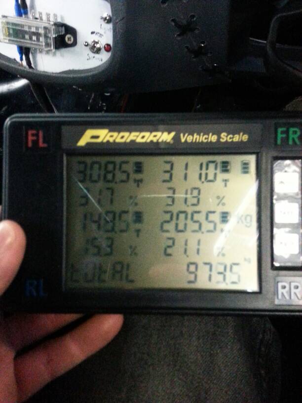

So yeah Anthony was on a mission and I managed to get my car on some corner weight scales.
So this was before, very very happy with the weight of it (about 1/4 of fuel) (899kg)
This was after I think, the diagonals and rears suffered abit but the front weights are pretty decent. But Im happy and happy that we didnt spend long on it at all and take up Anthonys day etc
But yeah after discussing my brake situation the brembo kit will be up for sale, and I'll go back to standard callipers and going to have another look at the way I have layed out the MC as I'm now getting to much bias to the fronts even on standard pads.
Oh and the rear beam is perfect, f**k knows what happened to the alignment machine in a few posts above...
