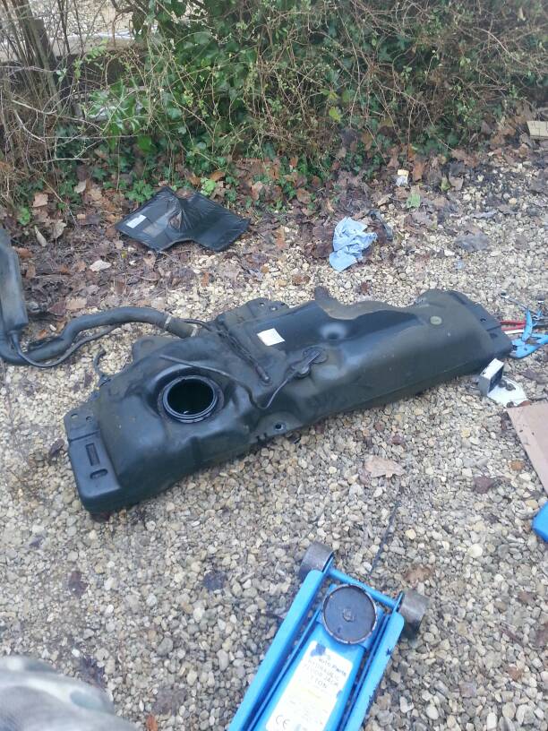

So those who remember I had problems with the fuel tank in my ph1, well I got a bit drill happy.

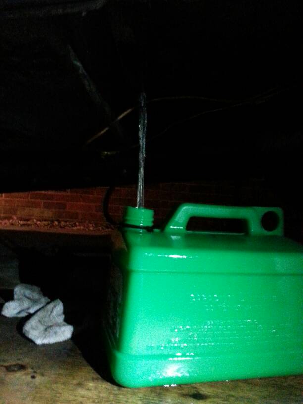

Turns out the previous owner of the shell did aswell, and there is also a hole in the top of this tank [emoji85] [emoji36] This was only apparent after the MOT when I filled up half a tank where I was driving home and the rear bench started to fill up with fuel the pump was totally dry so I was very confused... So got it back had a little feel ontop of the tank and yep could feel a small little 6mm hole..
So that night meant draining £30 quids worth of fuel while loosing about £10 worth on the way home haha

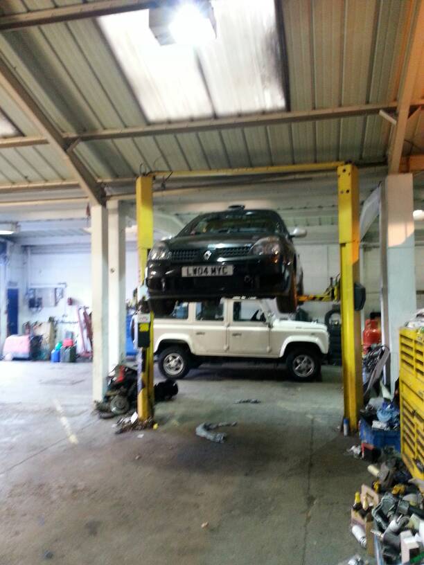

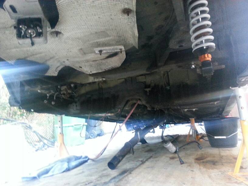

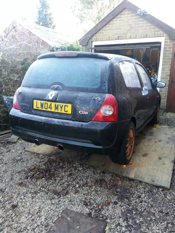

The next morning meant getting the car up nice and high ready to remove the fuel tank.

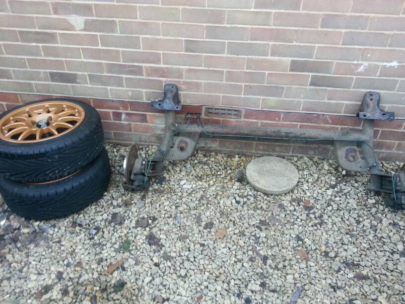

First off, the rear axle. Nice and easy this time as all the bolts were replaced last time so was easy off.. Annoyingly I have only just bled the brakes so this means I'll have to buy another tin of fluid. hey ho
Just had to undo the exhaust and remove the back box.
Ta daaah, one fucked fuel tank.
Please enjoy the solid exhaust mounts proper good quality stuff that.

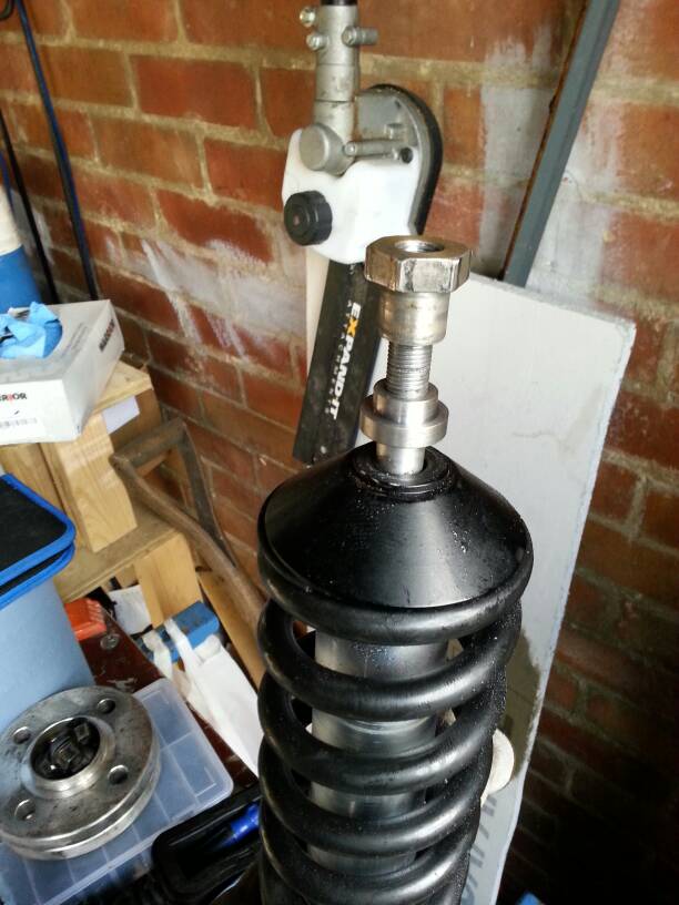

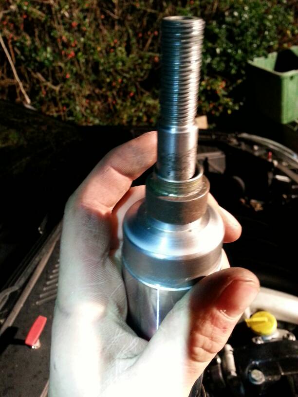

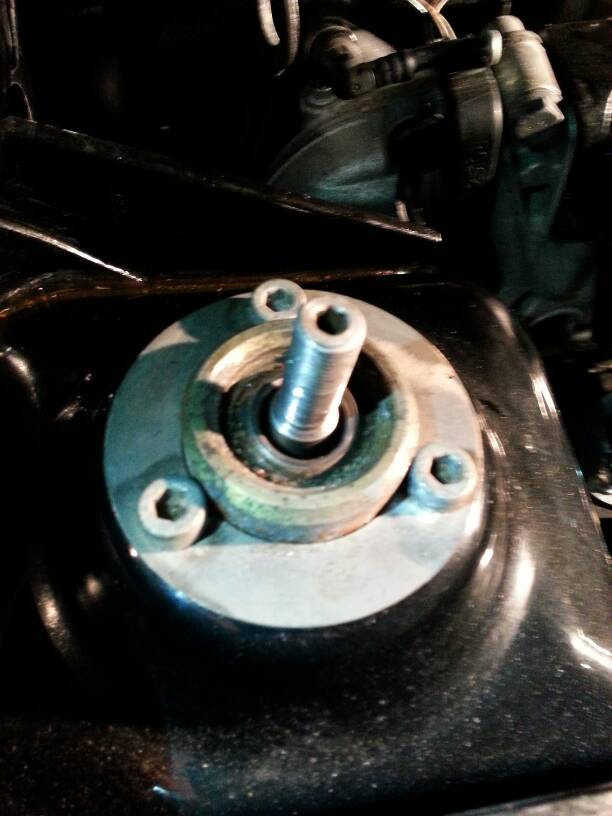

Not an exciting update, but had some sleeved spacers made up to suit the m12 thread on the asts to work with the PMS top mounts.
as you can see the old ones ID was m16 and slipped over the ridge so meant when fitting the top threaded sleeve nut wouldn't clamp down on the bearing (2nd picture down)

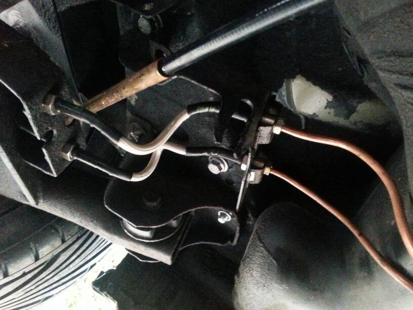

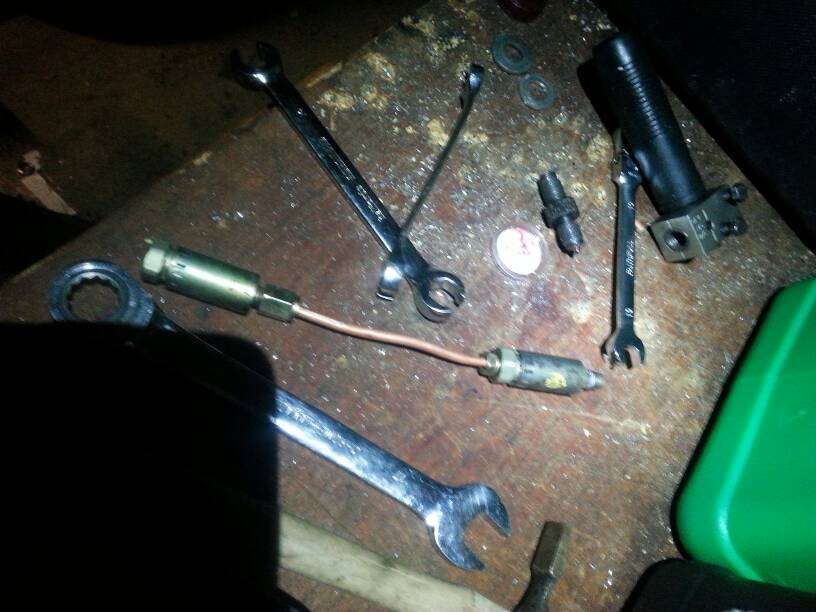

Tonight after work, I'm gonna get the flood light out and make up some new brakes lines which included the pressure reducers in as stated above! and bleed the brakes. Then I'm going to drive it to work Saturday woo
So Fuel tank back in, rear axle, etc etc
So last job to sort was the brakes, lines made, brakes bled, car down and wheels torqued up.
Excitedly took it for a drive, put my foot on the brakes hard... STILL LOCKING UP ON THE REARS [emoji36] [emoji36] [emoji36] [emoji36] [emoji36] [emoji36] [emoji35] [emoji35]
Sooooooo.... I put two reducers inline and still nothing tbh, made no difference really at all!
This looks like I will be ordering a Wilwood brake bias asap.
