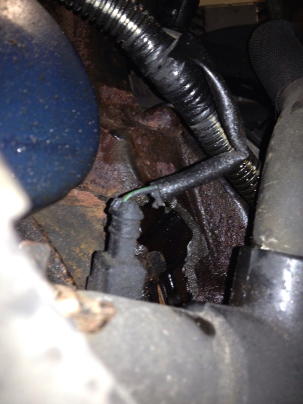

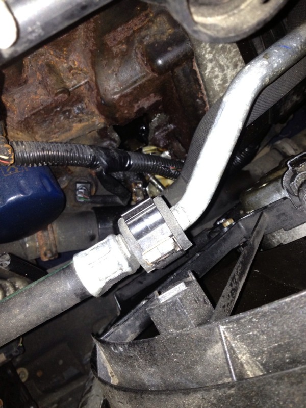

​monday the car was at Bedford, it went really well and pretty much faultless all day until just after 4pm.
i let a mate take the car out, after a while of realising he hadn't come past the pits for a while I started to get worried, and then he comes in to sight being towed back in.

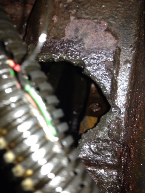

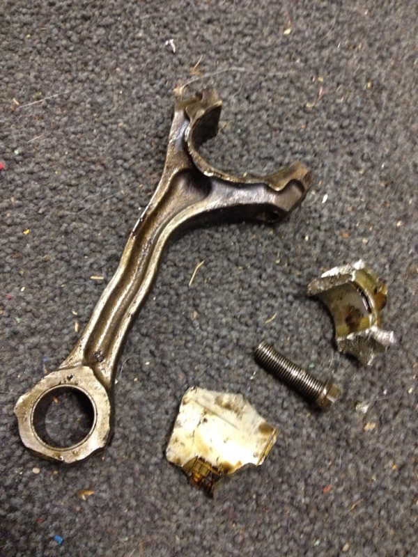

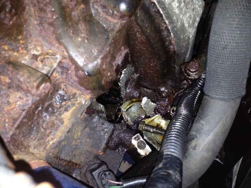

a little inspection revealed the engines trackday life had finally expired.
looks like a rod has tried to make its own doorway to the outside world.

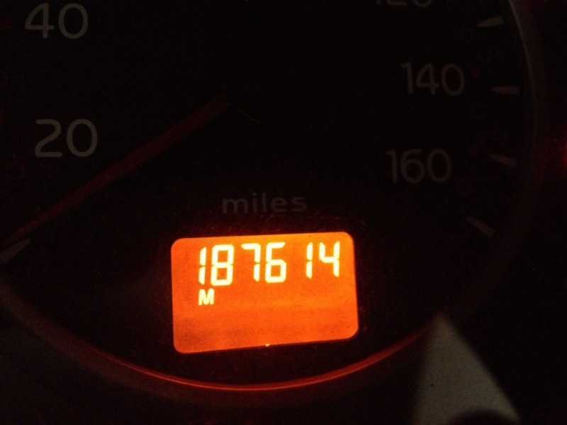

but overal, not bad going for the mileage it was on when it finally let go.

Very good mileage considering though!

lifted the block/box out of the car last night, a pretty effortless task actually.
i haven't fully inspected the damage but with a quick glance I was quite surprised to see that it had also cracked through the sump.
thinking logically its not a surprise that it wouldn't let go aswell when the damage happened, I just didn't expect it until I saw it, if I make sense!?

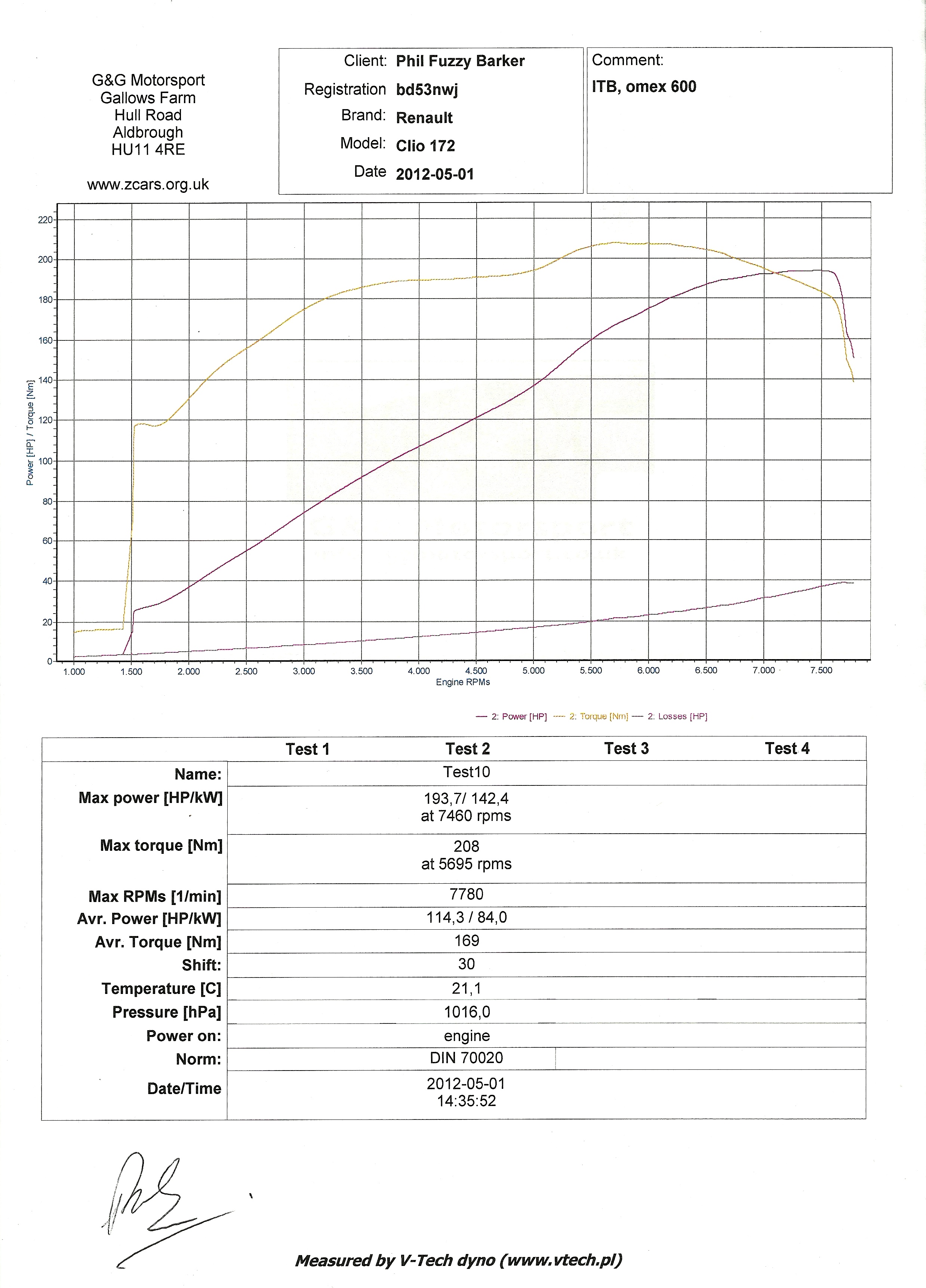

I've got 194bhp on my bog standard engine and if it pops I can buy a £250 lump - swap my bodies onto it and drop it in in a weekend :)
Yep
Standard 172 engine, jenvey ITB's, omex 600, with 182 manifold and an oreca group n exhaust with 200 cell sports cat
194bhp
That was after an entire morning of mapping and it was red hot - We think it's probably more around 200bhp when cooled down but I've never had a power run since it was mapped.
I don't think the 182 manifold particularly does much for power but I had the subframe off doing some other bits so whacked one on
The bodies cost me £1600 second hand with linkage, pedal, cable, omex and everything basically
Mapping was £300 for a morning on the rollers as I started off with a good base map and it just needed tweeking
Getting a better filter and carbon air box and bits probably cost another £200 - so about £2100 all in
That's not overal so bad atall.
it may only be 194bhp but id imagine you have a nice working window of power to utilise rather than that just being a peak figure.
what torque have you hit, or if up for mind could you pop over a graph you have please.
​cheers.
208nm of torque which I think is about 154lbs/ft
It's a very usable amount of power - that's one thing me and the mapper wanted to achieve rather than an impressive peak figure.
It pulls very very well out of corners :D I just need a diff next haha
I think it could do with 120mm trumpets to bring the power down a little bit - or revving a bit higher. But it's a 118k engine on standard rod bolts so not pushing it too far at the moment LOL

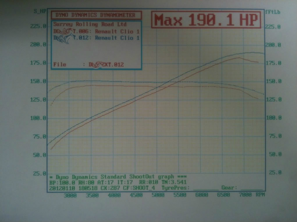

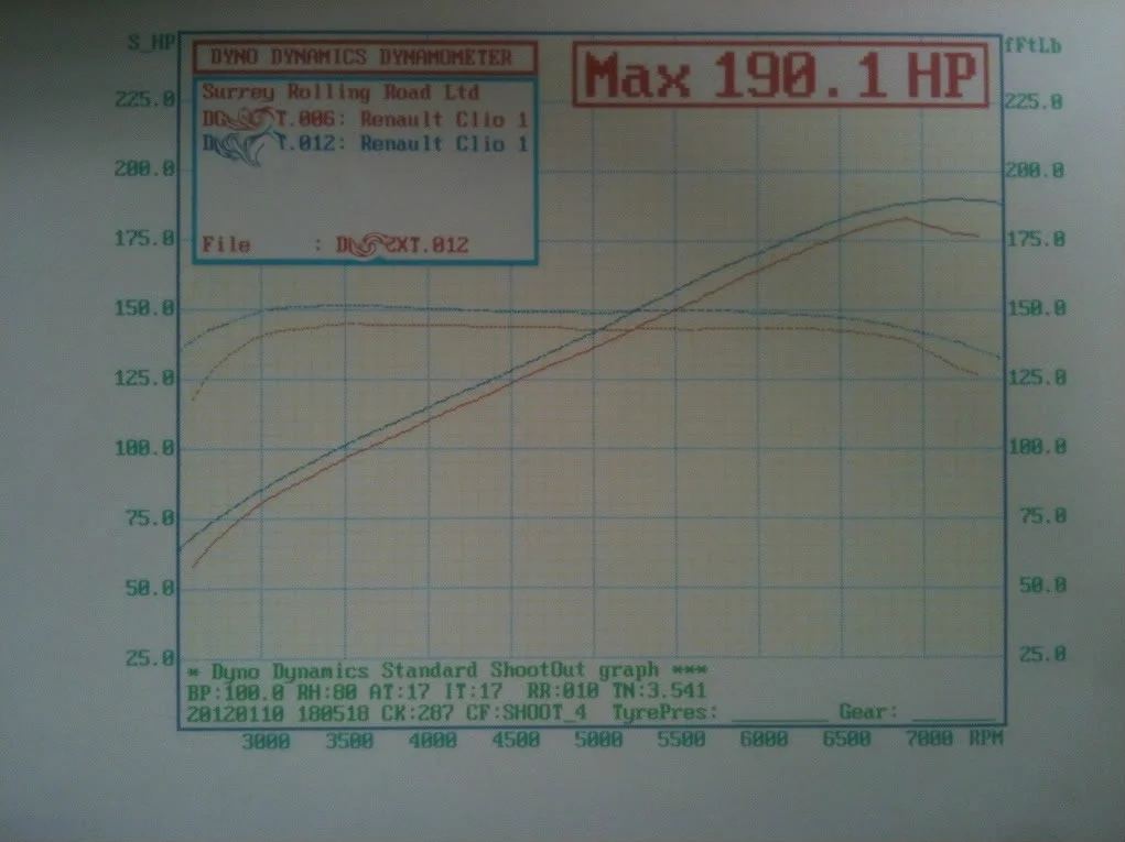

This is the graph from chip of an RS2'd engine
Down 5-8bhp on mine and only 150lbs/ft of torque
I'd rather have the extra torque above 5k cos you really don't drop below 5k on track
