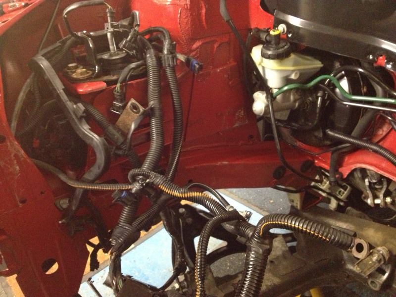

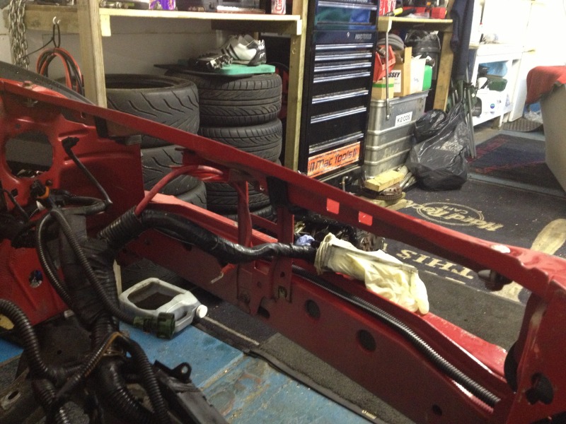

With the engine now out, and 187k of road grime taking root around the engine bay, it was time to attack everything with the ste cleaner and plenty of degreaser.
its come up quite well.

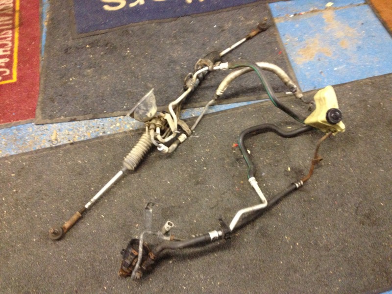

and once everything was clean and a bit easier to work on, the standard steering rack, PAS pump, PAS resevoiur ad pipe work has been removed to make way for a DCI non power assiste rack.
Christ I always forget how much stuff is in the normal engine bays! Don't forget the patch of heavy tar on the drivers side wheel arch (Below and to the left of the engine mount)

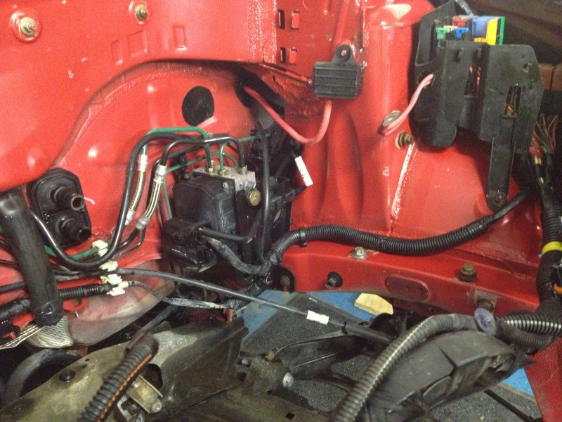

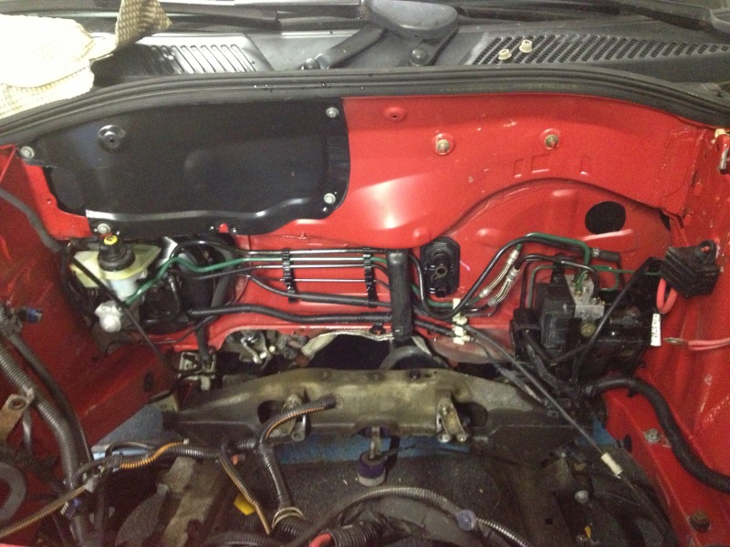

Would be rude not to get rid of the ABS while the engines out ;)
  XC90, 330d, Trophy’s
I want to get rid of the ABS aswell James, just not sure I've got time to sart running complete new brake lines, nor am i 100% certain what parts i need to source in order to do so.
new engine won't be going in until Monday/Tuesday so it gives me time so get new rack mounts, tidy up the new engine and fit ARP bolts courtesy of Danny @ 519.
just the pickle of the ABS.
my valeting mate questioned that spot in the bay, I wasn't sure if it was or not.... I shall now hop on to it :)
Realistically with the engine out it should only take 2-3 hours. You would need a 172 cup master cylinder, 172 cup load valve (goes under the car near the rear beam), copper pipe, a few m10 brake unions and a few m12 ones too. Flaring tool for the lines and a pipe bender and p-clips if you want it to look tarty :)
If you get stuck trying to find a master cylinder speak to Fred@BTM as I left my spare one there in September so you are welcome to that and just replace it in your own time (If he still has it that is lol)
