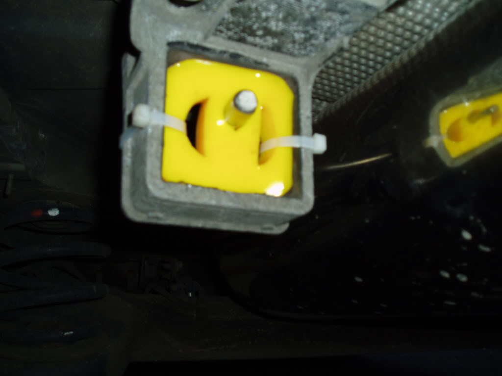

I've not really looked into the options previously for replacement mounts, but there didn't seem to be much available. I had the OE mounts for 4 years before they started to fail, replaced them with aftermarket mounts available but they have lasted a little over a year.

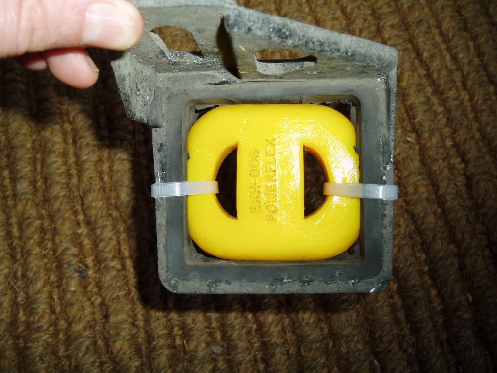

SO..... I bought 2x Powerflex universal exhaust mounts EXH 008, about £6 / £7 each. Pic in this link
http://www.powerflex.co.uk/i/product_images/2-Exhaust Mount Cat Page.pdf
I cut the useless rubber mount flush from within the metal frame so it left a nice opening to fit. They're not a direct fit into the standard metal mount and required approx 3 - 5mm taken of each side so I still had to compress it to get it in place. cabled tied in place to ensure it can't fall out (unlikely but just incase). All I have to do now is find a 12mm drill bit and make the hole for the hangar arm.
New exhaust arrives in a couple of days so I'll make final measurements then and get them fitted.
No more sagging :rasp:

Fitted the rs 192 system today and got the mounts drilled and in place, works a treat and would highly recommend buying the poly bushes instead of cheap aftermarket mounts. didn't take any pics today but I will do tomorrow and post them up in the afternoon

the OE holes are slightly raised over centre when no weight is on them, so I kinda did the same. I proppod up the tail pipes to where I'd like them to site, marked the rubber then drilled it.

Dave - couldnt you have turned the powerflex mount by 90deg and the slot the exhaust hanging arm through the semi circle hole?

No reason why you can't turn it 90 deg. but then it won't be held on place as such and will move around within the slot both up and down and sideways. Plus doing it this way meant it gave a better fit within the hanger, and I could also make the whole exactly where I wanted it.
They are stiff, but if you get hold of the tailpipe there is still a degree of flex in them still to allow for engine / exhaust movement if needed. It just doesn't bump around with general small road bumps too much.
As for the packing out of the OE mounts with sockets etc. wheres the flex and give in that?

I have modified some old mounts with these bushes now.
Have cut it down and mounted it 90 degrees turned to the OP's. The hole should be suitably located for the exhaust now.
The bush was quite tight fitting but i have silicon'ed around it to hold it in place. Movement is good as you have the hole at the bottom which allows it to flex vertically and the silicone at the sides allows it to flex sideways. The fit on the exhaust is also not too tight to allow movement forward and back also, but not too loose either.
Will fit them when i get chance (in good weather!) and see how it is.
