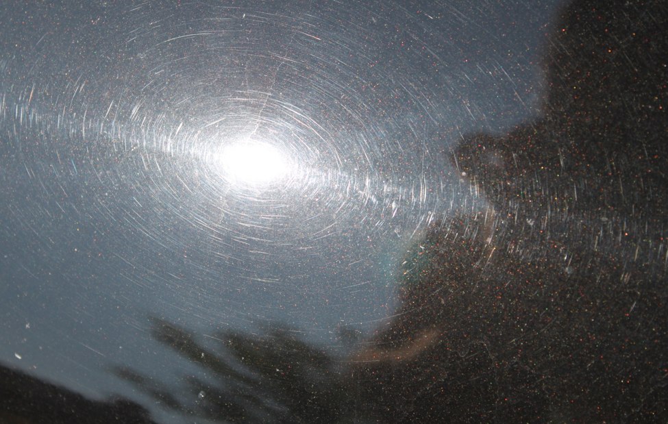

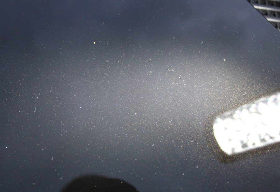

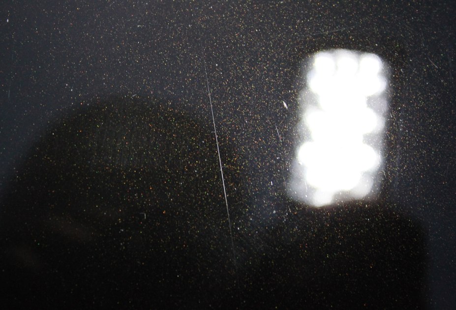

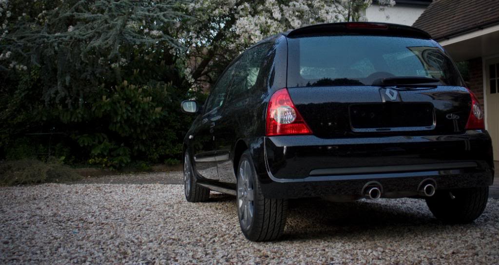

So, after buying a DAS-6 PRO a couple of weeks ago, i've been making some progress on the clio. Taken a while so far, mainly because of the learning curve, but also due to the condition of the paint and how bloody hard it is! It looks like the previous owner liked car washes, lots of straight line scratches all over from bristles i presume, and heavy swirling. Also had a strange haze to the paintwork. Went over the majority of the car last weekend with Menz power finish on a Lake Country polishing pad, but it wasn't taking a massive amount out. Few pics of the defects...
Bonnet after 2 hits with power finish on a polishing pad :banghead:

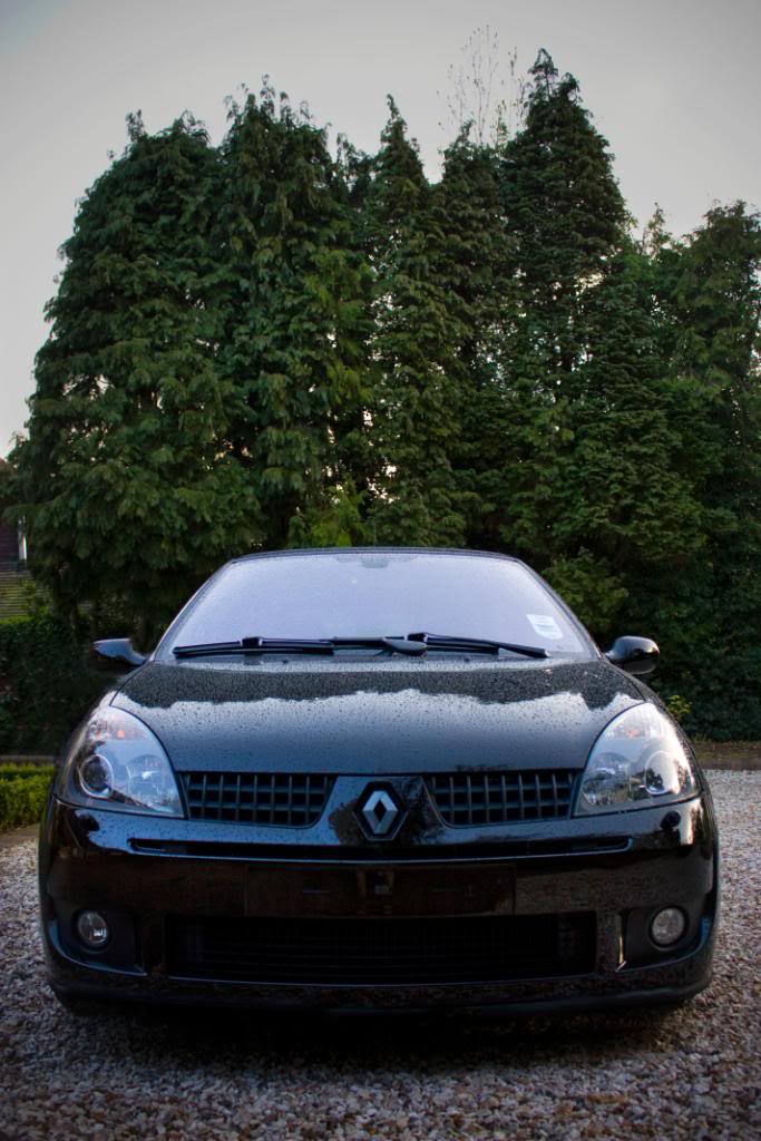

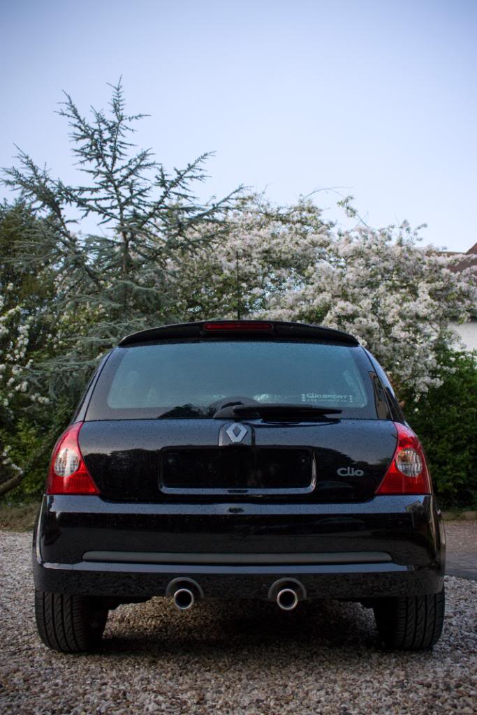

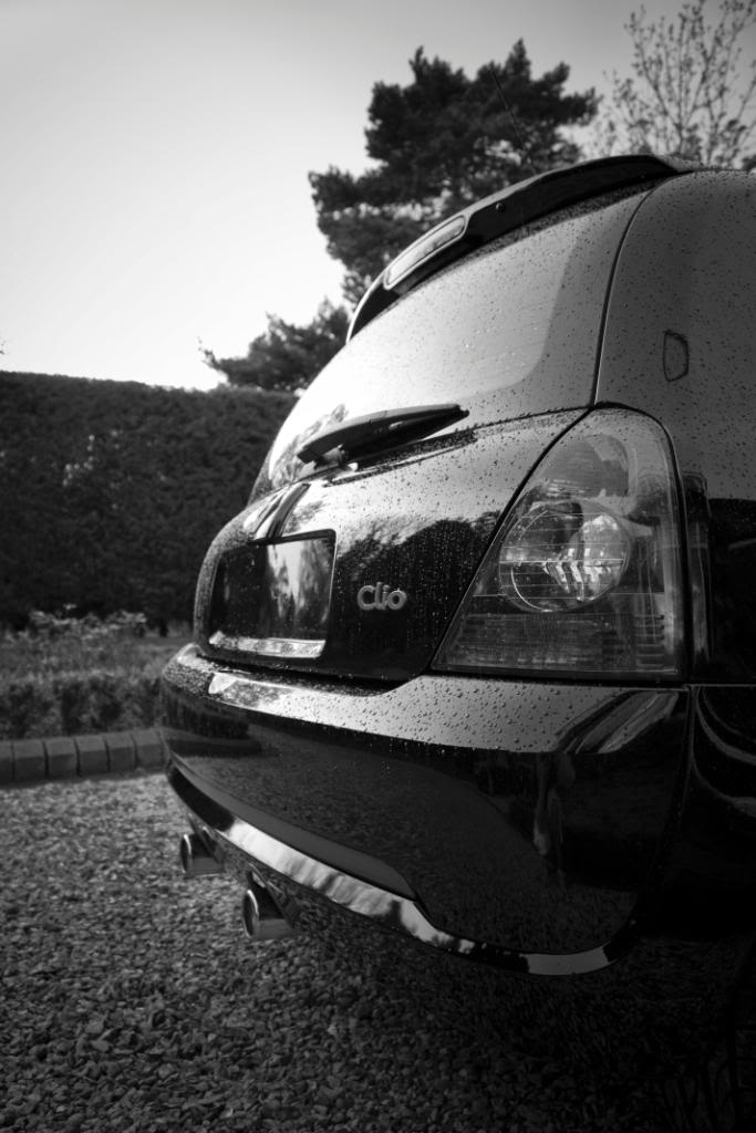

So i came back to it today, and hit the passenger side with Menz Fast Gloss on a Lake Country cutting pad. Still hasn't taken everything out, but it's a hell of a lot better. Not sure whether it's the depth of the swirls etc or just because Black Gold seems to be very hard! No detailed shots as it started raining, but a few shots of the car.
