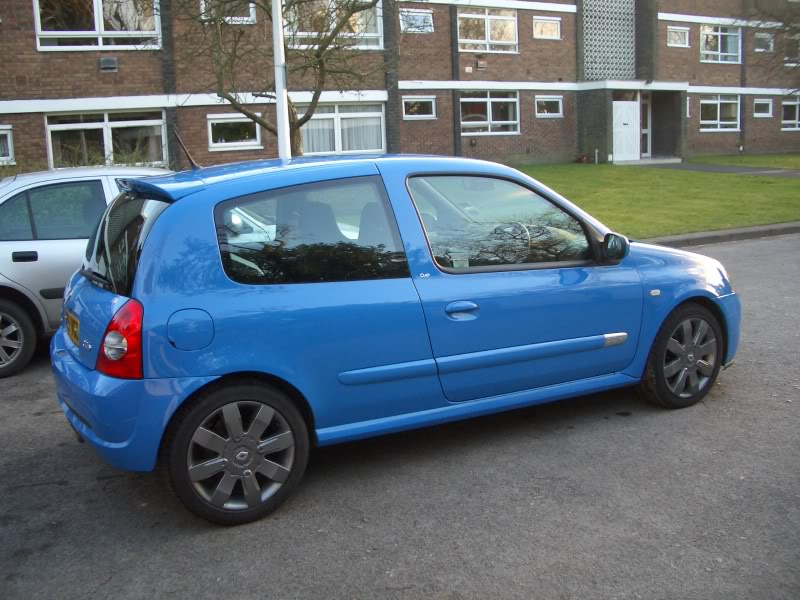

as title, please (briefly) explain what the differance is to compared to an 182cup?
all ino of is Recaros, the wheels and suspension setup. ..but could buying h&Rs and lighter wheels to put onto a 182cup end up being same if not better than a standard trophy?
..or is there more into y the trophy is quicker?
edit
only reason i ask is, 182cup / trophy is on my car upgrade list, ...prefere the colours (RB + LY) on the 182cup, not to keen on the colour of the trophy also the ride hight is 4x4 style lol but i love the passion thats been put into it..

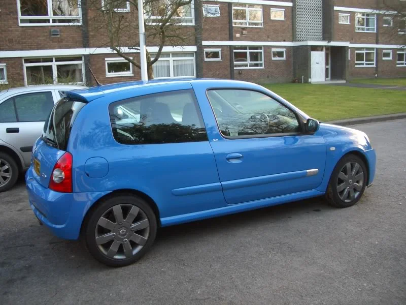

edit
better off just putting the money into your car mate!
