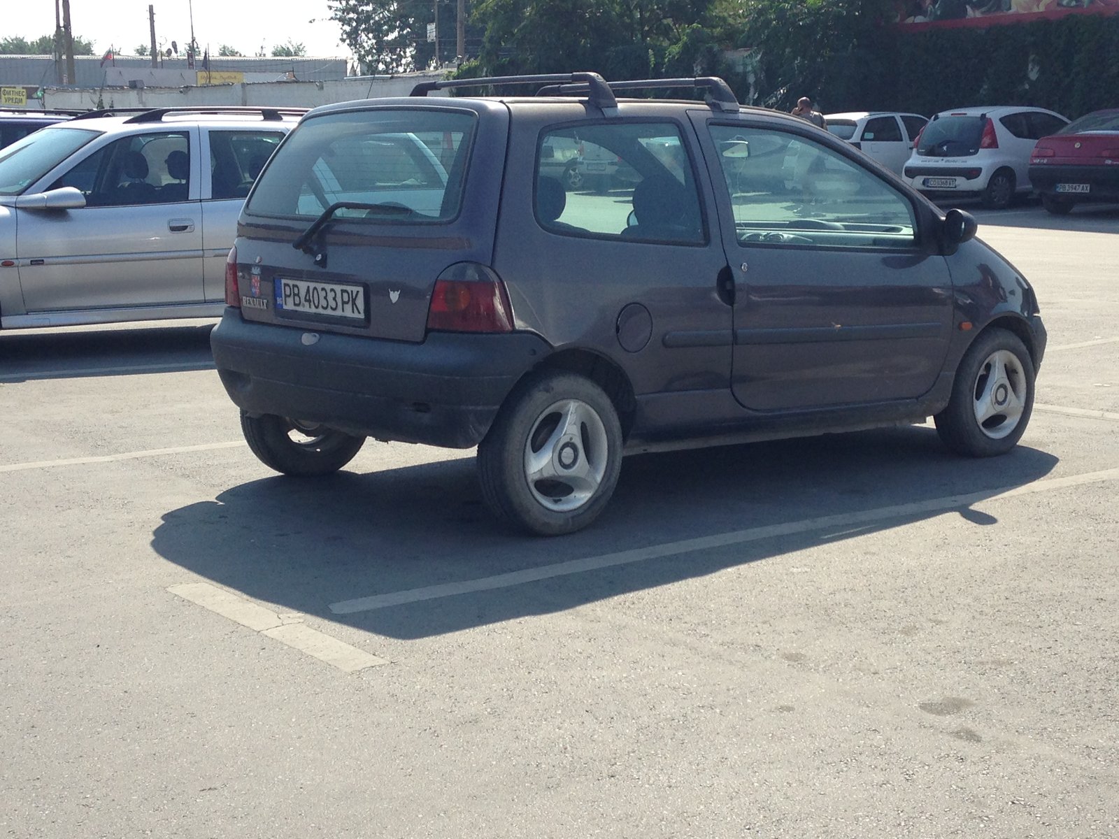

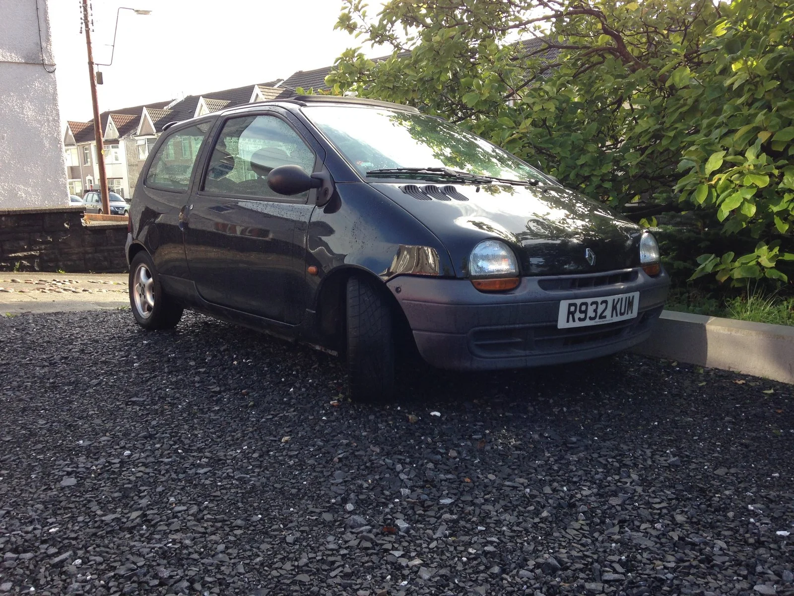

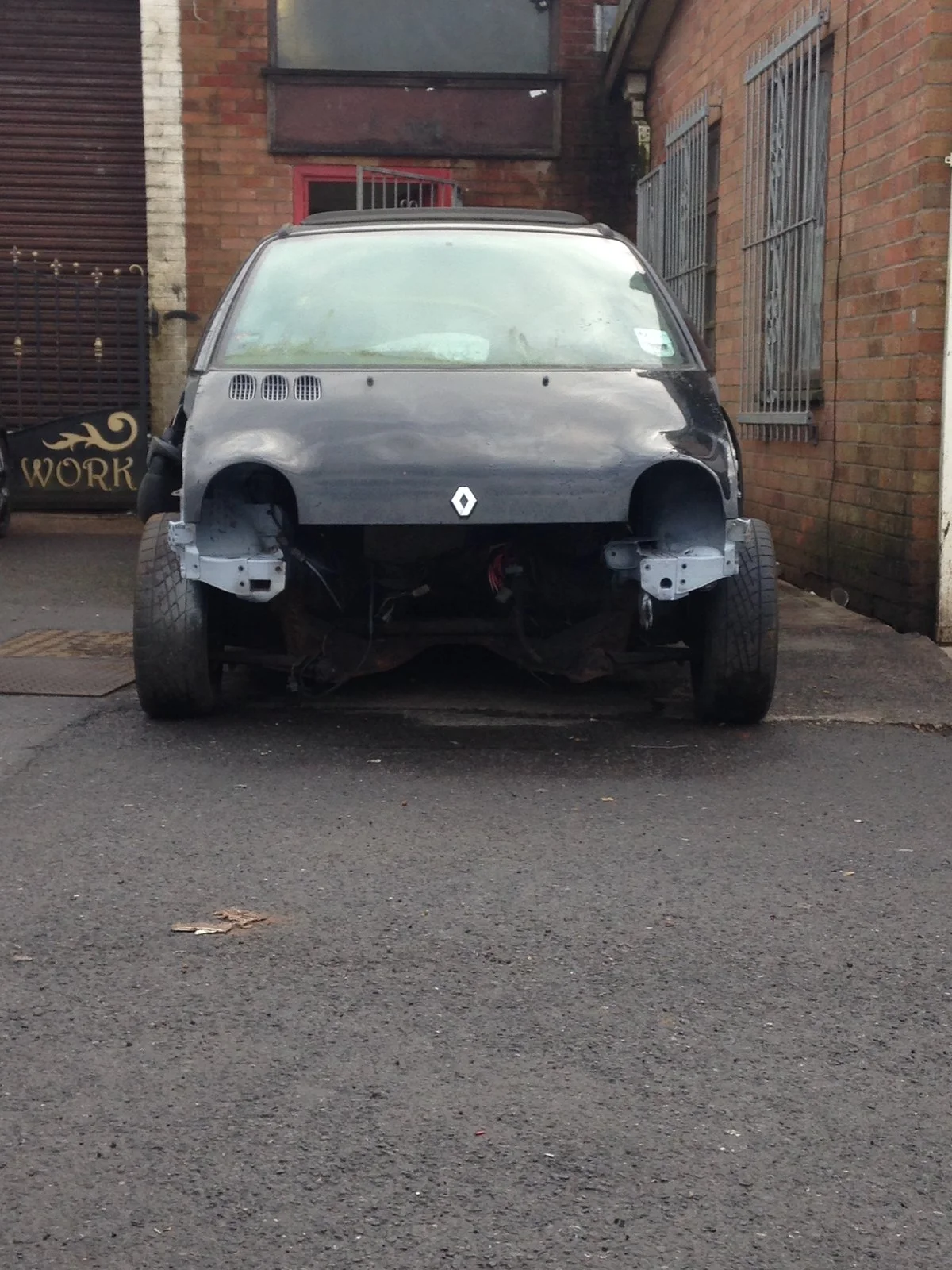

There she is. The car that looks like Stewie of family guy. As an Impulsive character I have a tendency to buy junk.. Little did I know that this little shoe-box is going to stay in my life for so long !
Started out with an eBay ad (as they all do) with the intention of swapping the Auto box for a manual and get about town with it.

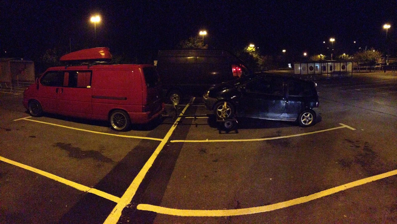

With good company on board , we headed out with Ry's van and picked it up Cardiff way From a gent who clearly didn't have a clue to the surgery his beloved twingo was going to get. 😂

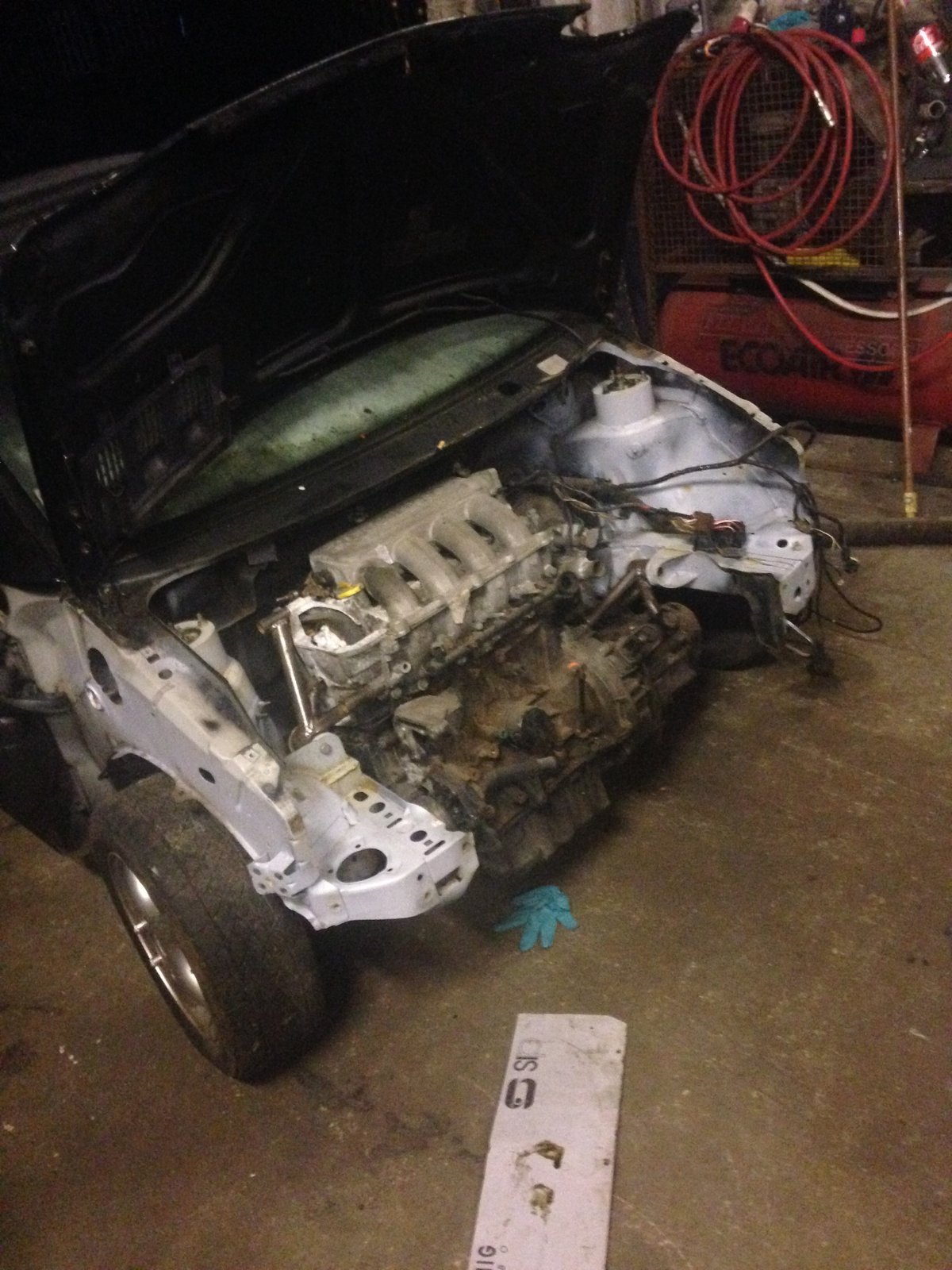

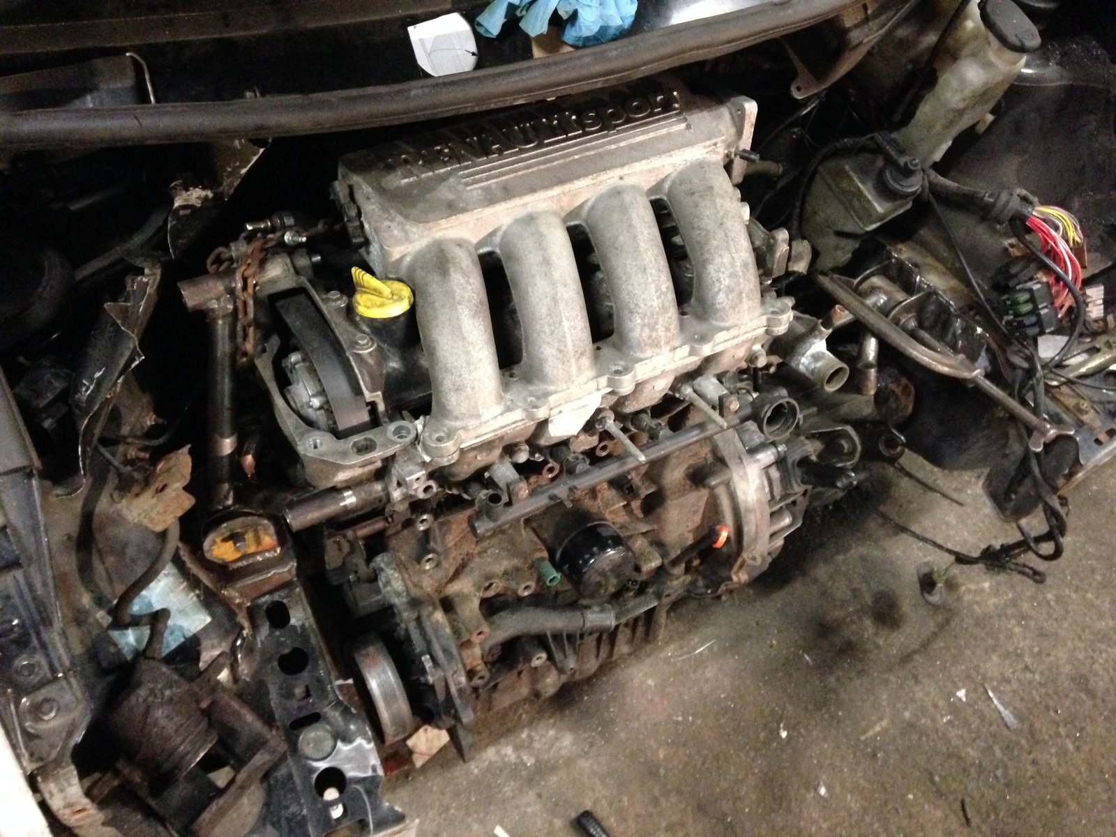

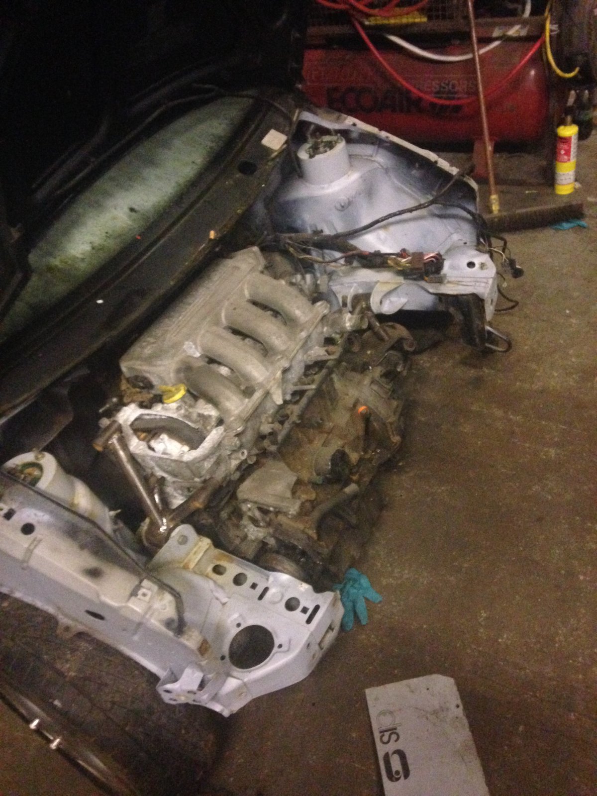

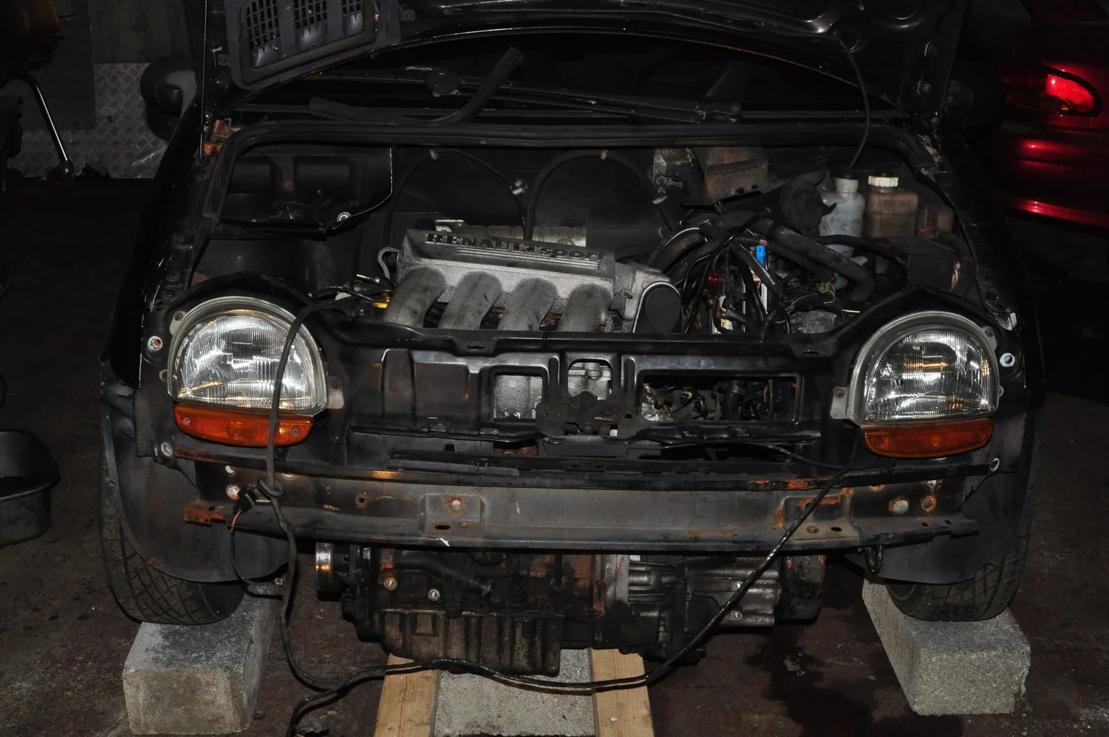

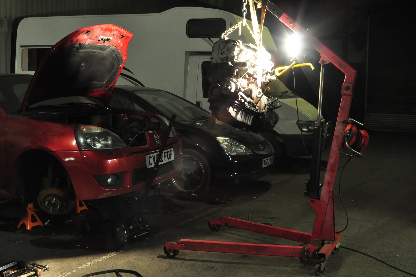

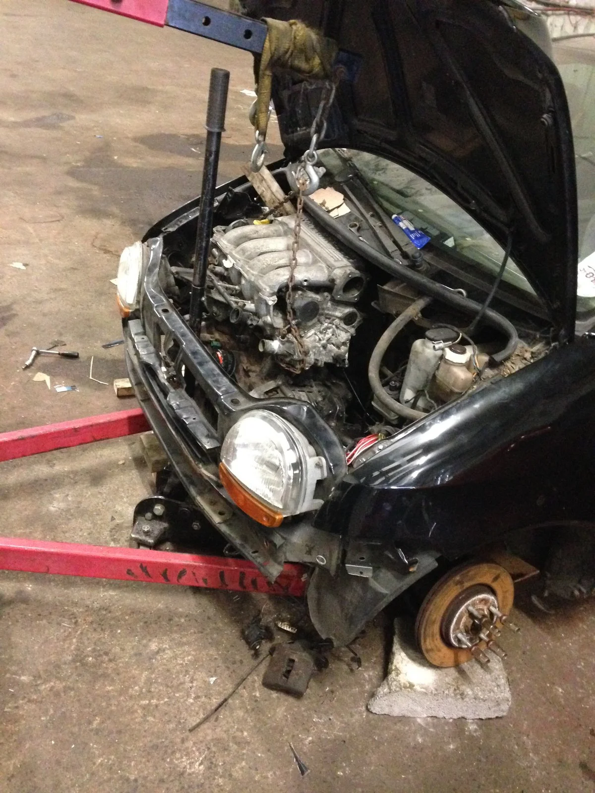

After a night of tinkering, the heart was out along with the gearbox. The plan was to use most of the parts from the Clio onto the twingo.

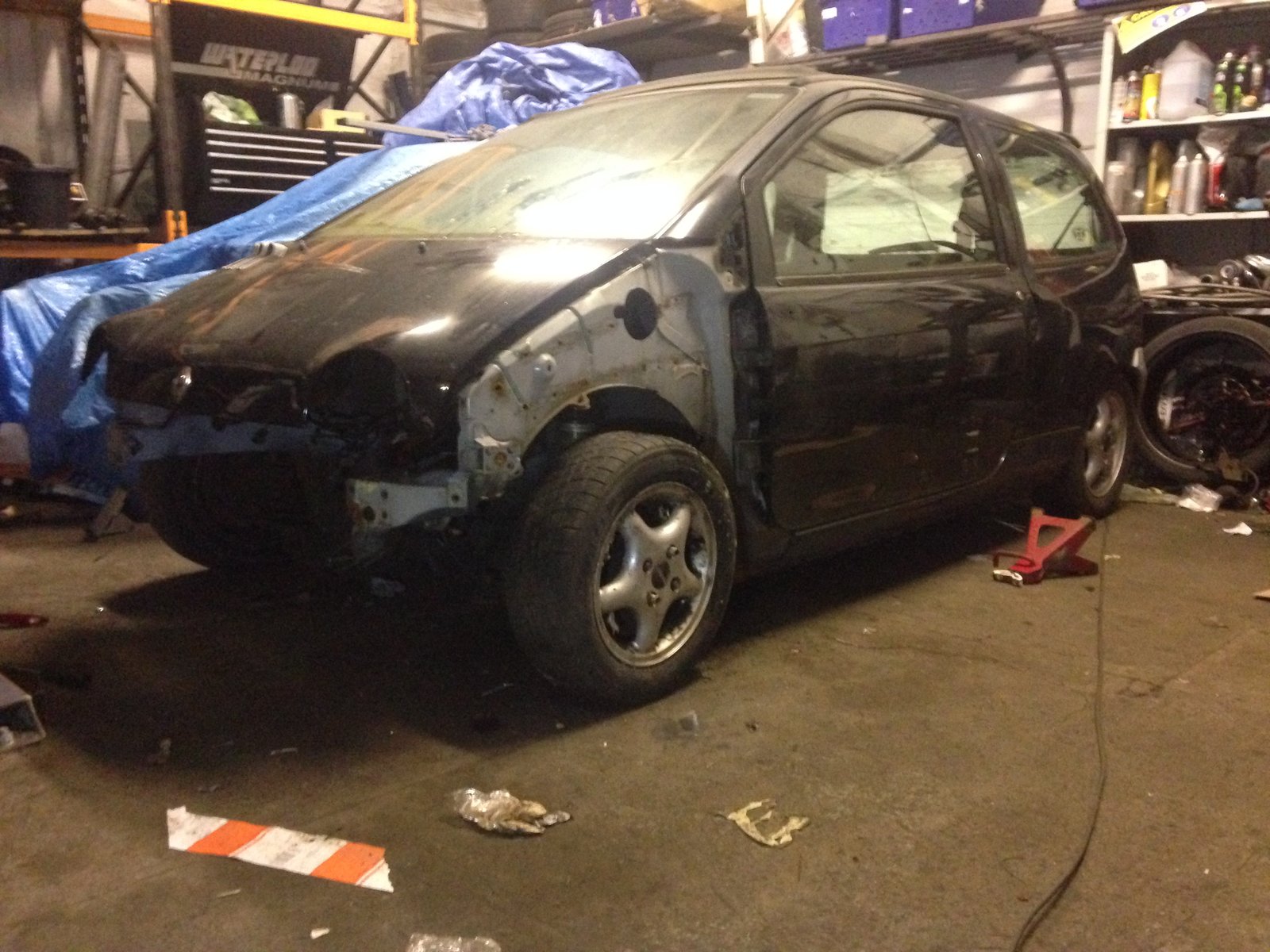

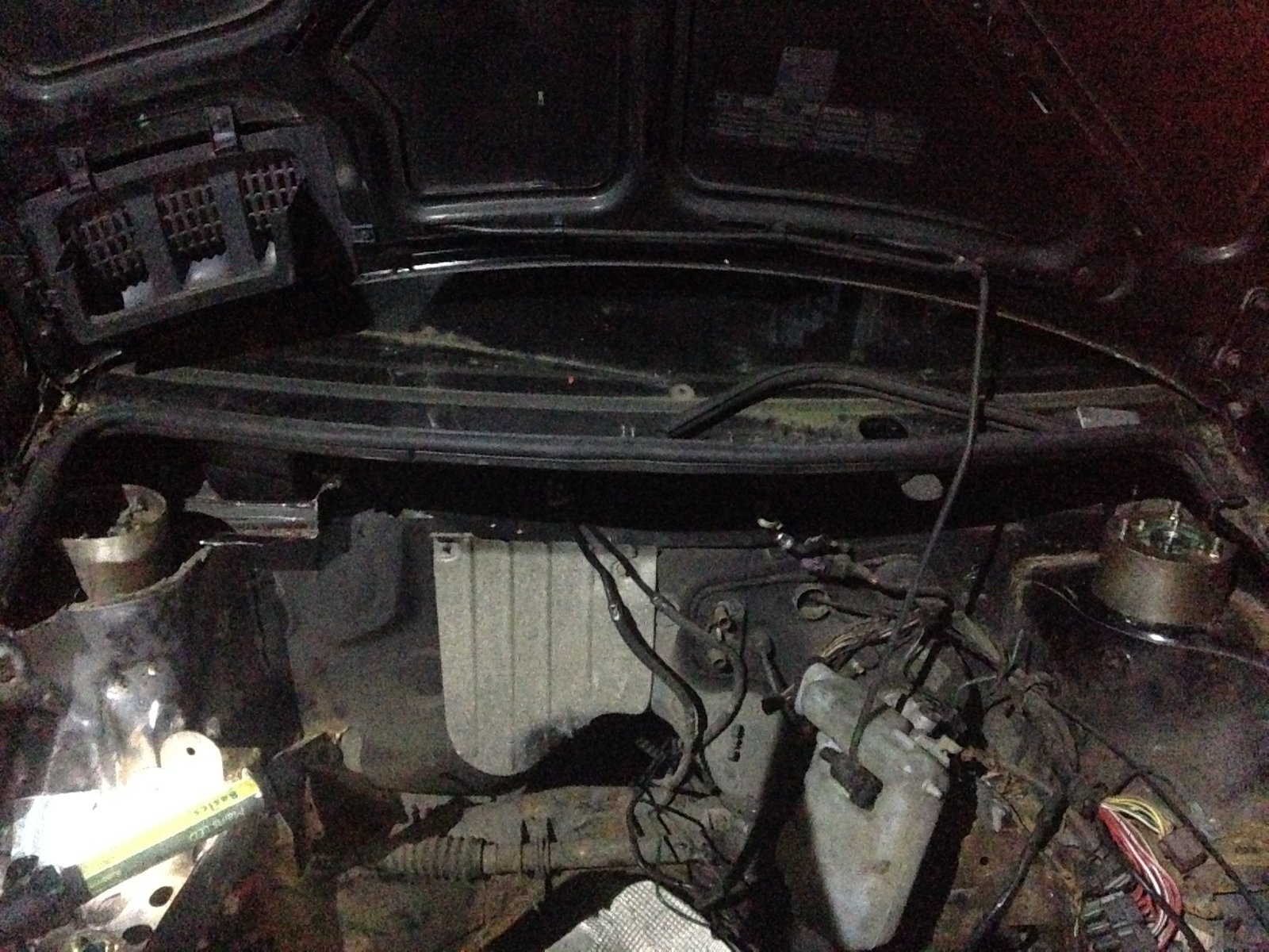

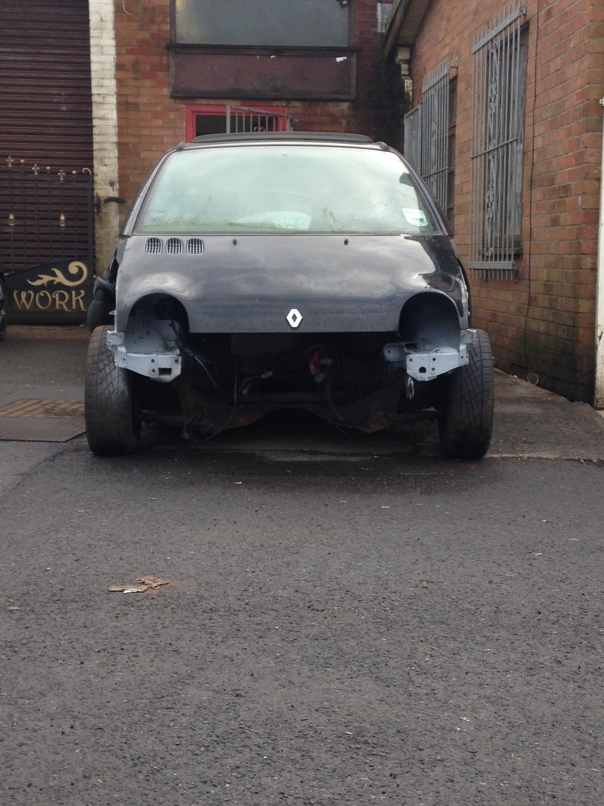

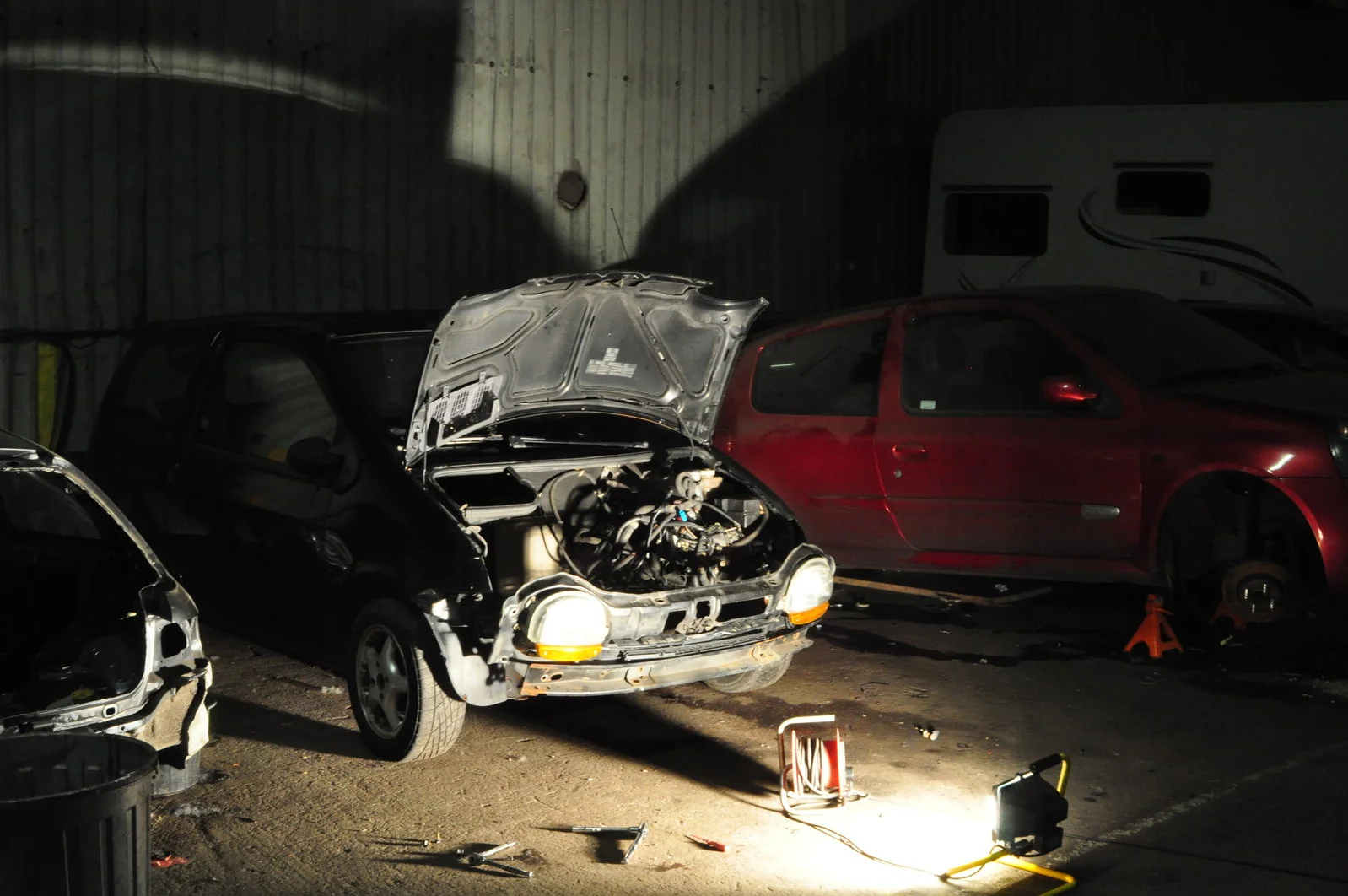

Since the twingo was sat outside in the darkness for almost 4 months, It was very impressed to see light again!

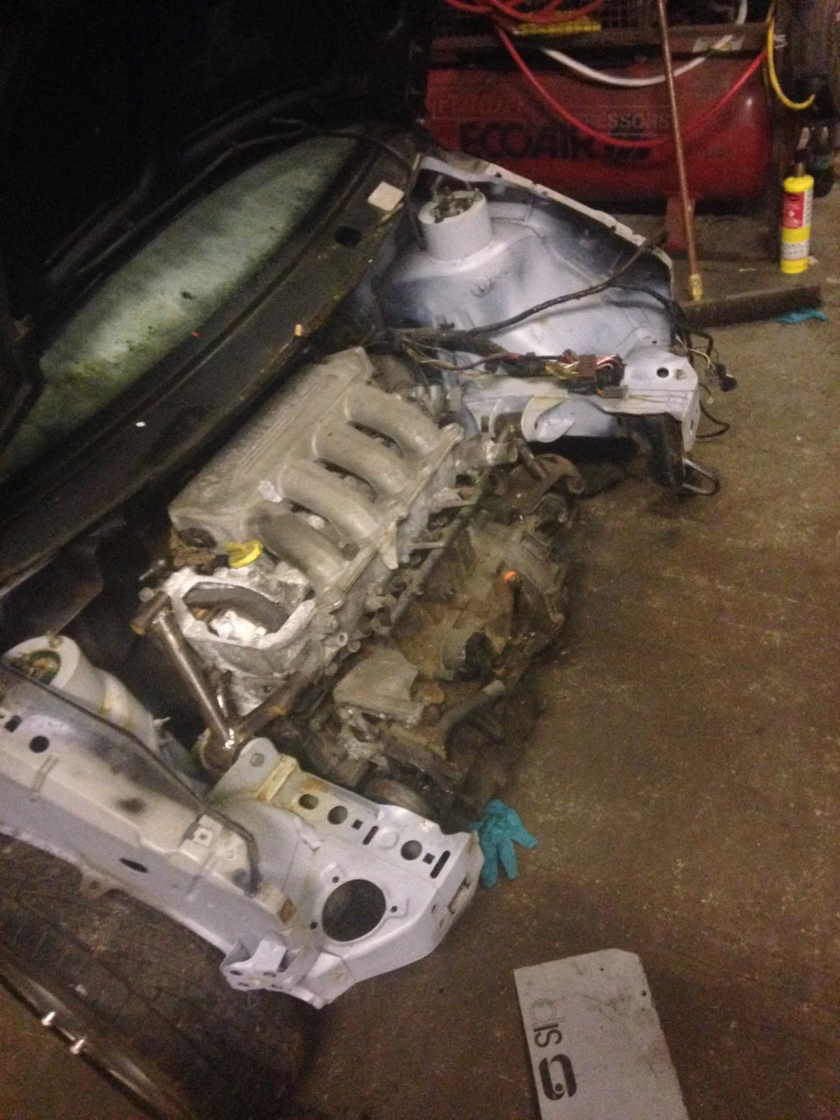

This engine configuration was not allowed due to increased health risks...

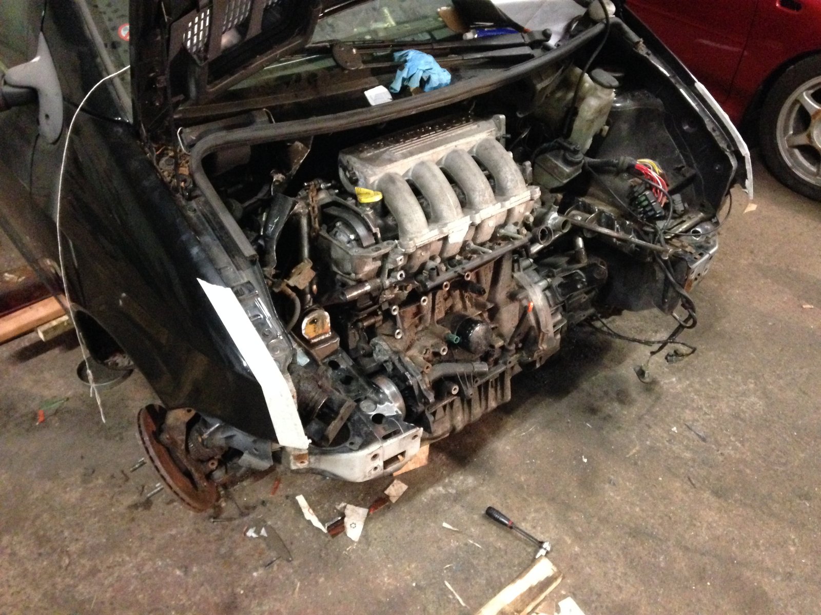

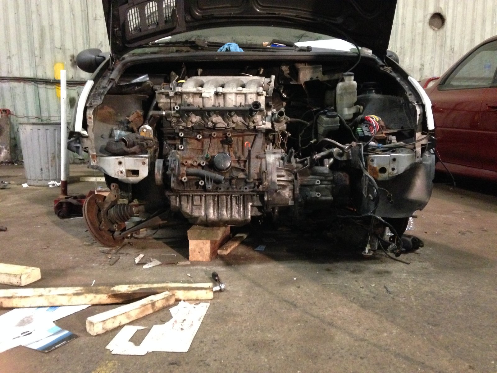

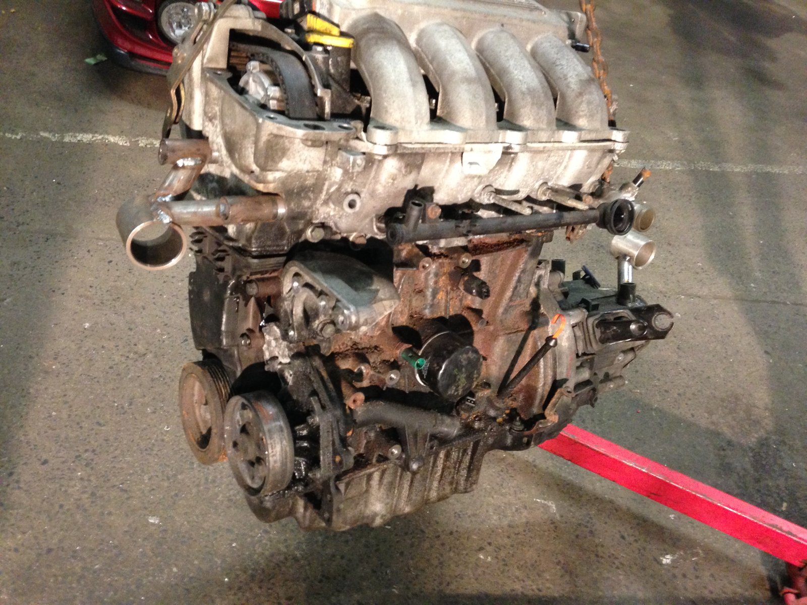

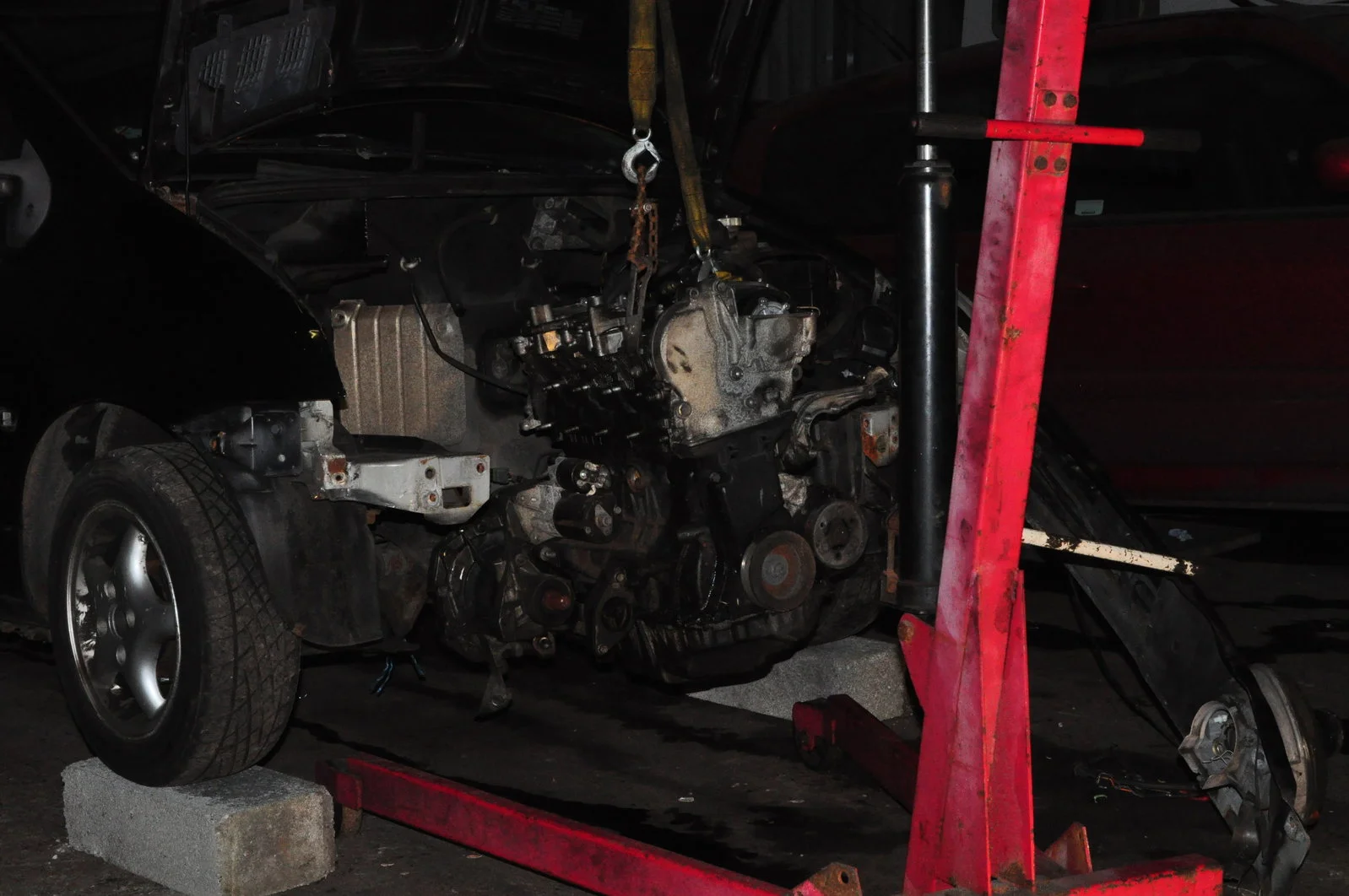

Just dumped the engine to see how it would look like inside the car, It was 3am but we wern't going home without an image in our heads!
The first thing was to Chalk up the engine into the chassis. The chalking was a pain since there was little room to maneuver and a lot to think about. e.g. driveshaft alignment adjacent to the subframe, Exhaust exit etc.

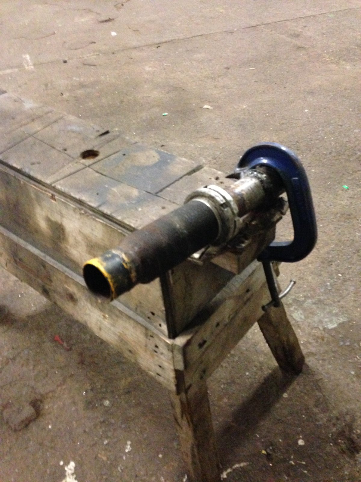

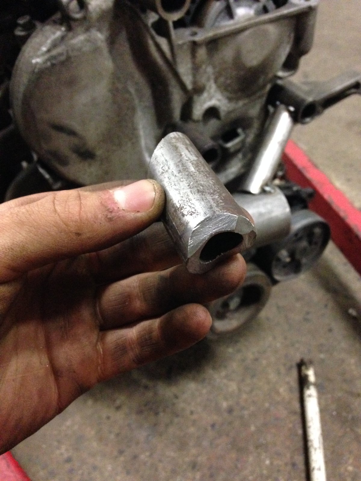

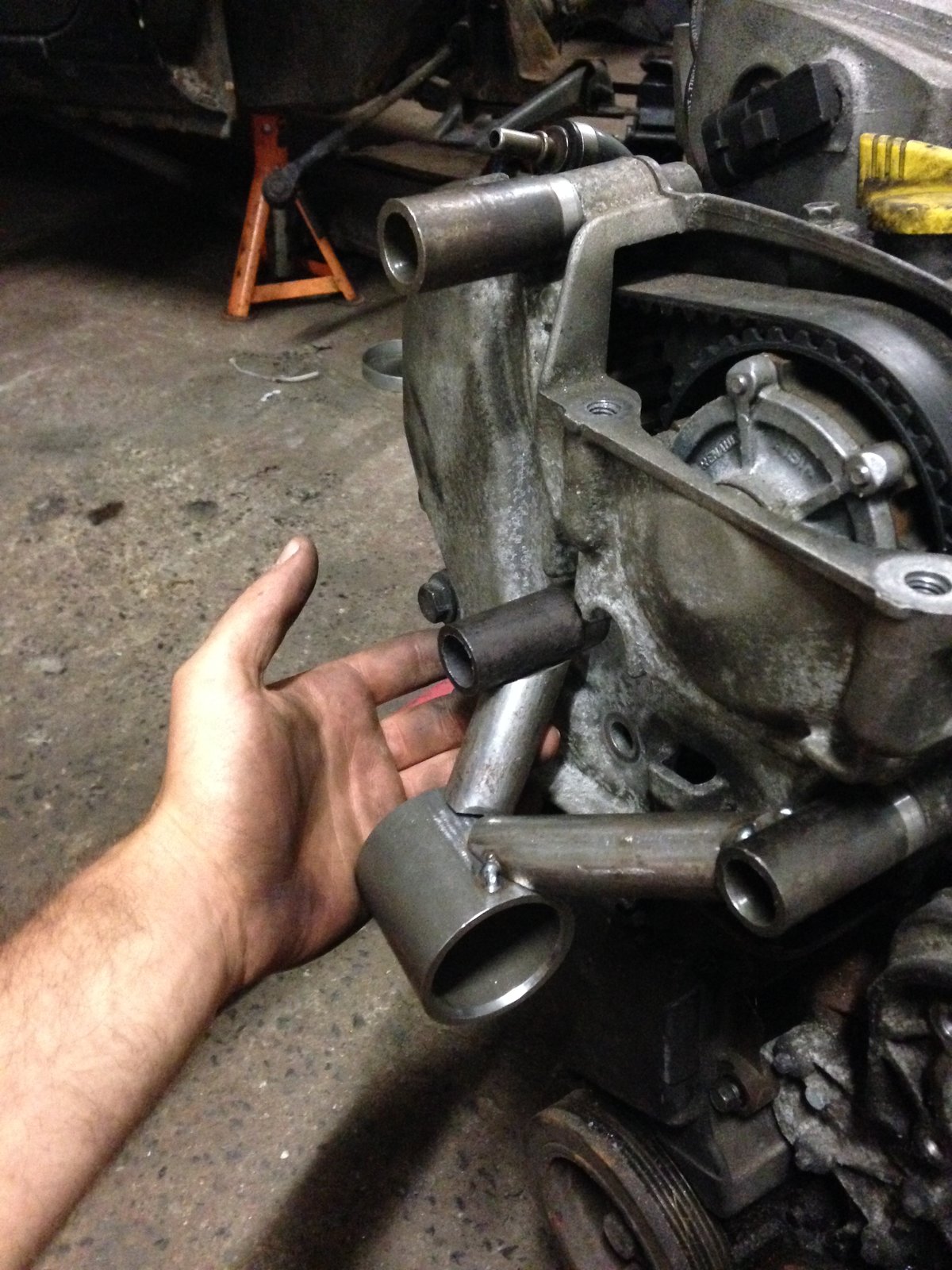

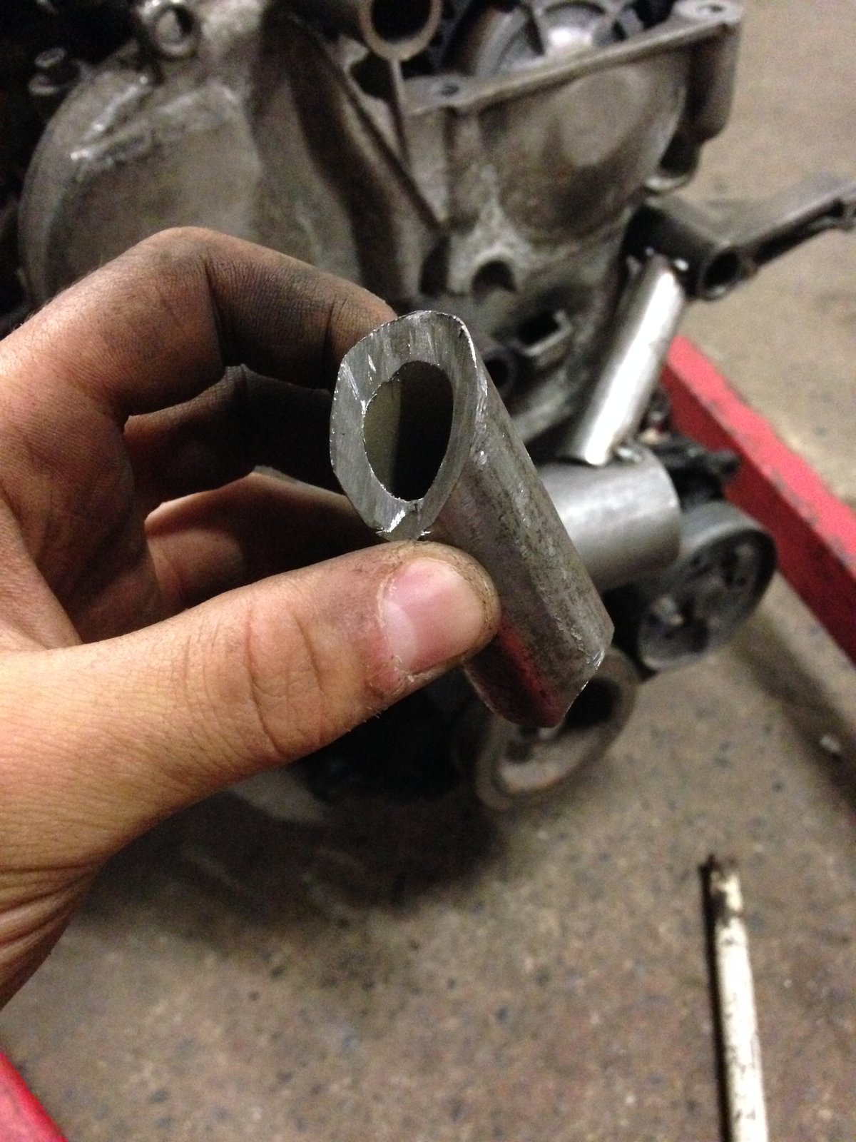

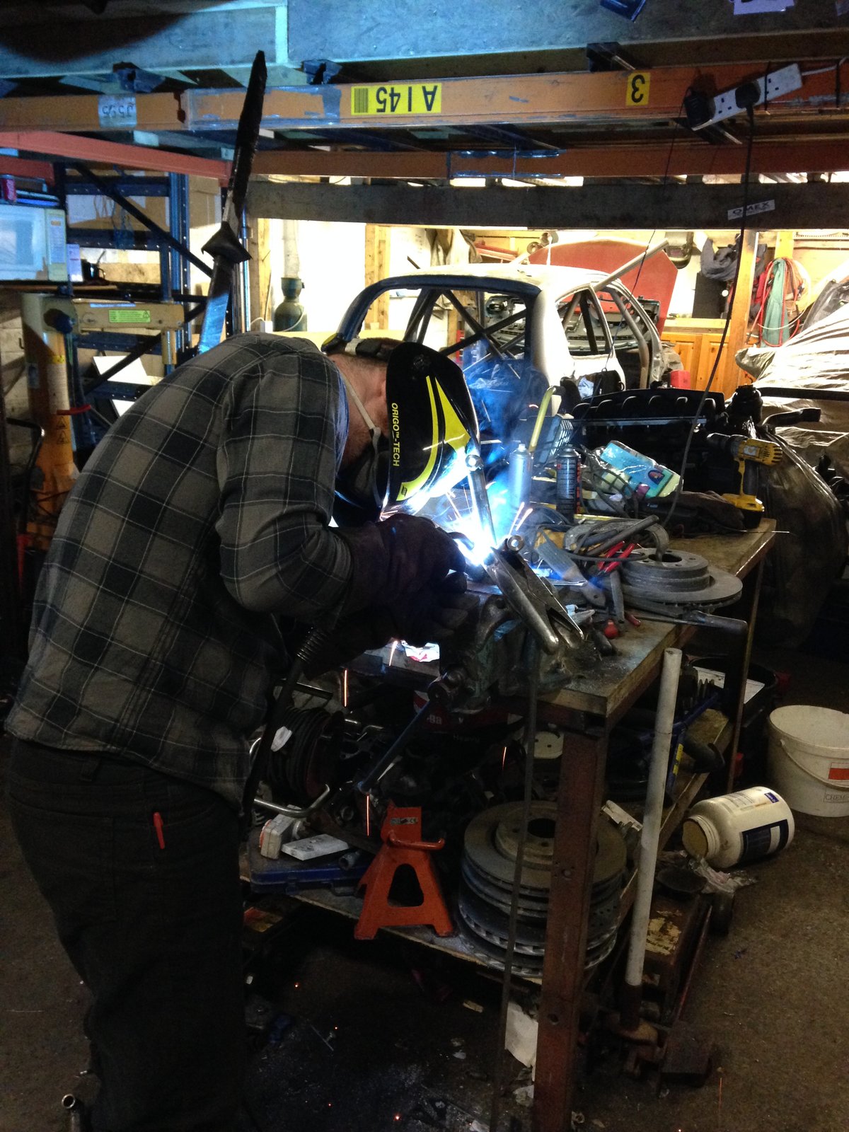

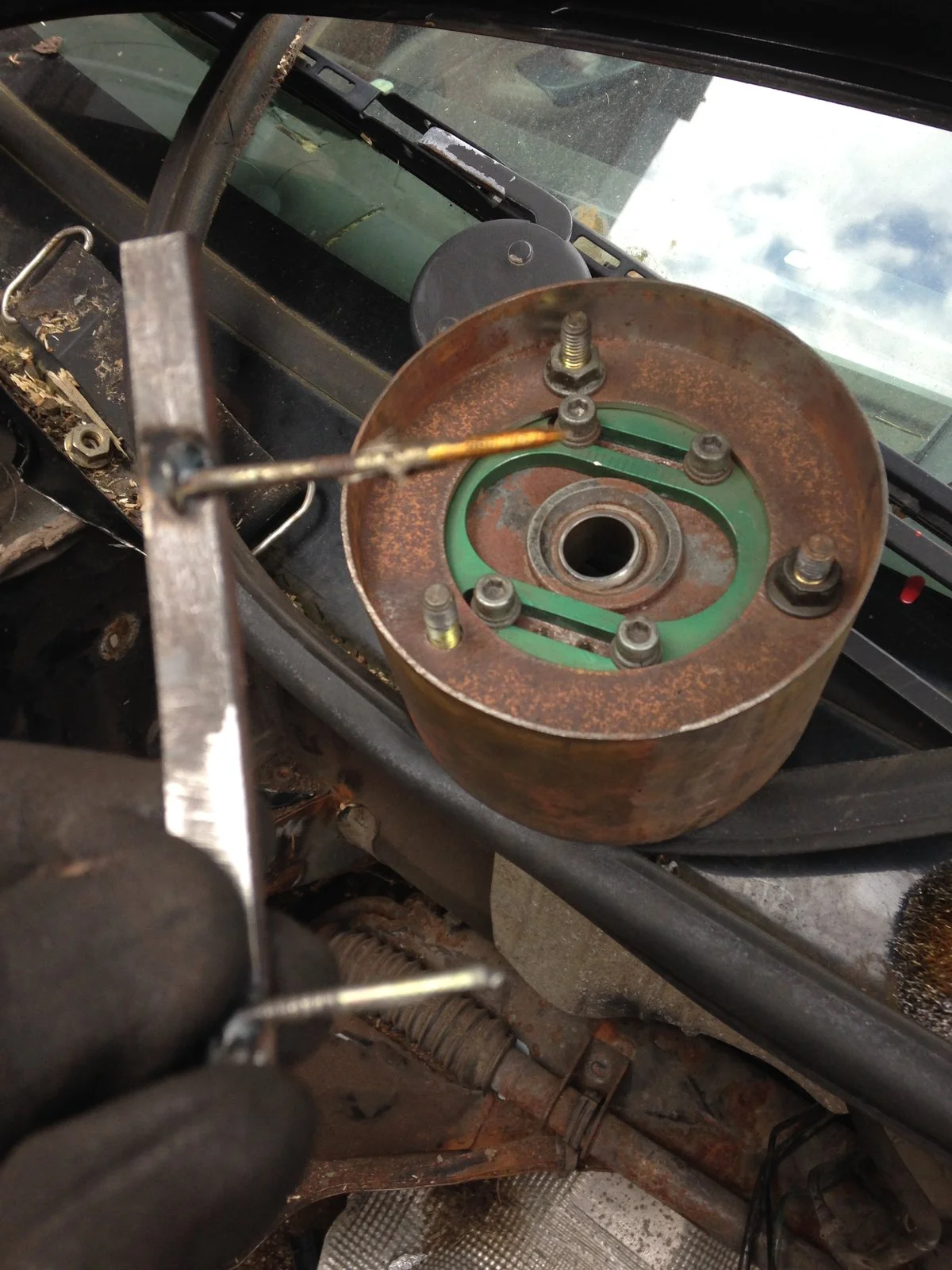

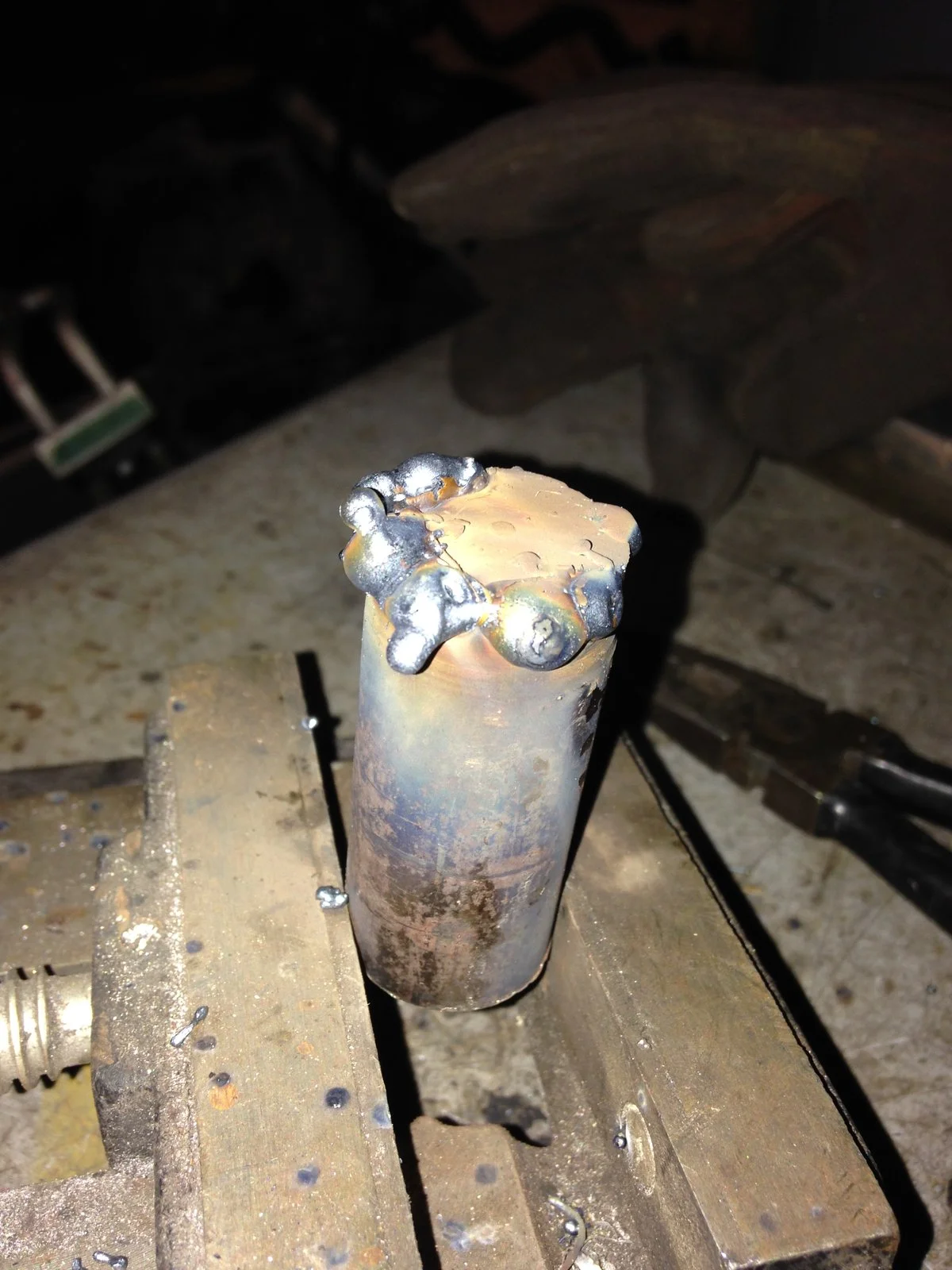

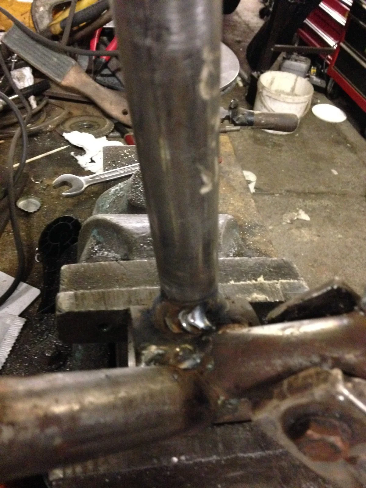

Next : engine side mount needed 3 studs that were going to be bolted on to some of the existing engine side mounts. This is one of the studs with my 2nd attempt at welding them , 25mm tube with the ends drilled out to make way for the hex bolts !
Ha! I had never ever thought of that, but I so see it!

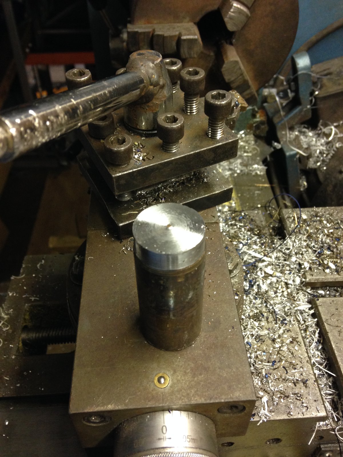

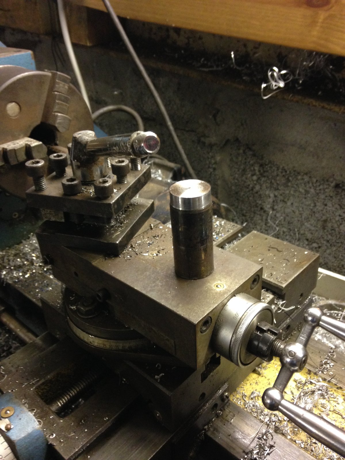

After some cleaning up on the lathe, They looked Fab !
All is left to do is to center drill it to spec.

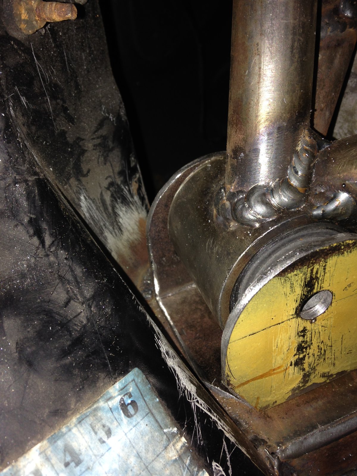

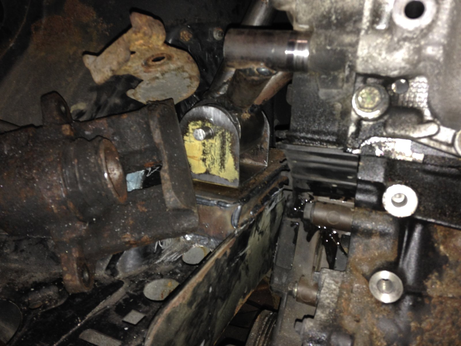

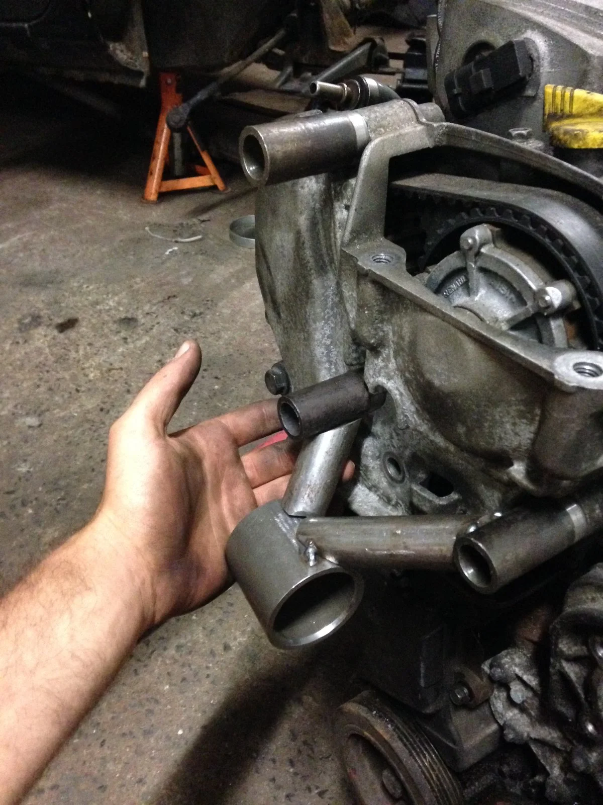

The mount was coming along nice, You can see the lathed parts on the 3 mount points on the engine. The bars inbetween the studs took hours to grind and shape but it was shaping up well. Made sure that all the 3 bars connecting the studs came to a point at the top of the housing of the escort bush housing so the engine load would sit on top.
Grind... Put on top of bush... Grind again haha !
With the 2 studs fully welded to the bush on the engine side, I started to concentrate on sorting the gearbox side out.
.... Of course l have left the welding to the expert... I go as far as tacking lol
Can't really see but that's the engine side mount fully welded. Lovely job Greg !
After that , placed the engine back to see if the drive shafts still cleared and everything was okay and not out of place.
Everything seemed legit!..

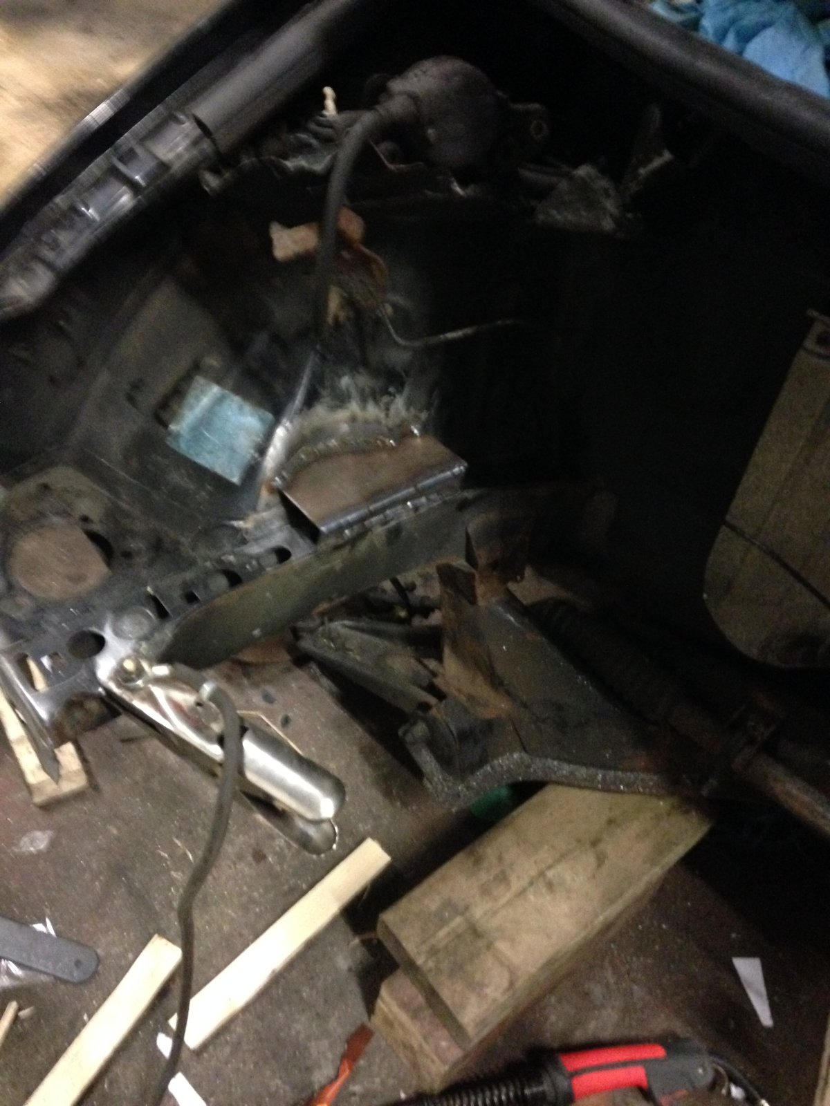

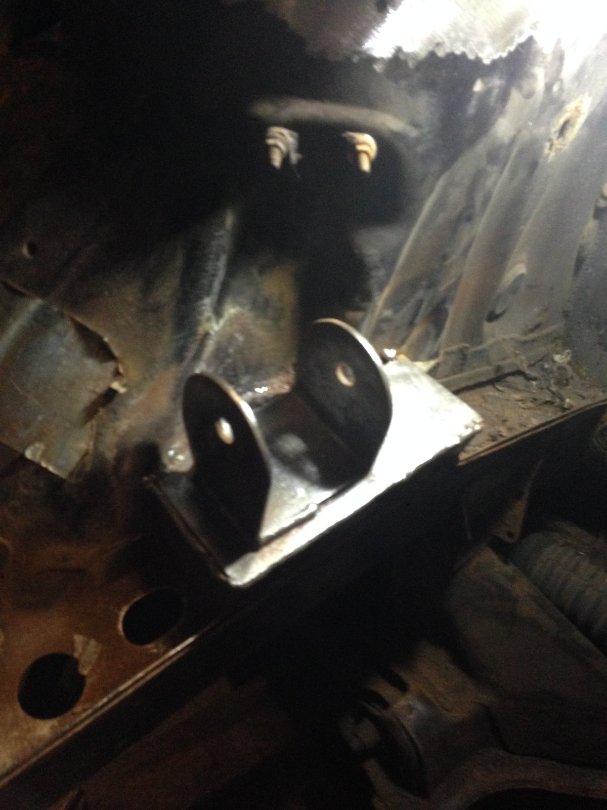

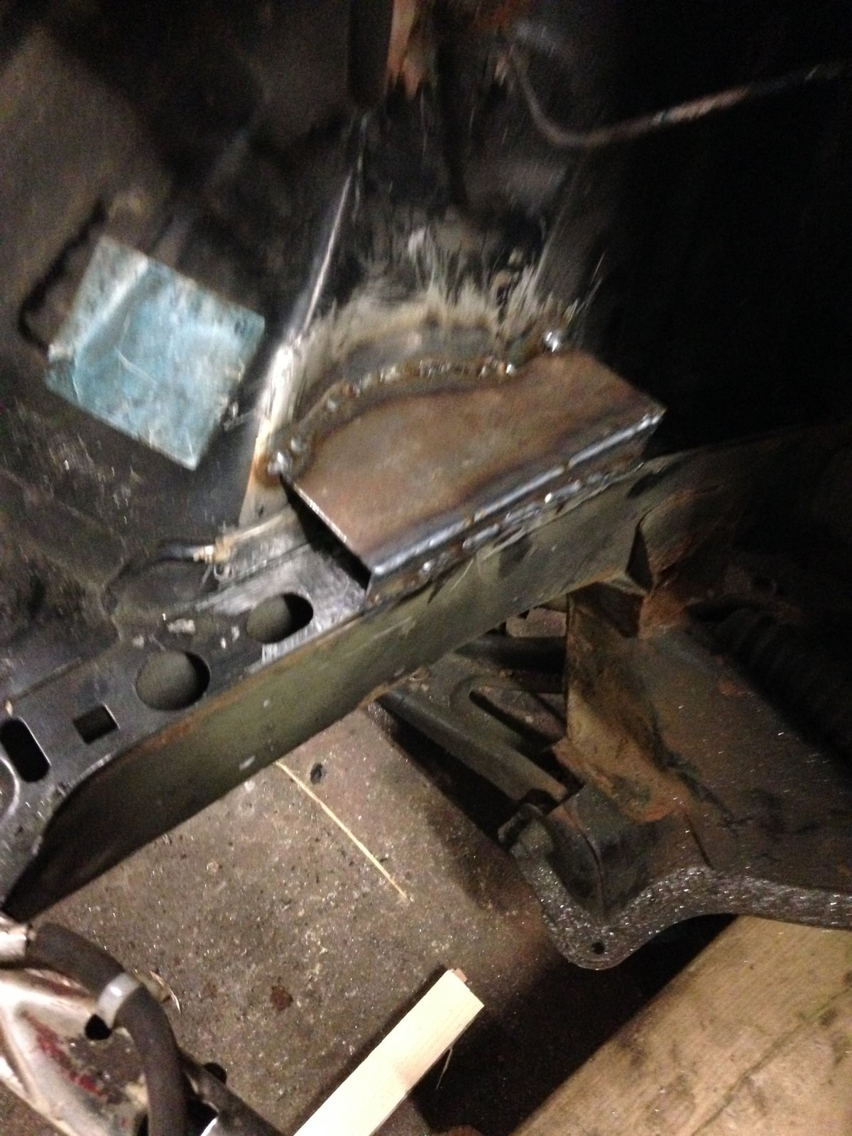

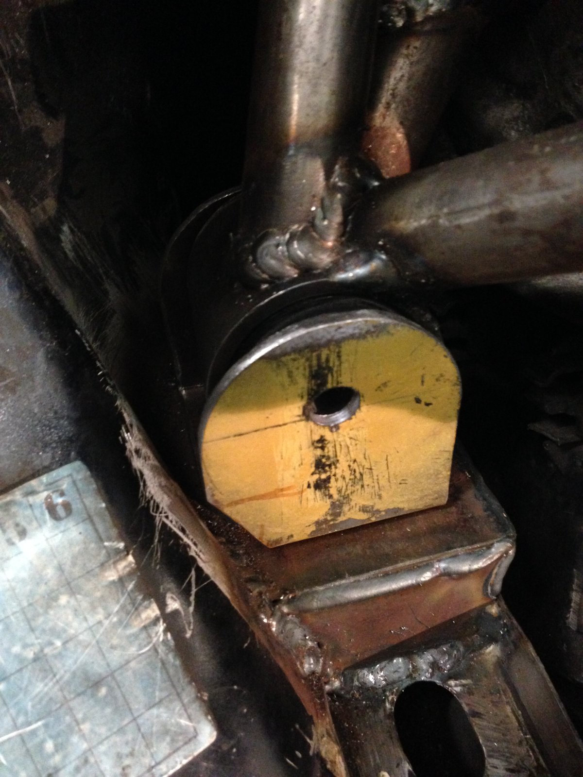

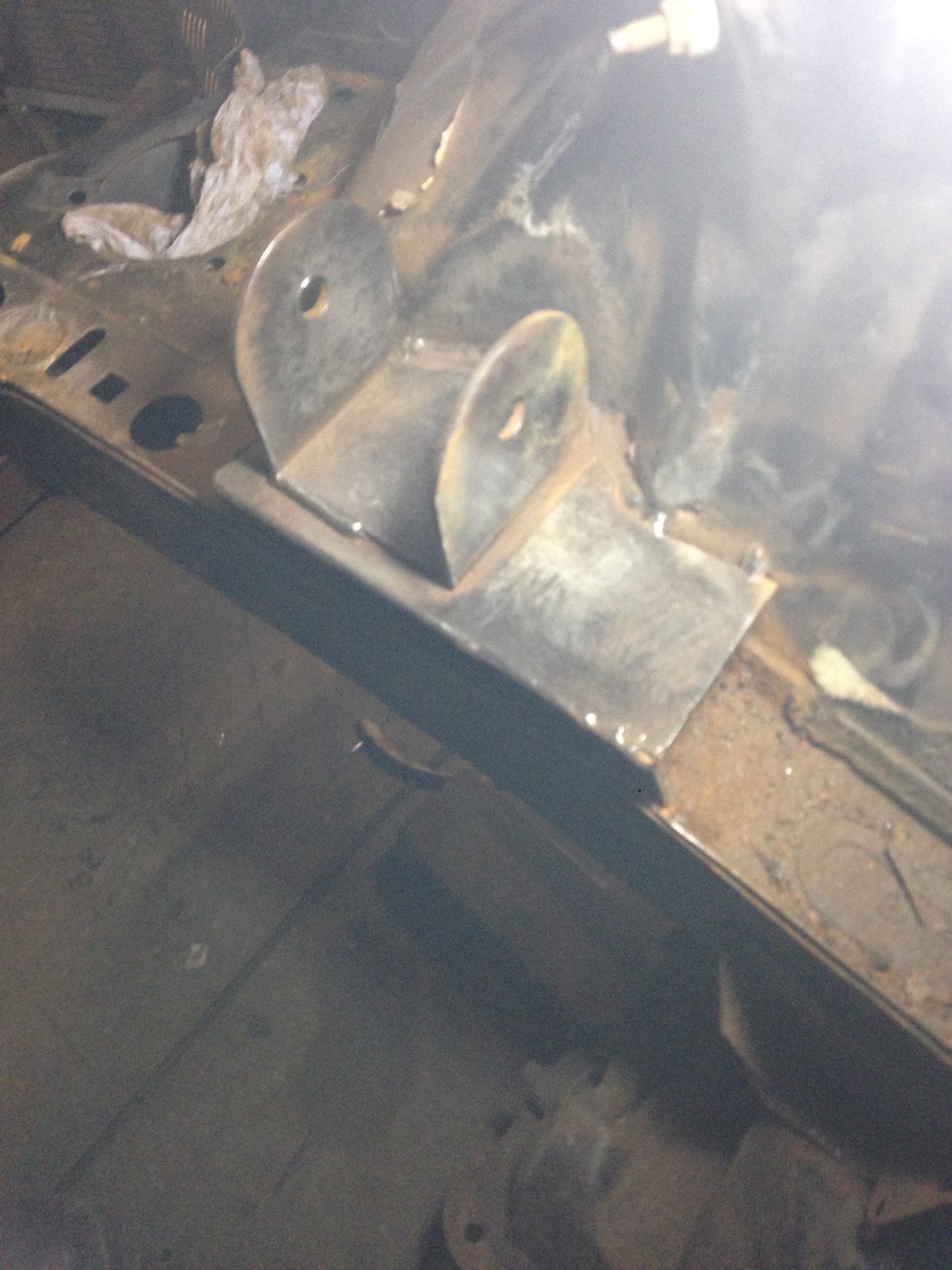

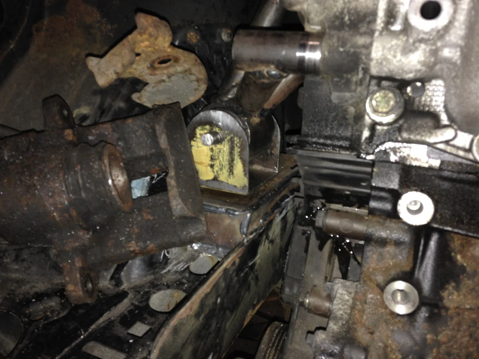

Welded Plate where my Engine side mount will be sitting is

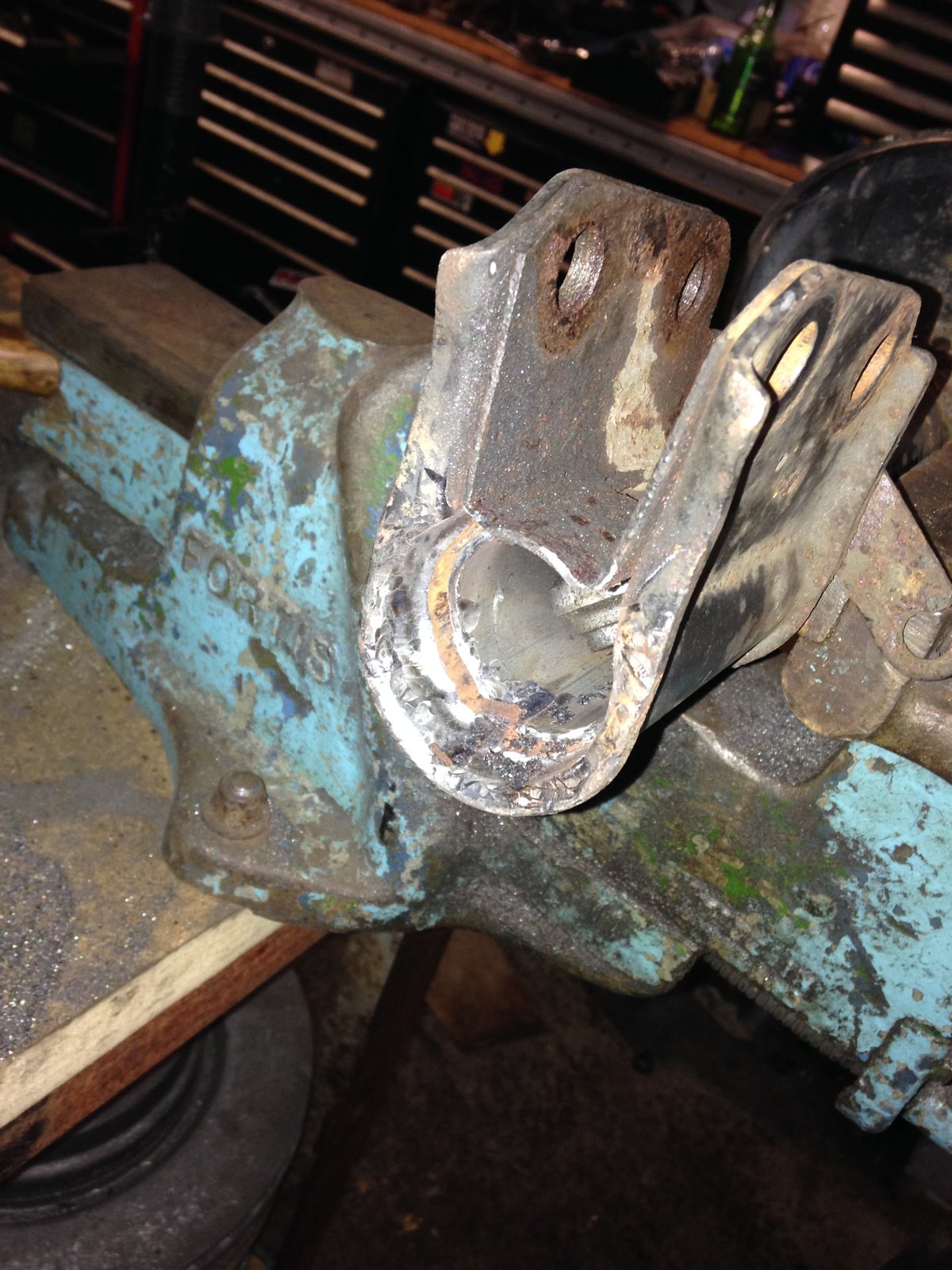

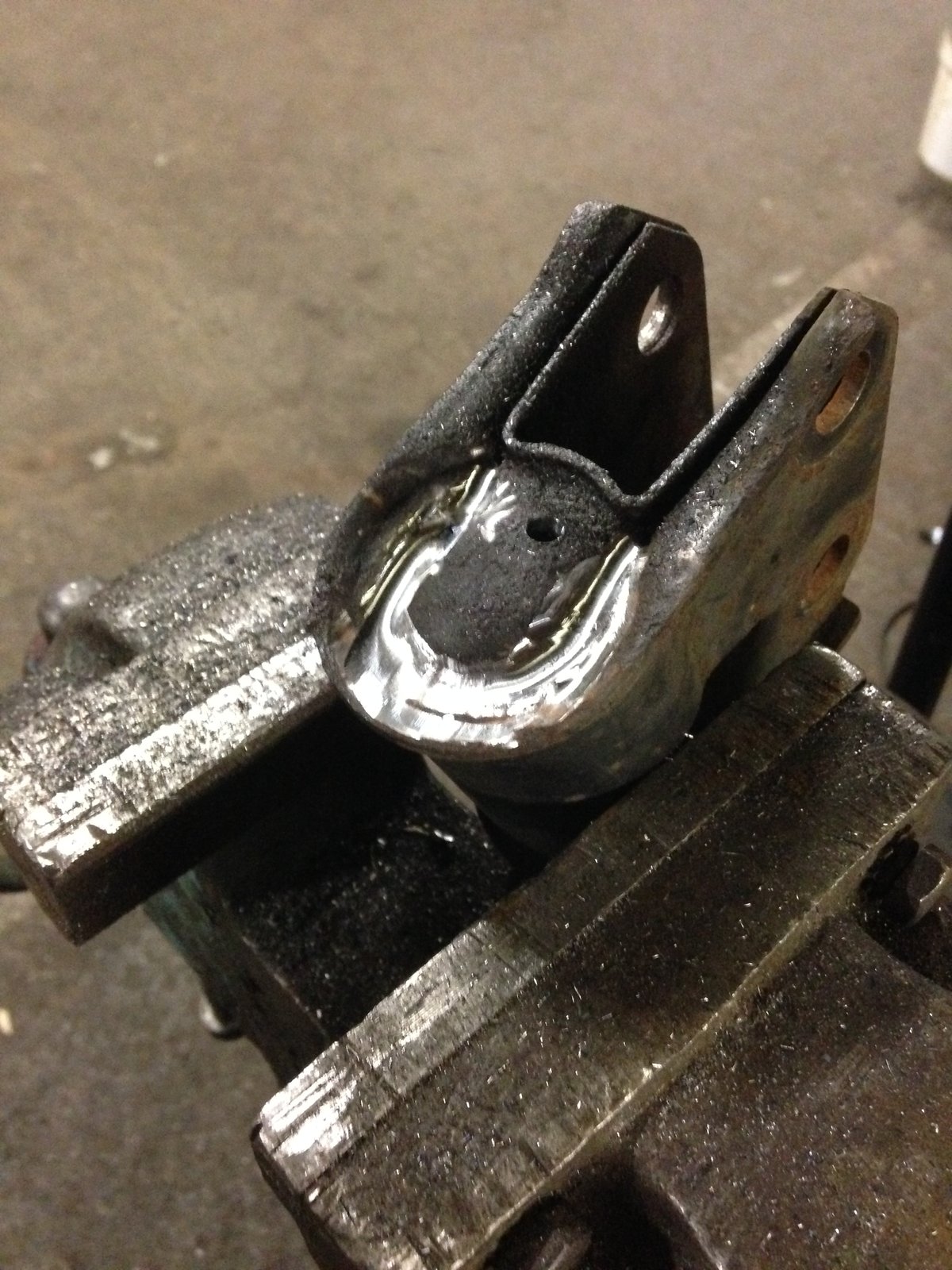

Bent some 3mm plate to make A "U" shaped bracket, This is where my escort bush will rest.

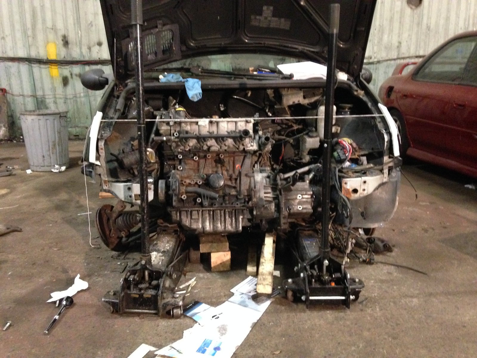

Now this Bit Took me ages: Trying to get the engine as level as possible before finally Tacking the 2 chassis side mounts in place... Greg saw me faffing around, Ended up placing some string across the whole car... Made life 100 times easier lol
Everything is level , placed a pin through the "U" bracket and the Bush

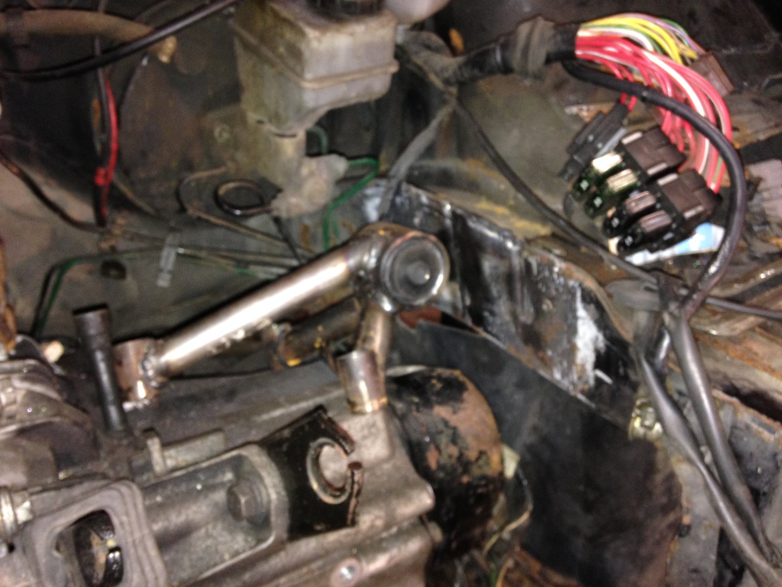

Now for the Gearbox side....
With both Chassis brackets Welded/Tacked up , Everything bolted nicely from engine to chassis.
There you have it... The heart is held in by its own weight !
Another shot of The gearbox mount.. Cant wait to paint them up, they are going to look great !

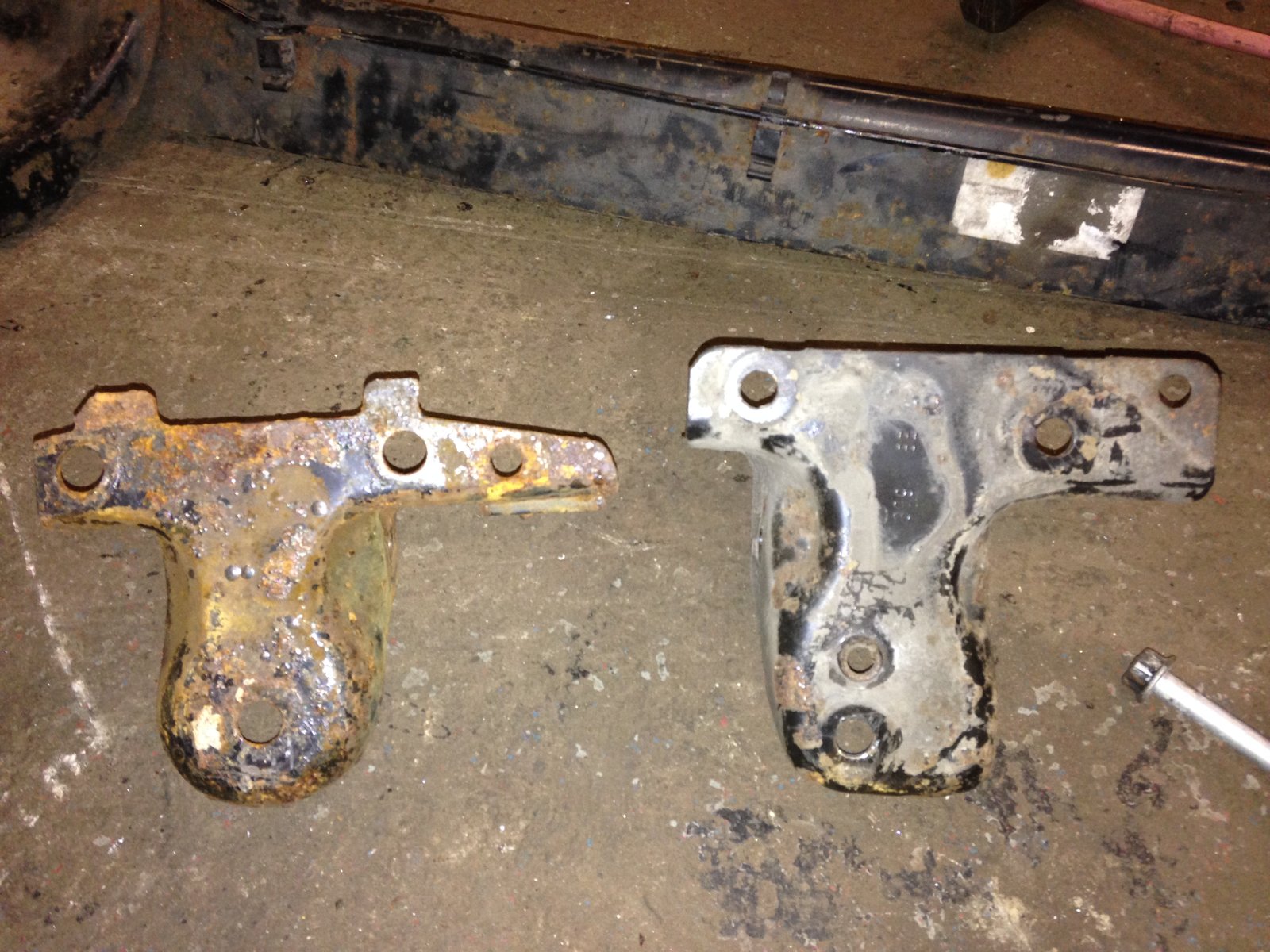

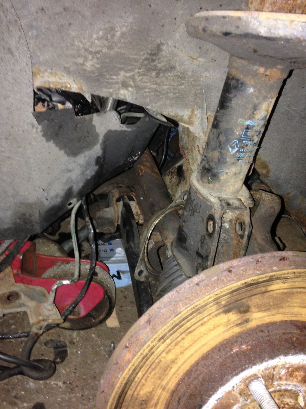

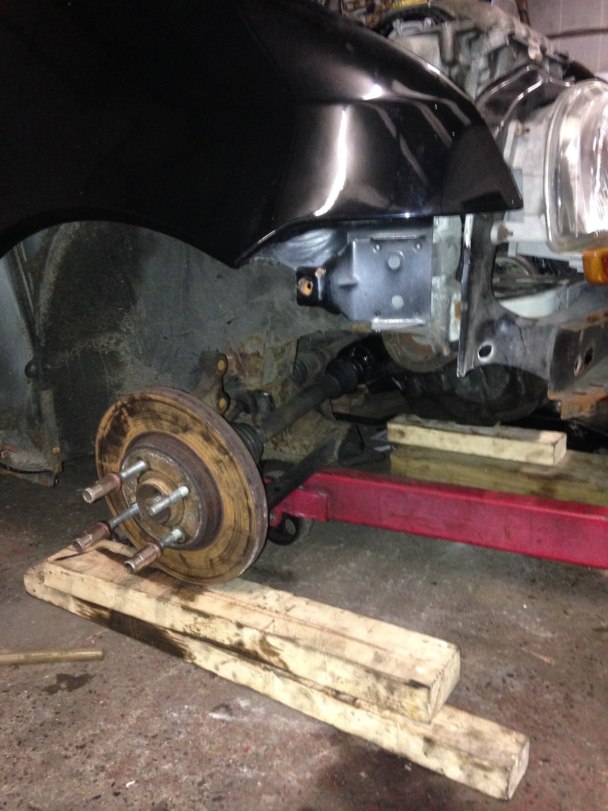

Now, The Suspension of this thing is a bit of a concoction/Cocktail mix of some fine skunkworks parts... here goes: Basically The Spax coilovers belonged to gregs old 4 door Clio (Which he F7R'd ). The 1.2 hubs are thinner and therefore the mounting on the coilies will not go round my 172 hubs, So the plan was to take the old shocks of the 172 and remove the mountings on them , then, slide them over the 1.2 coilies and weld them in place. So I dremelled round the welds in hope it will hammer off.
1 mount done , 1 more to go ,
Another one

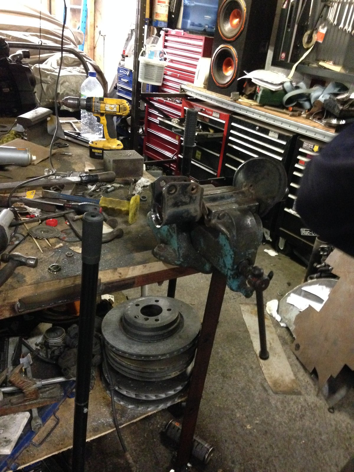

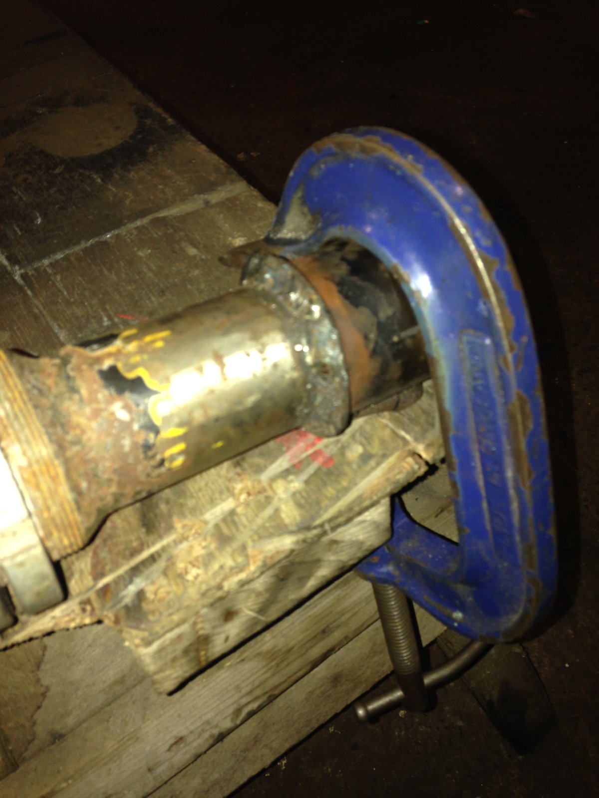

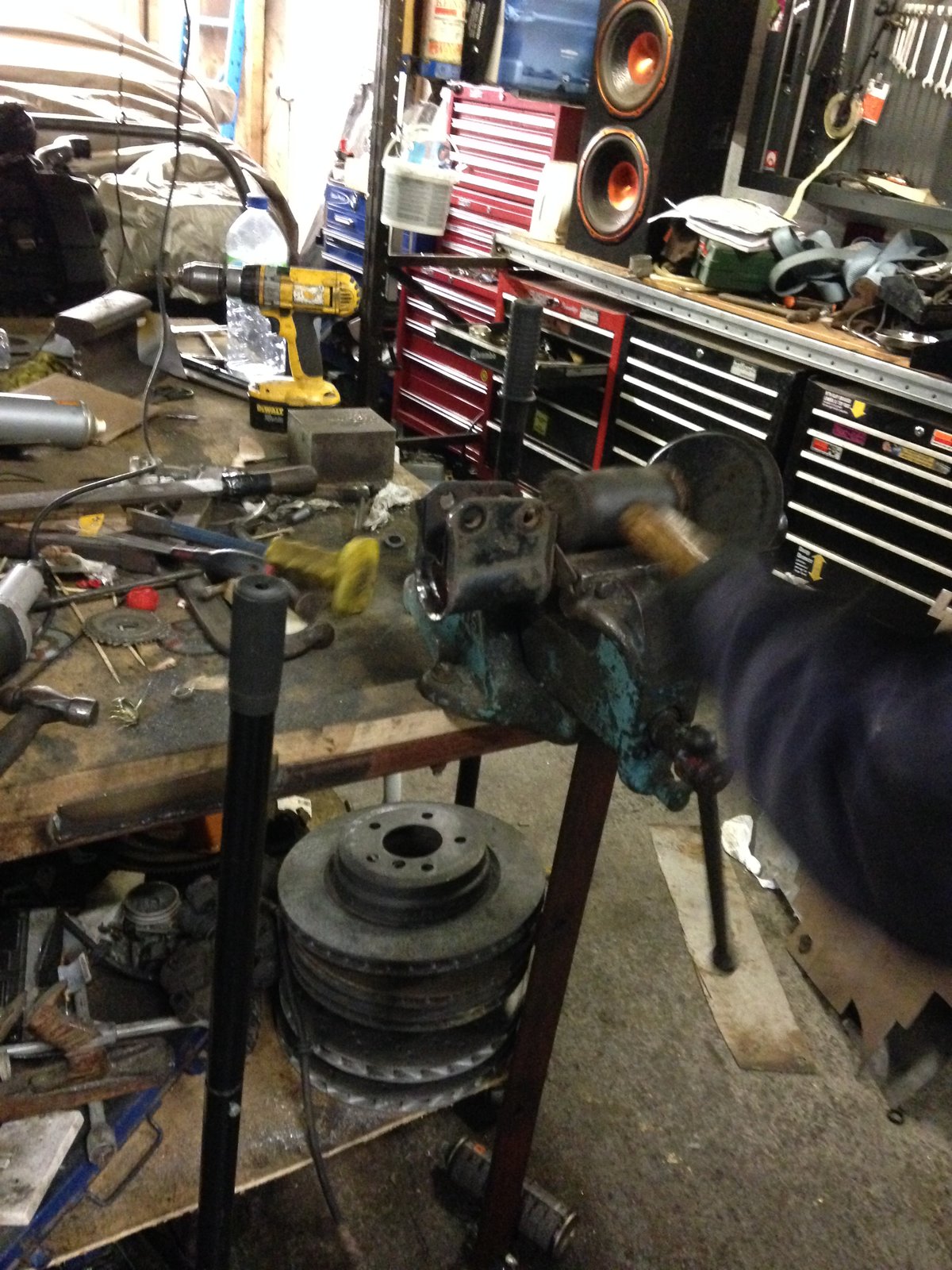

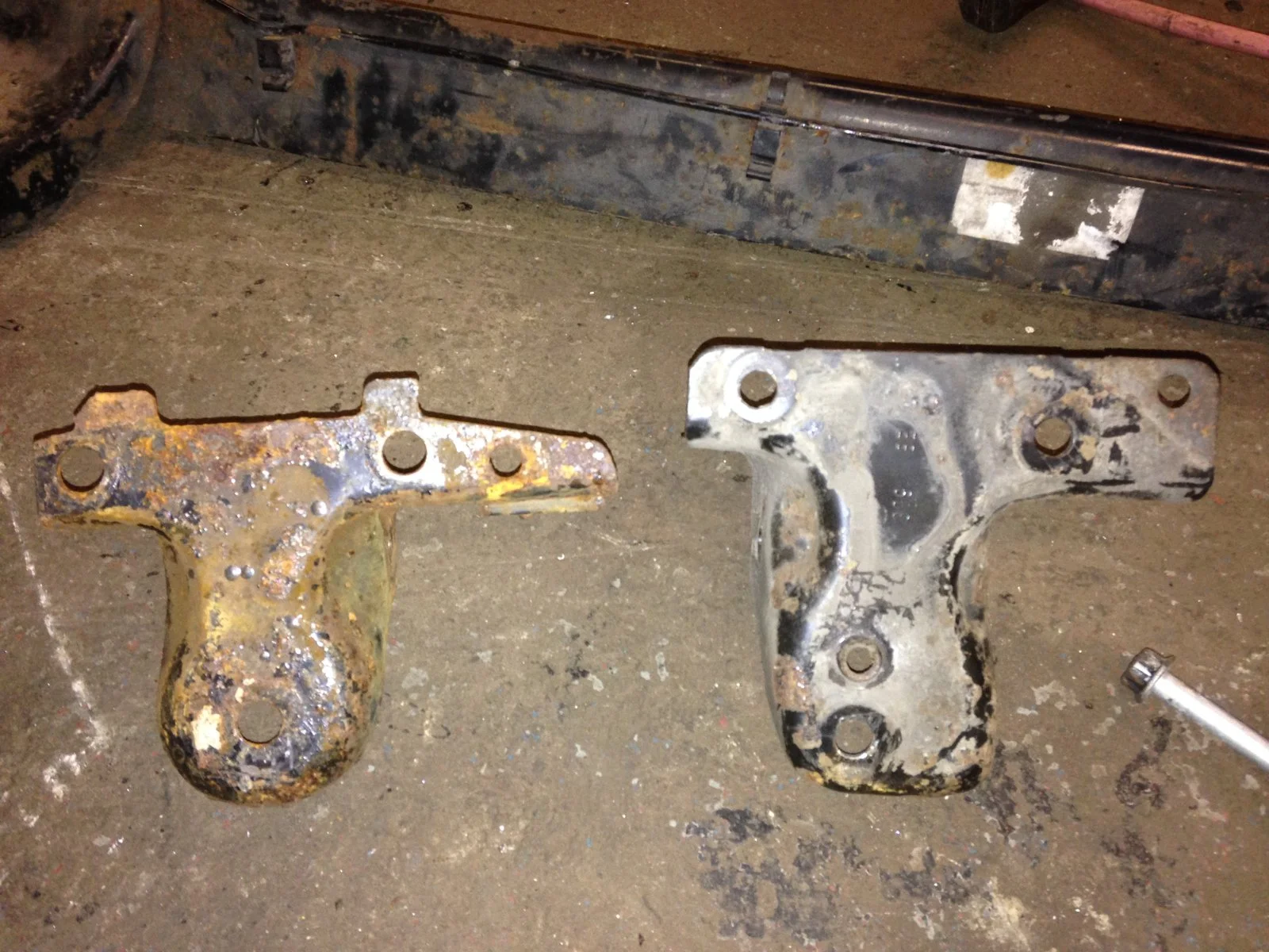

It took a couple of blows to get them off... But they did come off.. Well fly off.

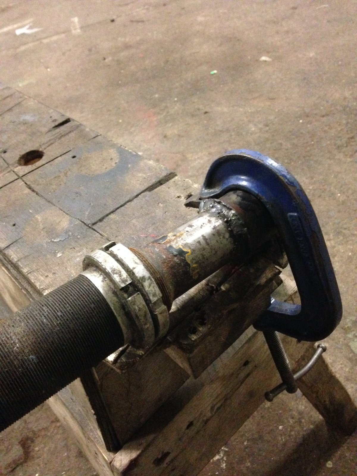

The Spax Coilies that I will be using, they also needed the Mounts ground off them
This is where I fucked up and pissed G off... , Kinda cut too much in with the angle grinder and ended up cutting into the actual cylinder. so he had to fix them up before sliding the 172 mountings on.. Sorry dude Lol

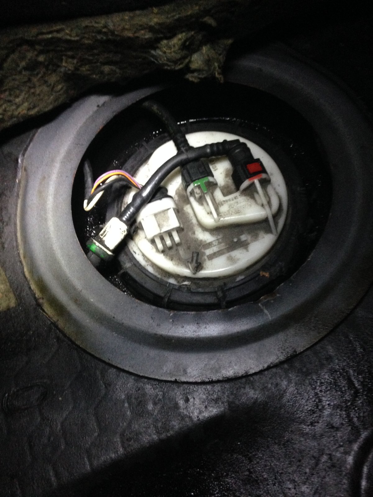

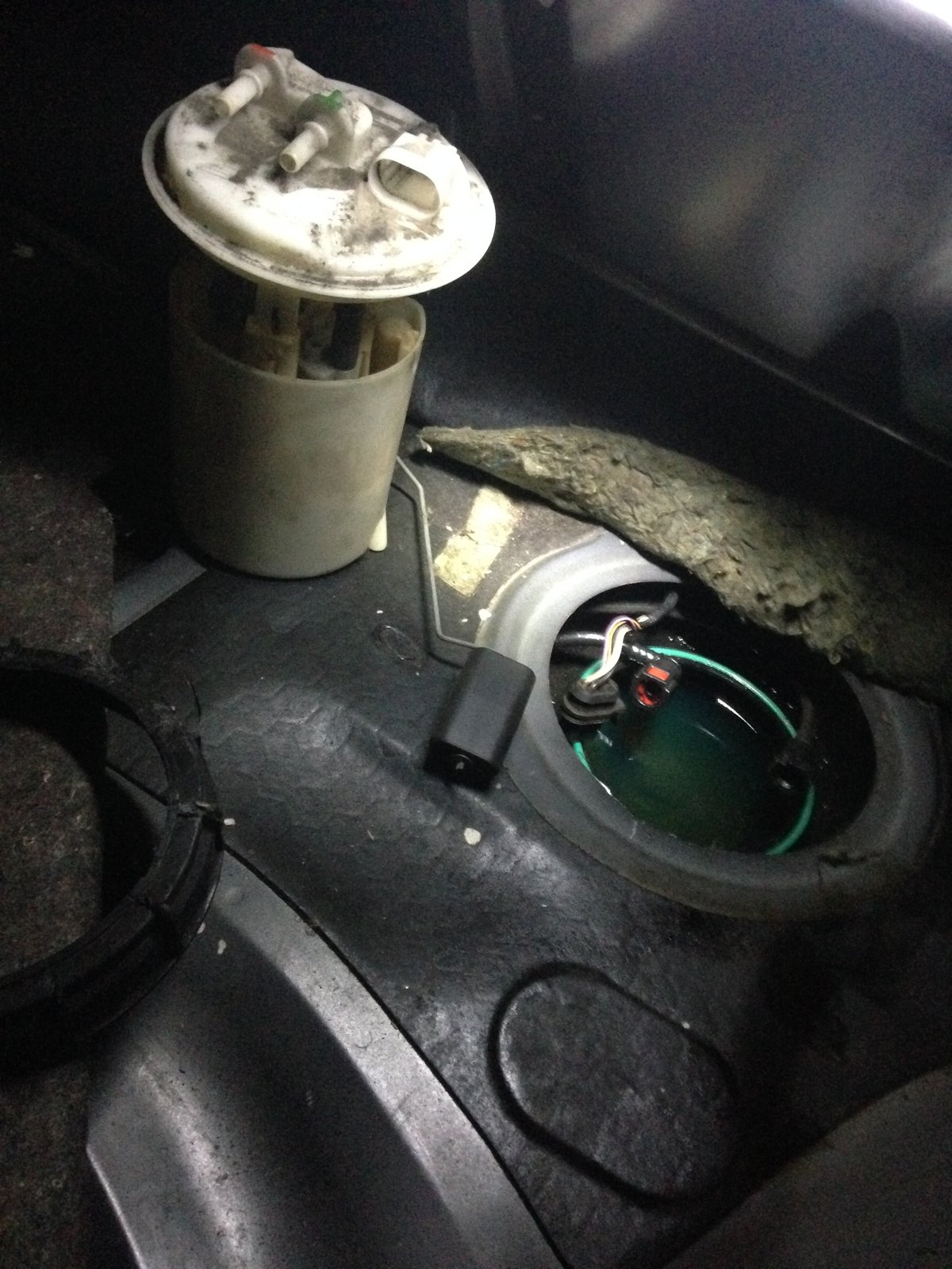

Fitting the 172 Fuel pump to the twingos tank.. (forgot that it had a full tank when I bought it , so you could say I was enjoying taking my time swapping the 2 items over... got me all chilled out this task.. know what I'm saying ;) )

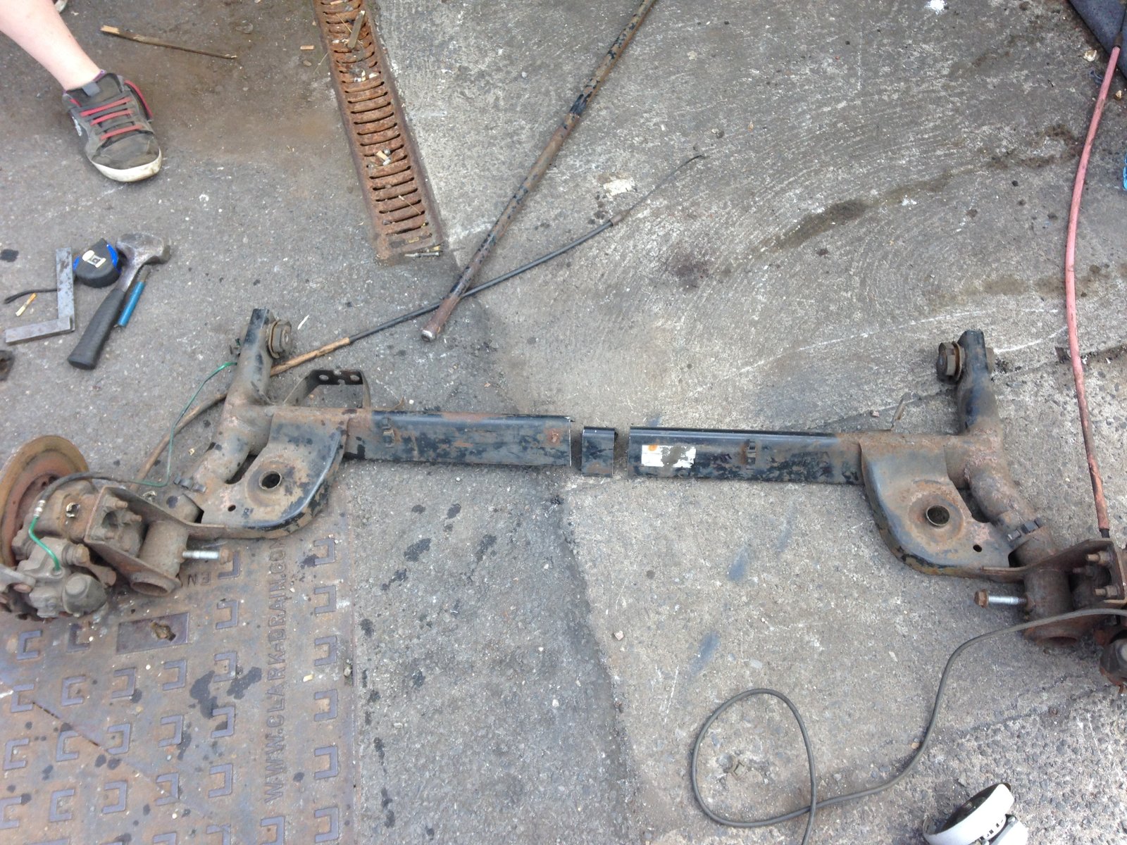

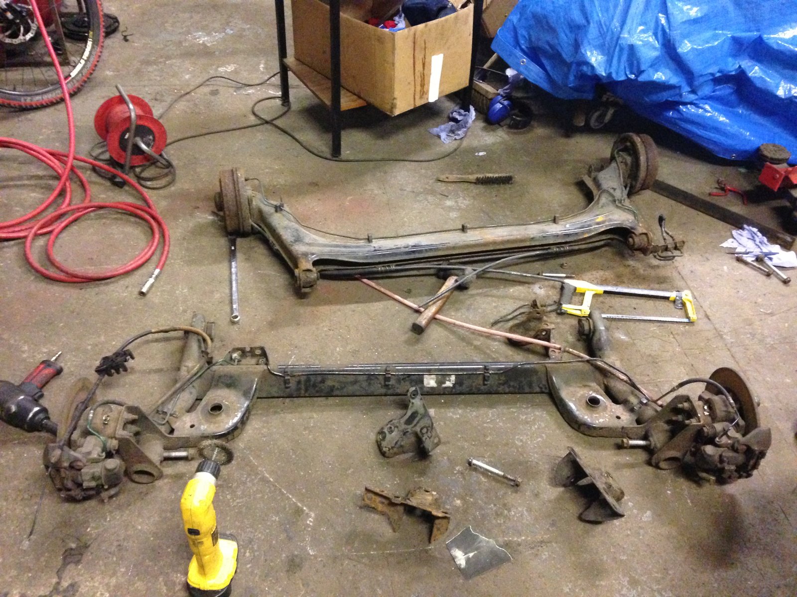

Now on this photo , The top beam is the twingo beam, The bottom is the 172 beam. Somehow I have managed to miss read another members build (The turqoise twingo 172) and thought that he mentioned that a 172 rear beam would fit straight on..... That wasnt the case, the 172 beam is a whole 5CM wider from mounting point to mounting point..

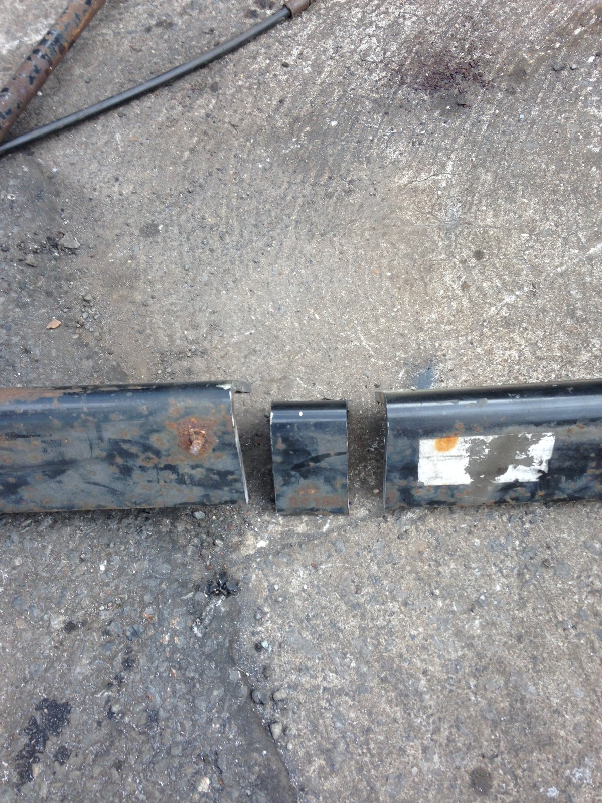

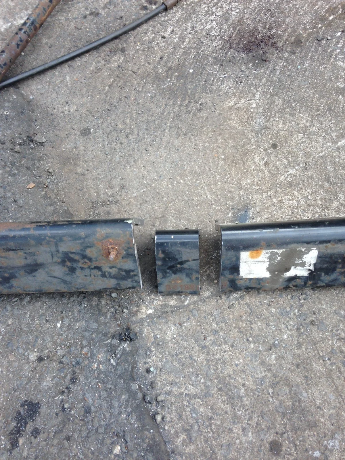

Greg advised to chop the beam in half where we would weld it... I was rather dubious but after some persuasion(not much atall) I said F**k it and I ended up chopping the bugger in half ... (at that point I didn't realized I misread the build thread ... lol )
Im a little bit gutted as I have a few photos missing on me grinding the beam and making the strength plates after Greg seriously welds the 2 halves together and the strength plates.. If I find them ill place them up here.

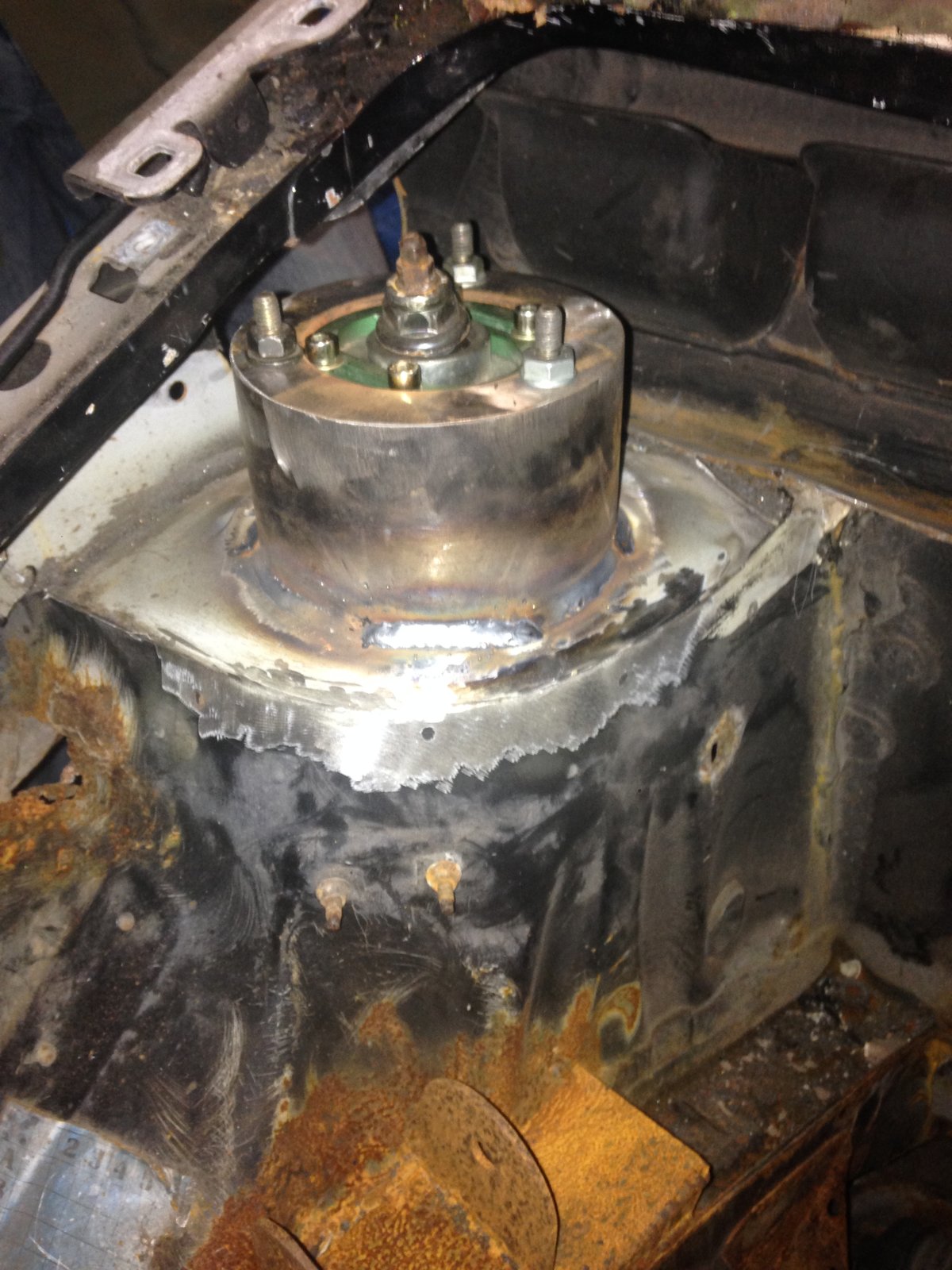

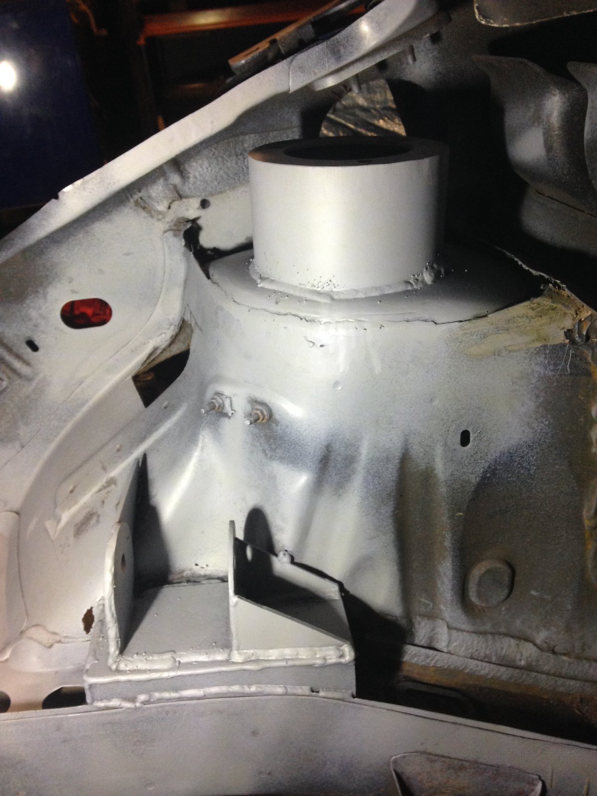

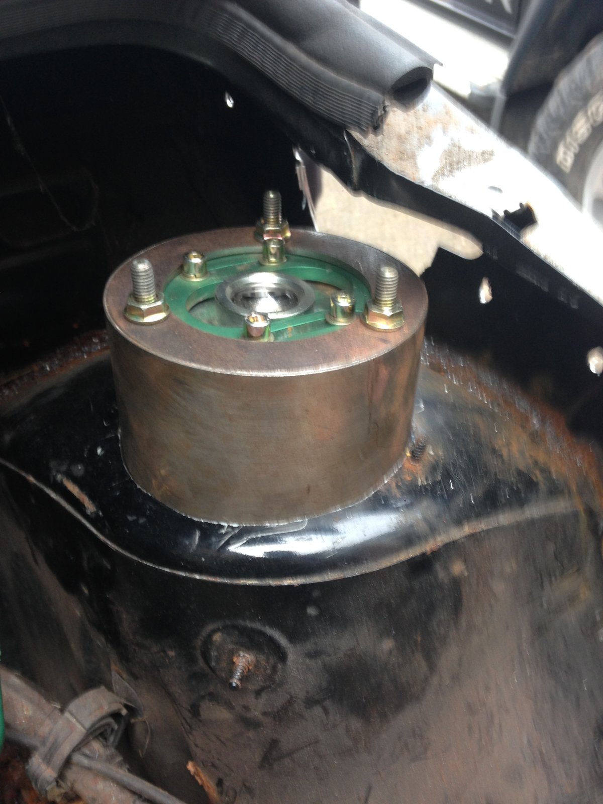

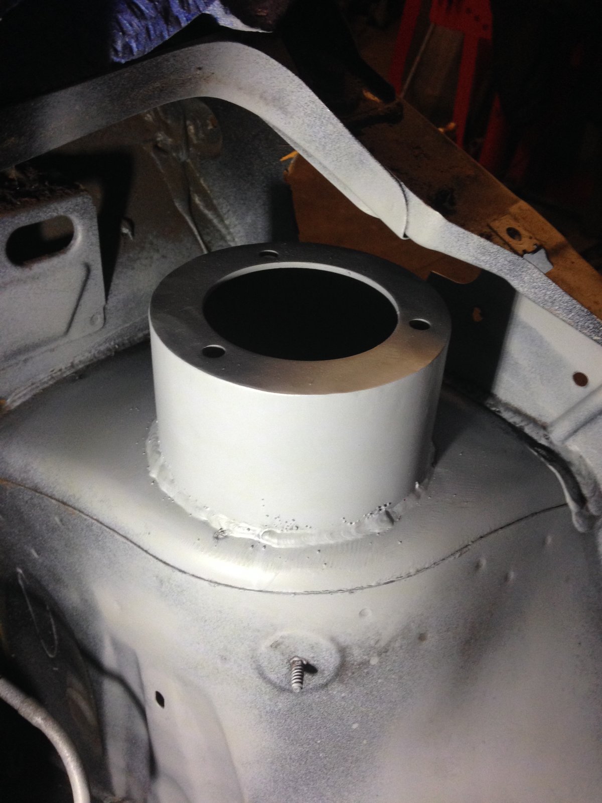

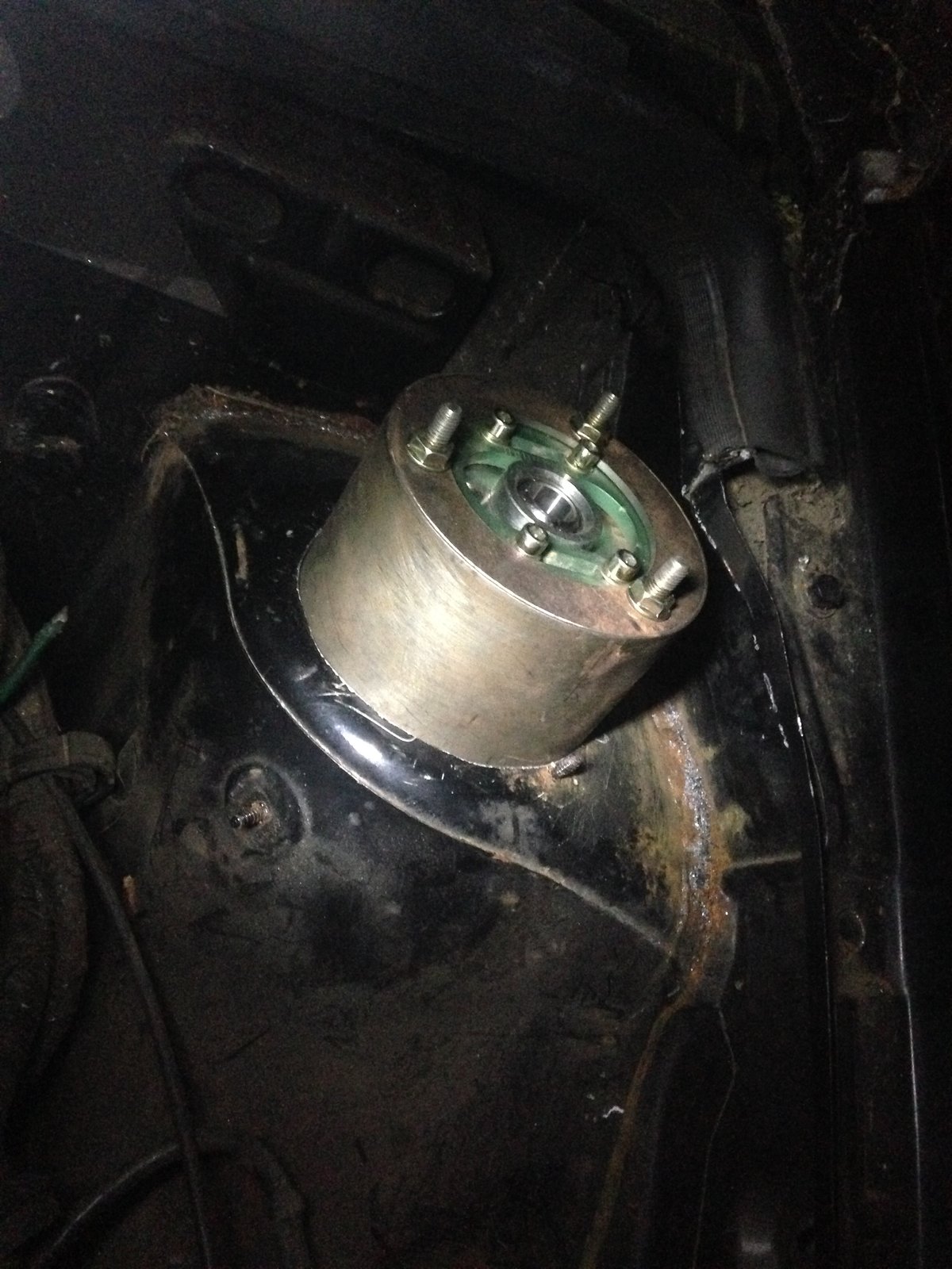

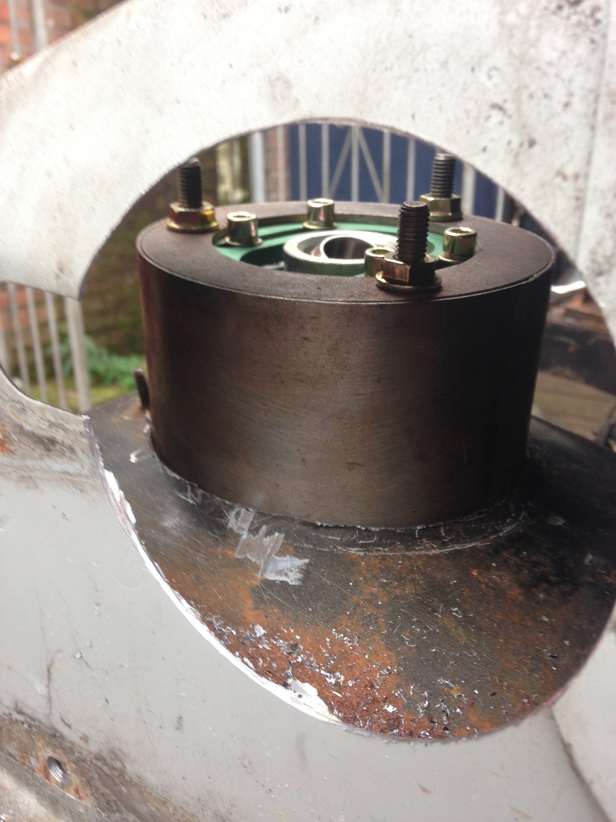

Luckily for me G has already made some top mounts for his own Clio project , so I ended up swapping my new spherical bearing top mounts for his items.

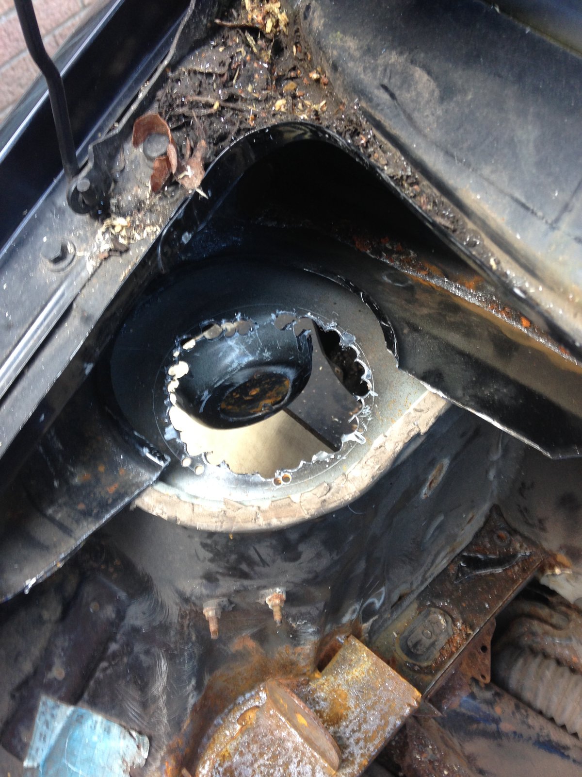

This was a pain because I had to lie down with the drill and punch holes through as I didn't have enough clearance for my drill up top. This is where I realized how weak my muscles were and that I need more training lol !
Lucky for the second top mount I used the air saw which made things a piece of P**s
Just testing how they would fit , They are looking sweet !

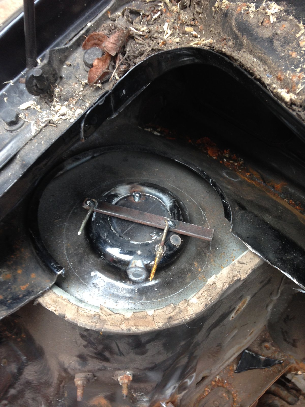

Greg needed some clearance for his welder so I punched these holes either side so he can get the welder round the back as well as the front.

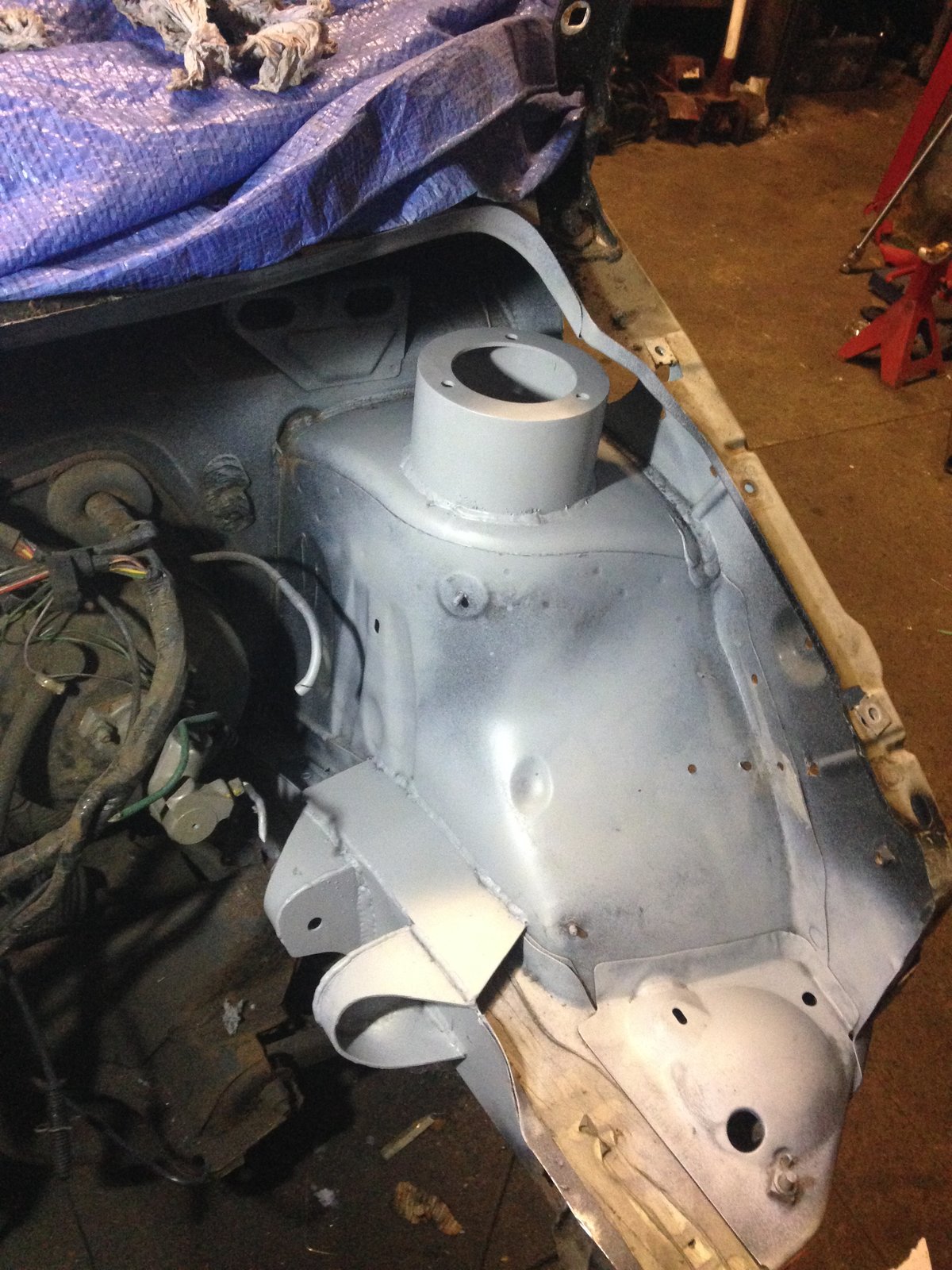

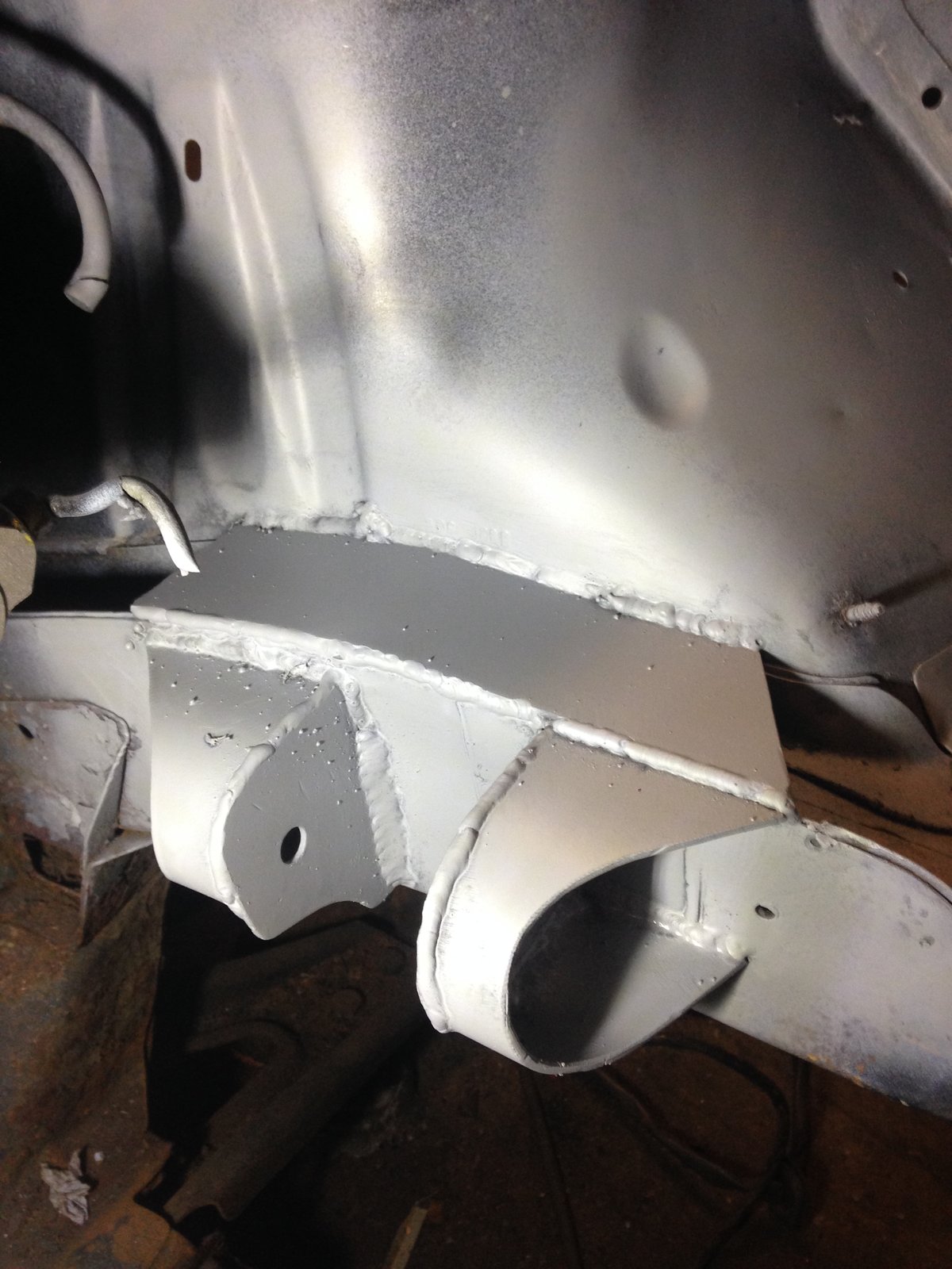

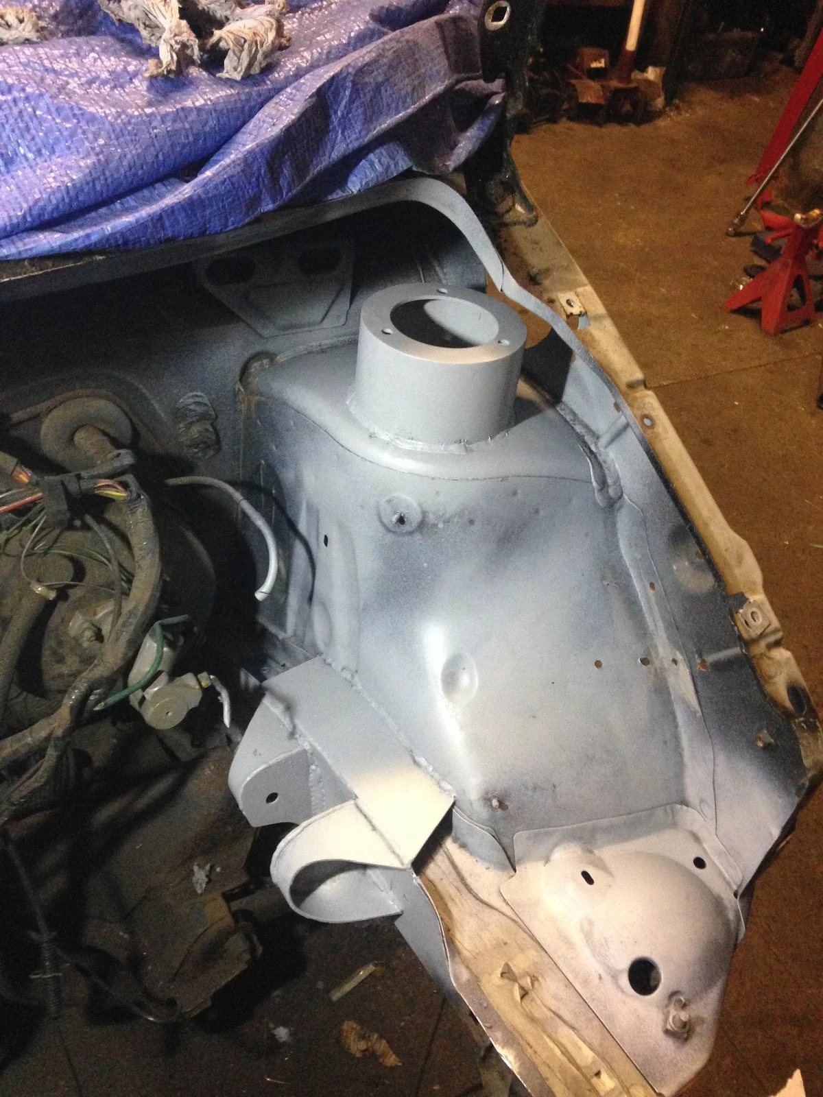

Welds are now complete on the top mounts thanks to G's epic welding
I have cleaned the bracket as it was rusty as S**t
Prepping for some more welding

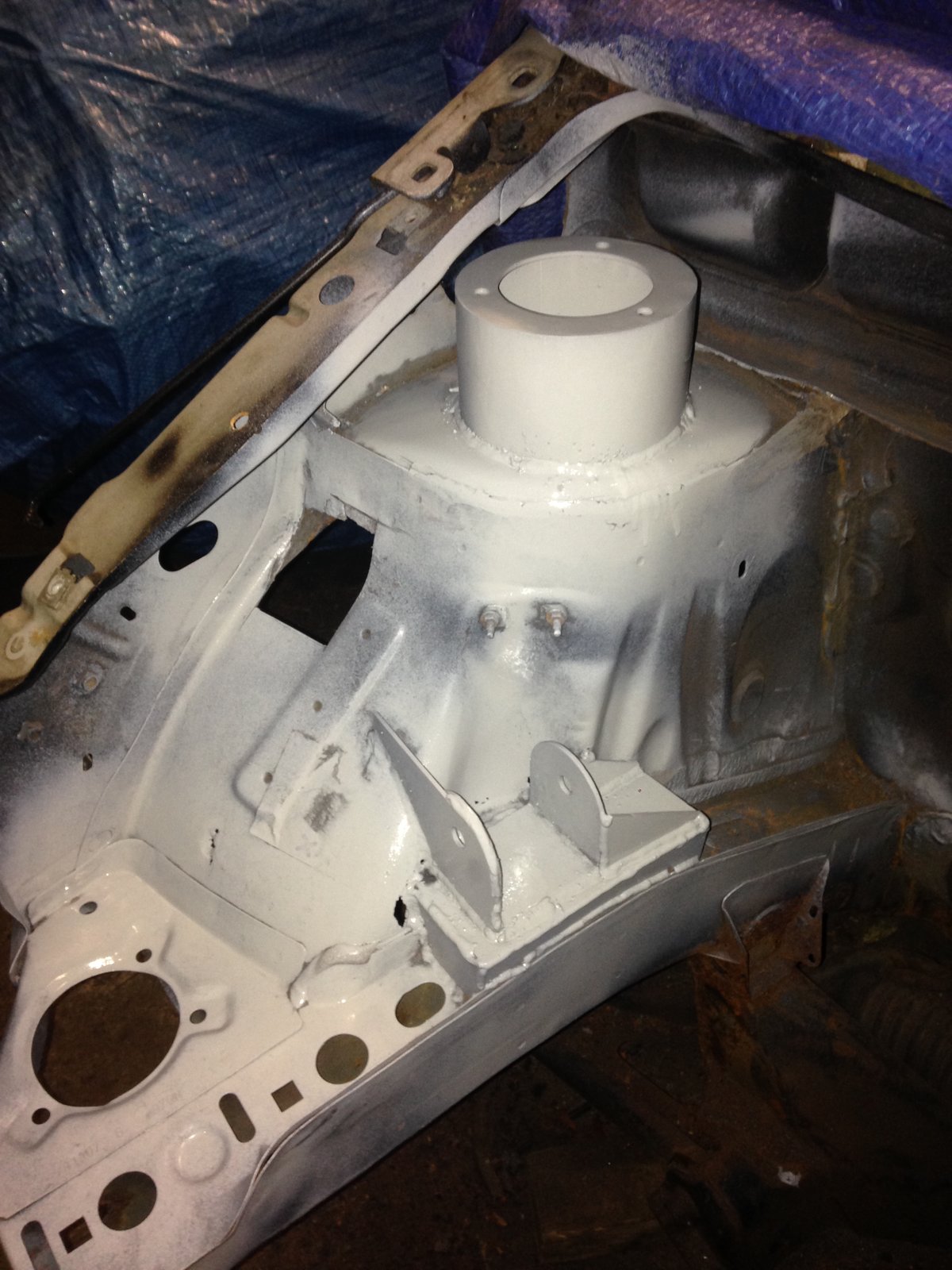

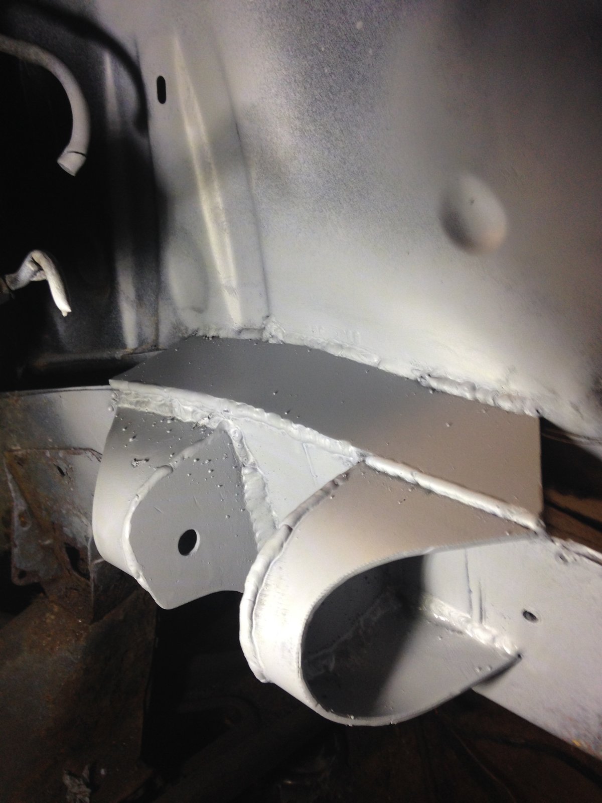

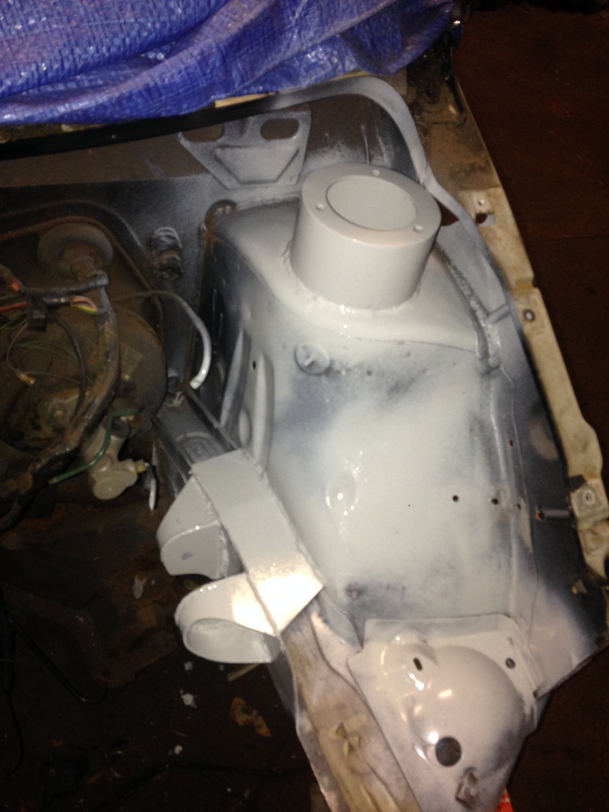

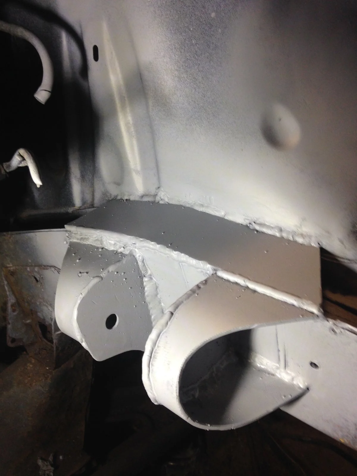

The gearbox mount has some strength to it thanks to the 2 plates that go round and one rectangular plate to give it some extra support. Sprayed everything with acid etch.
More support on the other side as well
Clean all the little spits from the welds and it should look awesome !

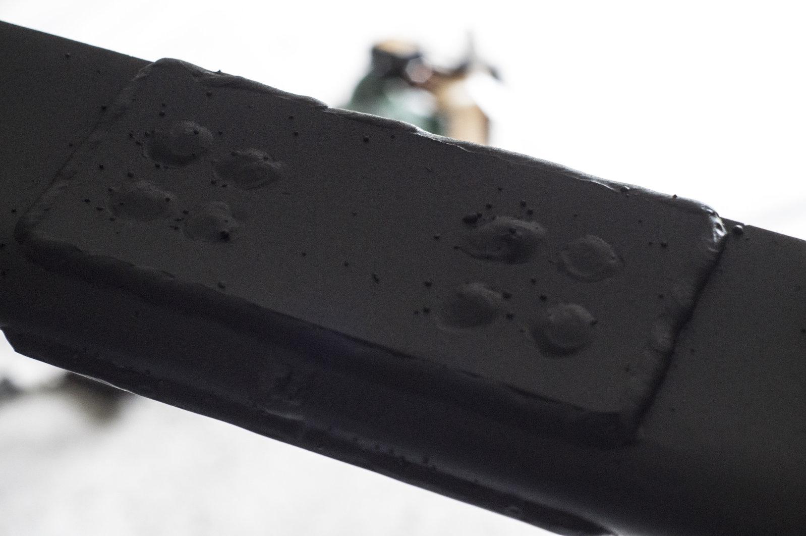

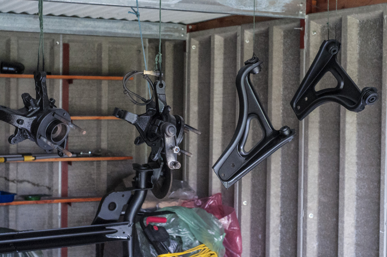

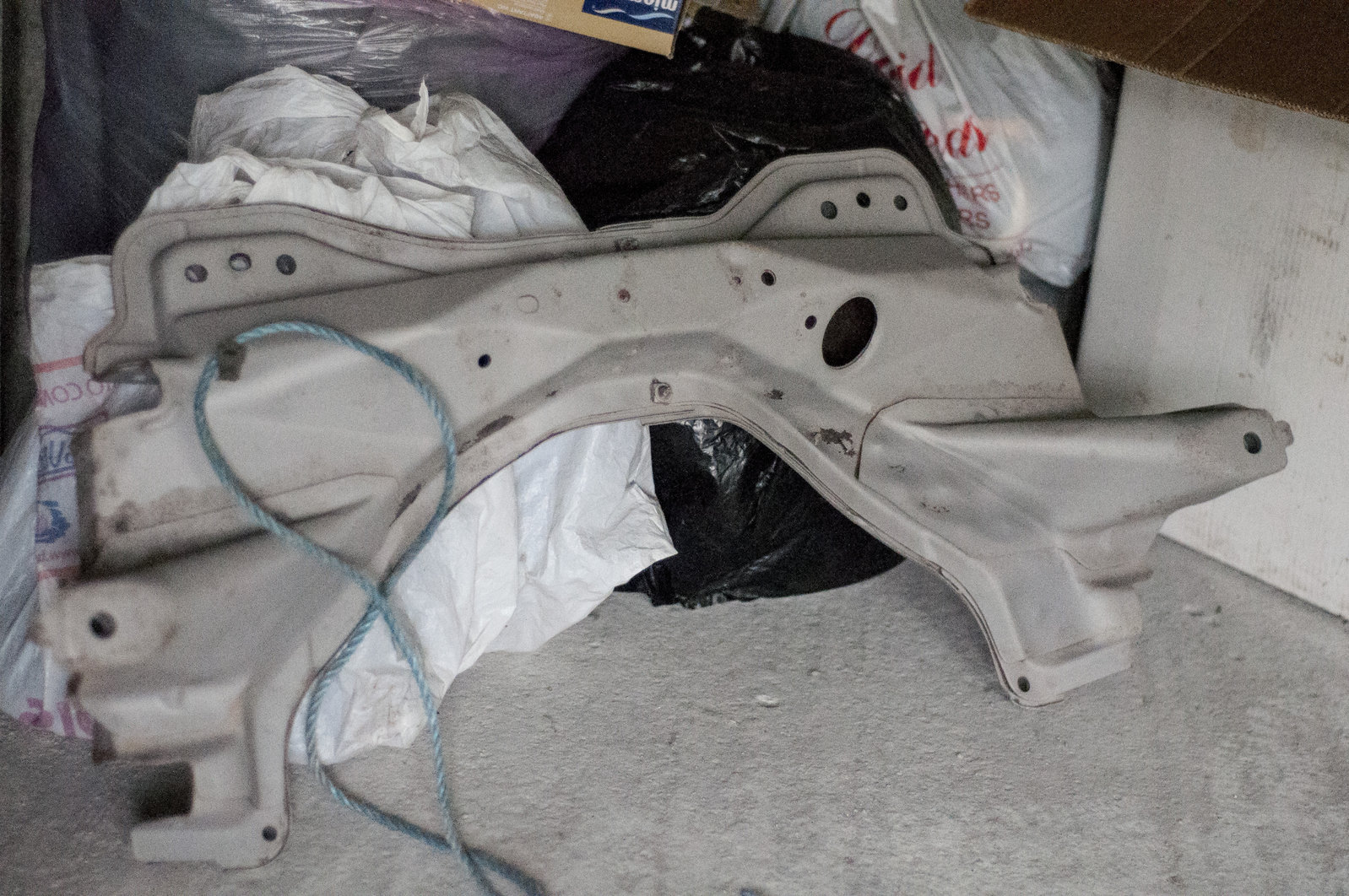

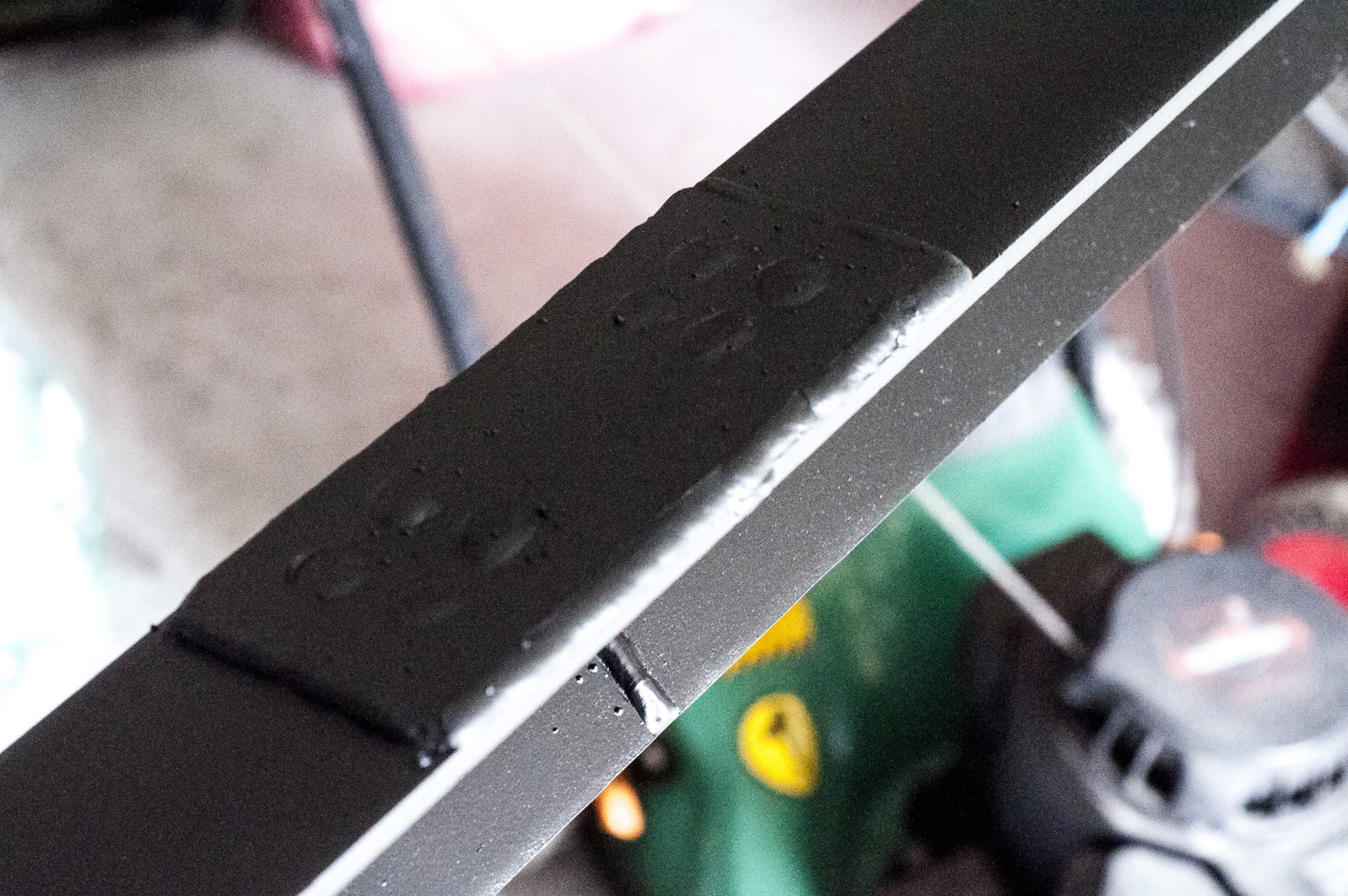

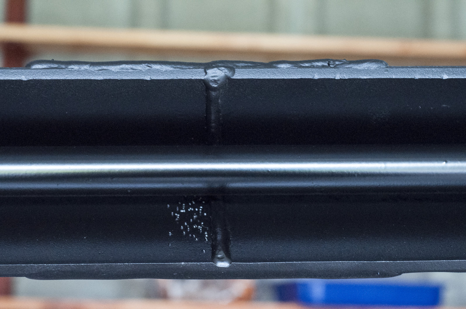

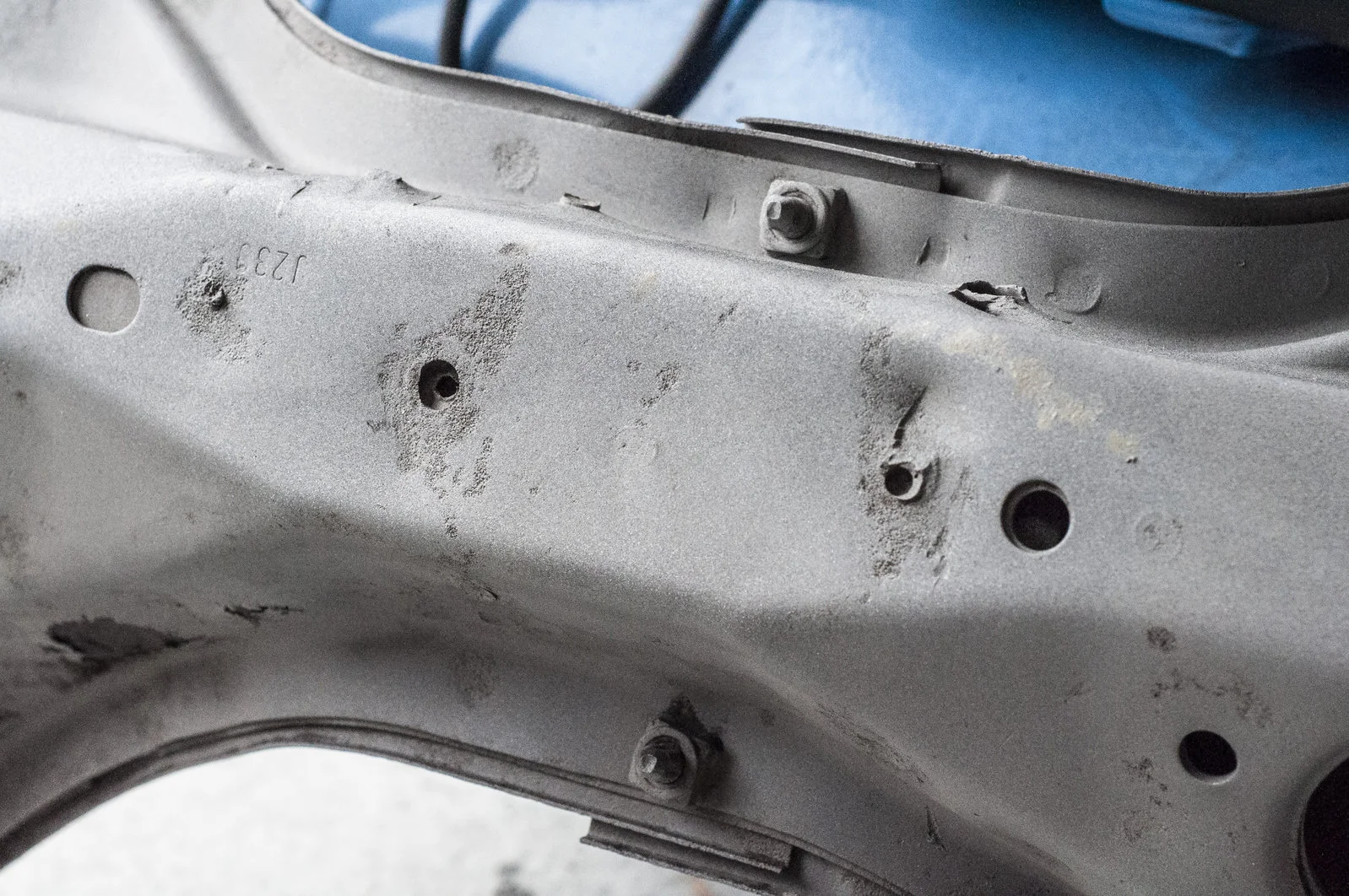

18/02/2016 Rusty Beam no more: I had a guy sandblast the subframe , wishbones , hubs and rear beam as they were getting rather rusty. This is the modified rear beam with the welded supports after a few coats of chassis black. Sprayed them in my garage so excuse the old lawnmower.
Another close up of the weld on the underside. Thumbs up for Gs welding skills again.

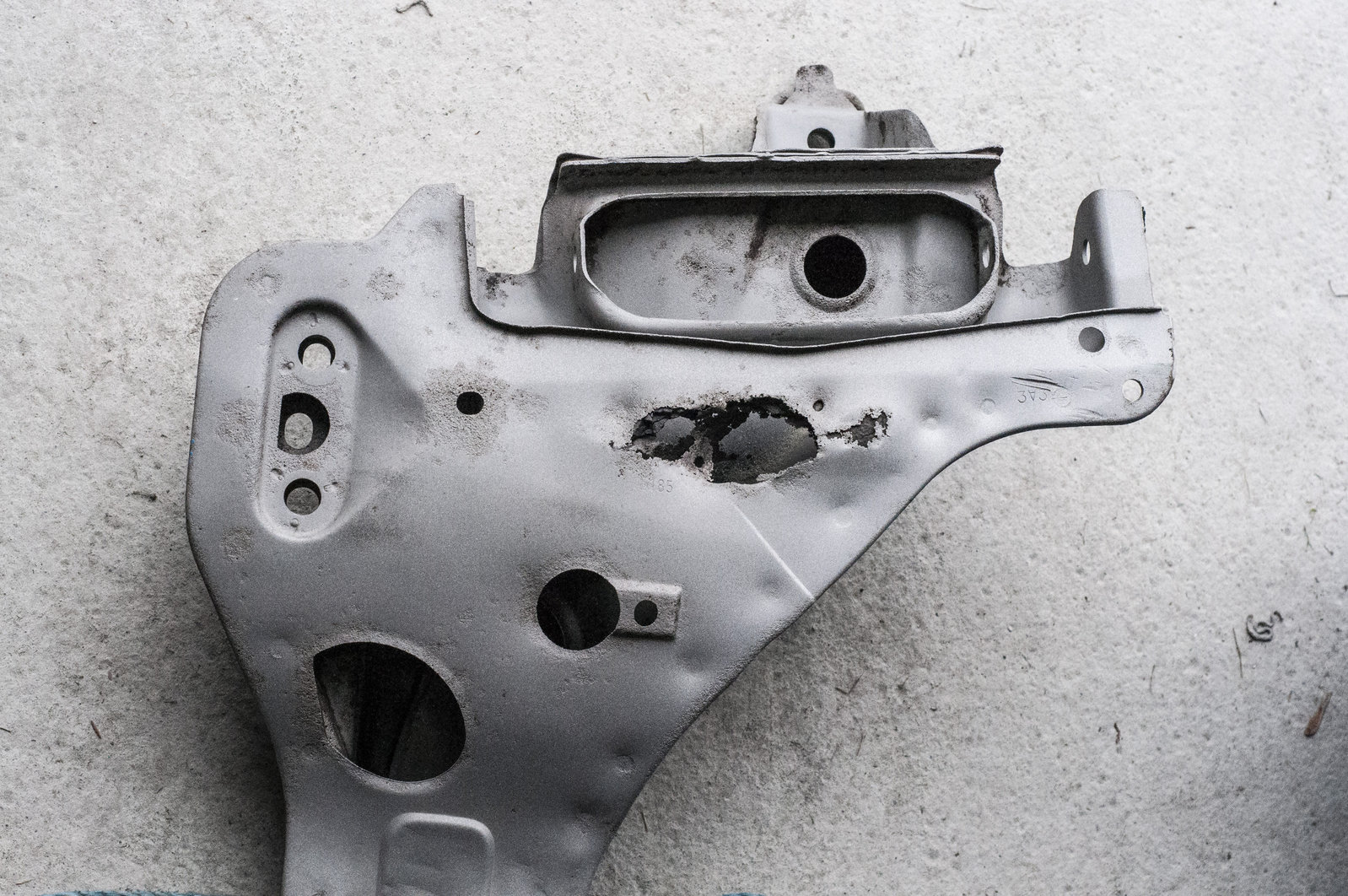

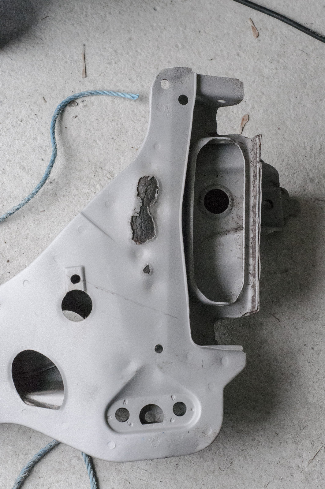

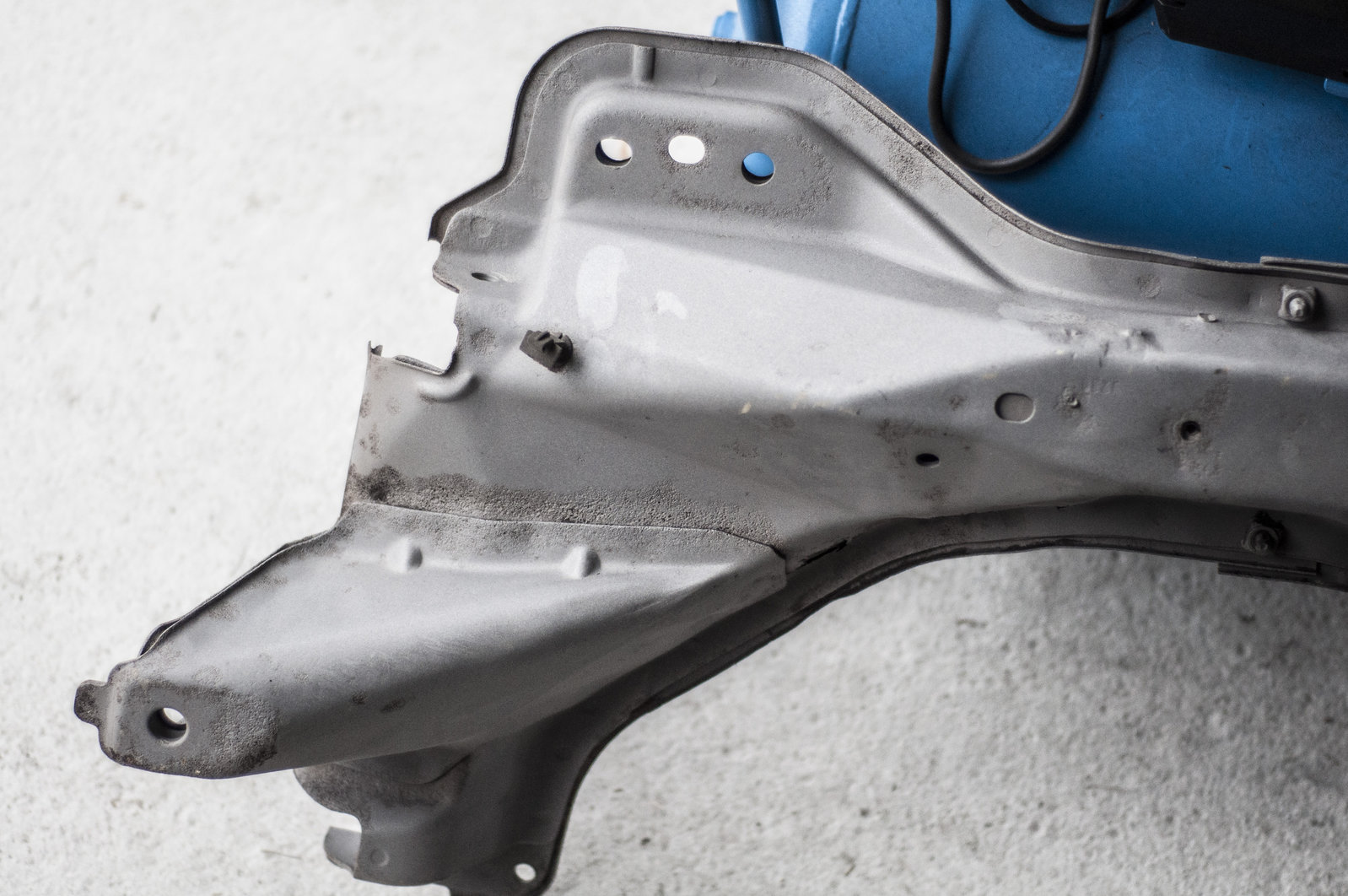

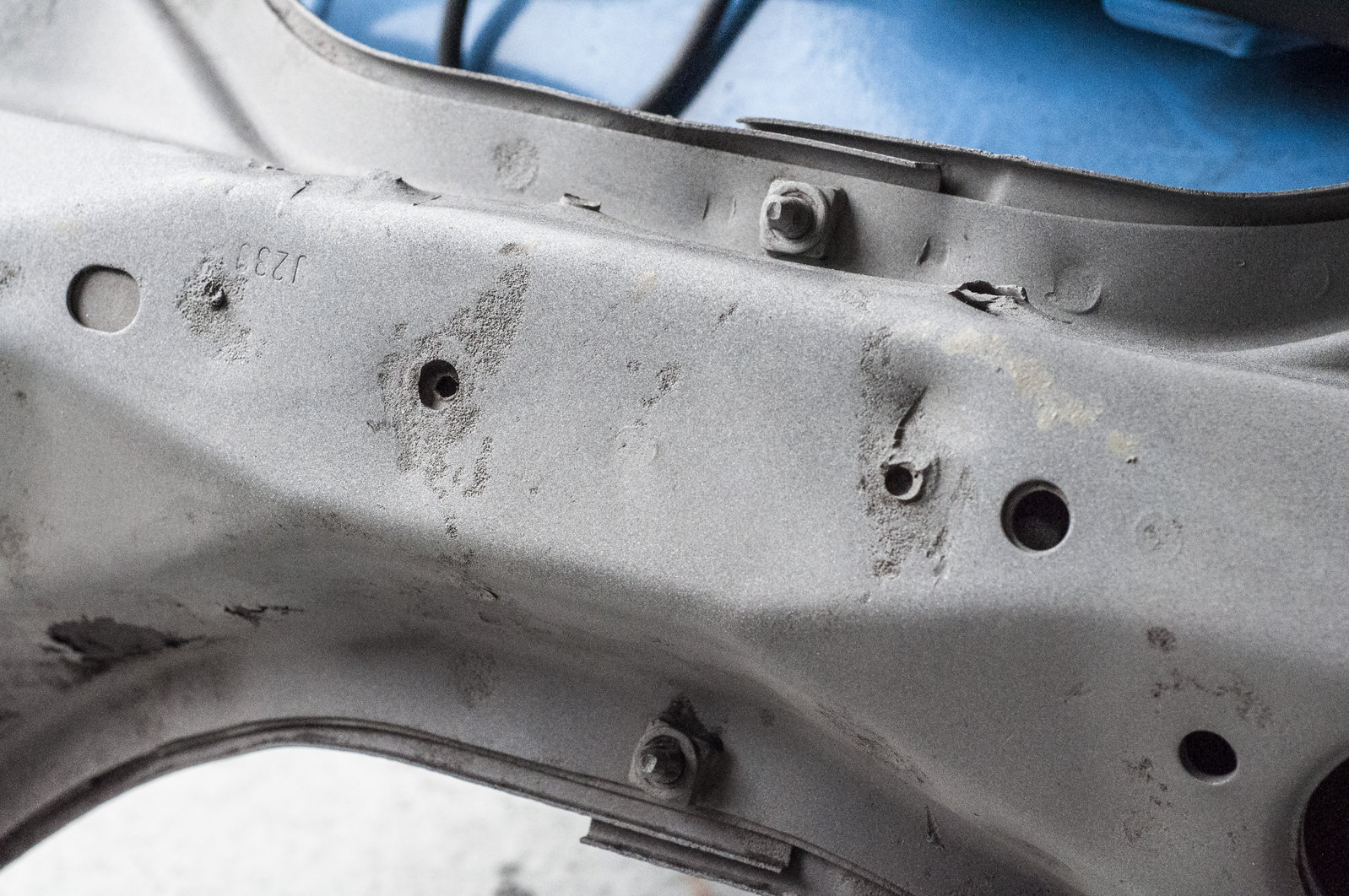

Remember the old rusty Subframe? This is whats left of it.... plenty of work thats for sure :(
The subframe is made of a couple of layers of mild steel so its gonna be tricky to repair.
Its come out lovely after sandblasting tho !

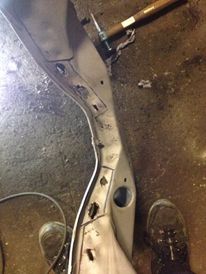

Last one for the night. just came home from the garage, the beam has seen better days, so its gonna have to undergo some surgery....tbc
