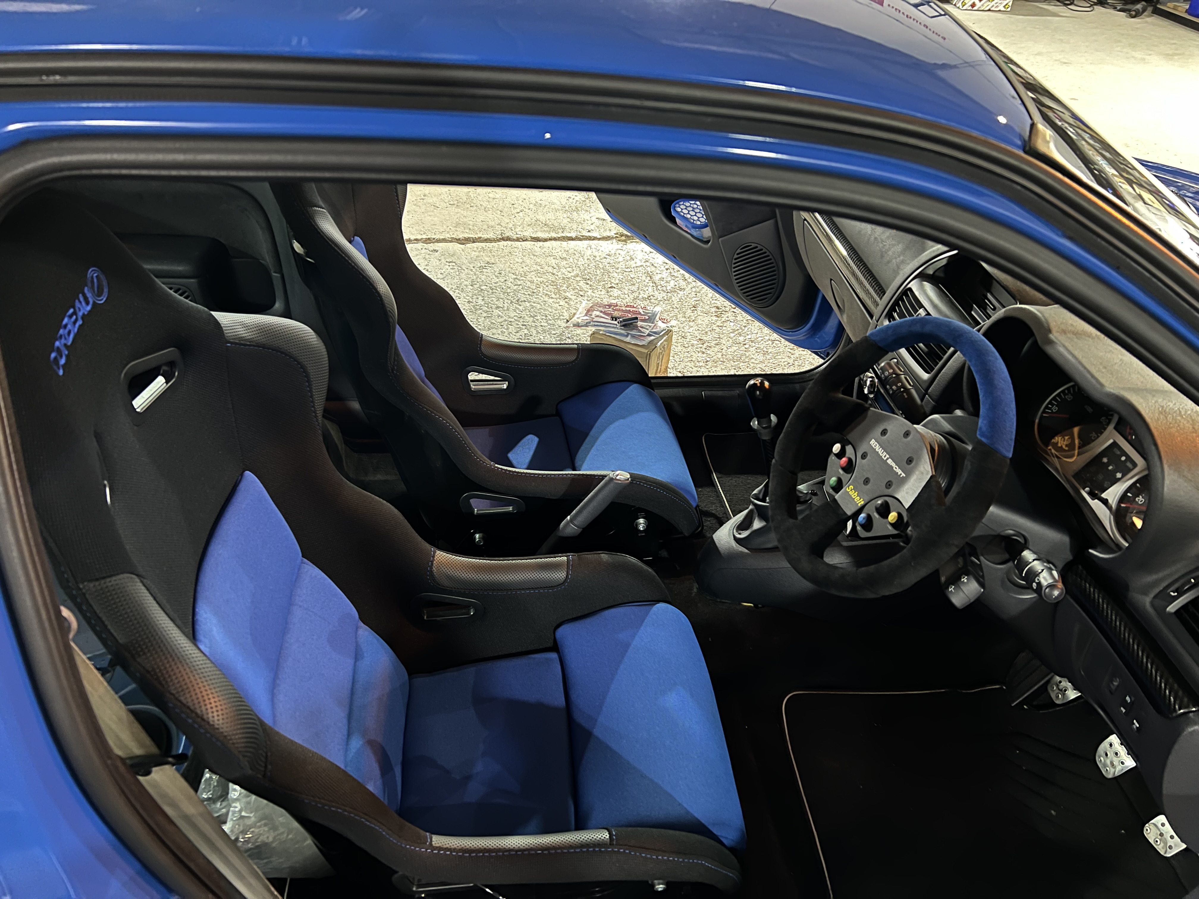

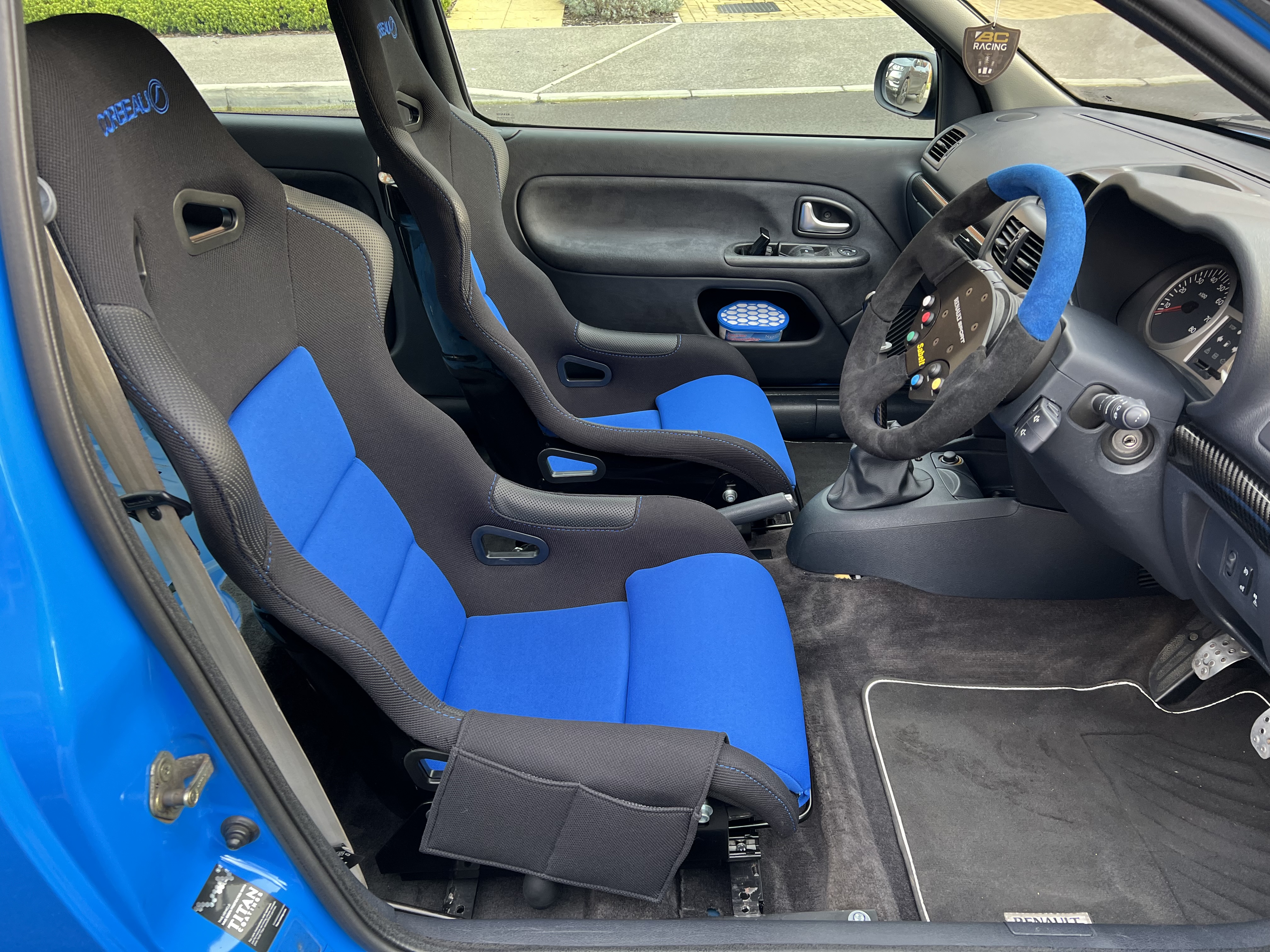

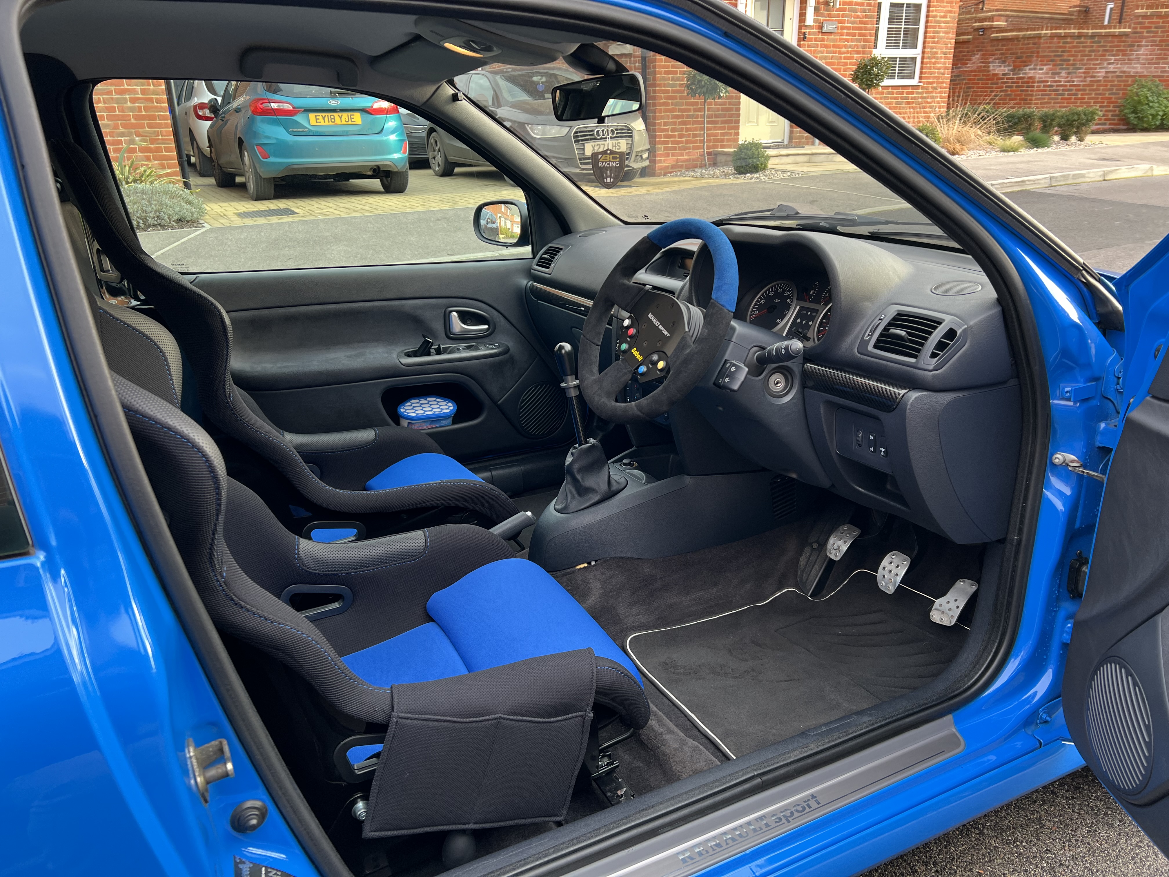

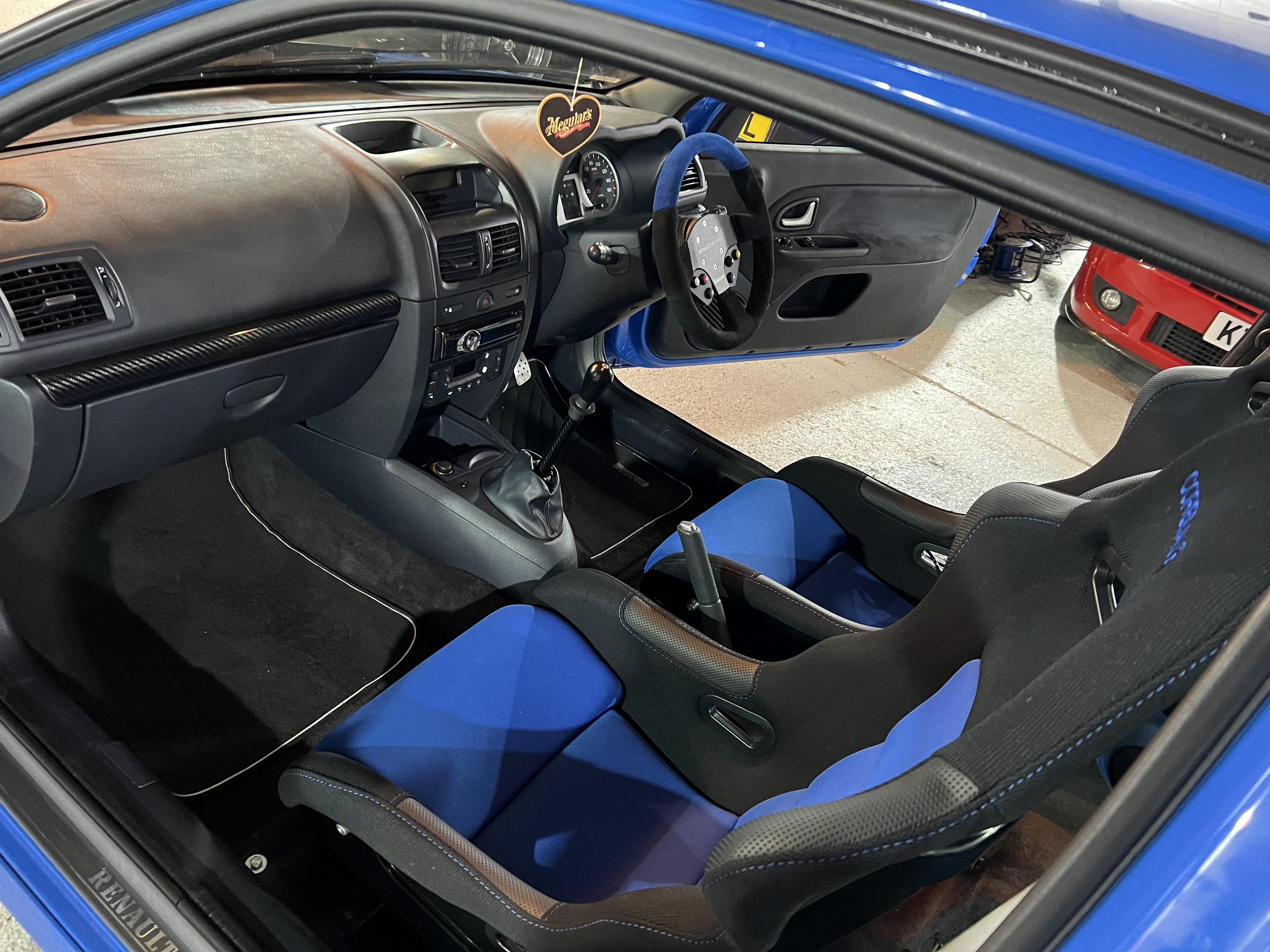

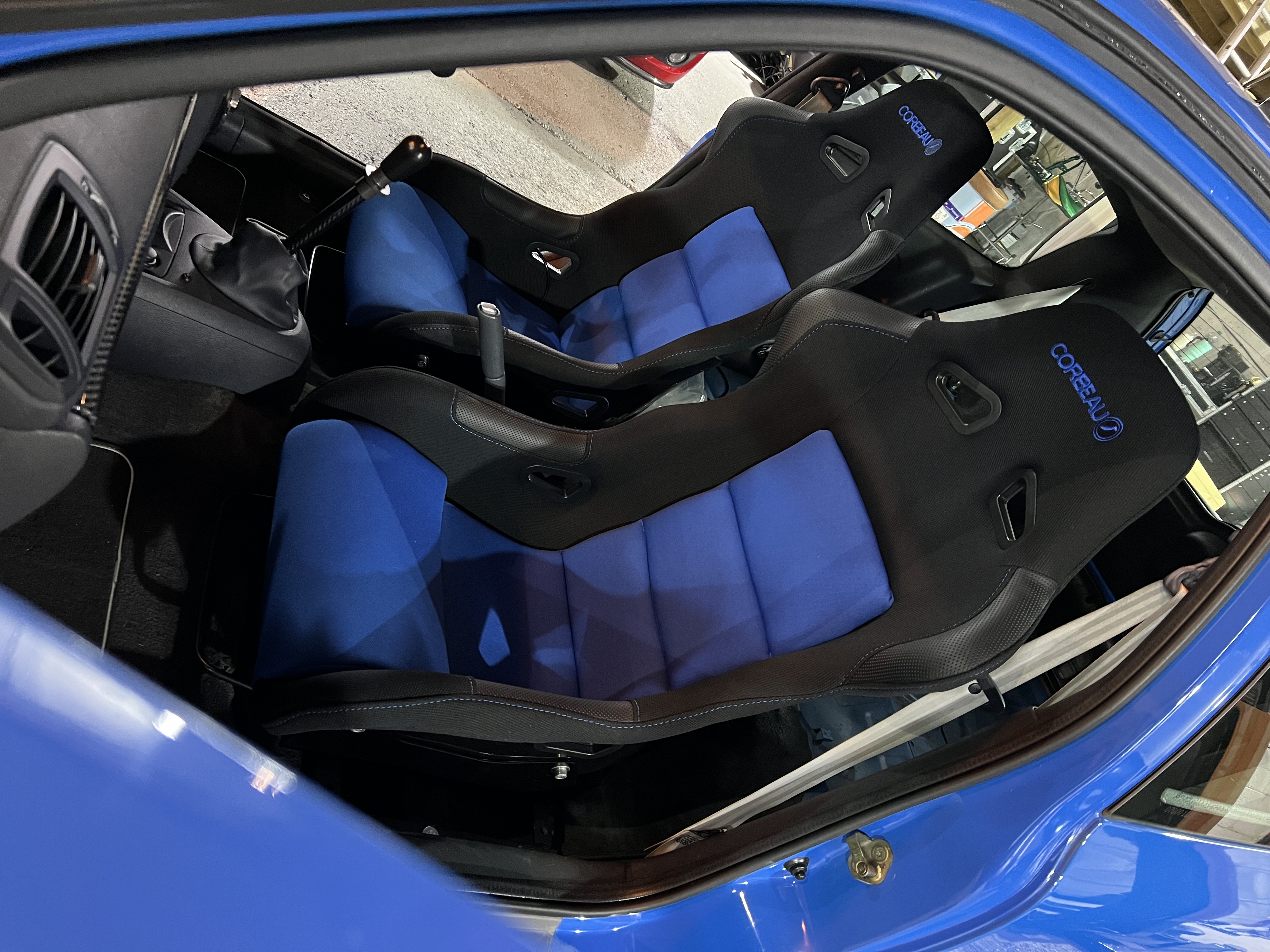

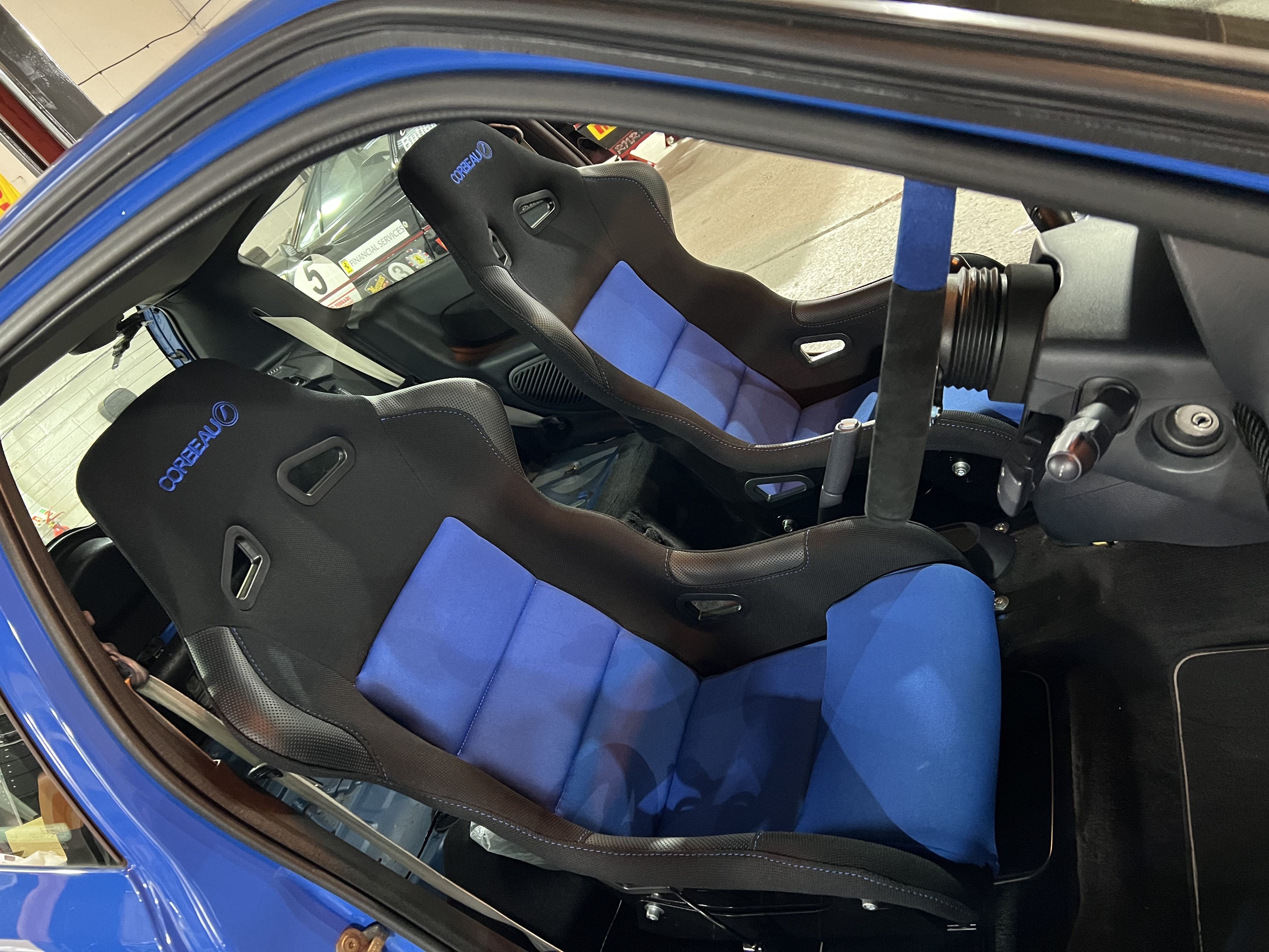

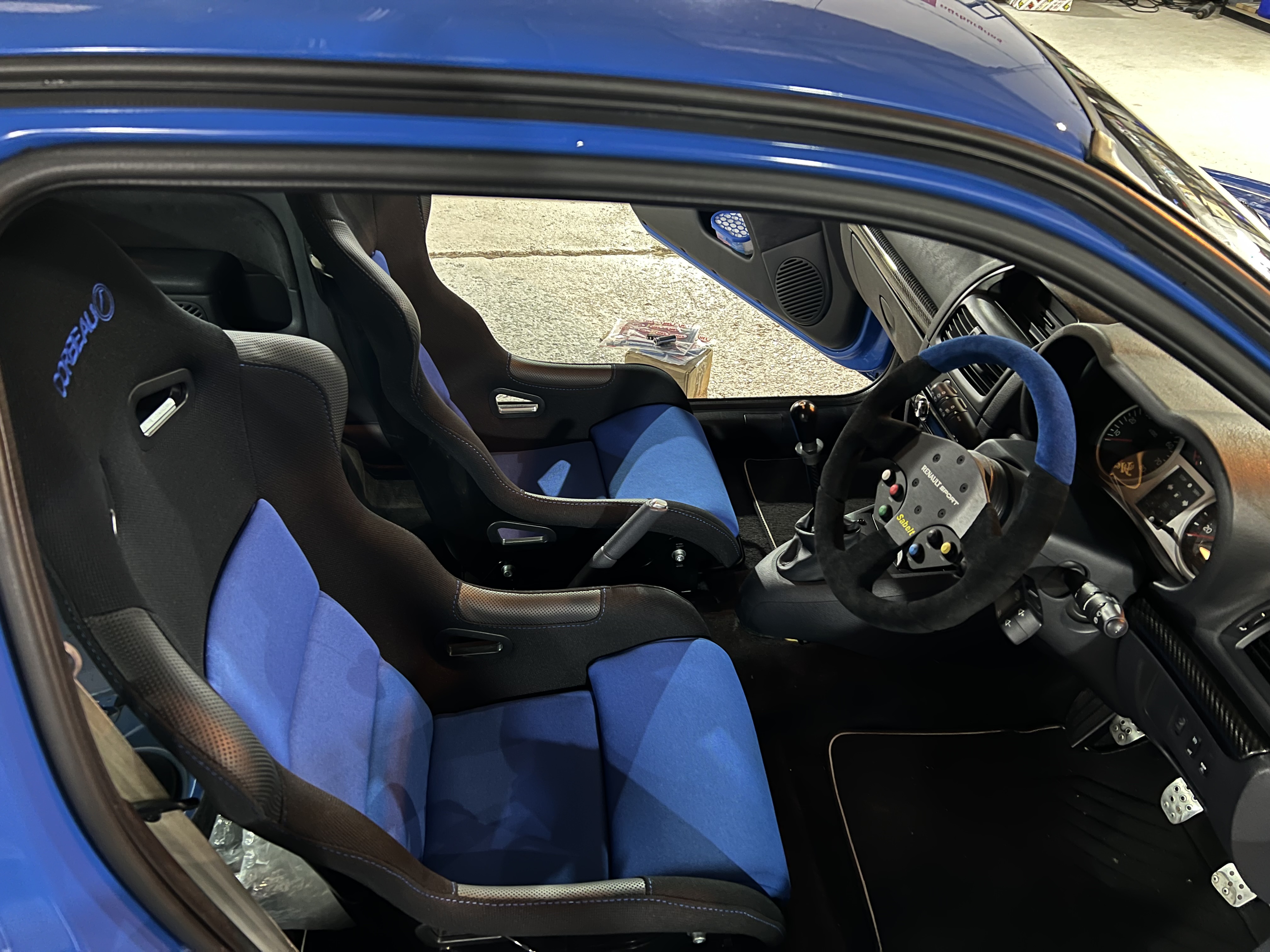

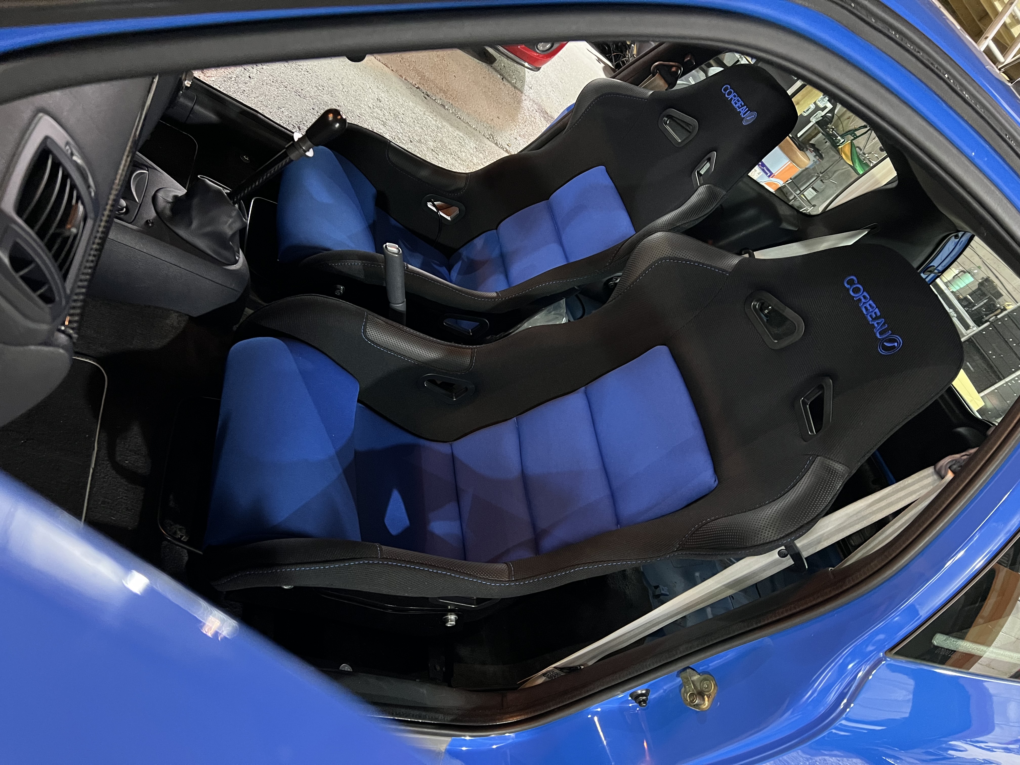

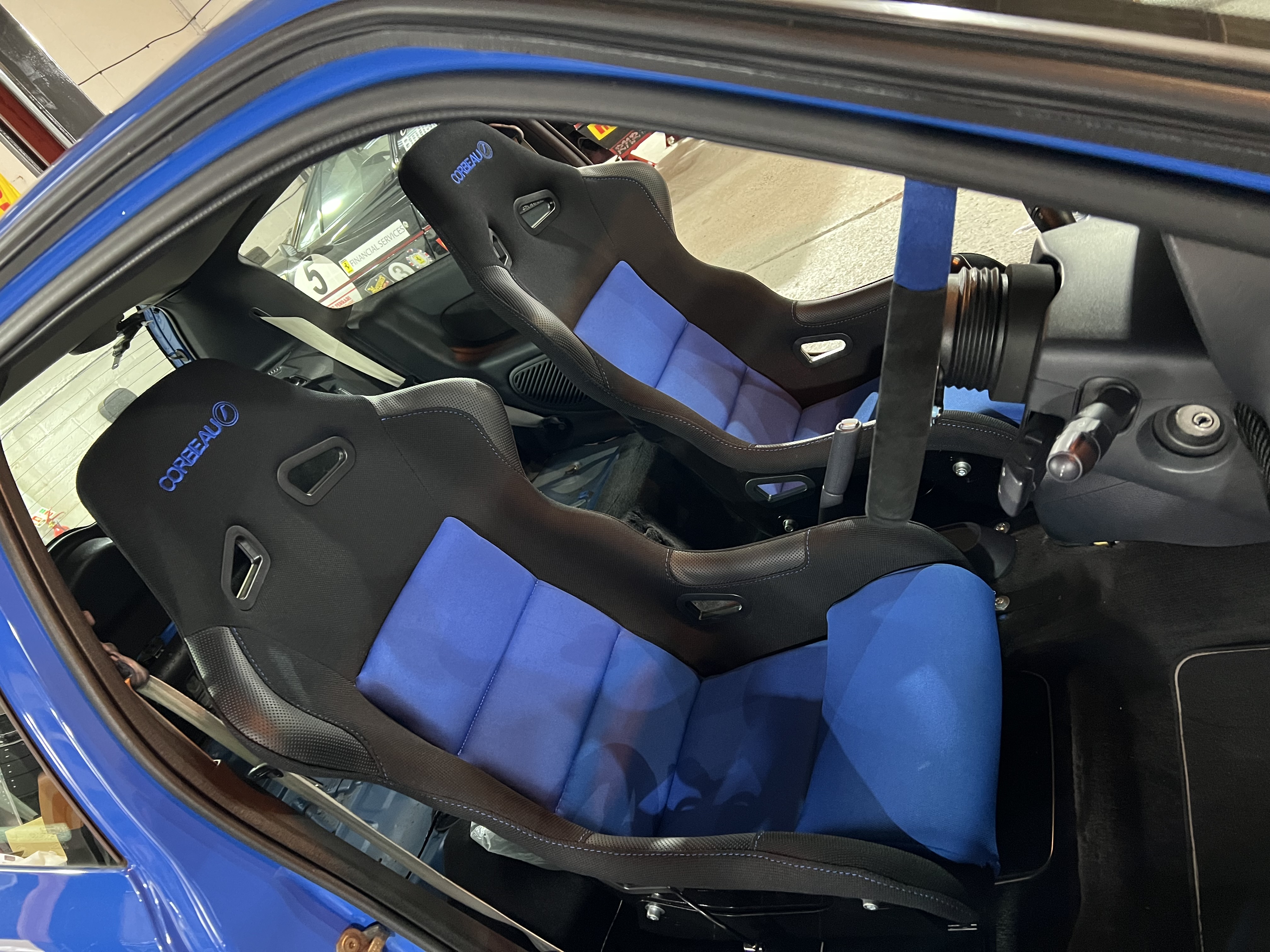

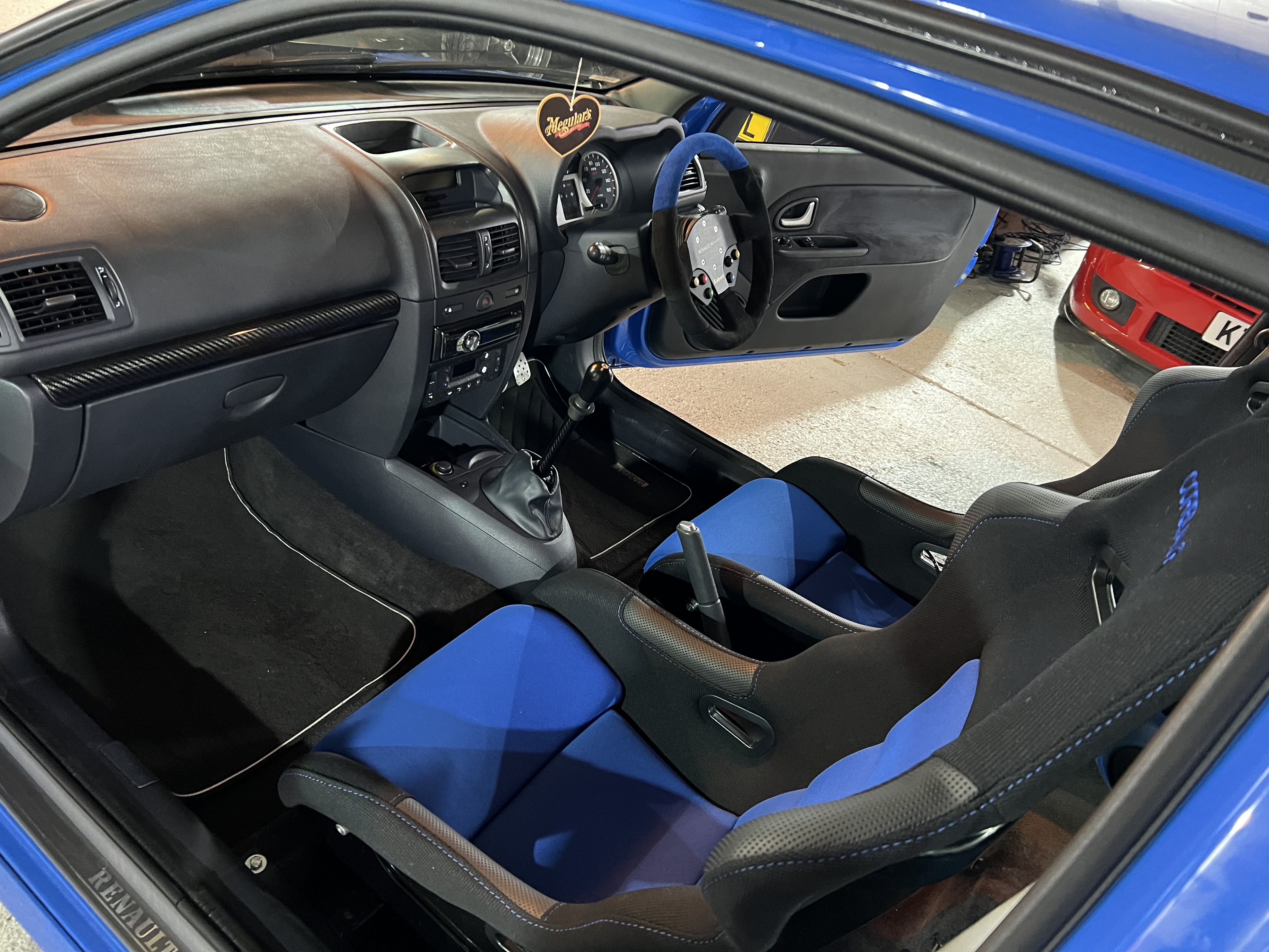

Seats in. Pretty much identical colour to the wheel
Over the moon with them. I think they look awesome personally !

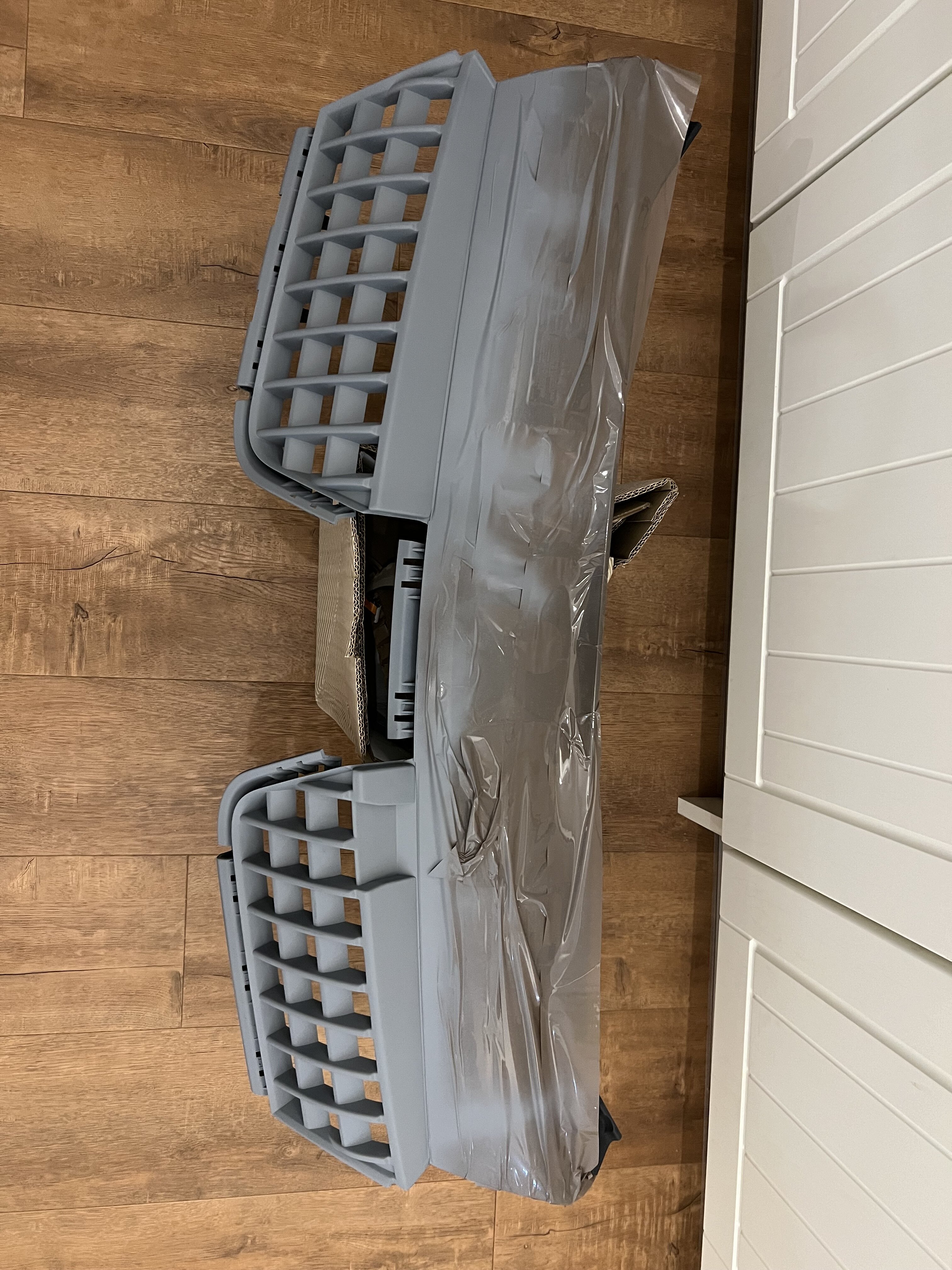

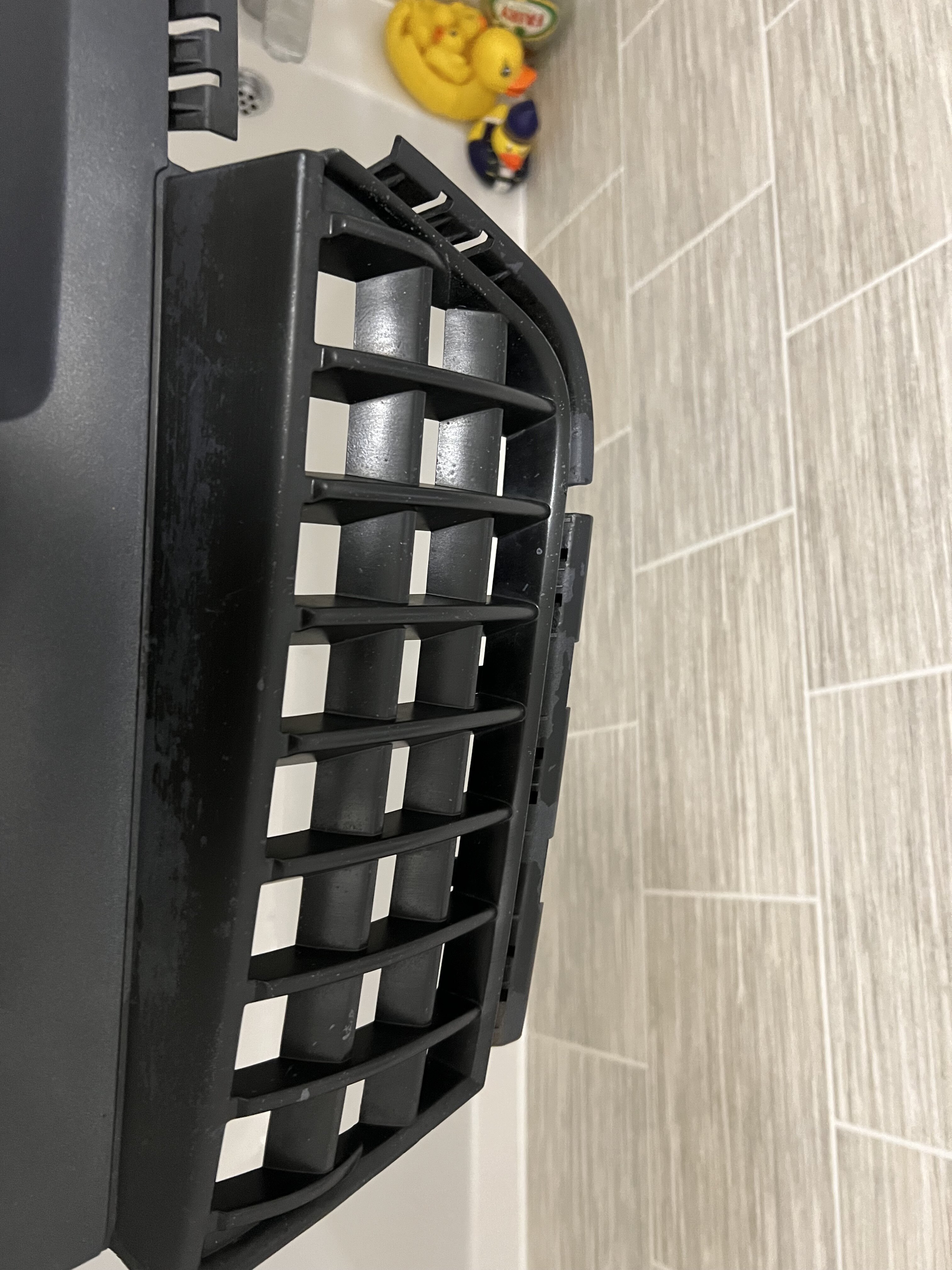

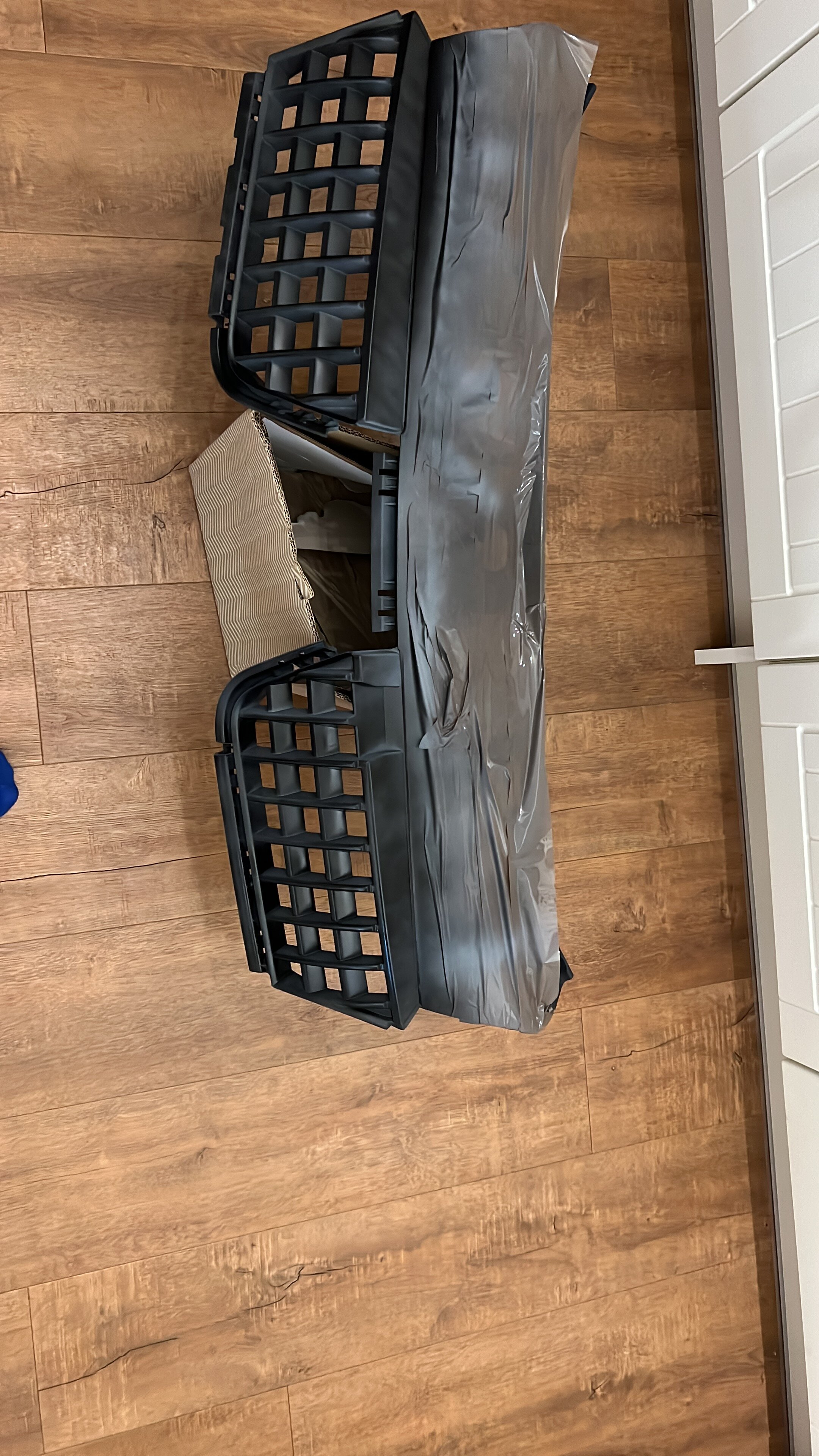

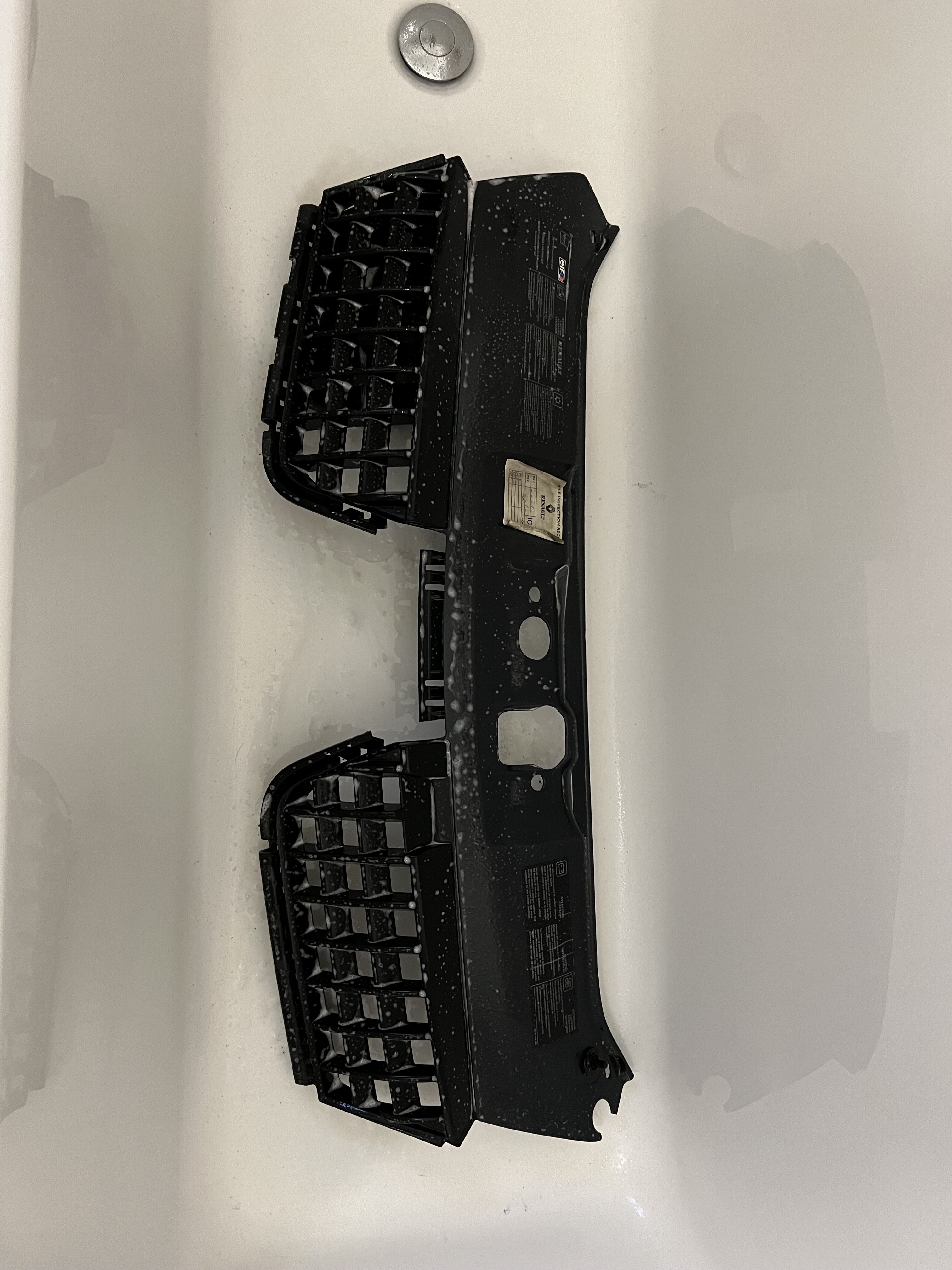

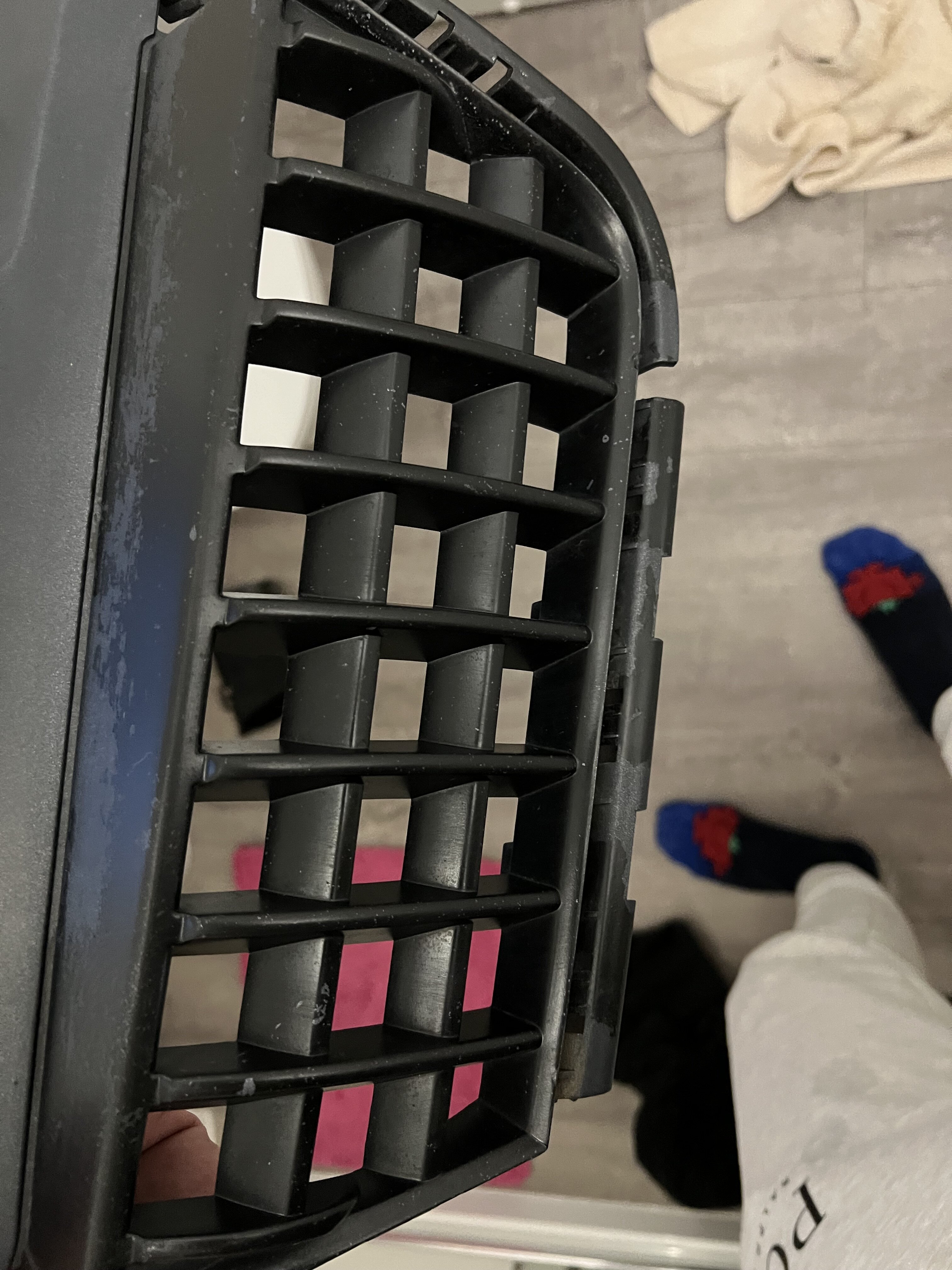

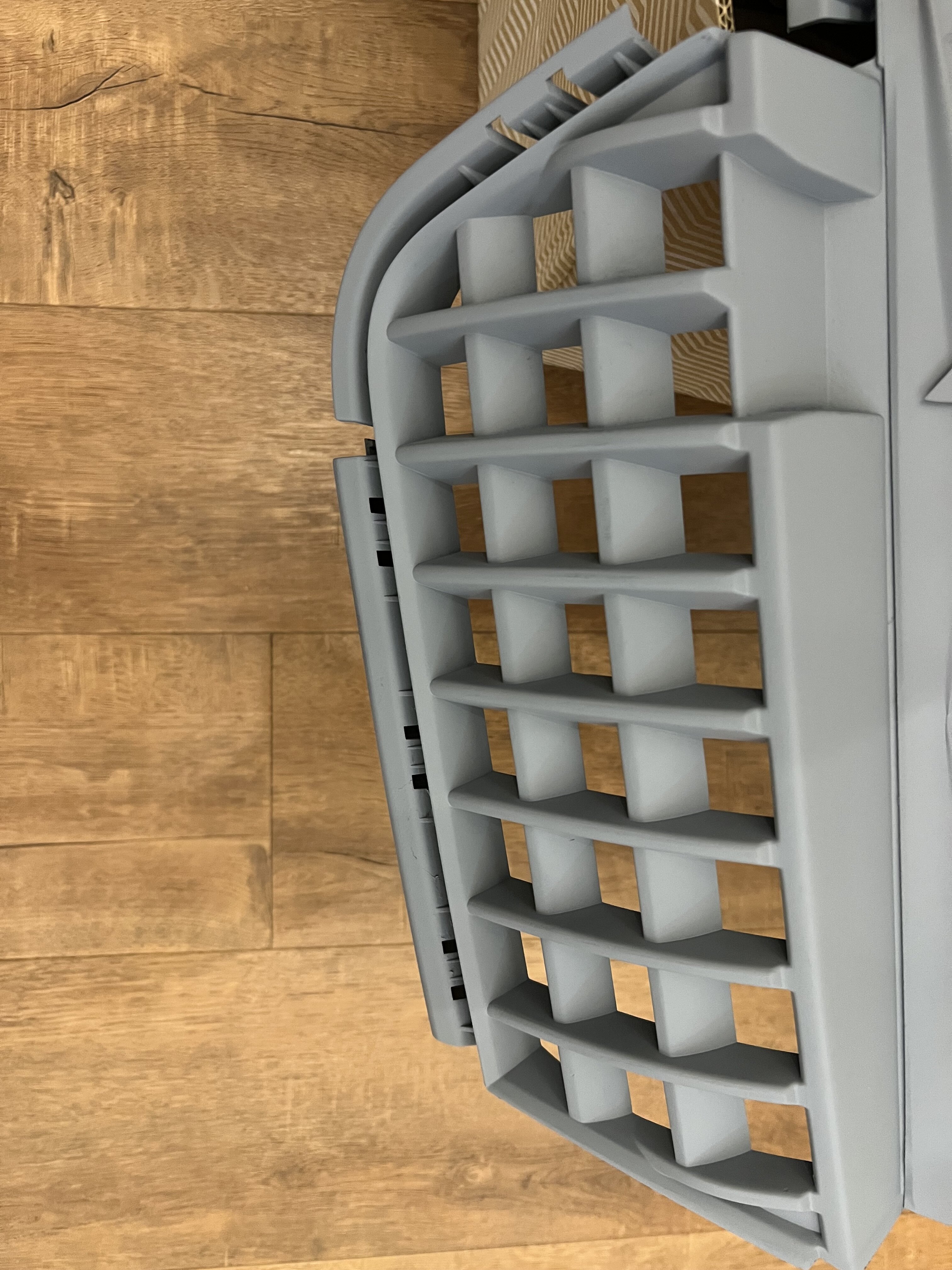

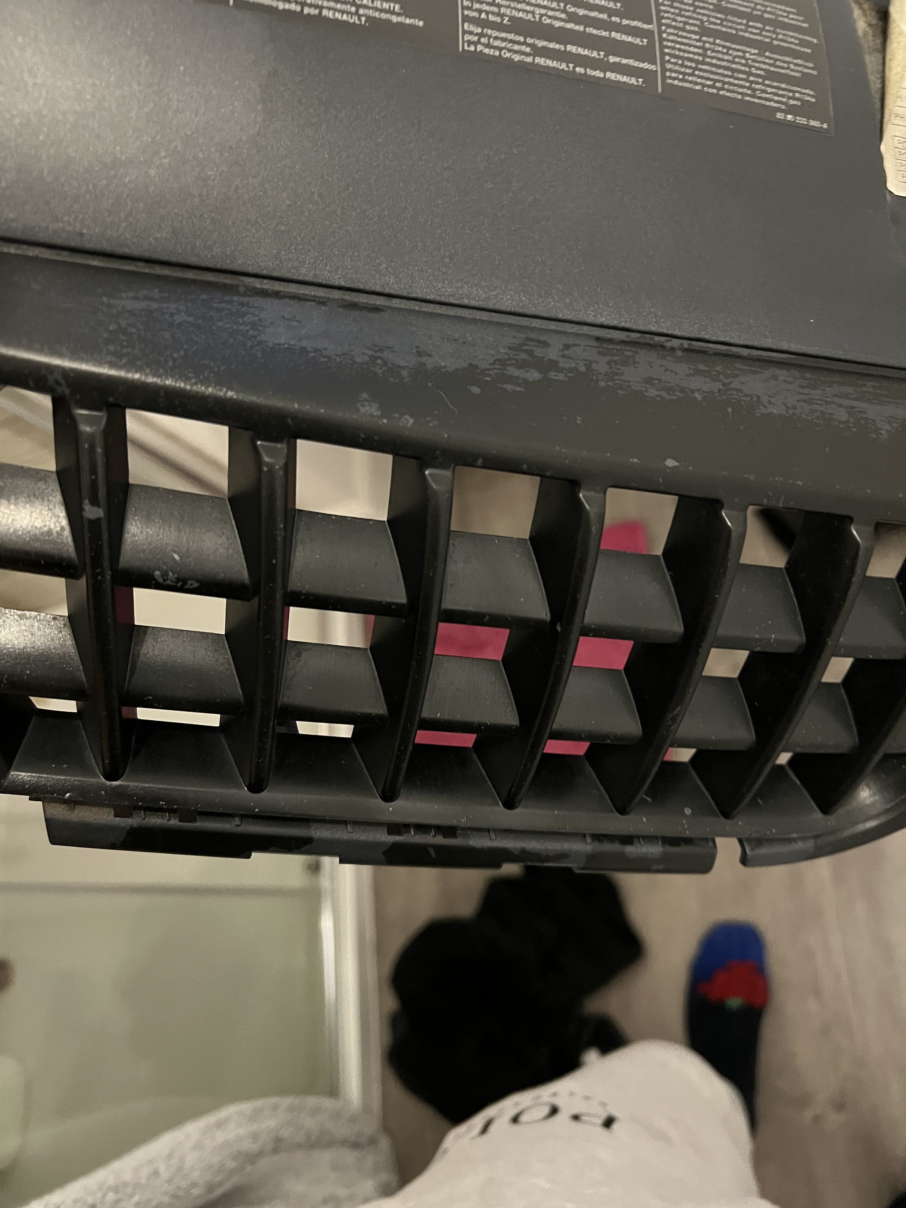

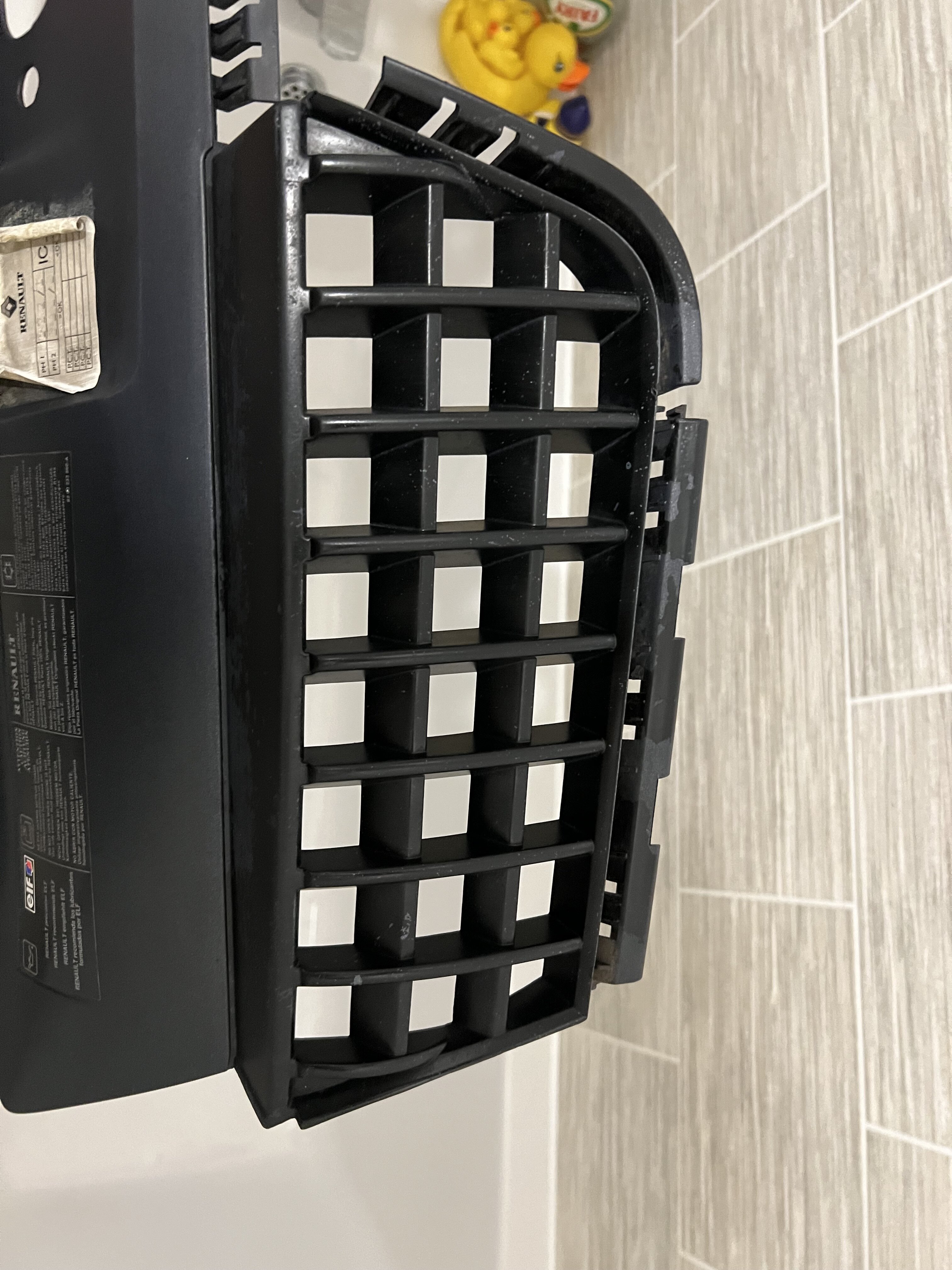

Starting to refurb the front grille and fog surrounds.
They’ve been done before by the looks but it doesn’t appear it was prepped. Eitherway, time for a refresh.
Few before pics. I shall be doing these and and when I get a minute over the coming days.
Will be going satin.

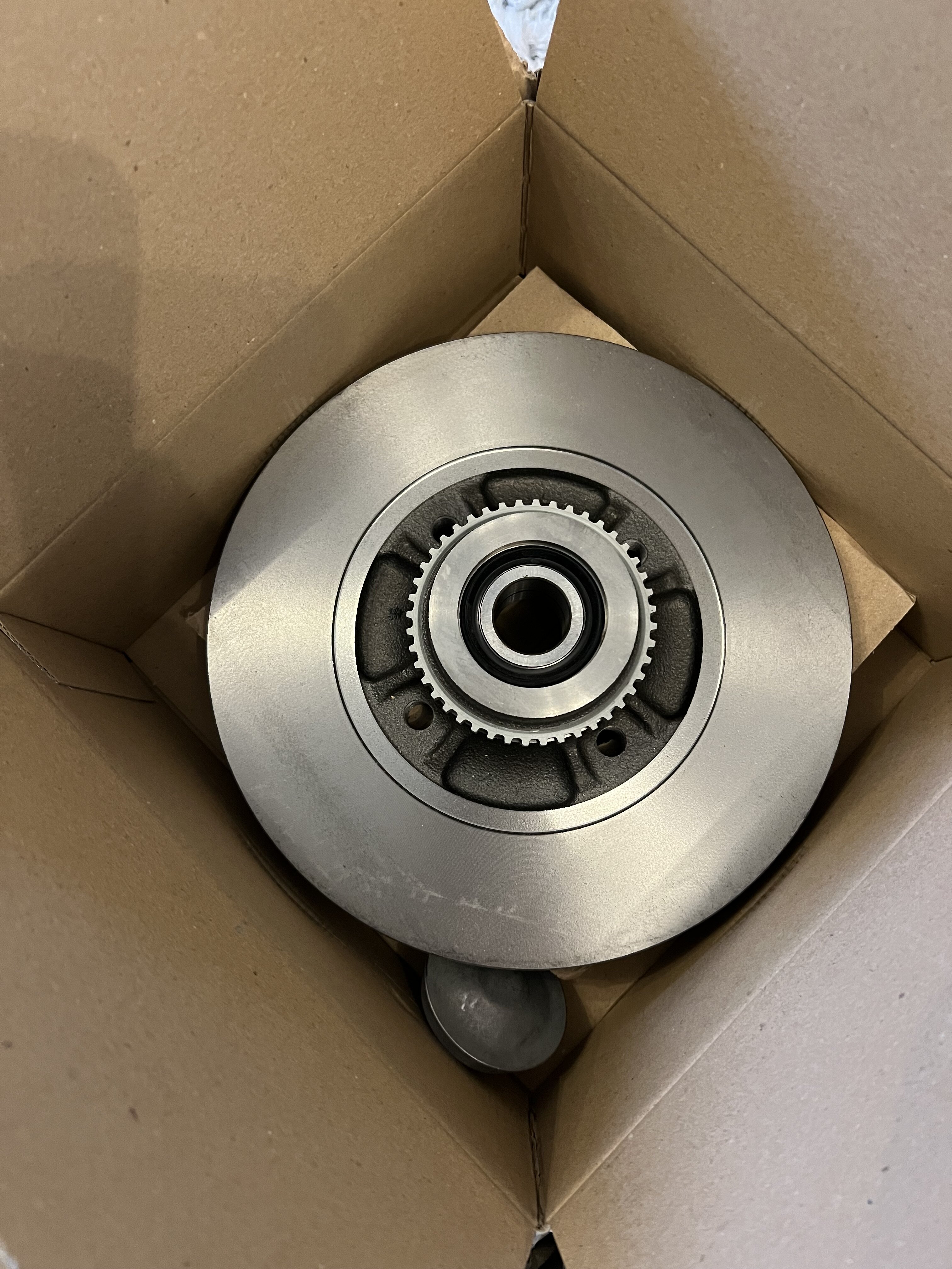

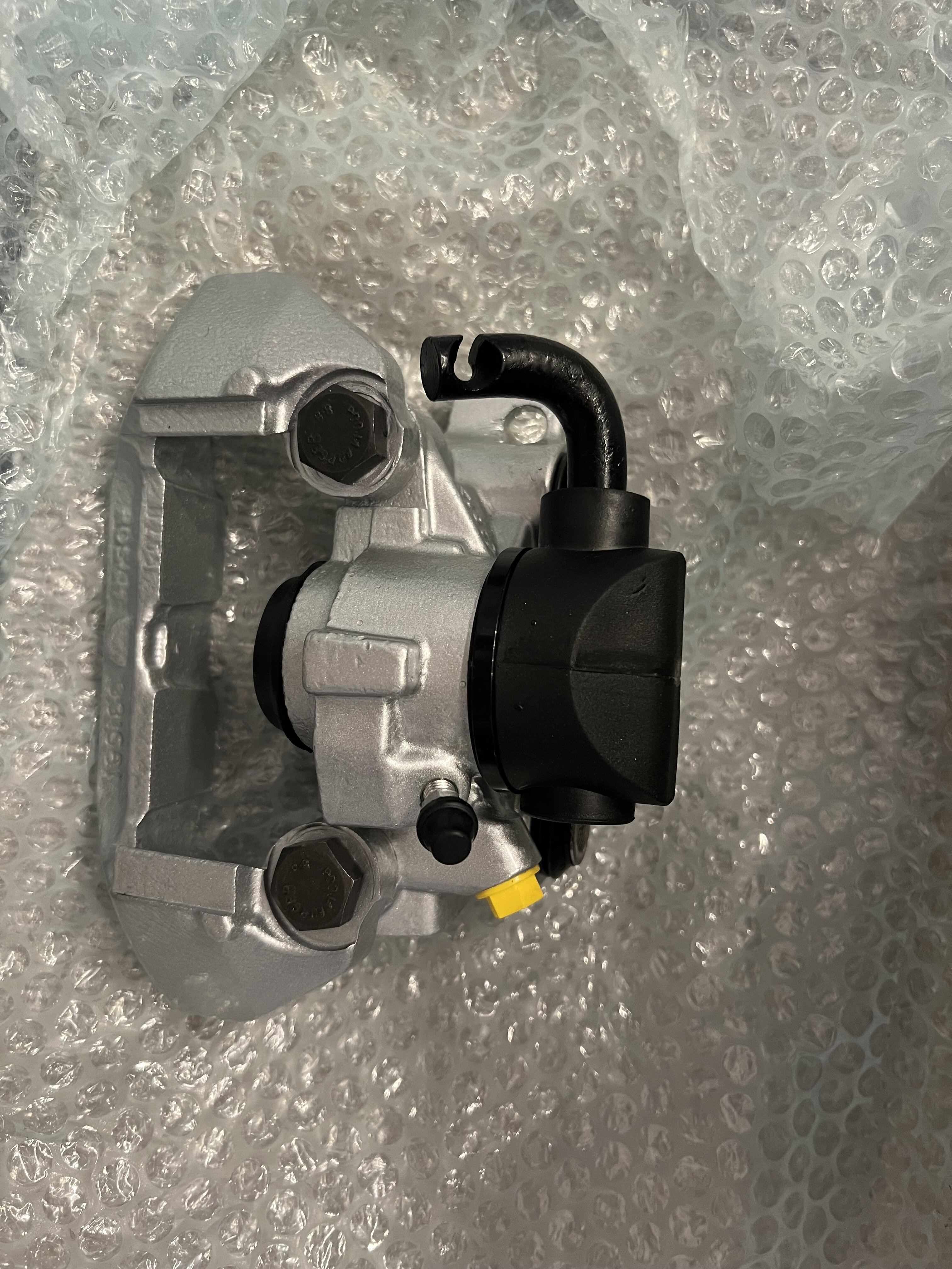

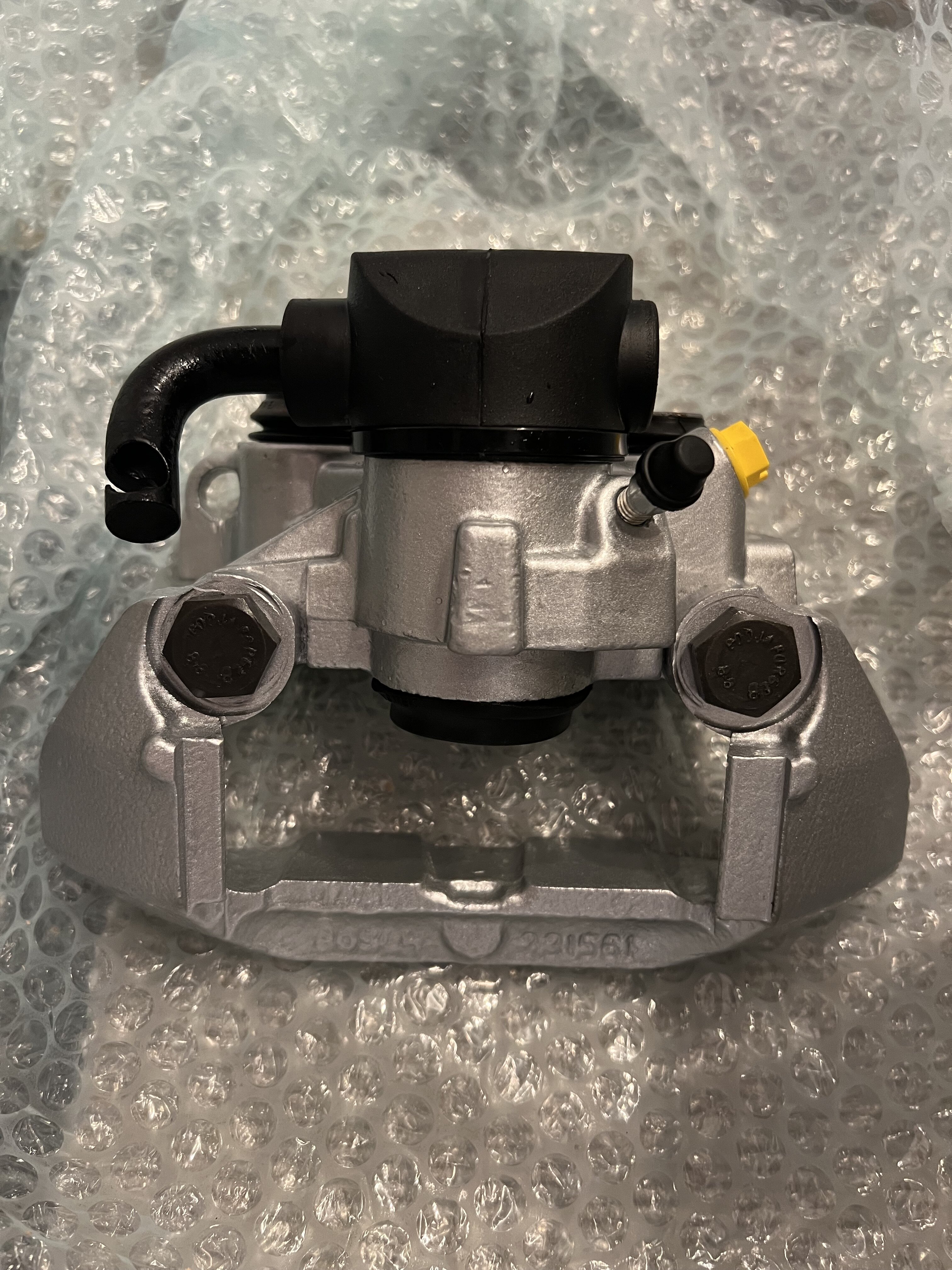

Car sailed through it's MOT but I am aware that the rear brakes aren't playing ball at the moment. Seeing as I'm already balls deep in to this project, I've ordered new calipers, SNR OEM discs, another new set of pads and a new spacer to renew the lot.

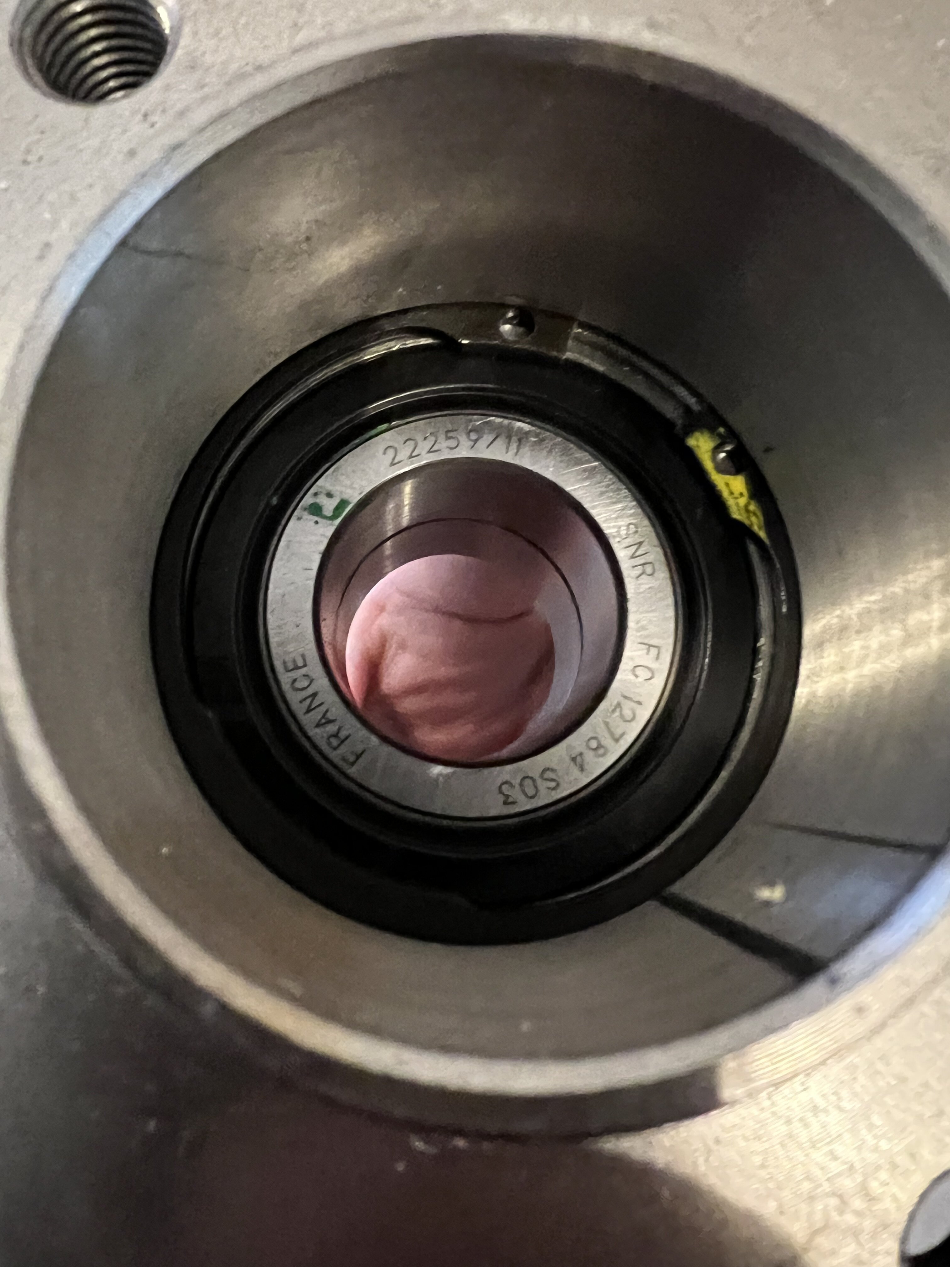

I have a constant 'whiring' sound from the car. Not sure if it's the PS3's or a bearing thats shot. It does it even when coasting so it's not the diff or box or anything motor related.

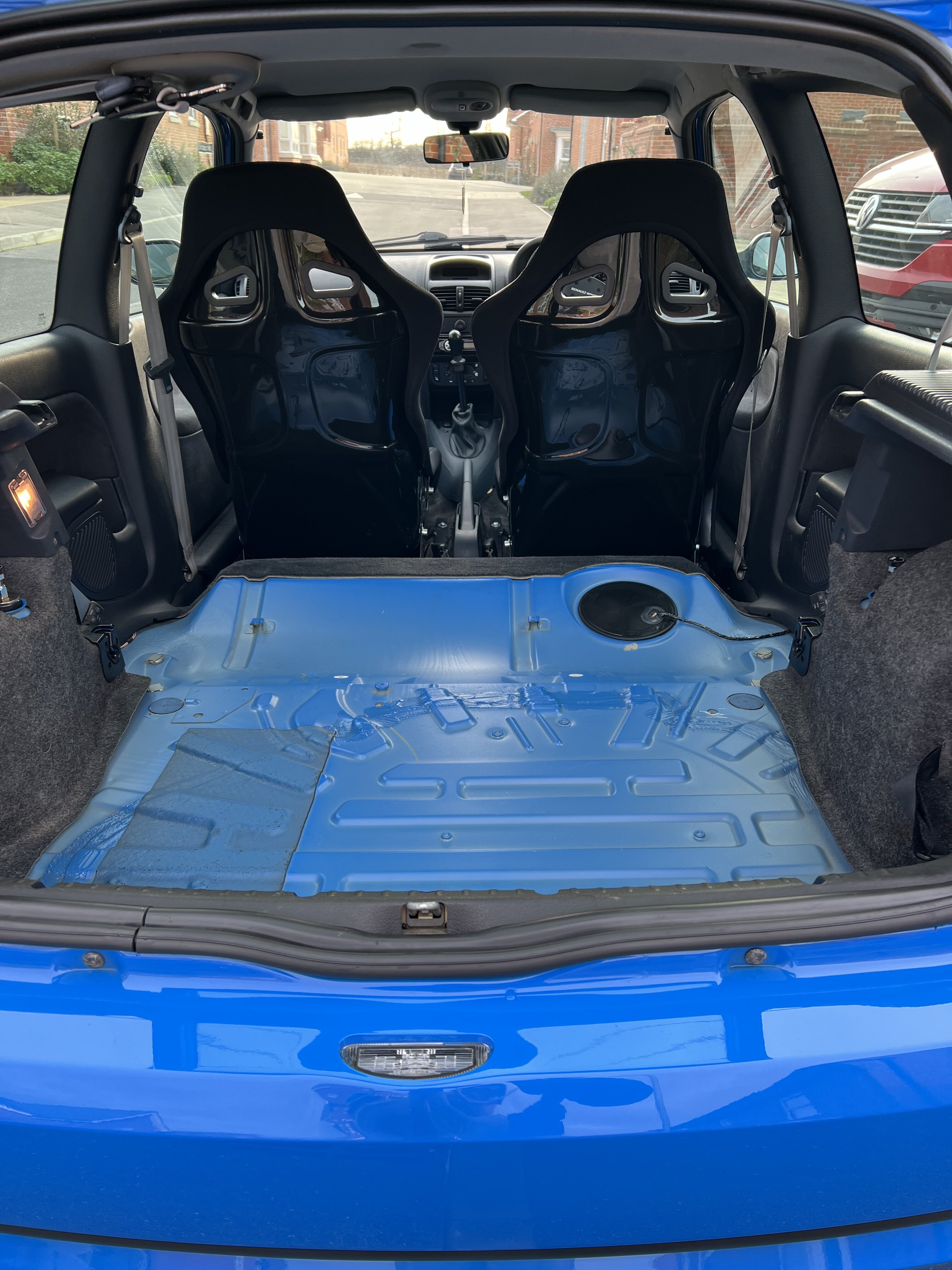

I need to sort some bungs for where the rear bench came out as well, any suggestions?

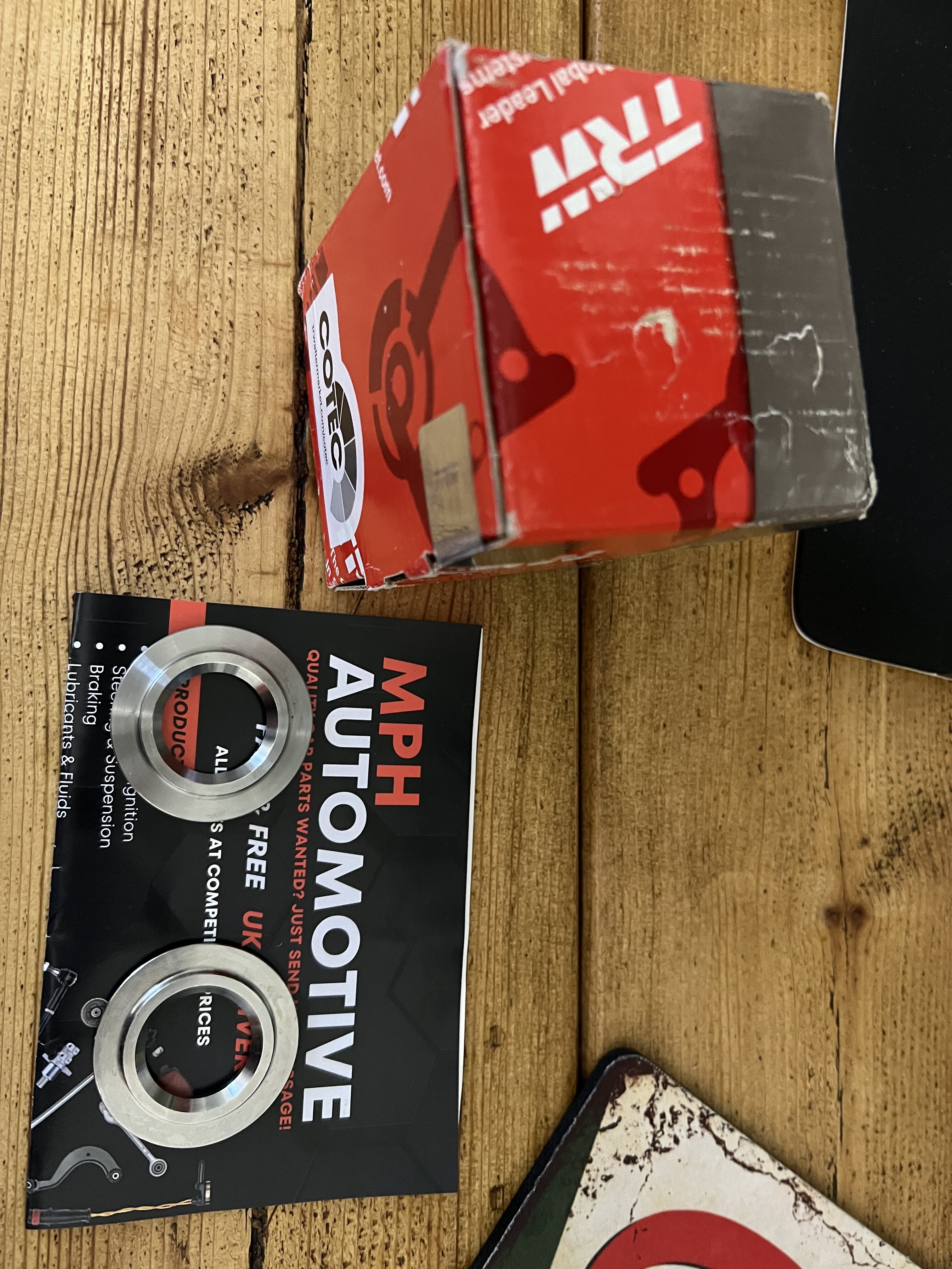

Oh, and this rubbing situation. Need to investigate if it's the well known bracket on the front rubbing or it's caused by the spacers..... regardless, the front 18mm PMS spacers will be coming off as it's too wide and no good for handling.
My front bearings failed on my BG. Despite driving it daily, I didn't realize the extent of the issue until they nearly fell apart.
I had a suspicion that something was amiss. To test it, I would drive along the motorway, shift into neutral, and let it coast, but the problem was difficult to detect thanks to the drone of the exhaust.
Just before the bearings finally gave out, the sound became unmistakable, particularly when approaching a roundabout — a sort of rotational whirring or rumbling that would diminish as I applied the brakes and turned into the corners.
What a difference when I changed them though. The car was so quiet.

I will get her up on the ramp soon and rotate/feel the fronts - just in case.

Did you do the SSL recon/exchange service via eBay? I've just sent mine off to be done by them too. Yours looks great.
Exchange yeah.
Was hoping to swap them over this weekend but the snr discs didn’t turn up in time annoyingly!
I’m happy with the calipers. They look spot on

Discs didn’t turn up until lunch time so didn’t bother with the rear brakes. Will do those next weekend.
Rotated all the wheels. They sound fine, but pretty sure one of the bearings is knackered as the noise goes away whilst driving under brakes or when turning hard right.
Got new oem discs and bearings to go on the rear, so let’s see if that cures it.
