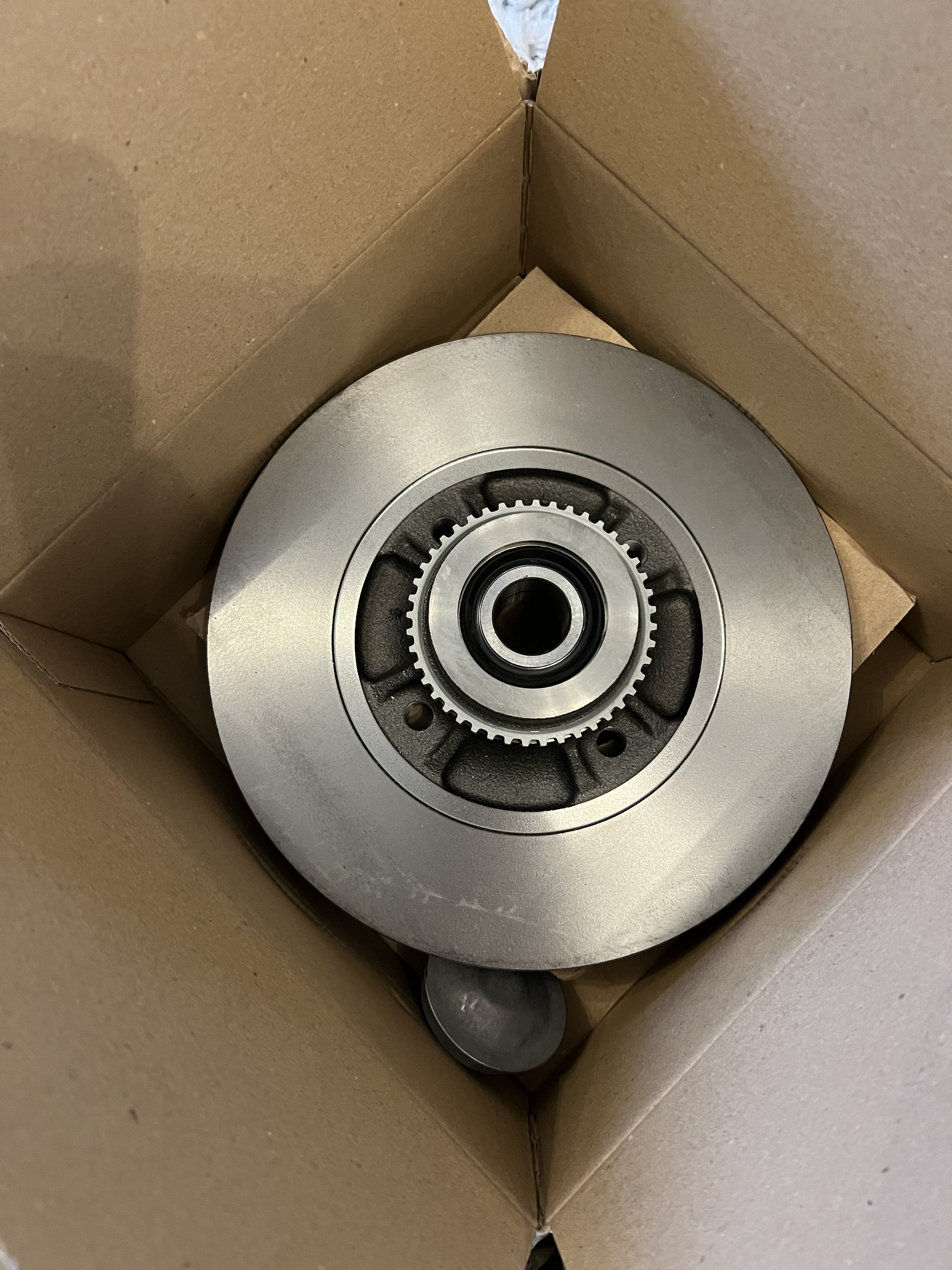

Hopefully tomorrow I will be fitting the following new parts - time permitting:
Rear Calipers
Rear OEM discs with bearings and Grams disc spacers.
Rear pads TRW
Hel Lines.
Replacement Exhaust Manifold to midpipe fitting kit
Powerflex Yellow Upper Engine Mount
Powerflex Purple Dog Bone
RS Tuner 98 Ron map.

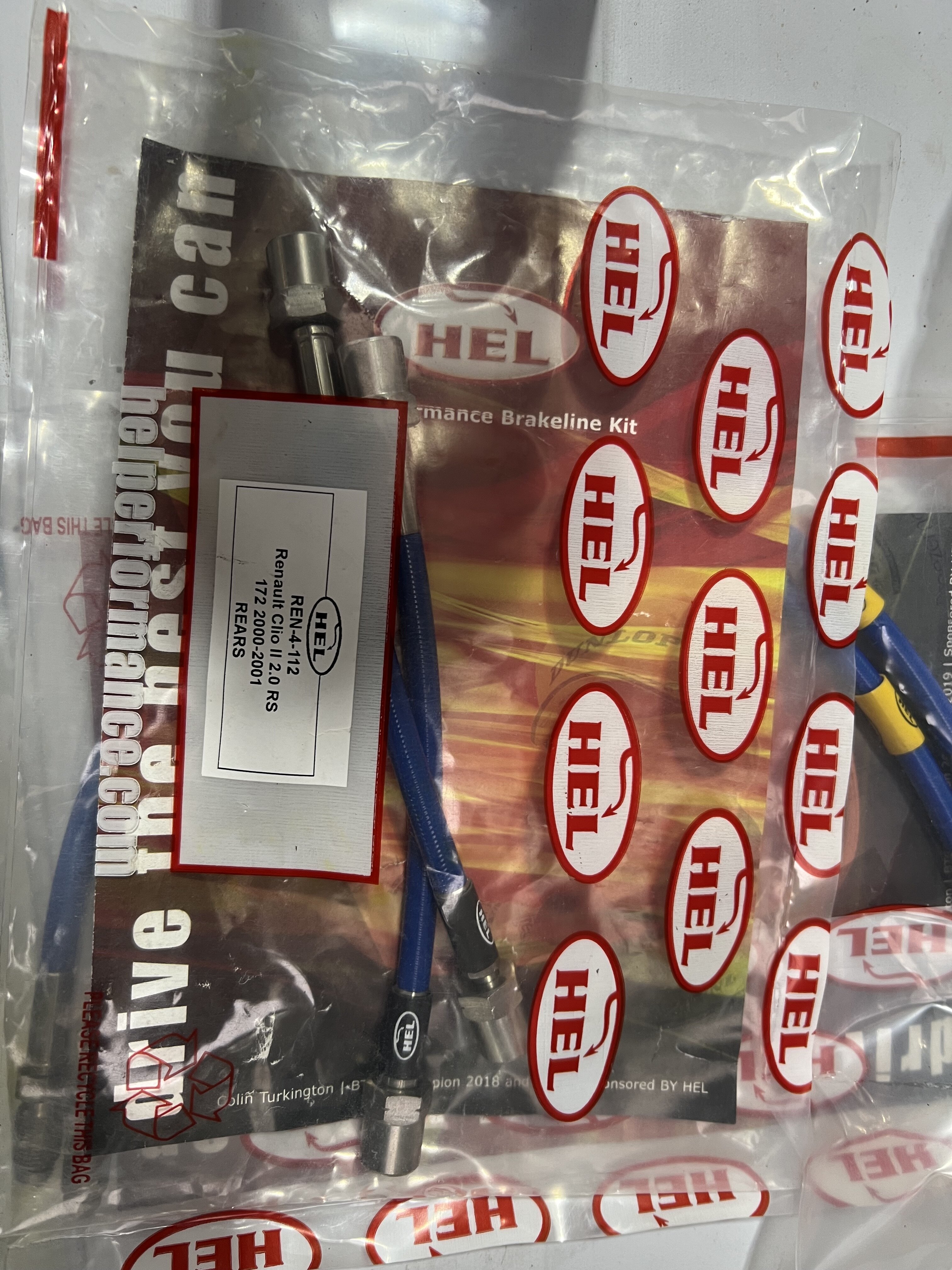

no progress today bar getting the new exhaust gasket in.
can’t really see how the hel hoses would attach as the existing hose is crimped and the unions to the calipers on the rear are seized solid.
So unable to do the rest of the bits as I couldn’t risk snapping the hose union and the new hoses not fitting ffs

The rears don't go on at the caliper mate.
They're to replace the flexi's at the rear beam connection under the passenger side.
Follow the hard lines and you'll see.

Rear SNR oem discs and bearings

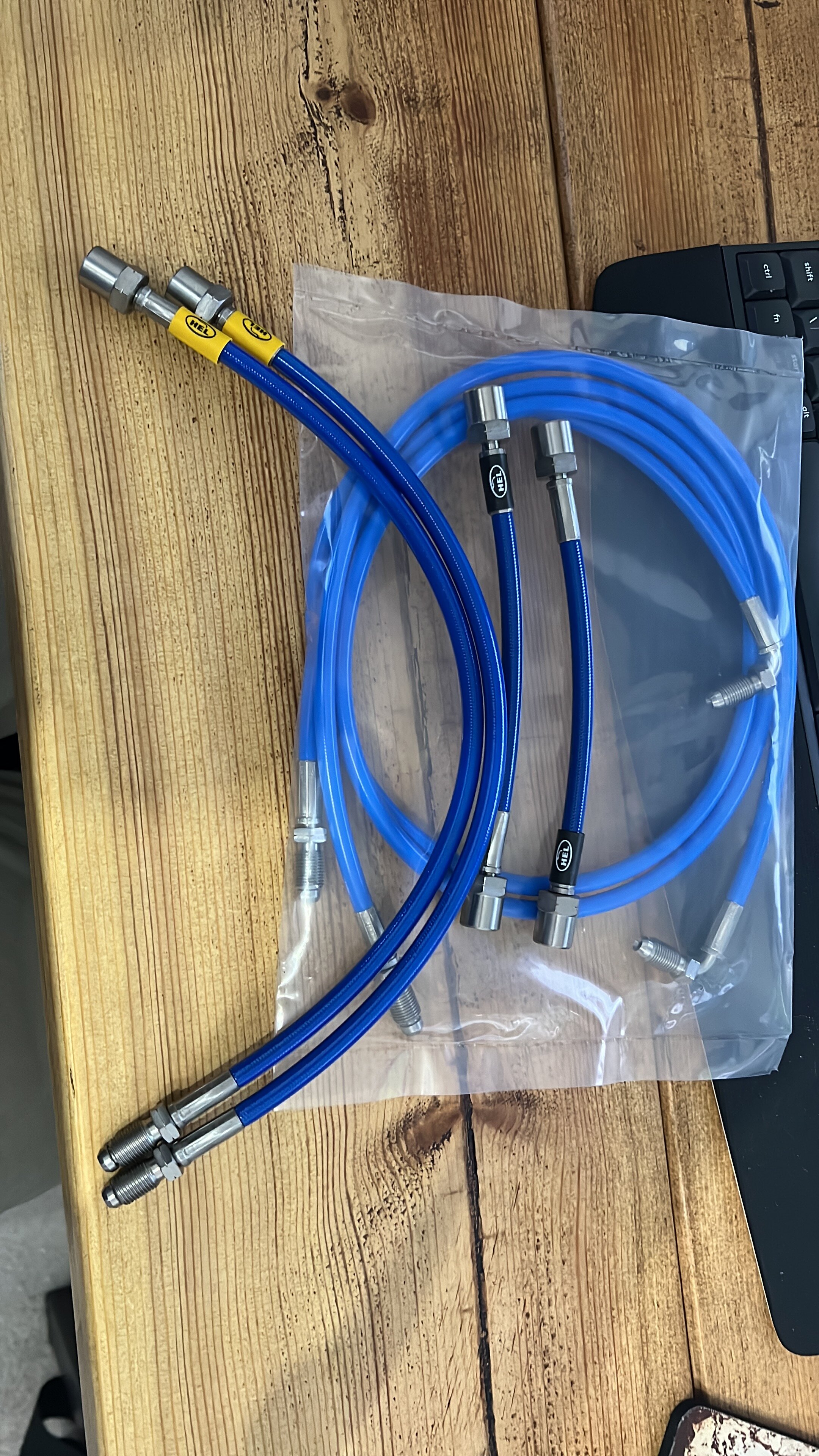

Right. Hopefully I’ve got what I need now and can get on with a few bits with dependencies on the lines not being seized.

Excuse my ignorance, what are the lines in the bag for?
They are the lines from the rear caliper up to the chassis mate. Then the smaller of the two Hel lines links the bagged up lines to the solid pipes. The other longer Hel lines are for the front.
You may not need to change the bagged ones generally as they are solid from oem.. BUT they go rotten and seize (the latter being the issue I have, so I've decided to change the lot).

it's a bit of an odd setup. Not sure why they didn't just braid the lot. On the rear you've got solid up to the union (for use of a better term) and then about 8-10 inches of rubber hose and then back to solid. Bloody french :ROFLMAO:
The bagged up ones are like 40-50 quid. So not bad at all. They're from ProLine. And are made by Hel anyway.
