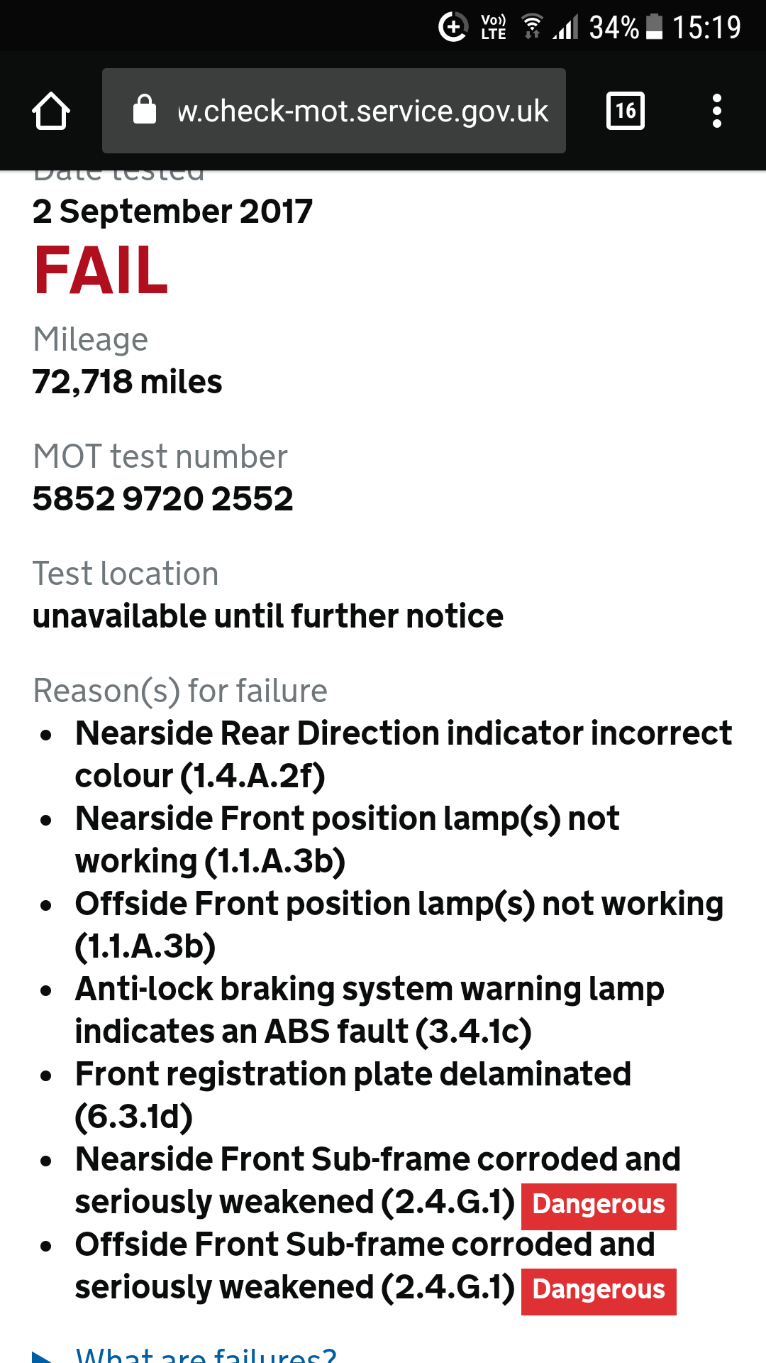

Hmmm. That doesn't seem encouraging tho..

Have you HPI checked it? In the advert it states "a full HPI is welcome"
If selling a car you would normally put HPI Clear if it was. That mot failure is a bit odd too. They don't normally suffer from serious corrosion on both sides of the subframe.

Rear quarter looks crap too.

£75 mot? Bargain.

Yeah that's strange considering it was only dine in Jan!
Aye. Seems weird eh? Also prev damage/corrosion to radiator mount
