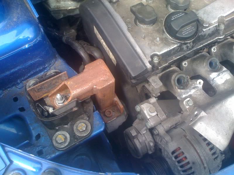

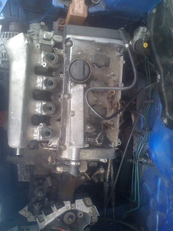

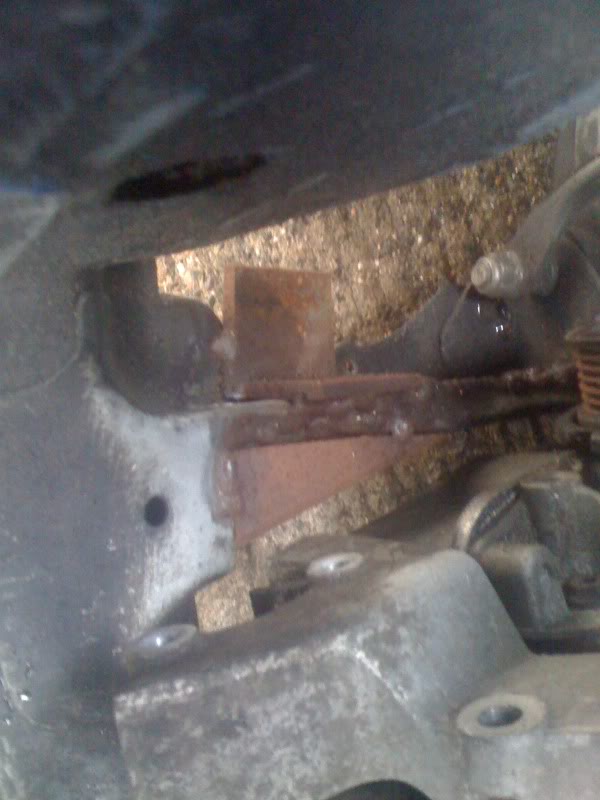

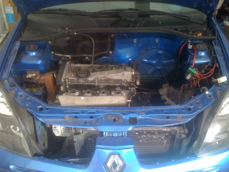

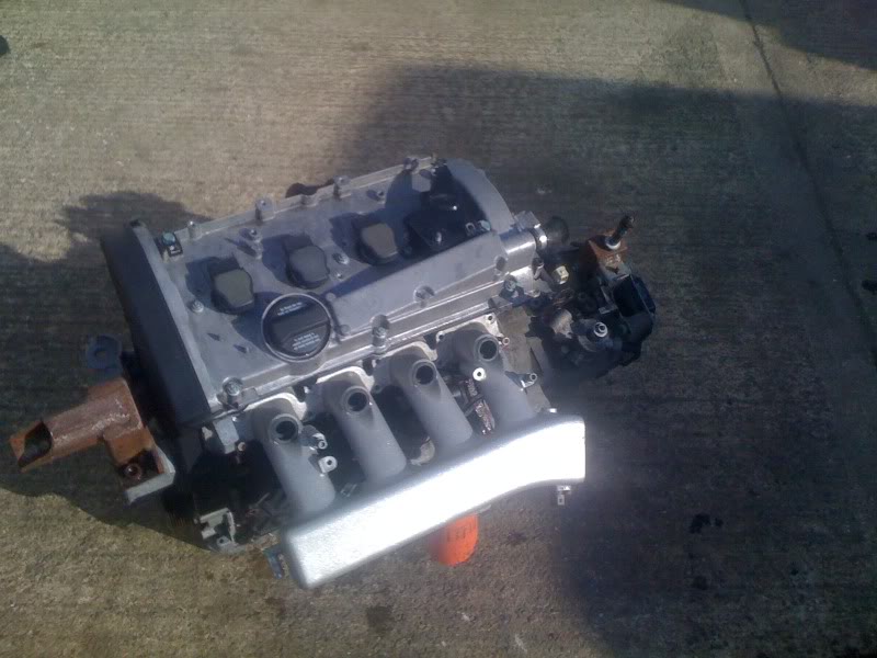

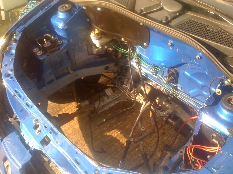

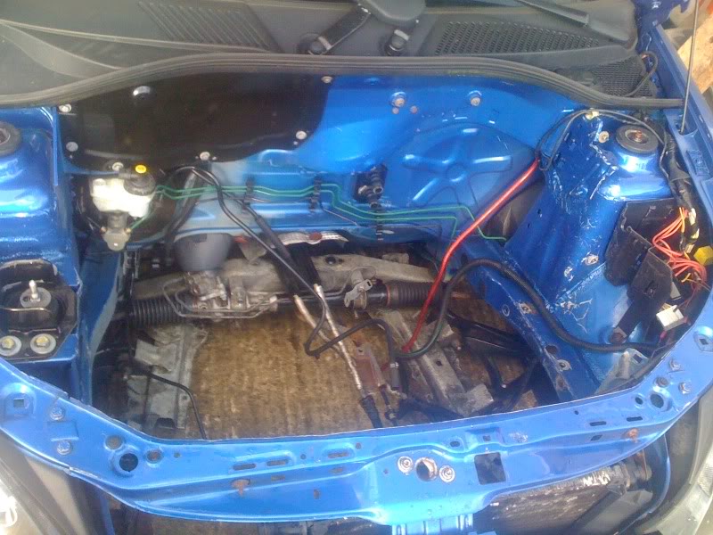

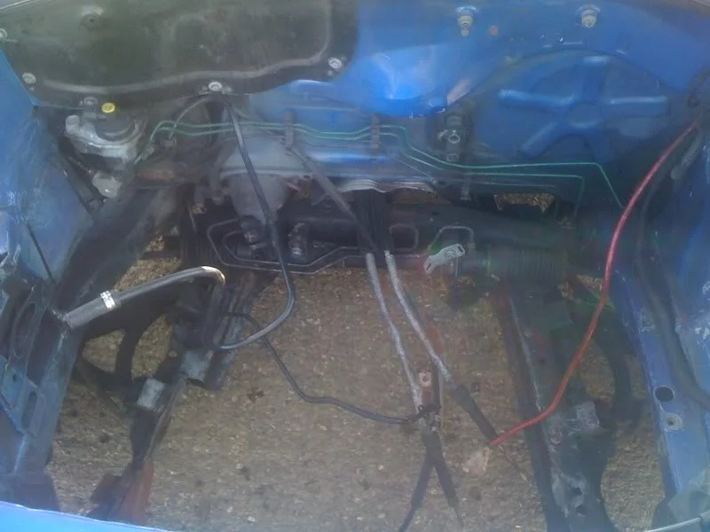

A Little update on the Clio, This is how the car was when it arrived. Engine mounts have been made, to be fair the construction is ok but its a shame the engine was not aligned first lol

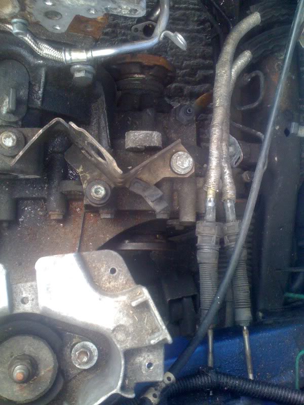

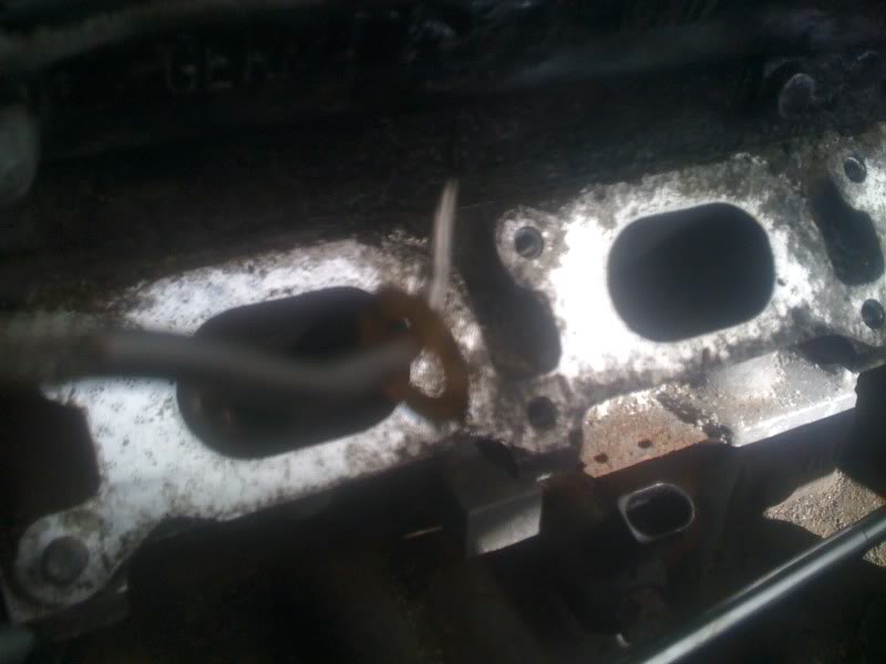

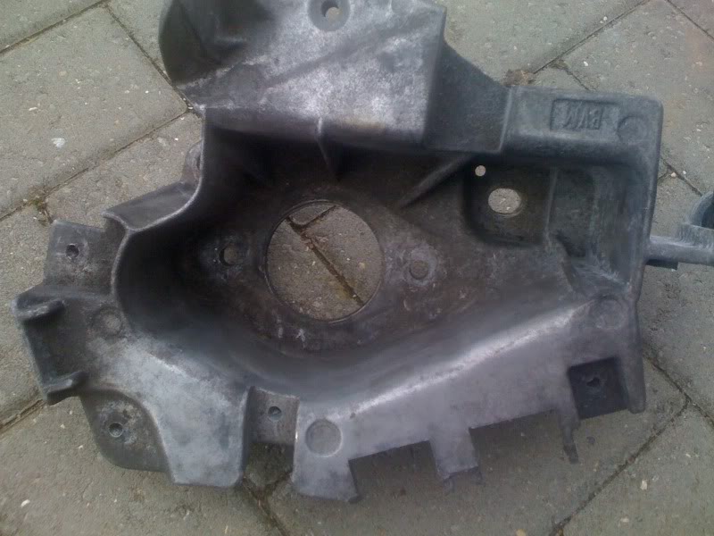

The cars been sat a while so its filthy and never a good sign when you find this sitting in the inlet port!! (its the base of an Injector)

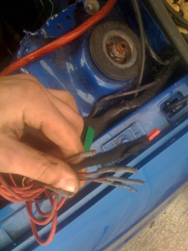

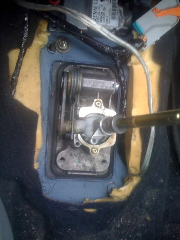

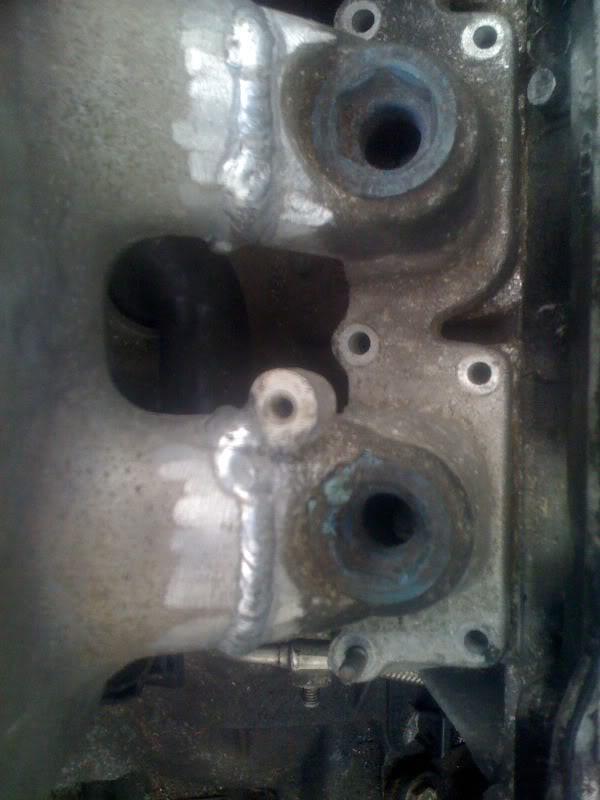

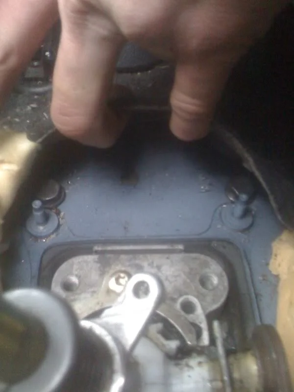

Gear lever is a tad bodged and the old inlet that has been cut and welded is rubbish... oh and not forgetting the cut wires!! Brilliant!!
Subframe looks... well....... i wont be using it put it that way lol
After a good clean it looks a lot better..

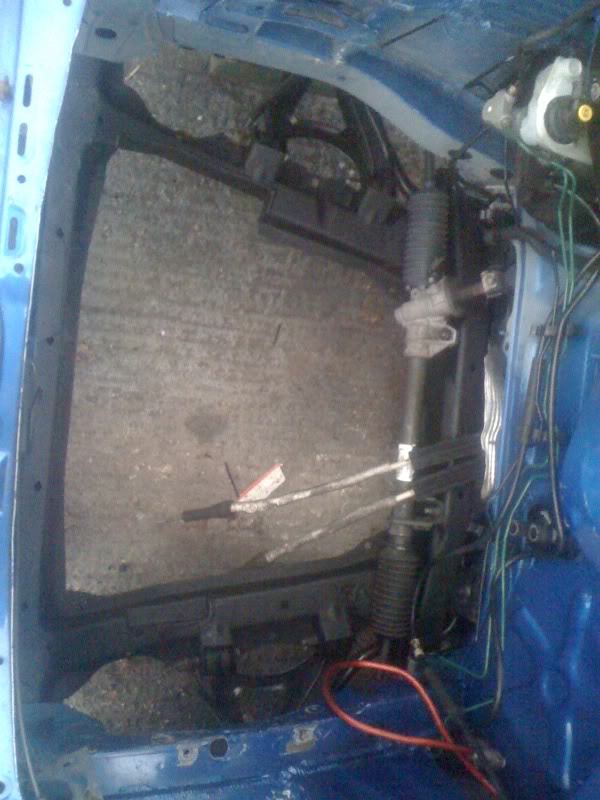

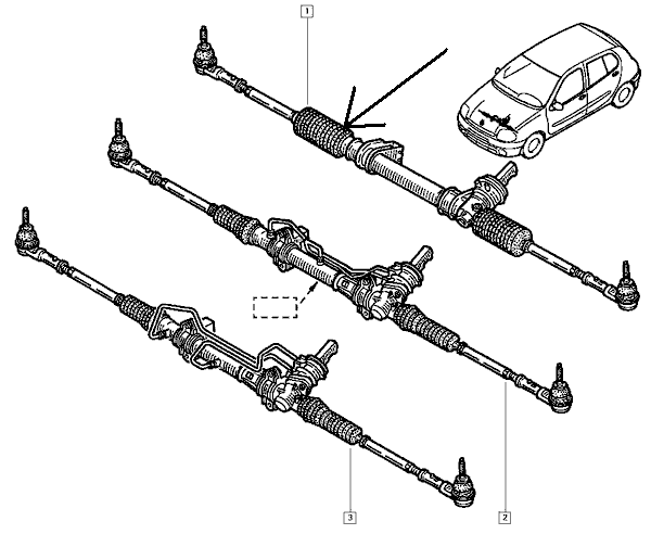

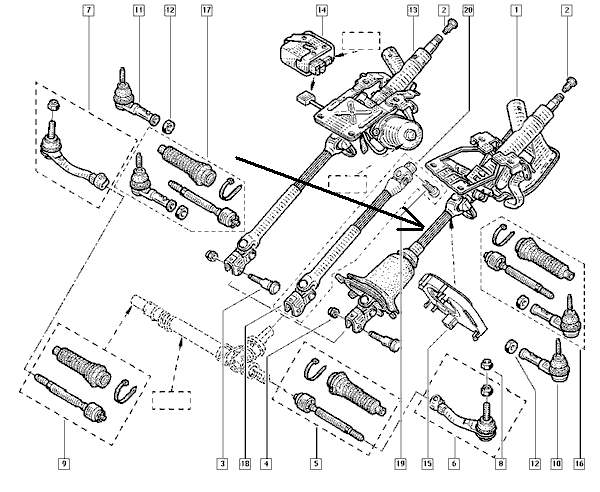

Next stage... new subframe and fit the Clio DCI manual rack ( i hope it fits the 172 column) then realign the engine and modify the mounts.

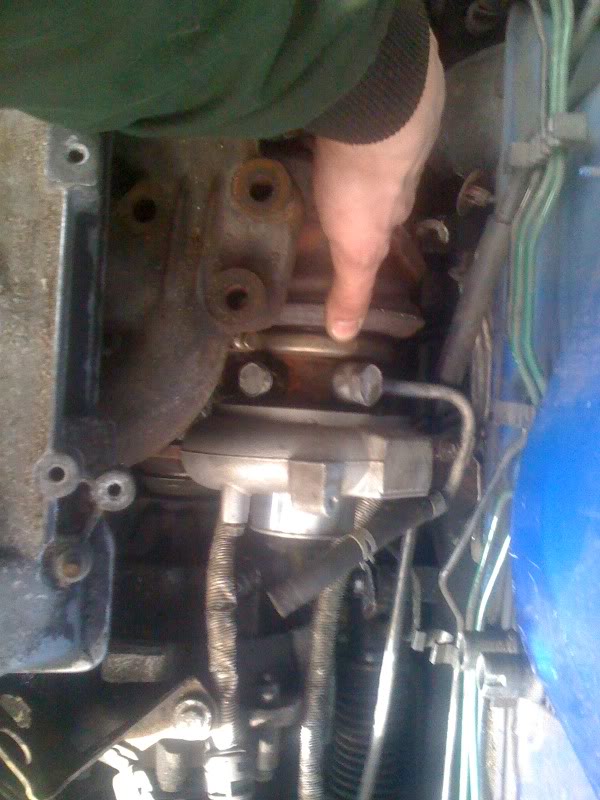

Also need a new turbo as this one is to big lol

Cheers for the Info Matt, do you need to change the track rod ends?
The Turbo was of an Evo 8... i could get it to fit but with alllot of work and a serious custom manifold.

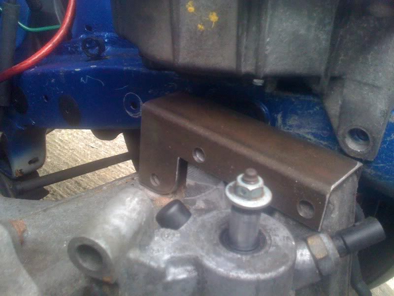

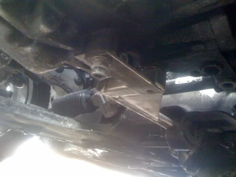

Tiny update.

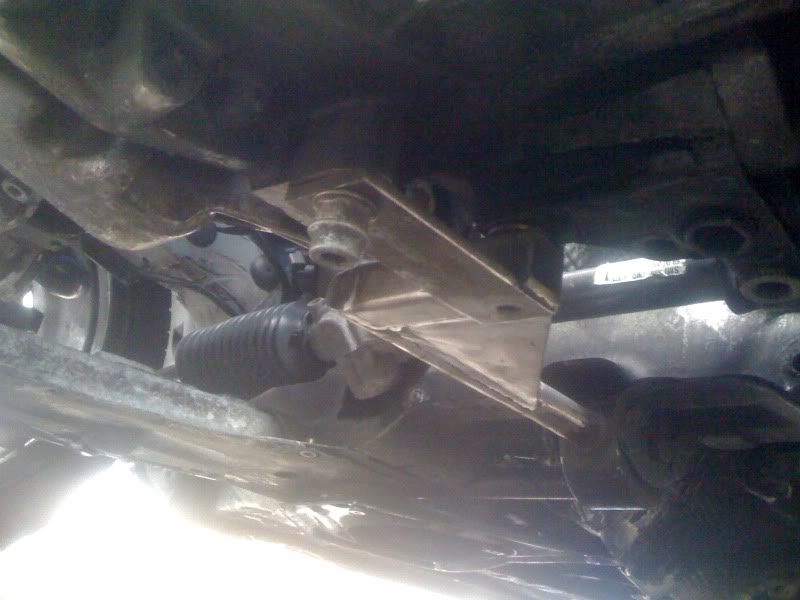

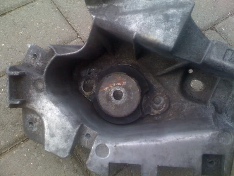

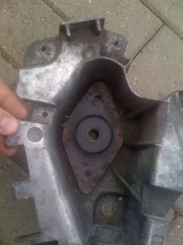

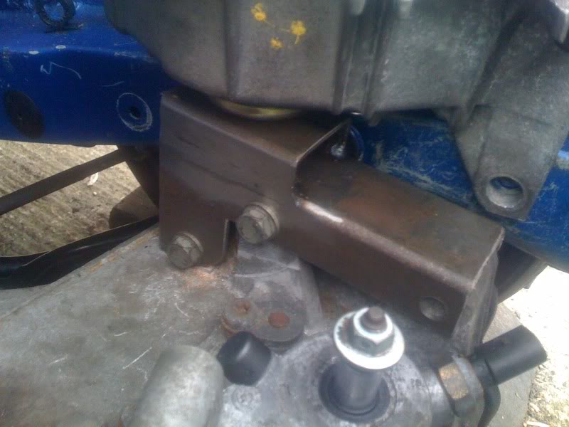

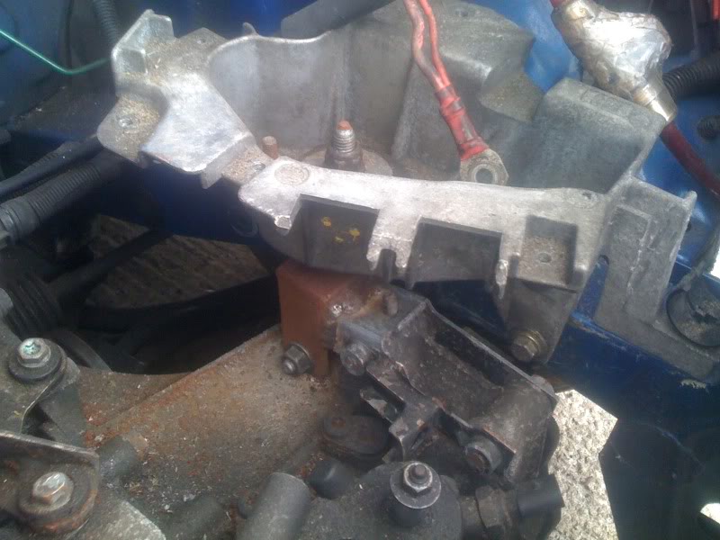

Standard Clio NS Mount bracket
With rubbish std mount, way to flexible for this job!!

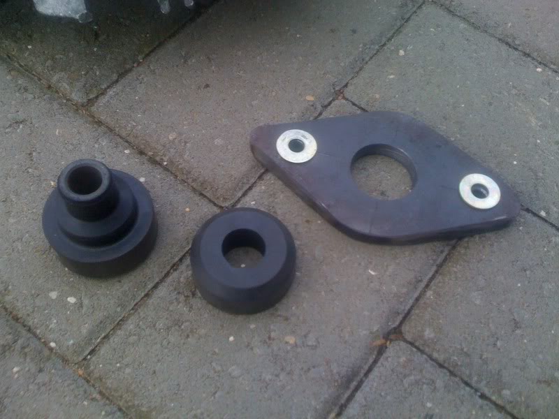

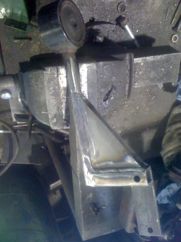

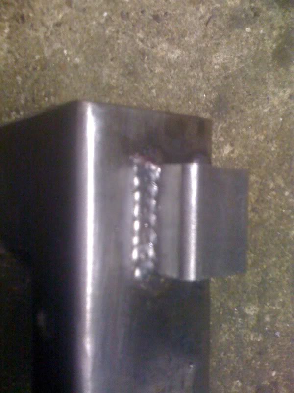

Just got this back from the engineering shop!!
New mount with very stiff poly bush!
Fits like a std mount
Re: Cup TT ??

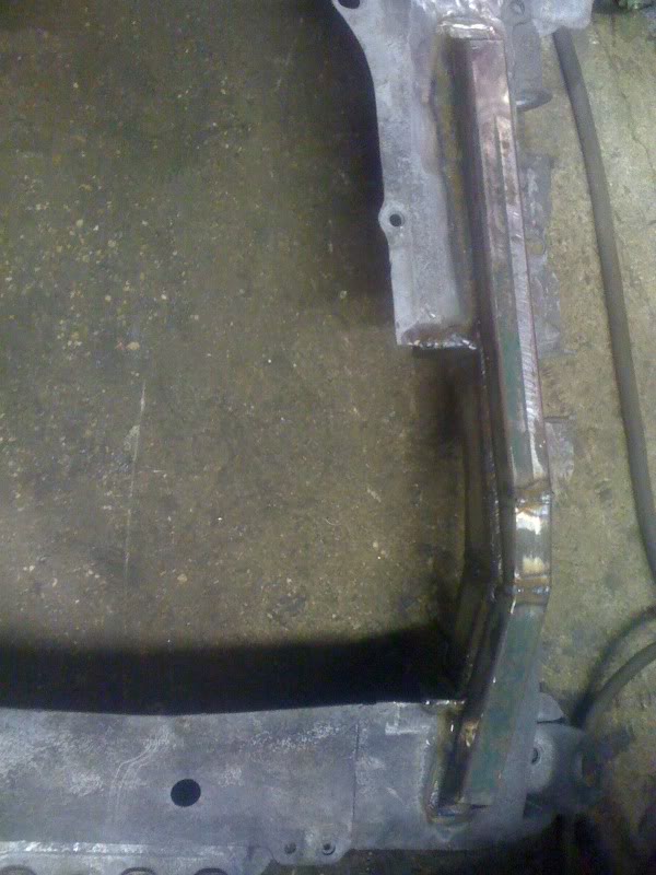

some break ive had!! been workin on the car all weekend but got lots done
New N/S mount
new dogbone mount

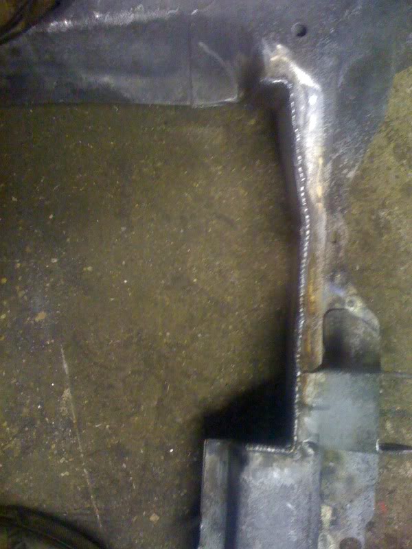

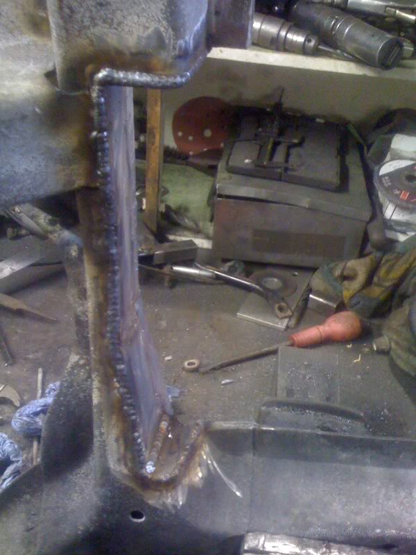

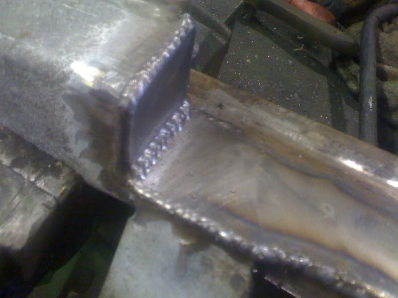

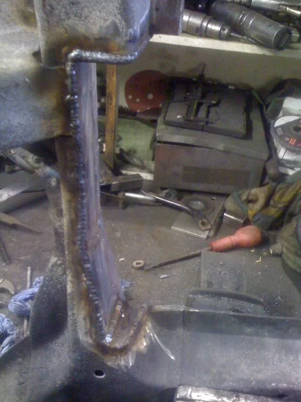

then the fun bit! Subframe... always fun with the zinc coating.. one unclean patch and the welder had a fit!
All done now
also picked up some more driveshafts.. Big thanks to Mark for sorting that out :D
Next step...painting and making the shafts...joy
Re: Cup TT ??
Lovely work mate. Weld is very clean and the N/S mount is the best one i've seen yet!

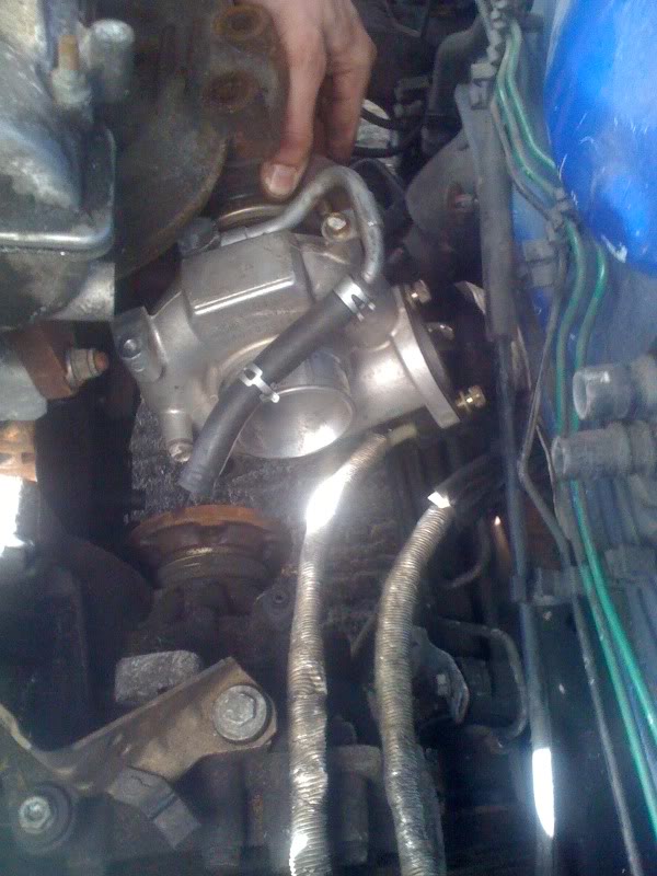

Were now using the std TT inlet manifold... the inlet temp sensor is 10mm from the bonnet catch :D
hope the boost piping works out ok with the pickup that side. Which side of the engine are you gonna come round off the turbo? N/S as normal? or try and do it like the stock TT and go O/S?
Re: Cup TT ??
i actually have the Std 225 bam hot pipe (intercooler pipe) that fits round the back and down the side (next to the cambelt cover)
There is loads of room compared to the MK1 ;)

I'm trying to work out the water route....having a big of trouble working out where the turbo water feed comes from. Might give you a PM later about it!
Re: Cup TT ??

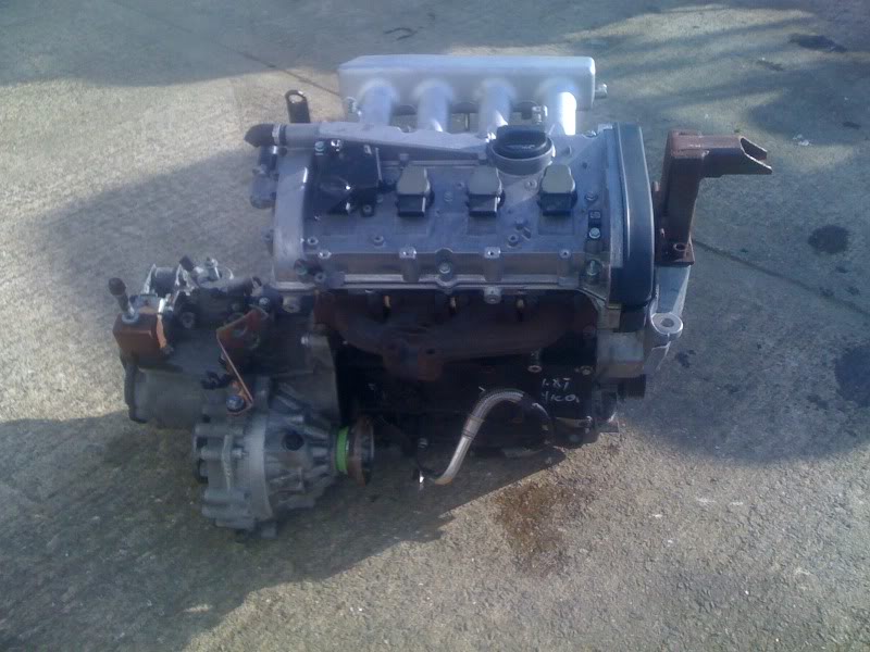

One of the water lines goes into the back of the block. The other goes round the cam belt cover and into a steel pipe...along the front of the engine then into the pipes running into the heater matrix...

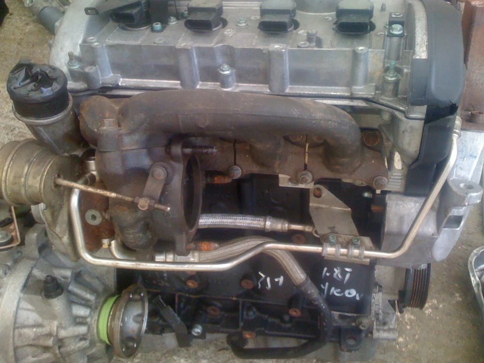

here is the K04 plummed onto the AGU (although i still need new copper washers) ;)

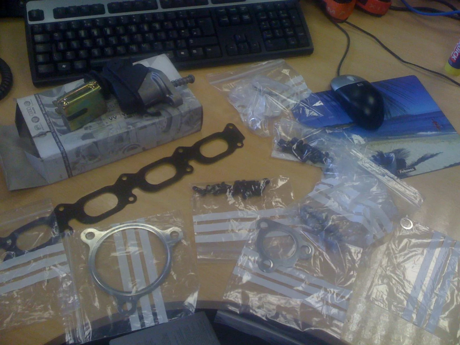

To late... i had to go get the friikin washers!!!!
and all the gaskets... your rubbish!!!!!!!!!!!
check.....
