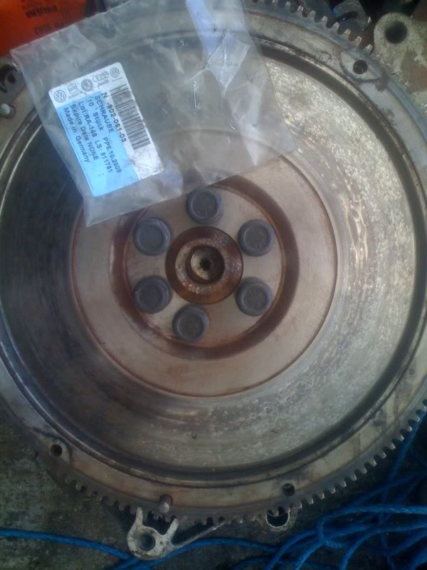

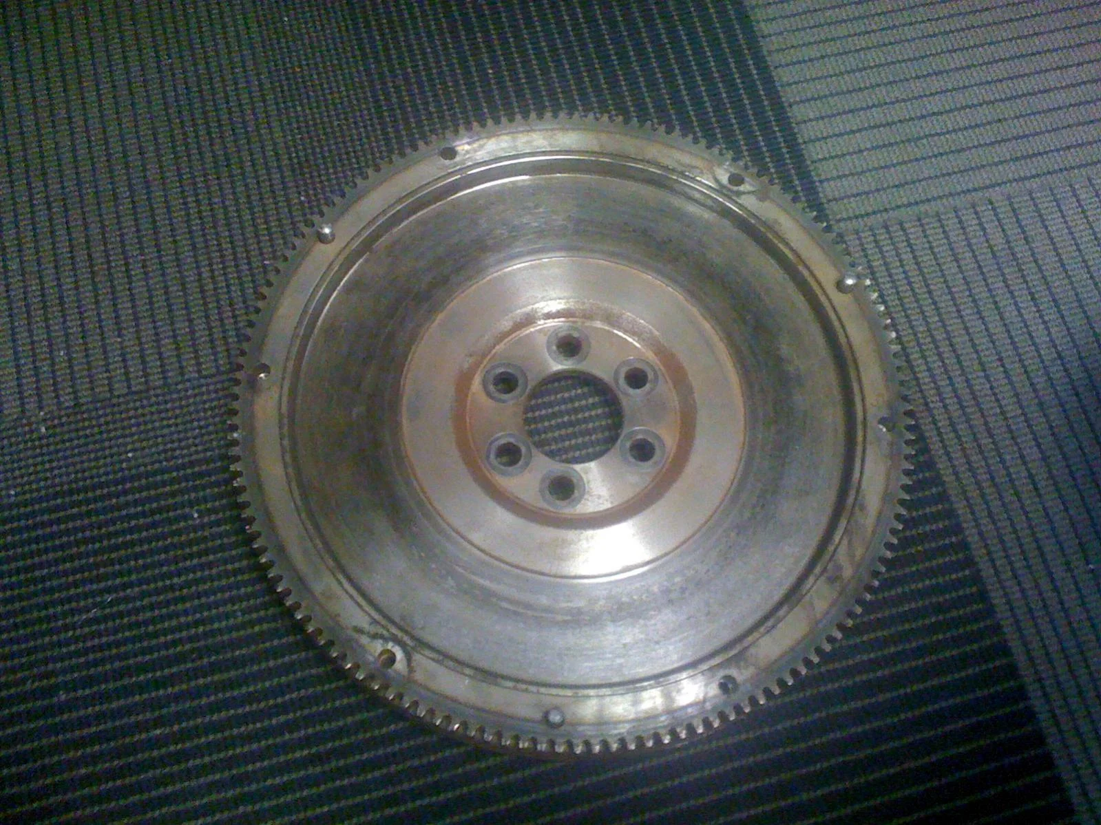

Look what i got!!
ABF/G60 flywheel part number: 037 105 273 combined with a Golf MK3 VR6 Clutch kit = Good clutch for 340Nm ;)

Yer, bigger and lighter. 228mm
new flywheel fitted with new bolts as there shorter
part number N905 398 01

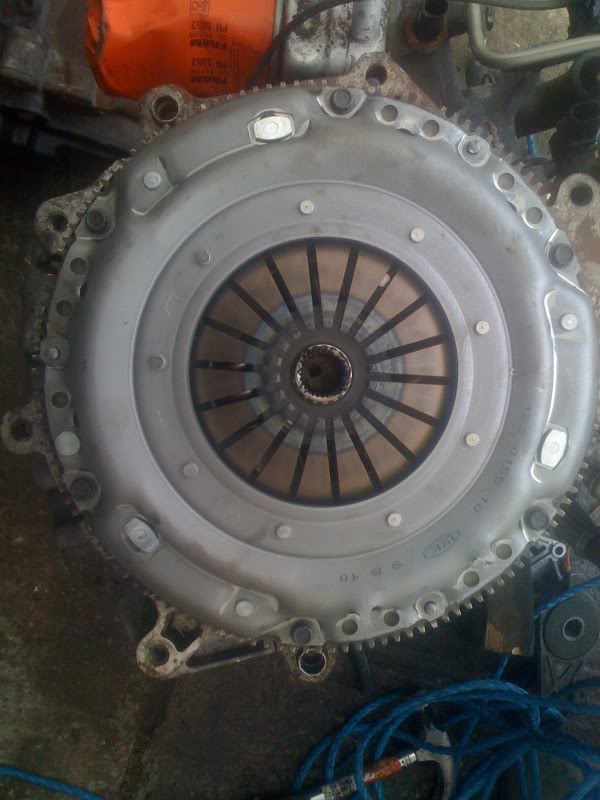

new vr6 clutch fitted with new bolts
part number n10101001

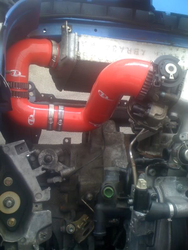

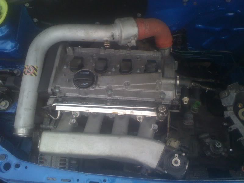

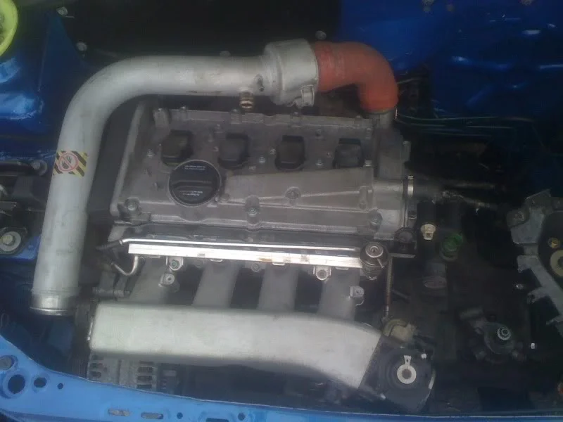

Mini update,

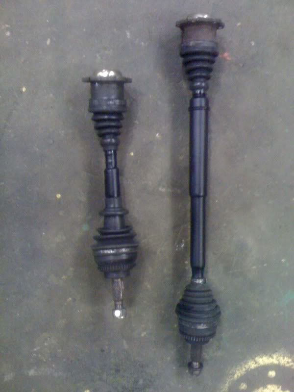

driveshafts finished, double sleved and welded...there not going anywhere!
next job..pluming? fun

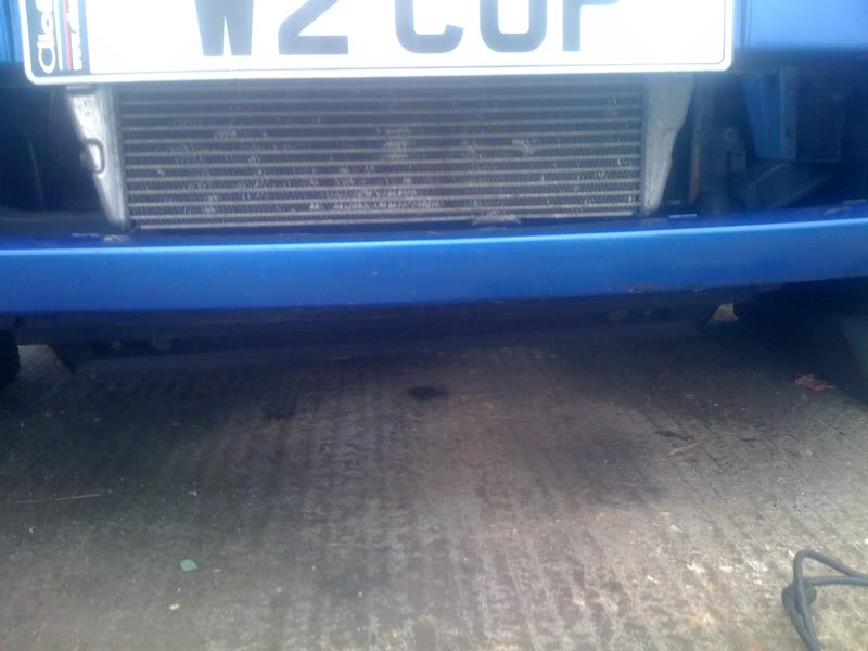

mounted the intercooler

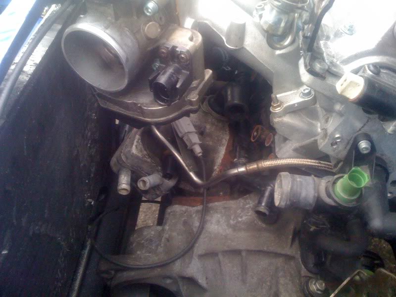

instaled the AGU throttle body, also you can see how tight it is between the oil filter and the rad...gonna need to use a oil filter sandwich.
the start of the intercooler plumming
lots more fun still to come ;)

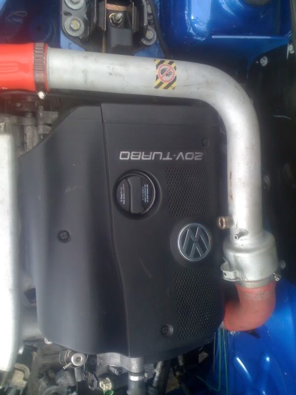

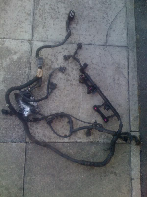

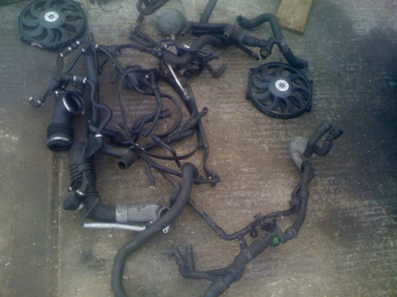

Yet more fun today :D
found an AGU loom at the vw breakers....and some other goodies ;)

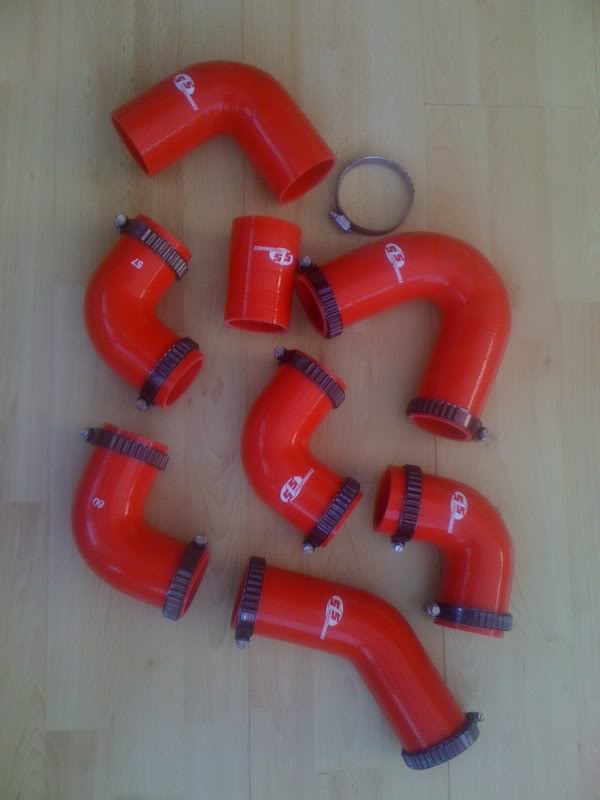

Then went to SFS to pick up some hose's
all plummed in with a new engine cover too?
next job... the Rad!

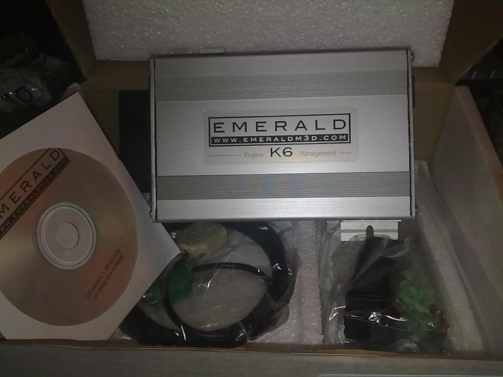

Had a package today
Woo its finally been built and arrived!
This has the 3 maps switchable from a dial on the dash.. Just got to decide what kind of maps to have.. guessing an all out power map, an eco map, and god knows what for the 3rd!

K6??
Is that a new emerald ECU? Or is it the variant with more ignition drivers, capable of running a V6/V8 or something?
  172 cup TT
Re: Clio TT (172 cup)
Yeh, brand new - does loads of funky stuff... Still shows as "coming soon" on their website

few pics... found a heat shield and added some VAG heat shield... not pretty but practical.
Also the flanges turned up!
and the new linkage... the one fitted was a 6speed... epic fail!
we now have a working gearbox!!! and throttle!!! ;)

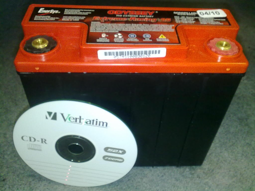

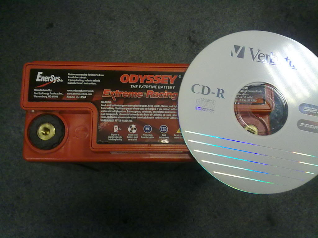

More prezzies arrived today...
ITG Maxogen:
And the Slimline battery - cant get over how small it is!.. pretty cool. Should solve our lack of space issue nicely!

Been a busy weekend... that c#ck Floodie was moaning so thought i best do some work ;)
Fuel sender fitted....that was fun!
then made some custom lines from under the car to the fuel rail with 24Bar hose...should be enough :d
all connected up...
next..the wiring......
FUN!
its getting a bit cramped in there....
