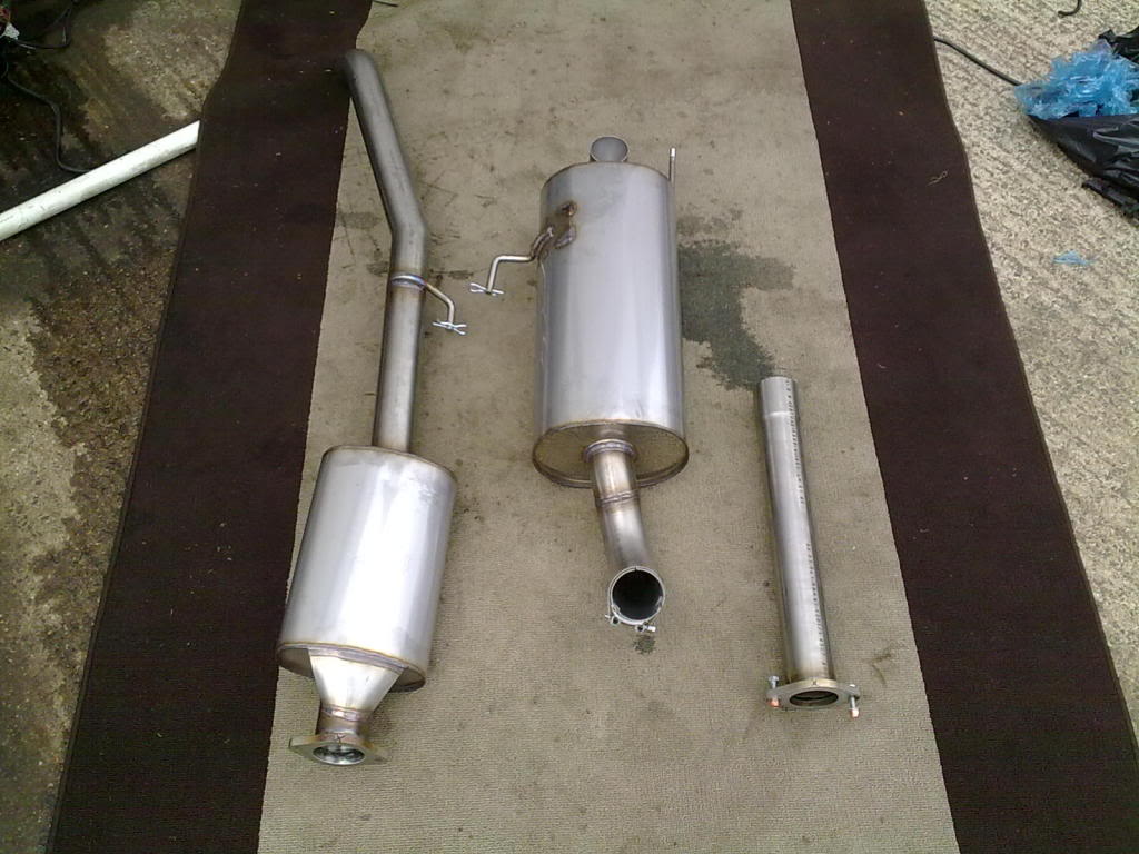

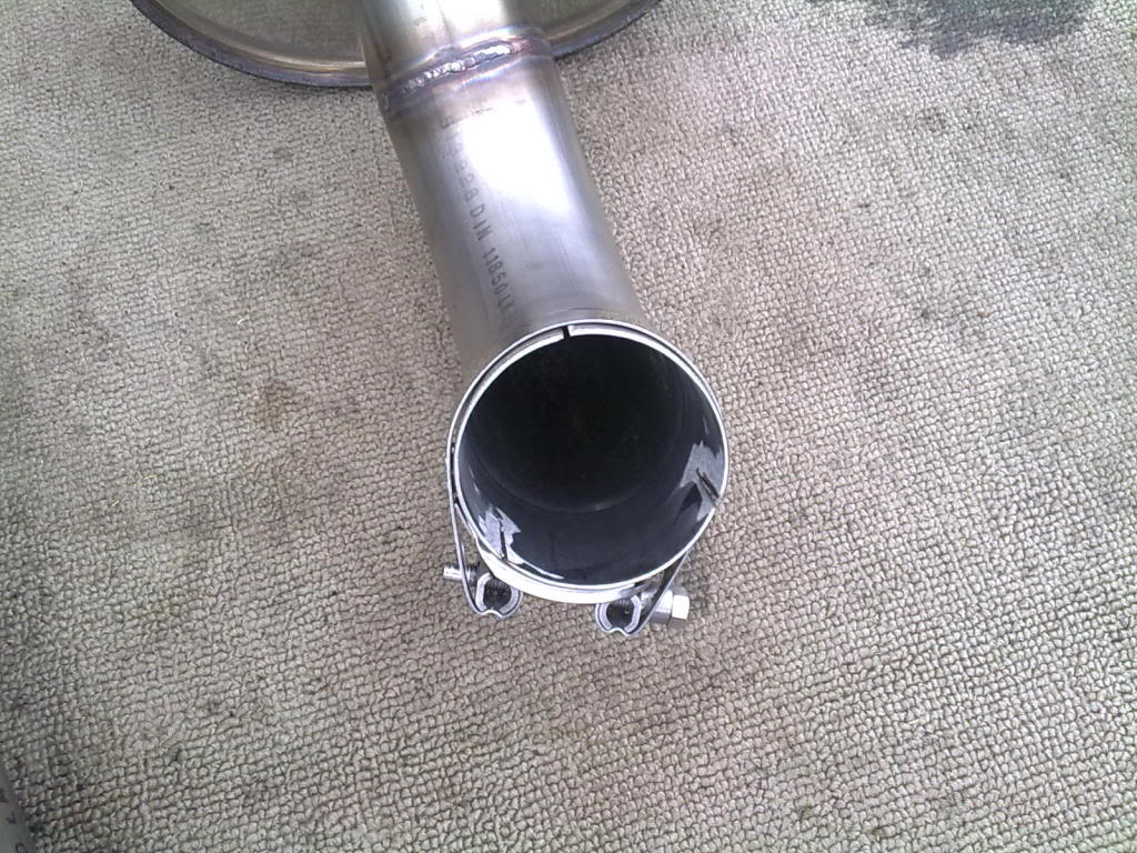

Exhaust arrived - must admit, very impressed on the whole with BTB exhausts. Cant understand why they dont have a bigger name in the clio world to be honest. Delivered in 2 working days, and not that i know sod all about the quality of welding but after showing Flan he was very impressed with the quality and the little touches given to the brackets and clamps.. A very smart system, and for the price its a no brainer.. With that said, it hasnt been fitted to the car yet so it might be an absolute pain, but i'd be suprised.

Its essentially a cat replacement pipe... i need to order another bit of pipe in a sec from him too..
  172 cup TT
Re: Clio TT (172 cup)
Yeh, got the downpipe from an LCR.... Flans plan for the DP solution is to mate this to an extra piece of stainless that i ordered today from BTB (half meter long, 2.5" in diameter with a 90 degree at one end) .... Main niggle at the moment is hoping we actually have a faulty crank sensor and its nothing more serious! (fingers crossed)

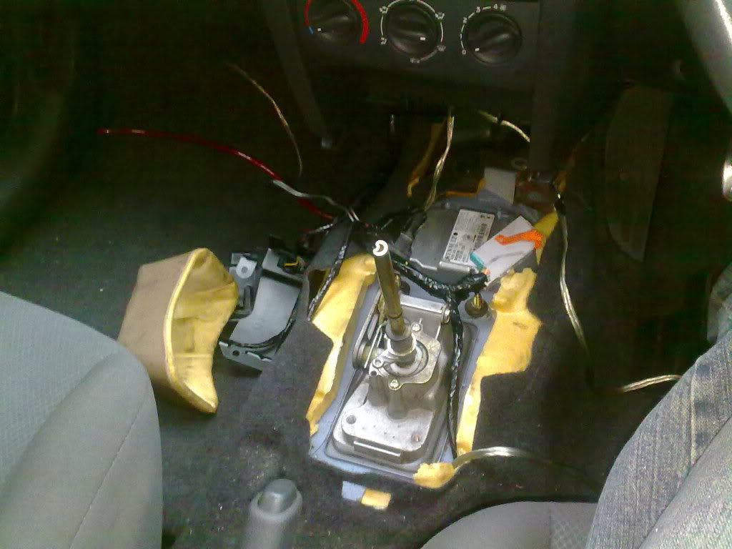

Had a few dramas on the way and I'm sure some fine tuning will be needed. Dave (Floodie) has got to get a custom downpipe made and fit the exhaust. Plus wire in the tacho and speedo. Then get it on the rollers... Should be 260/270 bhp with similar torque... Should keep Dave happy for a while ;)

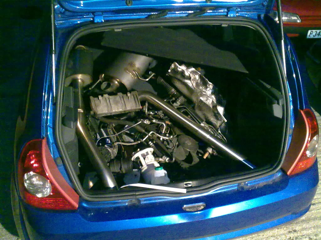

The back of the car is full of old renault parts, bits and bobs, plus my new exhaust thats going to be fitted.... Bit too late now but will give it a good clean out and spruce up tomorrow. Got to also start on the gear stick surround / lower part of the dash too...
