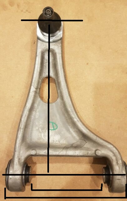

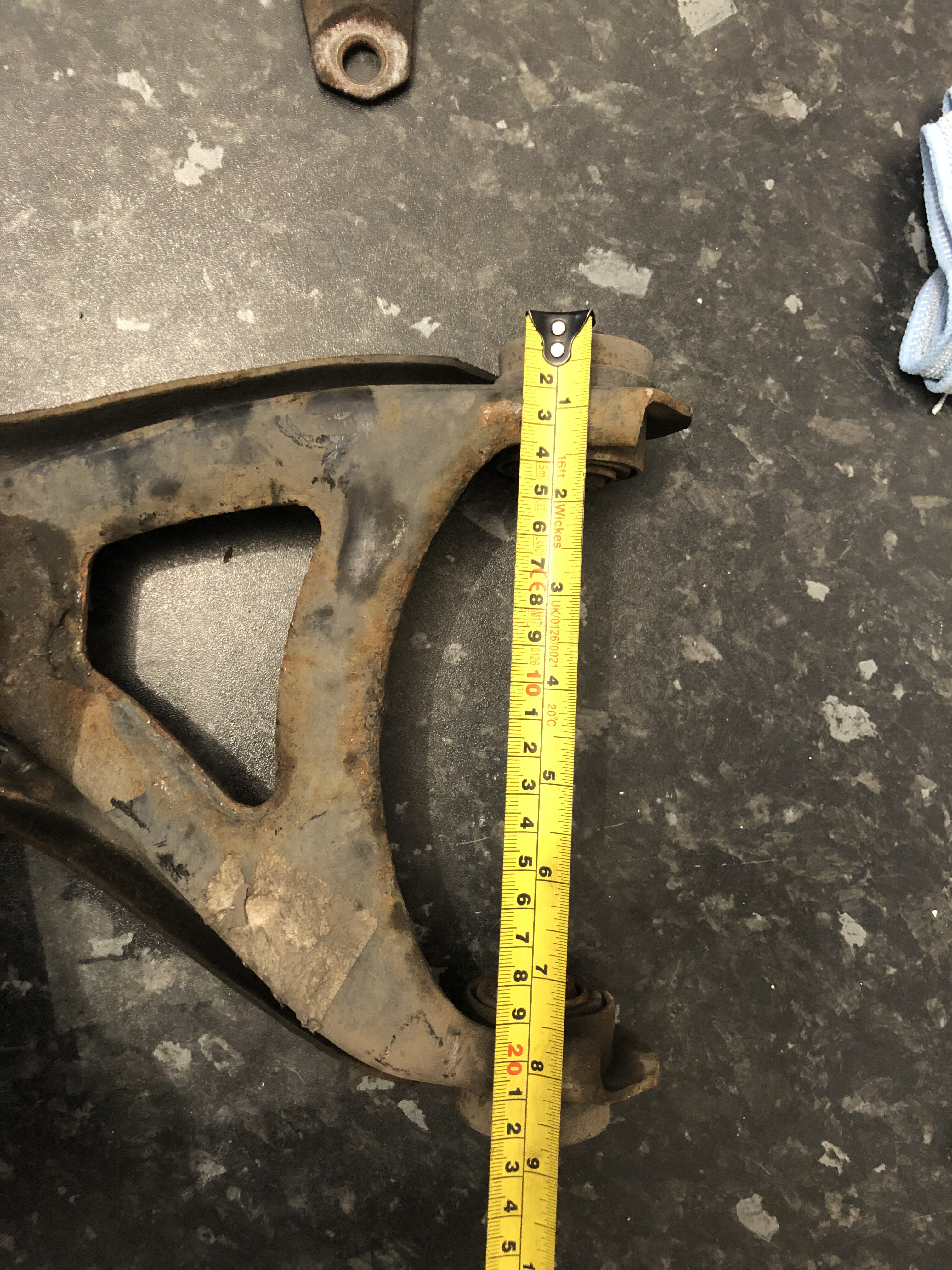

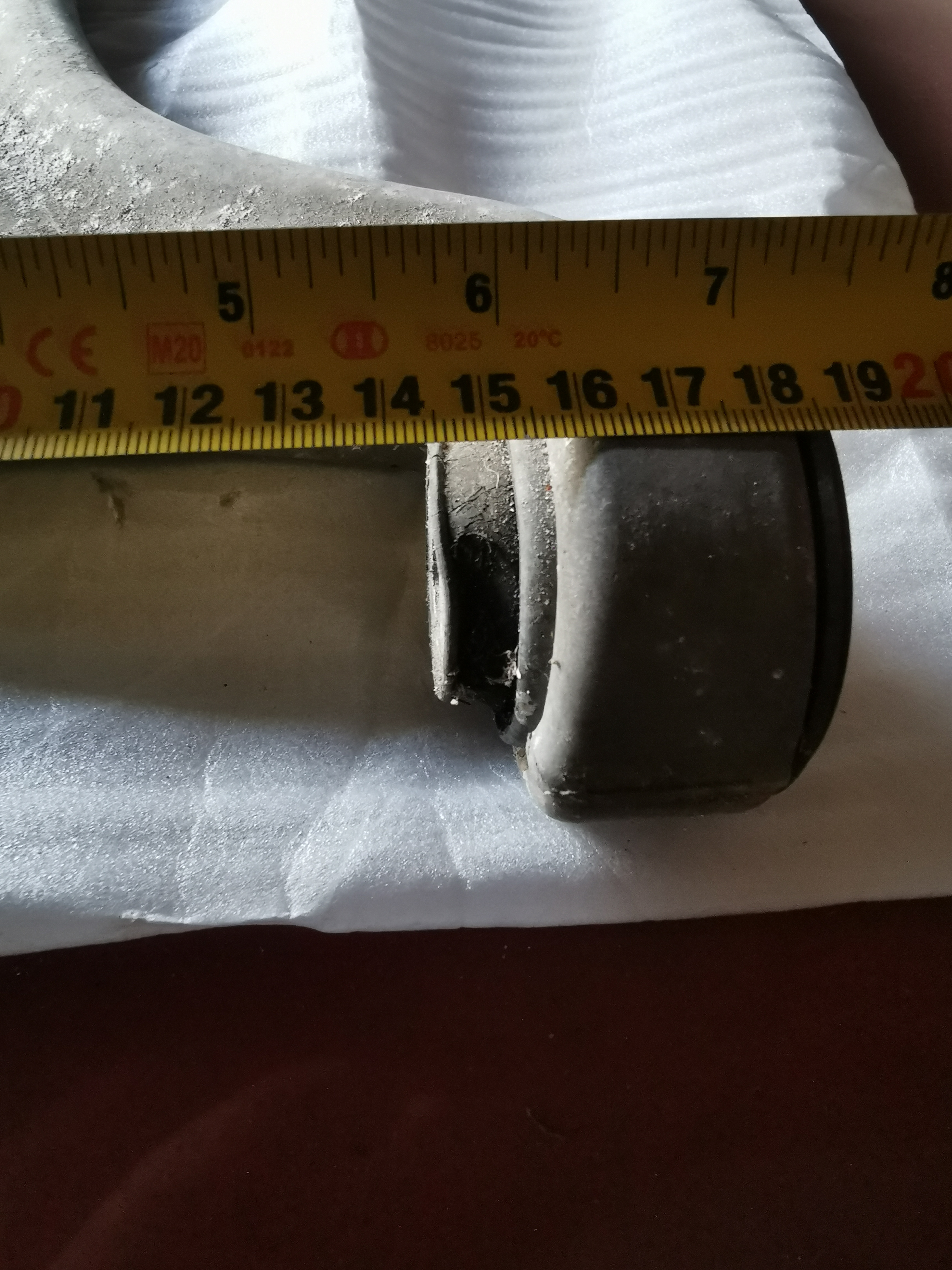

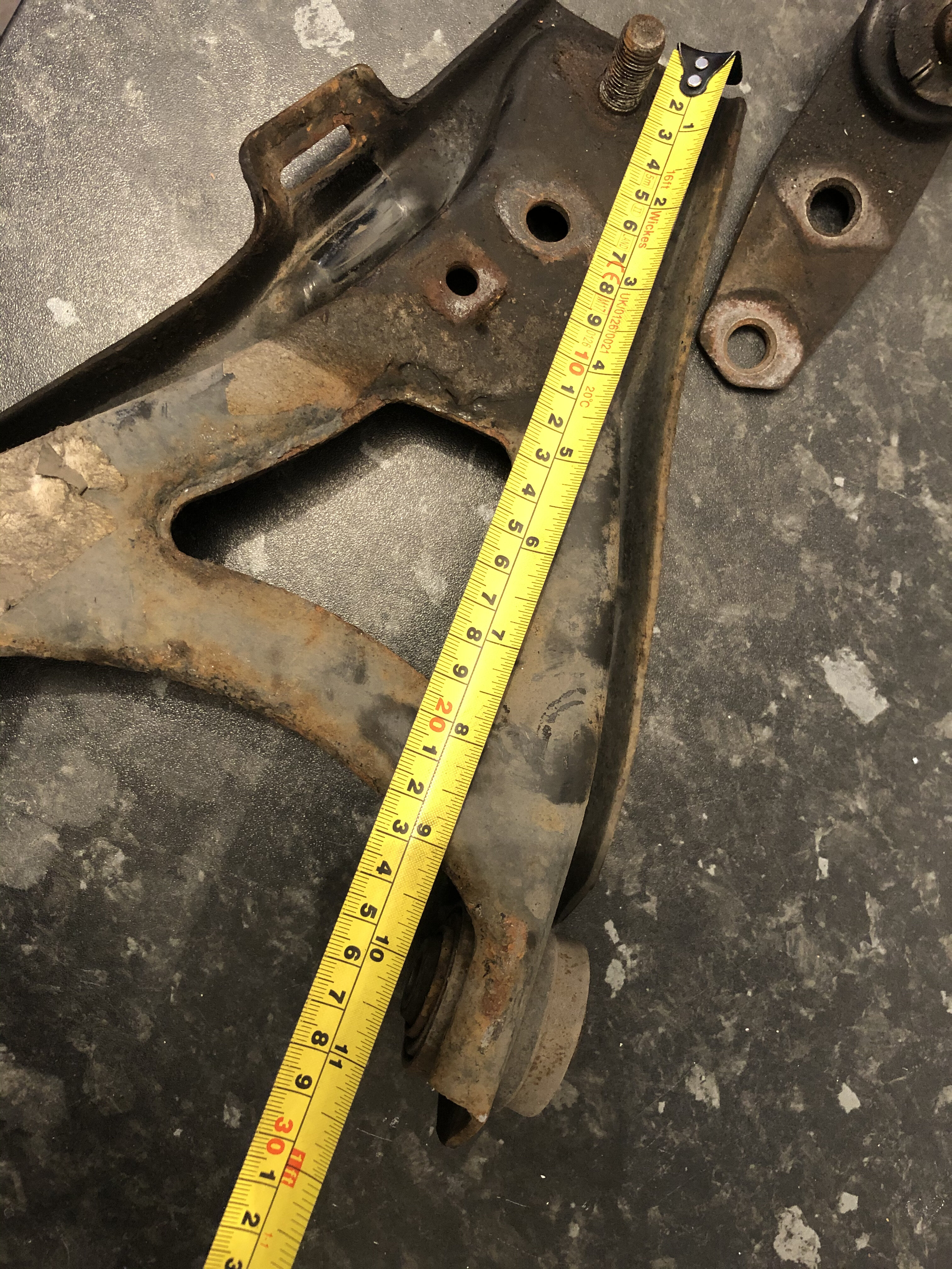

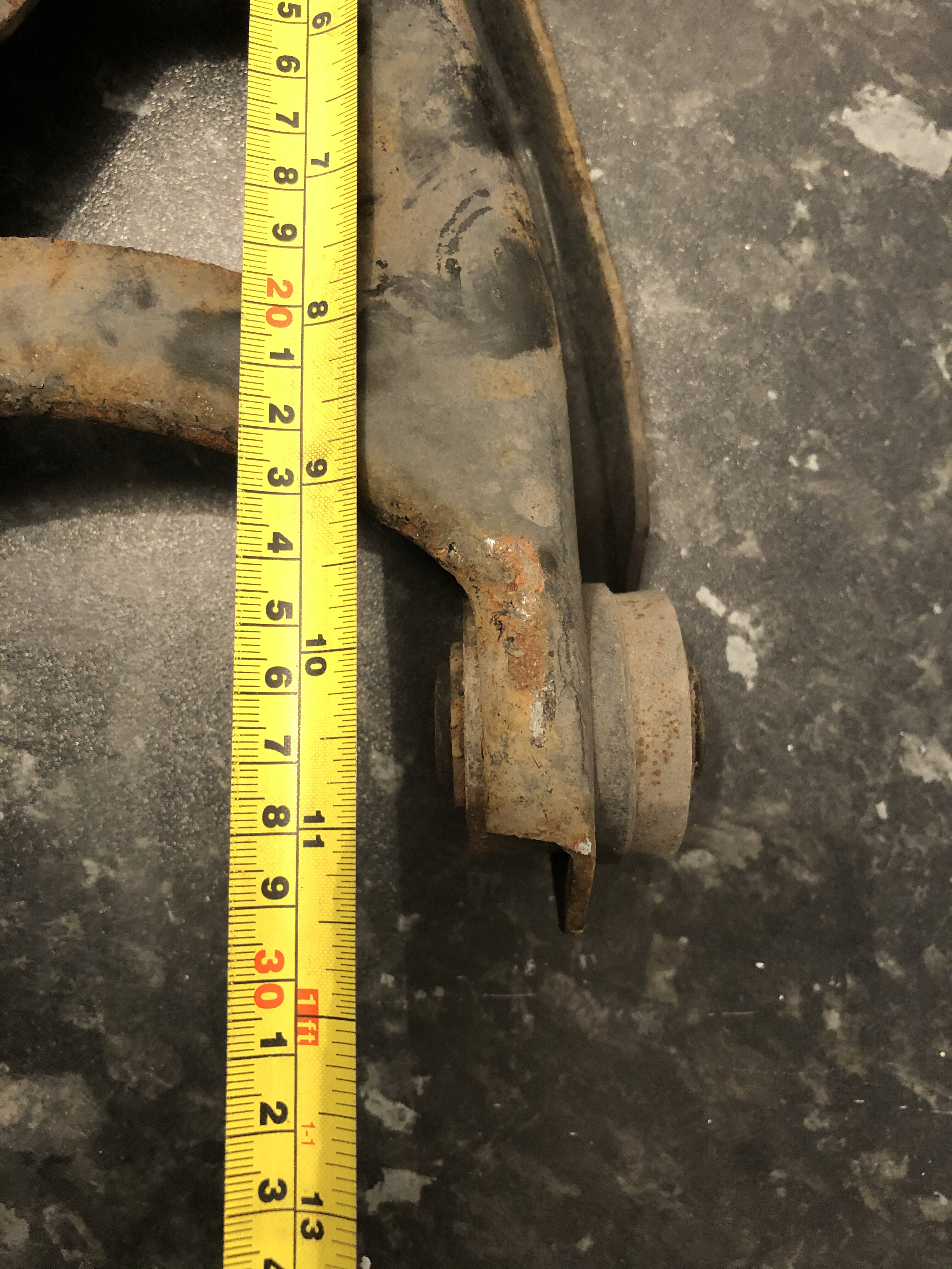

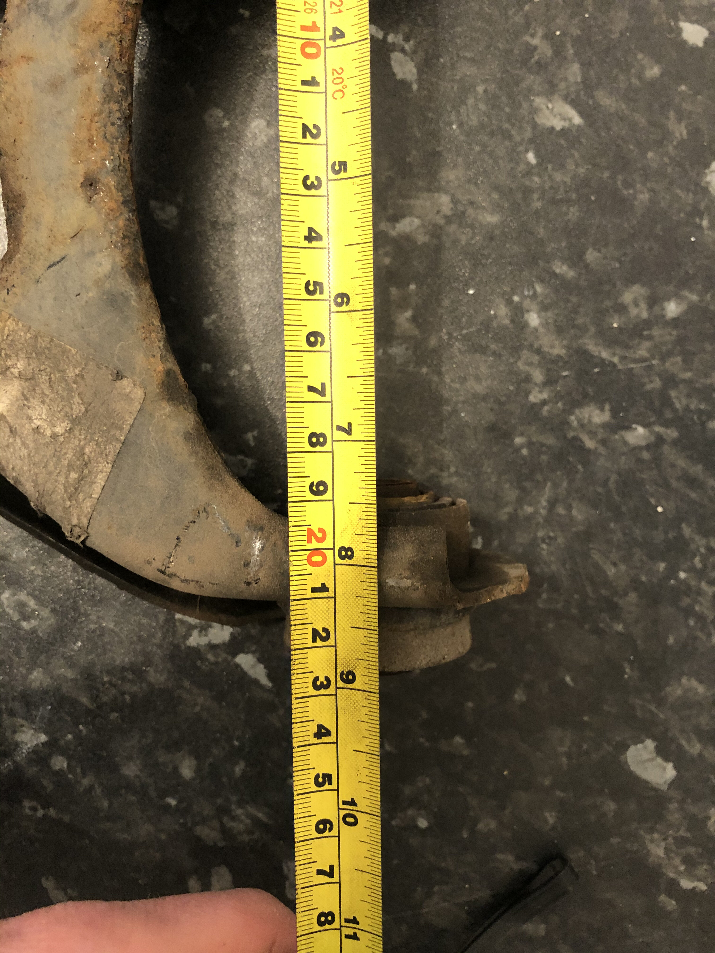

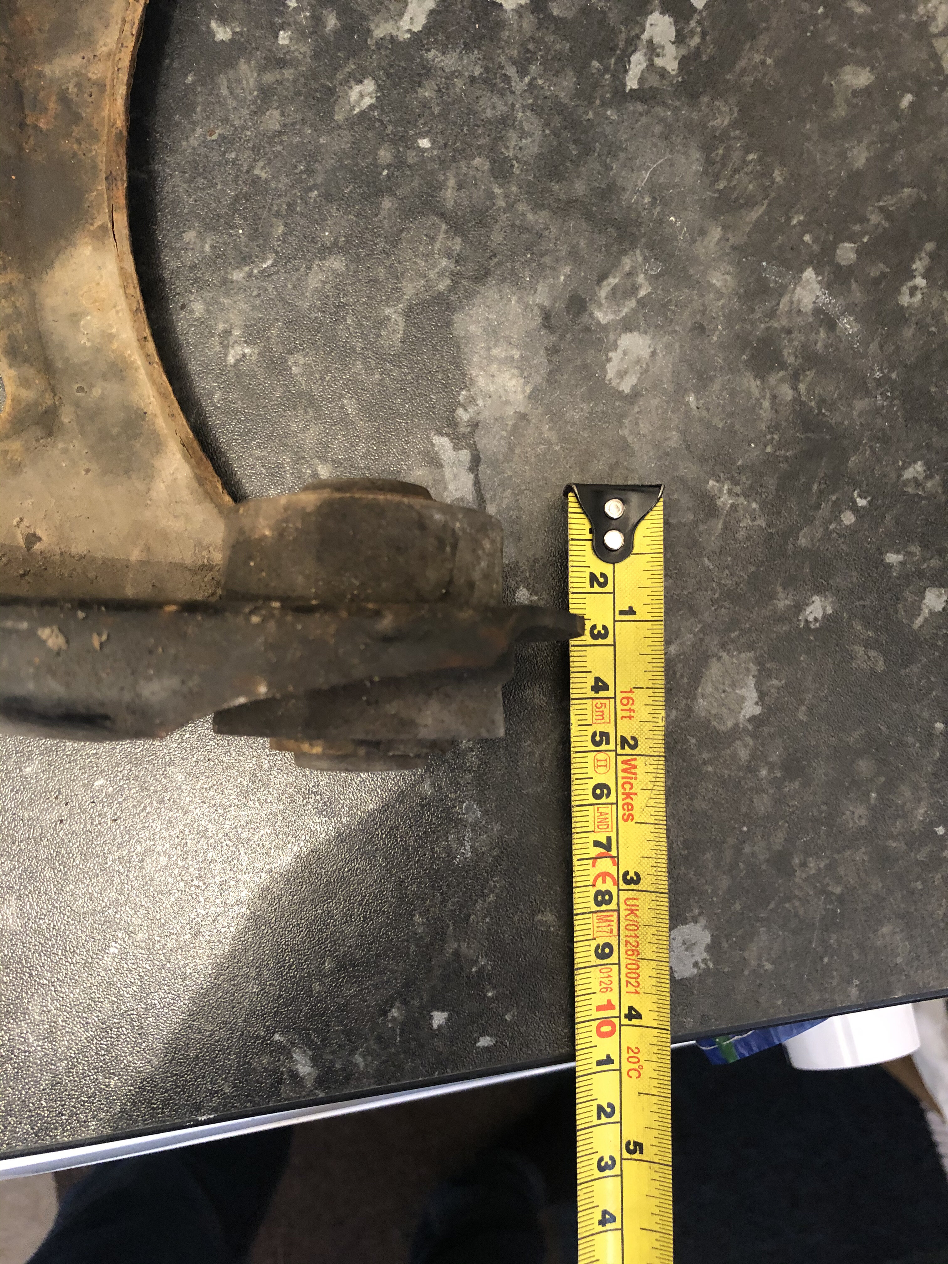

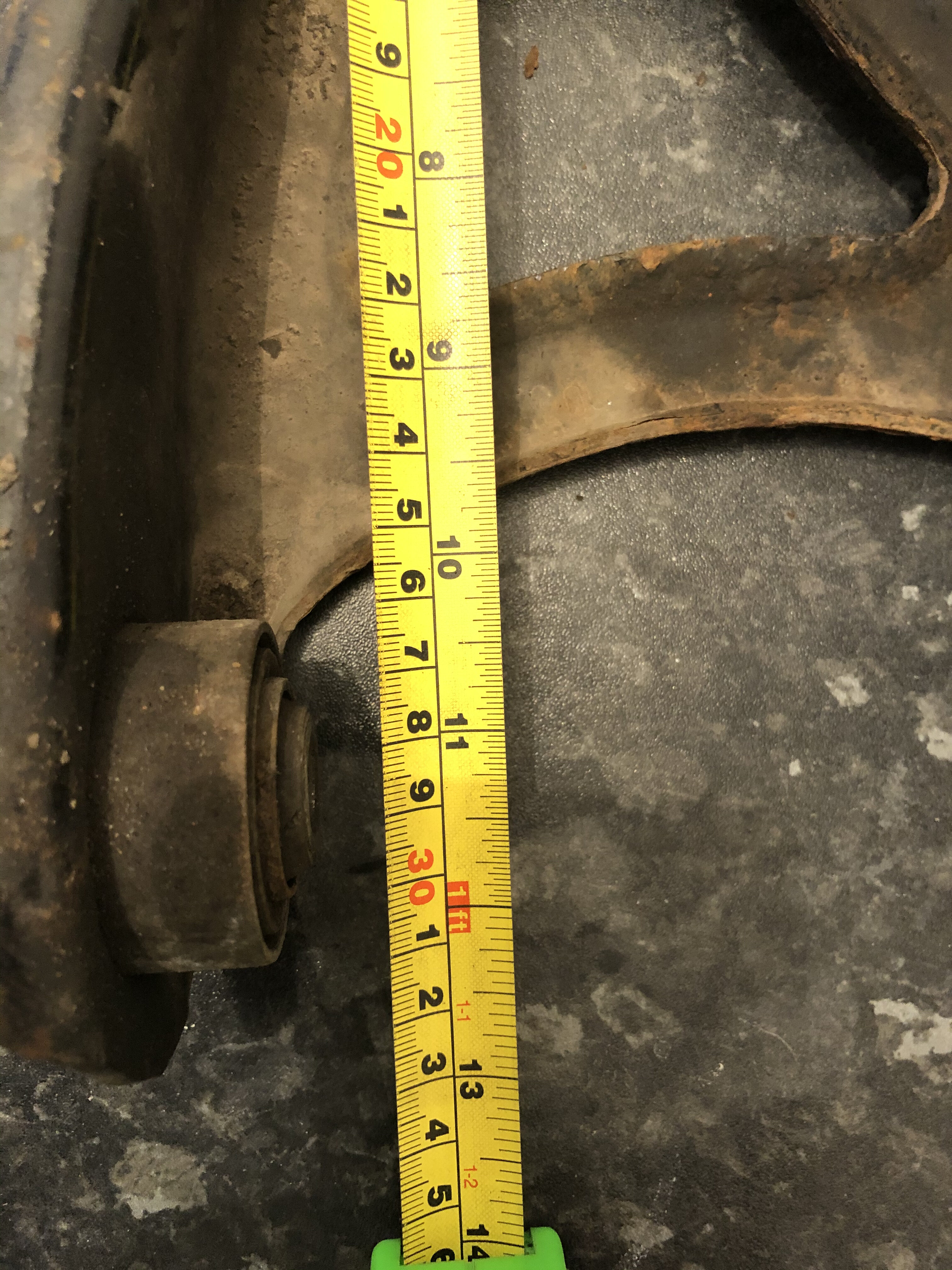

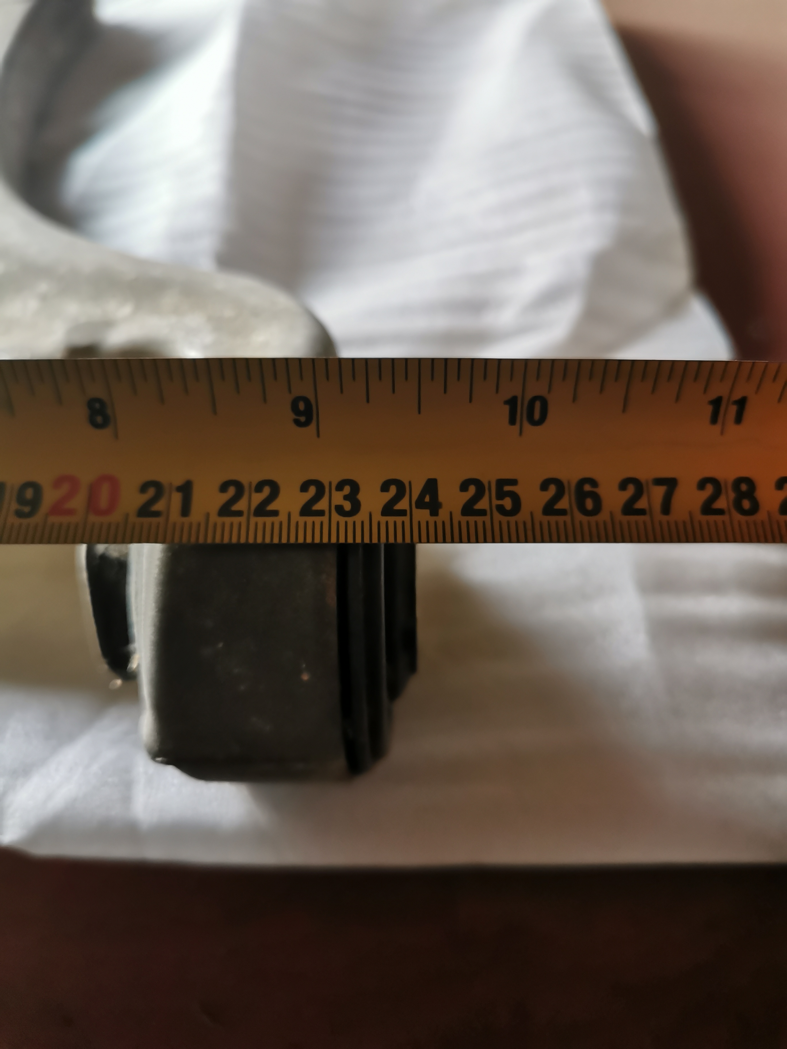

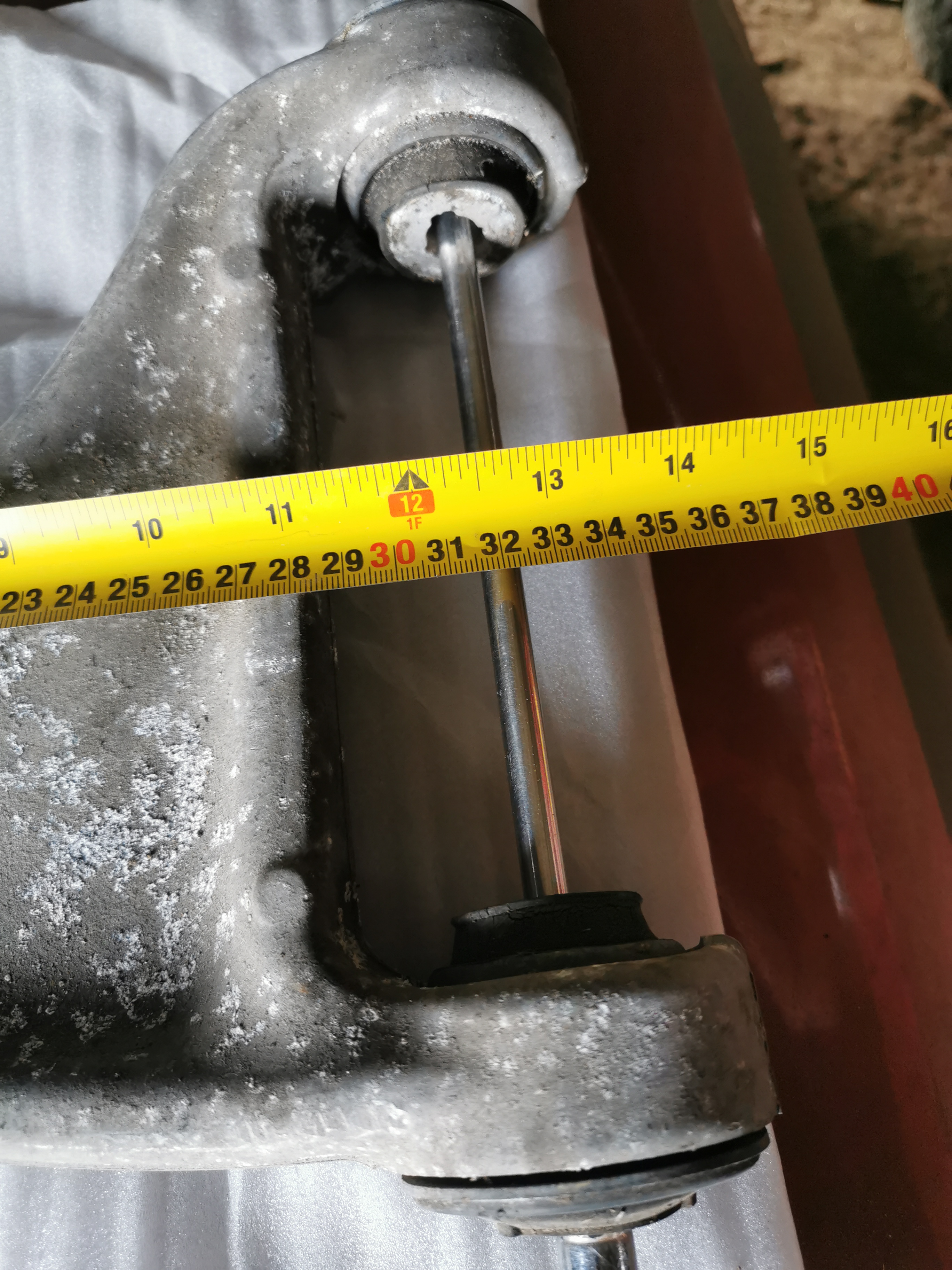

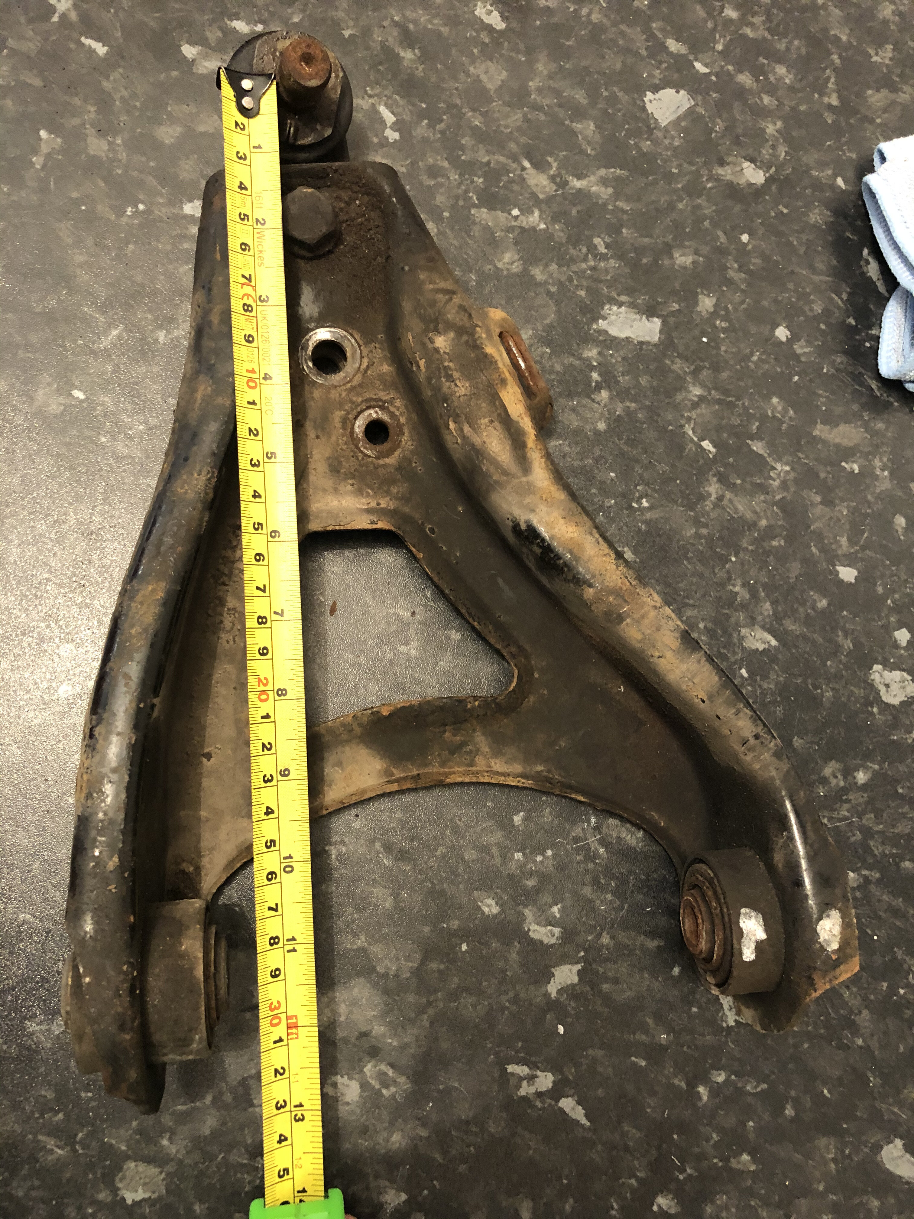

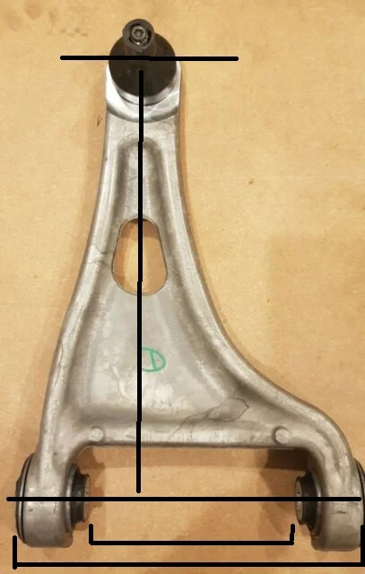

@Twingo 1?? I know you are a busy chap but could you get me some measurements off them if you get chance? between the bushes, inside to inside and outside to outside and centre line of the bolt holes up to the centre of the ball joint please?
Adey.
Cheers @KitsonRis
So they look very close to bolt on compared between each other, maybe a slight difference in bushes. length though..... the rs133 wishbone looks near to 35mm longer. way too much for me to use, i need to gain 10 maybe15mm or loose that length from a shaft.
