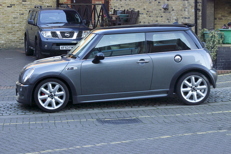

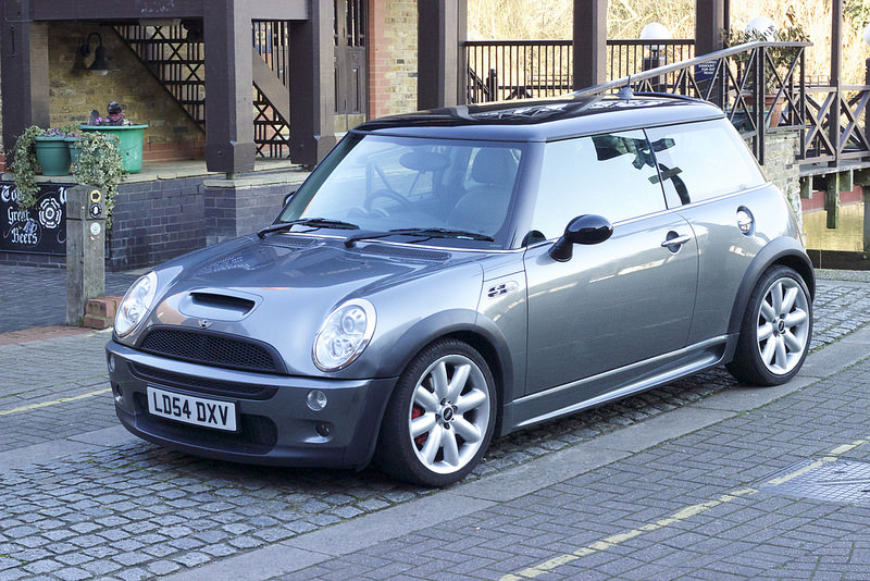

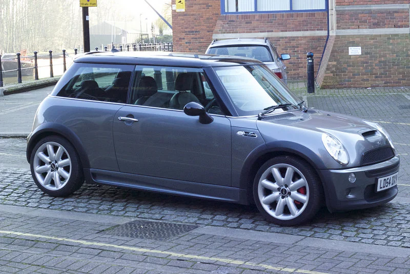

Haven't updated in a while, have just been enjoying it.
Gave it a clean last week and took some updated pics.
IMG_3802 by warren todd, on Flickr
IMG_3804 by warren todd, on Flickr
IMG_3803 by warren todd, on Flickr

Don't often see the Aero skirts without the front bumper... but it definitely works! Will hopefully get my hands on some one day :)

By the way... do you have JCW brakes? I've been told that they're the only ones that come in red on the R53s. Mine are red... but I can't seen any JCW branding on them.
  Clio 197 RB
I believe mine are the R56S brakes. They have been painted red, I don't think they are that colour standard.

Sorry if I've overlooked this but have you changed the springs? Looks like it has loads of rake and could do with either lowering a bit more at the back or raising at the front. May just be the pics though.
  Clio 197 RB
Everything suspension wise is standard. Hasn't been changed since I got it.
Needs a wheel alignment and geometry done!
I believe the R53 JCW brakes (red) and R56 MCS (silver) brakes are the same. As you say, may just have been painted... mine too perhaps :)
