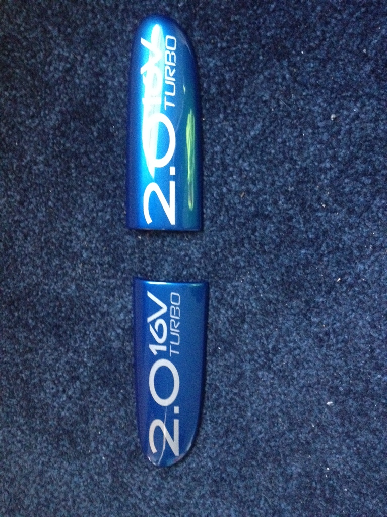

Bullets from the group buy are here :)

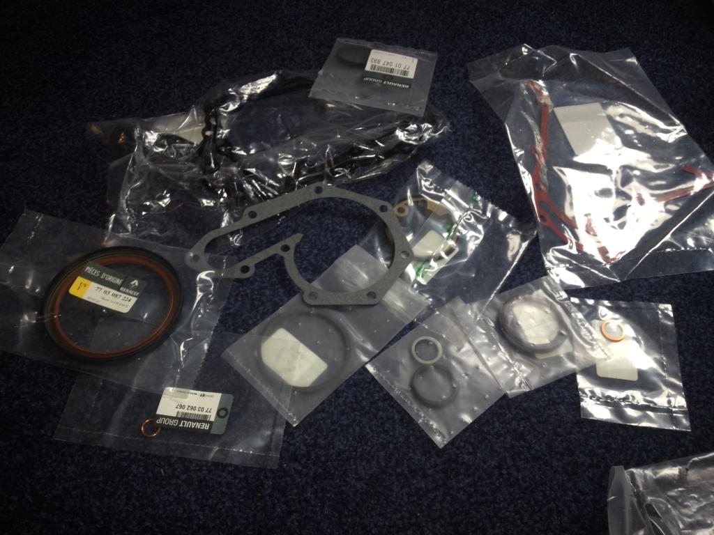

Head seal and gasket kit is here, and the engines coming to bits tomorrow to take out early next week :)

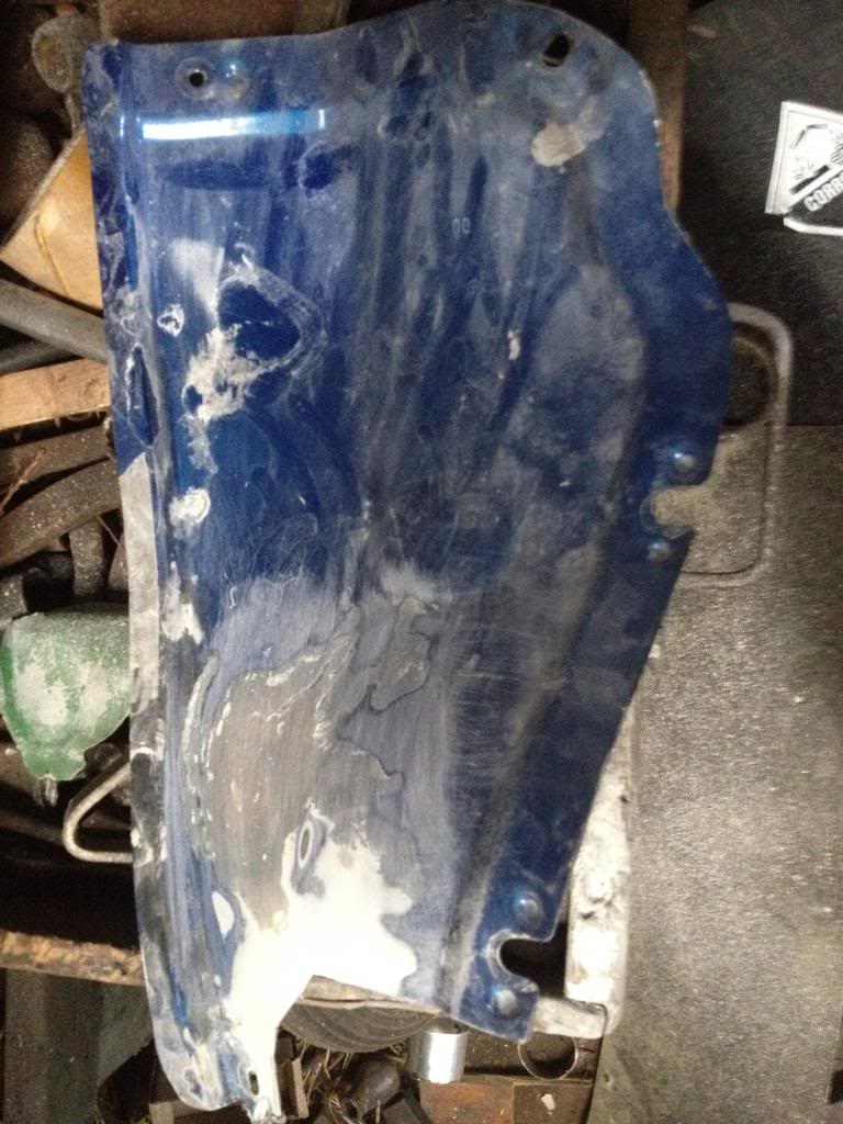

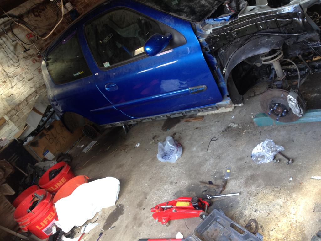

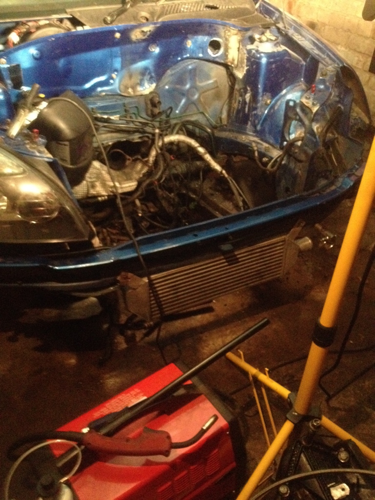

Been working on her again today :)

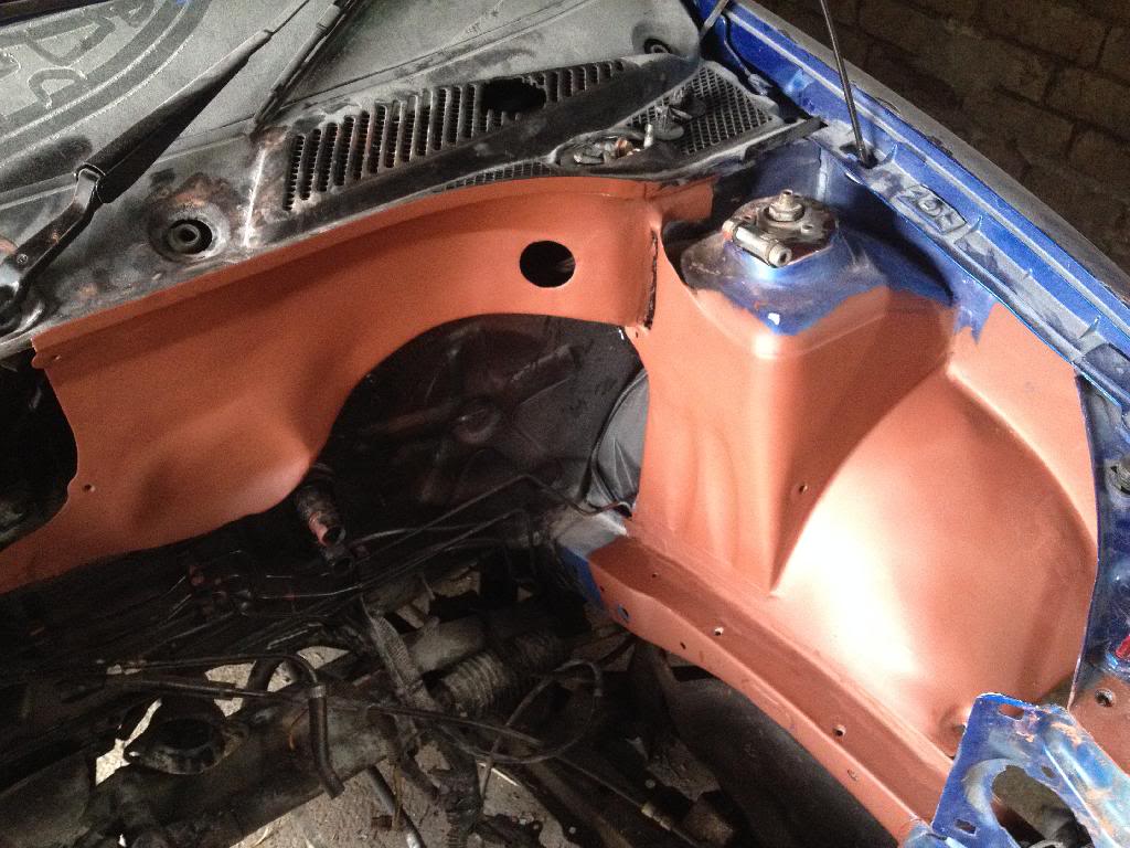

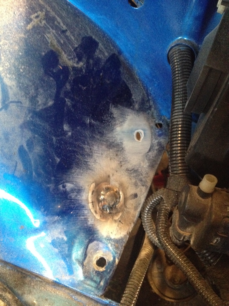

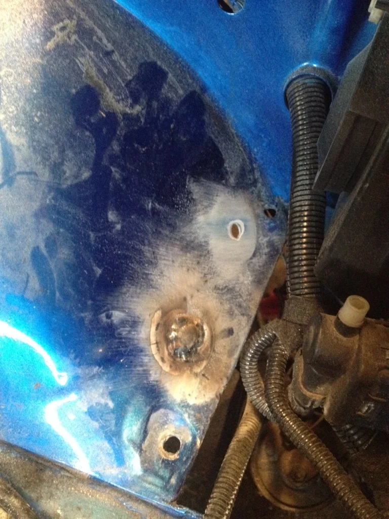

Welded up all the holes left in the bay I didn't want
Then carried on till gone 8 to get it done so I can start prep tomorrow ;)
More updates tomorrow :)

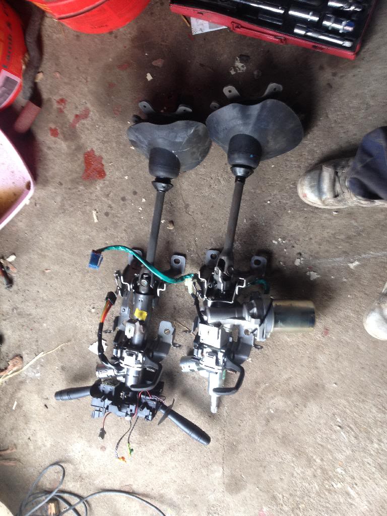

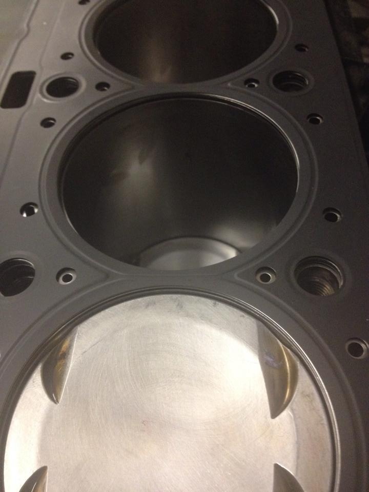

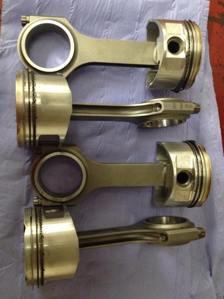

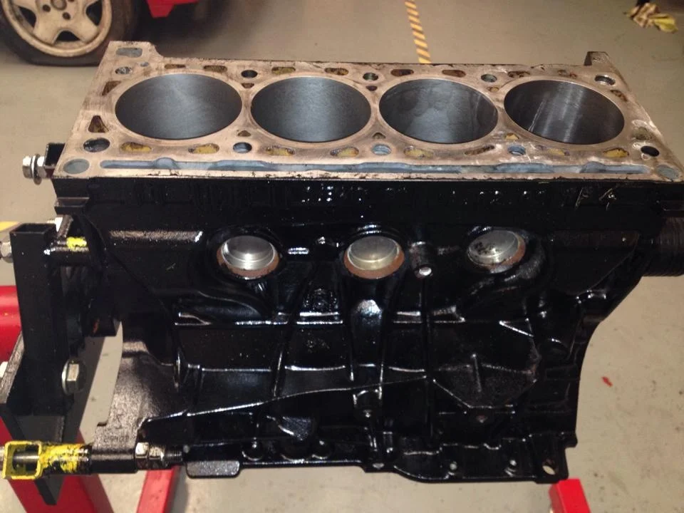

Not updated in a while, managed to get a few bits done but ive been working loads, started a new shift pattern at work and hopefully I will get more time now, mainly waiting on parts now too get the engine done...Its turning out to be quite a high spec engine,All seals, bearings, belts will be replaced, JE 9:5.1 piston, Forged rods, Paddle clutch, supertech valves and springs, looking forward to drive it now :DGot the EPAS column in place
Did the wiring today which is one thing I hate but I got there in the endAlso the bay is nearly ready for paint now

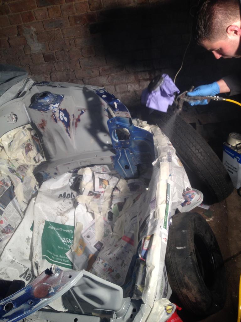

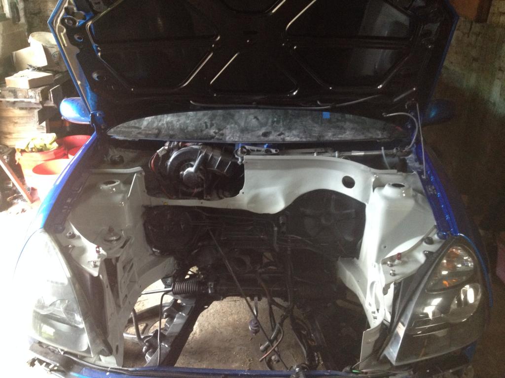

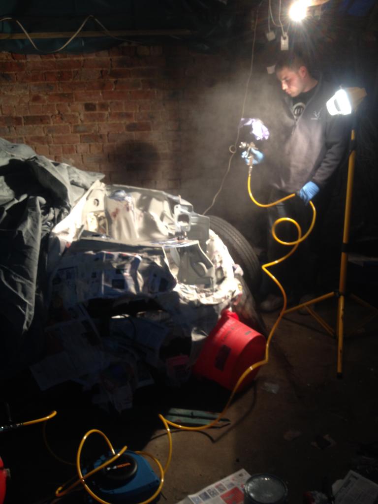

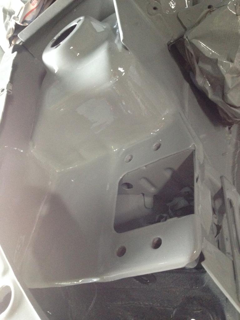

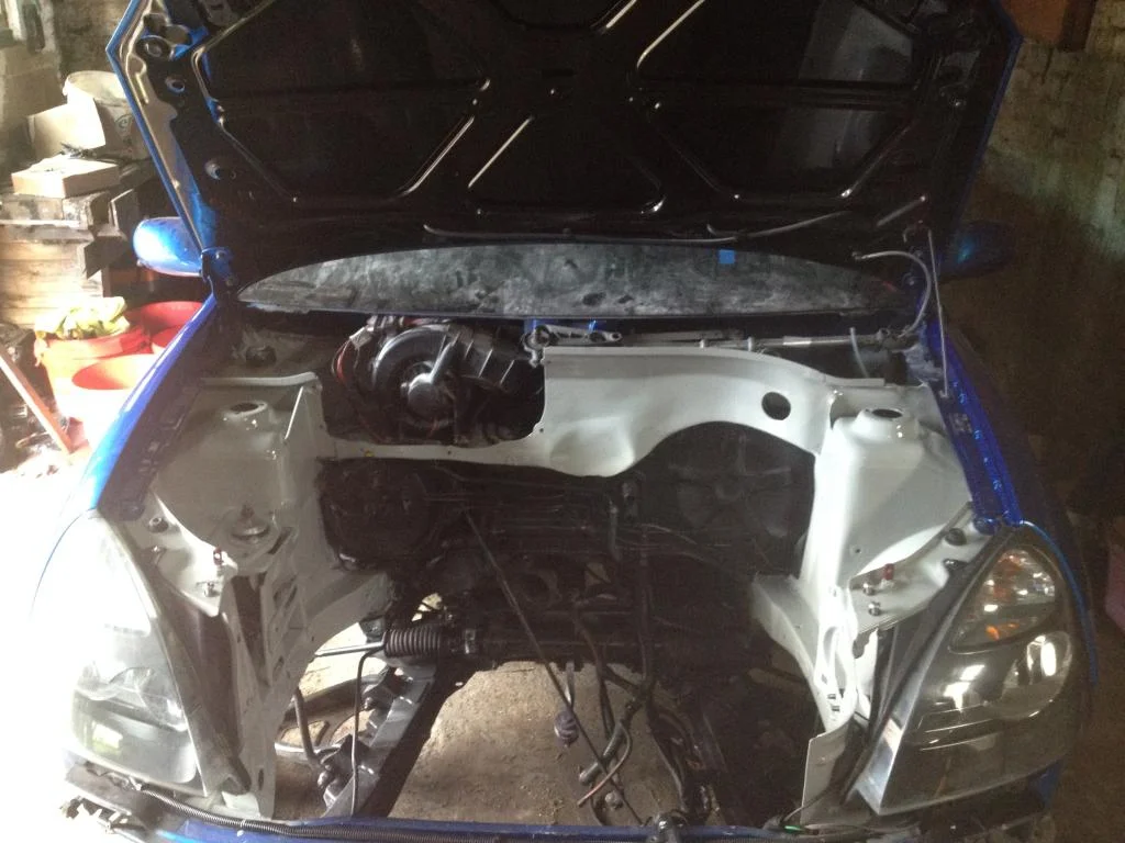

Done a few more bits on cup,
Prepped/smooth even more on the bay ;)
Then Tuesday night my mate came over to paint the bay at 8:30pm
Then finished at near on midnight...
Not bad for a direct gloss paint in an old open front shed, few niggles but will polish out :) very happy and better than the previous bodyshop's job :)

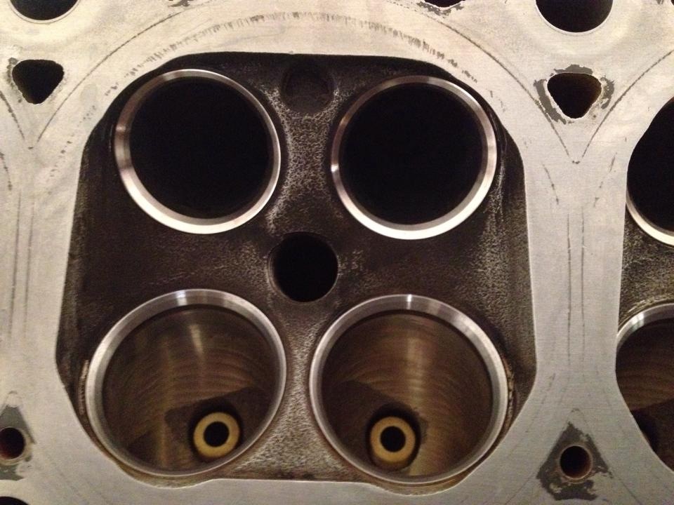

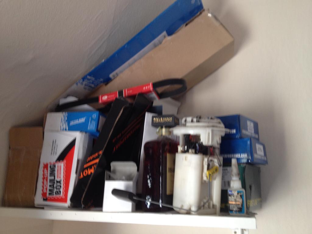

Parts all came just waiting on my supertec exhaust valves..

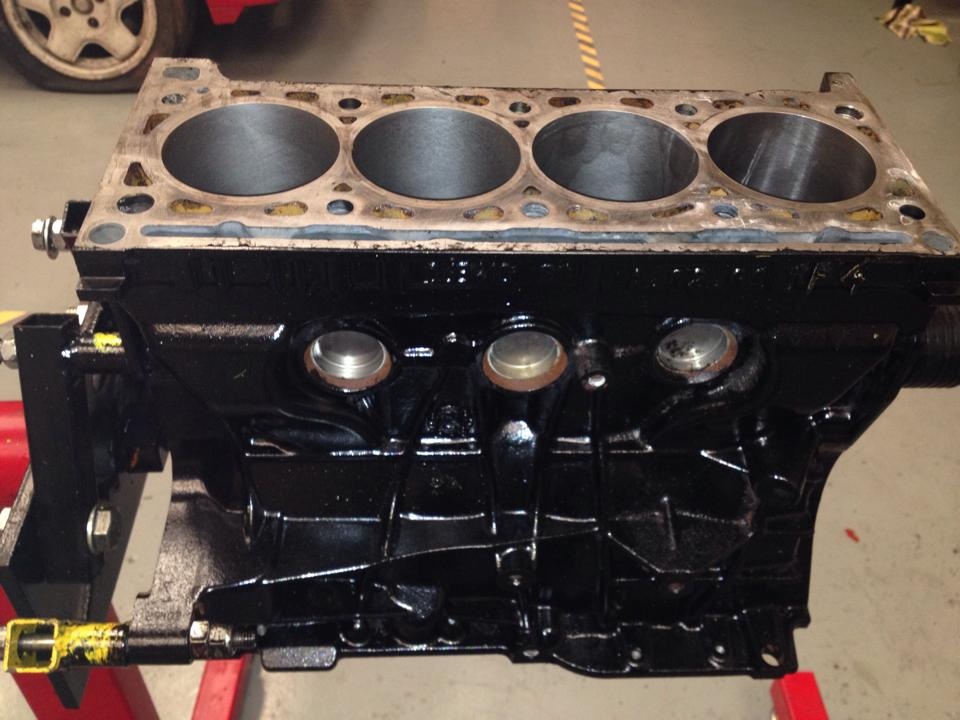

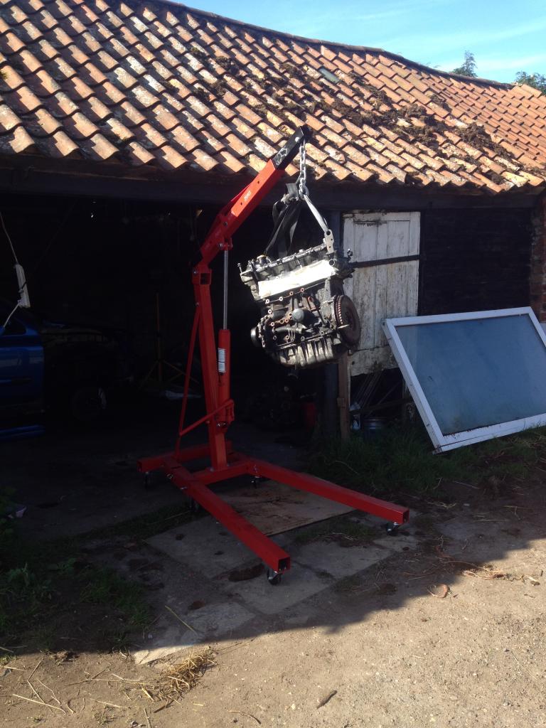

Never the less I took the engine to the builders to get started and ill send the valves over when they come for him to do the head :)

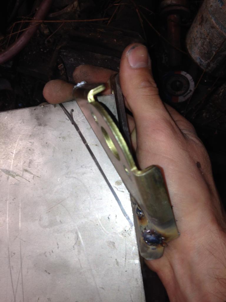

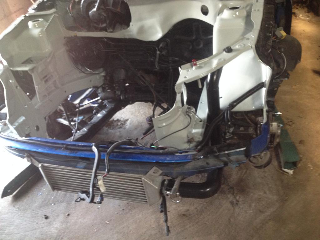

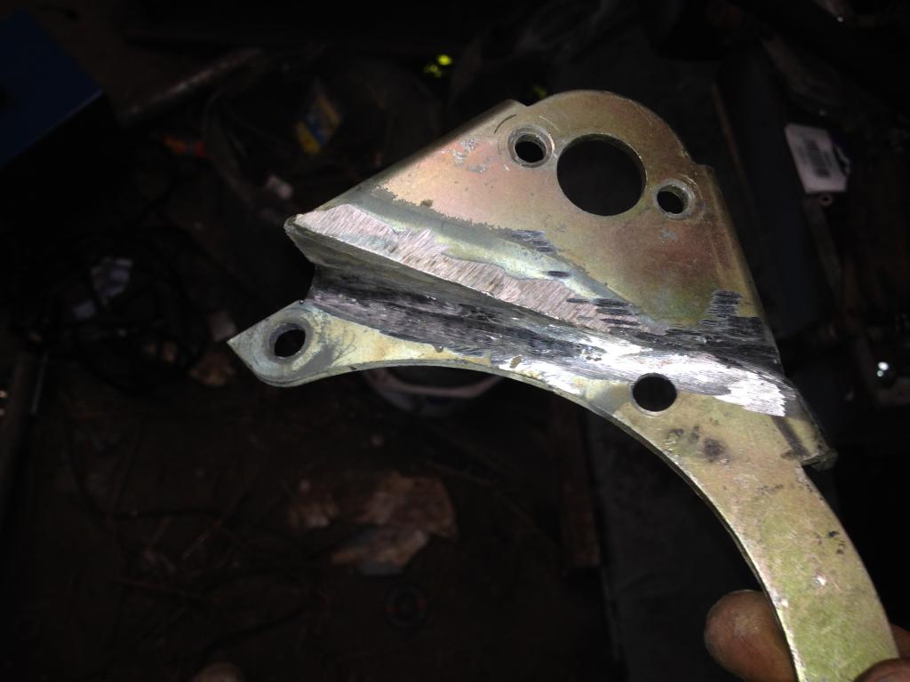

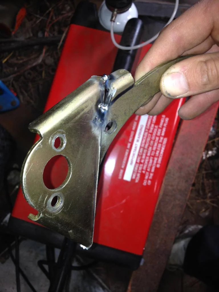

Then I had a spare day and once id rotated the new turbo housing the actuator bracket didn't fit :( sooo I got fabricating, my weldings not anything to shout about but its good enough for this sort of stuff :)

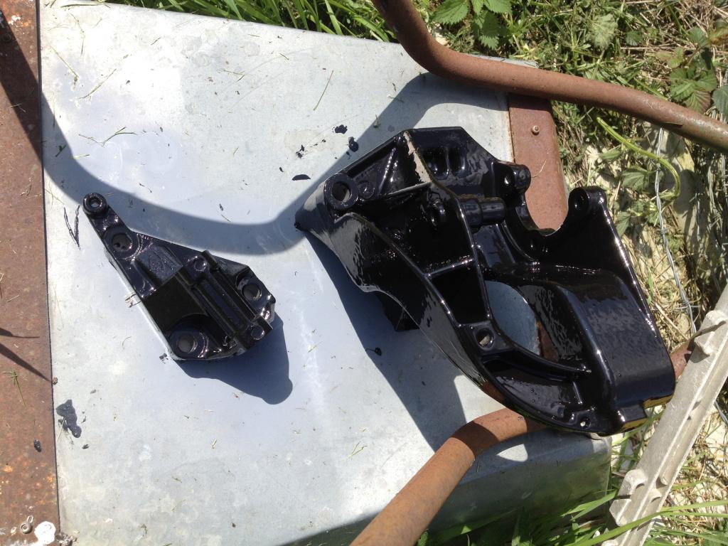

That's currently at the powder coaters with the newly smoothed inlet ;)

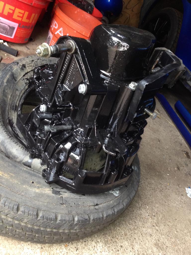

Then the gearbox a snazz up, decided to stick with stock at the moment until I collect parts for O2M

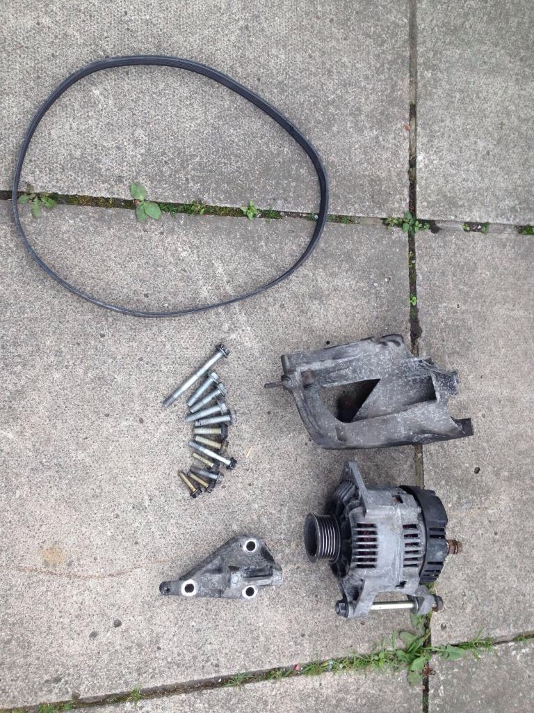

Then finally I found a cup alternator setup to replace the PMS kit, the PMS is a great bit of kit but I needed a new alternator and you cant just run a shorter belt on it and with me binning off the PAS I wanted to do that :)
Got a new shorter Gates belt to run with it, once it arrived I'll tart it up because i'm a ..well a tart haha

Can you take a pic of your actuator bracket in situ? Why did you need such an angle? Could you not just rotate the bracket?
batesey
  172 Cup Turbo
No I needed a large angle for the rod the line up with the gate , I'll take a pic when I have it all back together :)

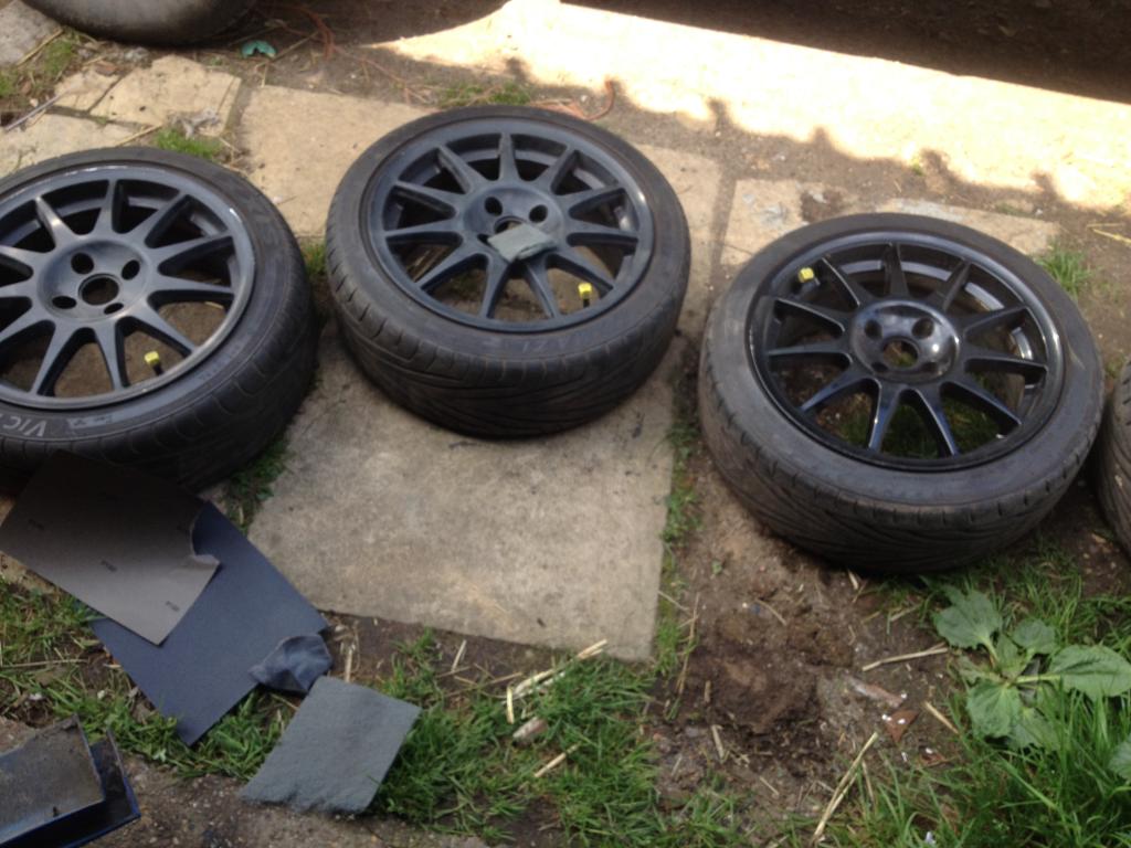

Took the wheels off

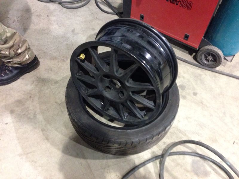

Refurbing them as they have been done 3 years ago and starting to look tatty, got some R888 for the fronts :)

Tyres off the wheels

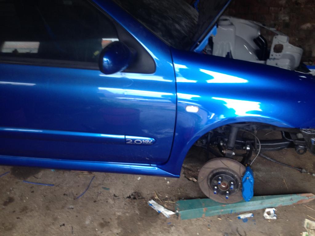

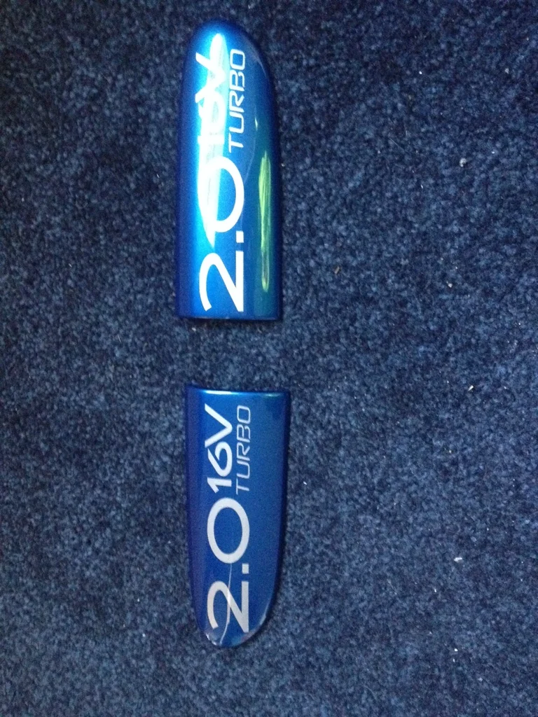

Picked up my resprayed wings earlier so I fitted them and finally fitted the bullets sprayshack made in a group buy :)

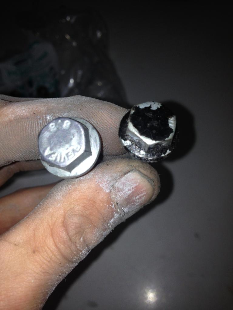

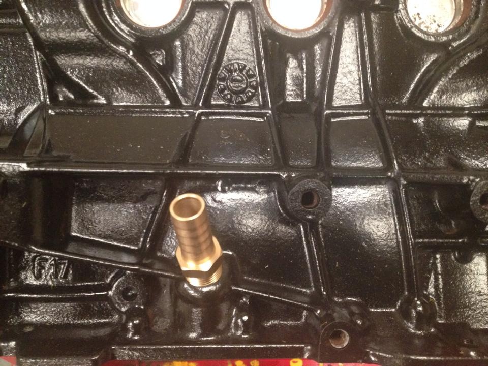

Was also having issues with the liquid metal bungs I made for the EPAS conversion, I couldn't get hold of any M12 x 1.0 bolts so I welded up the holes on my brass fittings which went quite well, then I cleaned them up on the grinder

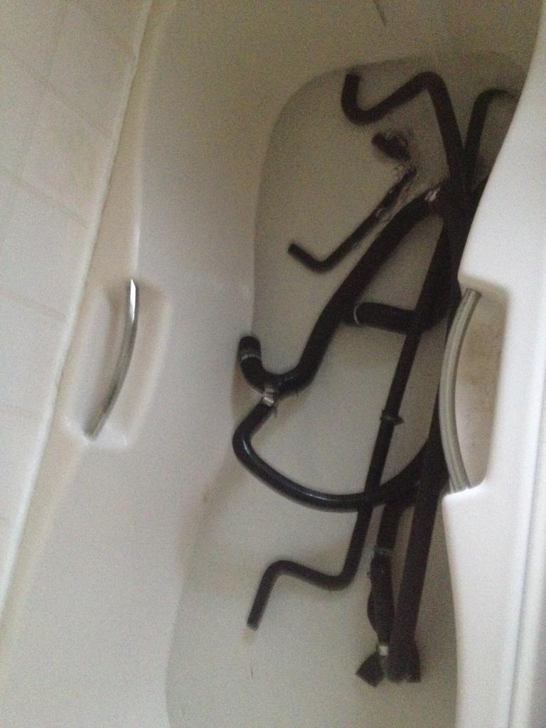

Then decided to clean the hoses in the bath :)

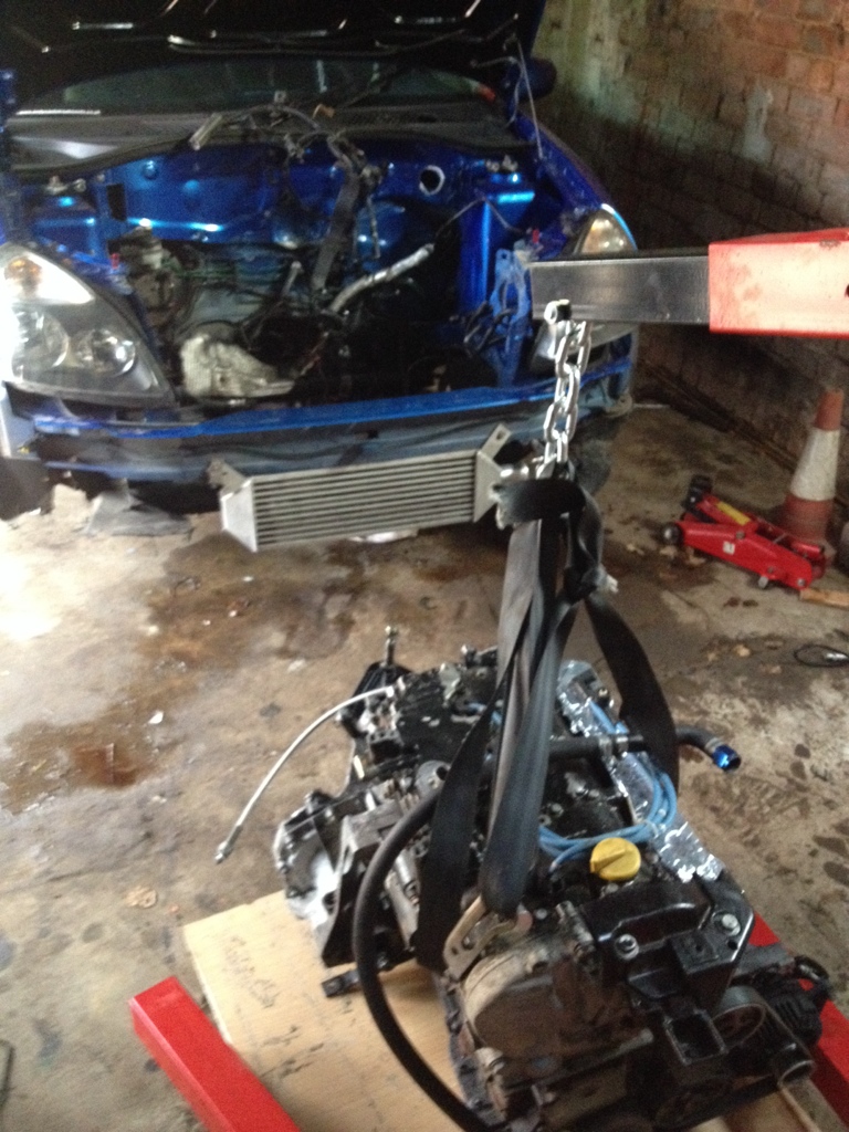

Been at it a bit more the last week...

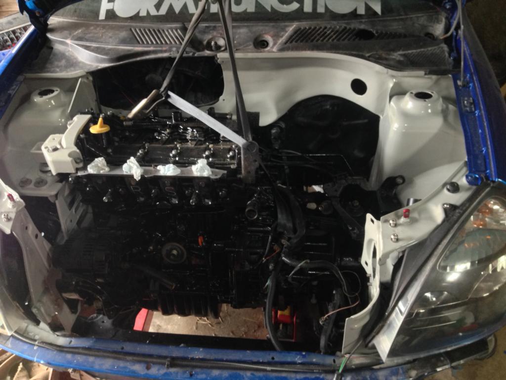

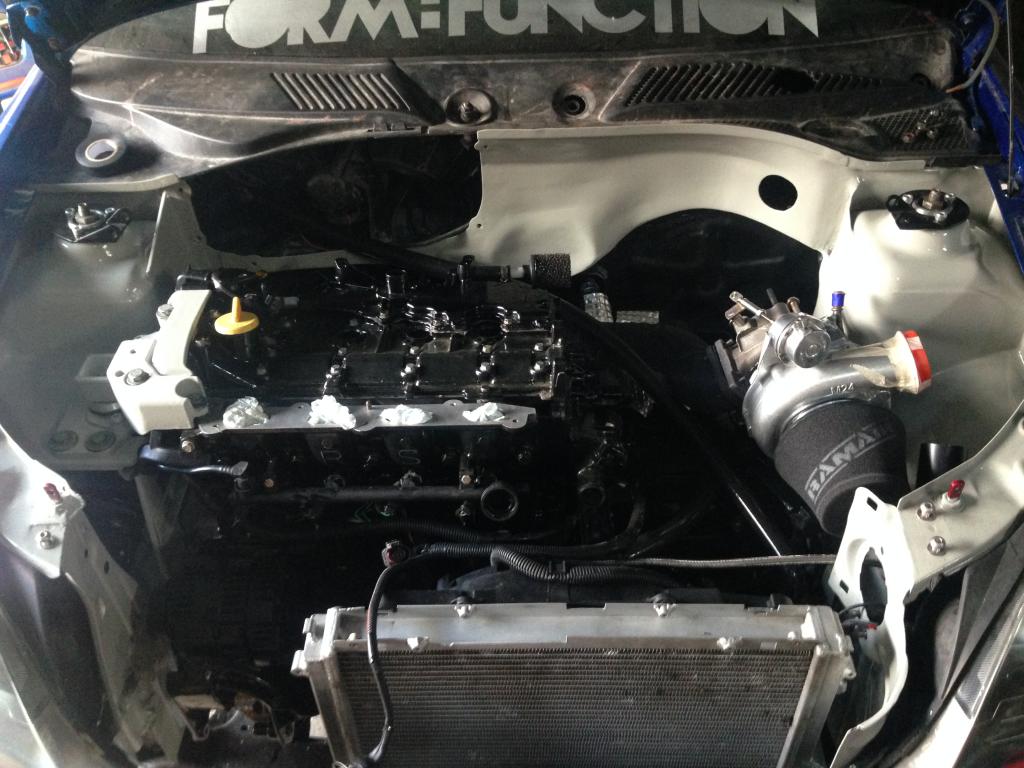

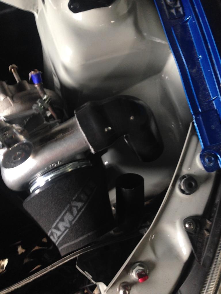

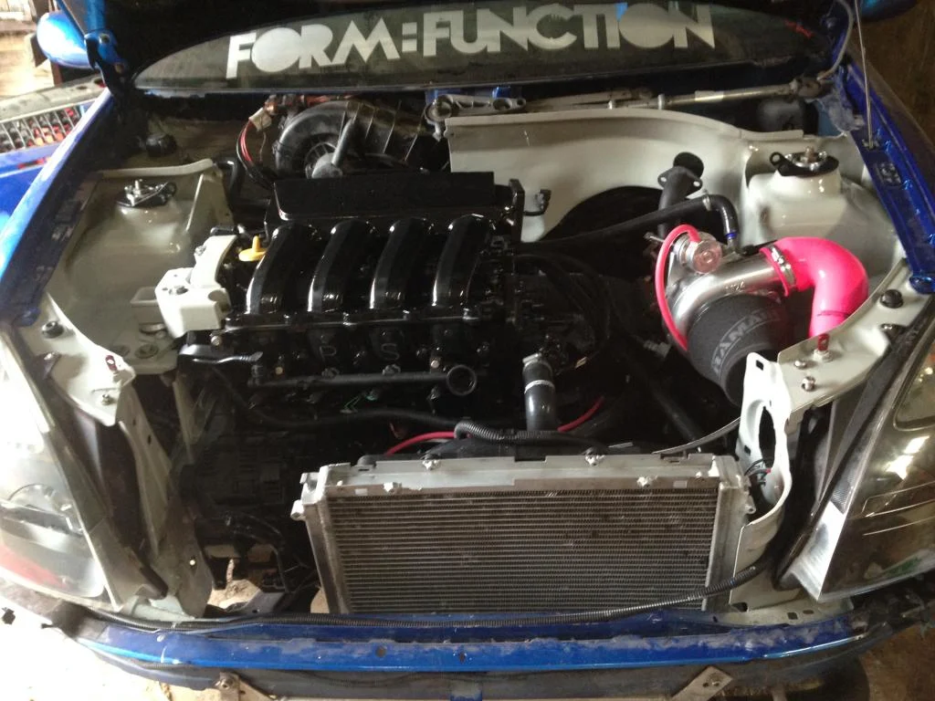

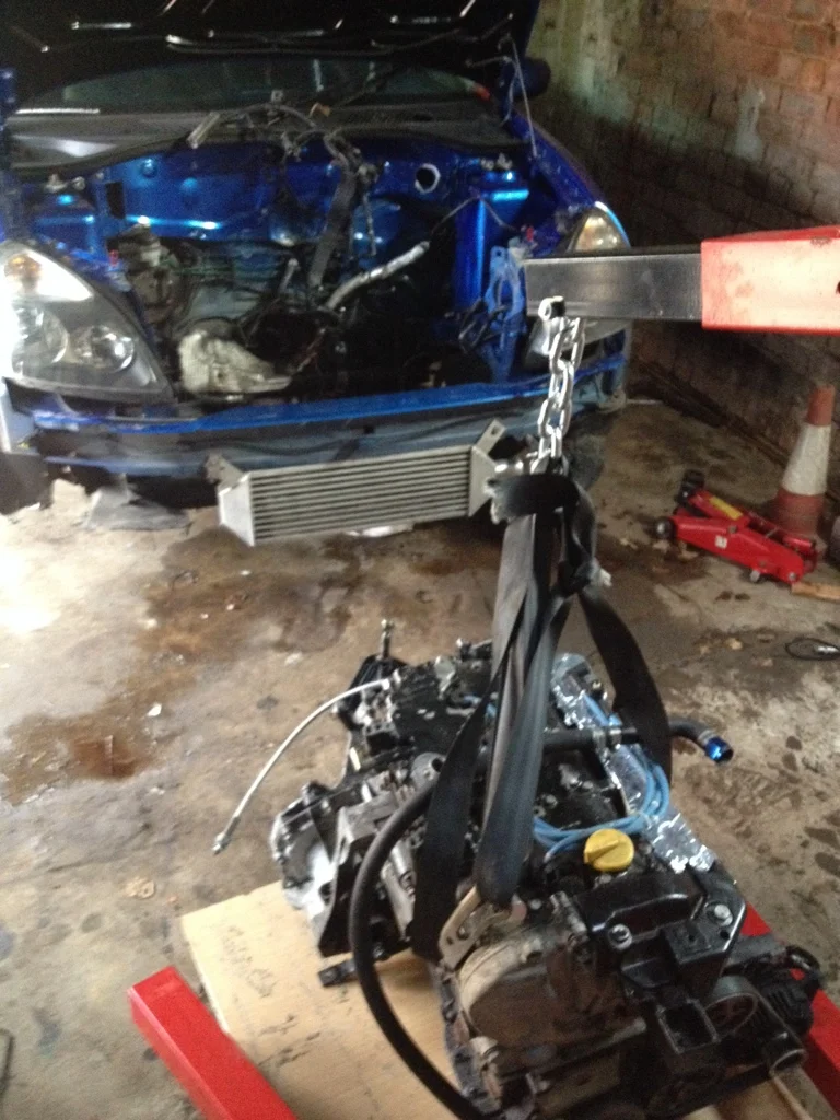

Last friday i go the engine in
Turbo on :)
Slight issue, bigger turbo and few things had altered :(
So Jsperformance to the rescue again, been toying with pink boost hoses for a while :p
Just got downpipe to fit, inlet to fit properly, restof coolant pipes then modify the screamer pipe as its altered slightly,
Will hopefully get it ran in soon :)
